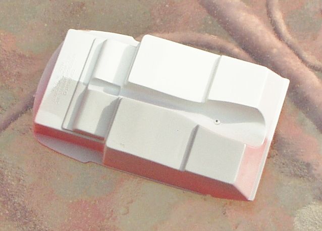

Did this test piece a couple months ago when someone said his clear coat had cased red pigment to leach out of the plastic and ruin his paint job.
Piece is a very red interior tub (underside) from an old Monogram '65 Mustang 2+2. I put one wet coat of cheap Walmart house brand gray primer on it, then masked half of it off and gave the other half one wet coat of cheap Walmart house brand white primer. When that was dry, masked off half of both halves and shot a real nice wet coat of whatever clear was being talked about--I forget If it was Testor Wet Look Clear or Krylon clear--to see if that caused any color bleed.
The pics speak for themselves. That cheap Walmart primer covers pretty well, doesn't it?

All I can tell you is that I TRIED to get some red bleed on the red interior tub above, fully expecting it in fact, and it didn't happen. And I shot that piece several months ago, so no red has worked its way to the surface in that time. It's still about as white as white can get.
