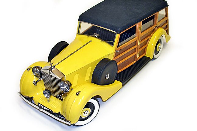

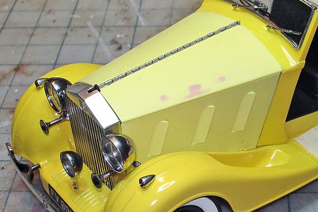

Works for me too. And the stuff looks pretty good in the photos. But I assume it comes in a bottle with a brush applicator, which means you have to decant it, thin it, and airbrush it. Too much of a hassle for me. I've found Spaz Stix to be a great alternative. It comes in a spray can, so no messing with an airbrush... and the chrome effect is about the best I have seen. All the chrome parts on this model were messed up... flaking, and sort of a satin finish rather than shiny chrome. So the chrome trees were stripped, and all the chrome on this model is Spaz Stix. Judge for yourself...

That's a beautiful chrome finish Harry. Was a base coat used before spraying with Spaz Stix?

More examples of Spaz Stix... the wheels on this Mercedes...
The grille shell on this Bentley...
Grille shell on this SS Jaguar...

I first primer the part, then spray (Krylon Short Cuts) gloss black enamel, and let it dry. Then I spray a couple of light coats of Spaz-Stix Mirror Chrome and it seems to work just fine.
