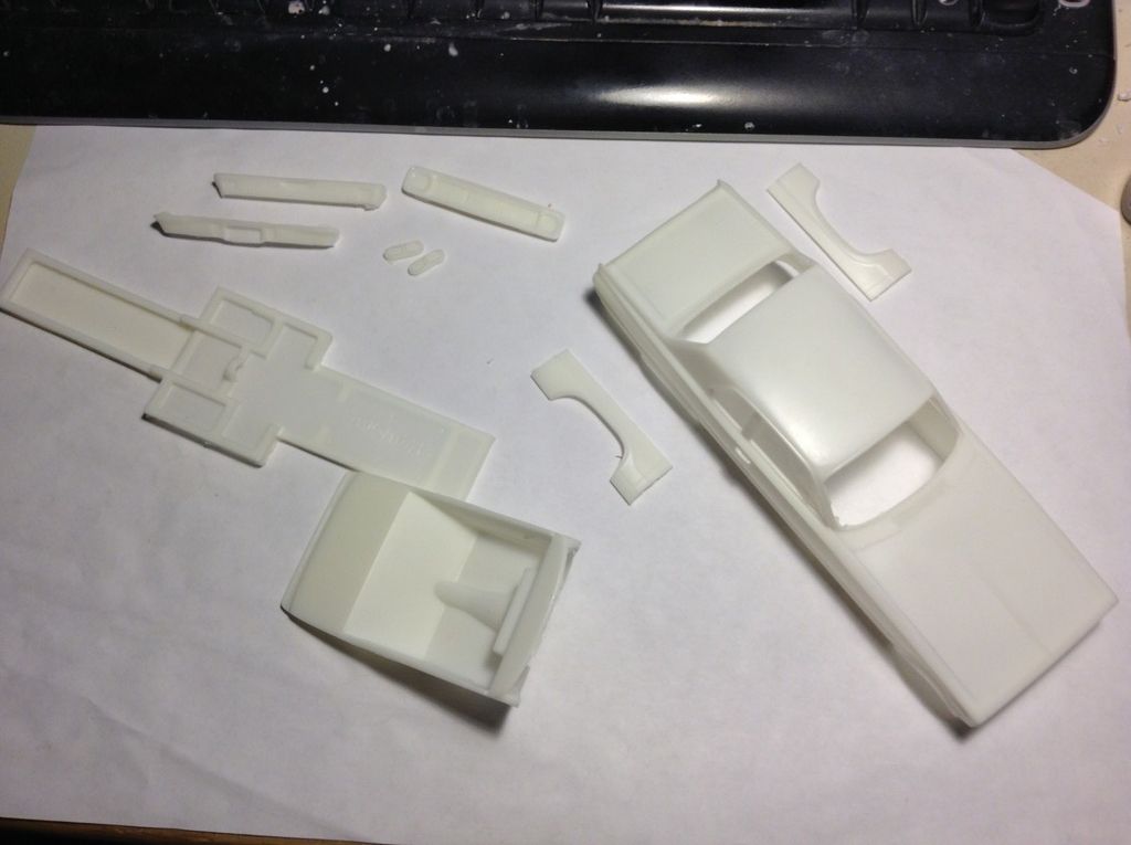

jjsipes Posted August 9, 2016 Posted August 9, 2016 I just received my resin body from Speed City Resin and have started to do research for this car. Having some trouble locating info on chassis. This is about time that they started using tube chassis' and wondering if this car had a full tube chassis? Does anyone have any reference they are willing to share. I have a bunch of builds started and I won't be geting to this one for a little while. I have some pictures I found online but no clear underhood shots of chassis. Here's the Speed City Resin Kit The chassis it comes with.
10thumbs Posted August 9, 2016 Posted August 9, 2016 Hi Jason, I'm no expert with this, but I can't imagine anything other than a custom chassis for a car like this. Tube frame? Probably. The last pic pretty much shows the deal. When the flash is trimmed off, is the frame round or boxed? I'd almost bet money that Speed City gave lots of attention to this detail. Another idea from this period is Don Nicholson's Comet. Not a Mopar of course, but some insight for the era. The pics of this car flipped up in the pits are readily available.That sure does look like a nice quality piece from Speed City. Cool car too, will make for a great model, good luck with your future endeavors.
jjsipes Posted August 9, 2016 Author Posted August 9, 2016 I was able to find this article. It starts out with the short car and then progresses into the long nose car. Thought I would share for anyone interested. Looks like the frame is square tube, like the resin kit has.http://www.moparmax.com/columns/magnante/vii_4-1.html

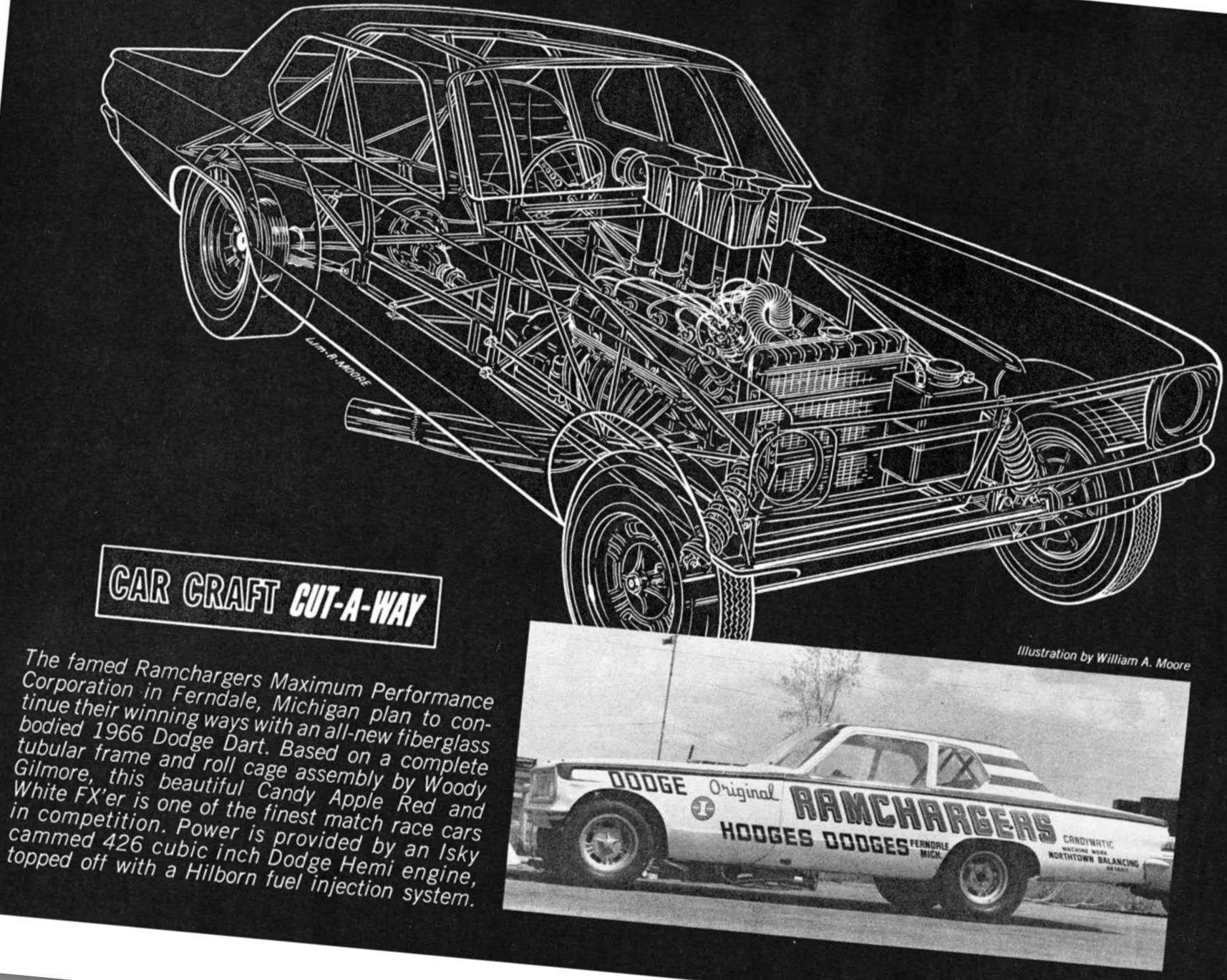

Daddyfink Posted August 10, 2016 Posted August 10, 2016 I now there is a Popular Hot Rodding Cut Away drawing of the car somewhere that shows the chassis pretty good. I will check and see if I have it when I get home.

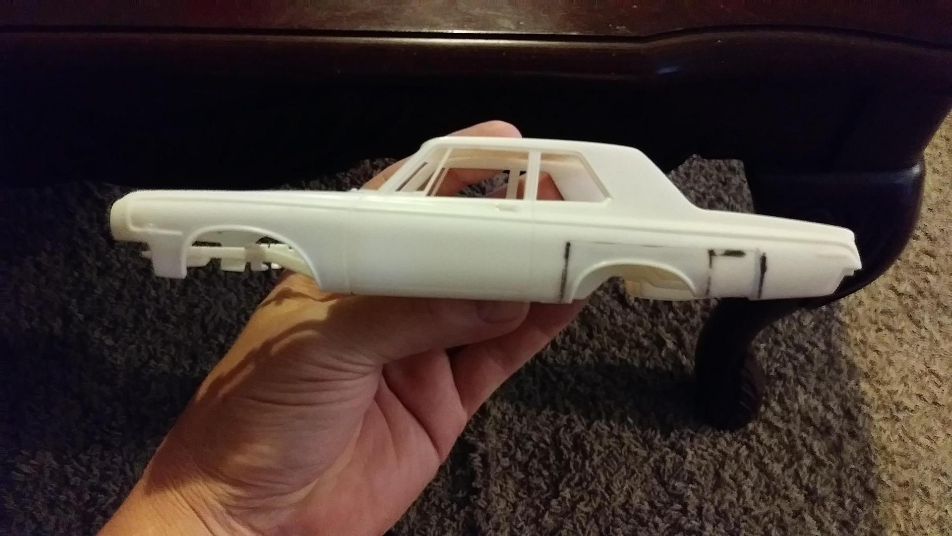

Harry P. Posted August 10, 2016 Posted August 10, 2016 Looks like you're going to have to do some serious reshaping of the rear wheel cutouts.

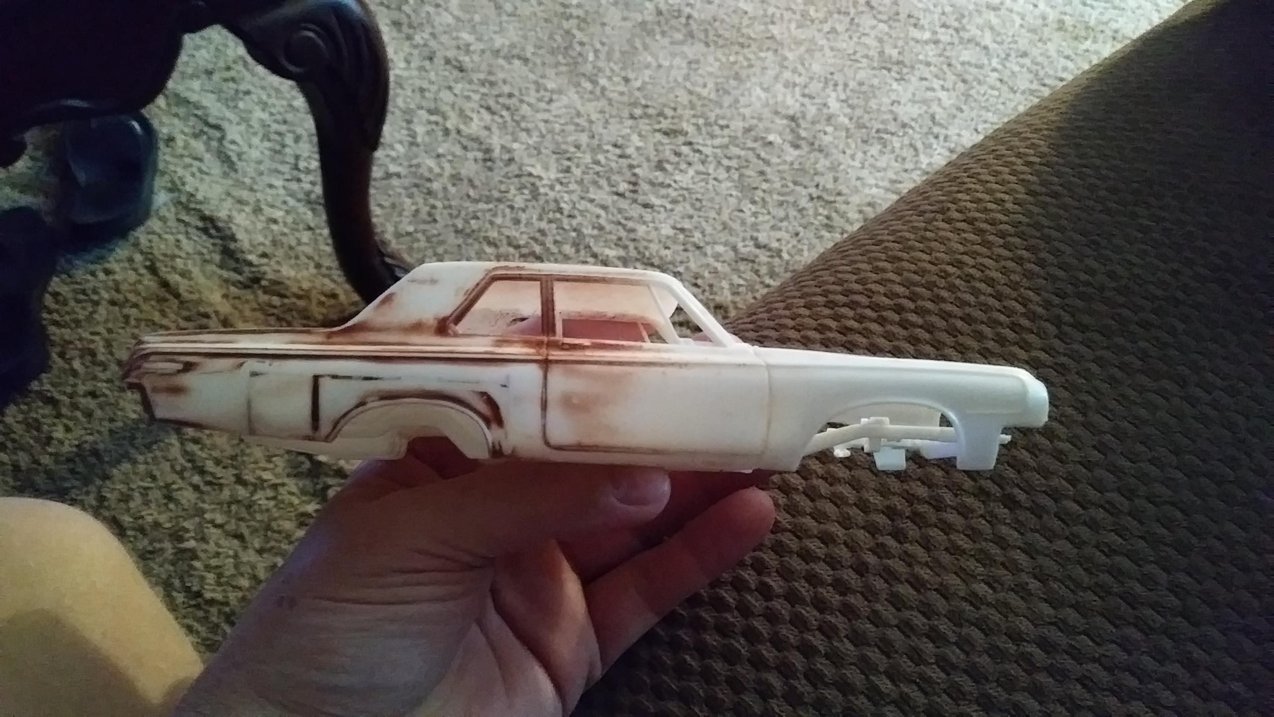

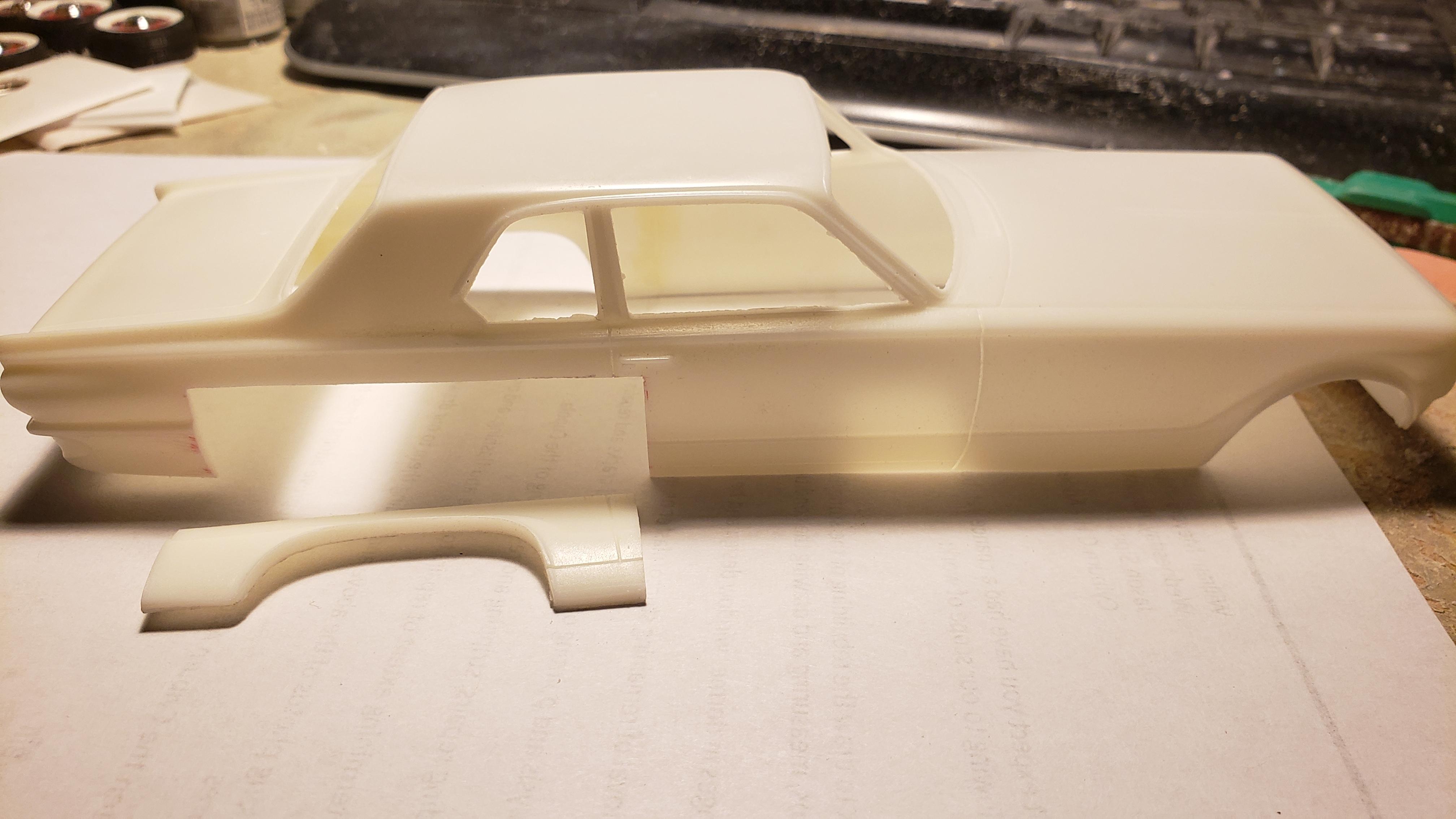

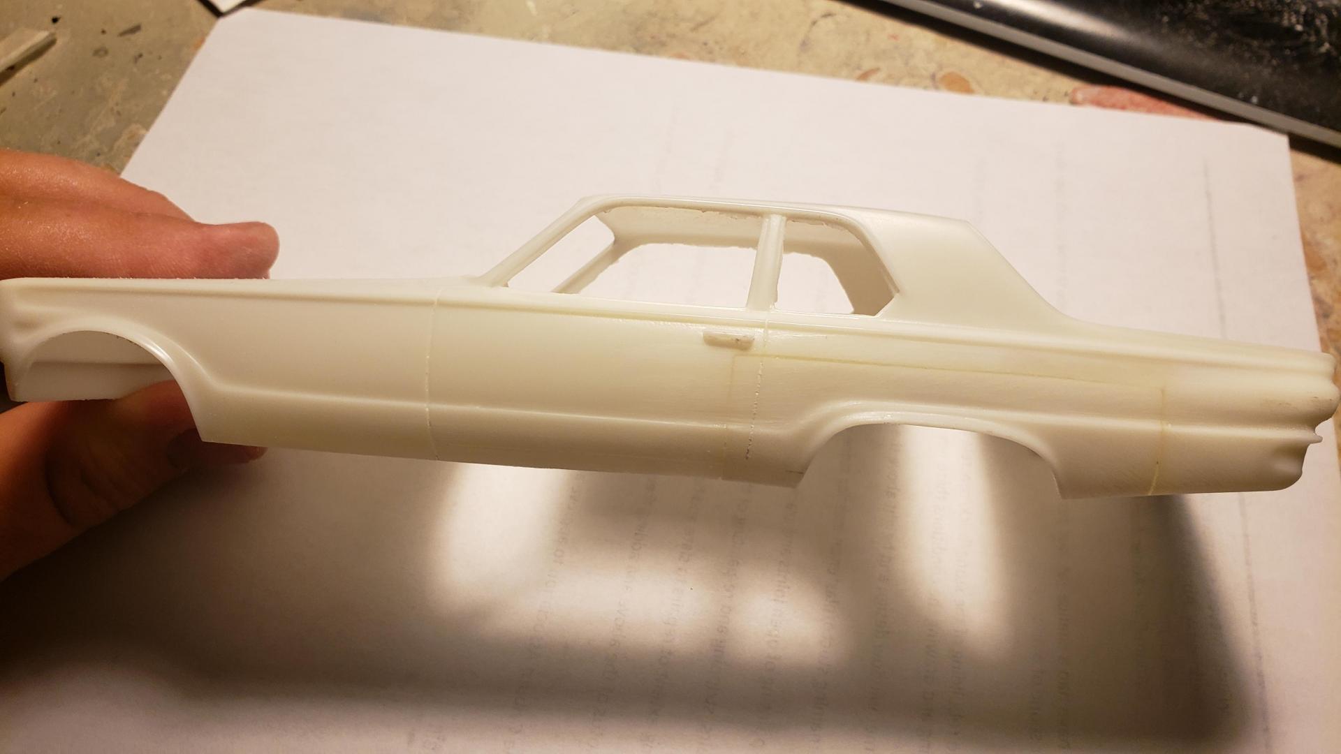

jjsipes Posted August 16, 2019 Author Posted August 16, 2019 Got discouraged with this when I started to modify wheelbase. Cut body to use the altered quarters and tried gluing it in on drivers side but superglue didn't want to hold. Put it back in box then. Decided to pull it out and see what's what with it and determined that I would try some 2 part epoxy I have. Seems to be holding better this time around. Cut the passenger side and got it ready to epoxy it in. Still need to enlarge to wheel openings. 1
Scott8950 Posted August 17, 2019 Posted August 17, 2019 23 hours ago, jjsipes said: Got discouraged with this when I started to modify wheelbase. Cut body to use the altered quarters and tried gluing it in on drivers side but superglue didn't want to hold. Put it back in box then. Decided to pull it out and see what's what with it and determined that I would try some 2 part epoxy I have. Seems to be holding better this time around. Cut the passenger side and got it ready to epoxy it in. Still need to enlarge to wheel openings. Gorilla glue has worked great for me so far. 1
jjsipes Posted August 17, 2019 Author Posted August 17, 2019 8 hours ago, Scott8950 said: Gorilla glue has worked great for me so far. Looks good. I did the same thing when I built my 65 Landy Dodge from the Polar Lights Coronet kit. Most of the time super glue has worked for me but for some reason it didnt on this resin body.
Scott8950 Posted August 17, 2019 Posted August 17, 2019 i didn't pay attention until i had posted, your car is a resin. i have never personally built a resin car but i have read on here that certain glues don't do well with resin.
Speed City Resin Posted April 9, 2024 Posted April 9, 2024 You need to use Loctite "Professional Liquid super glue !.... Regular super glue has a weaker formula and does not work on resin models/parts ! All this is posted on the www.seedcityresin.com website. Also: To get any information on the resin models that I have created and sell, I can also give advise, photos and even article pages. I can't understand why you guy's don't contact me since I was the one who created this model and most likely will have more information on these early funny cars than anyone else! Yes, the Dick Landy Long Nose '66 Dart had a Square Tube Chassis ! Round tube chassis' didn't come around until the fiberglass bodied "FlipTop" Funny Cars in 1967. 4

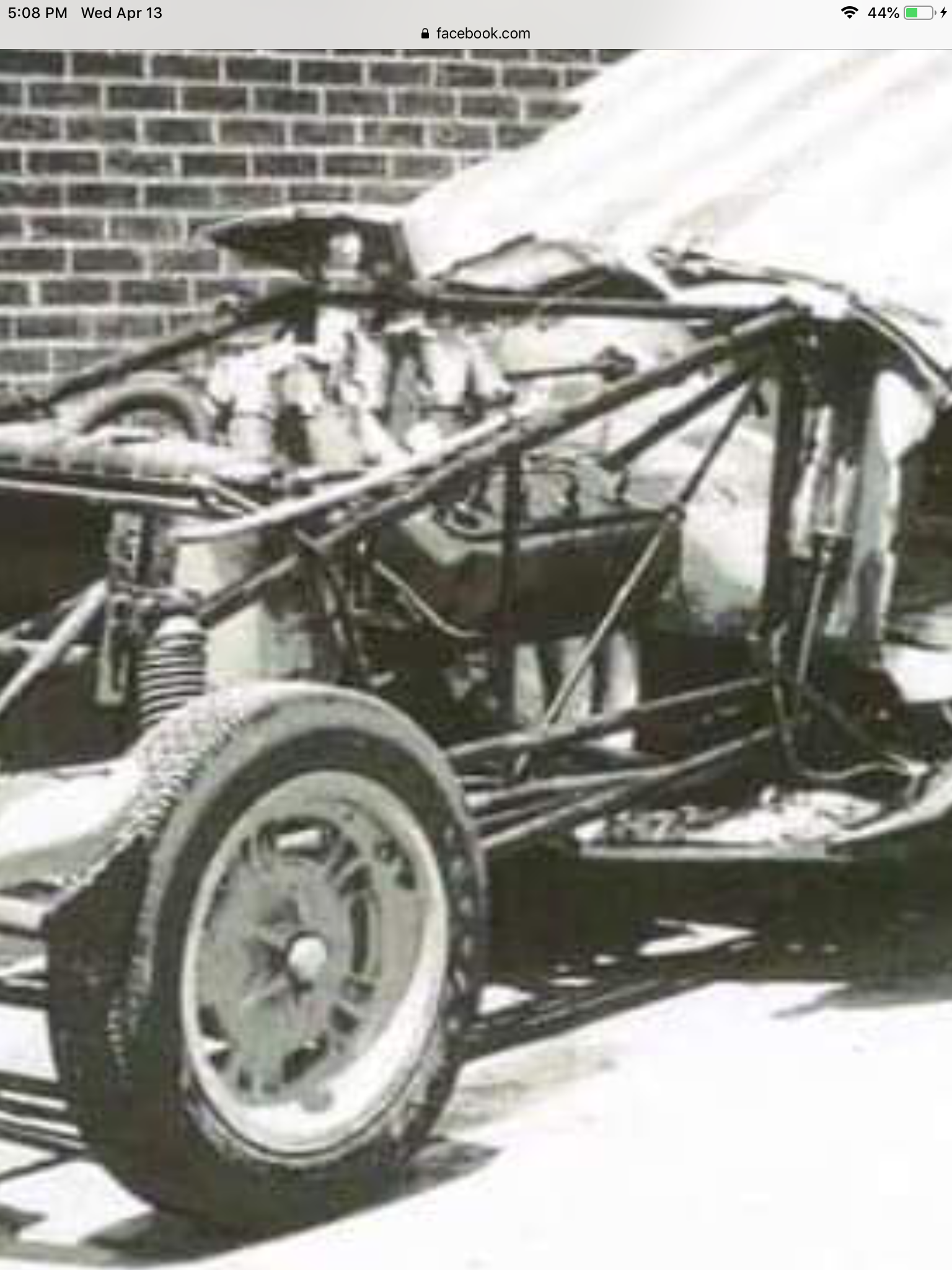

R. Thorne Posted April 11, 2024 Posted April 11, 2024 The Ramchargers car, on the other hand, was a full tube chassis. 1
