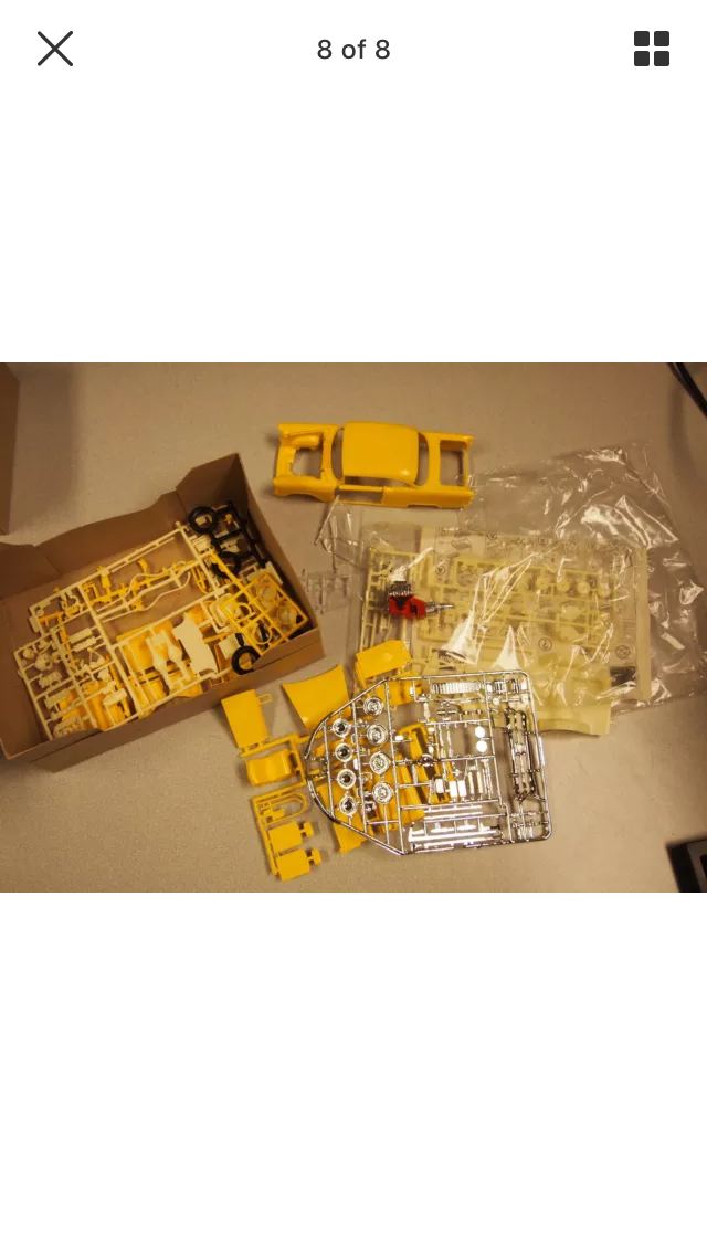

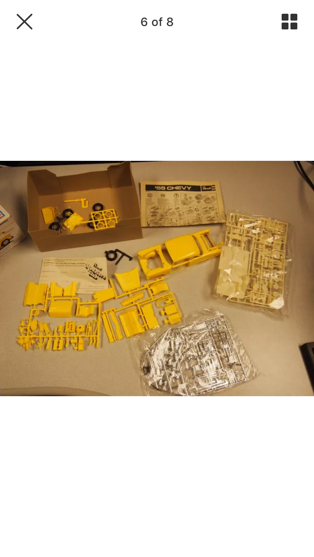

Very informative replies. Thank you. I didn't realize that the tooling had all these engine molds. I never had any of these kits, but I did see one of the chrome trees, and it did look poor as Robert stated. If I do get the 55 kit, I'm pretty much just interested in the body with all of the open doors, hood, and trunk. Most of the build would be a kit bash build. The headlights bezels are a concern. It's got to look like a correct car.
That's a Seventies issue, it will have the stock wheels/tires.  It should have everything that the original issue had, except the slicks and (rear only) mag wheels for the drag version.  They will have one-piece taillights on the plated tree (only the original had red lenses).  The bumper guards are molded as part of the bumper, if that matters.  The bodies appear to have the temporary braces in the door openings, so they should still be straight.
