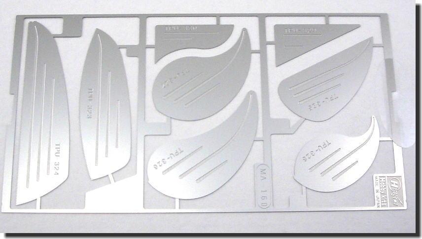

Pete J. Posted September 15, 2016 Posted September 15, 2016 These are my preferred weapons of mass distruction. The first is made by Hasegawa Tri-Tool and are finger saws. The cut so fine you can actually glue a panel back in place and you won't know it was ever cut out. They also bend around slight corners for delect cuts. The next tool is a Tamiya razor saw and is for those really big cuts. I use it for chopping and sectioning bodies. With the long pull stroke cut you can get really straight cuts the length or width of the body. Both are tools that I would not be happy to not have in my tool box. They are both available from Hobby Link Japan or any domestic model on line service that carries Hasegawa and Tamiya. Good luck!
