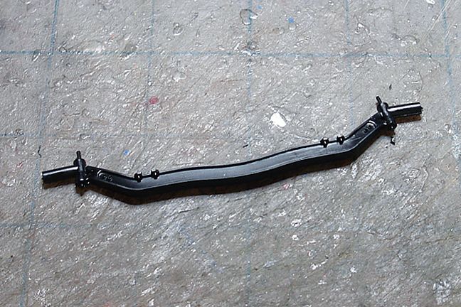

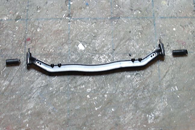

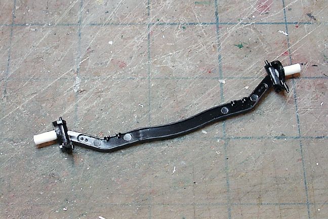

Harry P. Posted October 3, 2016 Author Posted October 3, 2016 Hmmm... something weird happened and this topic was posted twice. I deleted the other thread and will continue here. As you may know, I tend to skip around and not necessarily follow the instruction sheet building sequence. So here we go beginning with the front axle. In order to make the wheels poseable the molded-in axle stubs have to be removed like so... Then the spindles were attached, being careful to keep cement off the pivot points. Finally, new axle stubs of styrene rod were glued to the spindle faces.

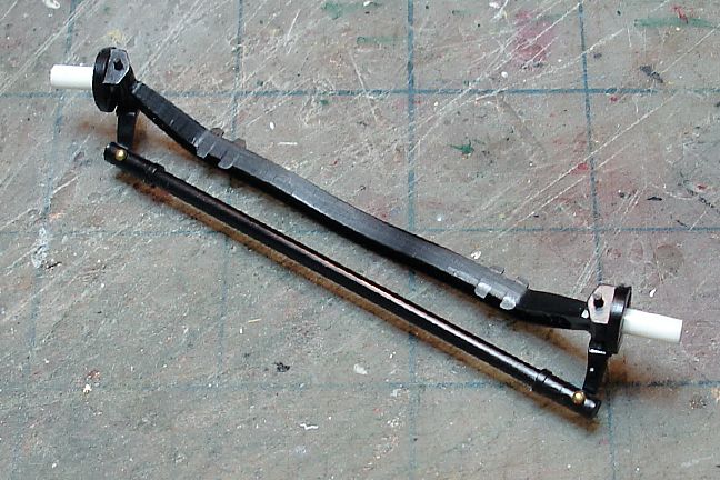

Harry P. Posted October 3, 2016 Author Posted October 3, 2016 I drilled holes in the tie rod and the spindle arms, and used small brass pins as pivots. Now the front wheels are poseable...

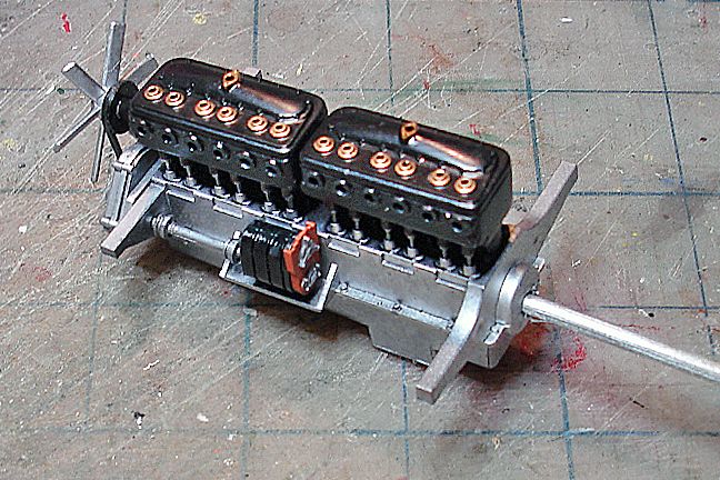

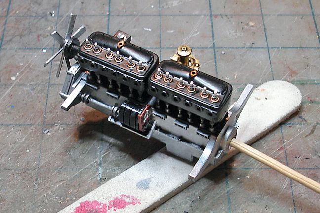

Harry P. Posted October 3, 2016 Author Posted October 3, 2016 The engine is fairly detailed but there are a few quirks. For example, the cylinders, which should be black, are molded to the block, making them difficult to paint (keeping the edges where the cylinders meet the block clean, straight and sharp). Also, the flanges of the various pipes and manifolds that attach to the heads are molded to the heads and not to the pipes and manifolds themselves! Therefore I had to carefully detail paint the molded-in flanges "brass," so that when the pipes are installed the flanges will look like they are a part of the pipes, not part of the heads. Here you can see the beginnings of the engine, detail painted to give the appearance of more separate components than there actually are...
Harry P. Posted October 3, 2016 Author Posted October 3, 2016 There are no spark plugs supplied in the kit; you're supposed to just stick the ignition wires into the holes on top of the heads. That will never do... the plugs are very obvious and visible on the real engine, so I had to scratchbuild 12 of them (two plugs per cylinder). What I did was use some thin styrene rod as the "insulator" part of the plugs. Then I drilled a hole into the middle of some hex-shaped styrene rod, cut off slices of that rod to create the hex-shaped steel part of the plugs, then glued a hex slice onto a length of styrene rod to create 12 spark plugs...

Harry P. Posted October 3, 2016 Author Posted October 3, 2016 Next, I painted the hex-shaped part silver and installed the plugs into the heads...

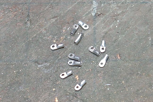

Harry P. Posted October 3, 2016 Author Posted October 3, 2016 I made ignition wire terminals by crimping the end of some small diameter aluminum tube with pliers, drilling a hole to fit over the plug's electrode, filing the end round, and cutting each terminal off the tube by rolling it under my X-acto blade to score the tubing, then just snapping each terminal off...

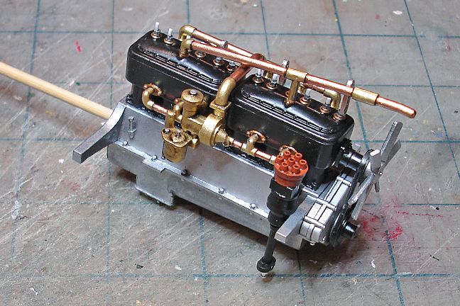

Harry P. Posted October 4, 2016 Author Posted October 4, 2016 Slowly but surely adding more engine details...

sjordan2 Posted October 4, 2016 Posted October 4, 2016 That water manifold is quite detailed -- is it straight from the kit?
