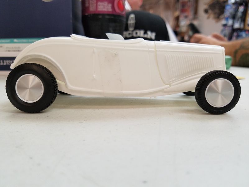

Mr. Metallic Posted November 1, 2016 Share Posted November 1, 2016 Definitely needs taller rear tires. Other than that, you're off to a good start, IMHO Quote Link to comment Share on other sites More sharing options...

JTalmage Posted November 1, 2016 Author Share Posted November 1, 2016 Definitely needs taller rear tires. Other than that, you're off to a good start, IMHO My thoughts exactly. It's a 1/24 scale body and chassis and those short '40 Ford wheels aren't going to cut it. I got some real nice resin parts from Replicas & Miniatures a while ago. Their part # SRD-1103 is a very nice Chevrolet 3 deuce intake. They also have part # P-123 "Hedman" type headers, great block hugger style. Just a thought if you're still going for the tri-power setup. Thanks for the tip on those parts, I'll have to check that out. Thanks! Oh yeah. Fenderless '34 Fords on the dry lakes...very right, and somewhat unusual to see modeled. I assume this is the one you were asking about the Revell '29-'30 tires for, and they would be right at home. Whoever did the master for that '34 did a real nice job on the tonneau too, looks like. Yes, the very same. I figured I'd just go ahead and start a thread for it. Might keep me inspired. This is actually an "Altered States" body. He sells a ton of stuff on Ebay, stuff that's not even on his website. I think he goes by "olmandowntheroad" on ebay. He makes a nice '30 as well that would go w/ the old monogram kit. Very nice! I have a few WIPS influenced by the salt flats as well. Will be watching this one, for sure. Thanks, I have grown more fond of them lately! I would like to do more for sure. There was some cool stuff on the salt back then! Quote Link to comment Share on other sites More sharing options...

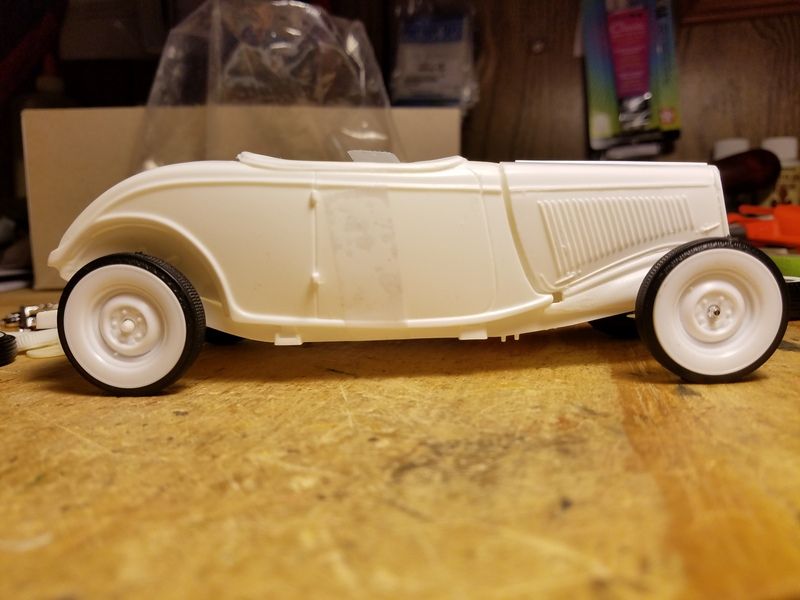

Art Anderson Posted November 1, 2016 Share Posted November 1, 2016 A set of Etzel's Speed Classics Champ Car wheels & tires (resin) would be perfect for this car! Those are Halibrand magnesium wheels with Firestone Deluxe Champion racing tires, the same casings as used at Indianapolis from about 1949 through 1963 (the year of the GREAT tire controversy!). For the salt flats, Firestone simply buffed off the "shoulders" of the tread on those tires, then cut simple concentric tread grooves in them. 18" rears, 16" fronts. Some Bonneville racers used spun aluminum discs on the wheels, and some did not.Art Quote Link to comment Share on other sites More sharing options...

JTalmage Posted November 1, 2016 Author Share Posted November 1, 2016 Oh how nice those revell wheels and tires are! just imagine these with the aluminum discs and that will be that! This thing has the look that I anticipated now. I think I'll keep the 9" under it. it works well for this build. it's no transverse sprung quick change, but it will do. I also used the Buick drums from the 30 model a kit, and I drilled out the front and rear axles out to accommodate the metal drive pins... after I cut off the old style snap on pegs from the axles of course. Quote Link to comment Share on other sites More sharing options...
Ace-Garageguy Posted November 1, 2016 Share Posted November 1, 2016 Oh how nice those revell wheels and tires are! just imagine these with the aluminum discs and that will be that! Quote Link to comment Share on other sites More sharing options...
Dennis Lacy Posted November 2, 2016 Share Posted November 2, 2016 You're off to a great start! The new Revell Model A wheels and tires look awesome on it. Just so you know, the engine in the Thom Taylor kit, although they tried to dress it up like a small block Chevy, is actually a Pontiac. It's the same engine from the ZZ Top Coupe sister kit, minus the "ZZ" logos on the air filter and valve covers. Quote Link to comment Share on other sites More sharing options...

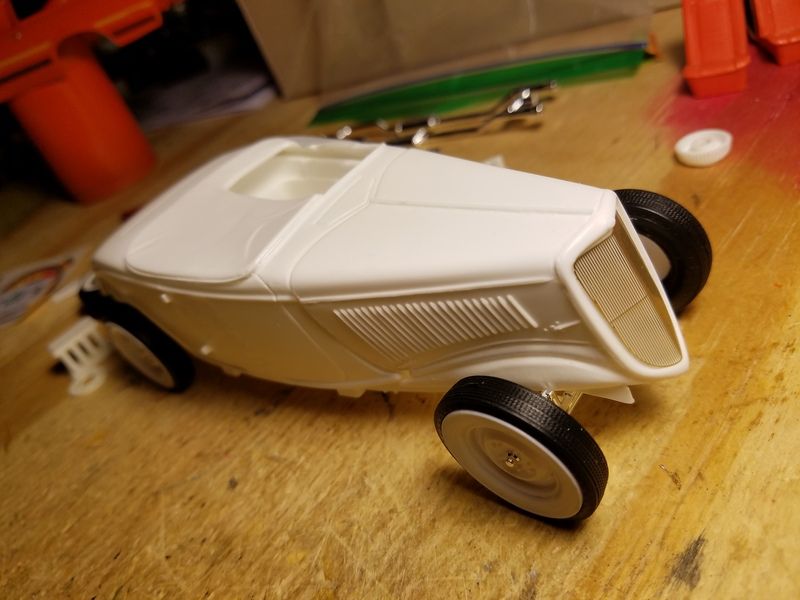

JTalmage Posted November 4, 2016 Author Share Posted November 4, 2016 I researched and forgot that the Ford 9" came into production in '57. So I think I can get by with it and not feel too bad about not using a quick change. Bobbed the rear frame rails. almost a little too much. I might add material and redo it. My decal sheet came in from Archer. They sent me the comoletely wrong thing. bummer. Figured out the transmission on my small block is a powerglide. not sure if a pover glide would have been used or even ideal at the salt flats.... so if anyone has anyou insight on that, it would be great. Picked up my salt flat moon discs. Super excited about those because they look rad. Take a look! Quote Link to comment Share on other sites More sharing options...
Chuck Most Posted November 4, 2016 Share Posted November 4, 2016 You kind of lost me with "Small Block Chevy"... then came "Powerglide"... yech. But even then, it's shaping up perfectly. It would look absolutely mean in a slightly distressed shade of factory dark green or blue. I can't say for sure, but I'd imagine Bonneville guys started running Powerglides about five minutes after you could start finding them in abundance at salvage yards, though I'm not sure how effective a trans with only two speeds would be if you're trying to set a top speed record. Quote Link to comment Share on other sites More sharing options...
Mark IV Posted November 4, 2016 Share Posted November 4, 2016 I'm not sure how effective a trans with only two speeds would be if you're trying to set a top speed record. As the top gear is 1:1 it really does not matter. Two speed or six speed if the top gear is direct it does not matter. Quote Link to comment Share on other sites More sharing options...
Chuck Most Posted November 4, 2016 Share Posted November 4, 2016 I'm not talking about gearing. Not necessarily anyway. I'm talking about how much of a toll a 'Slip-and-slide' transmission that only shifts once might take on the engine. They may be just dandy for drag racing (in highly modified form), but I'm not sure if I'd trust one if I had the thing floored for two ten-mile blasts. I'd want something a tad more efficient. Quote Link to comment Share on other sites More sharing options...
