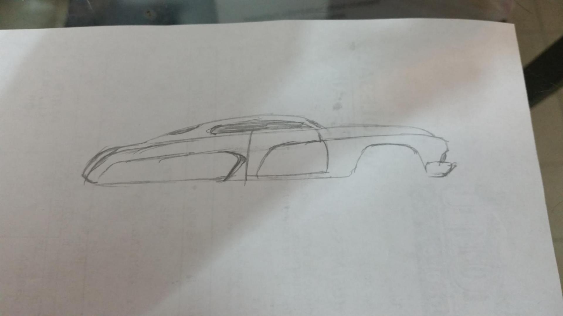

Ok Bill, love some of your's and Harry's input on this, just did a loose sketch on the back of a receipt from the dealership we've bought our cars from of what my thoughts were on the change to the dog leg in the door as well as that portion of the quarter panel.

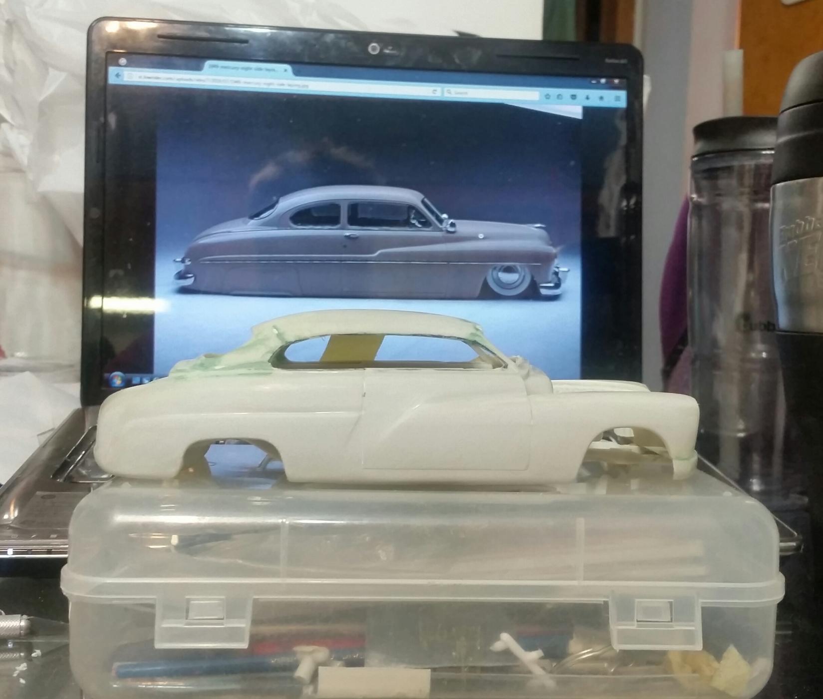

Well, did some work on an AMT/RC2 issue '49 Merc that has a failed chop attempt.......that top will have to come off, but I figured it might be worth experimenting on.   It's not perfect, but should be close enough for 3D proof of concept.  I haven't fabbed up, let alone added the cruizer skirts yet to flesh out that part of the design though.
I like idea, and sketch. Maybe 51  extended rear fenders rather than rounded 49-50?
Angle of front fender not flowing into RQ well, your drawing did, I really like it.
The drawing looks like rear fender/skirts more pronounced than the front, a fadeaway into a curvier RQ?
Your rendering has your straightened line thru it, I think dropping the trailing end of the front closer to the drawing would help.
Very doable, just needs fiddling. Don't hide it under dark color,
Roof, I like front of failed chop. Rear post echo the rear and front fender shapes in window edges on post? 51 style wraparound rear window.
Lots of potential.

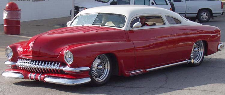

This is just my personal opinion but I think that if you take away the "dog leg" on a '49-'51 Merc, it ceases to be a '49-'51 Merc.
That dog leg is one of the main styling cues that make it the iconic car that it is.
Removing it makes it look far too "generic" in my opinion.
The red & white Dave Stuckey Merc you posted is just plain butt ugly as far as I'm concerned!

I'm still refining the appearance, both of the model and of the concept drawings.  Can't find it at the moment, but there is an updated drawing I did a week ago  with a bit of a Santa theme, once I figured out where it went, I'll post that too.  Color wise, I'm going to have to see what kind of metallic or candy reds available, may have to check out the cosmetics department at the OSCO Drug I used to work for and see what nail polishes they have there now.
As for the chop, what I was trying for was an easy way to chop the top without having to cut down the windshield much, if at all and not cutting the back at all.  As you can seem the back wasn't too successful, at least not when compared to the front......prior to the mishap that turned it into a failure that is.  All I did in the front was cut out the plastic between the top of the windshield and where the front of the roof curves back over into the top itself.  I just did some relief and pie cuts in the back then moved the roof forward to mate up with the a pillars/header.  The next victim will have a rear chop more like the successful ones shown in the how to chop a Merc thread, but I'm planning on keeping the stock back window, as don't care much for the shape of the '51 Merc back window compared to the '49.

That's why I left some of the shape there, I wanted it to still look like a Merc, so didn't want to erase the dogleg completely, like in the Barris Merc and others, but I also didn't want the wholesale change in the car's appearance, like the Boyd Coddington built Merrodder either.

I agree 100% with this post.
I am curious to see how this turns out though. The concept sketch intrigues me. It does not remove the dog leg, but splits it into two segments. Of the photos shown, the only one I feel that may have improved on the original profile of the car is the Hirohata car. The dog leg is still implied on that car, IMO. The Coddington car is ugly, but I think that about most of his cars. To some, customizing is to change everything even if they should have stopped at a handful of mods.
Agreed!
There is nothing about that car that says '49 Mercury.
What was the point?
You could have done the same thing with any other car from that era.
In my opinion, if you can't look at the car and say, "that started out as a '49 Merc" it was a waste of time.
I thought the idea behind customization was to "improve" upon the design of a car, not obliterate it.
One more reason why I have no love for customs.
Everybody thinks that they're a "stylist" & as I see it, they fall flat 90% of the time.
I'm a classic car junky & very rarely do I see a custom car that looks better than the original.
As I said, just my opinion.
Steve

Very cool sketch Joe, and I think it's worth trying. These are plastic models, after all! No real Mercs getting wrecked if it doesn't pan out!

A couple ideas/tips:
-don't let the rear skirt/fender bulge touch the rear door cut line...in drawing this is referred to as a "tangent" and is to be avoided.
-in order to justify the new divide that splits the car, it might need a trim strip that follows the front fender down (a la the Hirohata), or a scoop or some teeth recessed in the leading edge of the skirt....or go the other way and emphasize the newly divided pontoon fenders with colored panels (this can backfire, see the Barris "Chrysler City Coupe" from a few years back).
-some kind of chrome dagger/gravel guard on the leading edge of the skirt might work...like Troy Trepanier's "Sniper", or the '53 Ford. It might also backfire and draw too much attention.
-if you move the front of the skirt back so it doesn't touch the door line, it might make the rear quarter look short...and to get that long, low look back, you might have to extend the quarters to look more like a '51 Merc. Or...section the heck out of the car and remove a lot of vertical height so the quarters look longer.
As I said before, I LIKE the concept sketch. A LOT.
Concepts start to lose it sometimes when they begin to drift away from the original strong idea.
Watch your angles and proportions, stay true to your original vision here, and I believe you'll have a stunning model that's instantly recognizable as '49 Merc.
I agree about keeping skirt off door. A Tucker like mesh intake on the skirt/fender may work. I like the dogleg, left it on most my Mercs. Just maybe a little less elevation between front and rear?
The newer builds are odd at best. The Mystery Merc looks mor like a 53 BelAir with Merc features, unsuccessful. Hardtop maybe, echoing the dip lead and trail edges? Round wondows may not work. Think it needs a bit more fender in back to balance it a bit maybe. Lay down stock window and maybe 1/2 the current C-pillar? ,ake it end on same diagonal as the split in fenders, pulls focus rearward a little.
Best part is you can do what you want, plastic is forgiving.
Looked at sketch again. Your original unrounded window/Cpillar was what I was tryimg to describe. Maybe a small trim there like vent mimicing the rear skirt leading edge? Small, like old Caddy AC intakes?
