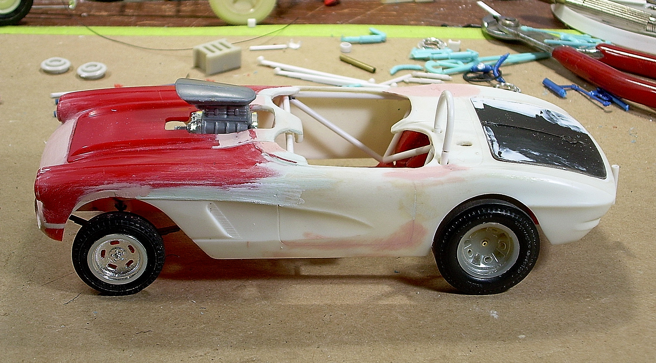

Thanks for your interest and comments. Like most of my builds, this one isn't intended to represent anything that actually ran, but something that could have run under NHRA class rules anywhere they were strictly enforced.     :D
There's nothing in the rules to prohibit a blown 409, and there were a few folks who ran 'em in other classes...   Related image

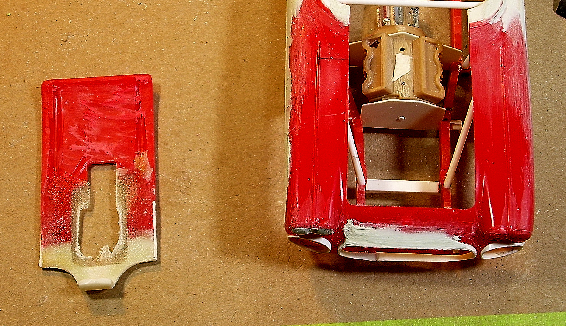

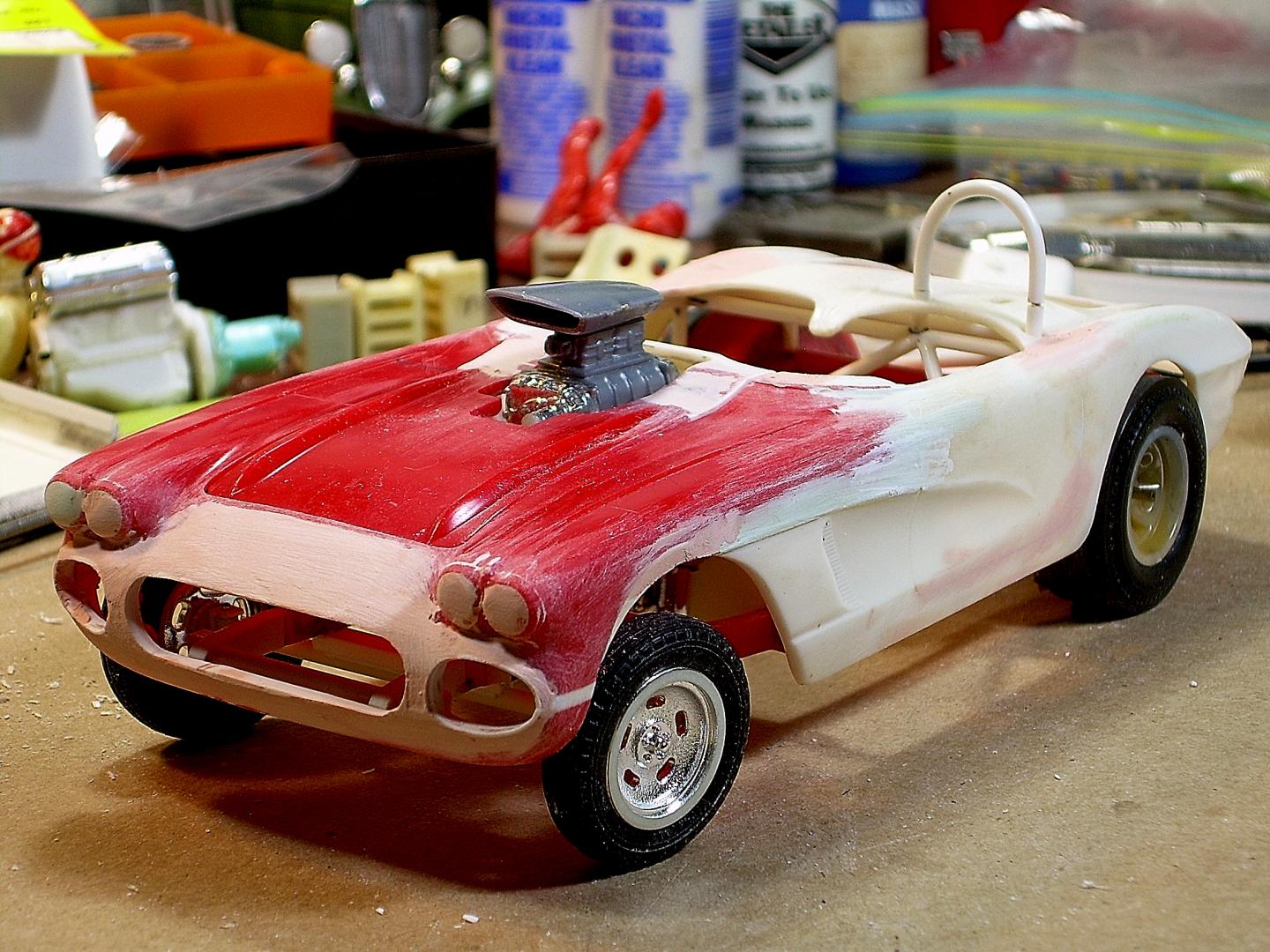

I glassed the two sections of the hood panel together, as it's going to be the plug for a near-scale-thickness panel, and needs to be stout at the join. I also straightened out the edges of the old hood and opening with strip stock filed flat.
This is my ace number one assistant, chief parts chaser, and occasional foot warmer. He doesn't seem to notice (or care if he does) he's now way too big for the box.

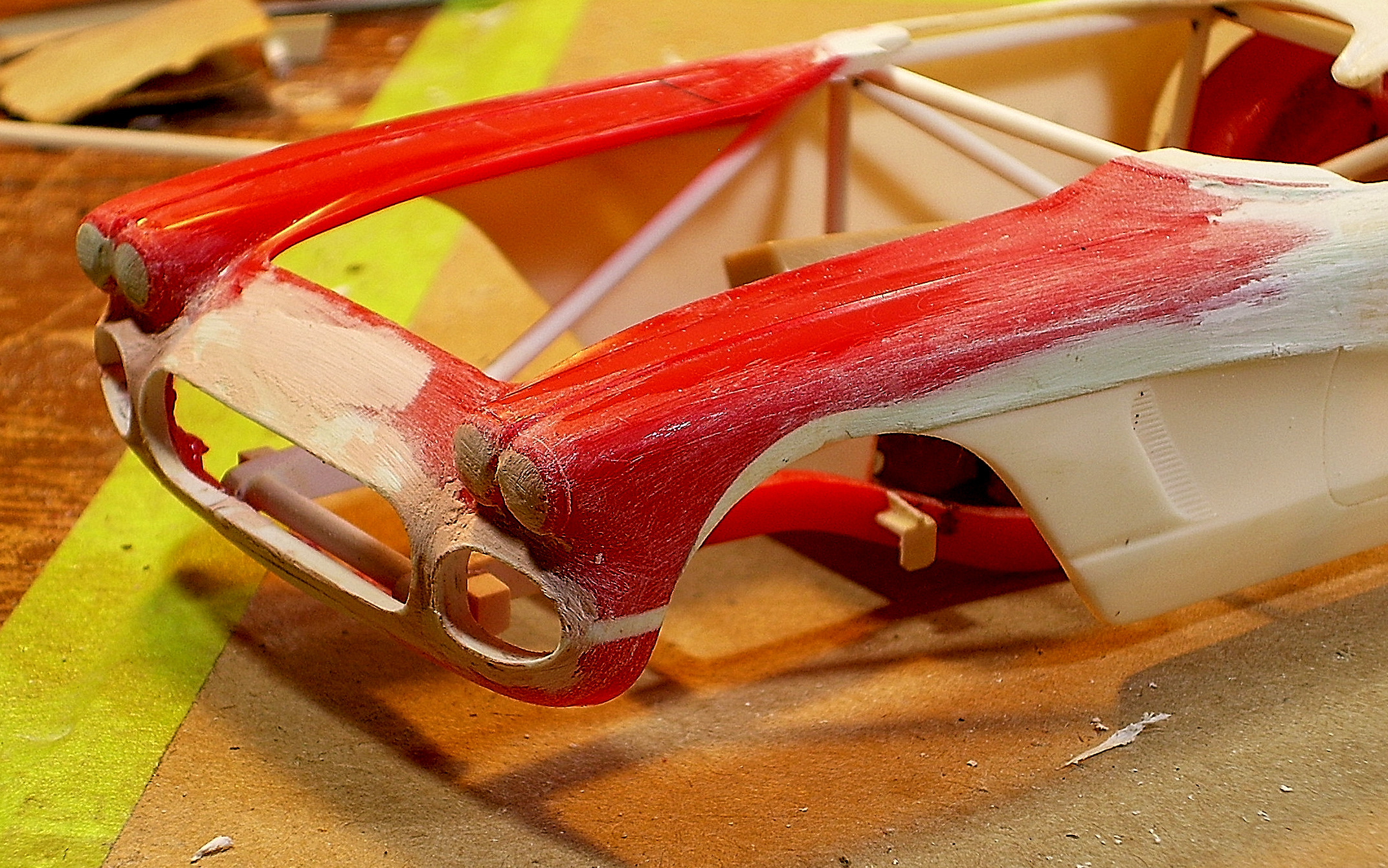

Progress on curing the flat-face appearance the AMT 4-eyed Corvettes of this generation seem to me to have. The grille openings have been extended with .010" styrene strip, as shown earlier, and will be filled.
We're getting there. The door lines are also being filled, as this is supposed to be a lightweight one-piece body (pre-funnycar, but moving towards that idea).DSCN1181.thumb.JPG.7be2167dd3cc30aaef06cac7de8a6082.JPG

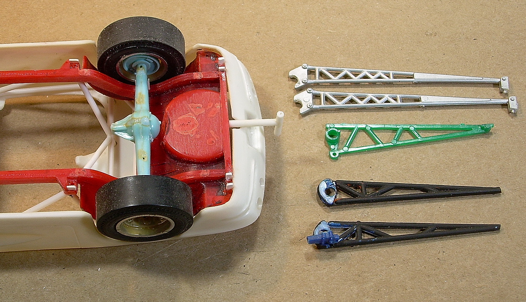

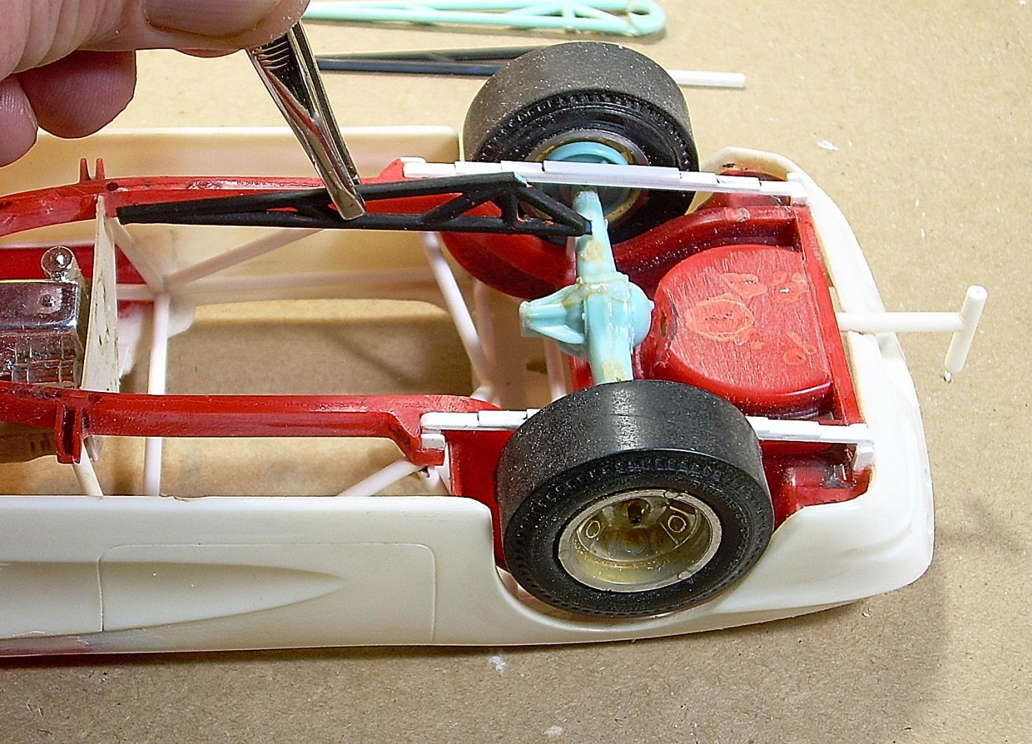

So...we gotta have some kind of "traction bars". Traction bars simply keep the rear end from rotating relative to the car during brutal acceleration. When the rear end "winds up", the tires usually dance around on the pavement, losing traction. Nasty launch characteristics and broken parts result if the rotation of the axle isn't controlled.
I could use the old-school style that goes by that name, but they're a little lame for a serious, blown car. Image result for old school traction bars
Ladder or lift bars will give more precise control, but they don't work well with parallel semi-elliptical springs unless you jump through some hoops.
Because of the (usually) different distance between the axle and the forward end of the spring eye, relative to the distance from the axle to the forward ladder-bar pivot, binding in the suspension is inevitable, again with jumping, shuddering launch characteristics, and more broken parts.
This can be alleviated by allowing the axle to slide and rotate somewhat relative to the springs, but keeping it closely controlled relative to the chassis by the ladder bars. Several ways are available to do this, and the parts are relatively small and difficult to fabricate cleanly in 1/25 scale. I've chosen a simple method to represent, but it won't be 100% accurate...it will simply give the impression of being there, just to keep the build honest, with thought given to function.

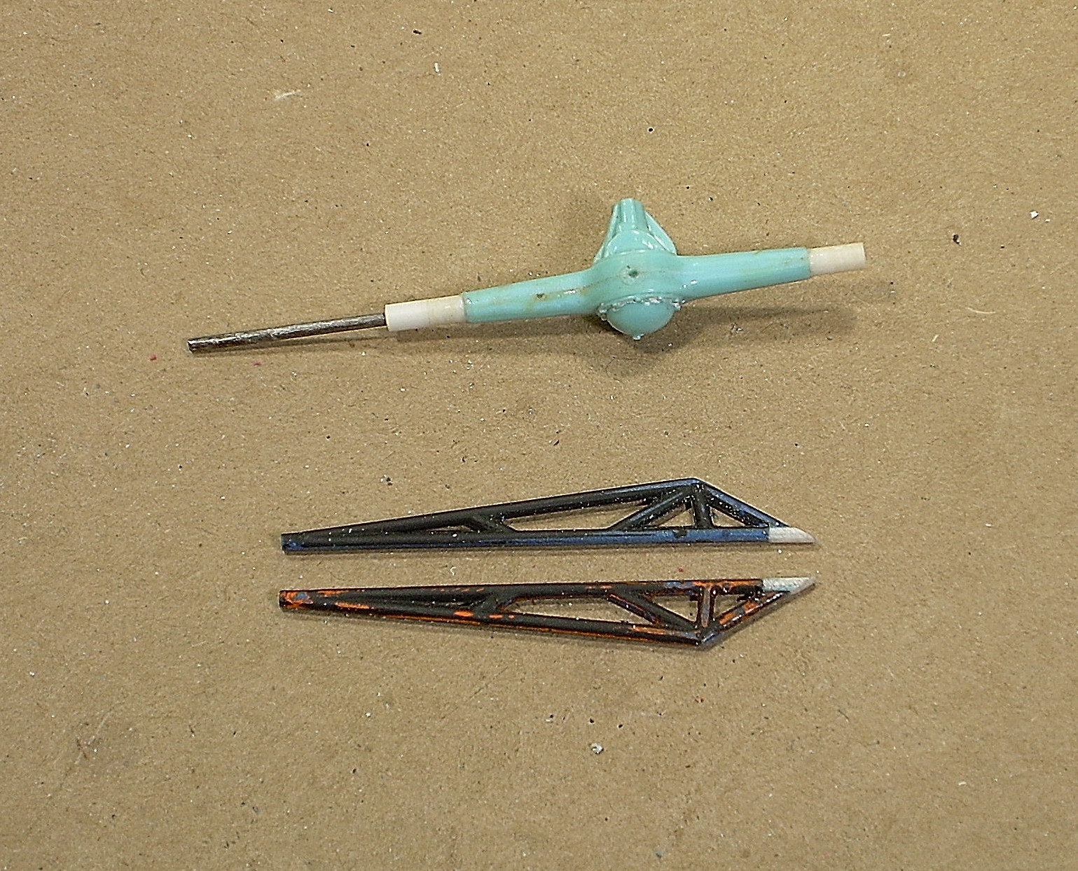

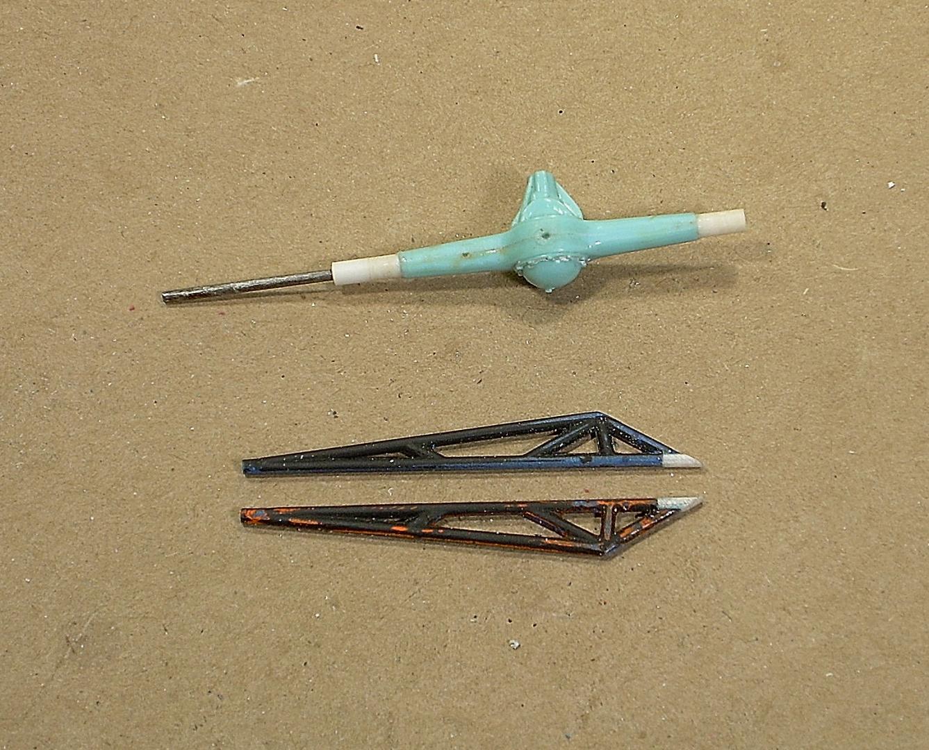

The ladder bars I have to pick from are shown below. Because of constraints caused by the floor and the frame rails on this car, none of them really work acceptably well. But not to worry. The black ones, salvaged from a Revell SWC Willys gasser, can be modified.
But first, I had to get the curve of the springs correct to maintain the previously established ride-height, taking into consideration the effect the axle "sliders" will have on height. Then I laminated additional leaves from strip stock. The ends of the single-leaves are only .020" styrene, and won't support the full weight of the model...but the shocks, when installed, will. I'd kinda wanted to have everything working back here, but if I do, I'll have to fab brass springs, shocks with sliding sections, and the thing will just go into limbo in the meantime...with all my other builds. So we're gonna fake it.
This last shot shows how the modified Willys kit parts will fit. The axle end will be gusseted heavily, with an additional upper diagonal tube, and the forward end will be fitted with a pivoting eye that catches the frame just at the engine plate. Classic lift-bar design, and it will all clear the floors.

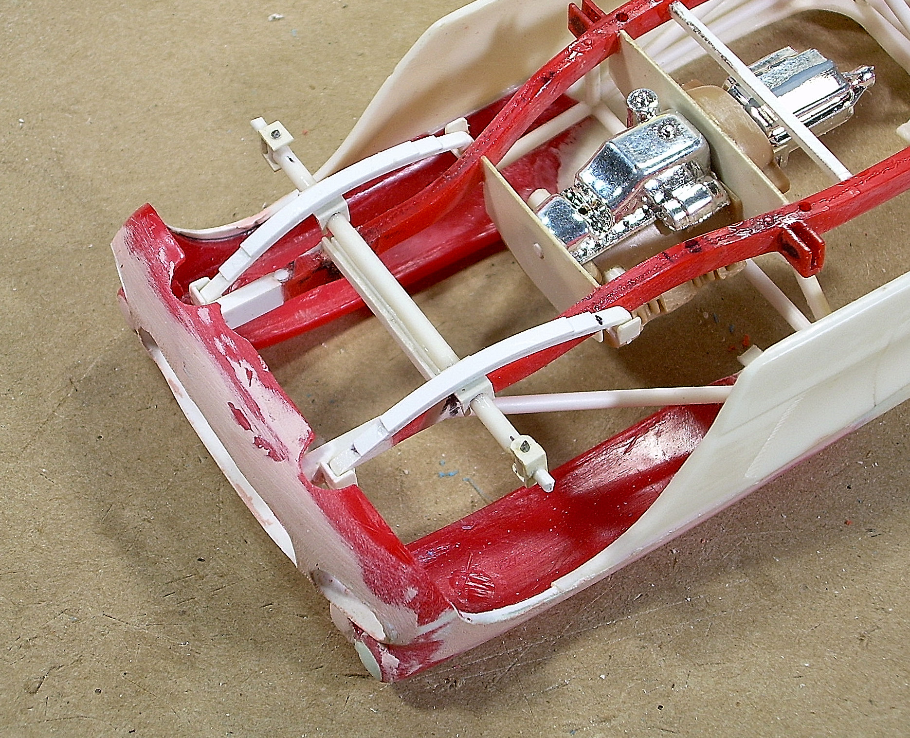

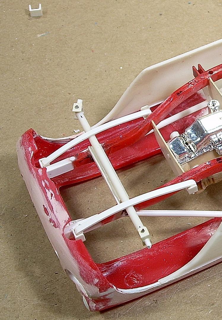

I'm pretty particular about how wheels relate to fenders, and I make an effort to keep things right. I've seen a lot of otherwise very nice models spoiled when the wheels / tires are way off center in their openings.
I glued the front axle in to a fixture on the frame (made earlier) that holds it in the correct position relative to the body, established during the mockup phase. I used white glue that's strong enough to hold the axle while I work on it, but easily removable when I'm done. You probably can't see it here, but the axle has the correct camber made into it, and the caster has been set by leaning the kingpin bosses back at the top. When the wheels are posed, the steering will move correctly and look like a real car. The springs shown here are single strips of .020" styrene with rod to simulate spring eyes on the ends.
This little part I made is one of a pair of spring brackets that would be welded to the axle. U-bolts would go over the axle, through holes in the brackets, and get nuts that clamp the axle to the spring and keep it from rotating.
Here's the first one in place, very carefully located on the axle.
With both brackets "welded" in place, I was able to laminate a few more spring leaves in place with the right curvature, made from .015" styrene strip. I laminated more leaves on the rears too.
Here the finished springs are in place on the axle, pinned from below so they'll go back in exactly the right location after painting and "plating" the axle.

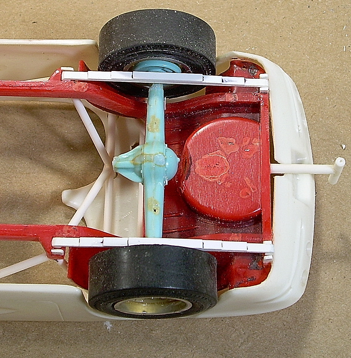

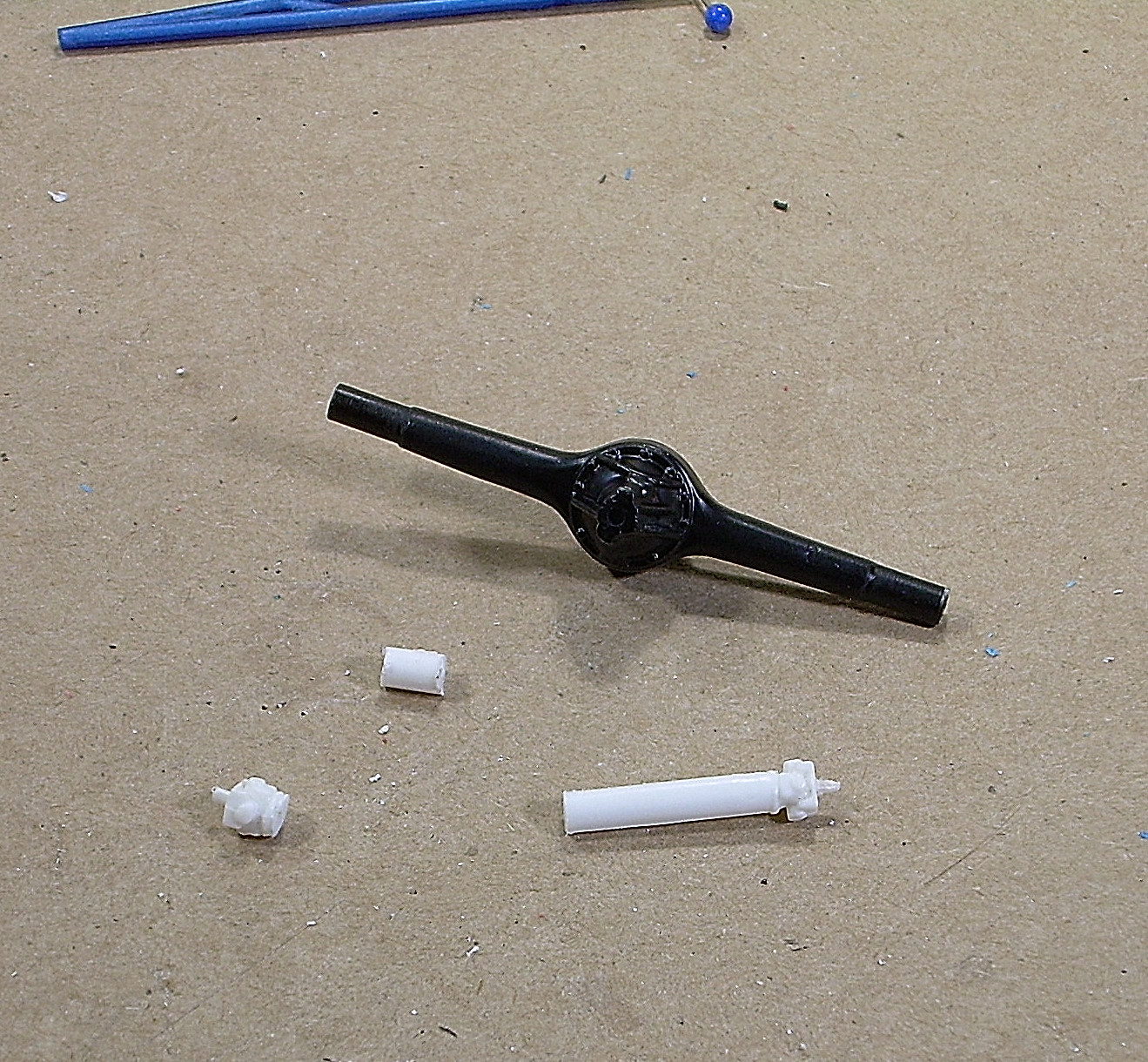

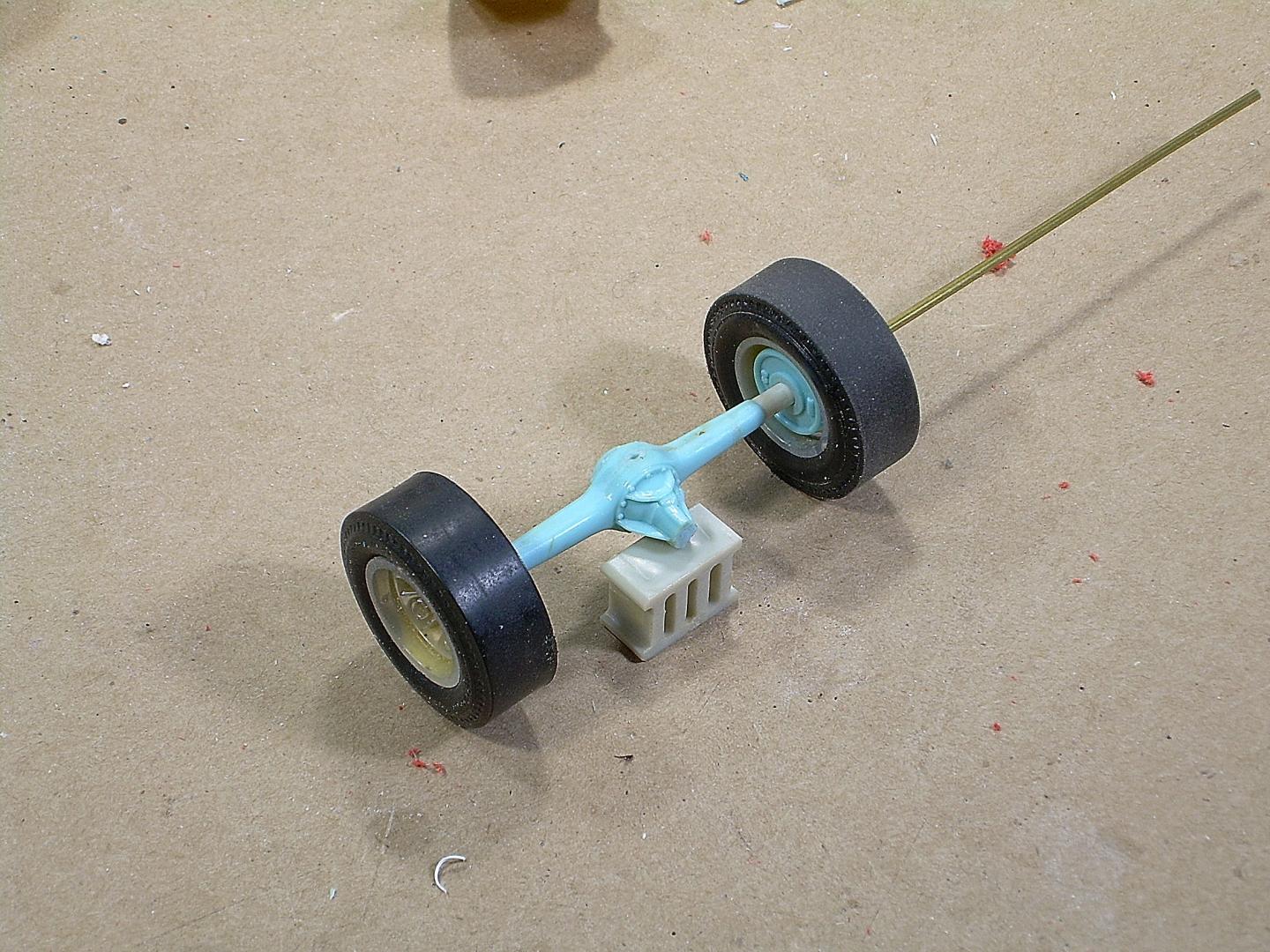

I buggered one end of the rear axle while working it down to fit the "sliders", so I took both ends off and replaced them with tubing. The mods to the lift bars are also proceeding in this shot.
Width check after trimming the ends to length. I ended up needing to use a .030" spacer on each side to get the tires exactly where I wanted them.
After the axle was primered to check some other repairs (it was salvaged from a gluebomb SWC Willys), I measured and cut a section out of the driveshaft to fit the previously mocked-up axle location, and to help me check the pinion angle relative to the trans. Yeah, it's not going to run, but I'm just wired to do things as if it was.

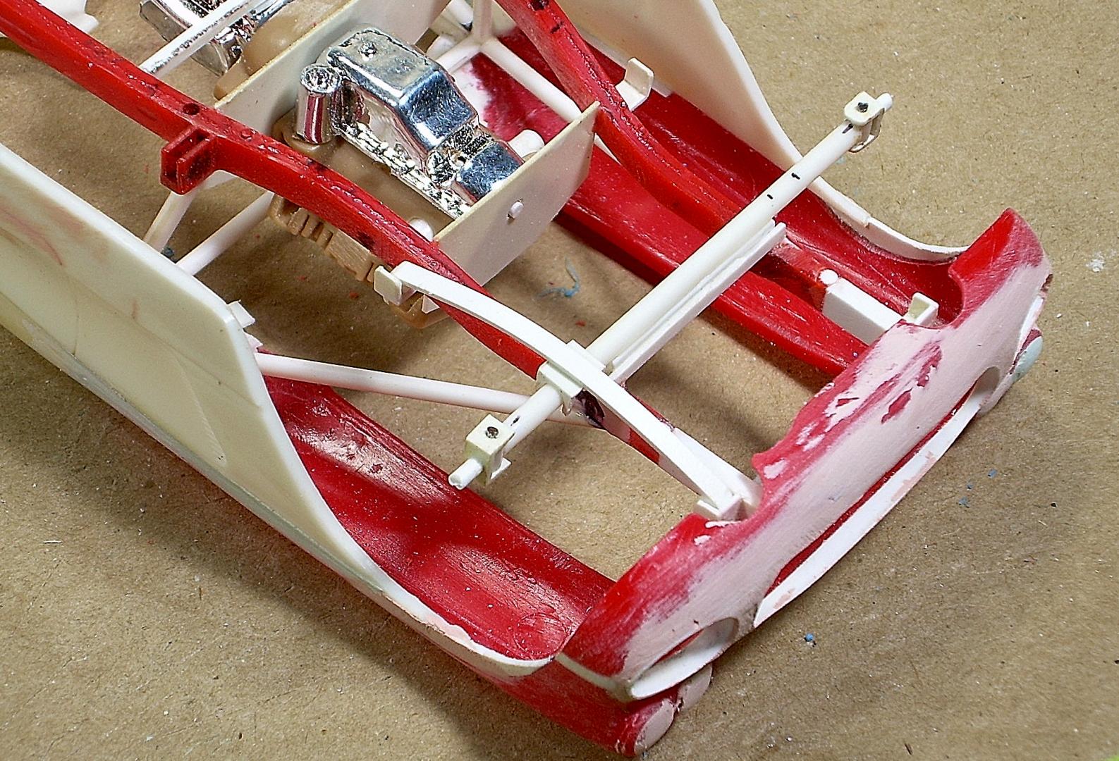

Finally, with all that fahoolin' aboot out of the way, I'm able to glue the lift bars to the axle housing, using the fixtures I made to hold the axle in the right place, and one more to hold the ends of the bars in position. Much like building a real car. There's enough clearance for the tail to squat about 4 scale inches when the car accelerates, without having the lift-bars hit the floor. Should be plenty.  ;)
Up on her feet again, to verify I got everything in the right place BEFORE the glue gets entirely hard, and to give myself a little more motivation to keep going.
