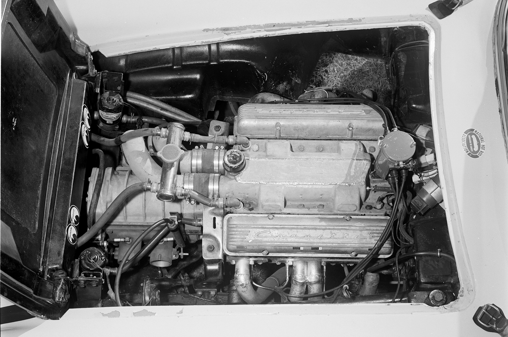

I had a quick look in the reference folder for my own (stalled) M/SP project, and found this pic of the Brian Chuchua landspeed 'vette in 1960.
I saved the pic because it appears to have dual electric water pumps, which would get me out of the same jam--want a radiator, but with a blown engine that has no provision for a water pump in the stock location.

Thanks Chris. I have the same pic of Chuchua's rig in an old Hot Rod, but your posting saves me from having to dig it out.
And thanks for the reminder which kit that water pump setup was in. I knew it was in something, but you've saved me more hours of digging.  :D

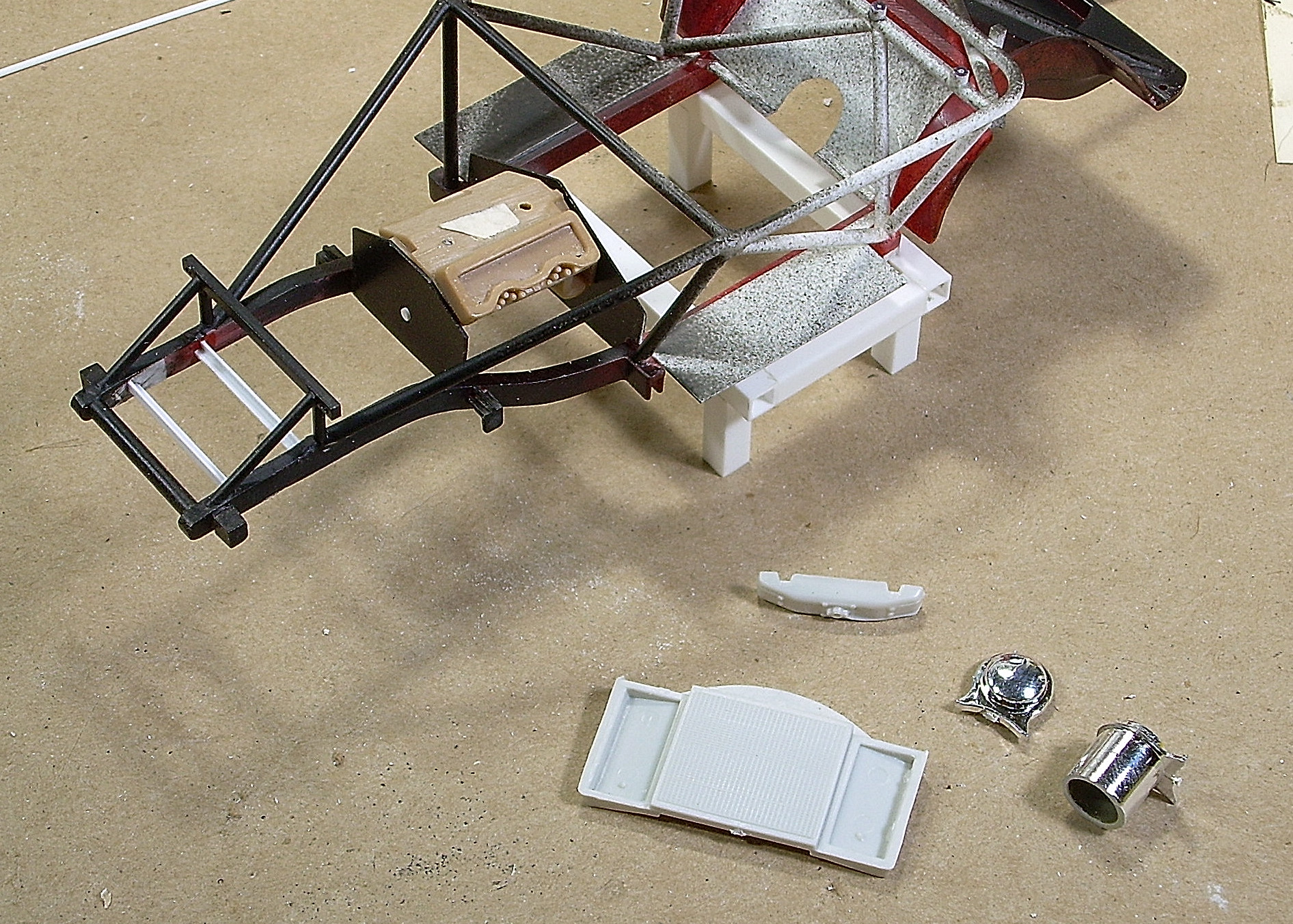

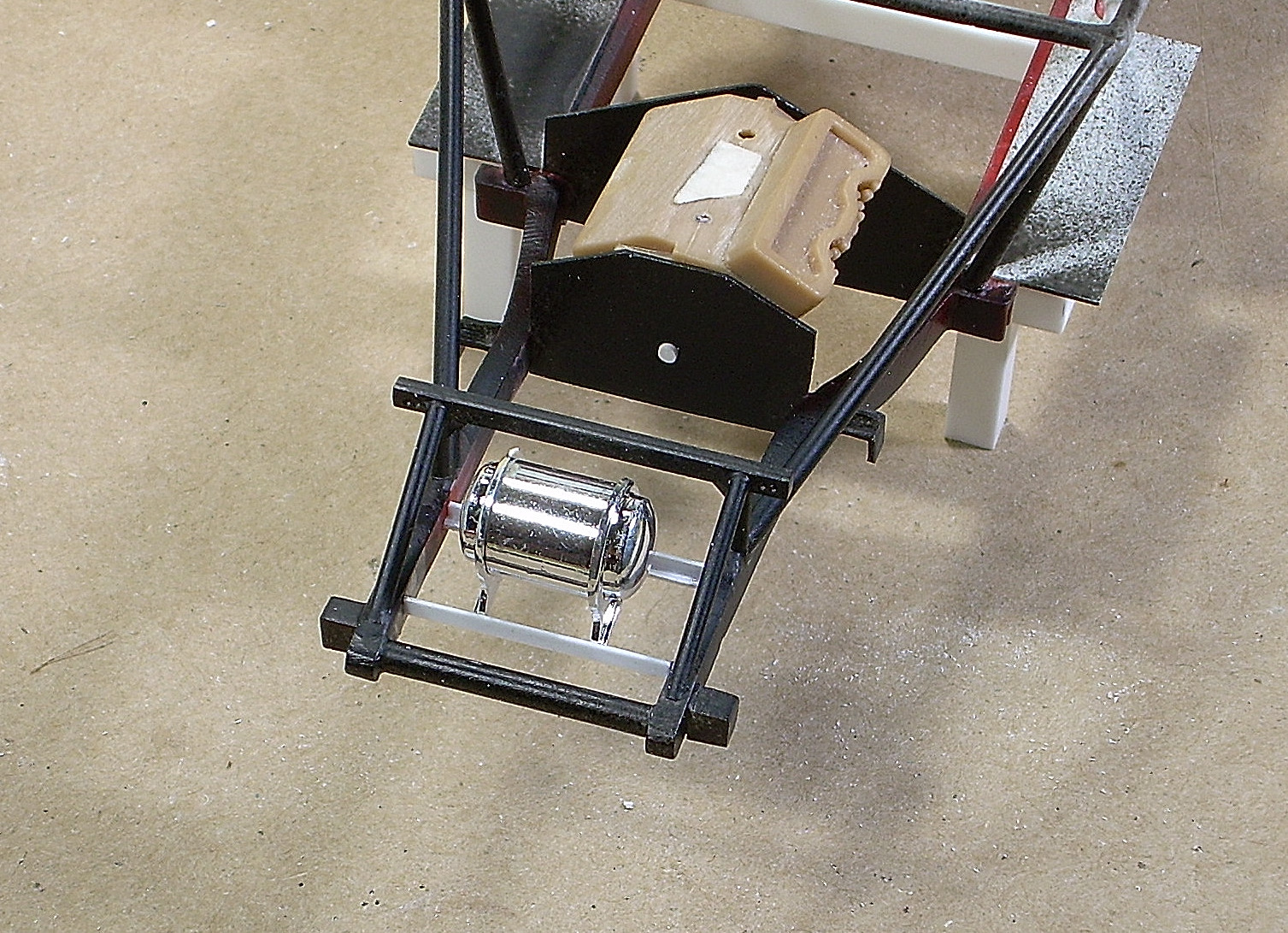

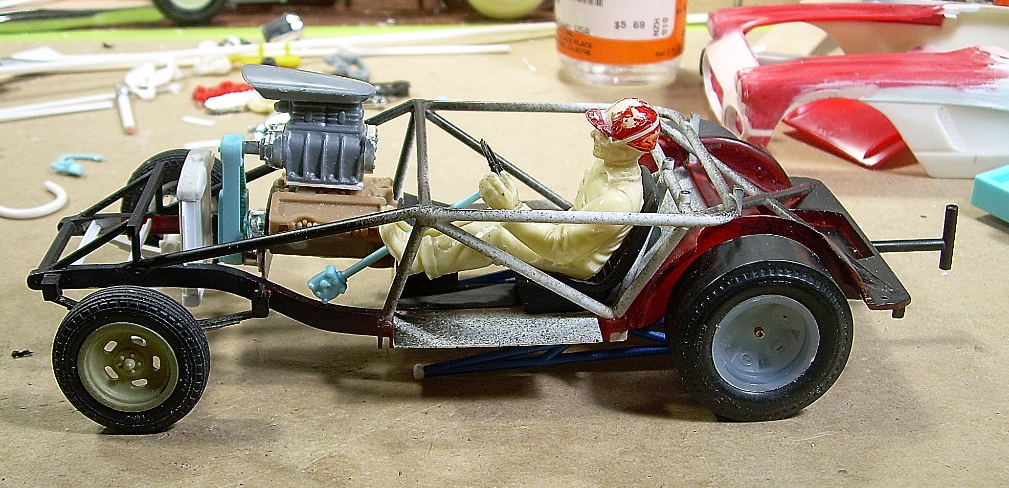

Time to start bringing the engine home while working on other things. First step is to fill the old metal-axle holes in the block, sourced from the ancient AMT '57 Chevy.

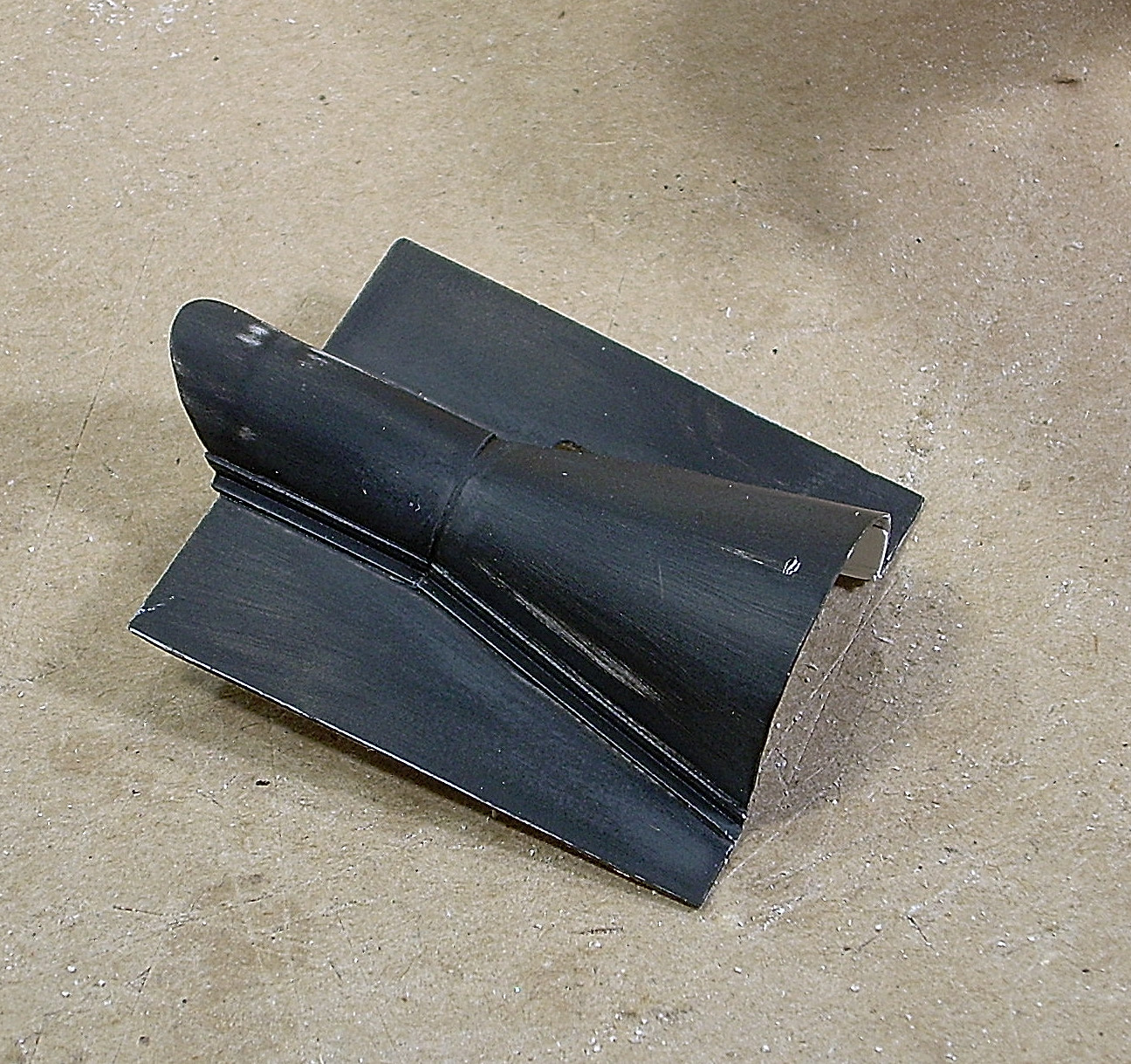

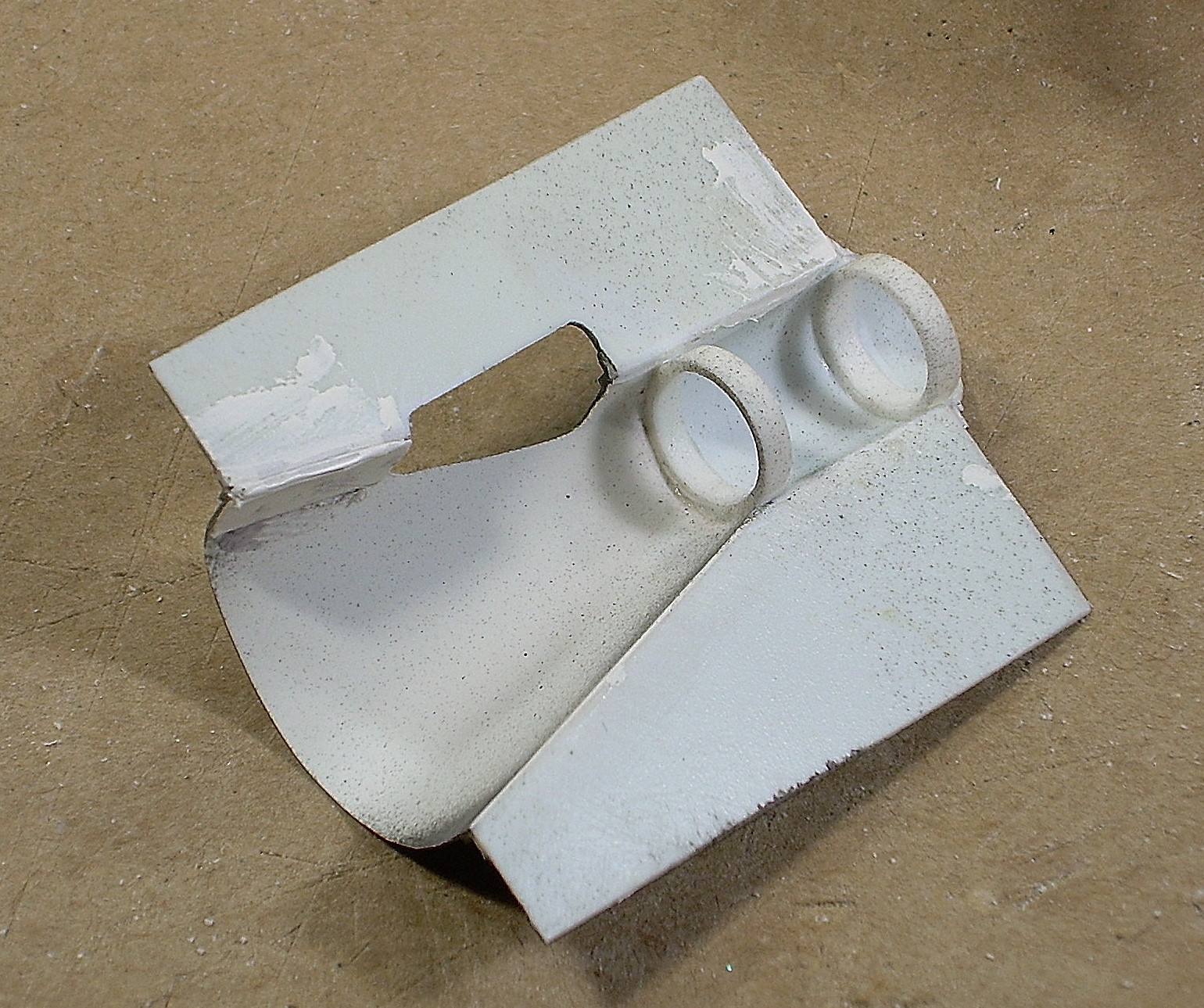

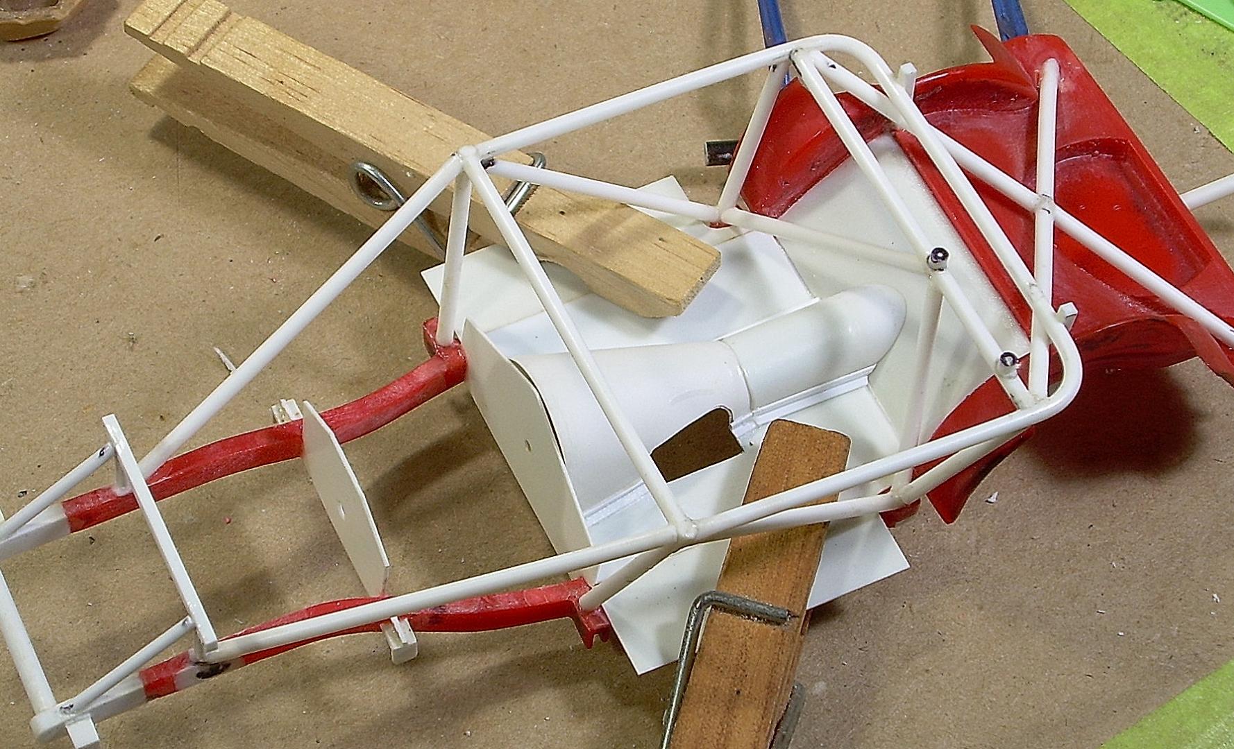

Next, the floor and tunnel assembly turned out to be very fragile at the glue joints (no surprise really, as the tunnel is .010" stock). The floor also tended to want to bow up as the glue evaporated. The solution was to reinforce the joints with light angle, using the chassis as a fixture during drying.
Driveshaft straps helped in the reinforcement of the assembly as well, and maintain the proper curvature of the rear of the tunnel.
A little black primer prior to the "bare-aluminum" finish. Yes, I know there's a slight joggle between the rear of the tunnel and the front. It's a race-car. The floor and tunnel would be in and out fairly frequently. It might get a little bent. That's my story.  B)

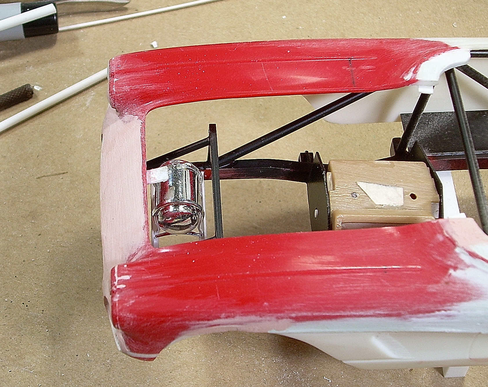

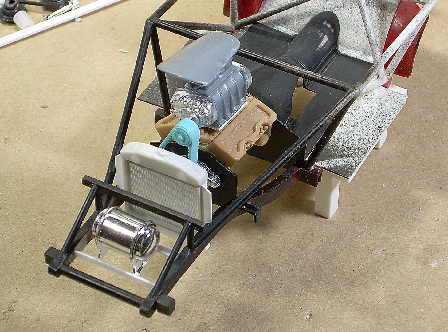

She's getting a radiator, but I didn't have anything the right size that looked period-correct (downflow with brass tanks). I decided to scratch-bash something with a core cut from the forward panel of a '49 Ford, and the upper tank from same. The Moon fuel tank is from the parts bin.
Moon tank installed in the frame, accessible through the hood panel.
Here's the radiator progressing. Core separated from the support, upper tank holes for flathead hoses filled, parts for the side frames and lower tank laid out...
Edited by Ace-Garageguy

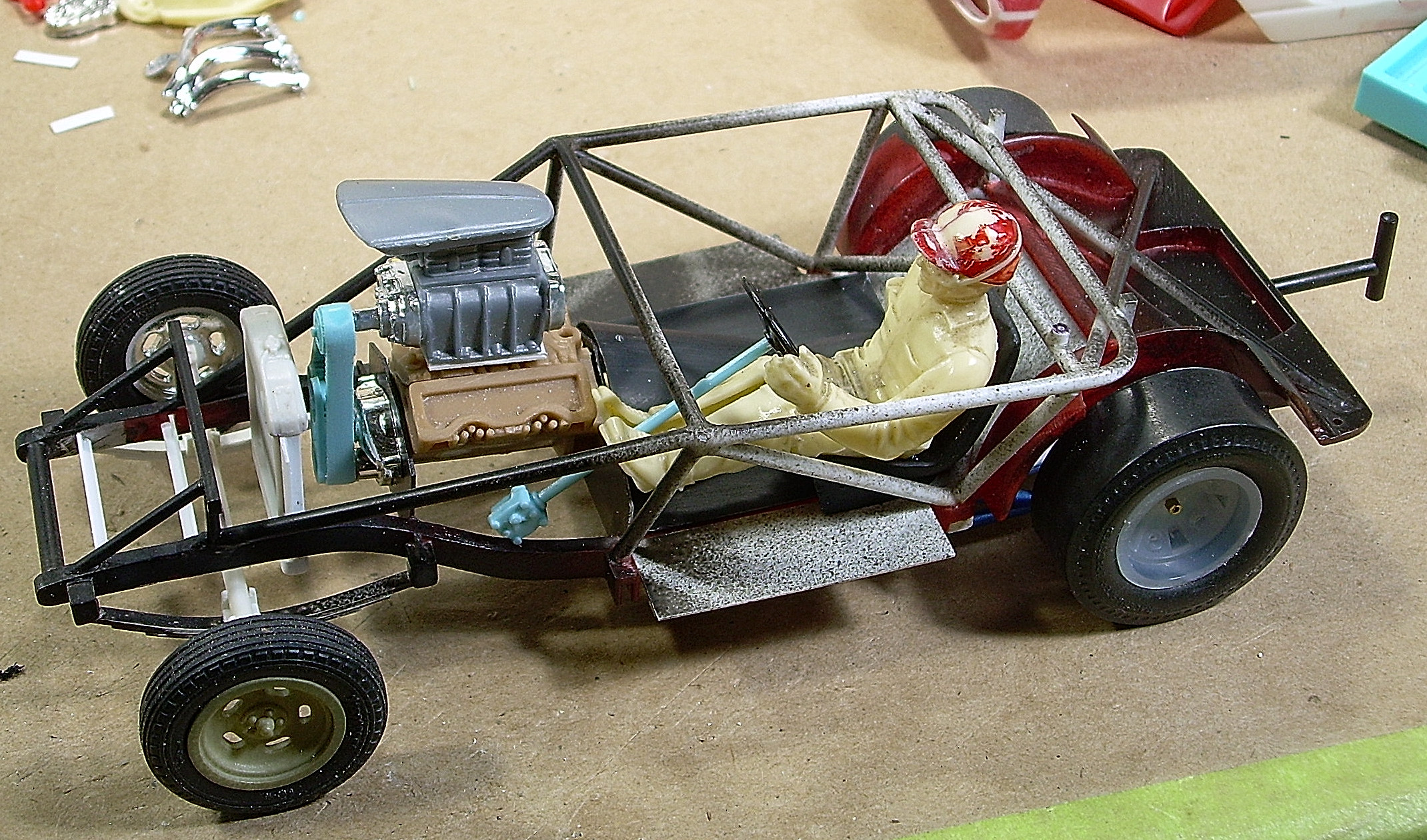

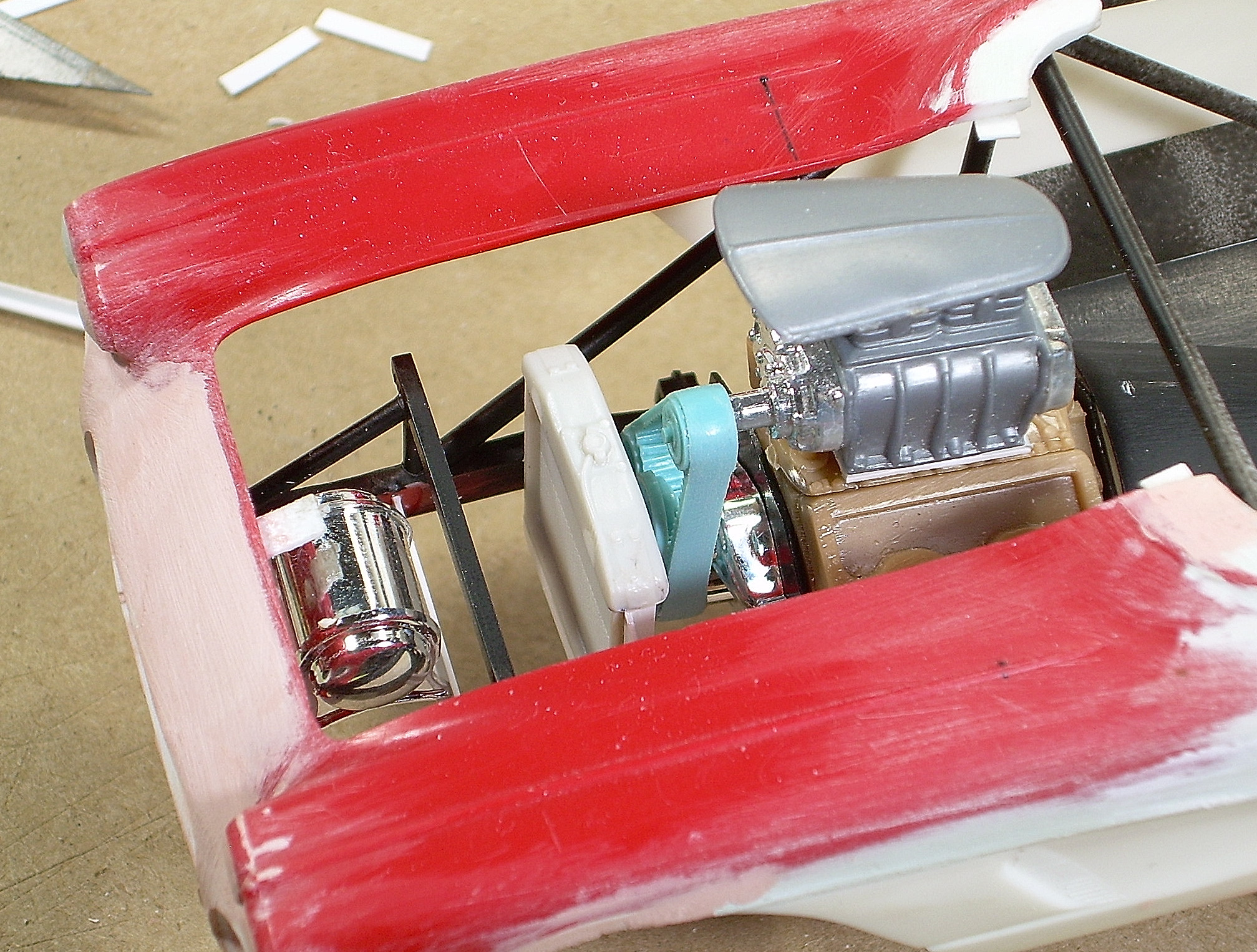

Radiator's assembled, with side frames and support wings. Lower tank is laminated from two short lengths of stock, with the appropriate edges and corners rounded.
This shot shows how it fits snugly between the frame rails. I'll make little triangular brackets on the frame for it shortly.
There are several ways to run a water pump with a supercharged engine. Some setups use electric pumps. Some setups place the pulleys behind the blower drive, but in my mind, this tends to make the blower drive more flexible than is desirable, as the blower-drive cogs get moved farther out on the crank snout and the blower itself. I did some research, and found the Stone-Woods-Cook Olds-powered '41 Willys in particular used water pump pulleys mounted forward of the blower drive cogs. This shortens the very highly loaded blower-drive shafts as mentioned above, and also makes it far easier to change water pump belts. I've used the Revell SWC Willys blower drive assembly for a mockup, to get the spacing on the front of the engine about right, so I could locate the radiator where the hoses would be as short as possible. I'll need to fab up a custom blower drive for this thing too, as the spacing between the crank snout, blower drive shaft, and water pump shaft are very different on the AMT Chevy 409 than they are on the Revell 394-based Olds.
With the water pump and radiator issues somewhat dealt with, the next problem to untangle is getting the steering gear in the car. There will be conflicts with the exhaust headers, and I'd kinda like to make the steering shaft in one piece without resorting to universal joints to get around other stuff. Sometimes it's unavoidable to use UJs, but I'd prefer to build the headers to clear the steering rather than the other way around. As always, multiple mockups and looking at things from multiple angles are essential to get everything to fit, and Lefty is a big help in getting reasonably correct relationships between components that have to accommodate a human.
