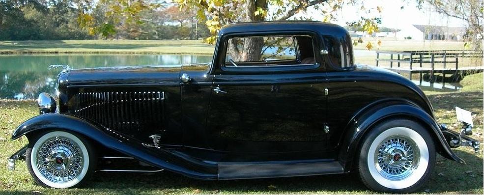

Just kicking an idea around to Revell's 32 Ford 3 window coupe

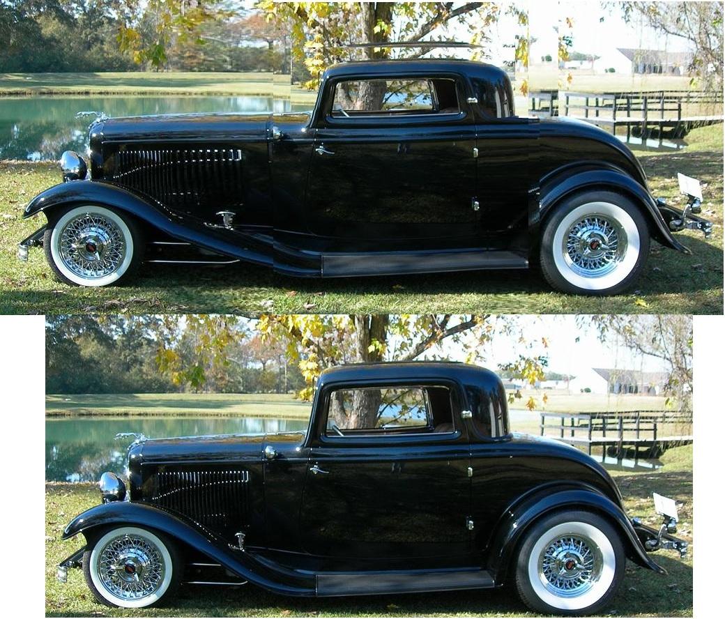

I lengthened the hood and trunk and chopped the top in this photo
Thoughts?

You asked, so I'll give you my $.02. IMO, extending the front and rear is not an improvement in any way, the chop even makes it worse and  I do like chopped 32's. The 32 Ford's overall shape and lines were perfect right out of the factory, even now in 2017 the factory design looks great. As I've said numerous time, if we all had the same tastes, the world would be a boring place.

What you are changing, in your photo shopped pic, are the "proportions" of the car. It's not that it's bad or your idea isn't valid but it throws off the proportions and makes the car look "funny". Stretching the front is similar to the mid 30's Mercedes-Benz 500K. If you compare that car to your rendering you will notice the cross-section is much lower which helps lengthen the car and draw your eye away from the tall grill and short top that grabs all of your attention in your pic.
90% of a good design is getting the proportions correct. If you take the grille and top down 6 or 8 inches it will look better.

It's just a matter of taste. I think you could extend the front and leave the back stock. The extended rear really kills it for me.
I think the long hood of and short rear look of the 35 Mercedes looks good. The shapes of the two are very similar. I think extending the front fenders on the 32 might help also. They seem to hang out a bit further than the Ford, also I think filling them in behind the wheels helps a lot.

This was a quickie I agree the proportions need to be played with
tge thought behind it?
in the 30's a longer hood essentially meant power. Straight 8's, V-16's, etc. needed the room. I added the additional trunk to balance it but I agree like the Mercedes it doesn't necessarily need it
the chopped to is to make the cab area look longer without stretching it but I think it needs additional work

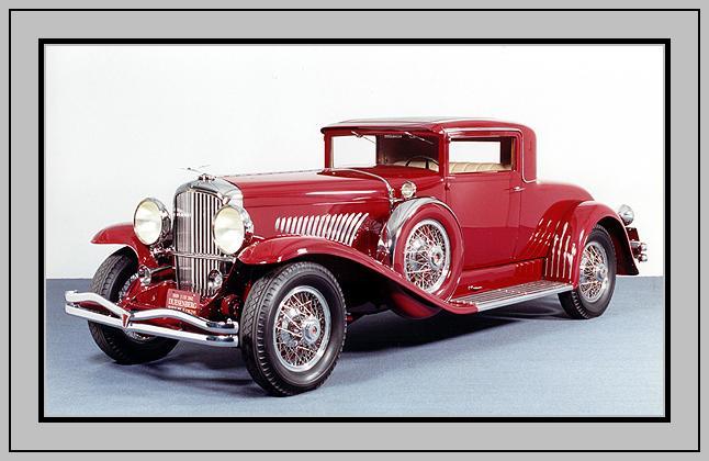

i had I mind a Duesenberg Judkins coupe as a sort of inspiration
and please pick it apart if you don't like it no hard feelings on my part

I think I get it. The lengthened version appears chunky and not sleek through the middle. The short roof adds to the chunky appearance. To get off point some, that front wheel is throwing me off, making it hard for me to take in the total image. Looks wrong to me.

I generally like what you did. I'm using the difference of opinion as a learning experience on aesthetics and proportion. Hope you don't mind my jumping in,
I wanted people to jump in.
The exercise is to lengthen the hood to imply more power and then change the rest of the proportions to match do it looks "right" without doing radical bodywork or a complete redesign something that may not be possible but fun in photoshop
Overall I like what you've done, and understand the reasoning behind it.
But the '32 Ford is very close to perfect as is, as David already mentioned, and it's hard to improve on something that's so 'right' to begin with.
Also as previously mentioned, proportion and line are absolutely critical to get right, no matter how many reworks it takes.
One important thing to remember when doing re-design work is that subtle, sometimes VERY subtle changes can be the difference between the initial reaction being "wow !!!" and "hmmmmmm....".
Something to remember on this particular restyle is that the '32 Ford is a much smaller car overall than the "classics" your design echoes, so widening it would really need to be done to get the 3/4 view proportions to work well.
Specifically, it looks to me as though the radiator shell could benefit from being dropped maybe a 1/2 inch or so, as the hood line appears to be climbing towards the front of the car on the rework. This is an effect of the p-shopping, but needs to be addressed.
And raising the front fenders a bit to accommodate a larger diameter front tire would be good. It's too small visually even on the original photograph, and it seems to be overpowered by the additional visual mass of the lengthened front end.
Also, the centerline of the front wheel could stand to be moved forward a tick, as it appears to be too far to the rear relative to the arch of the fender line.
Otherwise, as I said, I like your work here. Something like a classic Jag DOHC inline six would be perfect for it.
I'd also leave the chop as you have it. It becomes a quite 'formal' looking roof in your version, and introduces some visual tension into the design, which tends to make it more interesting than if it were even slightly higher.
For my own re-design work, I'll often spend many hours with 3-dimensional models tweaking the proportions and lines, sometimes only a matter of a few thousandths of an inch (working in 1/25 scale) and moving all around the project, photographing from every angle, and analyzing the photos on the computer screen, before I get something I'm really happy with.

If you look at the Judkins, a favorite of mine BTW, the rear is low between top of RF and deck. Cowl pretty thick on the Deuce as well.

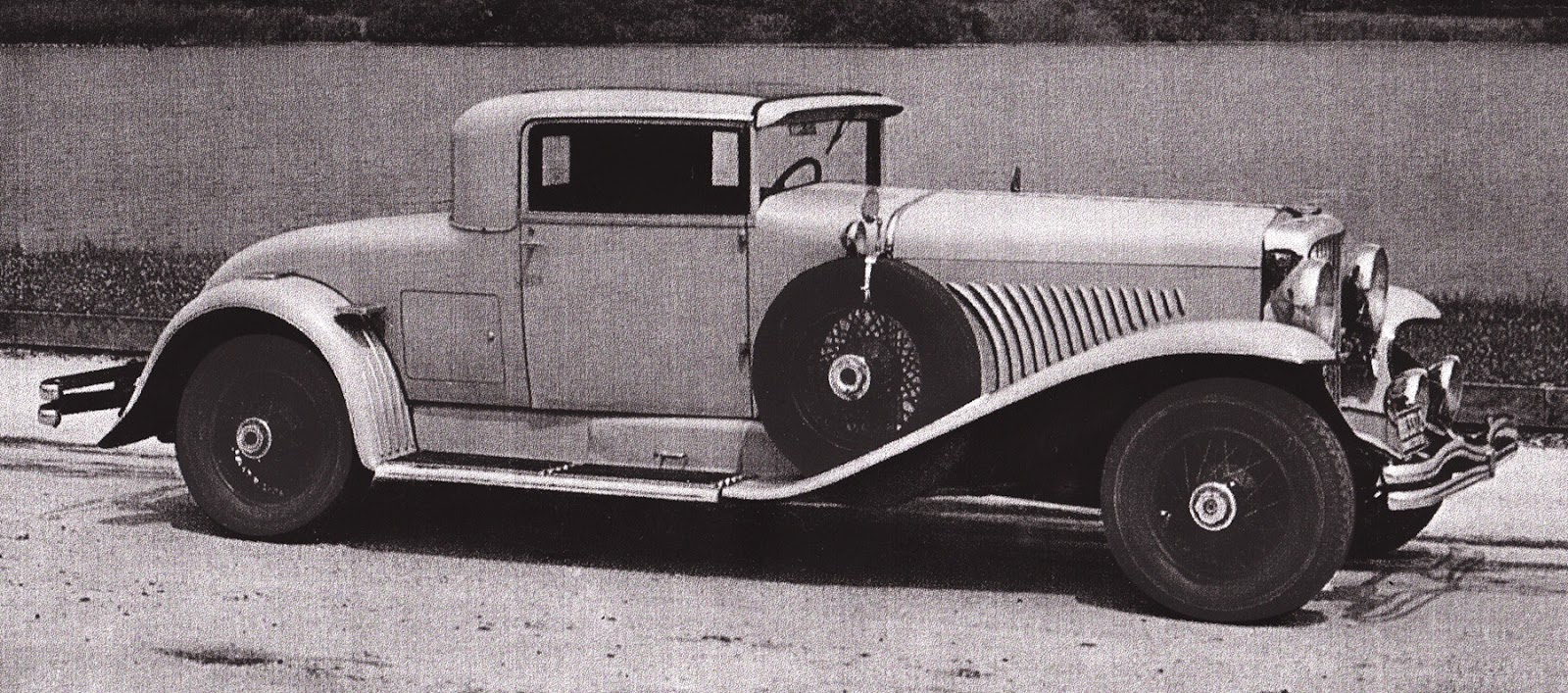

I think it'd be easier "Deucifying" a 28 Lincoln Roadster (AMT/MPC, common, cheap). It was Judkins, was basis for Lee Baker's master of the Duesy above for Art Anderson ages ago. Same scale, and gives you template.
You could mod Deuce fenders, use 2 32's and a Lincoln.
Here's 30 Judkins Lincoln coupe for comparo. Bottom pic is what Lincoln roadster depicts. Easier to graft bits than chop, lengthen, section perhaps.

Found a nice pic of J137 not over-restored. Maroon resto has way too much chrome, not all high end cars came with whitewalls. This has look of a rod in some ways, and a great looking car no matter what level of restoration

i wasn't trying to to copy the Judkins just I had it in the back of my mind. It is a completely different car
