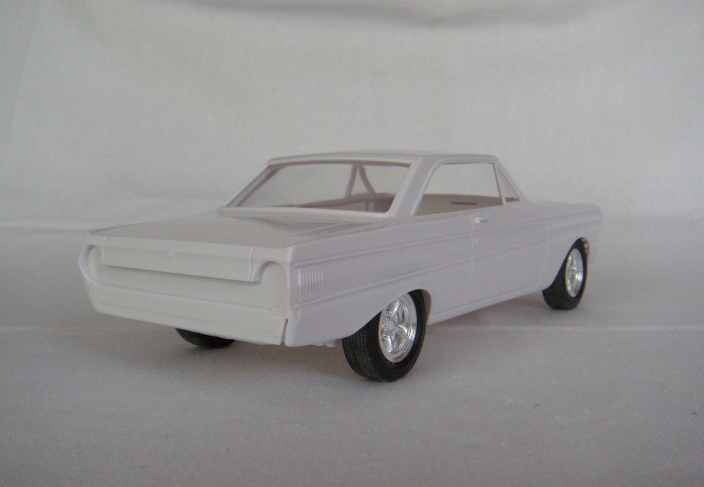

Not real exciting stuff to look at but I like my builds to fit together properly.  Adjusted the rear track to get proper tire clearance:
DSCN4515DSCN4517

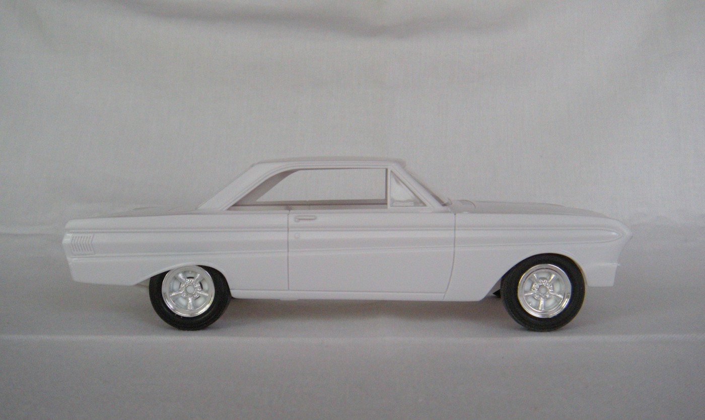

Lowered the front stance fractionally:
DSCN4520

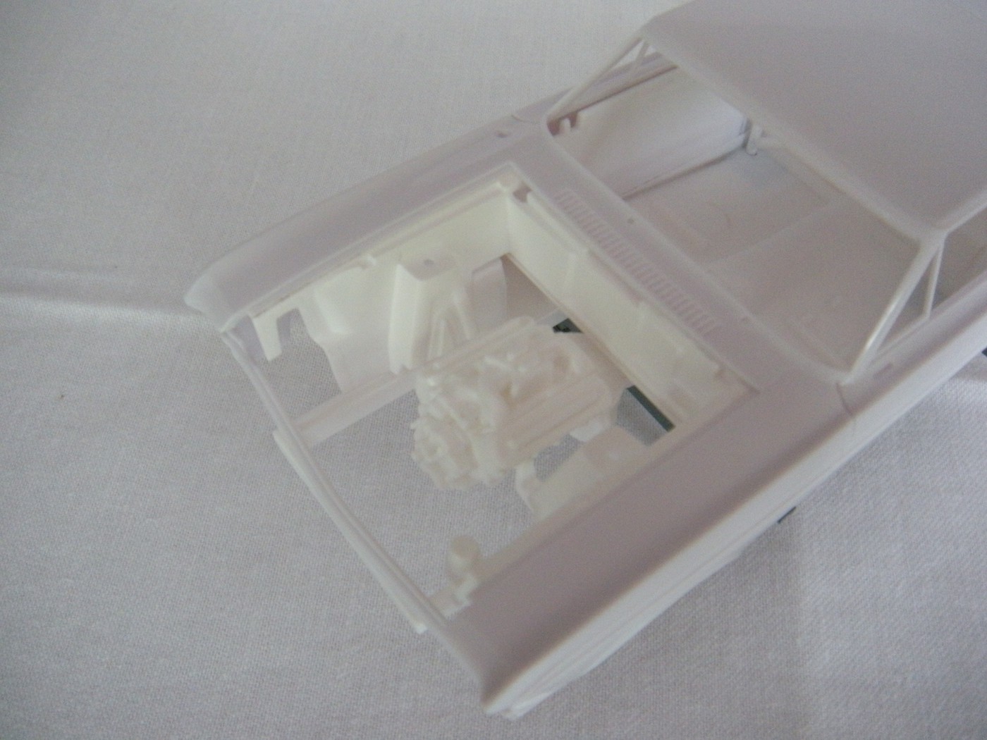

Didn't care for the big void between the inner fender and the foot well...
DSCN4526
so I fabricated a filler panel.  Also boxed in the top of the frame rails.
DSCN4527

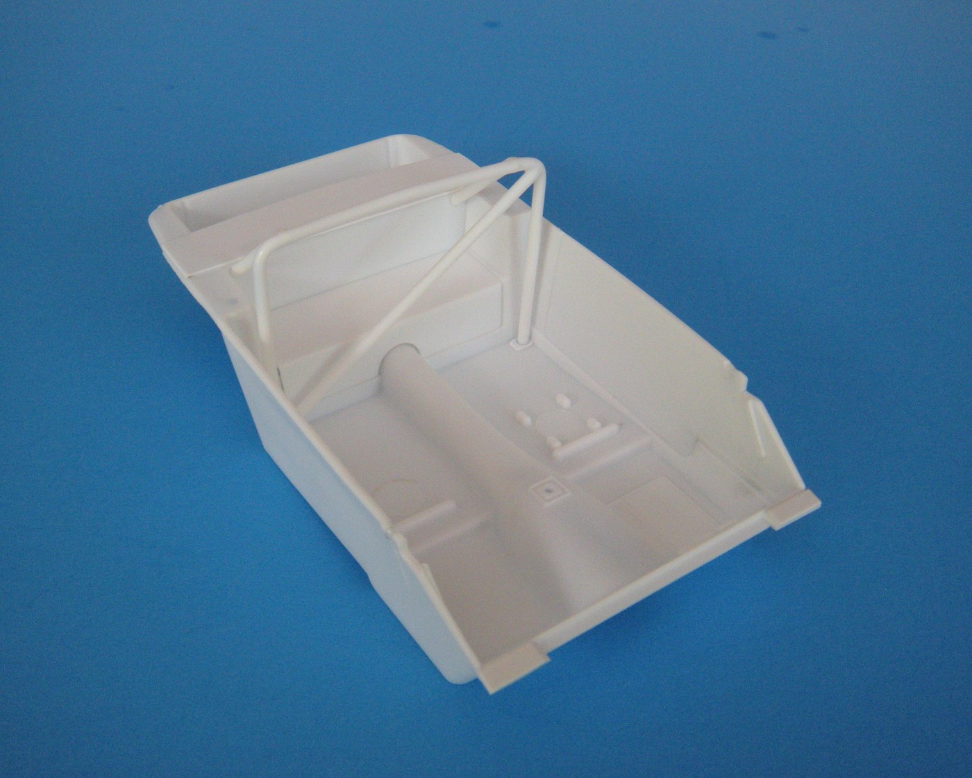

Trans-Am rules of the period did not allow full roll cages, only a simple roll hop.  Scratched one up based on the few period photos I could find.  Also fabricated the rear bulkhead/package tray.
DSCN4535DSCN4538

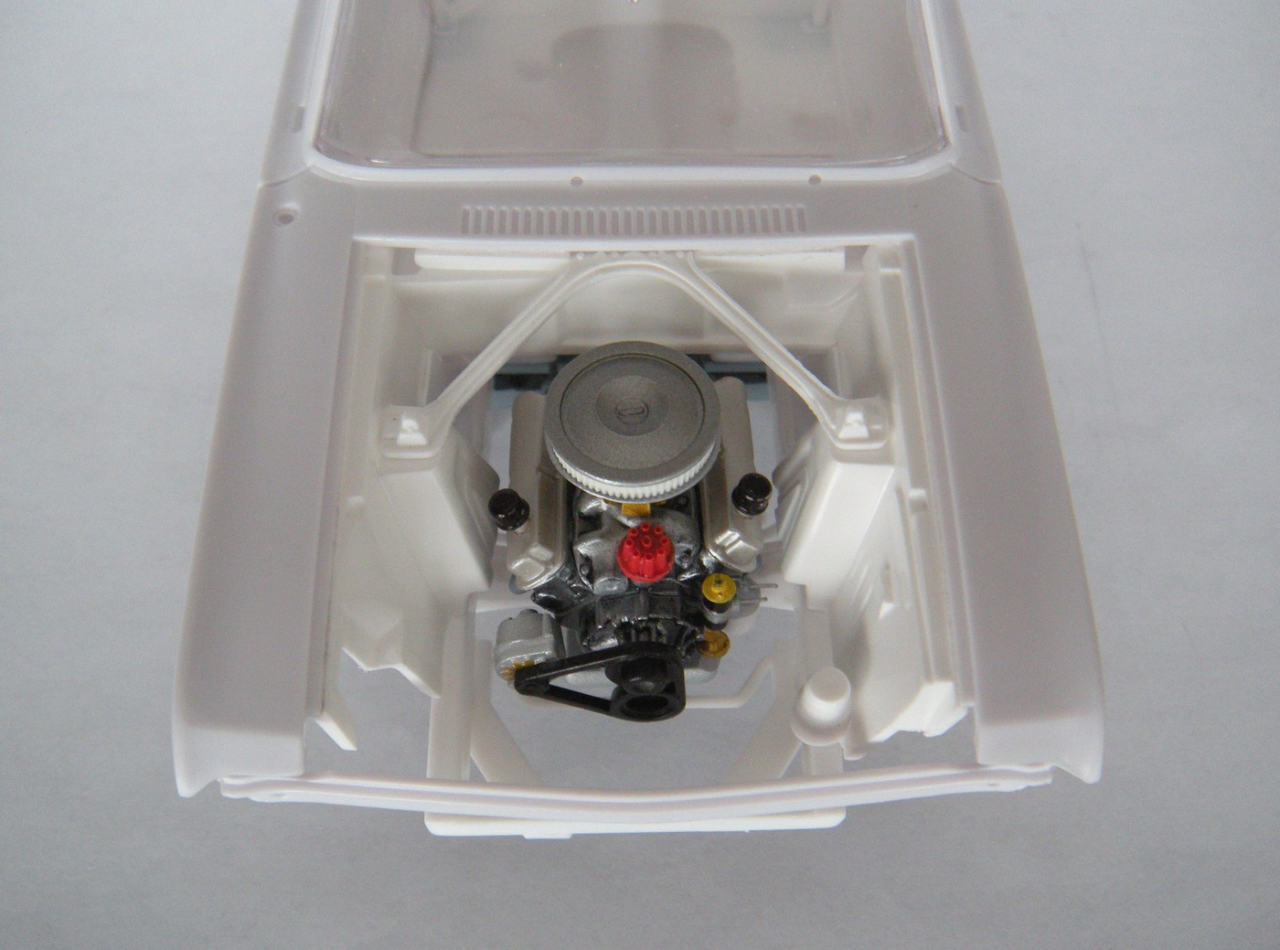

Not wired and plumbed yet but engine is painted.
DSCN4546DSCN4547DSCN4549

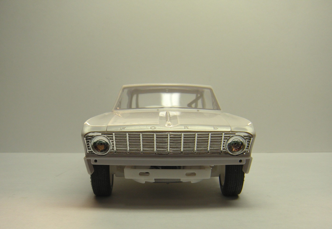

Trans Am rules allowed for the removal of the bumpers.  Since the frame will be exposed I wanted to add some interest so I created to oval opening to replicate the 1:1.
DSCN4552
Great eye for detail  B)
I can't remember seeing anything like that cylinder thing on the left front of the engine bay on any real mustang or falcon. Maybe it was unique to the car monogram researched?
mike
Thanks Mike, not sure what it is supposed to be but I am leaving it in place as a catch can for the oil breather vent tubes I'll install later.
If you're thinking of the object toward the front of the engine from the oil filter I believe it's the fuel pump and the "can" attached to the bottom would be the fuel filter. If this is correct it is a screw on affair with a disposable filter inside.
