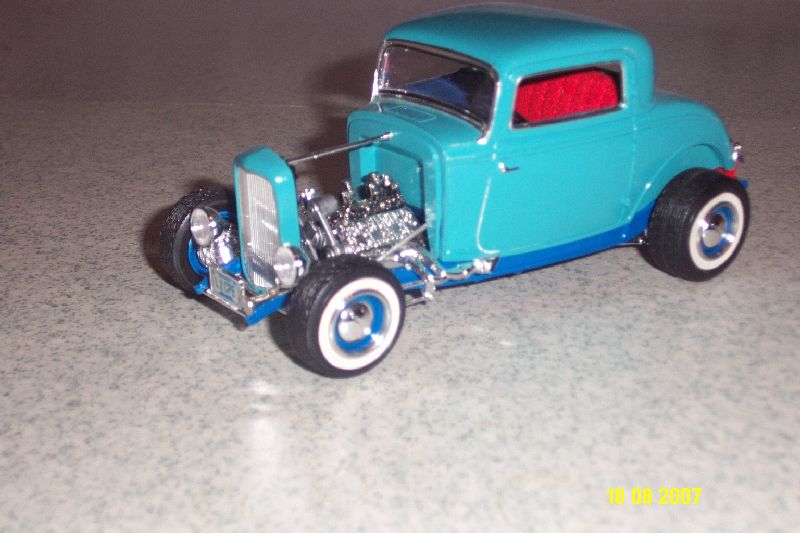

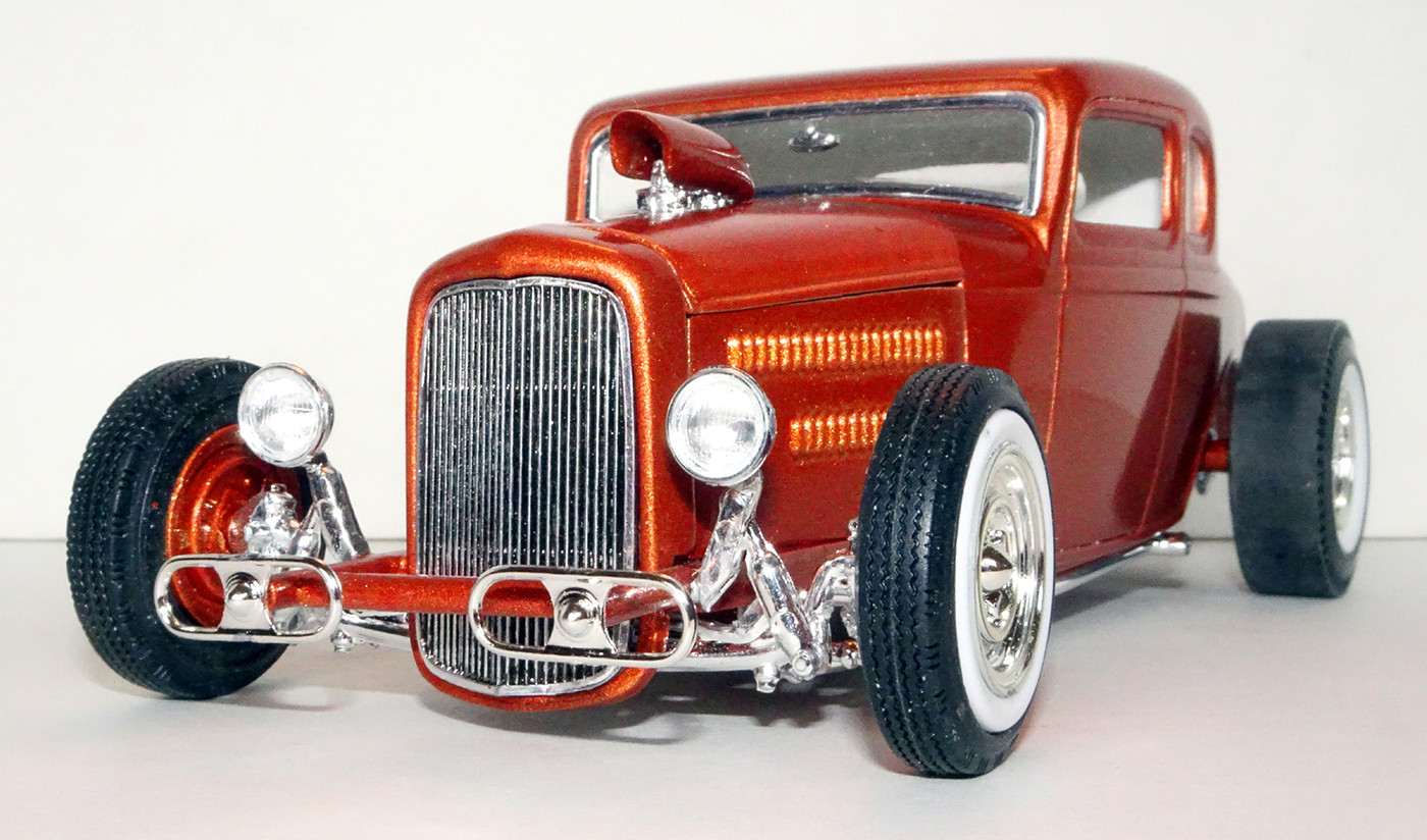

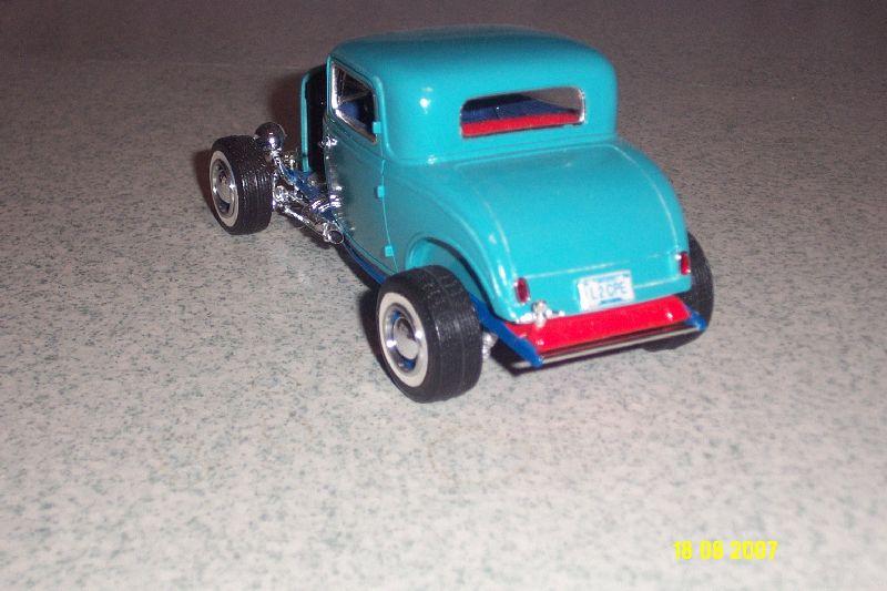

Many years ago I picked up a t-shirt at a Beach Boys themed show. The car on the shirt was the blue coupe you see. I followed the song words as best I could to create this model, painted Boyd's Pacific Blue. The gold car is a copy of a 1:1 car that someone built and I got in a collection. Both are Deuce coupes :) The car that is shown on the album cover is closer to the words of the song 'Custom Machine' They used it on the album cover because it was available.

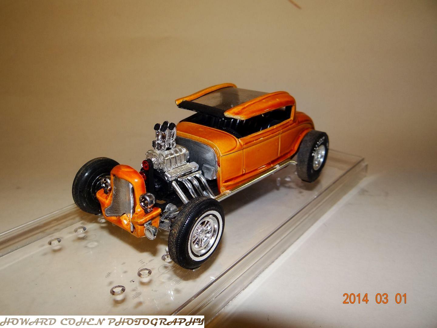

Here is my take on a Little Deuce Coupe build inspired by the song  with a very potent flathead engine, four speed and lakes pipes. I bet something like stripped down and lightened could have run 140mph or at least kph at Bonneville.
