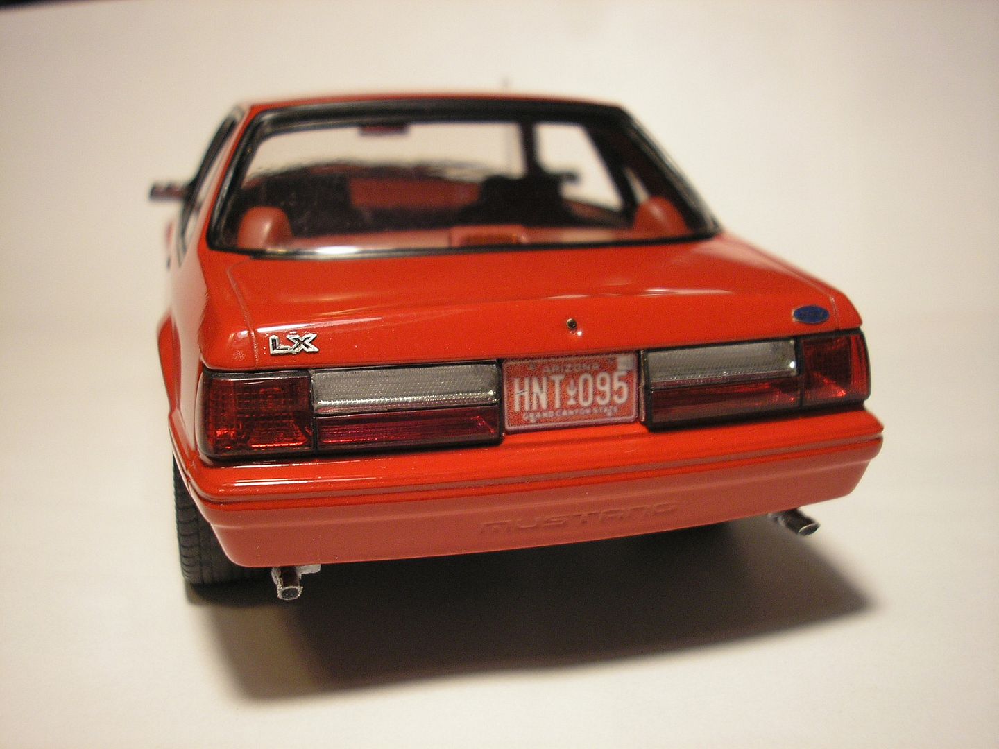

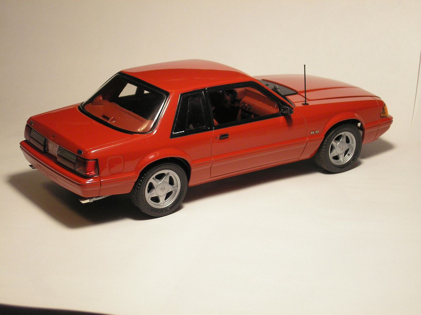

MonoPed Posted May 30, 2017 Posted May 30, 2017 Yes, the roof is too low. There is a resin body with a corrected roof, and there was a whole thread on how it was done (fantastic work, btw). I built mine using the kit body shell. I thinned the ledges that the glass sits on to almost nothing, and I sanded away the frosted edges, and polished back to clear. I used a black sharpie to go around the edge of the glass, and with the remaining ledges painted black along the with the window trim on the body, it does help "lift" the roof a little bit.
Draggon Posted May 30, 2017 Posted May 30, 2017 Brian , that's nice .Yeah, no kidding! Outstanding work.
FordRodnKustom Posted May 30, 2017 Posted May 30, 2017 Just as a refresher, this subject has been covered at length here before. As the owner of a 91 Sedan since new I can say that there are definitely proportion and detail issues with the kit body. Outstanding build Brian!

Maindrian Pace Posted June 3, 2017 Posted June 3, 2017 The resin body corrects a number of areas on the Revell body, the roof height being the biggest. The rear bumper also sticks out too far, the trunk lid is too boxy and doesn't have the subtle rounded down corners or the lip on the trailing edge, the rocker moldings are incorrect as the real car didn't have them, and the rear wheel wells were stretched for slicks. The lock cylinders were also relocated, among other smaller things. I built mine as a replica of my 1:1 car. Another builder here built both the kit and the resin body, showing the main differences. Apologies, but I don't remember who it is:
