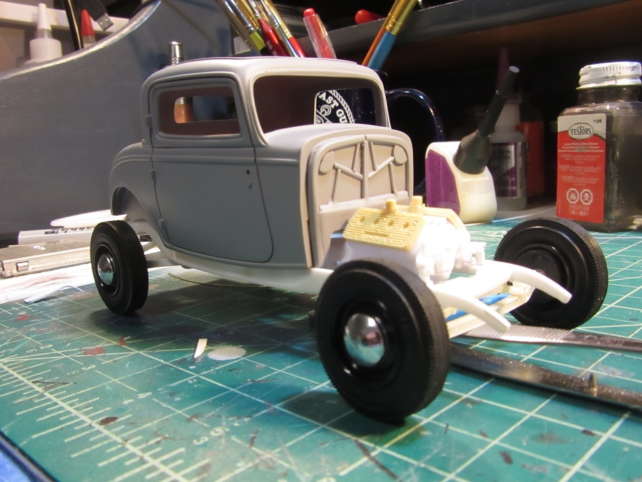

Some progress and a couple of steps back.
fh9
Under the assumption that he would have kept the interior mostly stock but may have recovered the 17 year old seat I removed the tuck and roll and went with the gray.
fh8

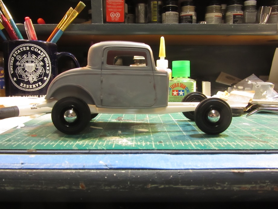

These are the wheels from the AMT 40 Ford and tires from the parts stash. Its hard to tell in the picture but the two bottom tires are smaller than the ones on top.
fh10
I need to bring move the front and rear axels up a bit and the tires seem too small.
fh11
At this point I'm not sure where to go. I've check every possible kit in my stash and I have nothing bigger unless I use Tim Boyds trick with the front tires from the Revell 29 roadster and the fronts from the Black Widow kit but they aren't the correct Firestone tires. Maybe I will mock them up and see how they look.
Edited by MGL

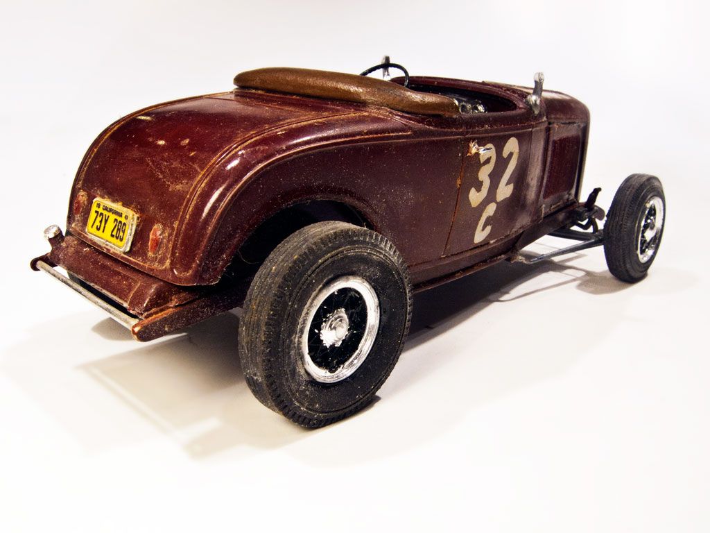

For sure bring the nose down using the Boyd trick of shaving the front spring. Looking at the stance of the Hernandez car, cutting down the front crossmember won't be necessary. A great source of period 16"bias ply tires is from the Revell '40 Ford Standard kit. They're whitewalls but if you paint them flat black and put them on the inside they look fine. My favorite bias ply narrow tires tall enough to go on the rear are the Herb Deeks truck tires he sells. I buy them each year at NNL West. He sells on eBay where he has a store (HerbDeeksRetro). Drop him a line.
For the rear, if you hang the transverse spring below the rear axle line that should bring things into line. I'm sure that's what Hernandez did. It's the classic setup.

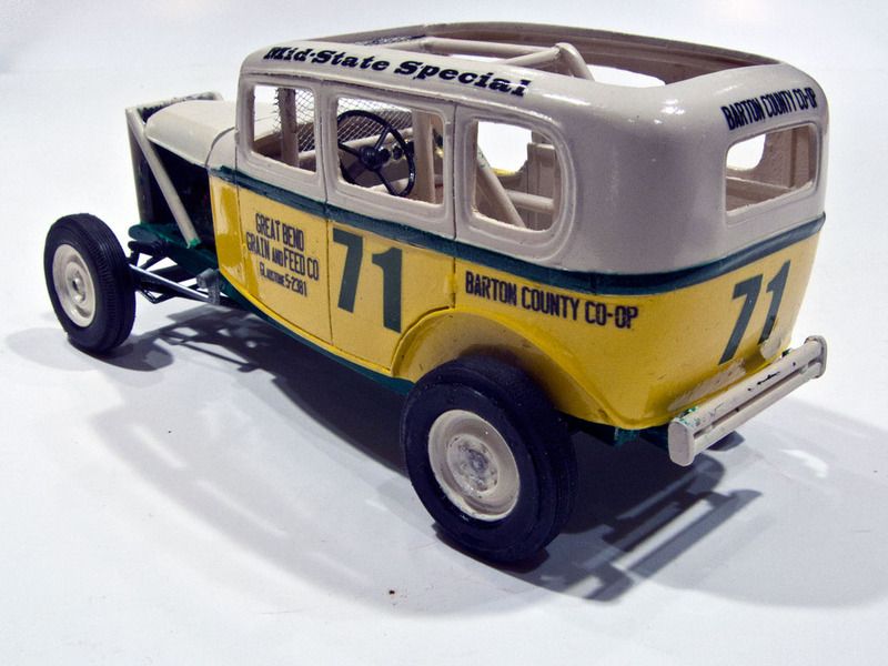

Here at the Revell '40 Ford tires on a jalopy racer I did last year. The wheels are the AMT steelies you're using. I shave some material off the inside of the Revell tires:
Here are the Deeks truck tires on a 40's lakes style Deuce I did, also last year. The rear end has a transverse rear spring hung below the rear axle centerline.:
Edited by Bernard Kron
The Revell Tires and wheels were the first thing I tried but they still look a little to small. The Deeks tires look perfect, I just ordered a set. I think for the front I may use the tires from the blue bandito kit. I do plan to lower the spring but I don't think I will go all the way below the center since I put the quick change in the car. Thanks for the tip on the tires, I don't normally look on ebay and would have never found them. I remember the jalopy racer but I think this is the first I've seen of the other car, I like what you did there.
On the advice of Bernard Kron I relocated the rear spring mount and shaved a bit off the top of the front spring. I also took about 1/8 of an inch out of the center of the front spring, it looked a little too wide. Even with the small tires it sits a lot better now.

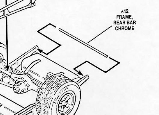

I wonder if he would have put a bar between the frame to protect the gas tank. Today I may try to get some paint on the body and start fabricating all the steering components.
Edited by MGL
Replacing photos
I wonder if he would have put a bar between the frame to protect the gas tank. ....
Movin' right along and starting to look good. There's a rear spacer bar on the chrome tree of the Revell 3 window kit:
