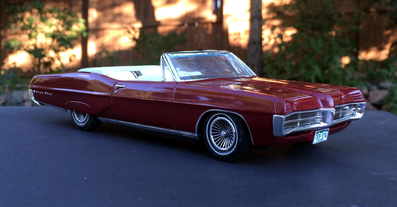

But was there a 67 Gran Prix model made back then
https://notoriousluxury.files.wordpress.com/2015/03/1967-11.jpg
Yes, a hand mastered one that Modelhaus offered. I have both the HT and I built the convertible as a tribute to one my dad owned for many years, I grew up with the 67 GP's Here's the one I built of the 67 GP

Great paint work Steve. Could you please explain how you did the scripting in more detail? The results are stunning
The old "foil under paint" technique.
It's a pretty common trick.
My method is to foil the script & other small chrome parts, such as the door locks, prior to the last color coat & then clean the paint off of the script after the last coat with a little thinner & a tooth pick.
I then clear coat the entire body.
Some guys foil them before any primer or paint goes on, but I have better luck waiting until I'm ready for the last color coat.
Steve

I like how the paint turned out. I think it is one of those colors you have to see in person in bright light to appreciate.
