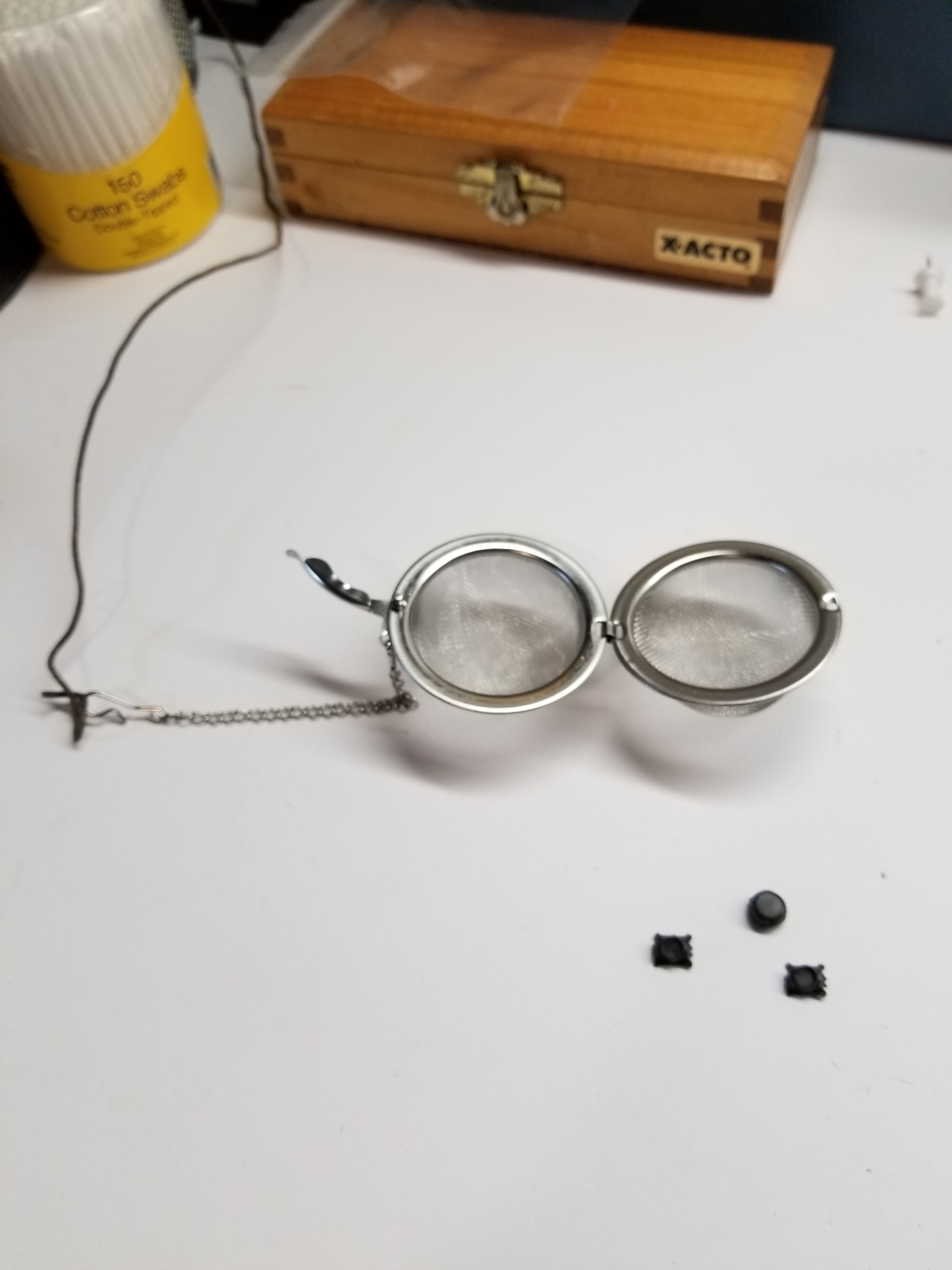

I use a 5gal. bucket with lid , from Home Depot. Purple power from walmart and for small parts I use a $3.00 Tea. I leave the parts in the bucket overnight. wash them off in the sink. Put the lid back on the bucket until next time20170712_203015.thumb.jpg.a308d9e932bd3d-ball from wal-mart
Edited by Super28
I use a 5gal. bucket with lid , from Home Depot. Purple power from walmart and for small parts I use a $3.00 Tea20170712_203015.thumb.jpg.a308d9e932bd3d-ball from wal-mart
I do the exact same thing with a tea strainer for small parts, so nice not to have to fish around inside the puddle for those little things.
Great idea with the tea strainer!
Just make sure the tea strainer, chain, etc. are stainless steel. The purple pond will attack aluminum, copper, and galvanized.
