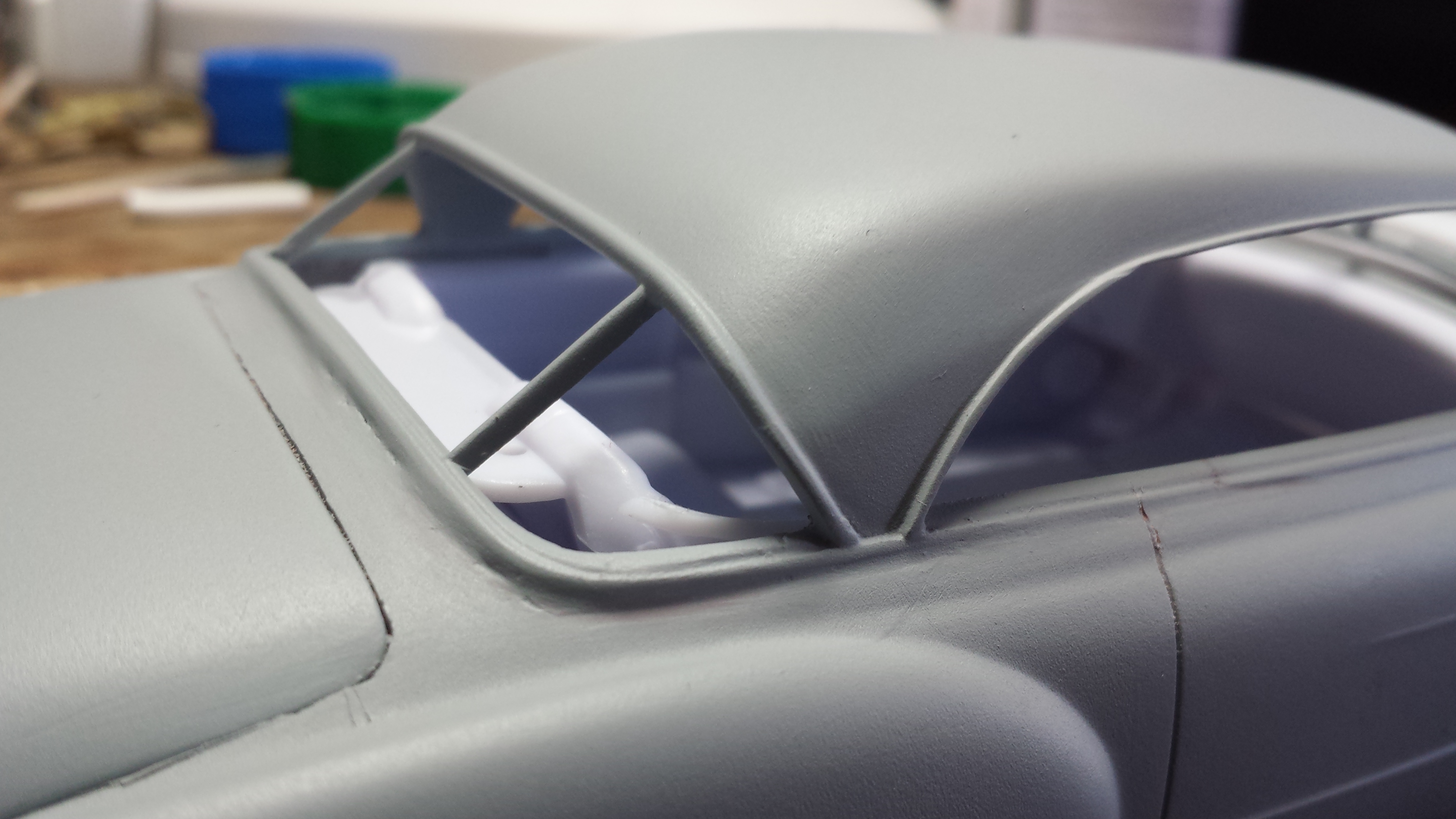

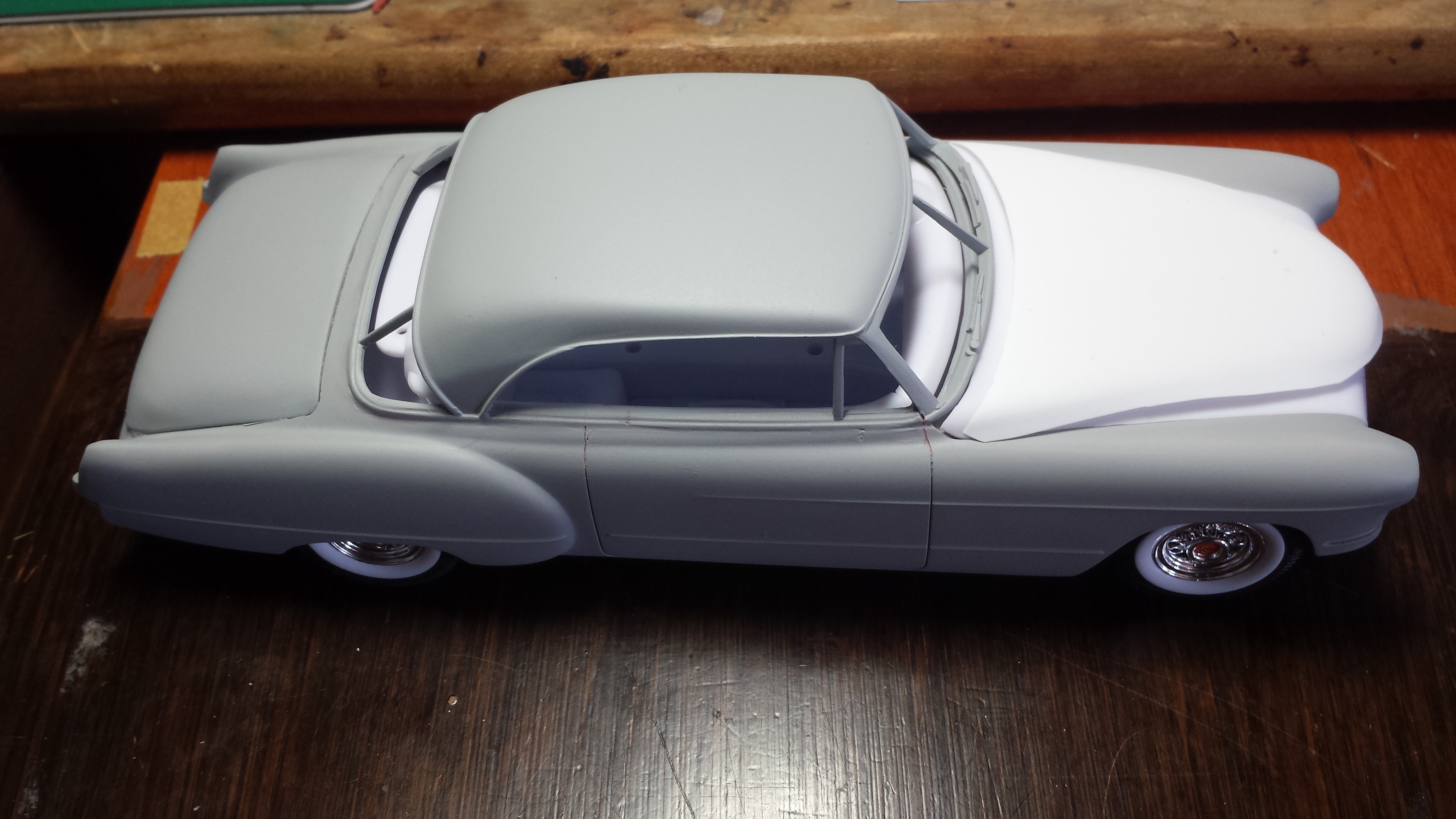

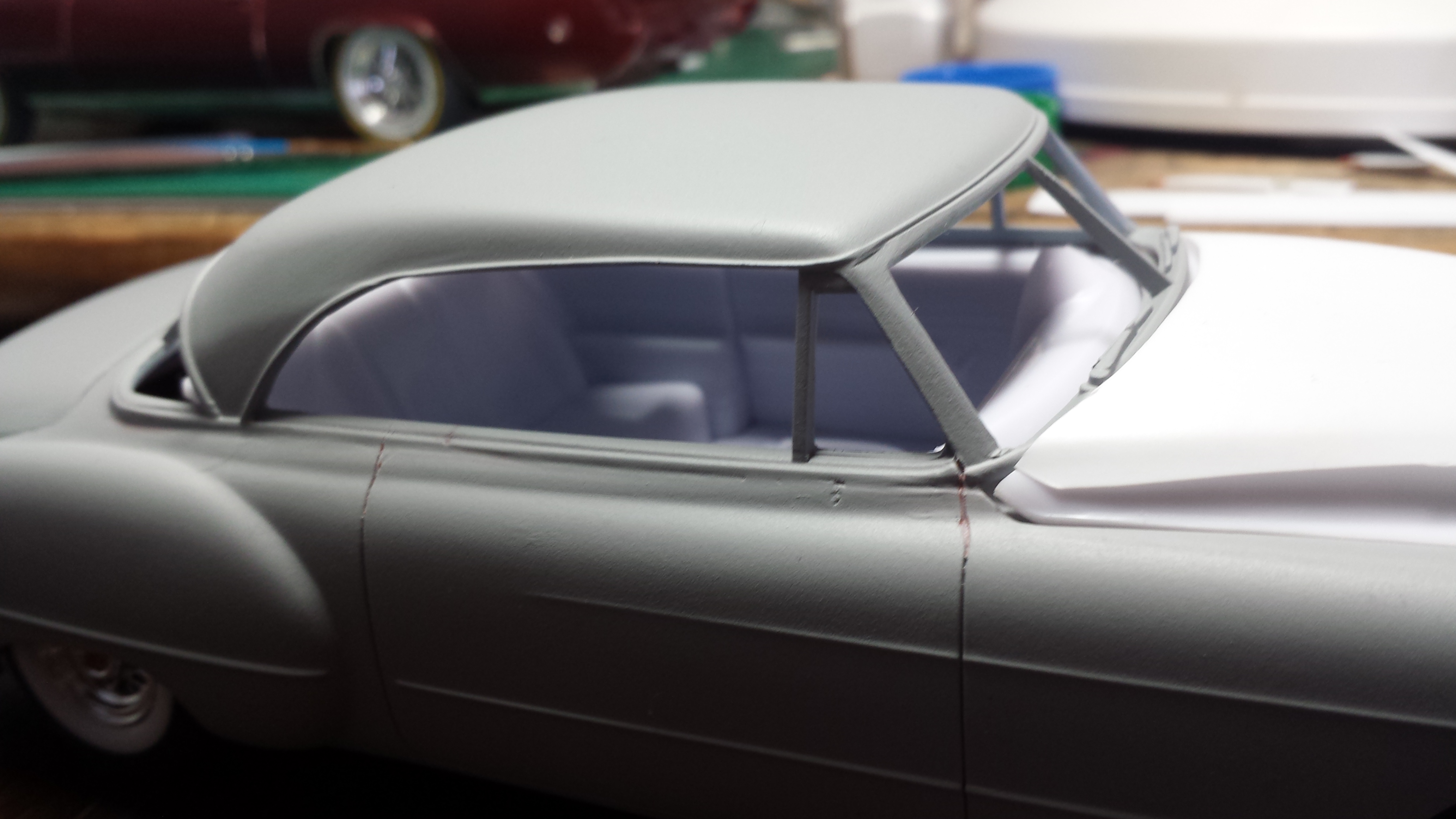

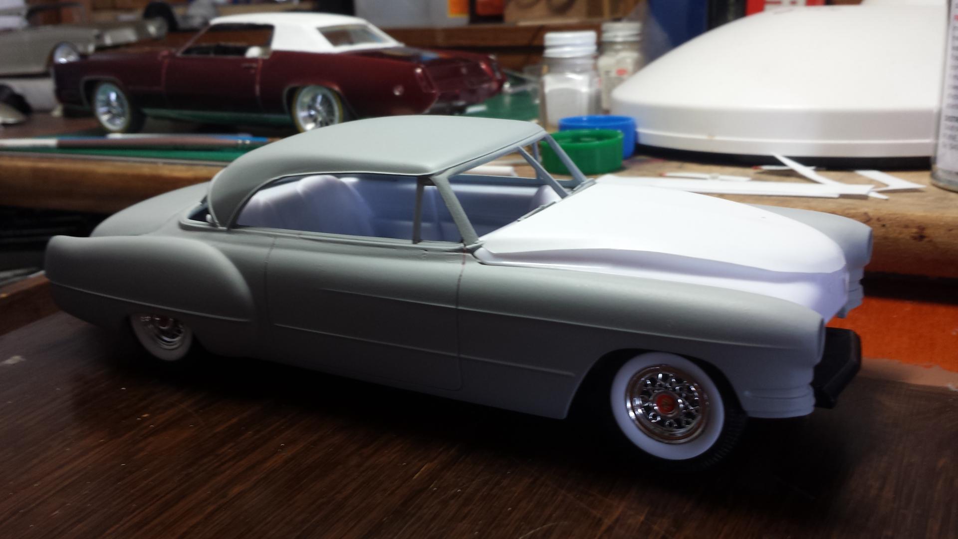

Perspective Customs Posted September 20, 2017 Author Share Posted September 20, 2017 I think the fix for the windshield to hood fitment is a combination of what has been suggested. The donor roof can come down and moved forward a bit. The Foose version has the top door edge angled back, shere the original 1:1 door edge is more vertical. Once I correct that, the roof and windshield will move forward. I'll then have to remove some material from the hood. Quote Link to comment Share on other sites More sharing options...

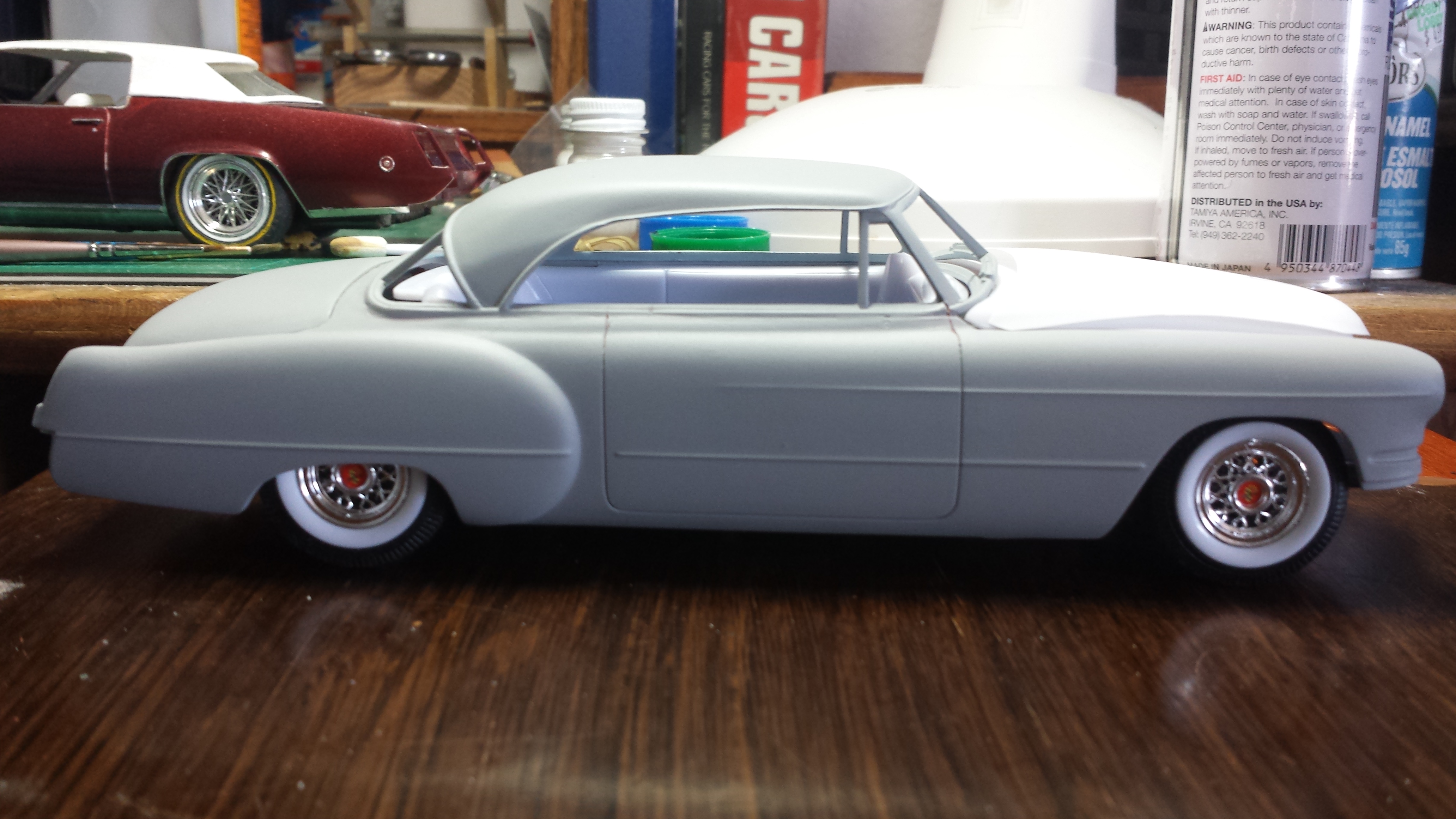

Perspective Customs Posted September 20, 2017 Author Share Posted September 20, 2017 (edited) Got the trunk in, just need to fill in a few spaces. Edited September 20, 2017 by Perspective Customs Quote Link to comment Share on other sites More sharing options...

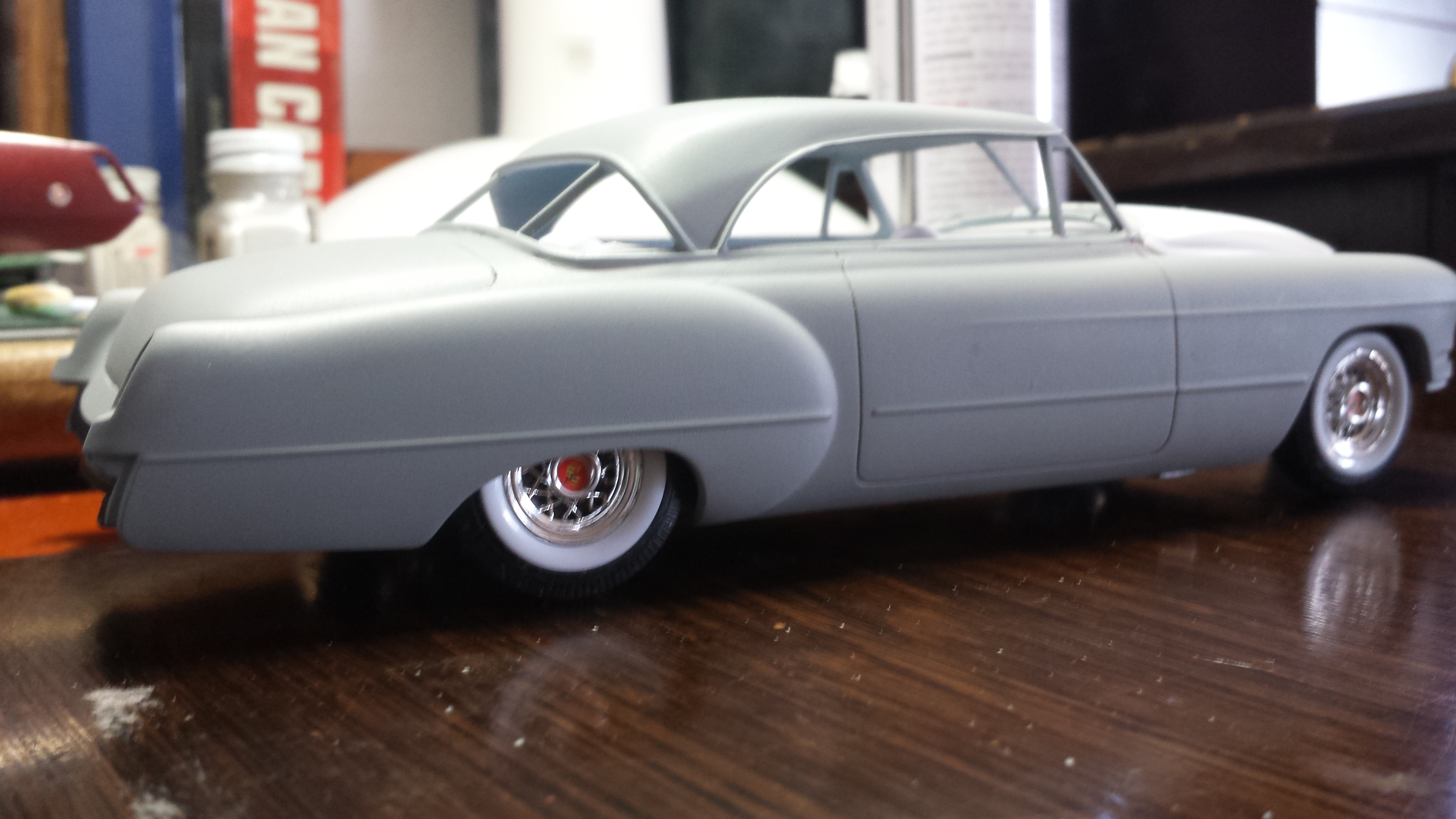

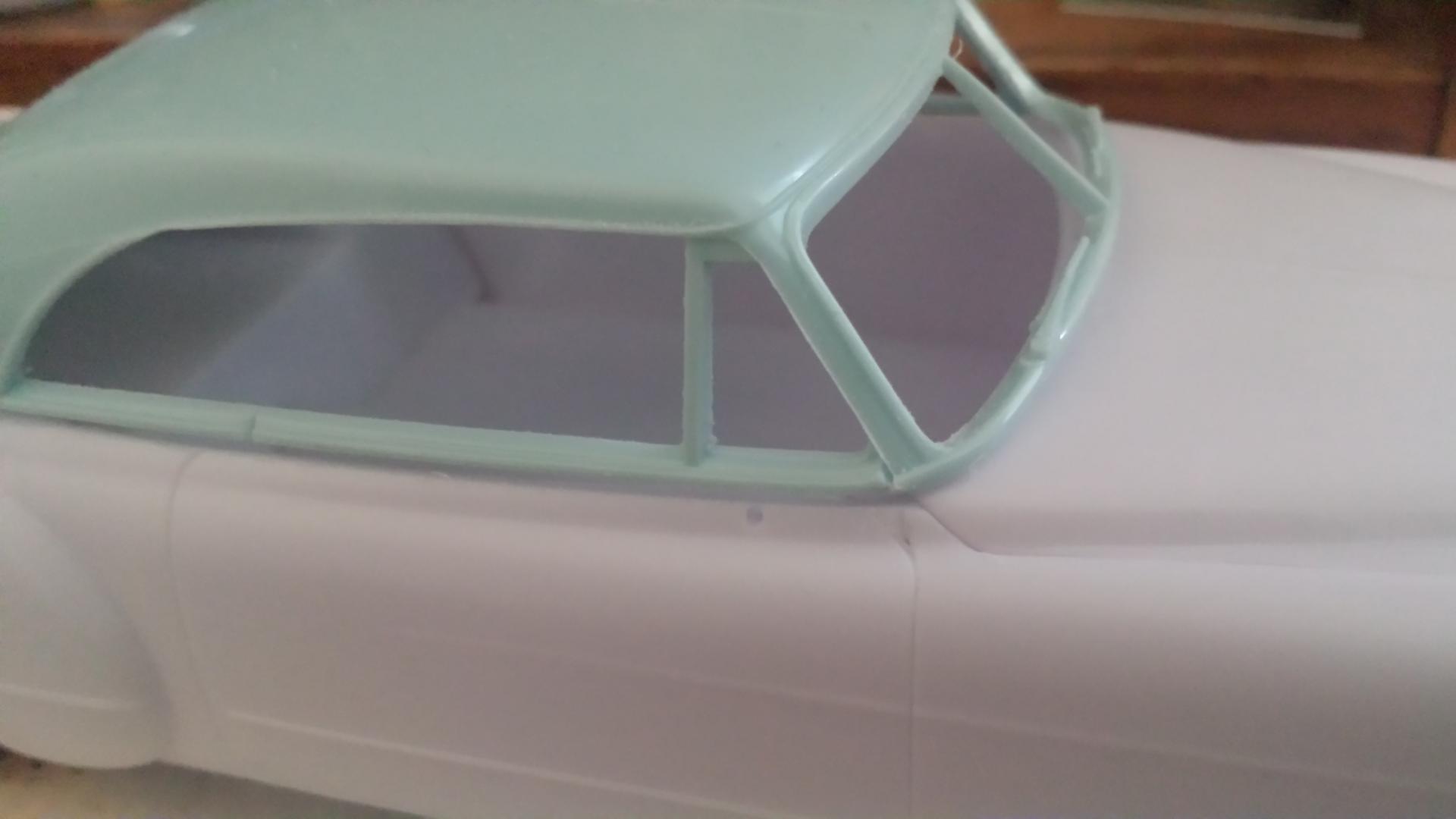

Perspective Customs Posted October 29, 2017 Author Share Posted October 29, 2017 (edited) Some progress. Roof and trunk are in and door top edges rescribed just need some clean up. Edited October 29, 2017 by Perspective Customs Quote Link to comment Share on other sites More sharing options...

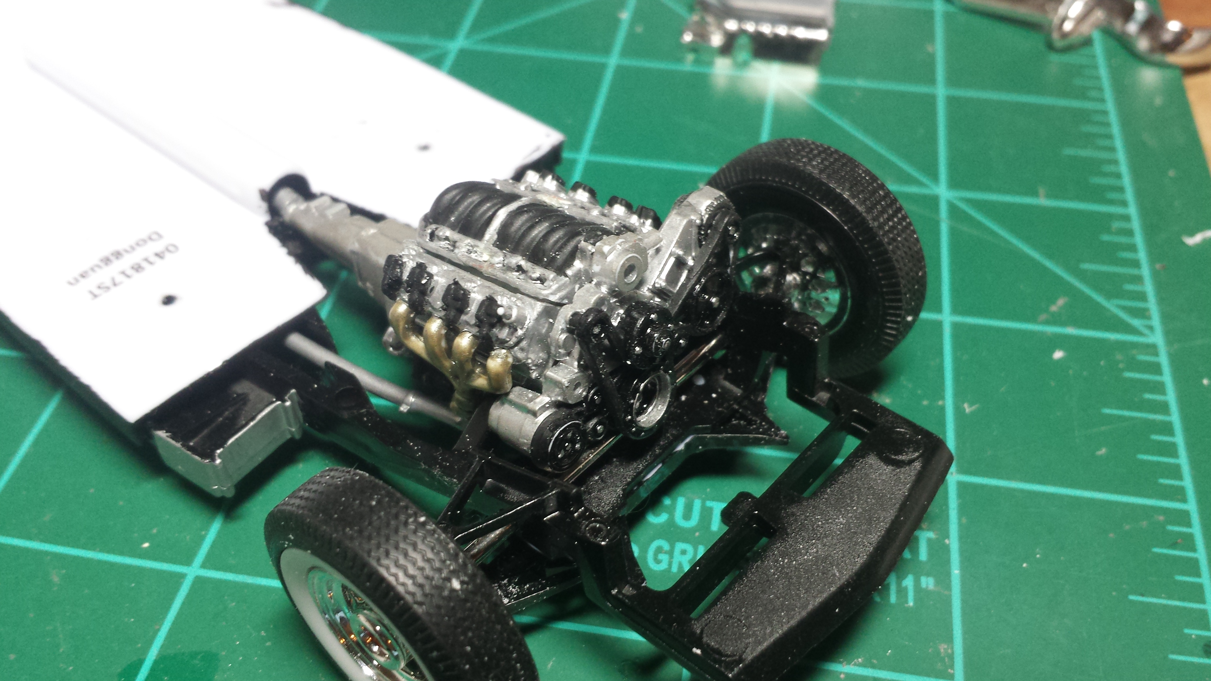

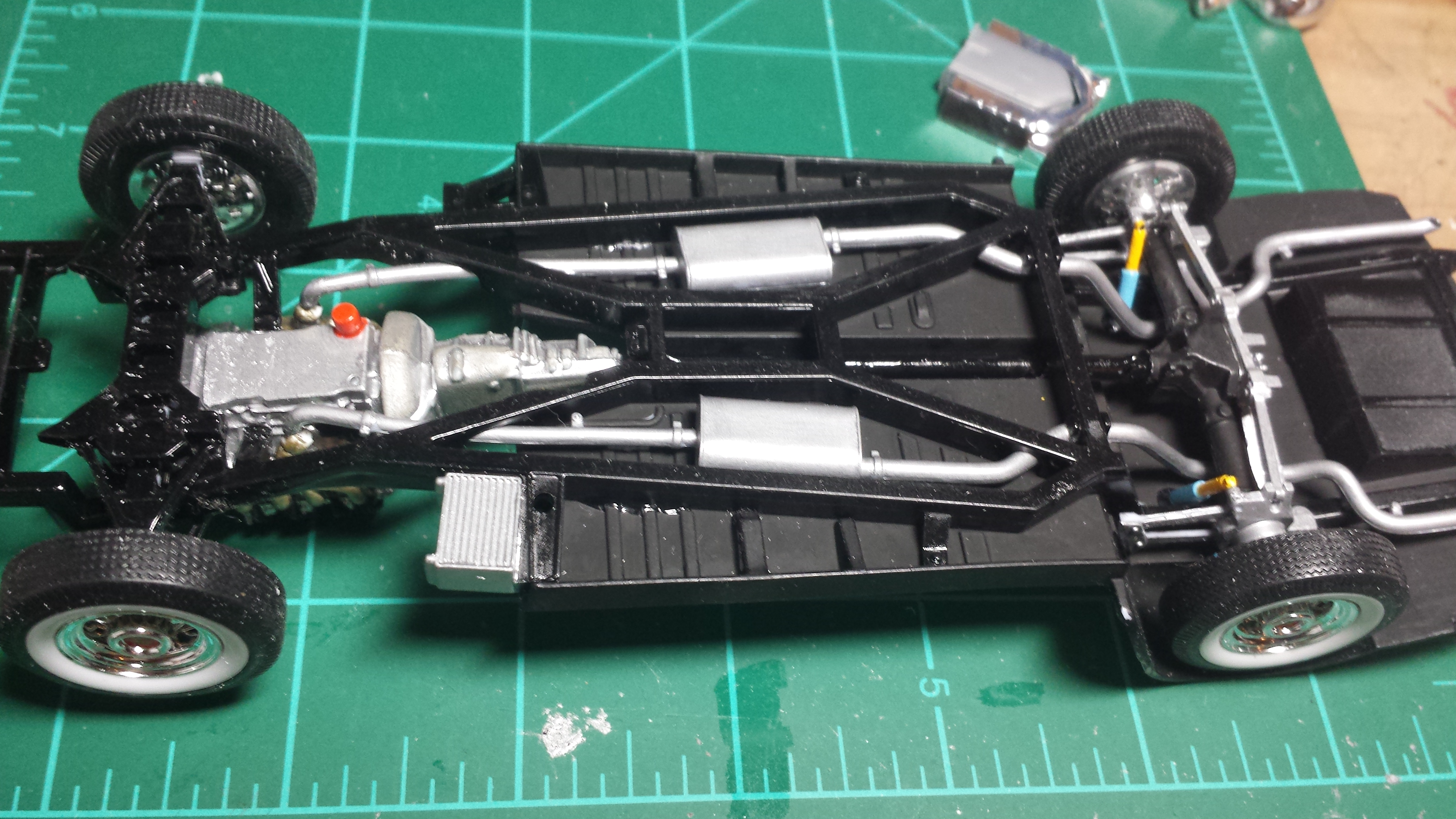

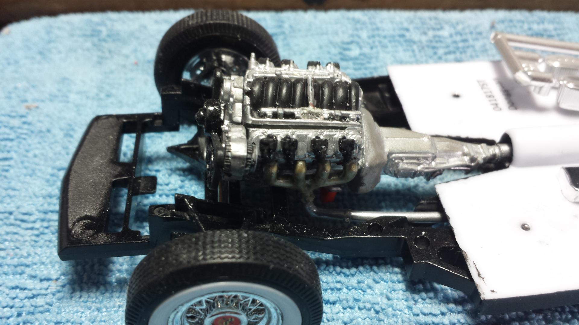

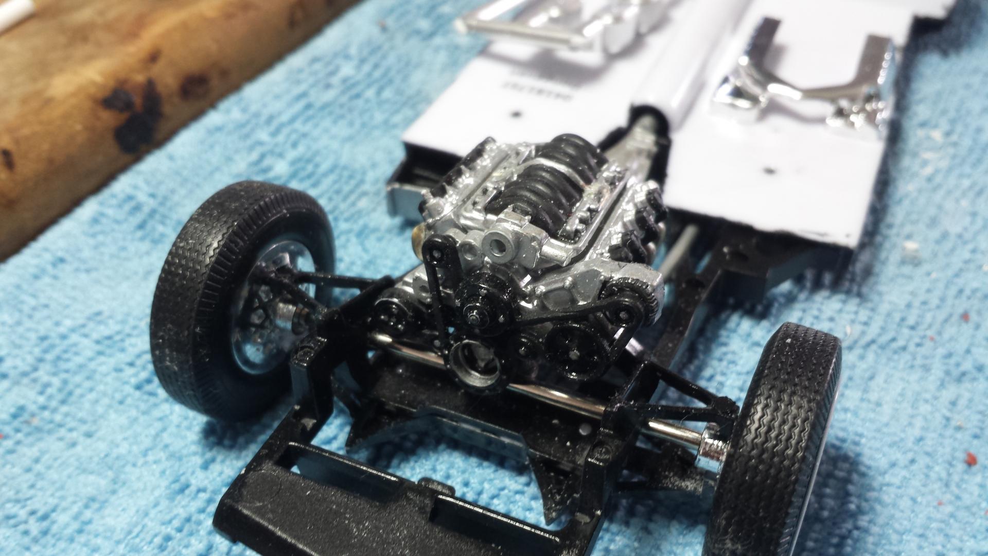

Perspective Customs Posted October 29, 2017 Author Share Posted October 29, 2017 Chassis is done. Revell 99 Corvette LS1 and I'll be using the Caddy STS engine cover. Quote Link to comment Share on other sites More sharing options...
carman1 Posted October 30, 2017 Share Posted October 30, 2017 (edited) I really like where this is going, and really really like those wheels ! Edited October 30, 2017 by carman1 Quote Link to comment Share on other sites More sharing options...
peekay Posted October 30, 2017 Share Posted October 30, 2017 Looking great! If the kit looked more like your conversion I'd have pounced immediately. Quote Link to comment Share on other sites More sharing options...
espo Posted October 30, 2017 Share Posted October 30, 2017 Amazing work on this build. The addition of the Chevy roof really changes this body for the better. I would hope you keep the three piece rear window but the Windshield I think would look better as a one piece. Quote Link to comment Share on other sites More sharing options...

Perspective Customs Posted October 30, 2017 Author Share Posted October 30, 2017 Thanks guys.Amazing work on this build. The addition of the Chevy roof really changes this body for the better. I would hope you keep the three piece rear window but the Windshield I think would look better as a one piece.I'm planning on keeping the three piece rear window and the two piece up front. The Caddy didn't go to a one piece windshield until 1950 and I want to keep this as close to a '48 as possible. Quote Link to comment Share on other sites More sharing options...

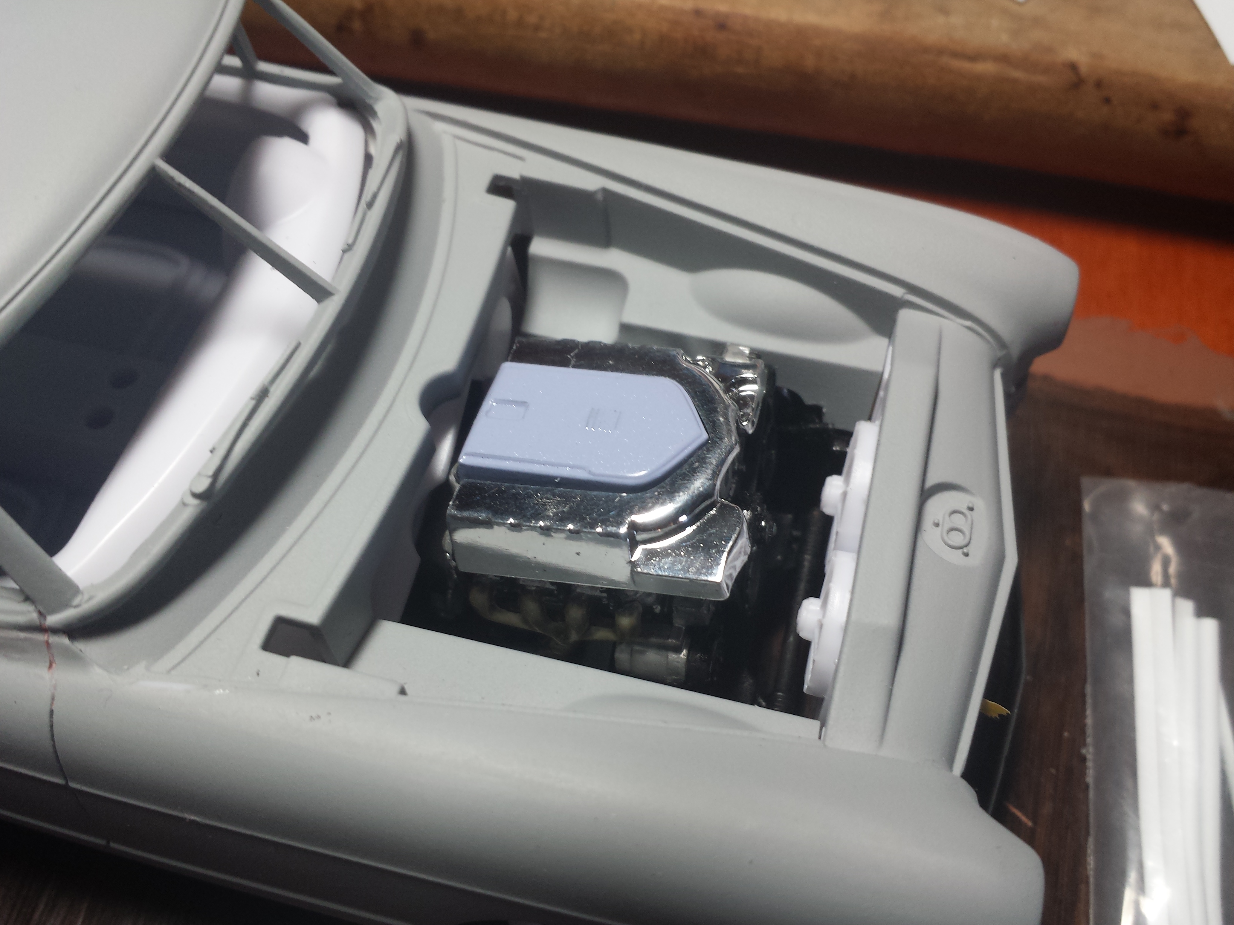

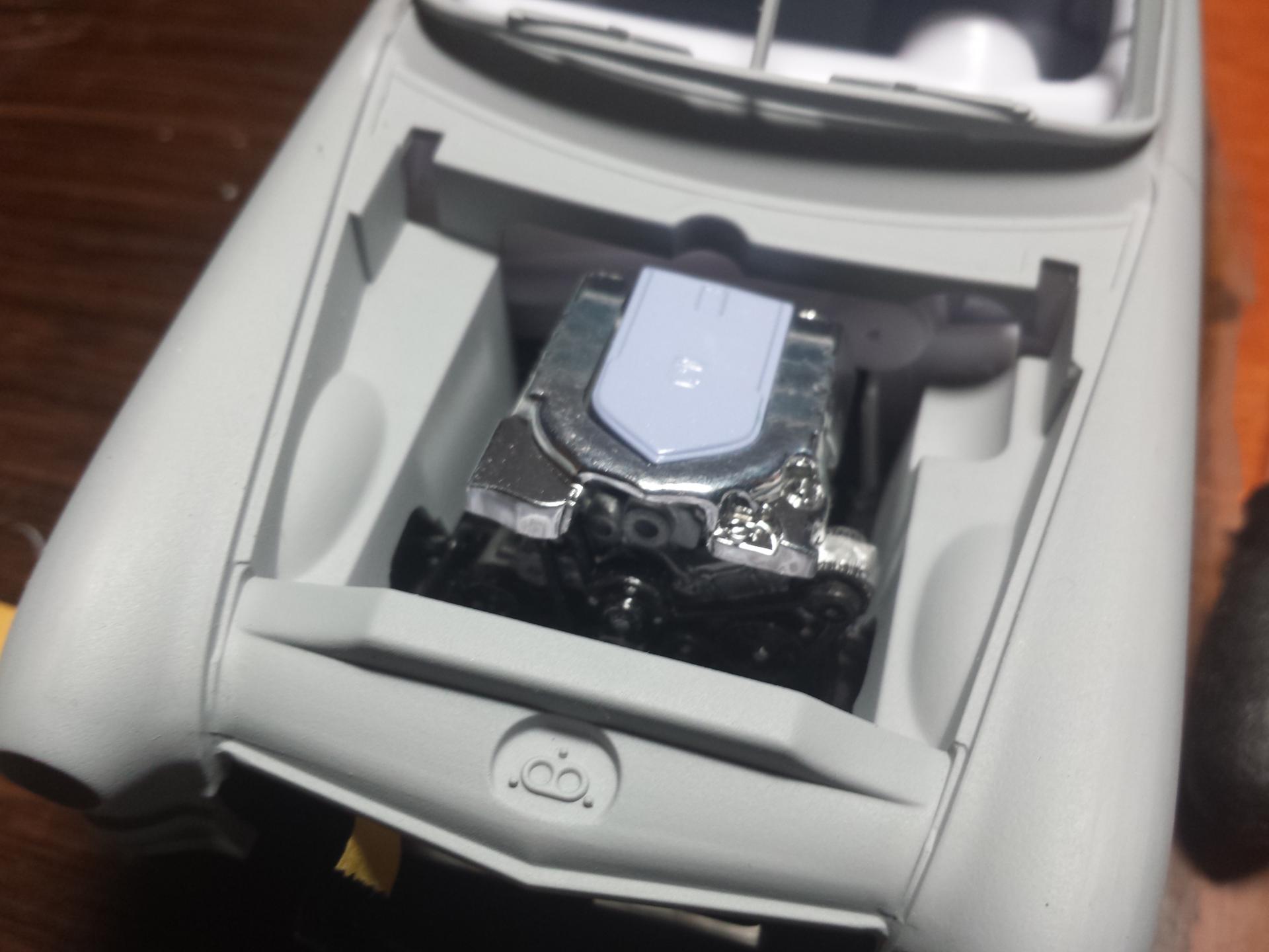

Perspective Customs Posted November 3, 2017 Author Share Posted November 3, 2017 (edited) The STS-V engine cover in place. Edited November 3, 2017 by Perspective Customs Quote Link to comment Share on other sites More sharing options...

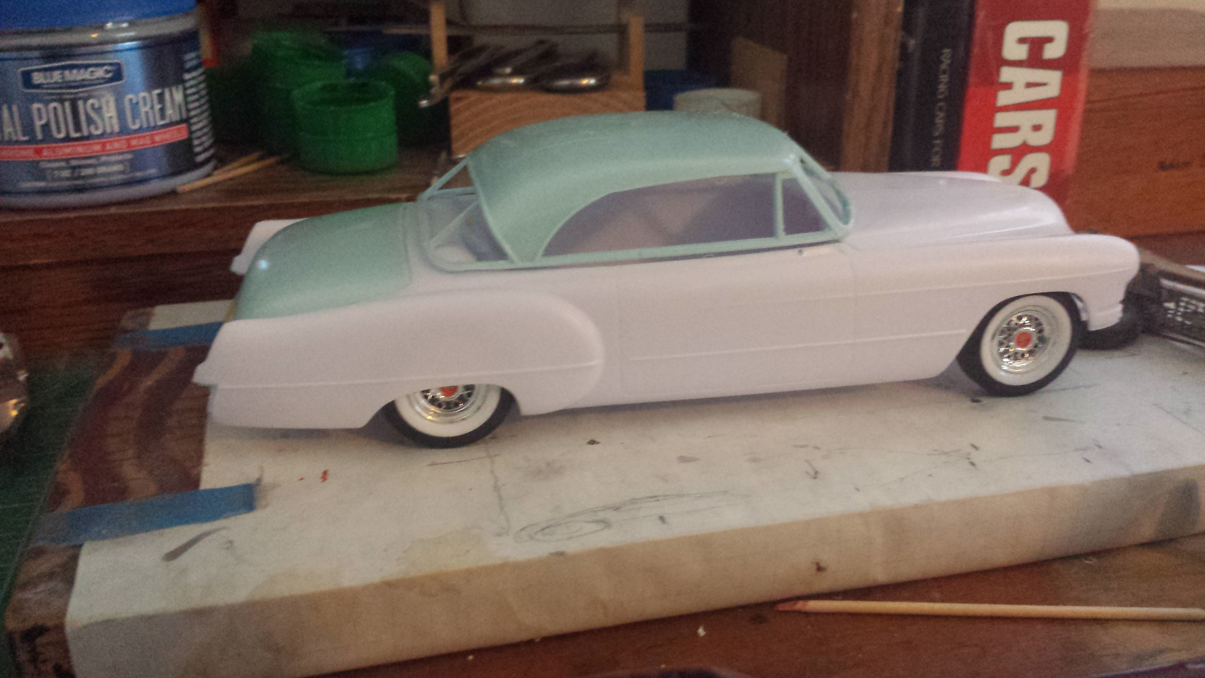

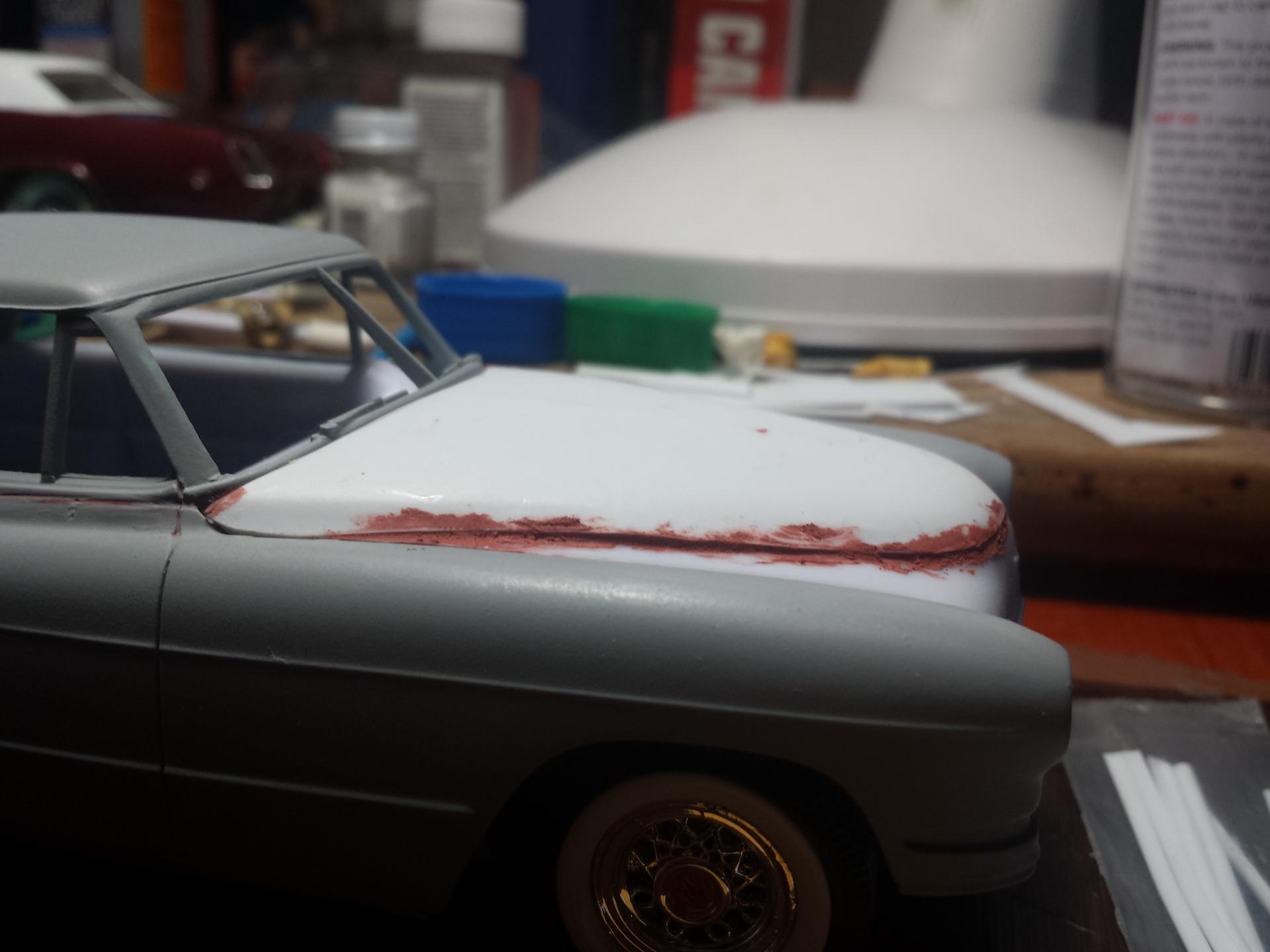

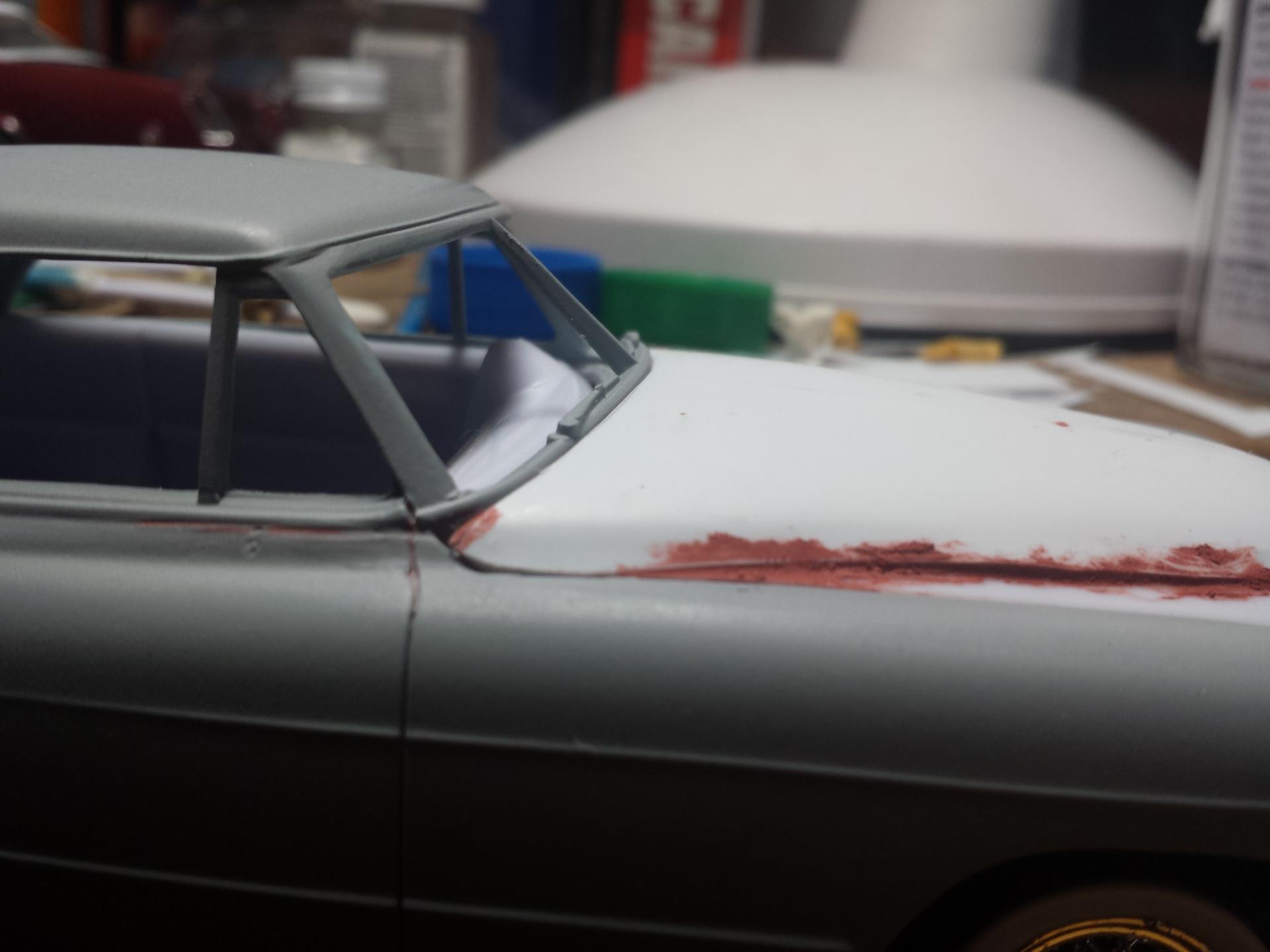

Perspective Customs Posted November 3, 2017 Author Share Posted November 3, 2017 Making progress on the hood. I tried to vacuum form a hood which didn't work out too well after several attempts. I cut one down and glued it over the kit hood to get the curve to match the windshield. Quote Link to comment Share on other sites More sharing options...
Rob Hall Posted November 3, 2017 Share Posted November 3, 2017 (edited) Looking good...like the hardtop body style of the '48-49. I think if I were to 'de-Foose' one of these, the main change I'd be interested in is adding the fins..the soft curved fins w/ taillights in them were the most distinctive styling detail of the '48-49 Cadillac, and the Foose car mostly eliminated them... Edited November 3, 2017 by Rob Hall Quote Link to comment Share on other sites More sharing options...

Perspective Customs Posted November 4, 2017 Author Share Posted November 4, 2017 Looking good...like the hardtop body style of the '48-49. I think if I were to 'de-Foose' one of these, the main change I'd be interested in is adding the fins..the soft curved fins w/ taillights in them were the most distinctive styling detail of the '48-49 Cadillac, and the Foose car mostly eliminated them...I agree completely but I couldn't figure out the best way to scratch build the taillight fins. I do have another body and a die cast '51 Caddy that I'll use to sort it all out for another build. This project is way cool, cant wait till it completed. What are you using for the interior?I think I'll use the kit interior on this one just to conserve time. Quote Link to comment Share on other sites More sharing options...

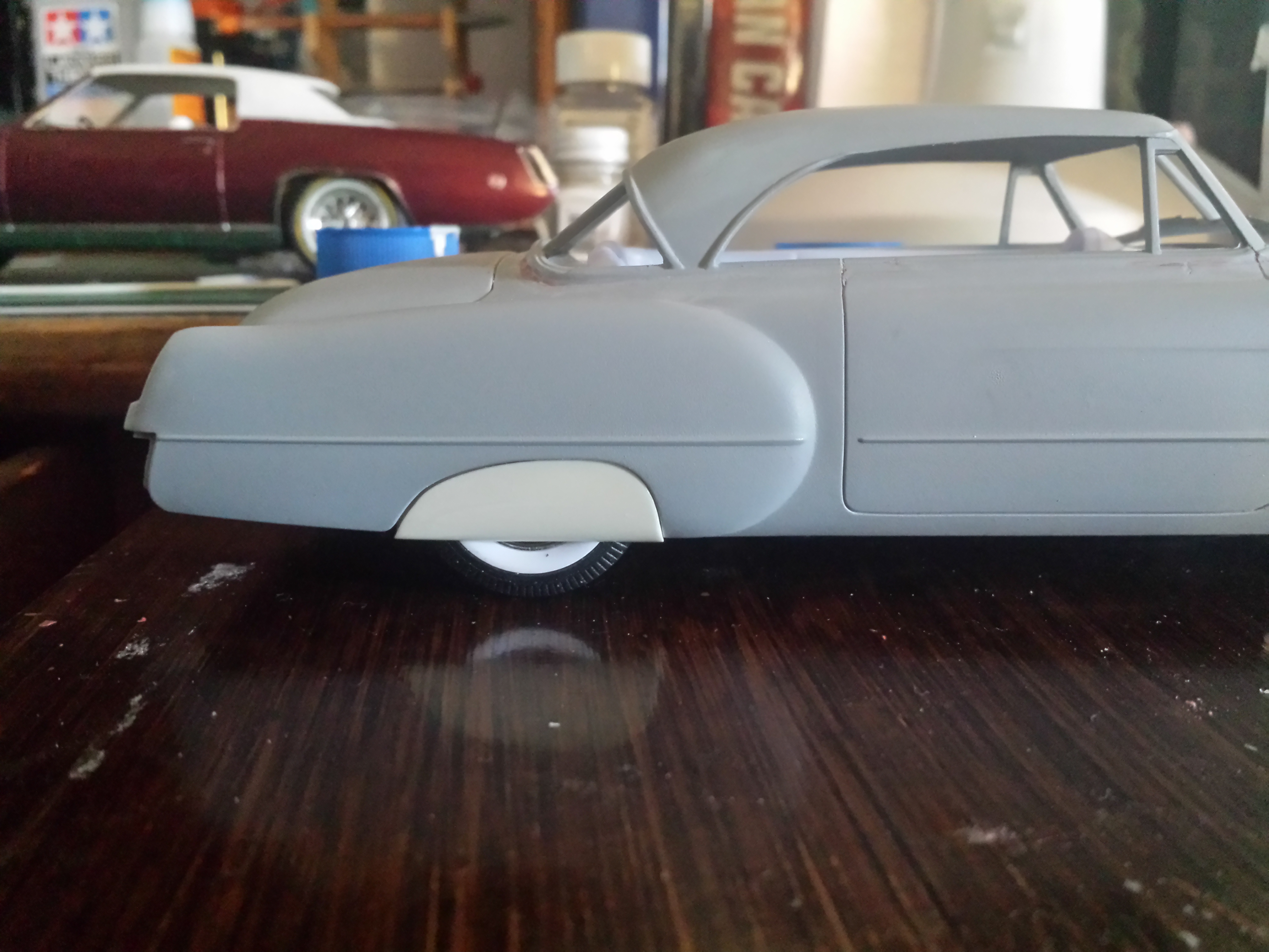

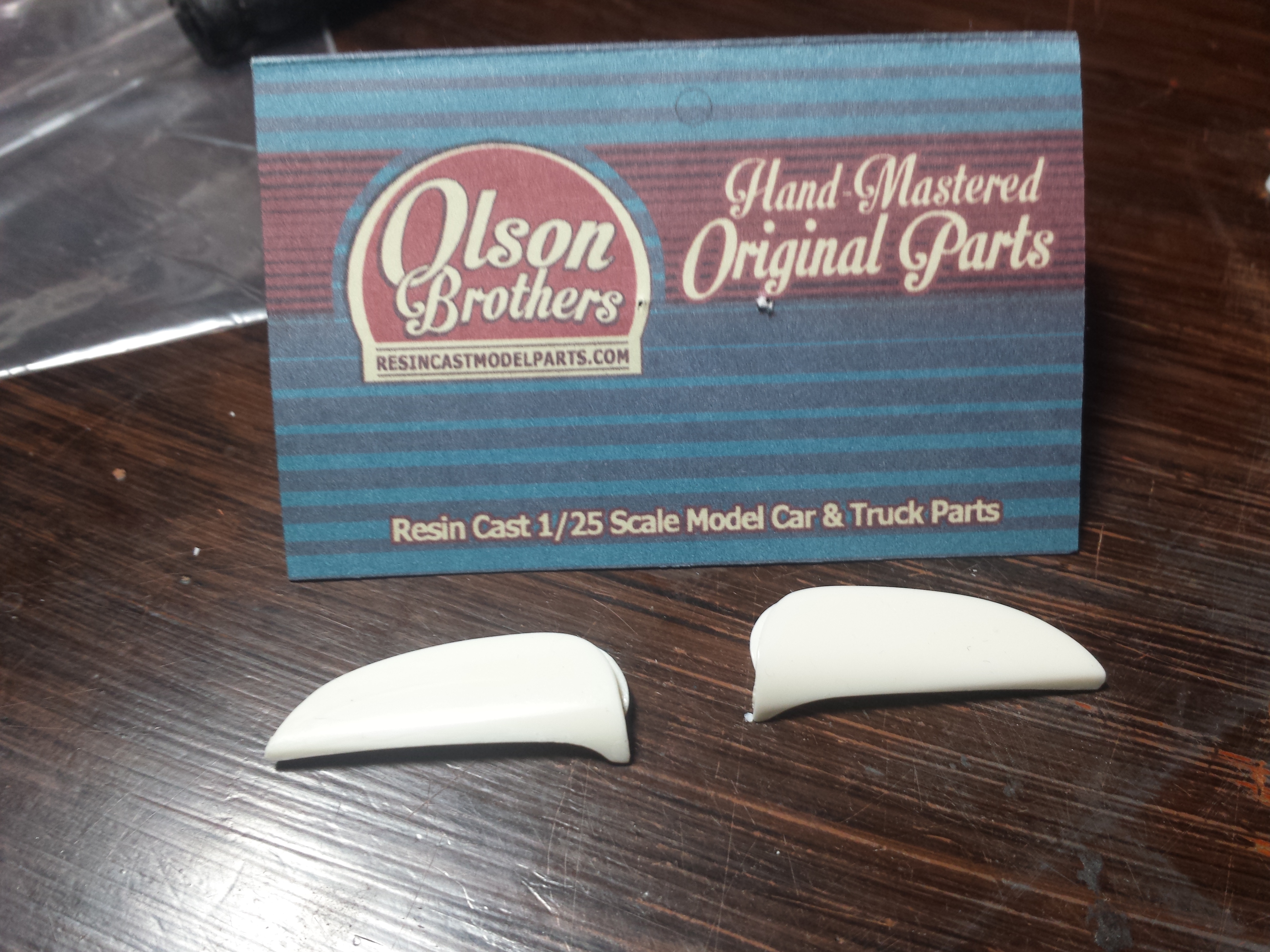

Perspective Customs Posted November 4, 2017 Author Share Posted November 4, 2017 I found these Olson Brothers resin fender skirts on ebay made specifically for the Foose Caddy. The casting is very clean and the fit is nearly perfect. These guys also make a bunch of cool parts for the Revell Bronco. Quote Link to comment Share on other sites More sharing options...
