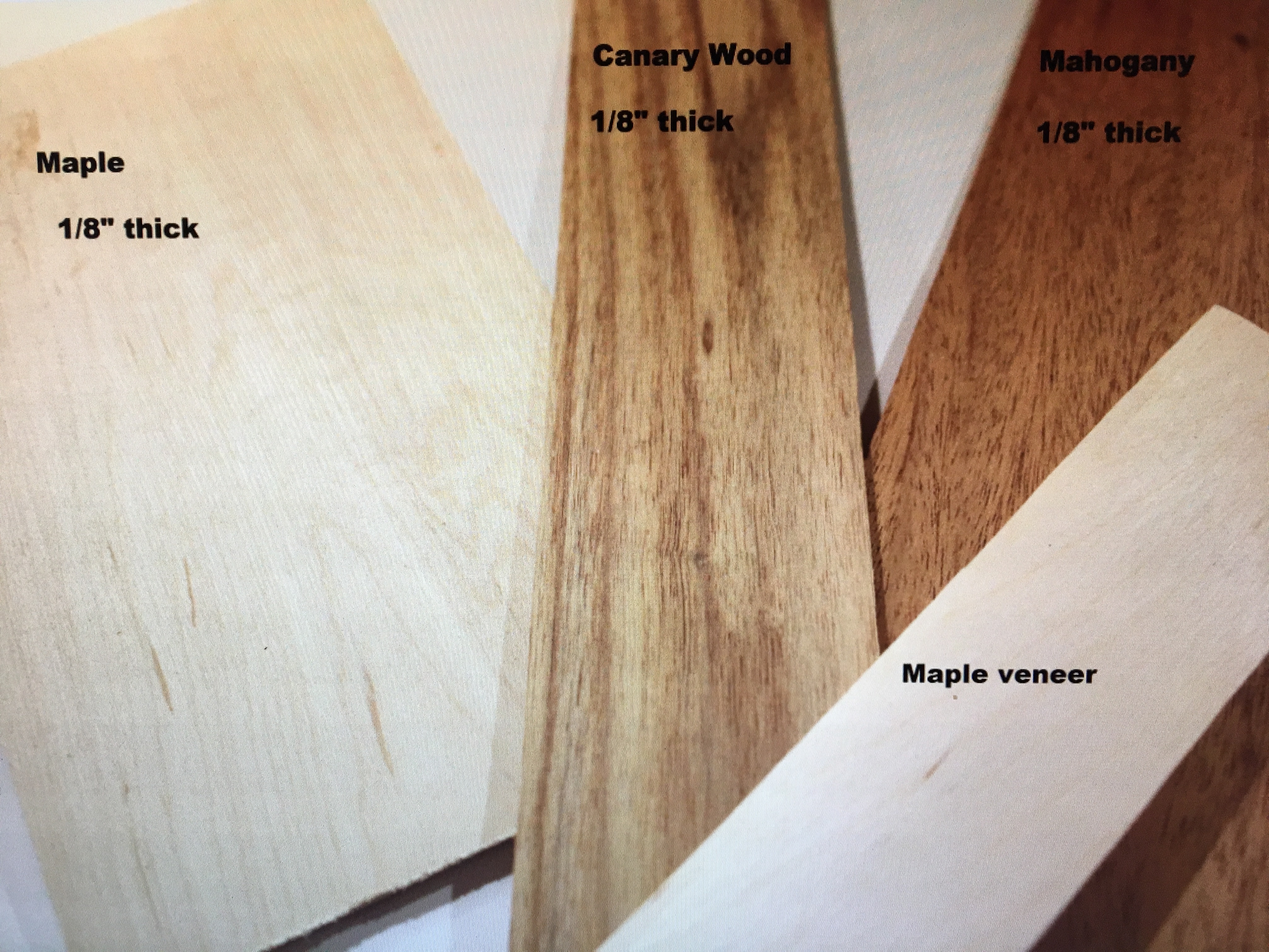

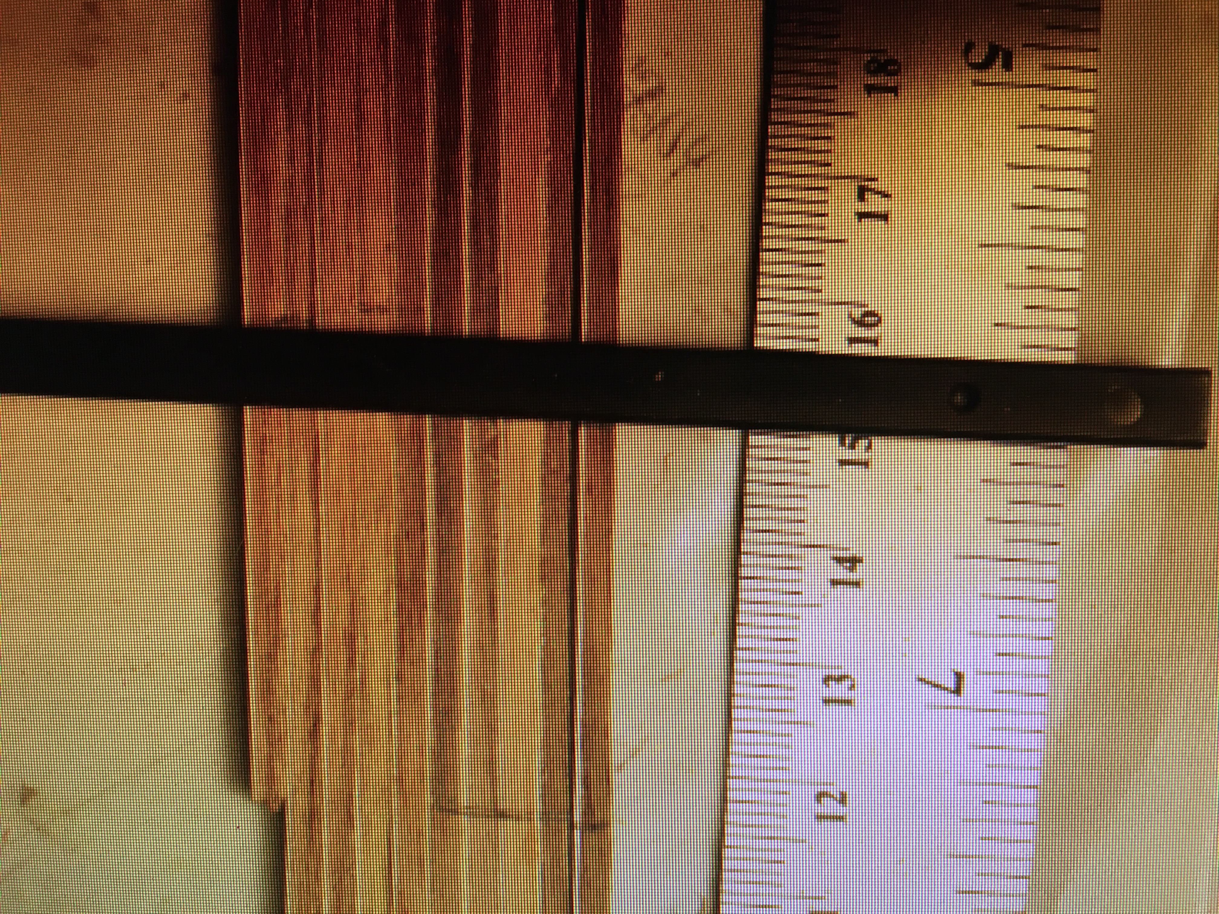

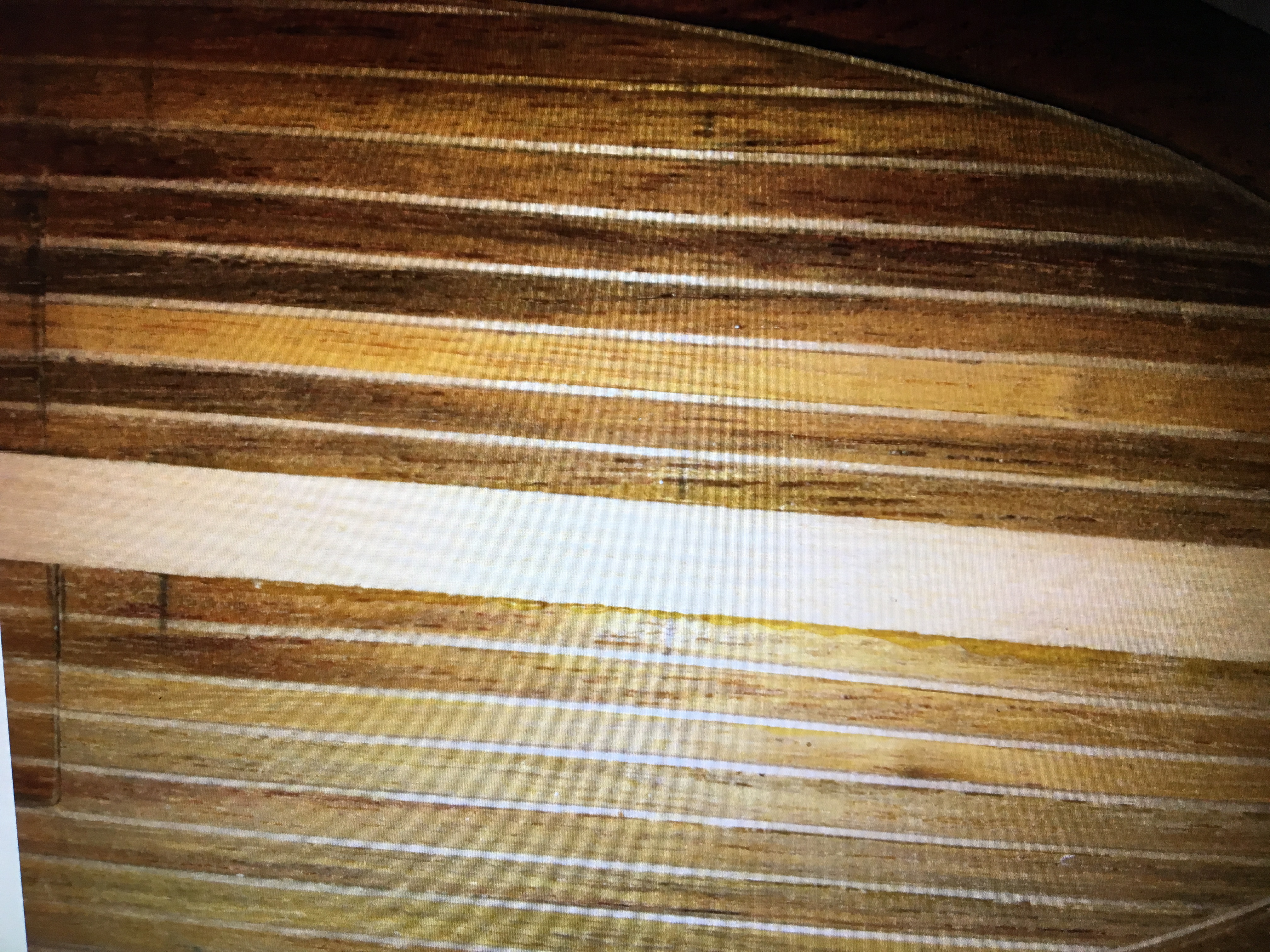

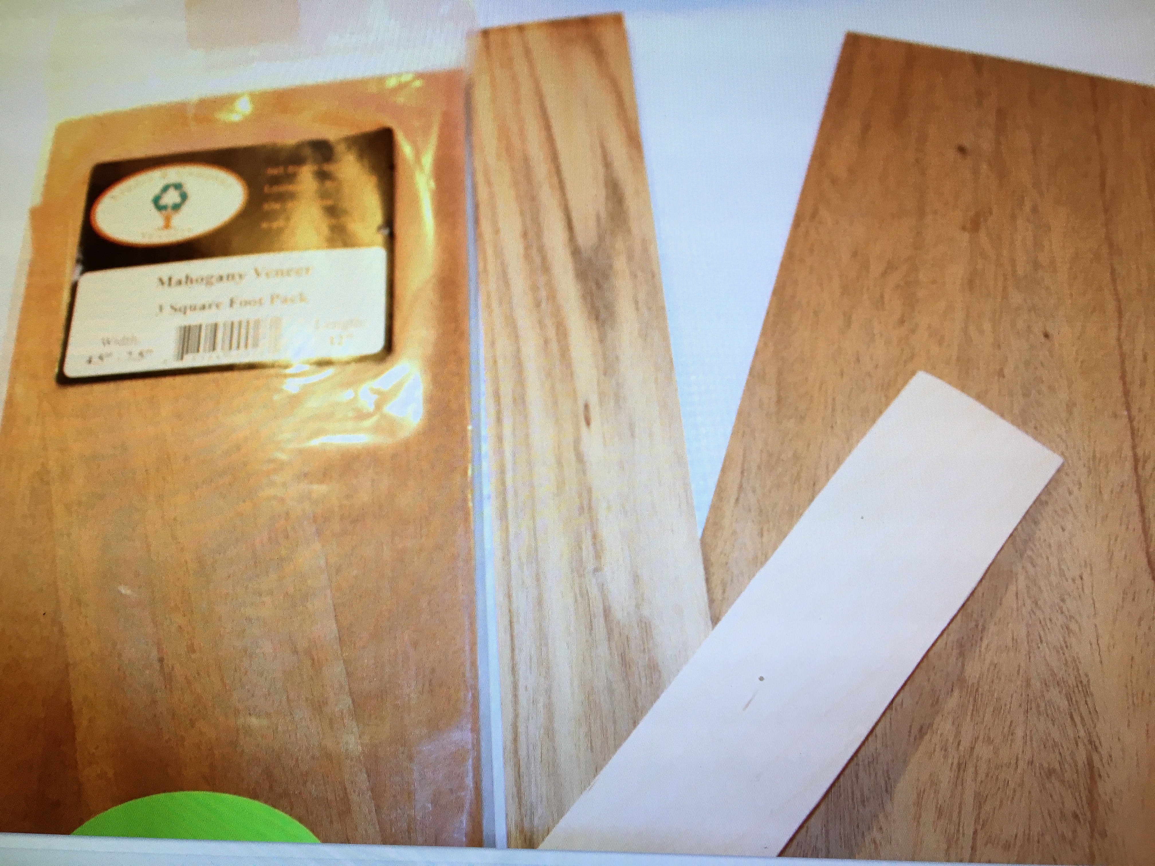

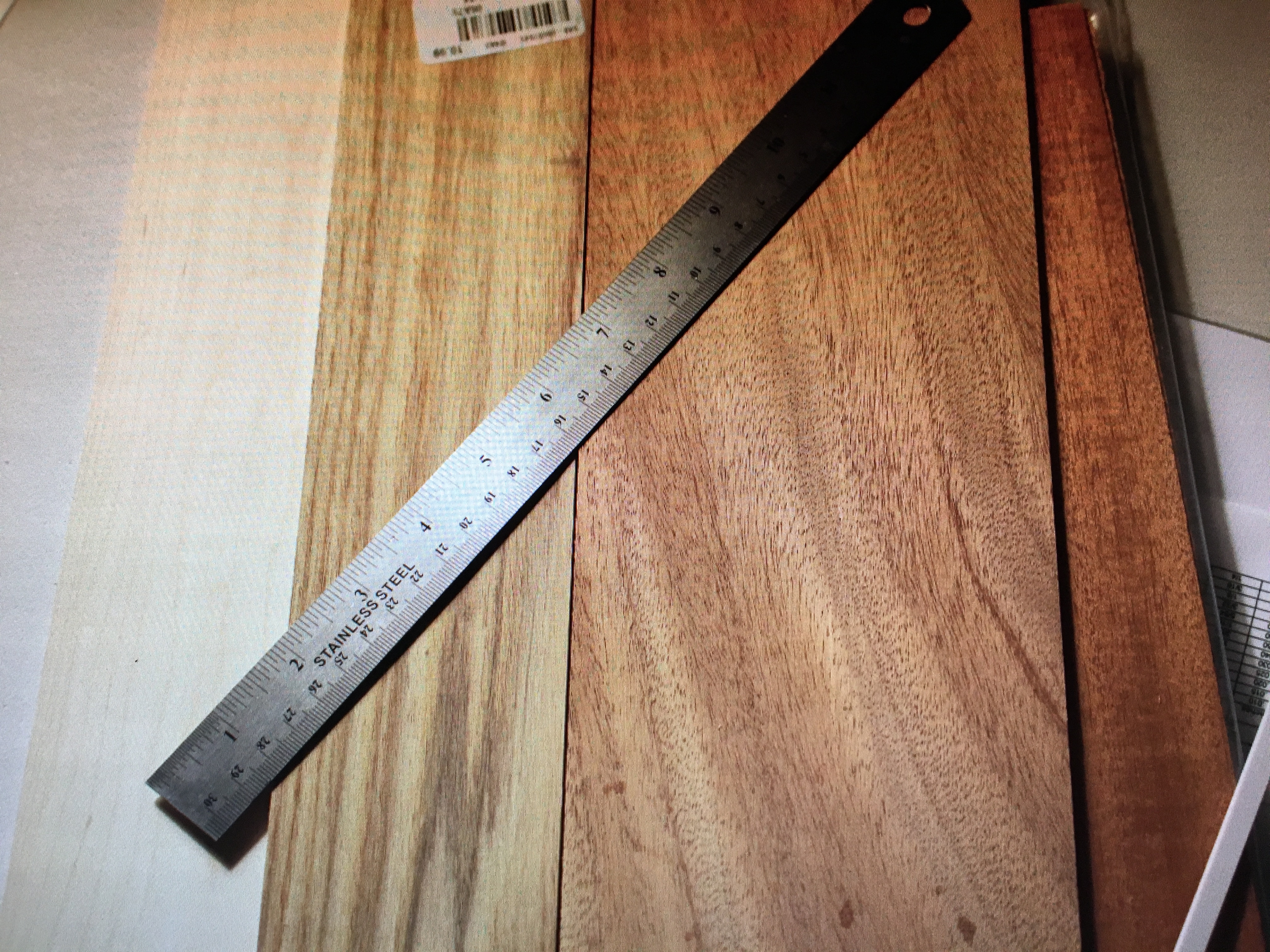

Mercuryman54 Posted October 24, 2017 Author Share Posted October 24, 2017 Here are the woods I used building the AMT boat. The deck consists of 3 types of wood. Perimeter is 1/8” Mahogany. The center strip is Maple. The “ boards” are Canary Wood with iron on Maple veneer strips between the Canary Wood “boards”. Thanks for looking. Dennis Quote Link to comment Share on other sites More sharing options...

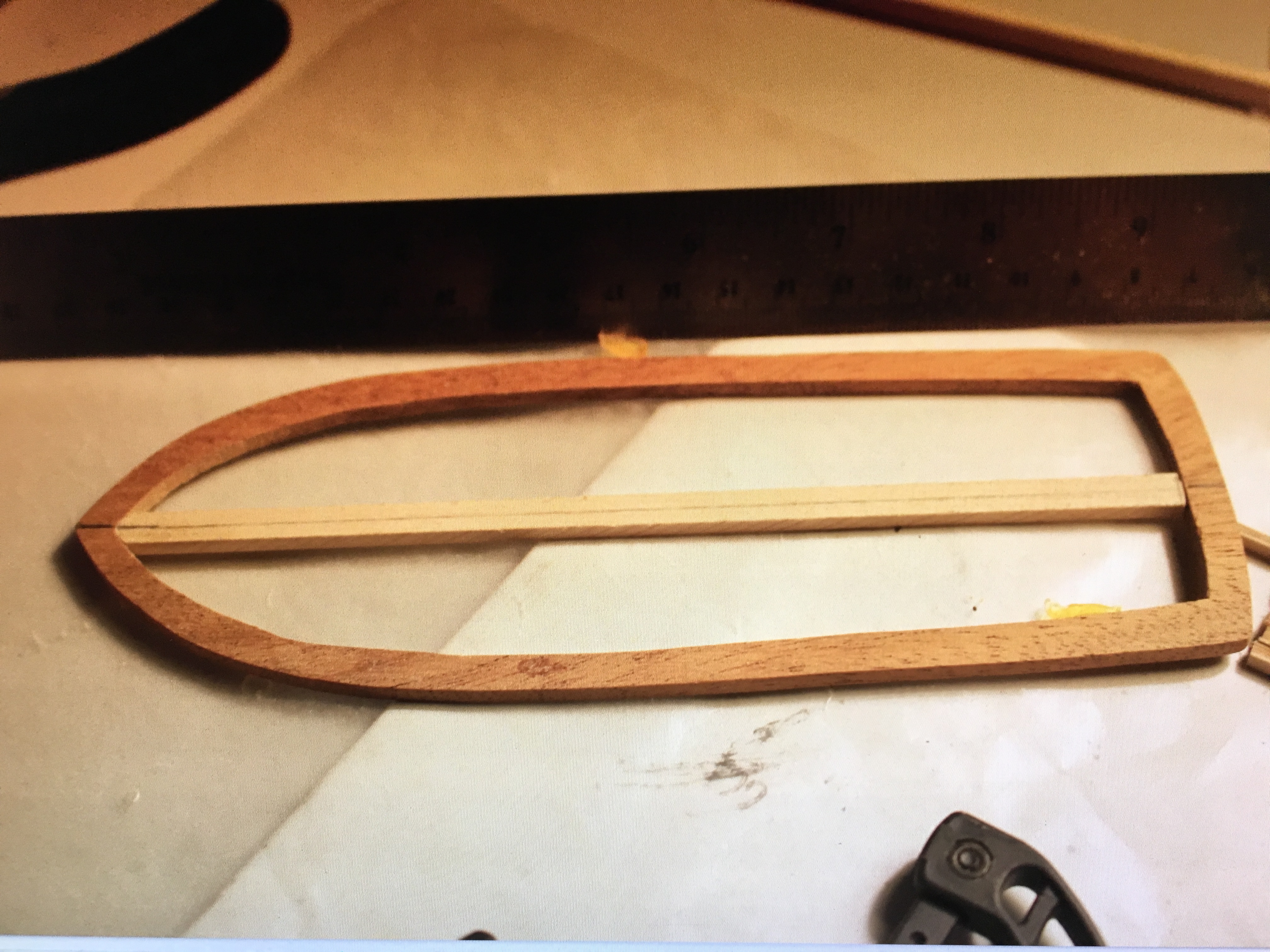

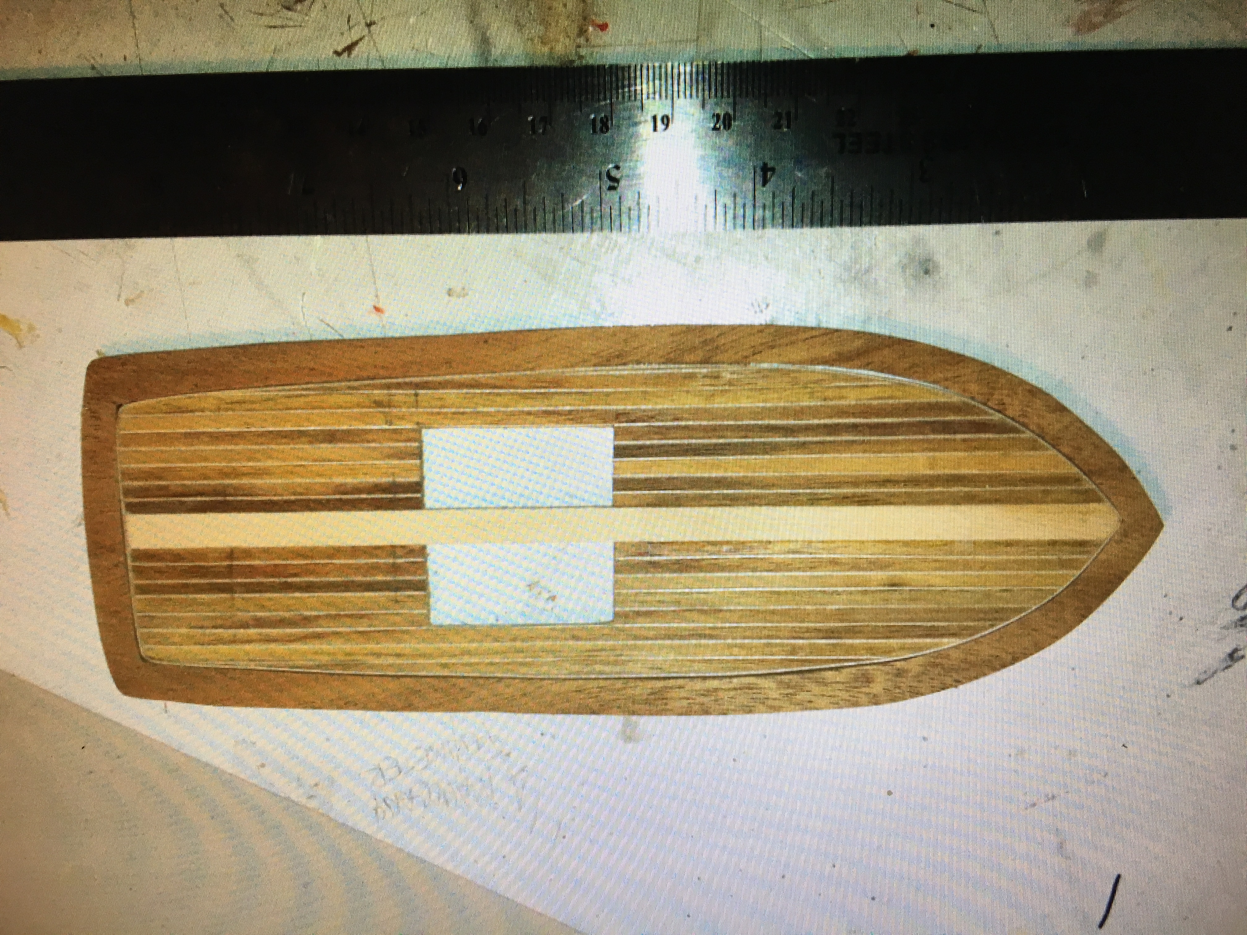

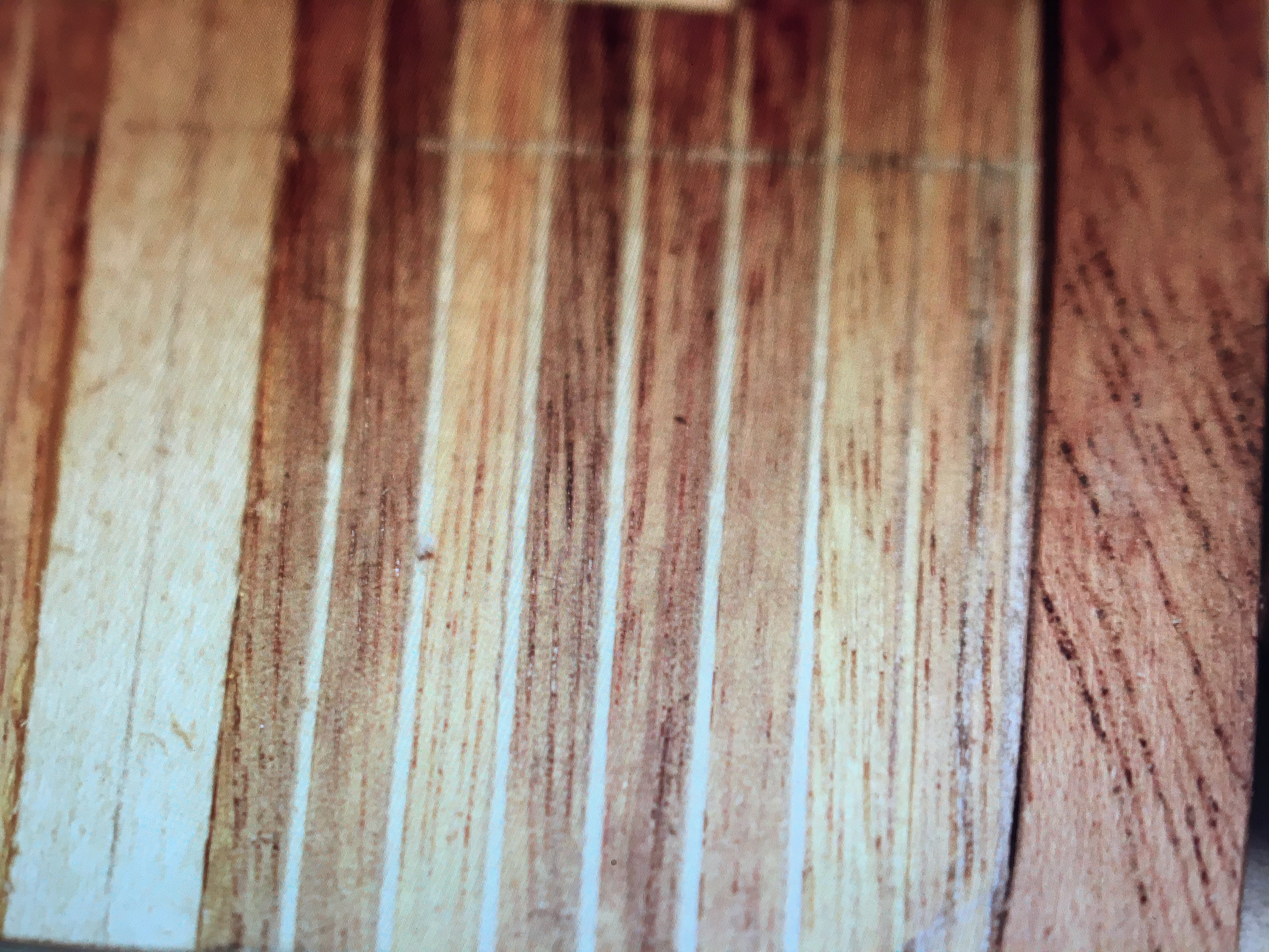

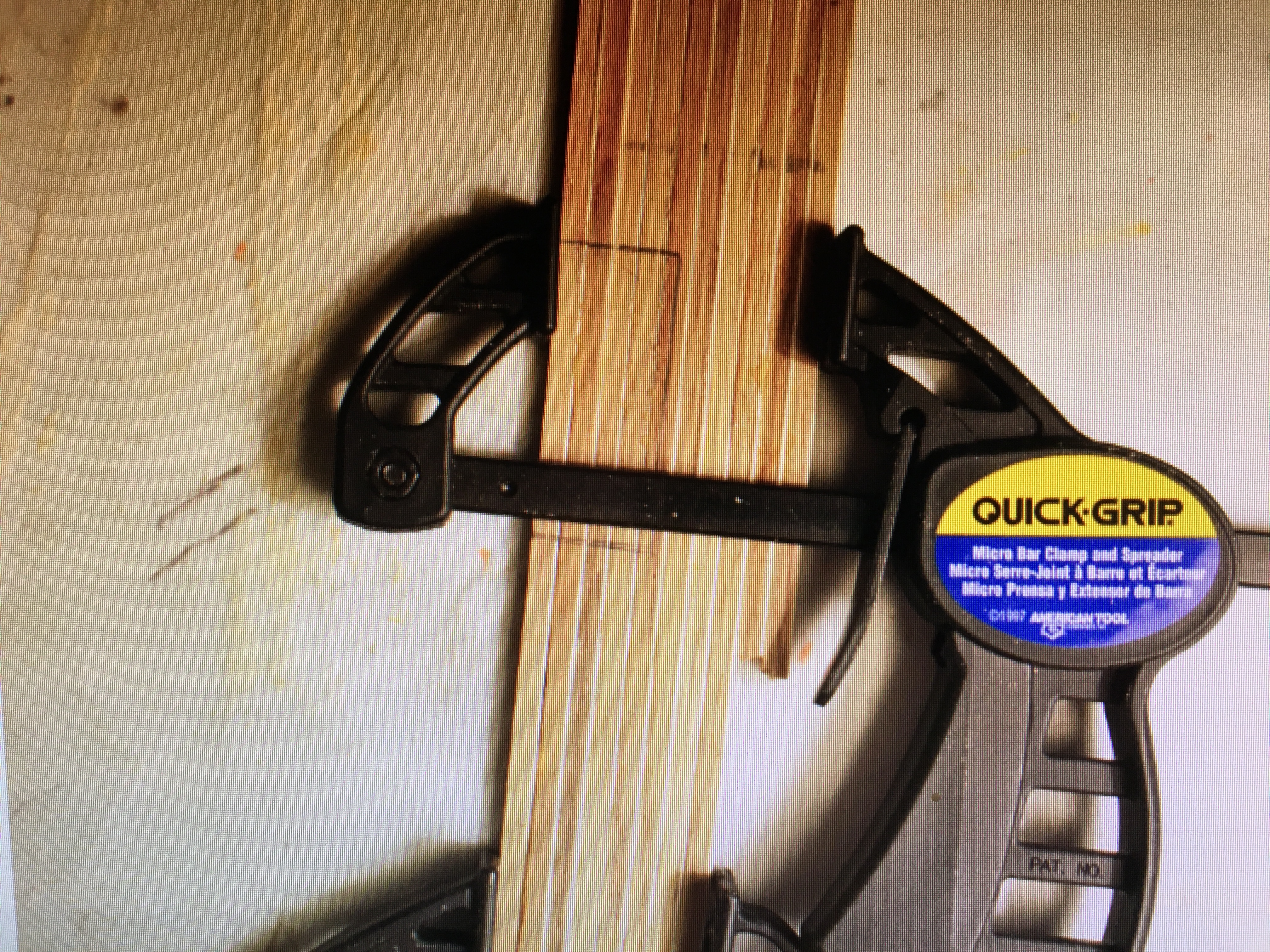

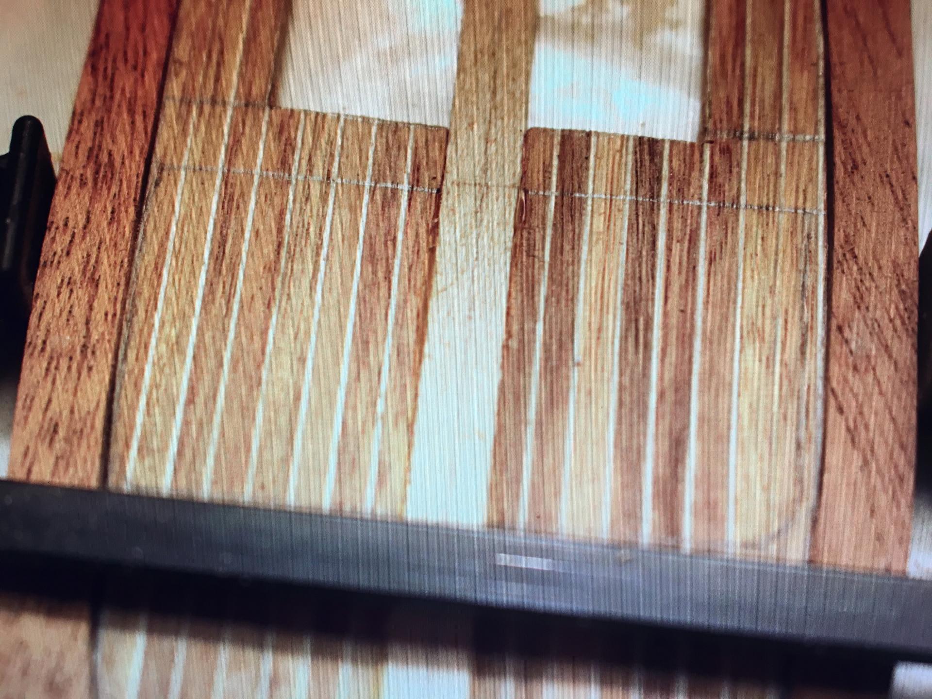

Mercuryman54 Posted October 24, 2017 Author Share Posted October 24, 2017 I set up a fence on my band saw and cut strips of the Canary Wood. Each strip of Canary Wood got a strip of heat activated iron on Maple veneer. Then they were glued together to make up the blanks to go in the perimeter of Mahogany on each side of the center Maple strip.Dennis Quote Link to comment Share on other sites More sharing options...

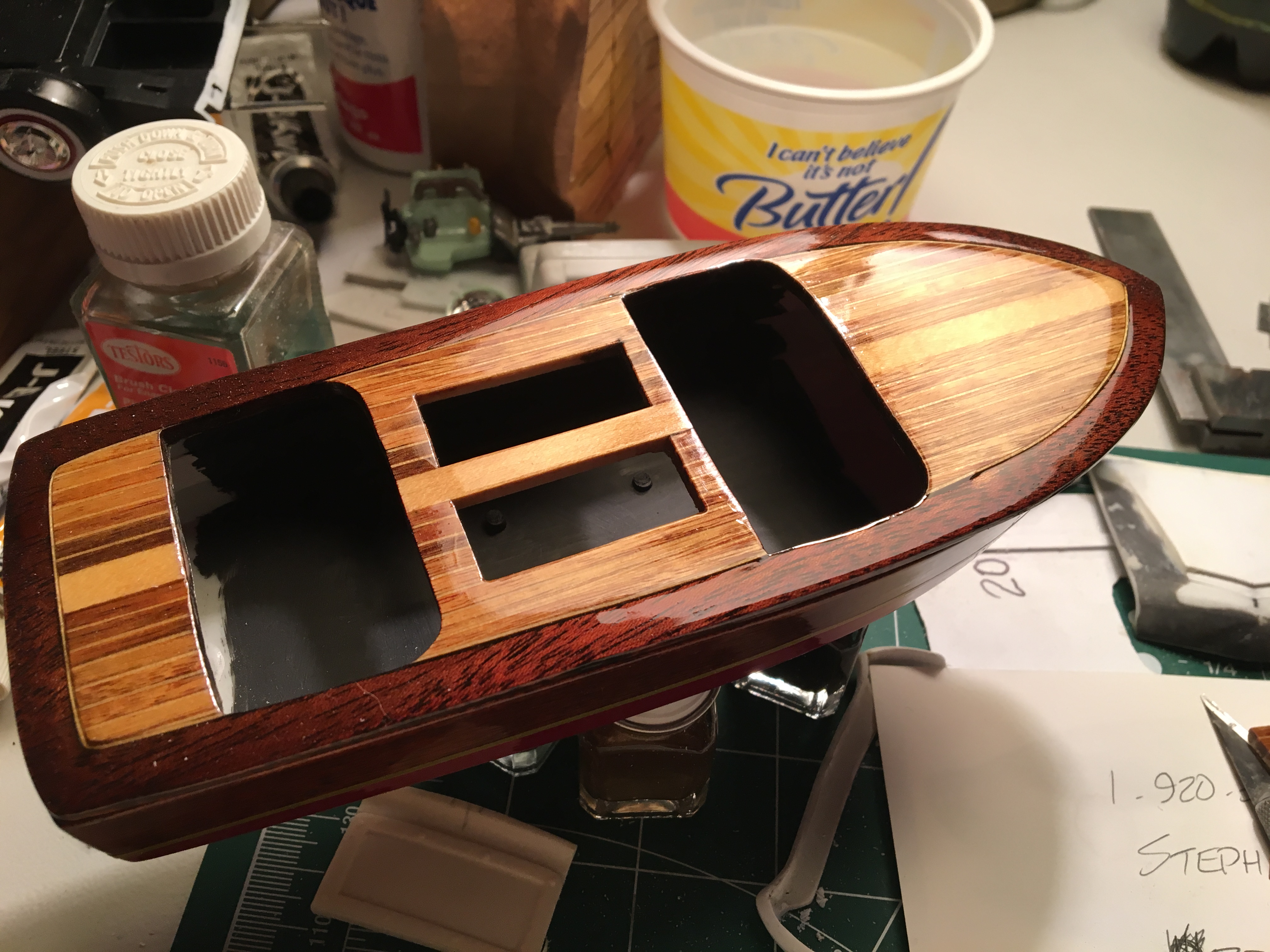

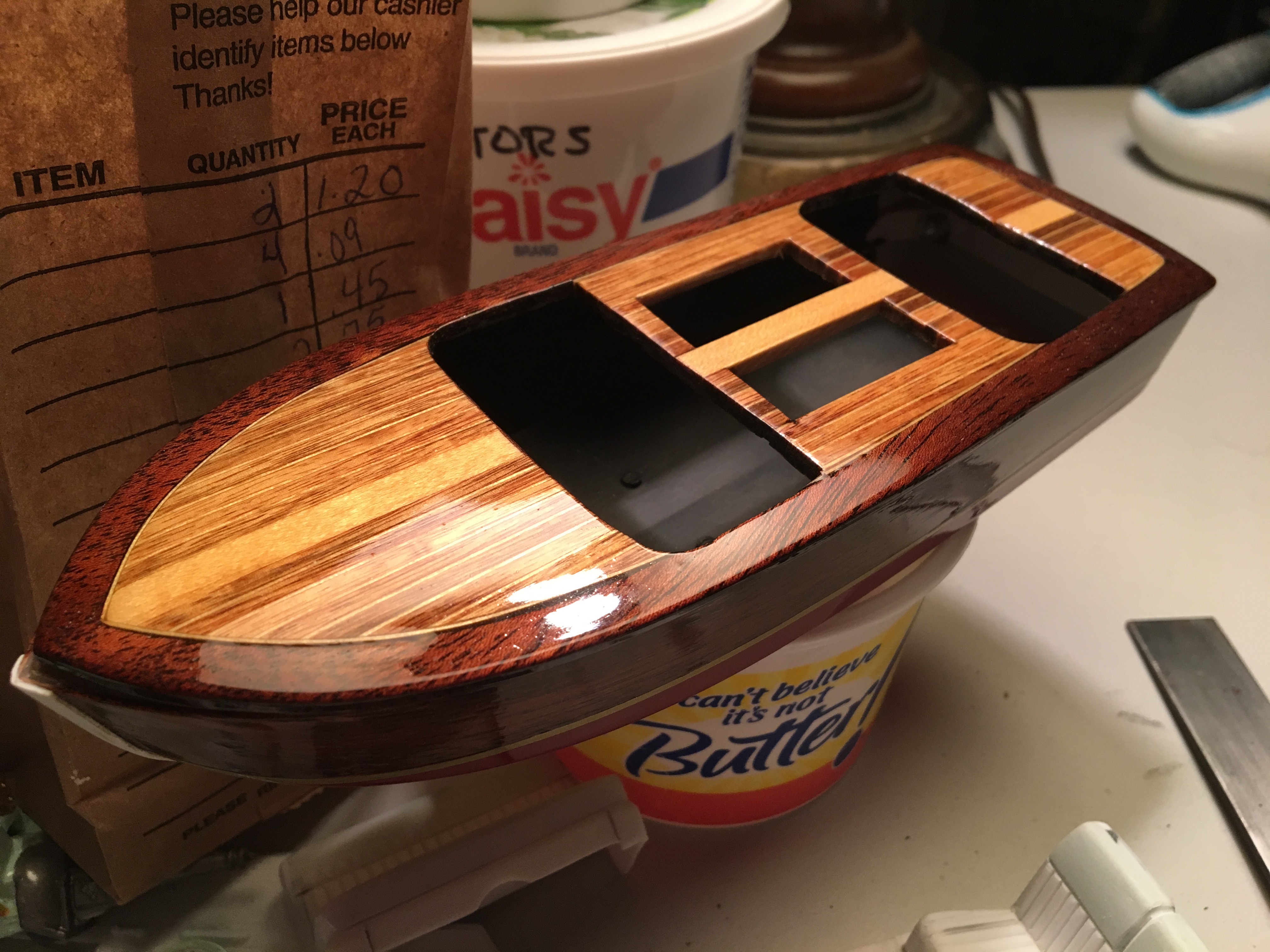

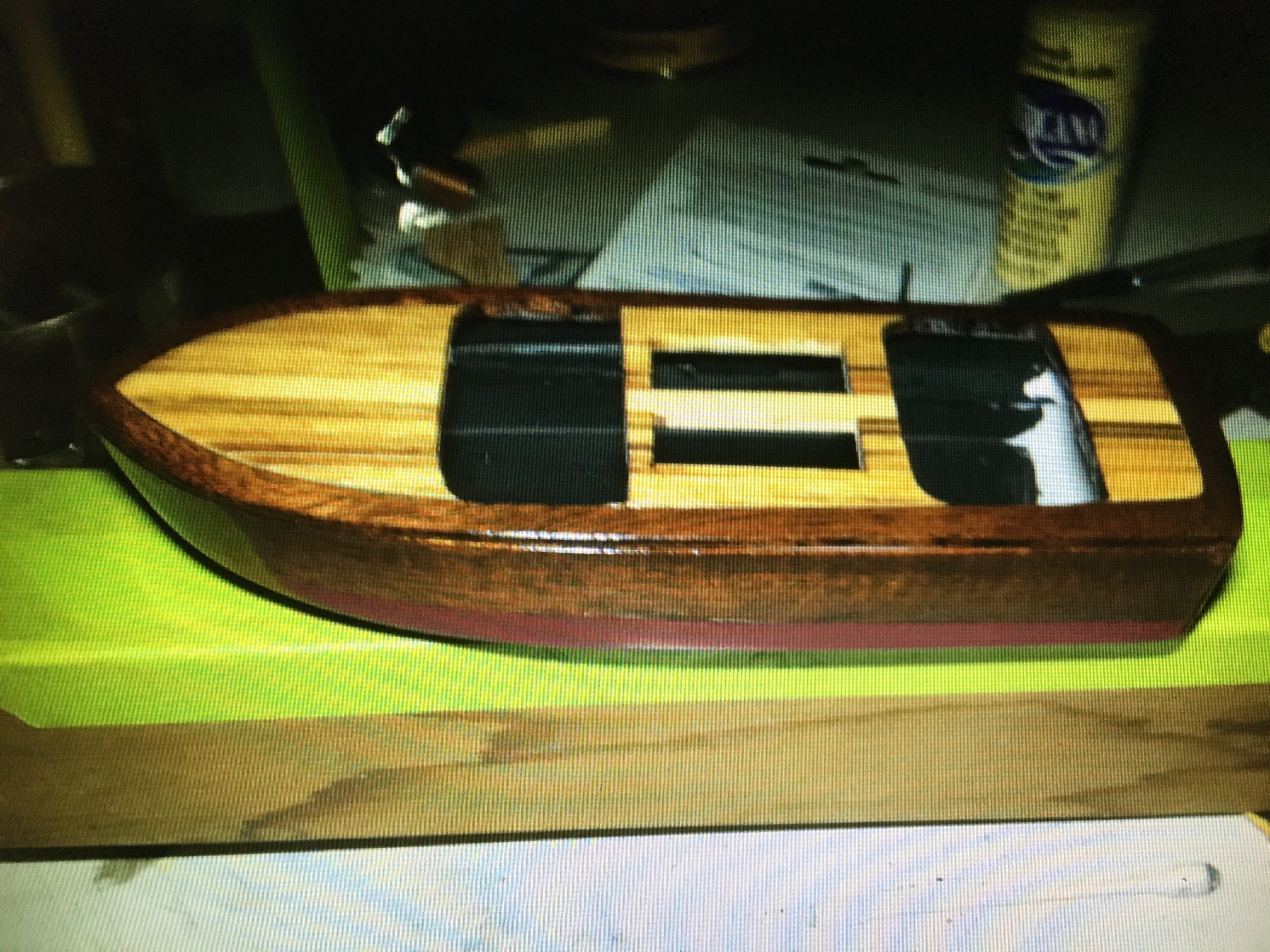

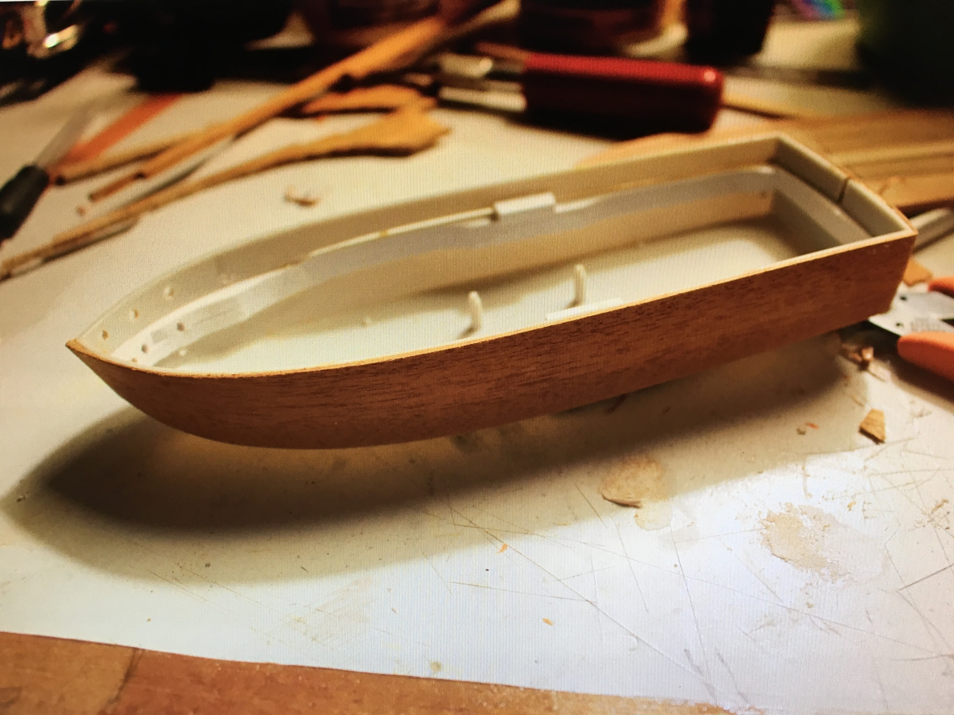

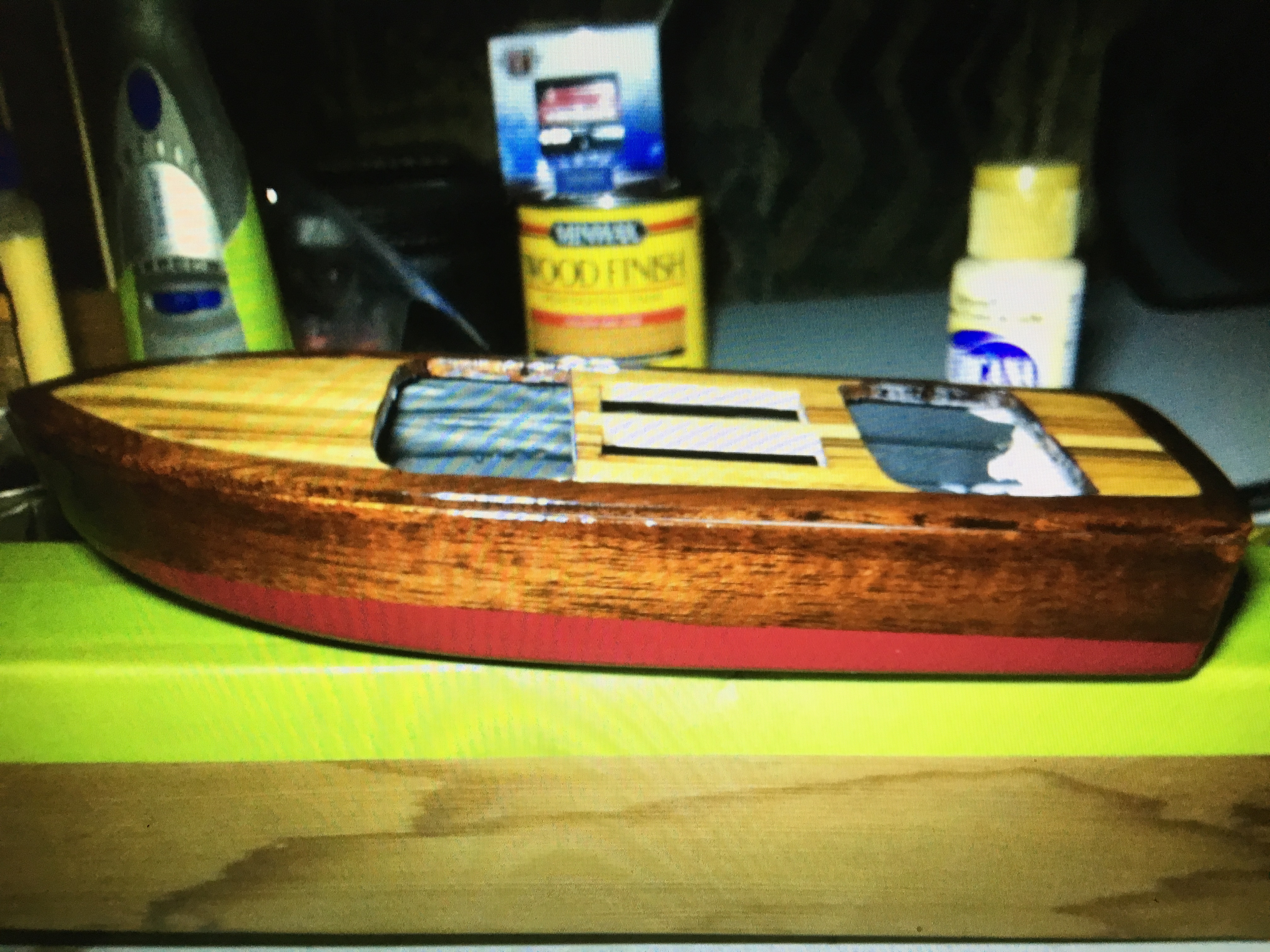

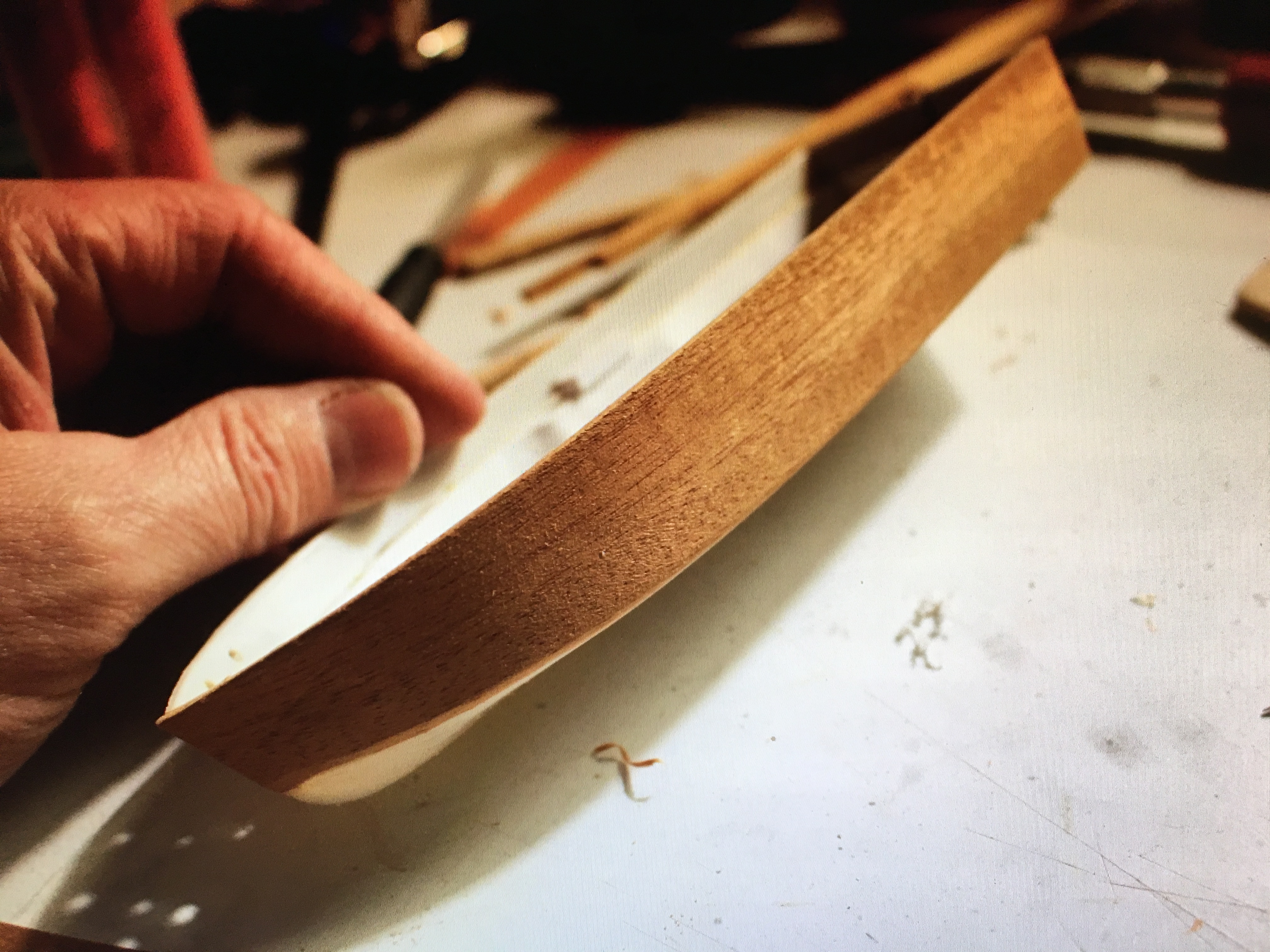

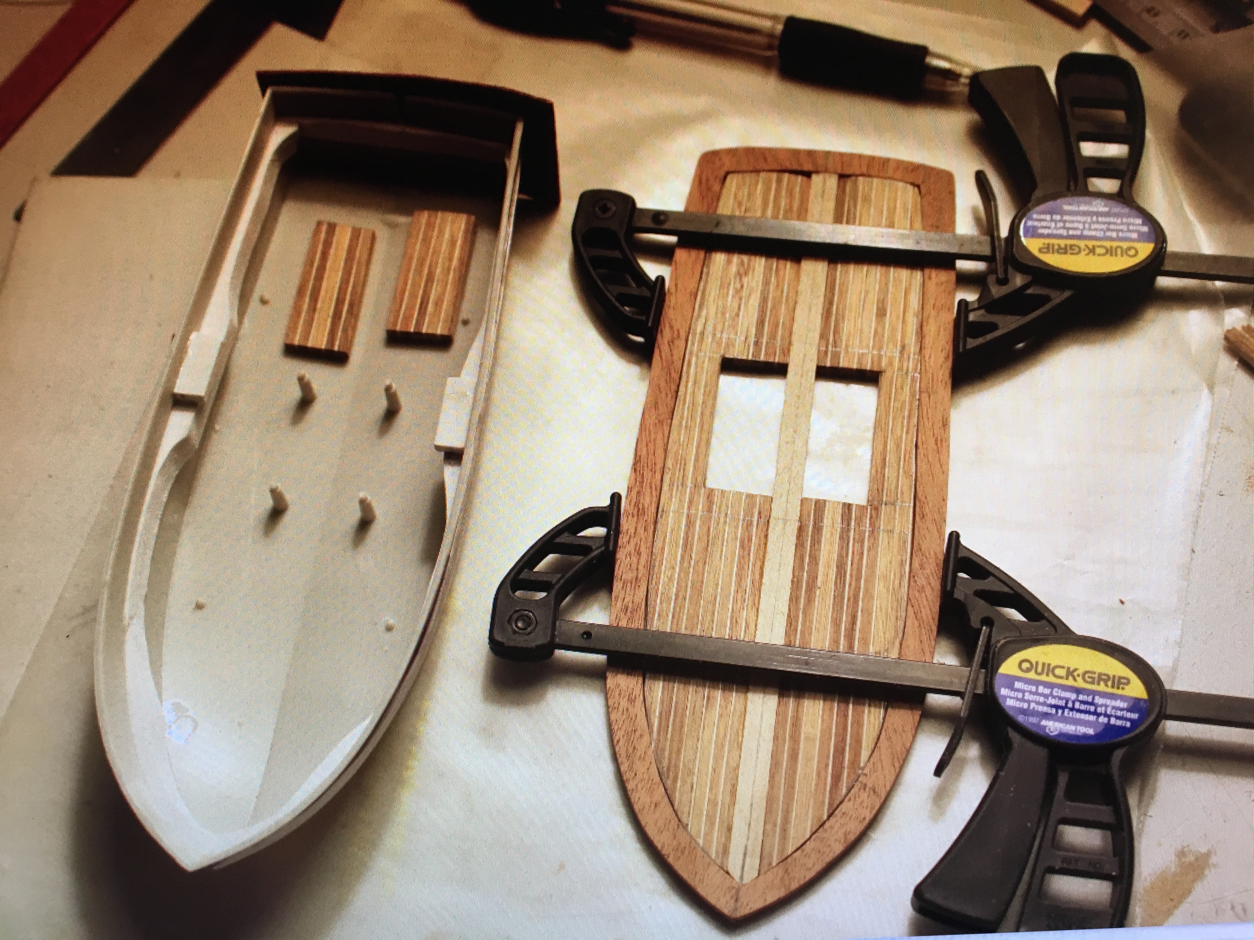

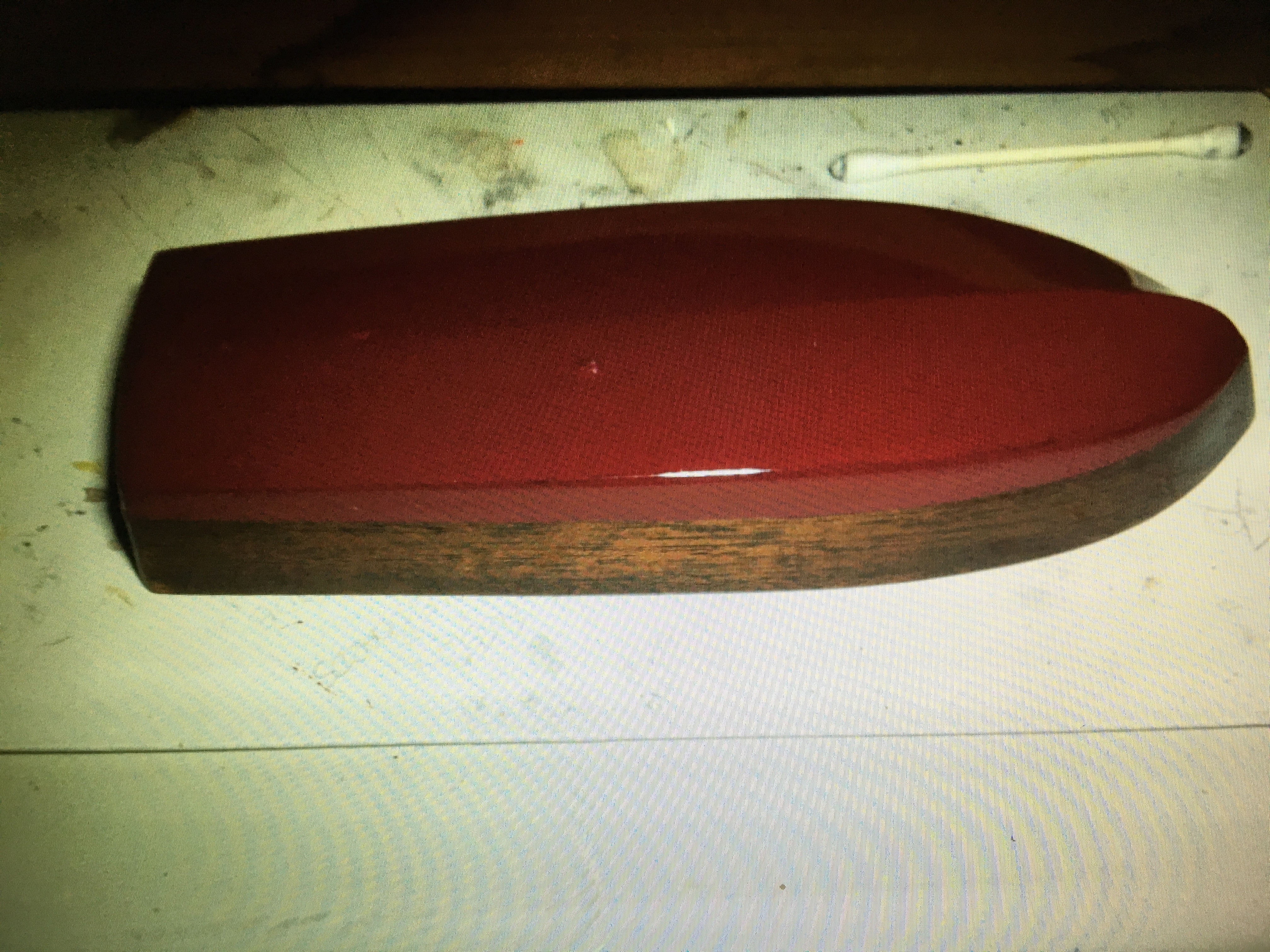

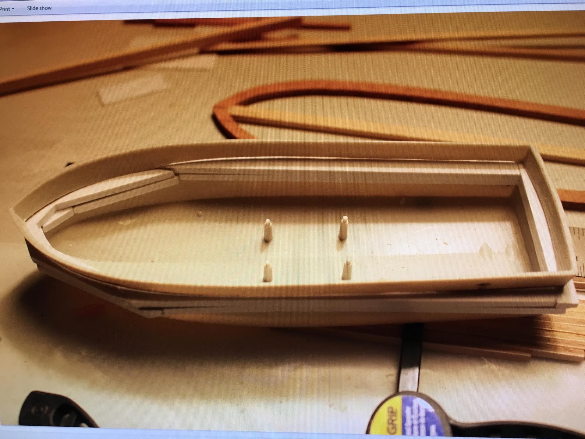

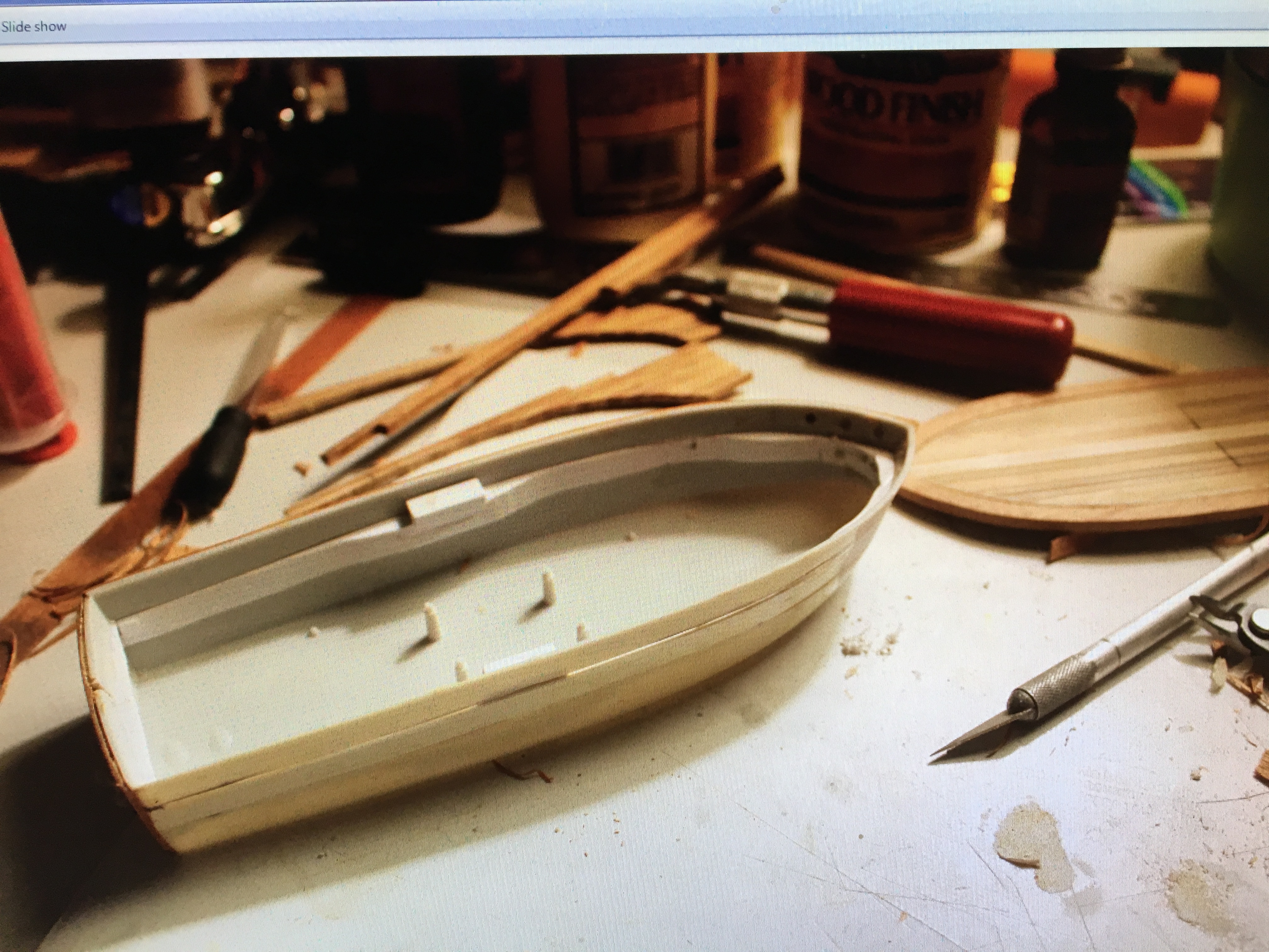

Mercuryman54 Posted October 24, 2017 Author Share Posted October 24, 2017 Here’s a few pictures of the construction of the deck. The hull of the boat looked too shallow to me. I added 1/4” to the depth of the boats hull and wrapped it in Mahogany veneer. Dennis Quote Link to comment Share on other sites More sharing options...

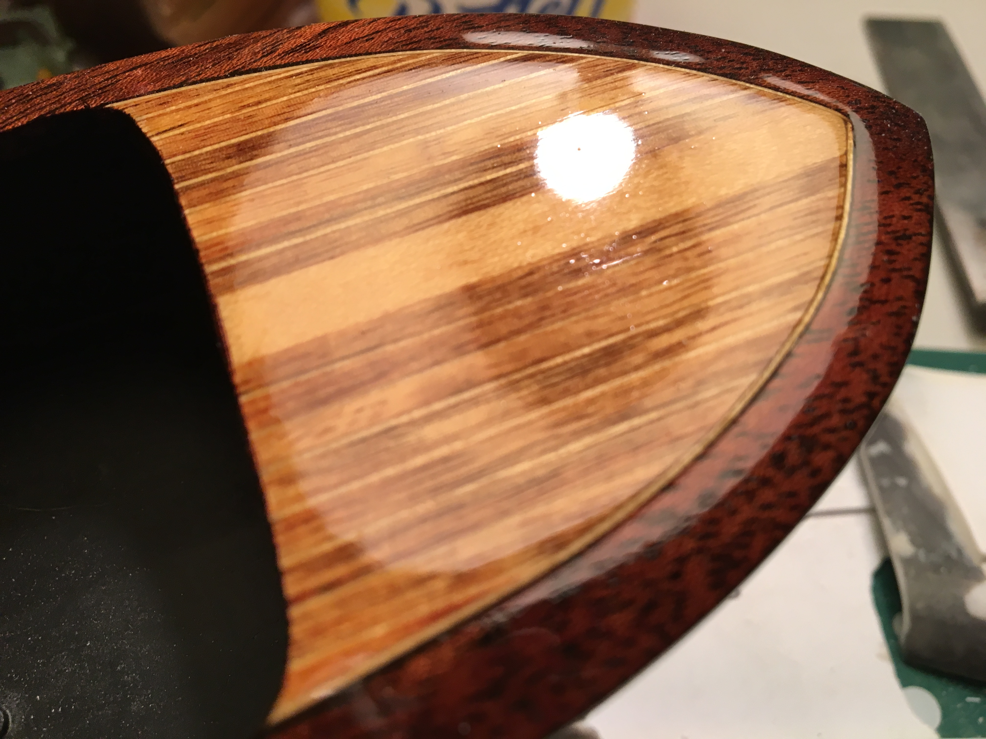

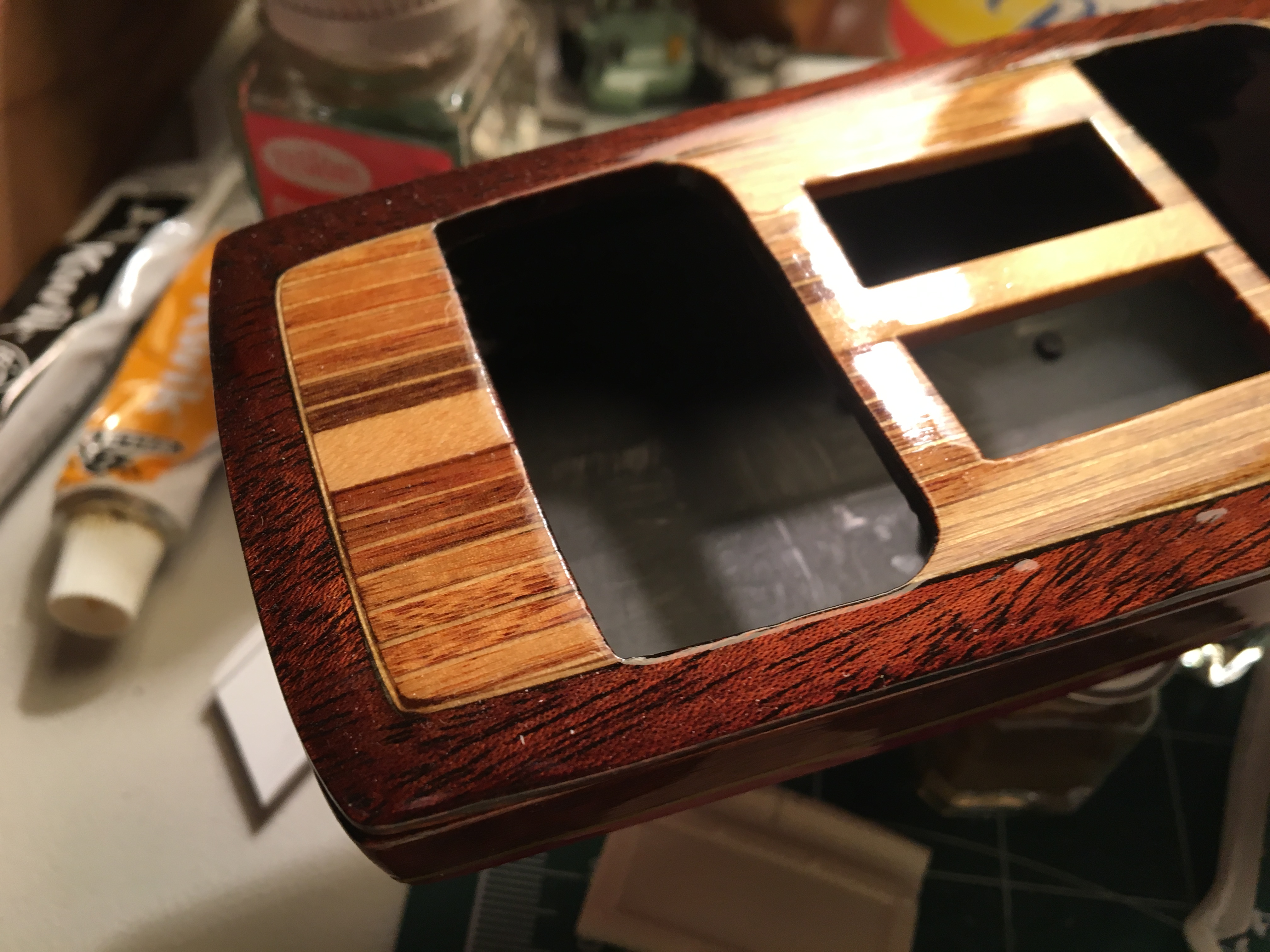

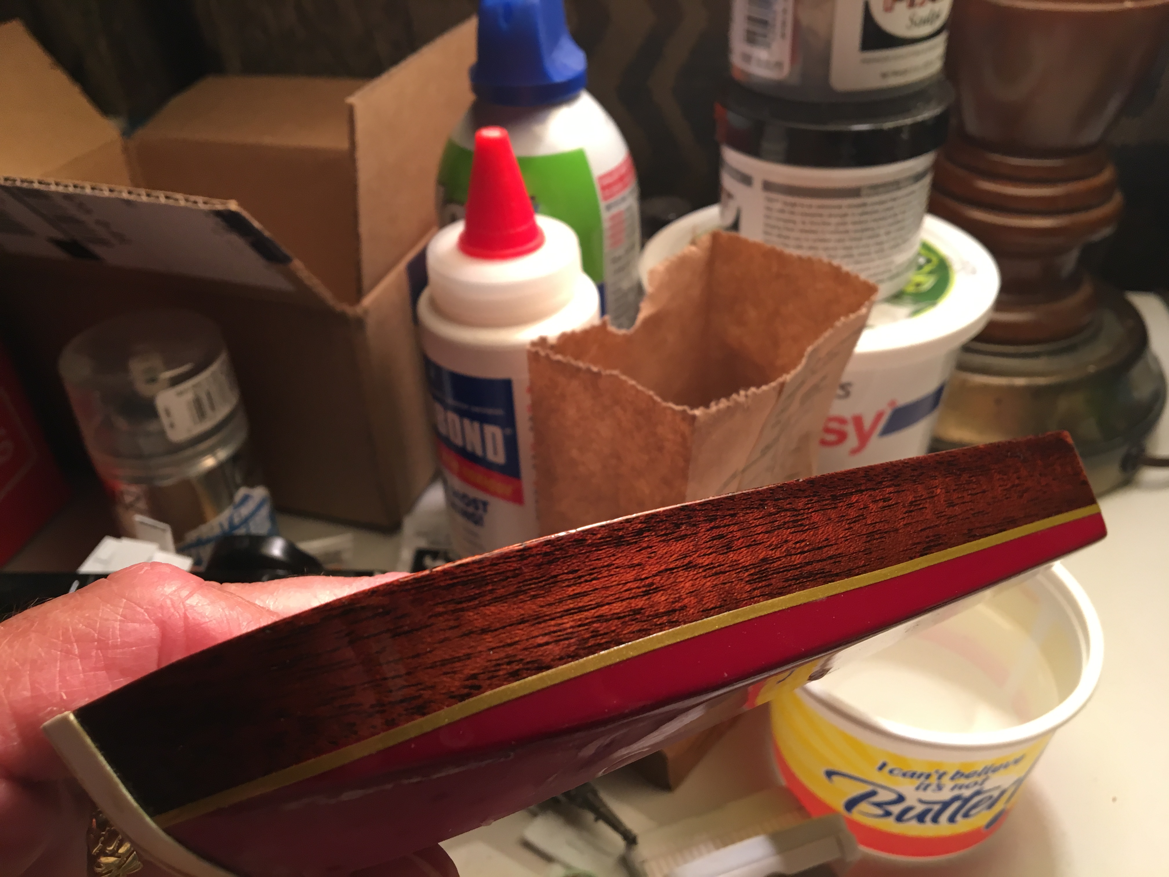

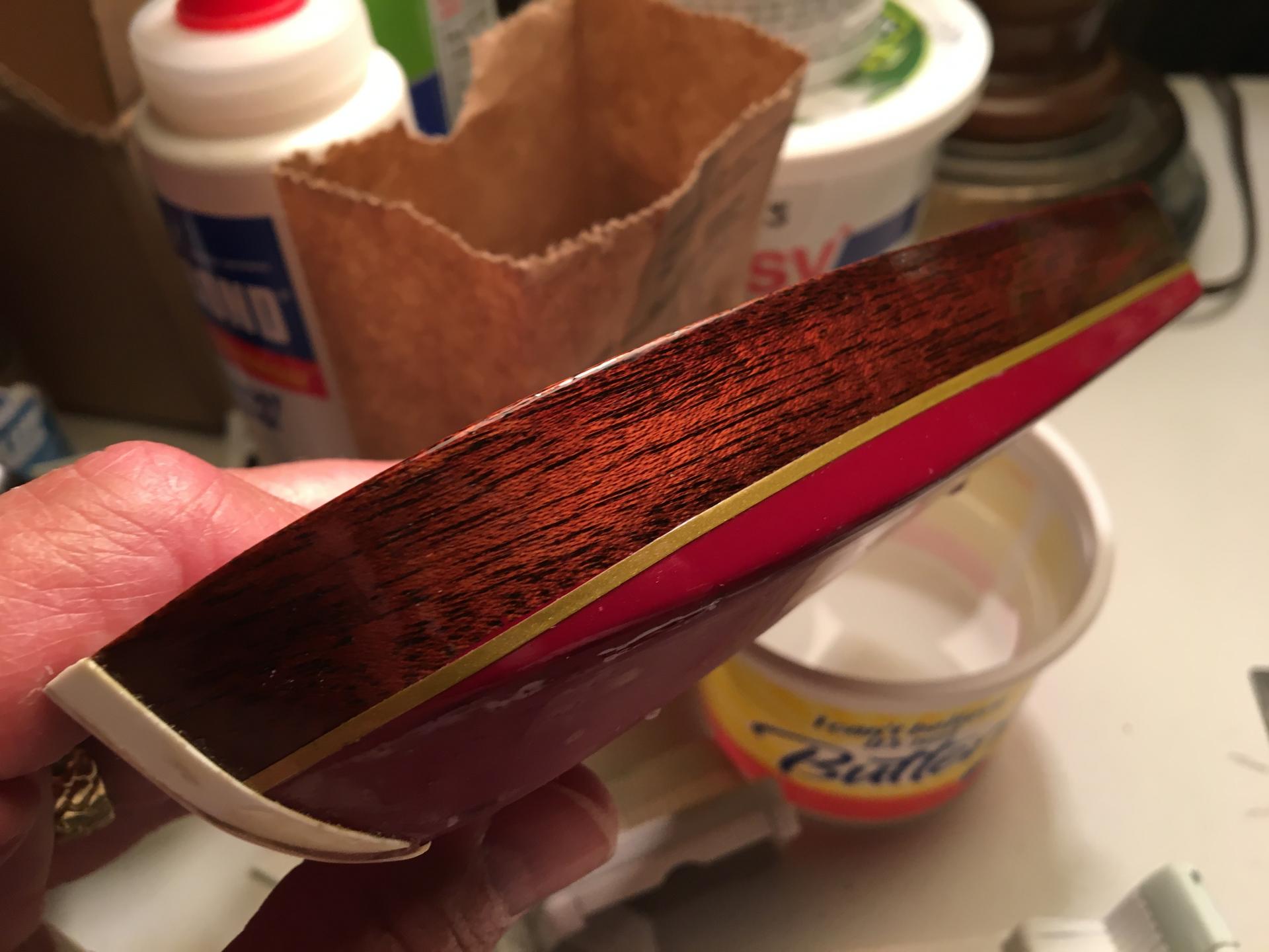

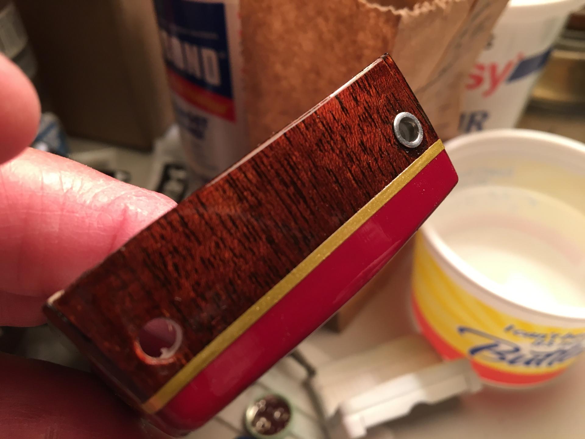

Mercuryman54 Posted October 25, 2017 Author Share Posted October 25, 2017 A few more pictures of the progress. Bottom of the hull painted, pinstriped and polyurethane. Deck interior and engine panels cut out. Quote Link to comment Share on other sites More sharing options...

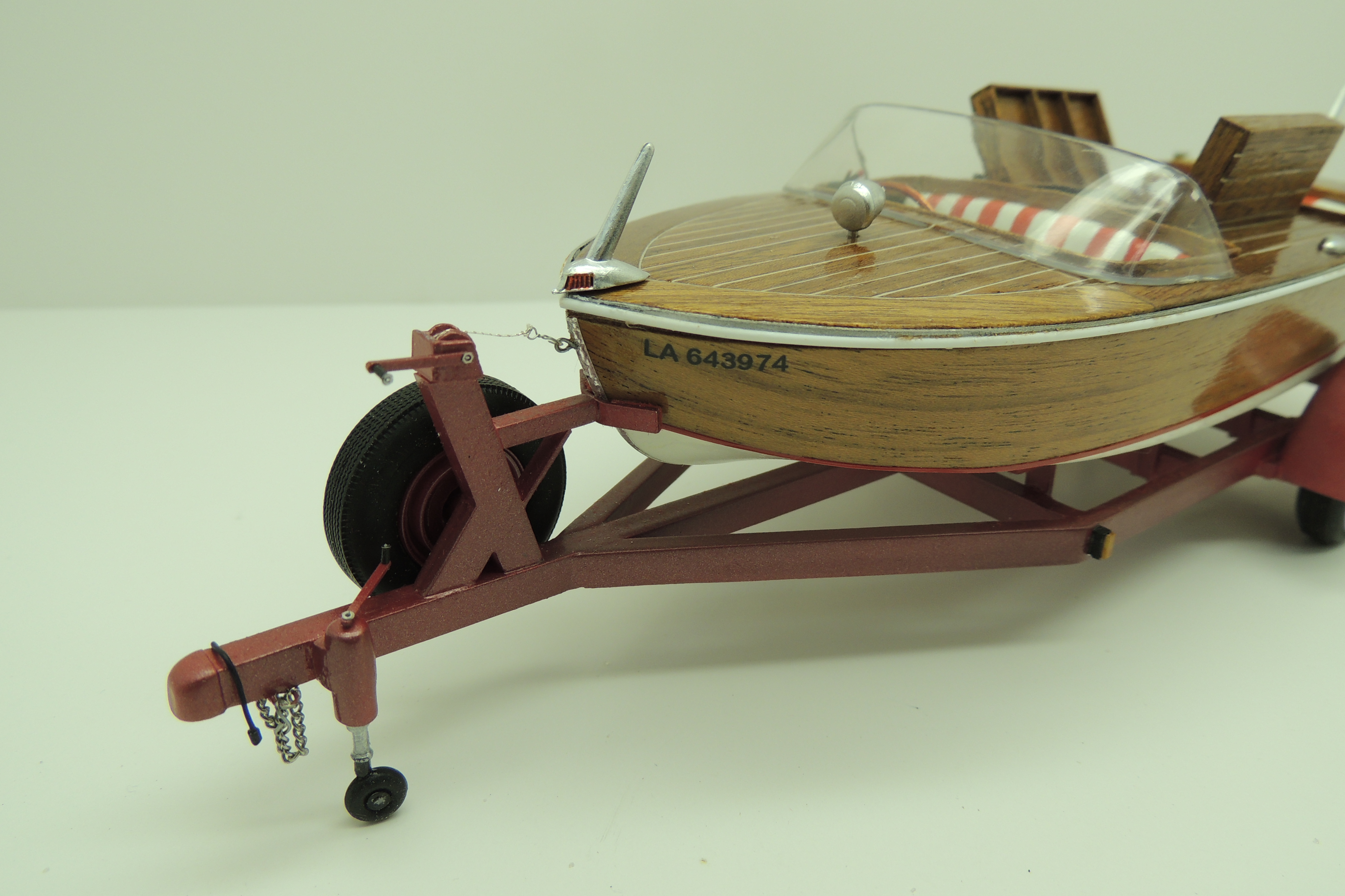

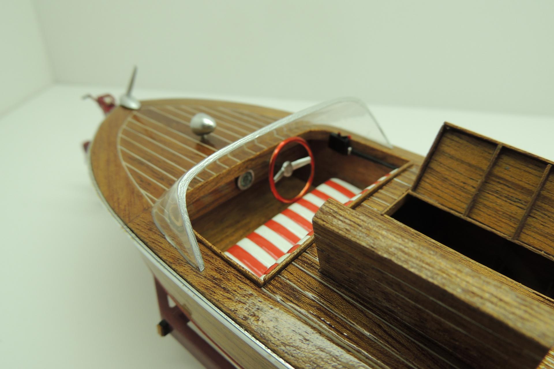

SteelyEd Posted November 4, 2017 Share Posted November 4, 2017 (edited) She is Beautiful!!!, I did one like this with a similar wood treatment. What engine are you going to use? Hoping not to offend you in any way, here are a couple shots of my version, I used .10 square plastic rods between the planks. Edited November 4, 2017 by SteelyEd Quote Link to comment Share on other sites More sharing options...

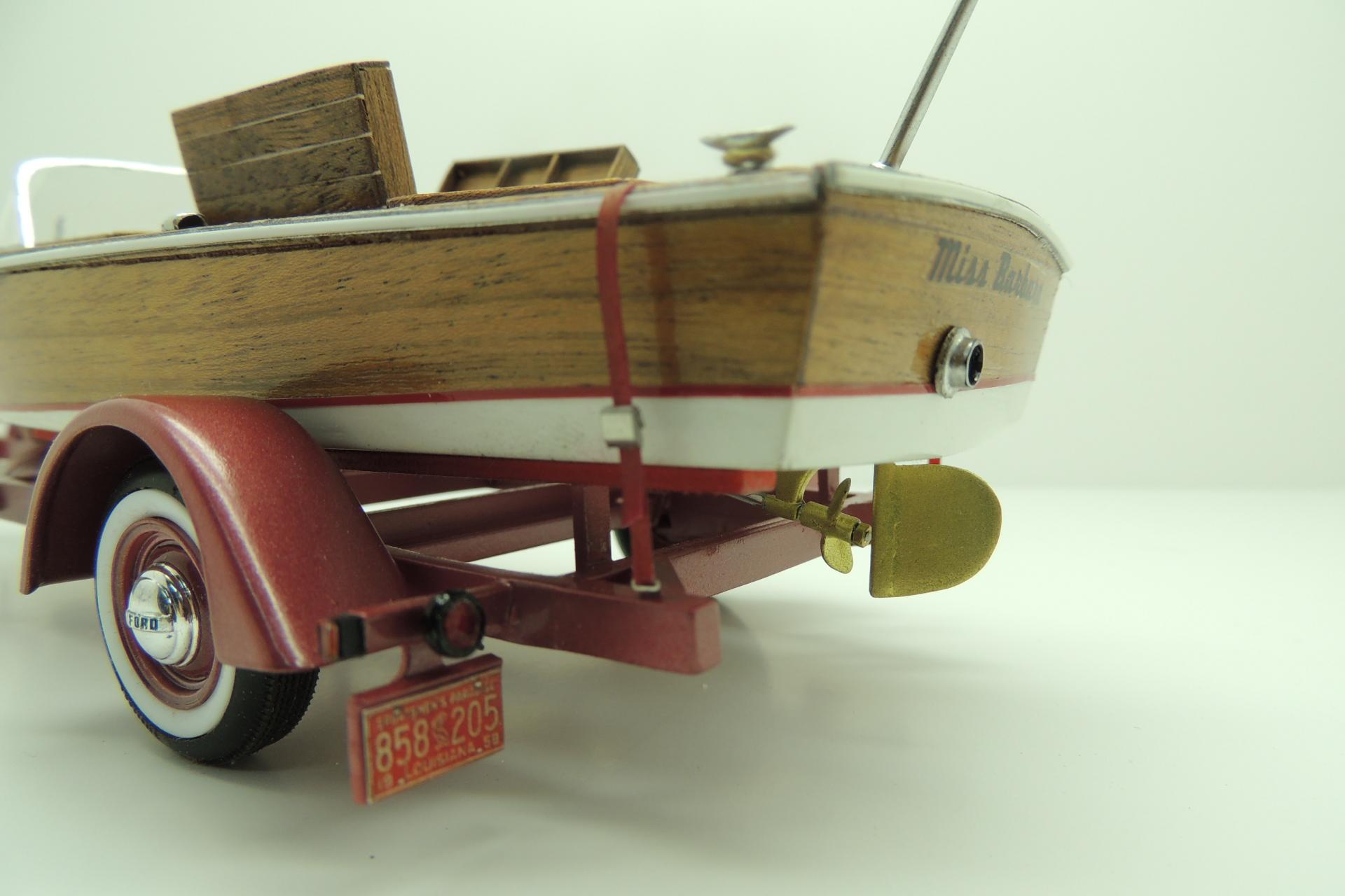

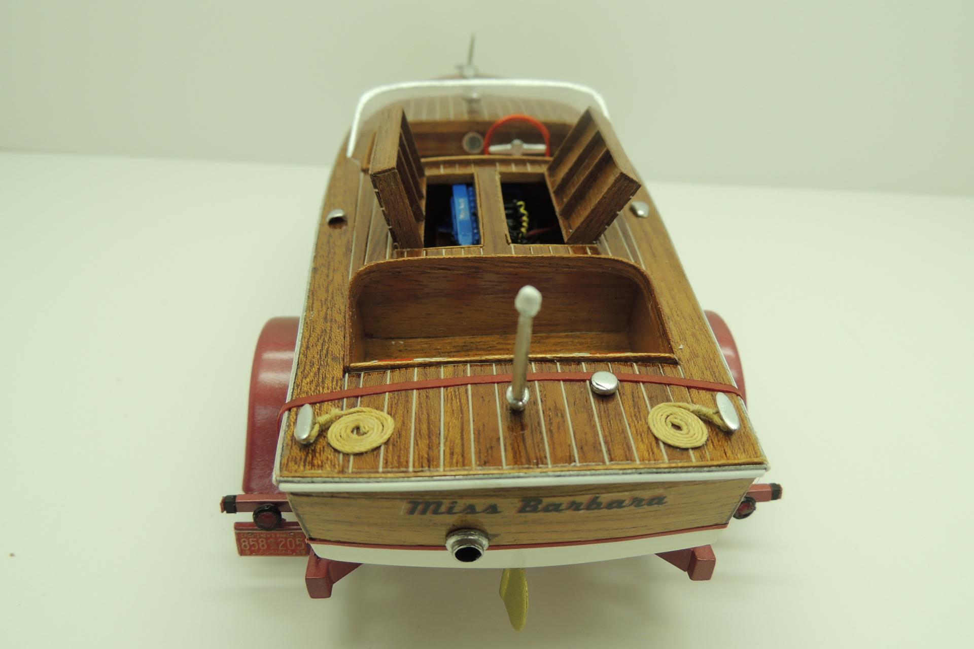

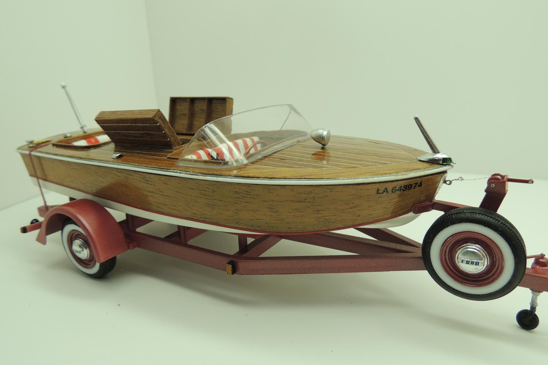

samdiego Posted December 19, 2017 Share Posted December 19, 2017 (edited) Awesome stuff! I didn't take it nearly as far, but this is mine. The bottom one is covered in mahogany veneer Edited December 19, 2017 by samdiego Quote Link to comment Share on other sites More sharing options...

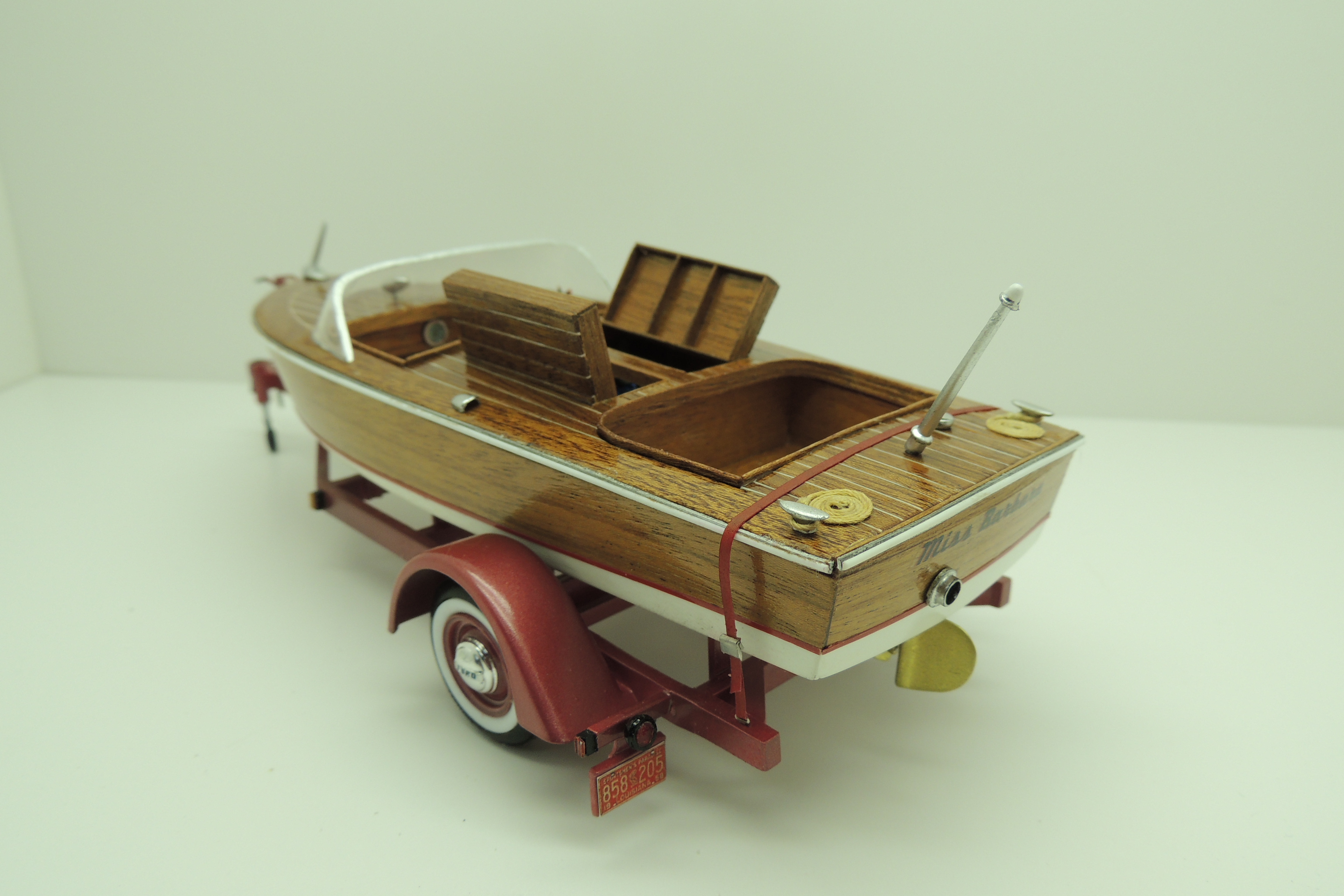

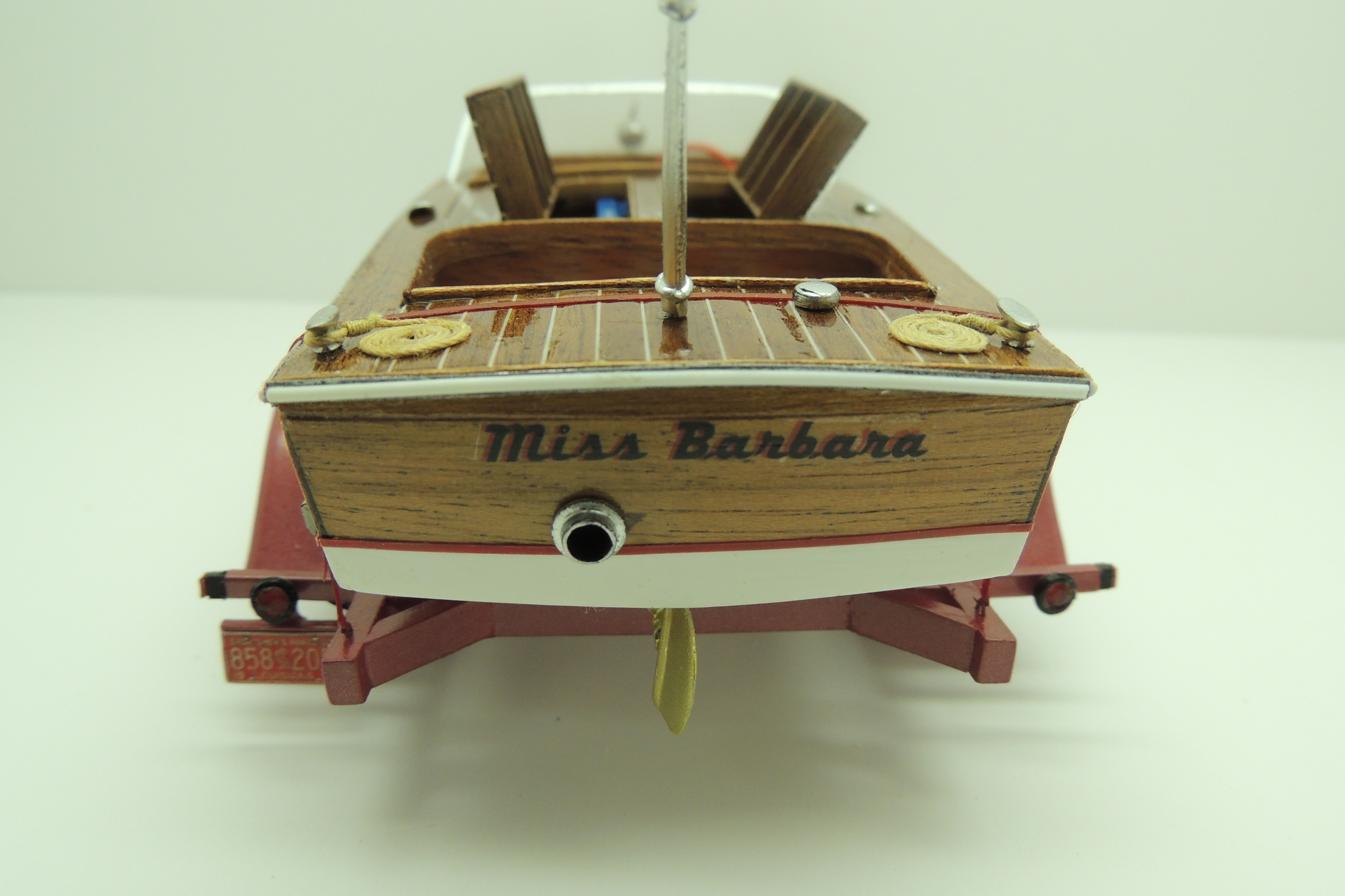

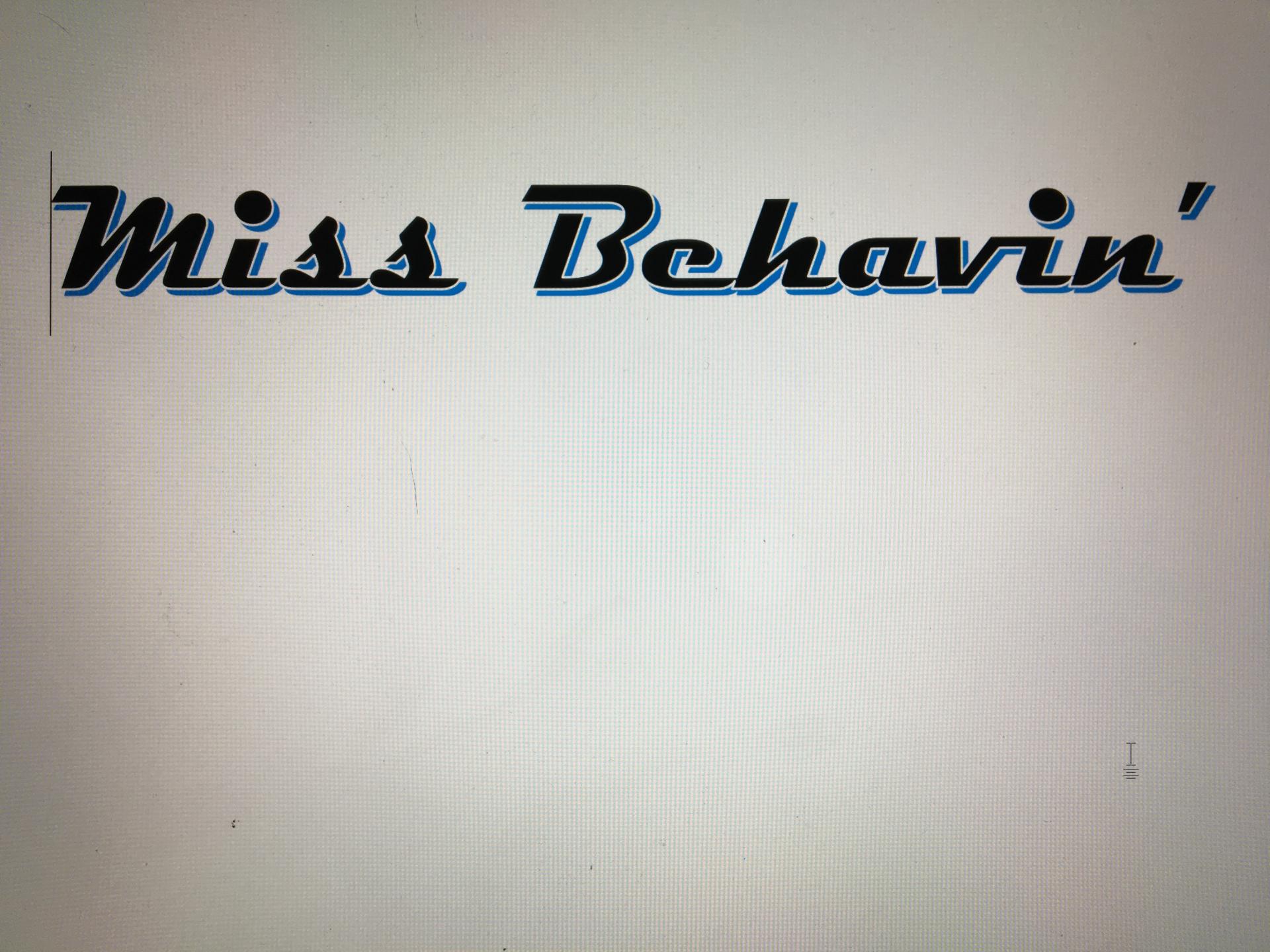

Mercuryman54 Posted February 22, 2018 Author Share Posted February 22, 2018 This may be the script I use on the back of the boat. Hopefully I’ll get back to work on it soon. Dennis Quote Link to comment Share on other sites More sharing options...
