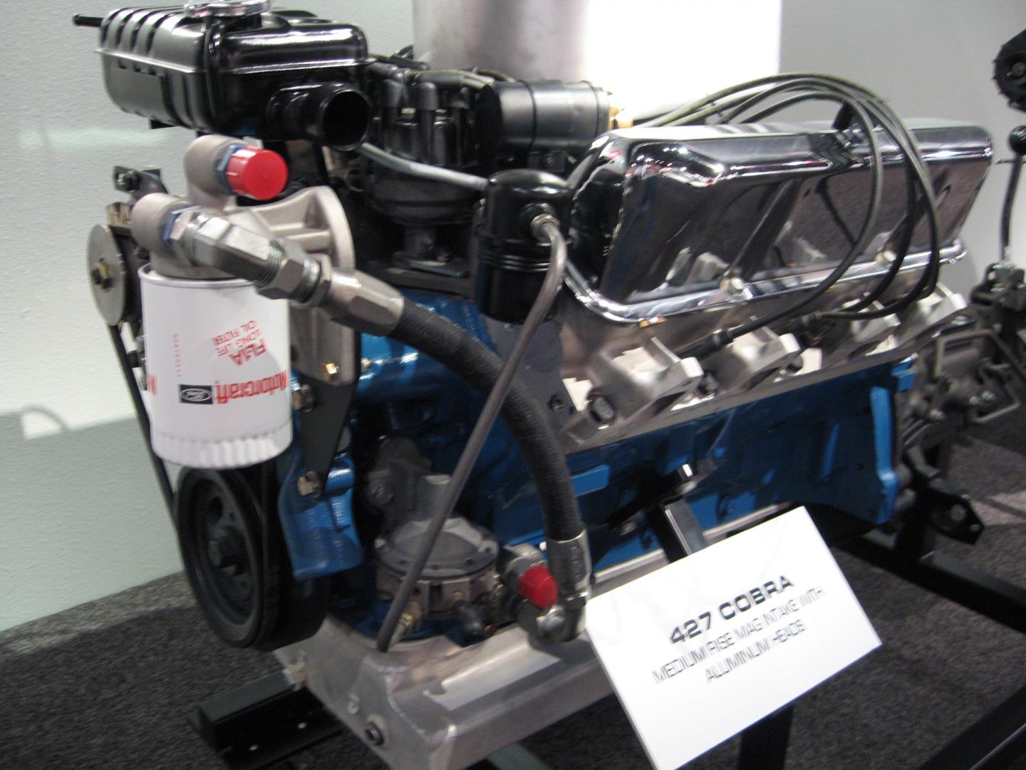

Gramps46 Posted January 1, 2018 Posted January 1, 2018 I hope these photos might help as they are the only ones in my files showing the carbs. The one caption says center pivot 780 Holley. Hope it helps.
Force Posted January 1, 2018 Posted January 1, 2018 (edited) For modelbuilding it doesn't matter what size the carb has, a 4150 series 650, 750, 780, 850 cfm looks the same on the outside, the differences are mostly internal. Of course there are visible differences when it comes to what type of choke it has, if it's a double pumper, vacuum secondary stage and so on. In this particular case I would go with the FMR-092 as it has the correct LeMans float bowls, and there are two carbs in a set so you can do two cars. The FMR-090 or FMR-093 is not that wrong either as they are good replacements for the LeMans bowl carbs. The LeMans bowls were Holley's first version of center hung float bowls wich are better for road course use than the side hung floats, and they were later replaced with the "Catheral" style bowls wich are easier to adjust the float level on as you do it from the outside without taking the carb appart, on the carb with LeMans bowls you have to take the bowls off and bend the float arms to adjust them. Edited January 1, 2018 by Force

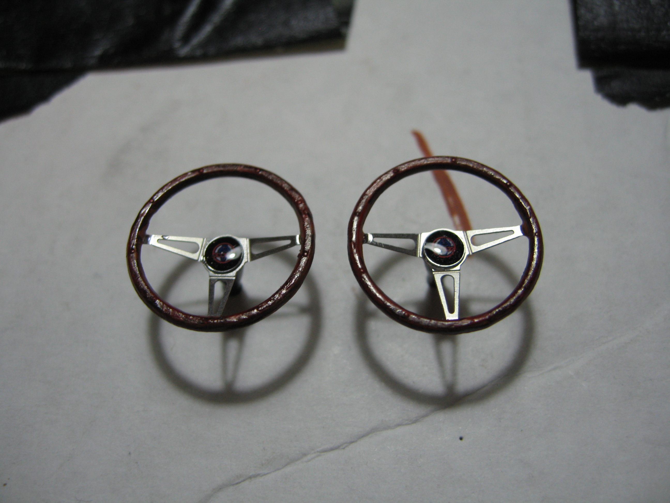

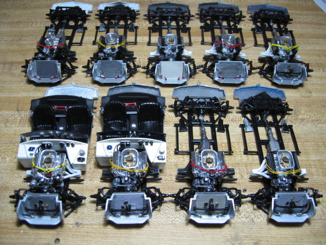

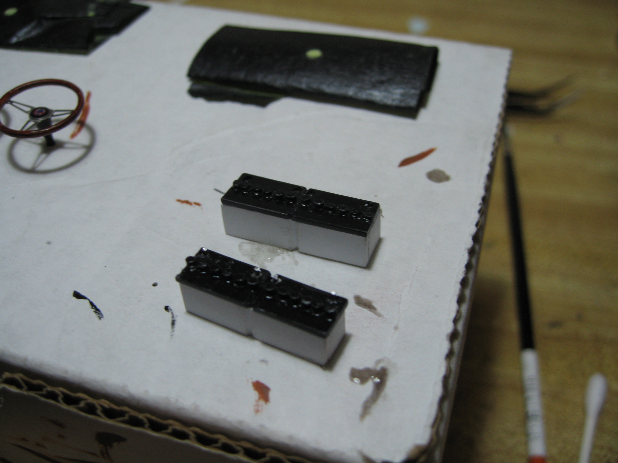

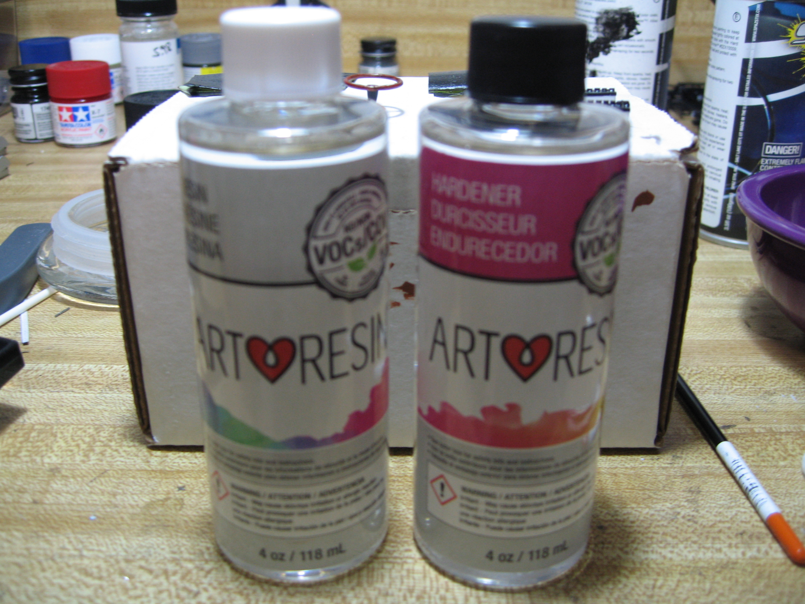

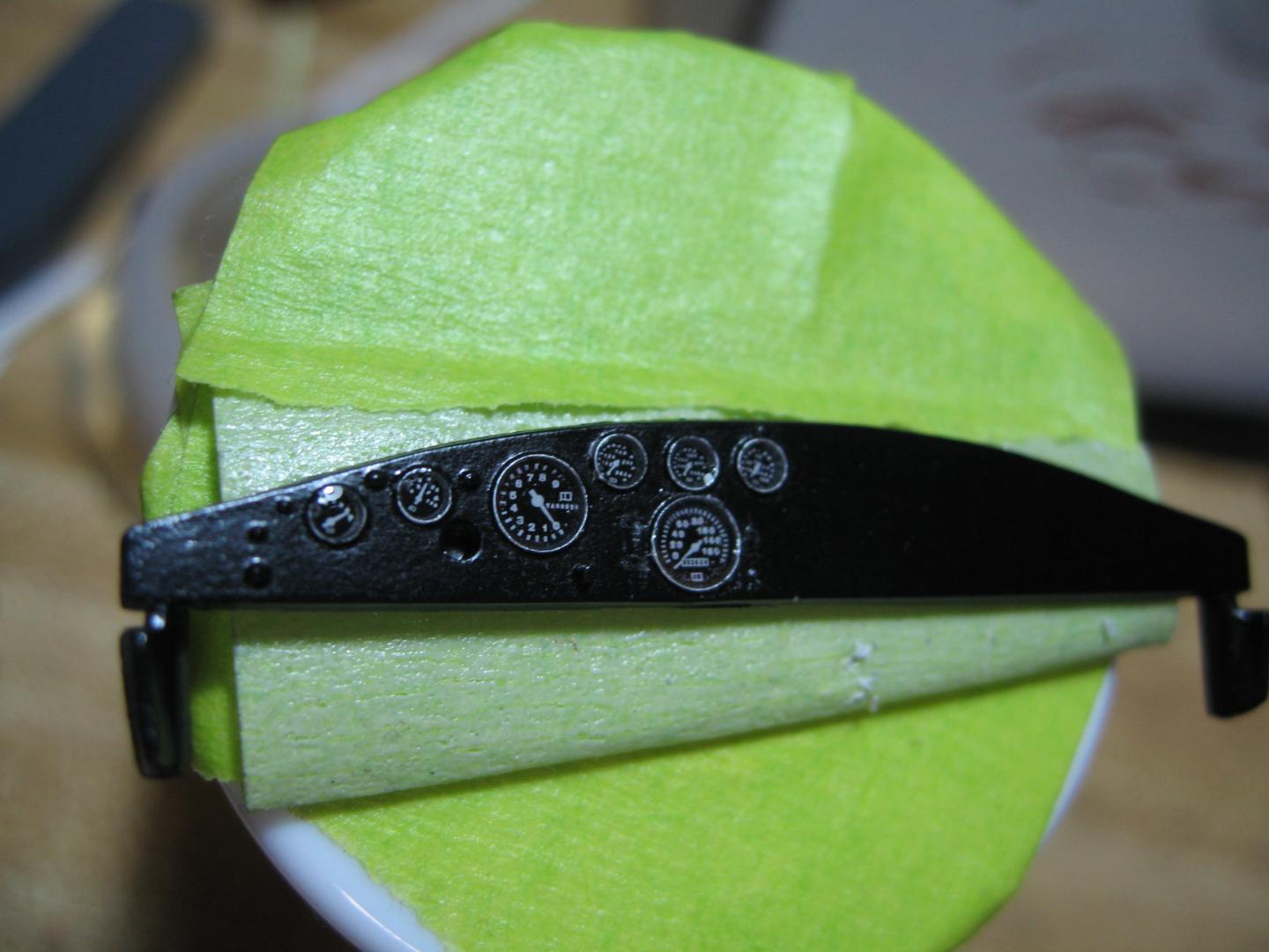

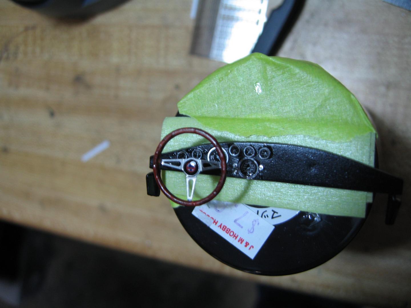

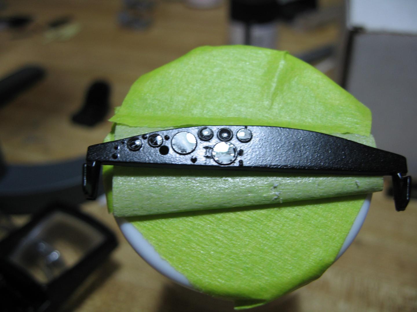

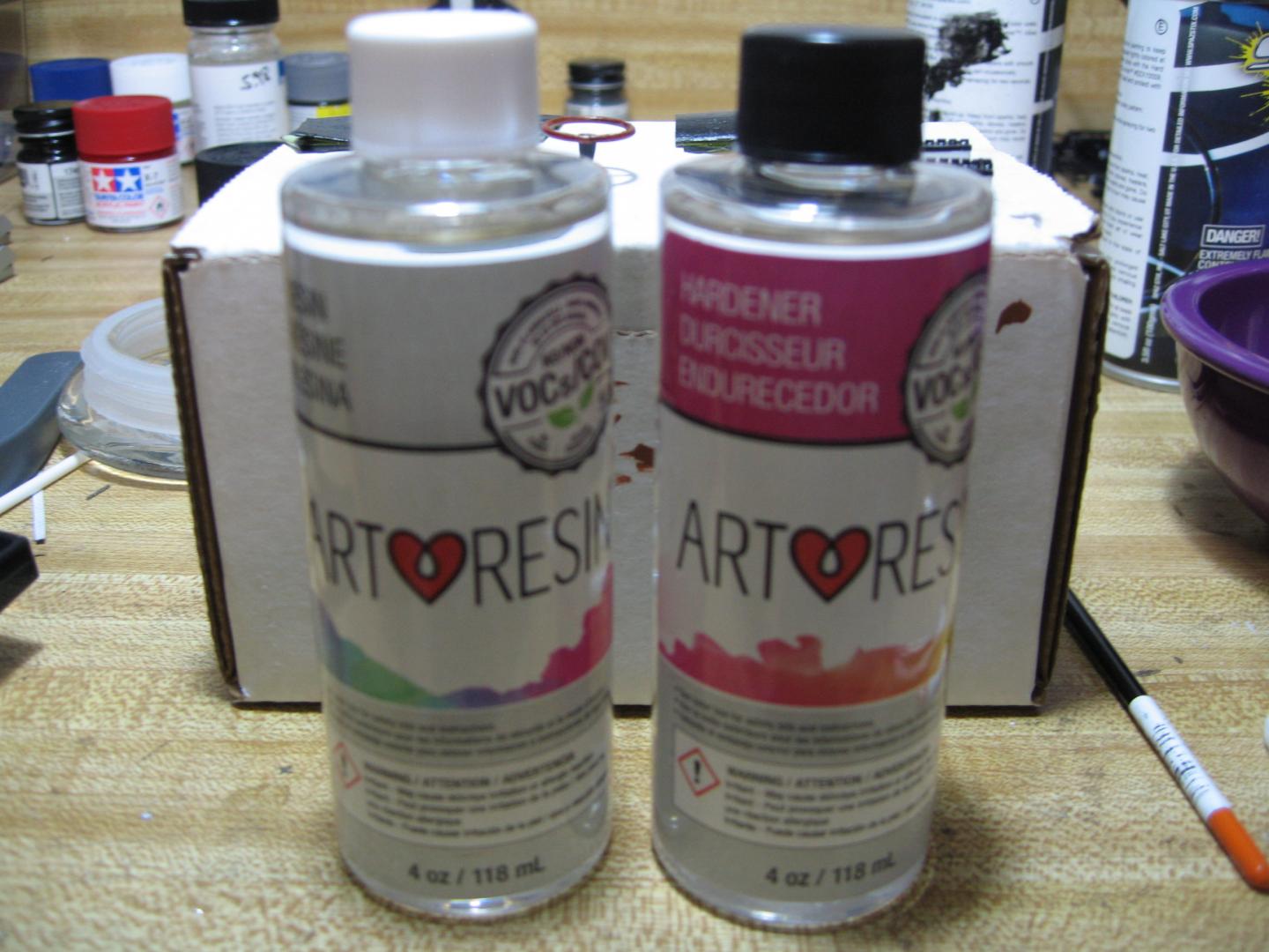

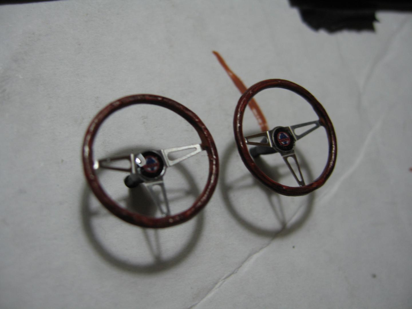

65slotcar Posted January 7, 2018 Author Posted January 7, 2018 ok, not all 9 are getting full detail. i would but i don't have many photo etched detail kits by Hobby design. can't find any supply anymore. working on steering wheels , scratch built batteries and gauges on dash. to replicate glass for gauges, i tried 2 part opoxy but it yellowed and hard to work with. i tried floor wax (pledge) took forever and would not build up fast enough. found this product on-line. art resin (artresin.com) mix1:1 work time 45 minutes,dries in 24 hours and full cure in 72 hours. super user freindly and great results. comes out crystal clear. also used on center cap on steering wheel

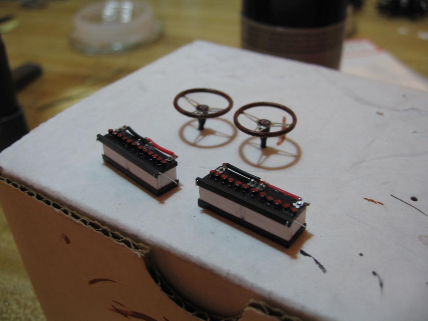

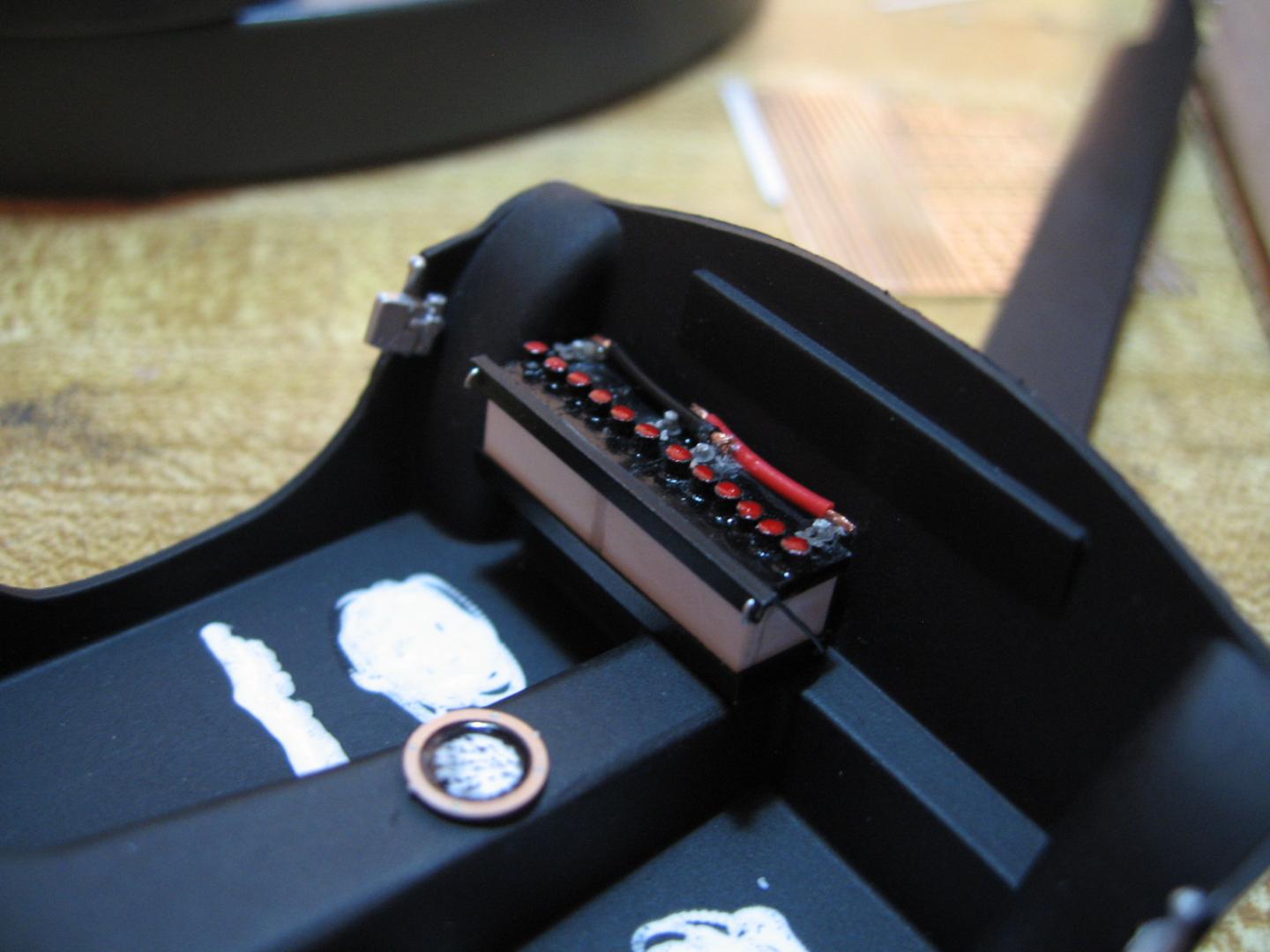

65slotcar Posted January 8, 2018 Author Posted January 8, 2018 added some gauge rings and finished a couple batteries
Tom Louis Posted January 8, 2018 Posted January 8, 2018 Wow, that is quite a Cobra assembly line you have going there! I will be watching closely, as I have just started building so ports cars for the first time. I have many years of circle track builds, but I need to diversify. Great building. Thanks for the references, too! Tom
DustyMojave Posted January 8, 2018 Posted January 8, 2018 Nice job on those batteries. Shelby used aircraft batteries that are smaller than the usual car batteries used in most American cars. Plus the caps that you did right have a ball check valve in each cap to keep the acid from spilling if the car gets upside down. I used to use them in my offroad race buggy too.

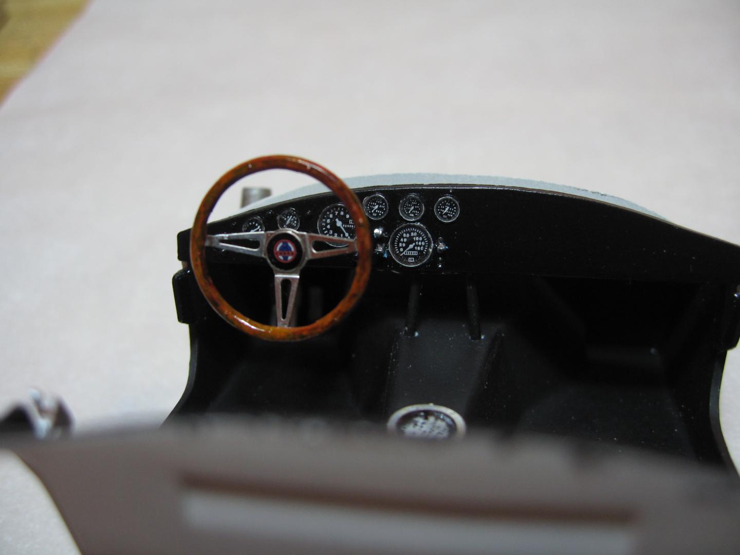

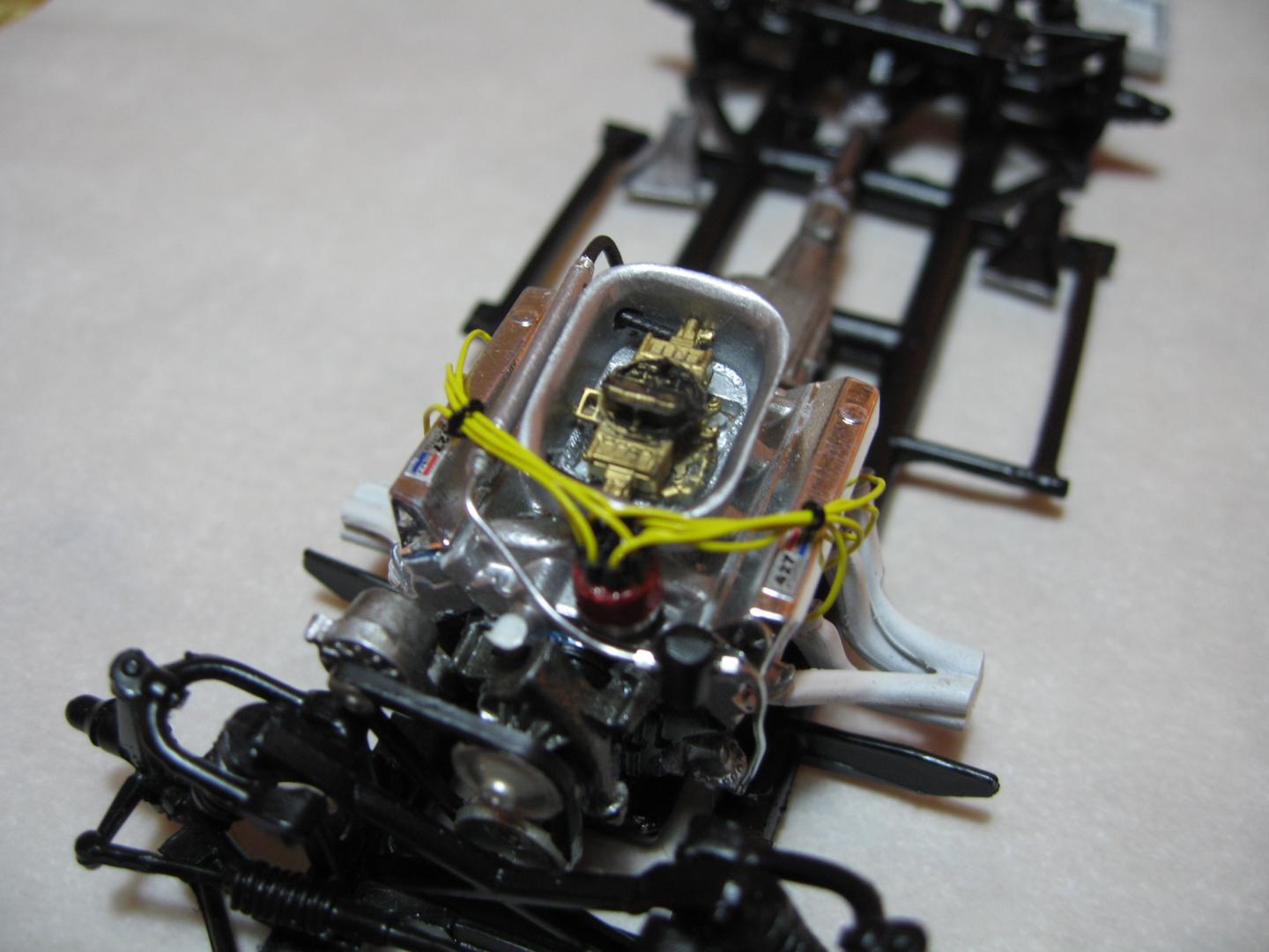

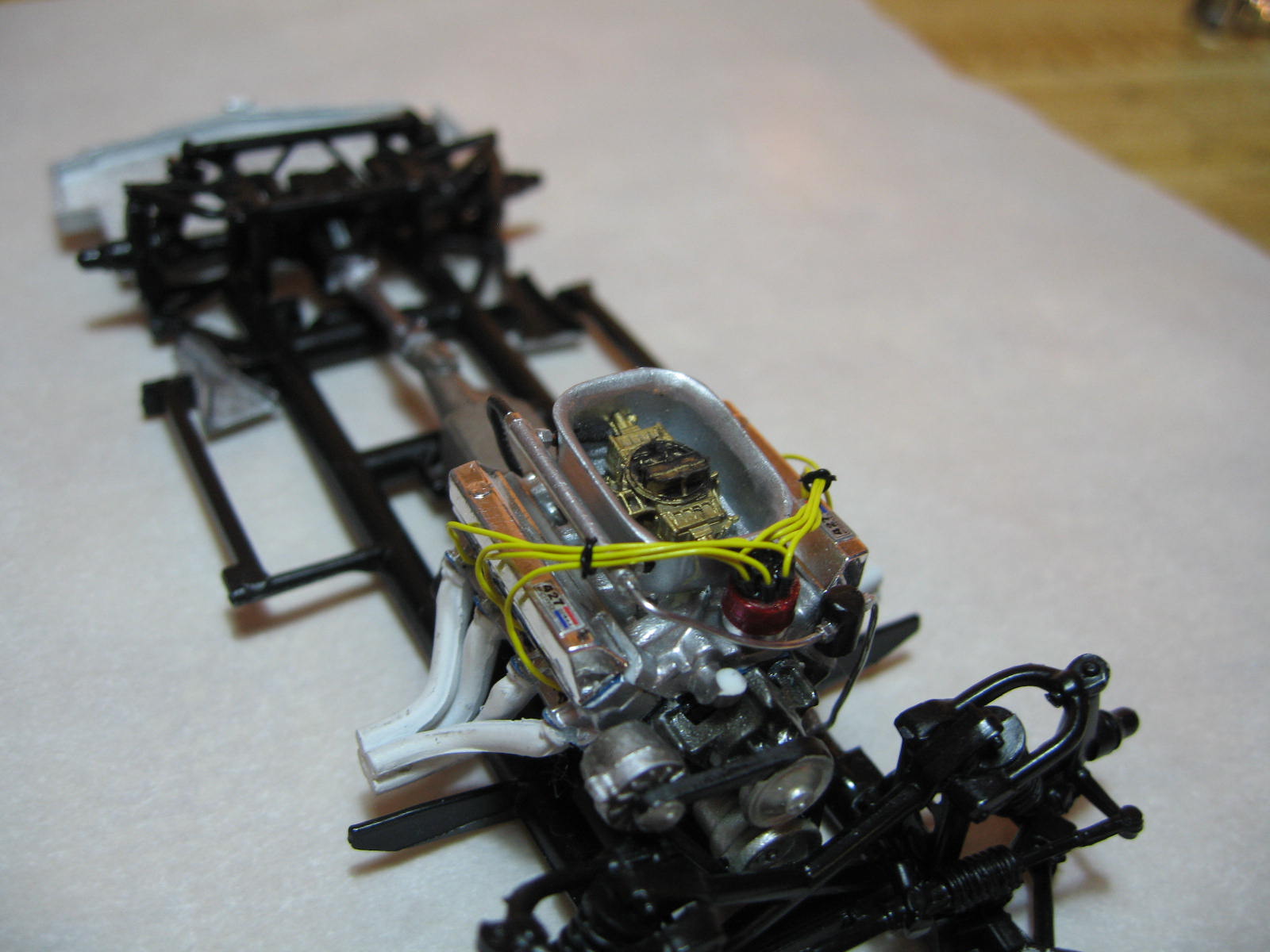

65slotcar Posted January 21, 2018 Author Posted January 21, 2018 On 1/7/2018 at 9:29 PM, DustyMojave said: Nice job on those batteries. Shelby used aircraft batteries that are smaller than the usual car batteries used in most American cars. Plus the caps that you did right have a ball check valve in each cap to keep the acid from spilling if the car gets upside down. I used to use them in my offroad race buggy too. thanks Richard, a few updates. added supports tubes under dash and now have correct carbs installed. all radiators done. a little carbon build-up on carb or dirt since they didn't race with air cleaner and tried to replicate fuel filter
Force Posted January 22, 2018 Posted January 22, 2018 (edited) Now we're talking, looks great! Edited January 22, 2018 by Force
Mark IV Posted January 23, 2018 Posted January 23, 2018 Gauge faces look great but speedo should be the reverse wind setup. Comp and S/Cs used the "backwards" speedometers.
afx Posted January 23, 2018 Posted January 23, 2018 I wouldn't sweat the spedo too much Bill, but for future reference Best Models sells the correct face gauge. Not super detailed but you can see the reversed rotation spedo in the lower right.
65slotcar Posted January 23, 2018 Author Posted January 23, 2018 15 hours ago, Mark IV said: Gauge faces look great but speedo should be the reverse wind setup. Comp and S/Cs used the "backwards" speedometers. Rick, thanks for pointing this out. i have some of the gauge faces from best models and didn't use because it was hard to cut out gauge exact (not a pre-cut decal) will try to fix on future builds. Bill

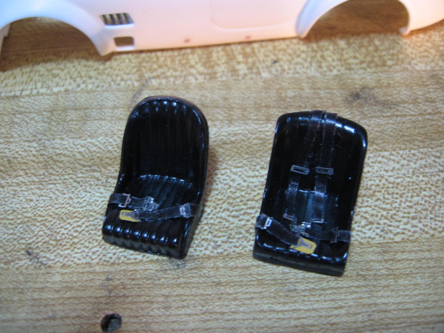

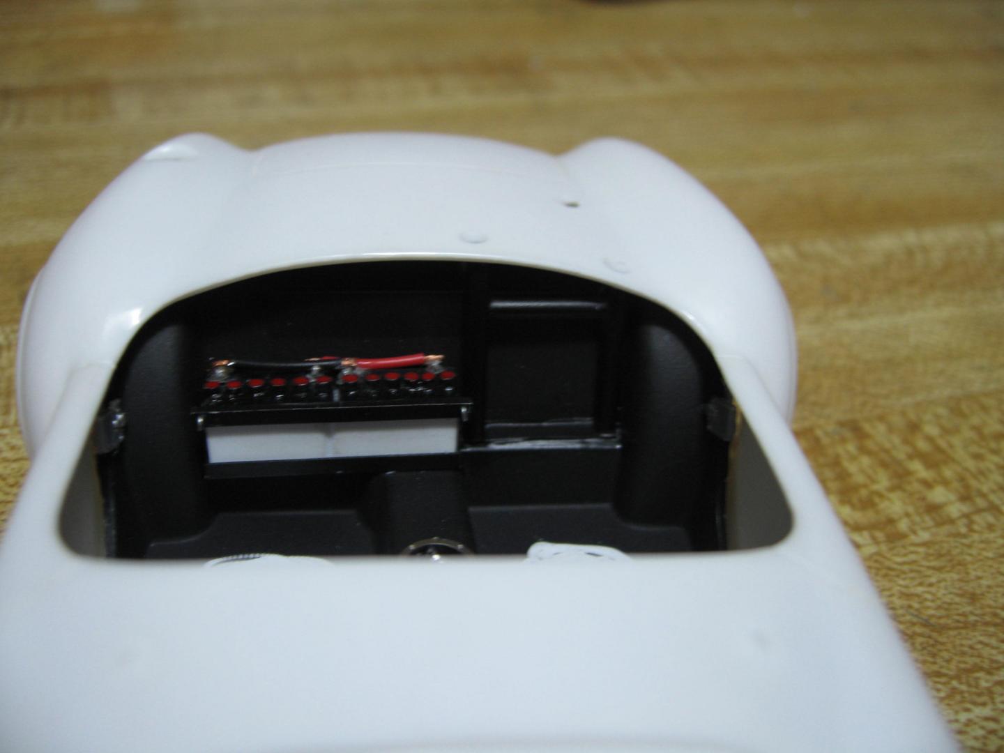

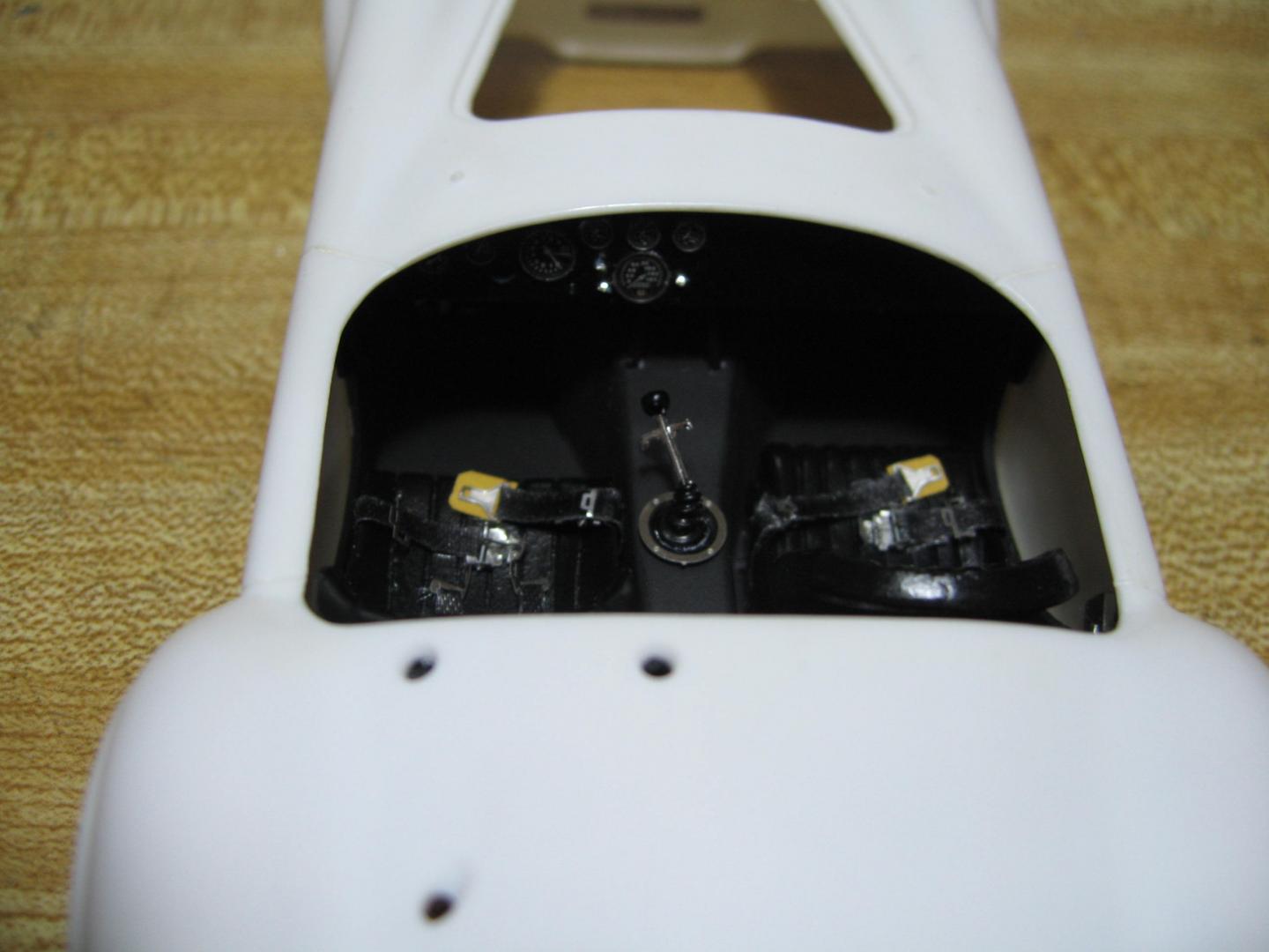

65slotcar Posted March 3, 2019 Author Posted March 3, 2019 wow, last update was about a year ago. have been working on my 1/1 scale project and took a break to hopefully finish my 427 Cobra's. Sanded off all emblems to use photo etched emblems or decals, cut out side louvers for photo etched part, seat belts done,roll bar extended into interior and holes drilled for roll bar.

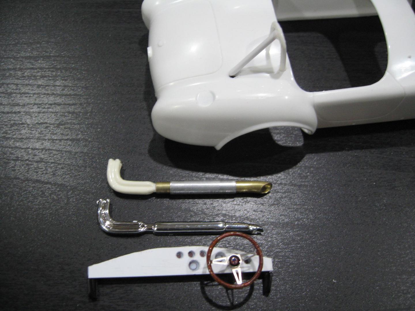

65slotcar Posted December 15, 2019 Author Posted December 15, 2019 (edited) i'm back at this project. working on new side pipes and building a right hand drive version. cobra csx 3006 . i don't have a great picture, maybe someone knows if black paint on top extends past trunk as it looks in some pictures, also hood scoop looks extended forward and maybe longer . restored version has 6 spoke halibrands like a 289 comp car. can't tell what wheels it had when raced. ( update 12-15-2019 can't figure out how to edit post title) Edited December 15, 2019 by 65slotcar
