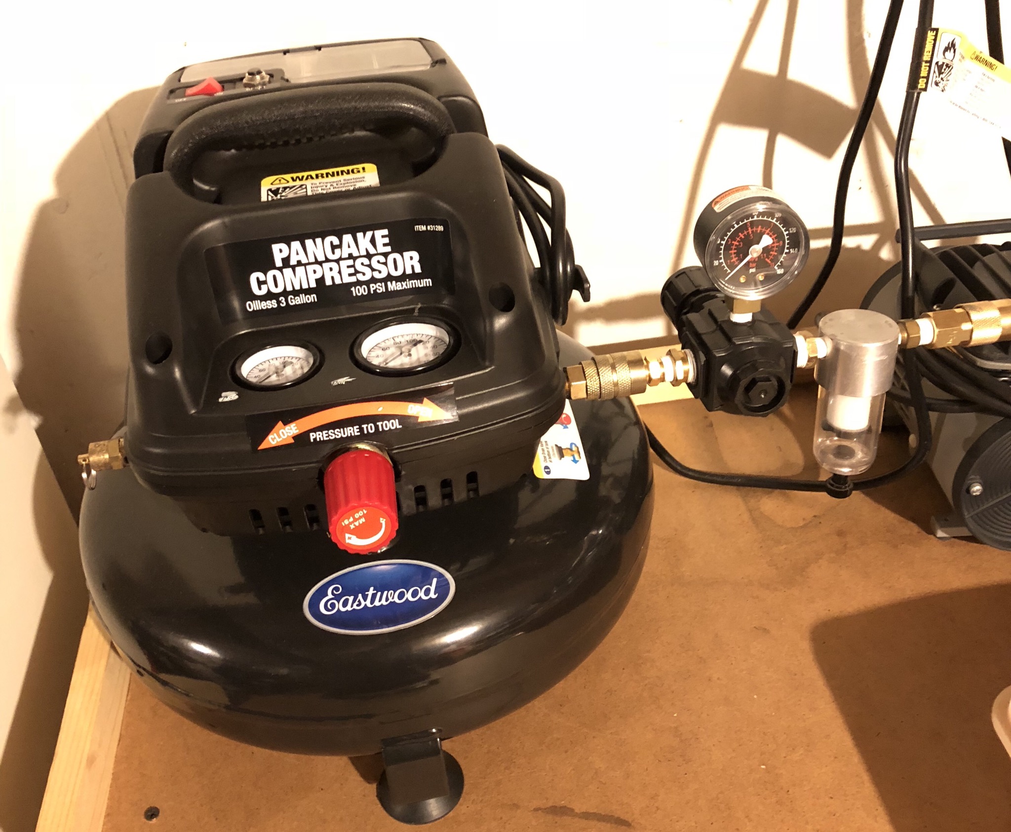

George Bojaciuk Posted February 15, 2018 Posted February 15, 2018 (edited) I will admit that I worked at Eastwood. I picked this up after leaving there, for $35. Didn’t like the internal regulator, so I added my own from my last compressor. Once the tank fills, and it’s pretty quiet, I can spray a lot before it kicks in. With my reg, it’s consistent. With the internal, it’s a hit or miss with pressure. You need to add an external reg. My old Badger compressor was a workhorse. It’s loud and run constantly. It done service over 20 years! A comparable unit to the Eastwood is a Porter-Cable. My contractor had one here at the house. He let me try it! I’ve seen them on sale at Lowe’s for under a C - note. Edited February 15, 2018 by George Bojaciuk
