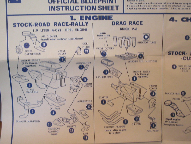

Doesn't the recent-ish reissued Opal have a Buick V6 ?
It certainly has SOME kind of V6...but the illustration of the "race" version lacks the front distributor...and it's hard to tell about the center one.
Image result for AMT opel GT engine
Edited by Ace-Garageguy
I seem to recall that Tim Boyd stated -- in some 1988 issue of SAE -- that (to paraphrase) "The V6 from the AMT Opel was used [ for this (c.1932) Ford (pickup) that I built _______ years ago ] ..."
The image on the box looks like a 231 ( ad / sub seq. ) engine .
The AMT opel GT's Buick V6 is garbage. Completely smooth and block cylinder heads and block (much like the AMT Gremlin's engine)...I would find something else:
