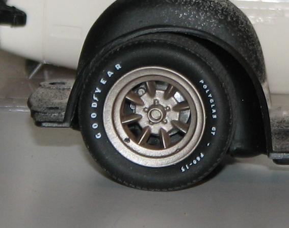

Today, I got some paint and valve stems on the wheels--still a lot to do, before they're finished, but, I like the color. It's Design Master Modern Metals "Metallic Taupe". I also got the dash panels cut and formed. Next up for that will be poking some holes in the faceplate for gauges, switches, etc. I shot some white primer on the exhaust dumps. I still need to paint their insides dark grey/brown/black, and dust them with a blend of powdered pastels. I will be washing/shading and highlighting the wheels, and dusting them, inside, with a pastel blend, along with some powdered graphite, to simulate brake dust.

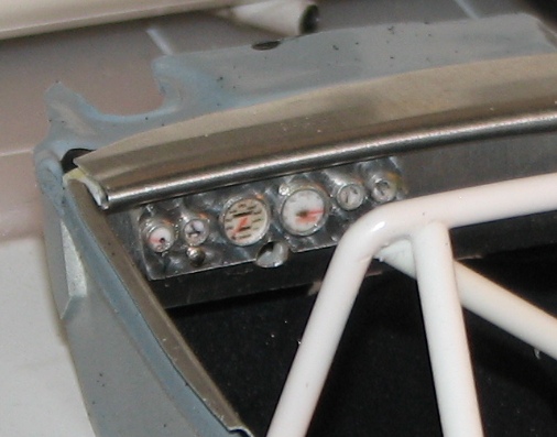

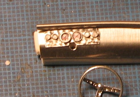

I've been playing around with gauges. I used photos from around the web for the gauge faces. The bezels are made from aluminum tubing. I have yet to install the lenses. I'm not thrilled with the engine turning on the panel, but it'll have to do, until I figure out a better way to accomplish it! I still need to add a few knobs and switches. This tool from Micro Mark was extremely helpful in cutting the bezels to thickness, as it has a bent rod that can be inserted  above the clamping slot, and adjusted to regulate the length of the tubing to be cut. It made it an absolute breeze!

Stance is right on and all the details are very sharp! What did you use to paint the lettering on the tires both paint wise and applicator wise?
Hi, Joe. Thanks for the kind words! Those are the AMT Parts Pack tires. They are beauties!

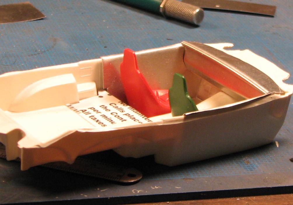

If it were me I'd switch the green seat to driver, just to help it go faster! LoL, looks good though...
Rooster, I think you have a point! I'll get that taken care of!grin

Looking very, VERY good! Your engine-turned dash panel is particularly impressive.

Awesome! Looking forward to seeing it! Thanks for the kind words re: the dash panel. I'd like the turned pattern to be more uniform, but, it does have the look.

That is correct - the red seat goes on the port side, green on the starboard. Oh wait, that's navigation lights on a ship.
In that case, they are in the proper position! Same for aircraft. Guess I won't be switching them, after all!

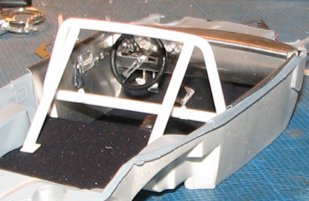

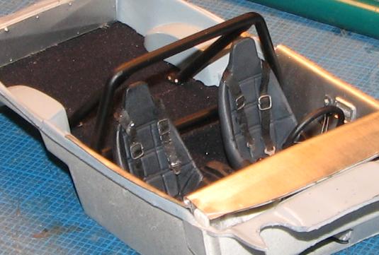

I've put together a bunch of parts and pieces for the interior. I still need to clean up the roll bar, and cut openings in  the interior door panels for the door handles. Pictured here, you can see the NEW gauge panel--I am just about to add the ignition switch and the starter button. Also visible are the window cranks and armrests--it is still a street car, after all. That means the steering column will have the turn signal switch. I will add some corrugated piping just beneath the dash to provide heat on cooler days. I'm not 100% sold on the P.E. steering wheel, so that's pending. The floor has been covered with embossing powder because, even though I want to convey the image of a racer, I want it to be at least somewhat practical. I chose the leather-booted shifter because it has a more of a sports car flare, than, say, a Hurst...

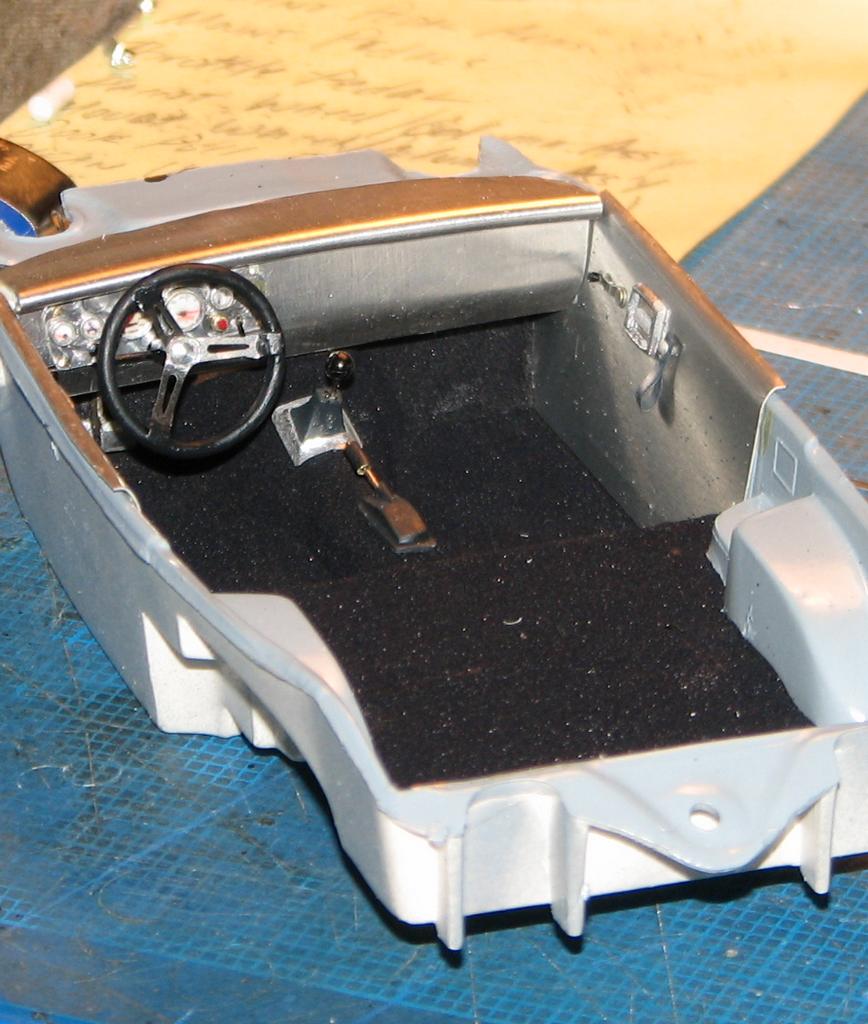

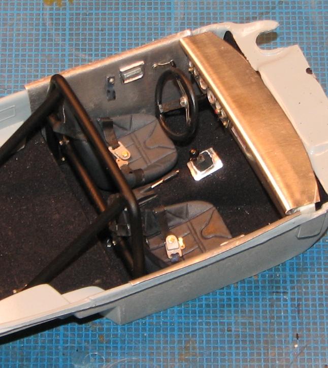

I've been picking away at this interior. I had a set of photo-etched steering wheels from Detail Master, and opted for one of them, for this model. The dash is almost finished! I made the pedals from aluminum tubing, that I quartered, then  cut the sections to length, and sanded them to shape. They are mounted to arms made from .020" styrene sheet. I made door pulls from some soft aluminum foil/sheet in a drawer of scratchbuilding junk. Those are mounted to the door panel with a model RR rivet. Still a fair amount to do, but, figured I'd share the progress.

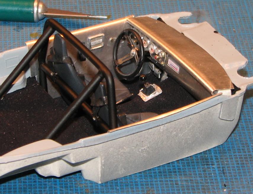

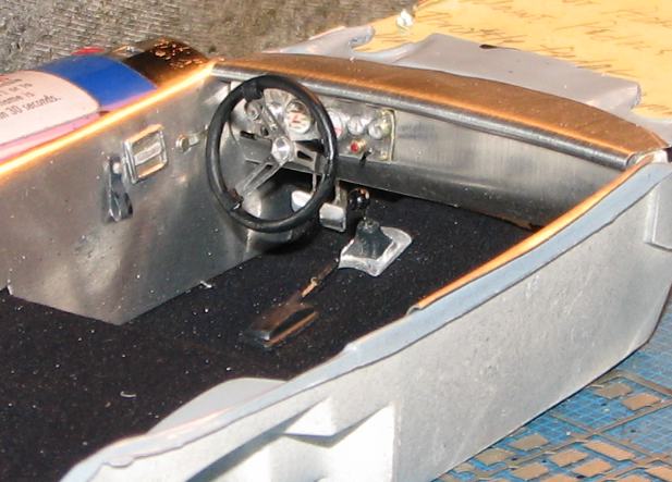

I finally got the interior finished. I'm not happy with the heater control "panel", and I may get rid of it. Now, I can go on to the body! I thought I had a color chosen, but after seeing Snake's promo, I think I want to go with a brighter shade of green than I'd planned, if not quite that bright. I've been playing around with ideas for stripes, and have a few mocked up, but nothing concrete, yet. The grey "hoses" poking down under the dash are heater ducts. I got the idea for them from the gas station job I had in high school--We did full service and washes, etc. I was cleaning a car from the oil field, and they'd spliced into the factory ducts, and had attached a pair of corrugated hoses, that laid along the trans hump, and emerged in the rear floorboard from under the front seat. I thought it was a pretty ingenious way to transfer heat to the rear passengers! So, that's the inspiration for that. Comments/questions as always welcome!

That looks fantastic! I wish I had the patience, or the desire, or the attention span, to do interiors that well. I'm really looking forward to seeing this one finished.

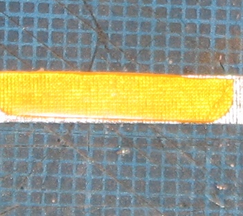

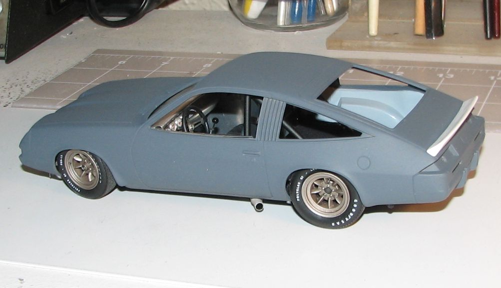

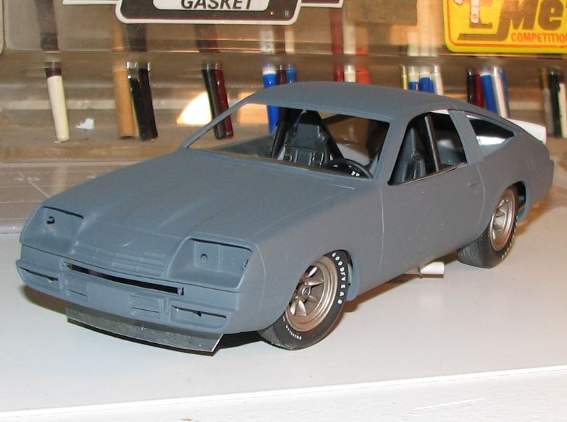

Got a bunch of sanding done, and got the body in primer, so I can see what I've missed! I'm surprised that MPC didn't get the line between the fender and the cowl. I am debating whether or not I'll attempt to scribe them, but, if I know me...I am going to open up the side marker lights and install a lens made from the materials shown. The amber is a tab from a piece of amber sprue from an AMT truck kit. I sanded off the ID numbers, and polished it up. The reflective material is foil liner from a hard pack of cigarettes. I gathered a fair amount of it years ago, when Don Fahrni used it to wrap a chute pack. I will likely use it under the taillights (where appropriate), as well. I also got the front spoiler and body drilled, so the spoiler can be pinned to the body--more on that in the next update.
Link to comment

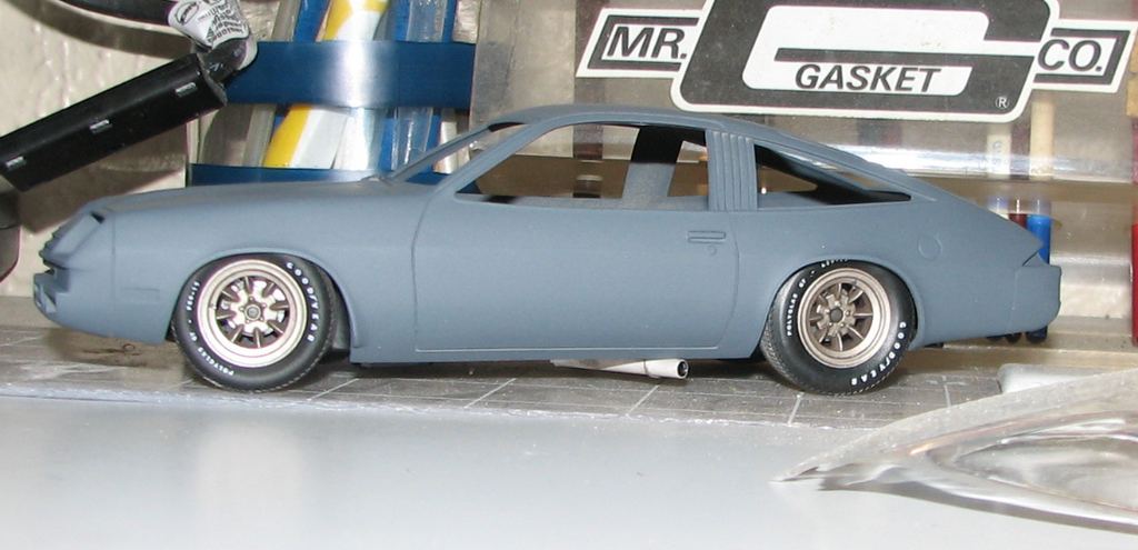

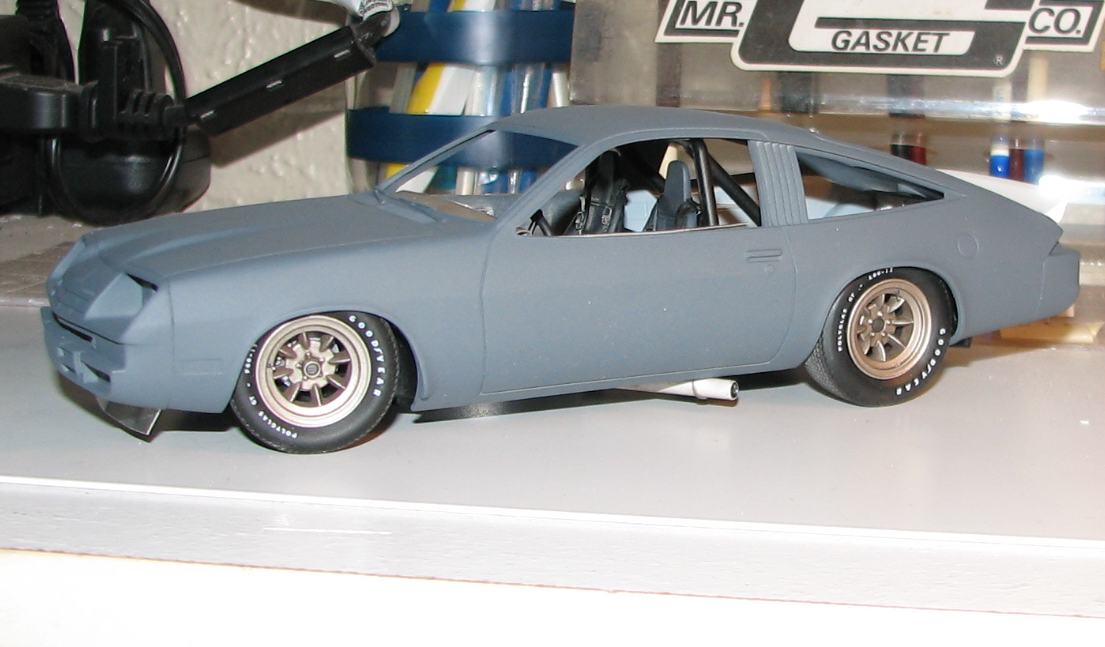

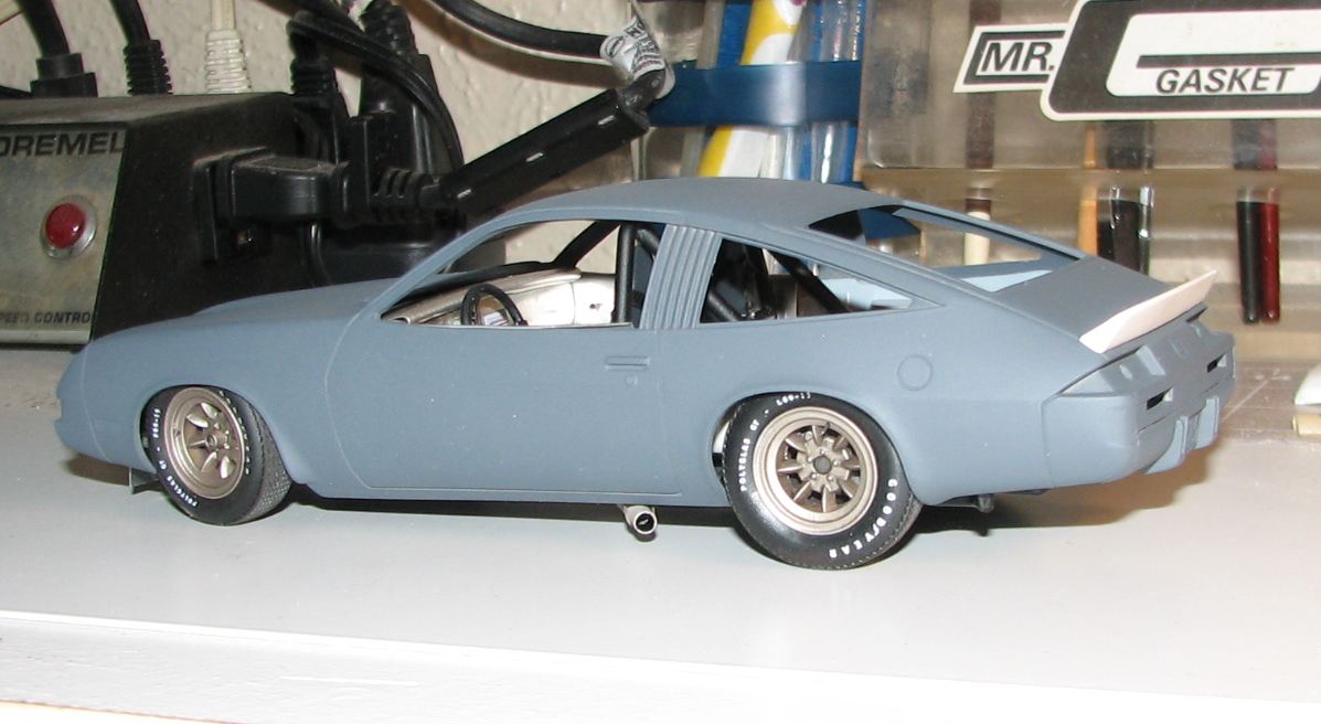

Thanks, Rooster! Just a few shots with the body in primer, and the interior in (temporarily). The spoilers really help the overall look of the theme. Shouldn't be too long until paint--once I decide what color I want it, and get out to find some, which will likely be Wednesday. Comments/questions always welcome!
