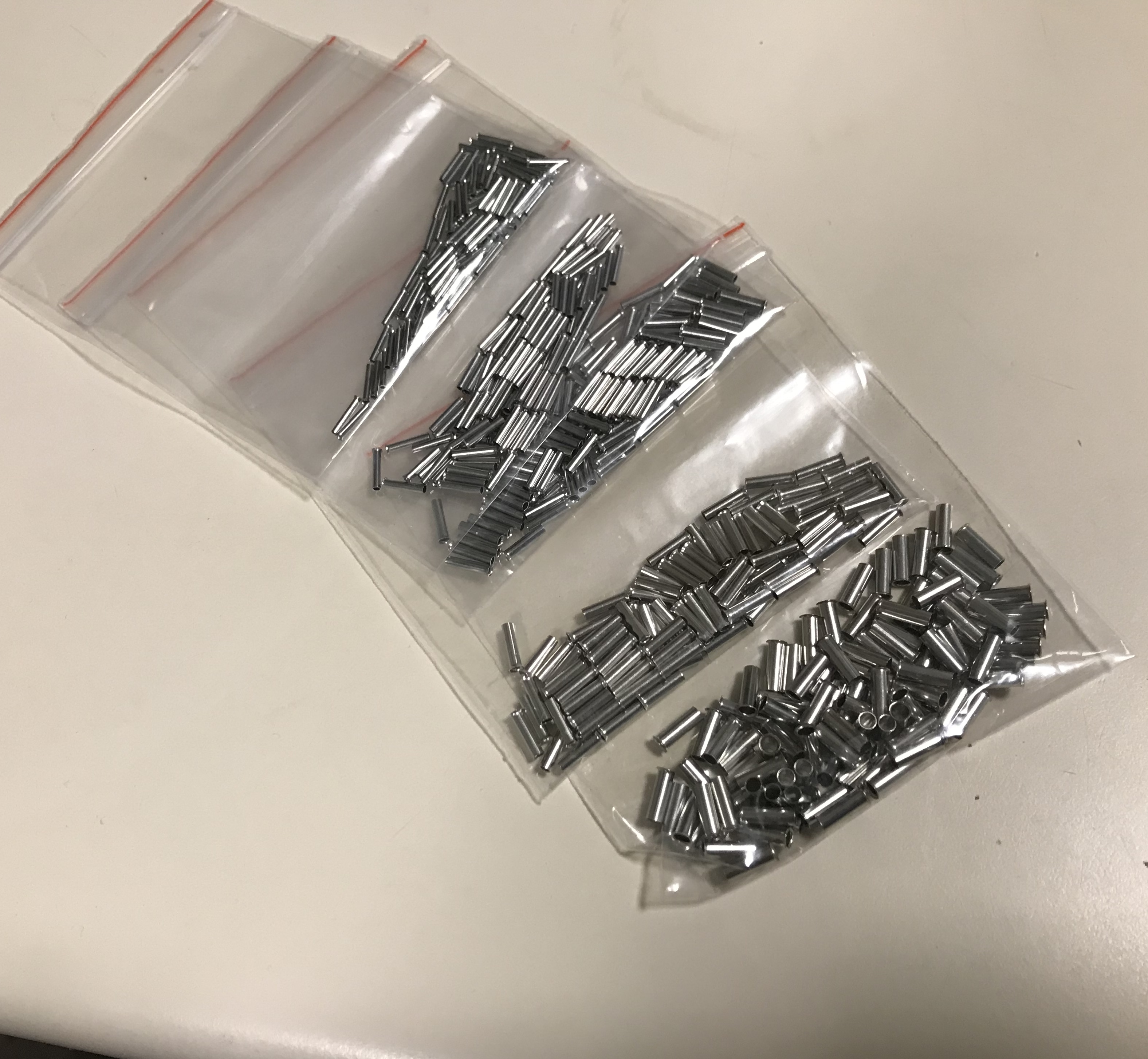

Impalow Posted February 19, 2019 Posted February 19, 2019 (edited) Very nice work! Heading back to a previous post....about air horns/ velocity stacks... I found a nice assortment pack of wire ferules on amazon that work perfect for these, and you get a ton of usable sized ones for $7.29! Just a heads up! https://www.amazon.com/gp/product/B01I93KA90/ref=ppx_yo_dt_b_asin_title_o09__o00_s00?ie=UTF8&psc=1 Edited February 19, 2019 by Impalow
afx Posted February 19, 2019 Author Posted February 19, 2019 (edited) Thanks for the heads up Eric! Those look closer to scale thickness than the turned aluminum pieces I've seen. Edited February 19, 2019 by afx

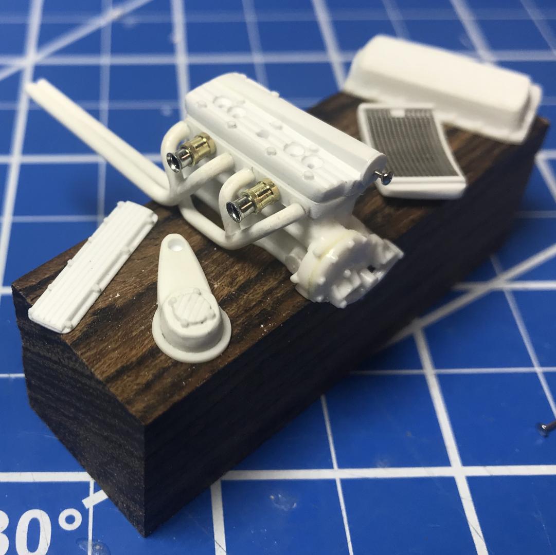

afx Posted February 21, 2019 Author Posted February 21, 2019 (edited) Turns out Erick I had some of those wire ferules in the stash. Had to make a low profile oil pan because of the raised front cross member and still had to notch it for the tie rod. Carefully drilled the distributor to accept wiring. Edited February 21, 2019 by afx
afx Posted February 21, 2019 Author Posted February 21, 2019 (edited) Wanted to use one of these engines but it would require major surgery to get them to fit. Edited February 21, 2019 by afx
