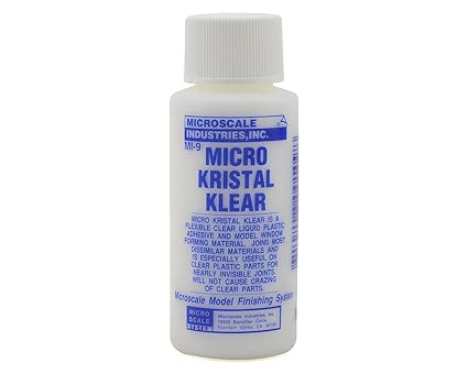

My particular go-to is this:
Image result for micro mark krystal klear
Gator Grip Hobby Acrylic Glue is great stuff too. In addition to attaching glass, you can use it to mock up assemblies to check for fit and whatnot.
I've had great luck lately with Aileen's Tacky Glue, available at Walmart. It seems stronger than Elmers (and way cheaper than Micro Kristal Klear), but can still be removed from styrene or paint if you really need to.
