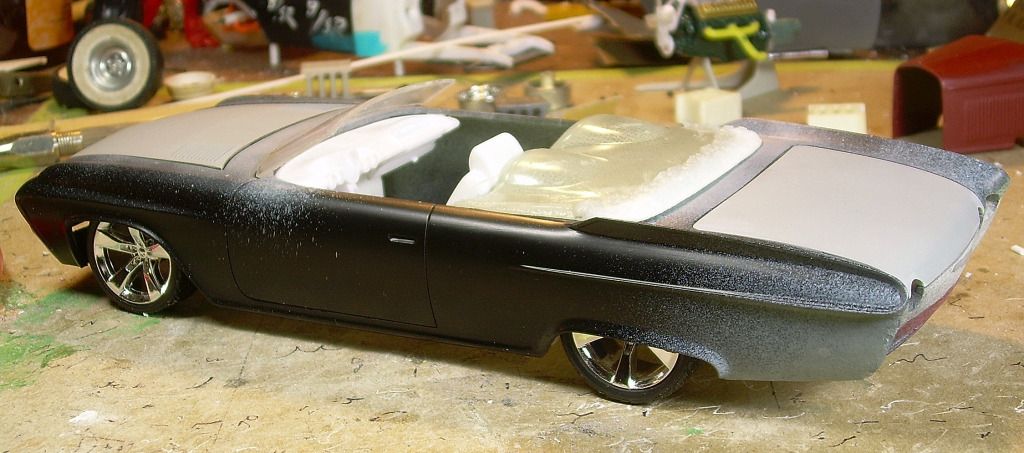

Ace-Garageguy Posted July 6, 2018 Posted July 6, 2018 (edited) On 7/6/2018 at 12:59 PM, jchrisf said: Bill.. two years later what is working for you now? I read the thread and it didn't seem like you had found a solution. Expand One of the main reasons I've stopped building...last Revell '29 Ford body I shot with Duplicolor red "sandable" primer right out of the can crazed so bad, it looked like HEAVY surface rust...and that was NOT the look I was going for. In years past, I learned to shoot my primer slick (which means "wet") so I wouldn't have to do much sanding, and wouldn't have to use a lot of detail-filling coats. I don't like the surface texture, dusty orange peel, if you shoot "mist" coats from a spraycan either. It's shooting my primer wet, after scuffing the surface very thoroughly, that's causing the problem...but ONLY ON THE SOFT STYRENE that most kits are made from these days. I can use my old tried-and-true method on most early Johan, Revell and AMT kits with no ill effects. The '61 Dodge below was shot with SEM self-etching primer (black), one of the "hottest" primers out there. Shot WET. Slick and smooth as a baby's backside. No crazing, no problem. The older 1/8 scale '32 Ford from Revellogram, below, was shot WET with Duplicolor red "sandable". Again, hard plastic, much harder than today's kits, no crazing problem. To answer your question, I have no answer as yet. I'll be experimenting with Steve Guthmiller's recommendations (and variants) as soon as I have the time to invest in a potentially maddening and frustrating series of tests. Edited July 7, 2018 by Ace-Garageguy
