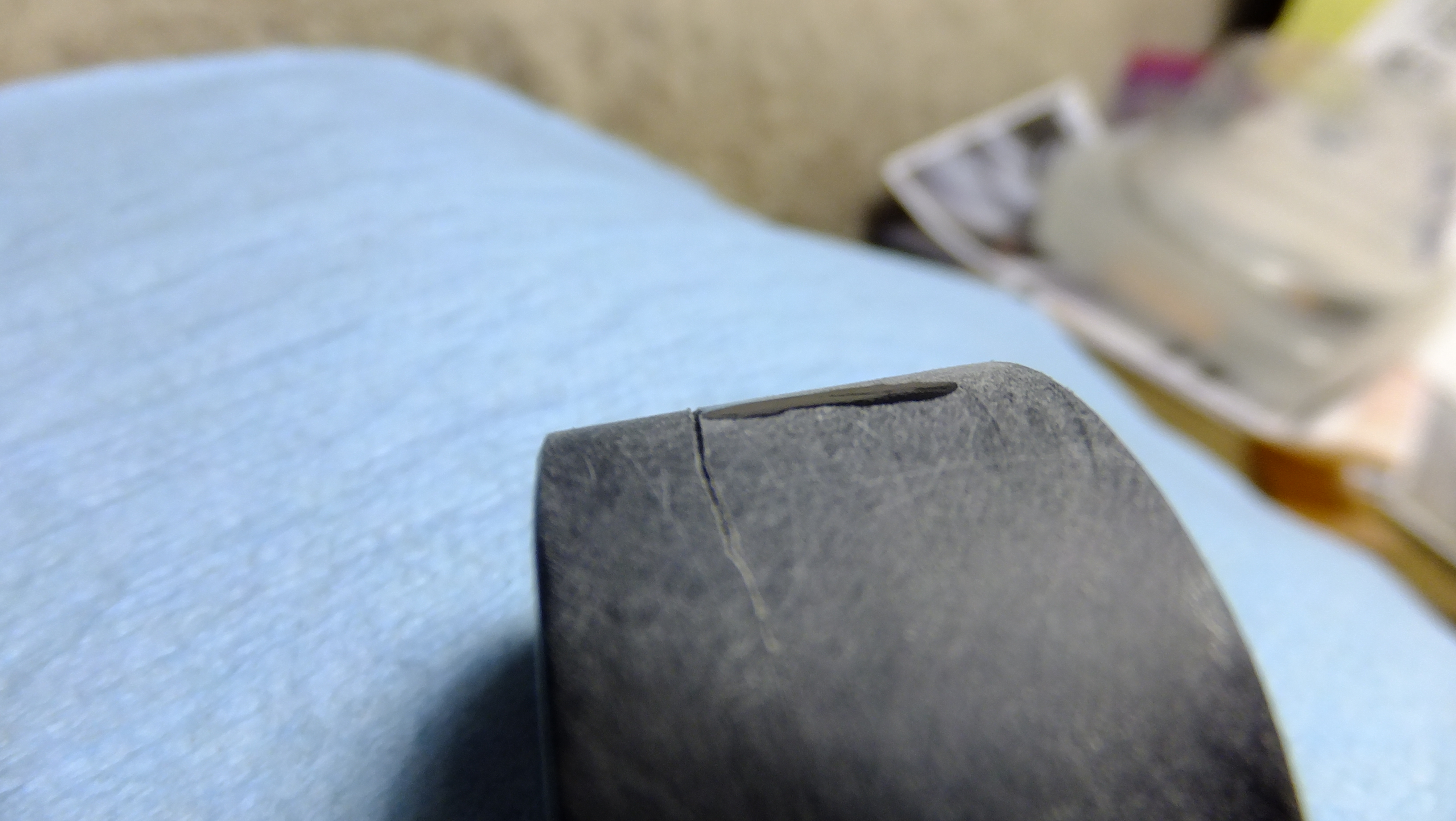

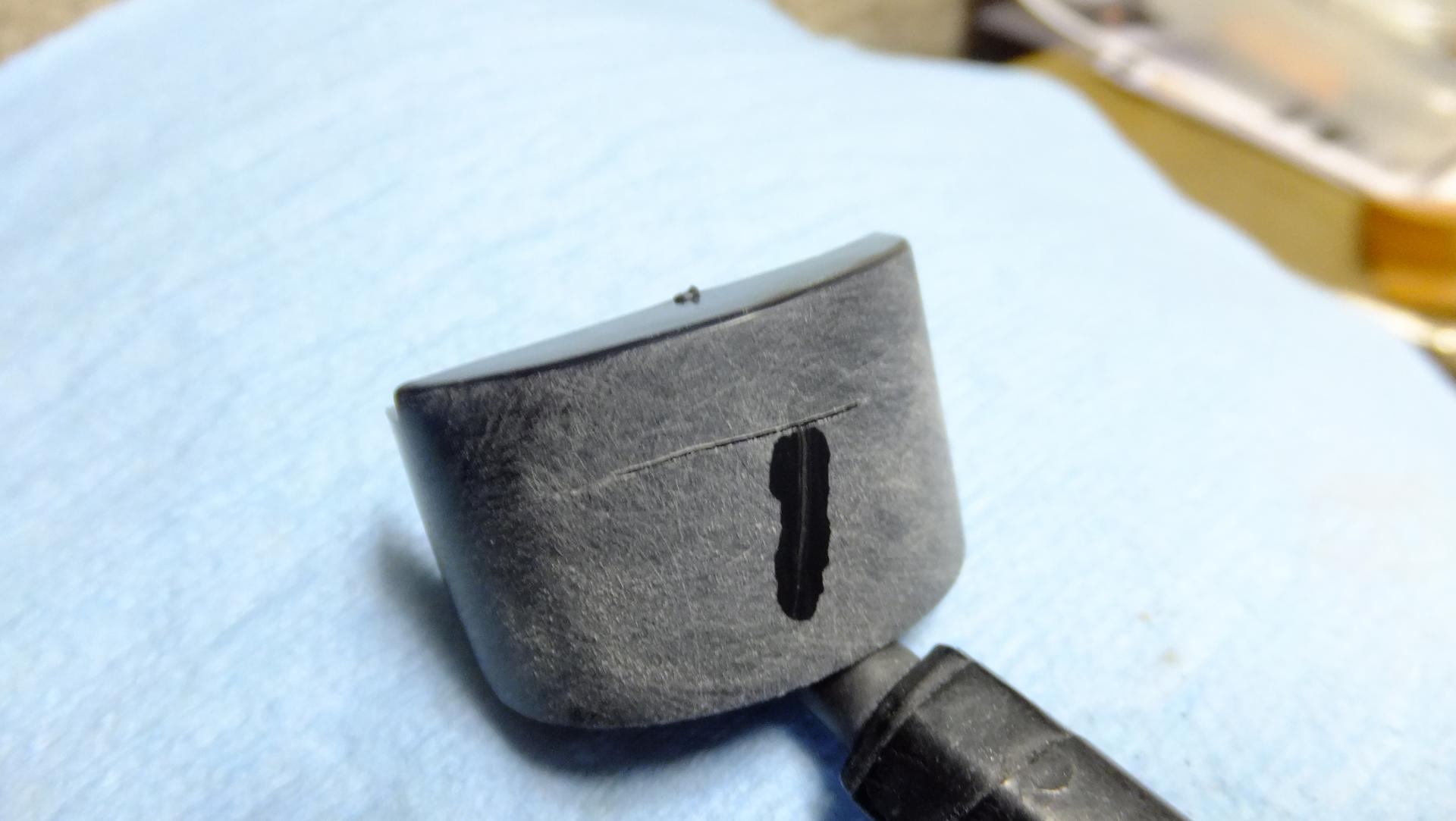

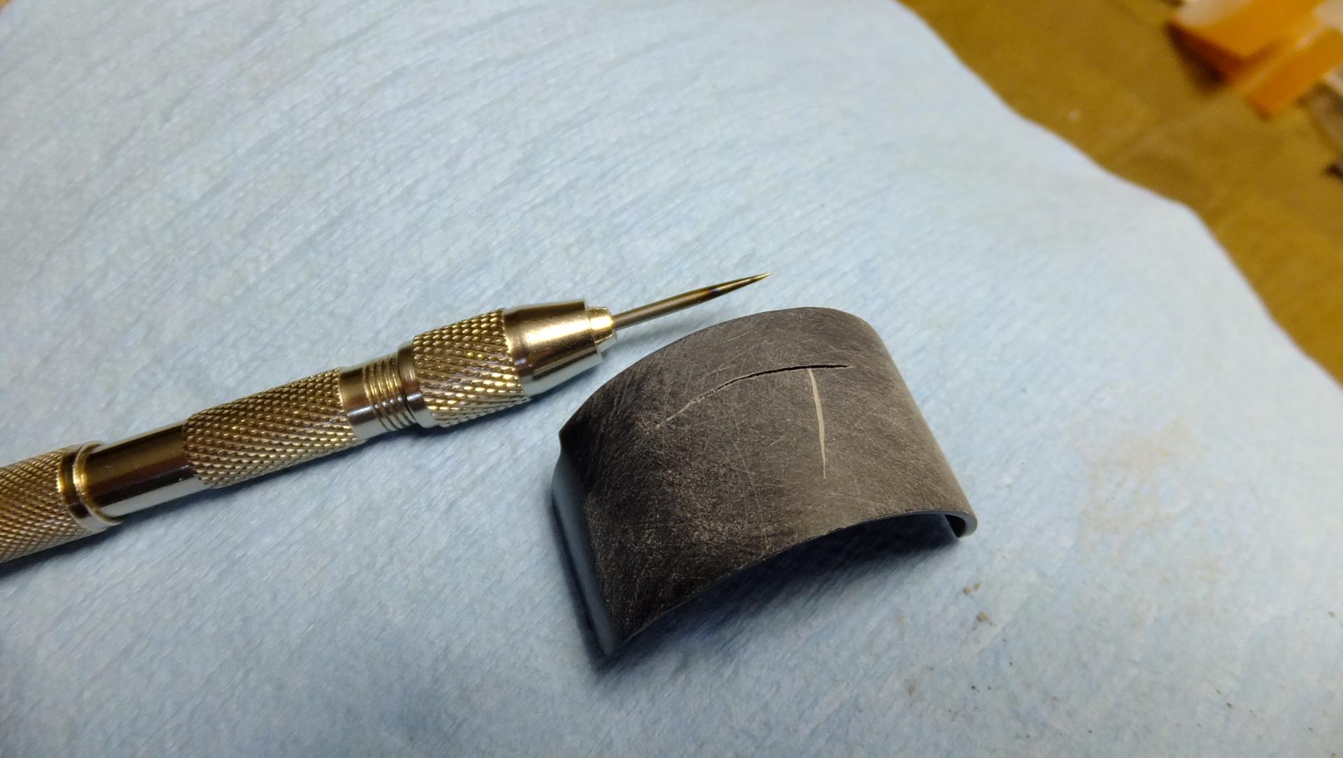

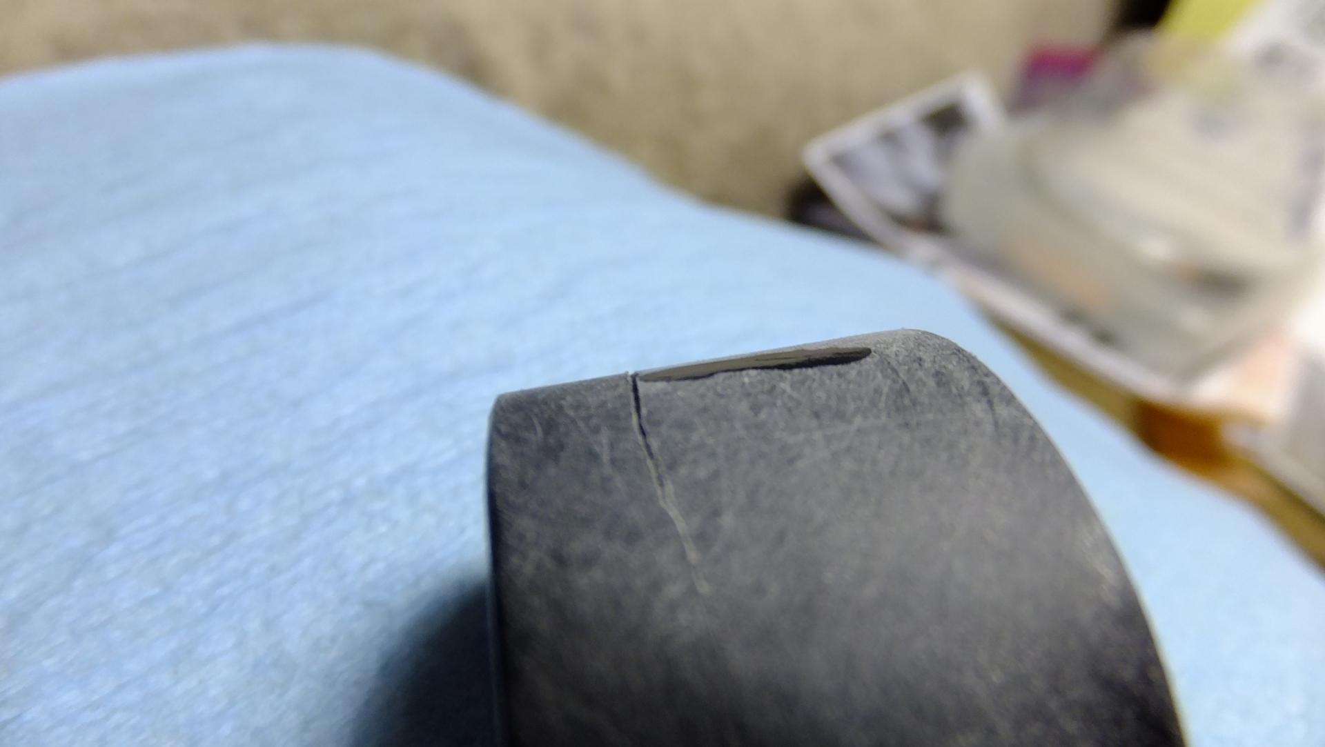

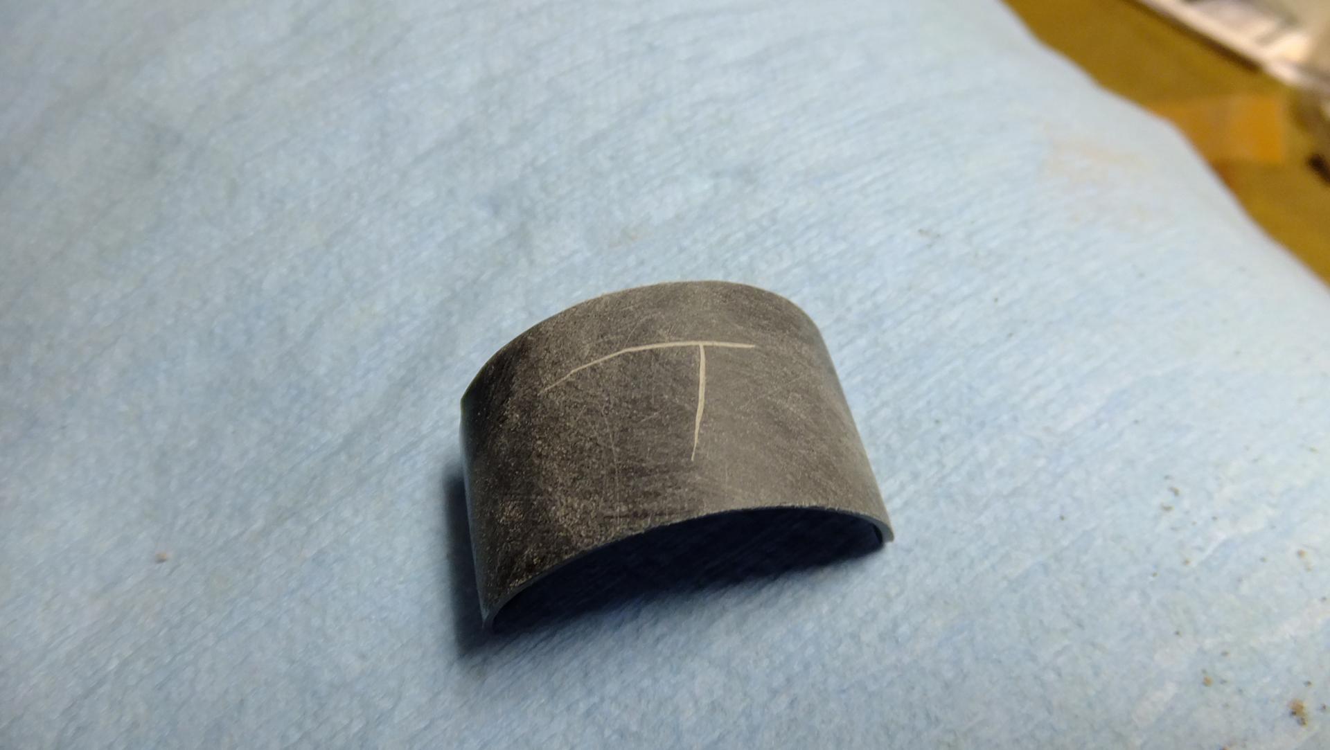

Here you go, Thomas!....
-Photo 1; The demonstrator with two scratches...
-Photo 2; I cleaned out one of the deep scratches with the same tool I used to pronounce the scratches...
-Photo 3; I put a couple of drops of my Plast-Zap CA onto this klear plastic container bottom, and used this tool I made to be able to apply a VERY thin glaze on, so that sanding is easy. I use the long flat side to apply the glue with.....its a broken drill bit that I put into my pin vise backwards, and then carefully ground a sharp angle using my Dremmel, and a diamond Barrel bit.  This is the glue applicator I use the most, and I periodically scrape-off the built up glue with an old blade, and carry on!...…..been using it for 26 years!
-Photo 4; Notice how I was able to get right up against the intersection without flooding it...
-Photo 5; Heres an angle shot that shows just how thin I do it...

Hi Dann, many thanks for your efforts in explaining your process. No doubt about it, I will need to make myself a reasonable glue applicator too... Up to now I habe been mainly using pointed toothpicks, but there's a limit to how well that works.
I have one more question though. Isn't it part of the process to intentionally fill some of the sanded "plastic dust" into the scratches, along with the CA? In your description it sounds to me like you rather cleaned the scratches from dust...?

Hey, Thomas!, in photo 2,  I show only one scratch filled in, but the other was still filled with the dust for me to show you in photo 4....
