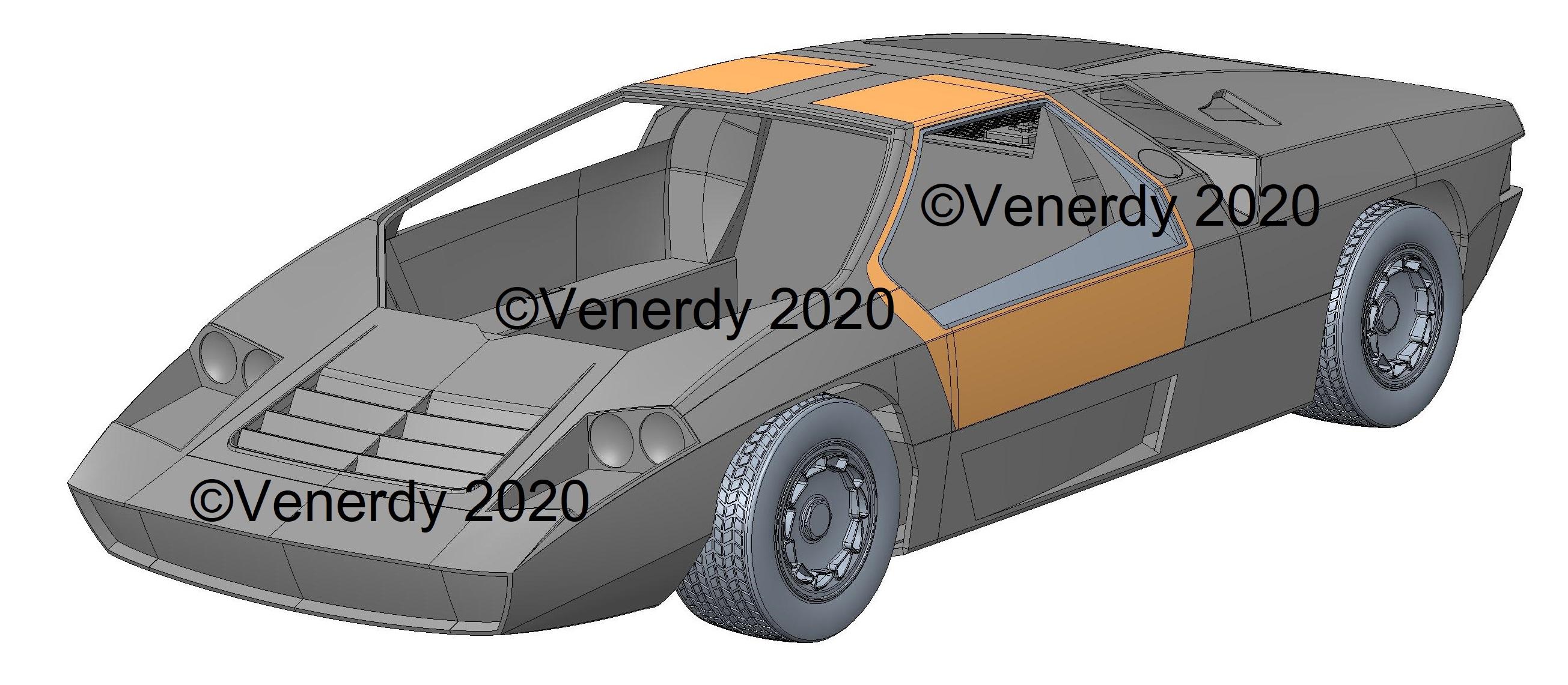

capricorn71 Posted May 7, 2020 Posted May 7, 2020 (edited) Progress to the hood: • window slots • window notch • valve cover • hexagon lattice Edited May 7, 2020 by capricorn71 pictures added

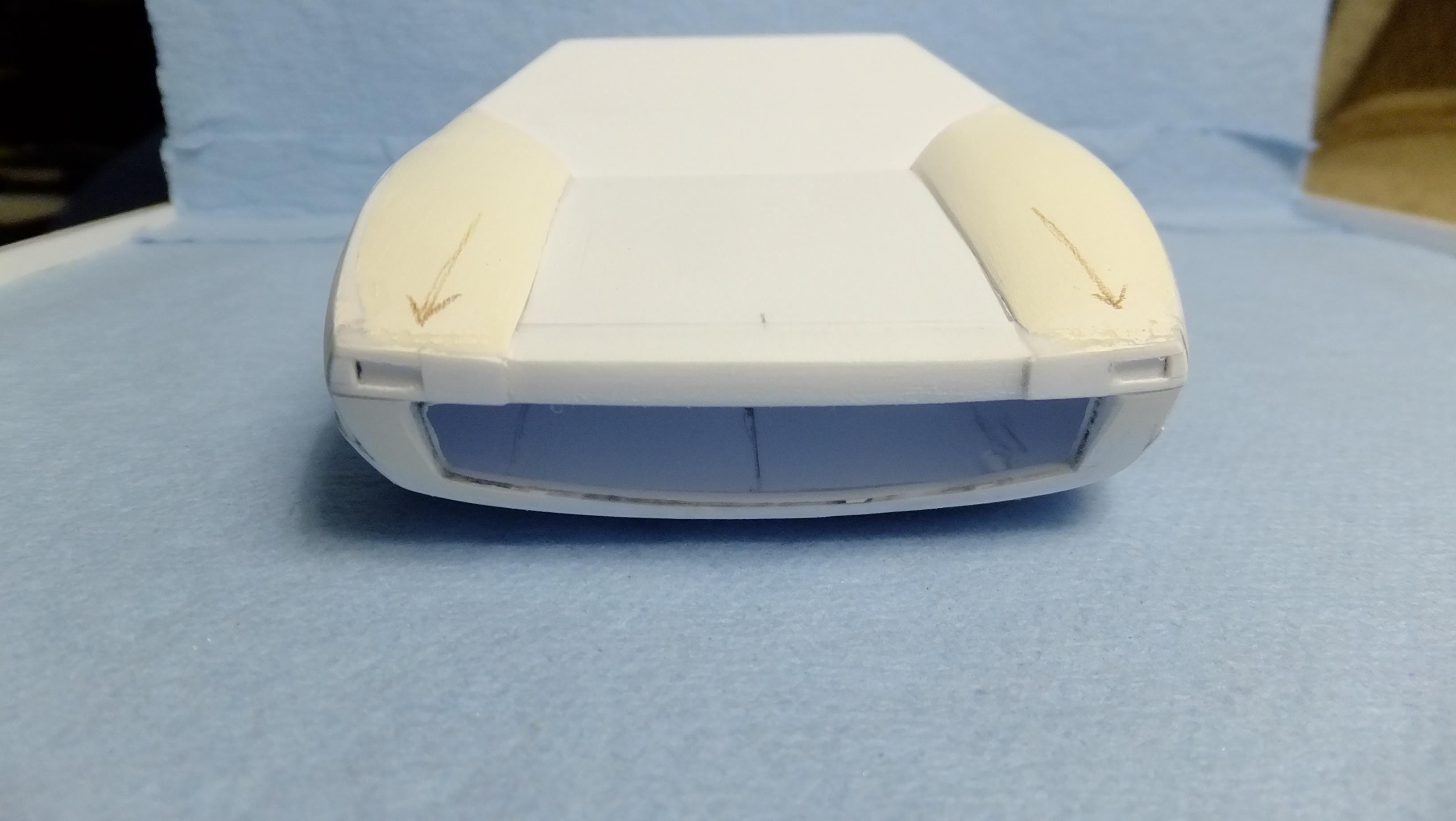

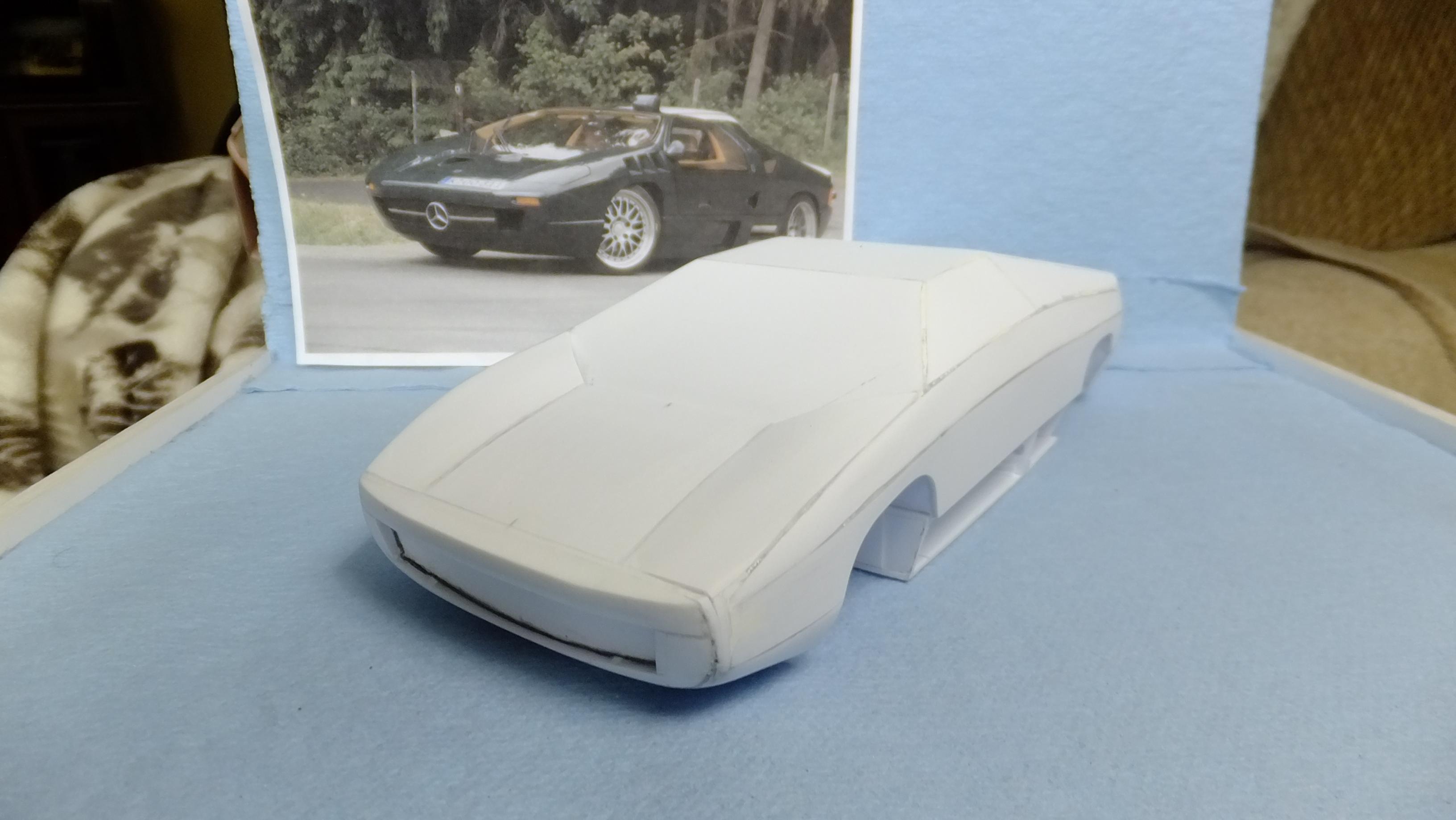

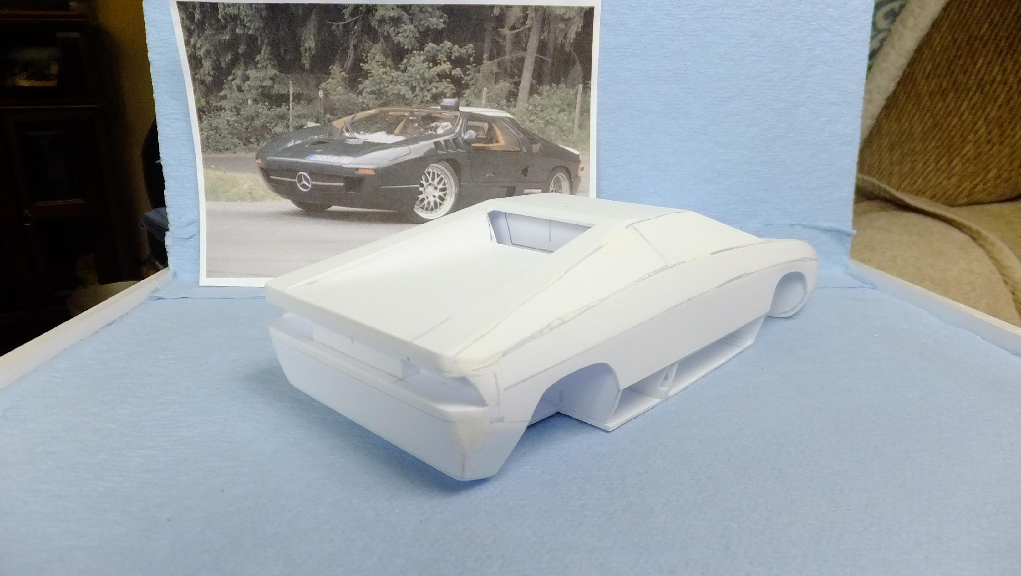

Dann Tier Posted May 9, 2020 Author Posted May 9, 2020 (edited) Hey, everyone!, i've got some great updates here!!...its going like MAGIC!!!! -Photo 1-5: Apart from the wheels, this 1993 version is my inspiration. Now that the main thing is done, i can start tweaking it into shape. -Photo 6; Here you can see all the supports i used...i eliminated the rear one, but the others will stay until after the bodies final sanding. -Photo 7; Time to add Milliput to the top of the fenders, and to properly frame in the windscreens shape. -Photo 8; These areas are too flat, so i will add styrene to them, and shape them. -Photo 9; These lines show how i need to shape the front fascia. -Photo 10; This area is too flat, and needs to be angled back. -Photo 11&12; I knew i would burn through, but no biggy....thats what putty is for!! -Photo 13; Sketched out some things just because, and added some styrene to keep the fender putty in place away from the windscreen. -Photo 14; It was nice to cut the mouth open finally! -Photo 15; Sometimes i even mask 0ff the areas to be puttied. -Photo 16; Open, and ready for intercooler detail! **next steps; shape the front fenders...add front indicators...make rockers...final sand, and then open all windows, vents, and doors!! Edited May 9, 2020 by Dann Tier

Dann Tier Posted May 10, 2020 Author Posted May 10, 2020 (edited) Hey, everyone!, as far as the bodies construction is concerned, i'm done....next two steps will be softening the edges, then start cutting open the windows, and vents! -Photo 1; The Milliput worked a treat for those fender arches! -Photo 6; To recreate body details, i added tint square stock, then filled it in with Tamiya putty, and blended it in. -Photo 7; Using tiny bits of styrene, i needed to make the front indicator surrounds. -Photo 8; Three things happened here...one; i needed to add a crossmember to the top of the cowl...two;after i cut open the cowl, i need to remove a section for a proper window area, and i also needed to straighten out the inner edges of the sail panels. Edited May 10, 2020 by Dann Tier

capricorn71 Posted May 11, 2020 Posted May 11, 2020 I added some details to the hood: - Isdera logo and eagle - wheel housings Also I started to detail the inner side of the doors

capricorn71 Posted May 12, 2020 Posted May 12, 2020 While Dann has a real model in the works I am still tweaking the CAD files. The door panel is quite ready.
