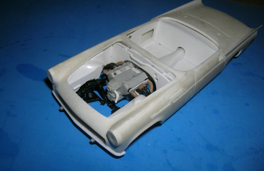

Ralph Henderson Posted September 8, 2018 Posted September 8, 2018 (edited) I haven't been around for a while. I've been lurking off and on, but haven't been building much. Recently I got the bug, and decided to attack a project I've been thinking about since I saw the Hot Rod article back in the early 90's. So I figured I'd show what I've done, and hopefully, where I'm going First thing that has to go, is the AMT 57 Grille/Bumper Assembly. That looks an awful lot like the grille in the AMT 56, so. I took a pretty clean 1st issue 57 and started sanding and grinding and filling until I came up with this. I cut the sheet metal out of the engine compartment, and started work on the frame from the 56. As others have mentioned, the AMT 56 seems to sit high on the frame, a little too much frame shows beneath the rocker panels. the next few photos show how much I had to shorten the underhood and interior sheetmetal to get the frame tucked up inside the body like I think it should be. I also opened up the area behind the fenderwells for the outside the frame header routing. I also moved the front perches for the rear springs from the interior plate to the frame to make it easier to buildup the frame as an assembly A little preview of the rear rolling stock, those neat old AMT slot car tires-Firestone "Gum-Dipped" 9.00-9.50-15's More soon...Comments and suggestions welcome! Edited December 26, 2018 by Ralph Henderson left out text.

Ralph Henderson Posted September 10, 2018 Author Posted September 10, 2018 Thanks for all the kind words. I have to say, it can get a little intimidating for a mere mortal as myself to post his work among all the stellar builds on this and other forums. But we all learn from each other, right?? I know I've learned a lot here. And it's given me the confidence to try new things. Thanks again. thought I'd show a couple more pics showing a bit better detail on what had to be done to get the 56 grille to fit in the 57. From the underside looking forward you can see where I lengthened the corners, (about 3/16") to match the height of the grille: next you can see how plastic much was removed to re-shape the nose. so far no filler, just liquid cement and styrene stock. the next shot showa what happens when you try to remove the bumperettes from the 57 grille assy Other nice thing about the 56 grille, is it actually has a lip that surrounds the recess in the sheet metal. Fits and looks a lot better. another shot to show the new bedding. Still a little filling to do, and I have to figure out the little spoilers on the ends under the headlights, but it's coming along. soon some shots of the engine mods, and suspension stuff.. found some springs to replace the block of plastic in the front end, and raised the spindle to lower the front end. plus a shot of the hilborn injection I'm trying to replicate..

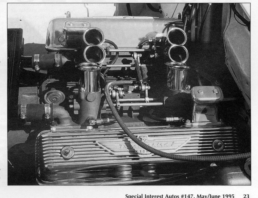

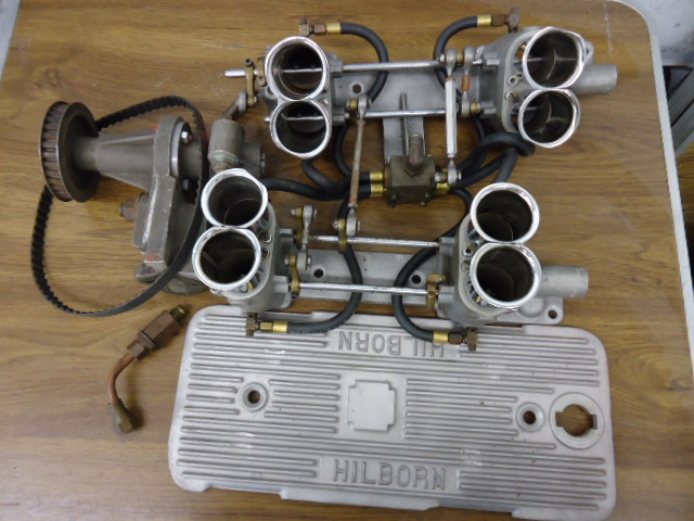

afx Posted September 10, 2018 Posted September 10, 2018 (edited) Glad you're pushing yourself. For years I was intimidated at the thought of scratch building and/or major modifications. One day I decided I had really nothing to fear and jumped in. Really increased my enjoyment of the hobby. If I can ask what is your plan for the unique Hilborn injection? Are you scratch building it? Edited September 10, 2018 by afx

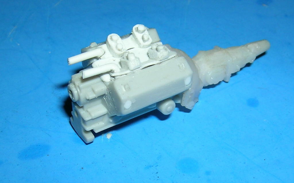

Ralph Henderson Posted September 10, 2018 Author Posted September 10, 2018 at this point, scratching it. here's a couple pics of 'rough draft'. using 3/32" aluminum for the stacks. it looks better with the stacks on. I have a couple other thoughts too, and any suggestions welcome.. and I may use the engine out of the new Revell 57 Ford. On this I grafted the bell housing and trans from the old tool revell parts pack 427.

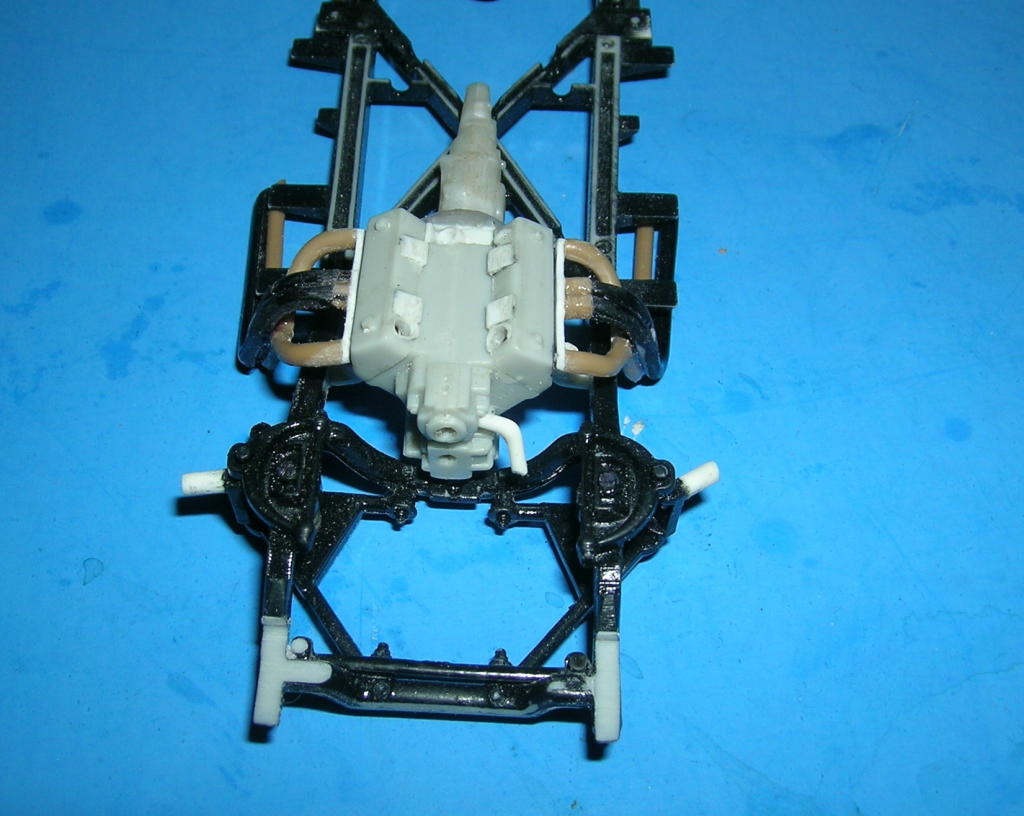

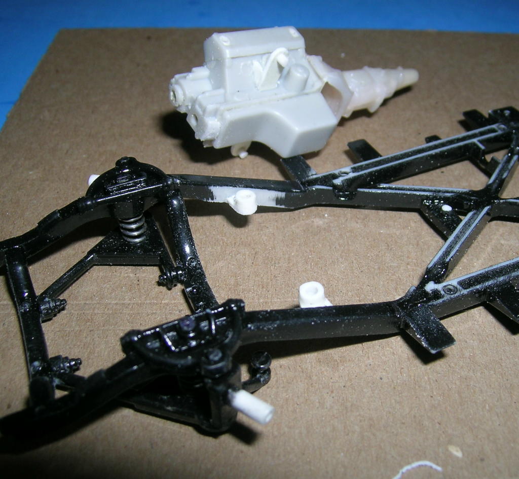

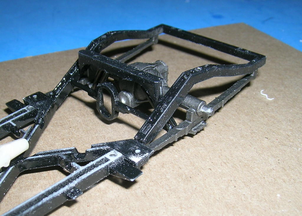

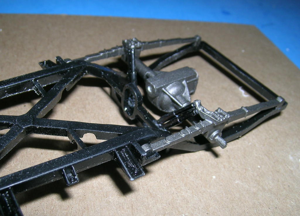

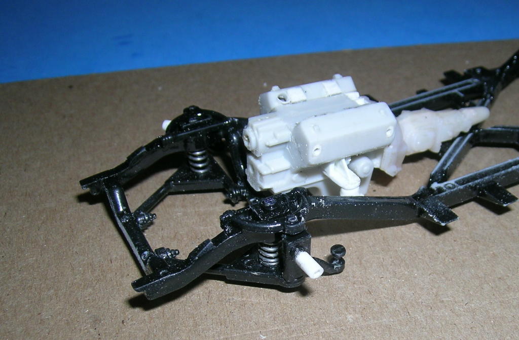

Ralph Henderson Posted October 18, 2018 Author Posted October 18, 2018 So, I build pretty slowly. I seem to be more interested in "little Victories", than the sum of the parts. The real car had a quick-change and dual shocks. The amt kit didn't come with spring plates or rear shocks, so I checked the Fireball Roberts 57 Ford to see how they did it. Come to find out there is an extra set of dual shocks and the corresponding spring plates in the kit. I picked up a nice q-c and grafted it in the rear axle, and added a cross member and voila! dual rear shocks and a quick change! I added the necassary drive shaft hoop.. I then decided to come up with a bit better way to mount the engine. A little bit of evergreen, and some more eyeball engineering came up with this; Now I can get onto the headers and finishing up the interior... Thanks for looking!

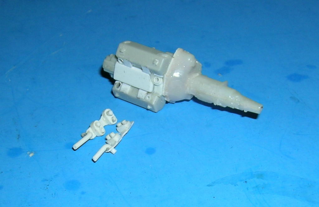

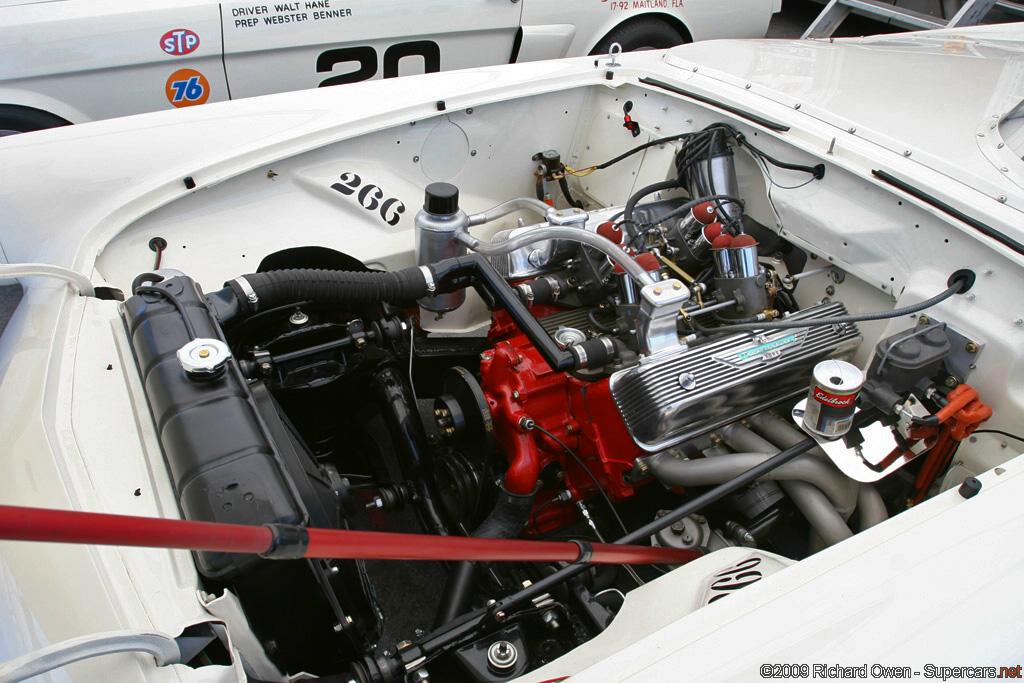

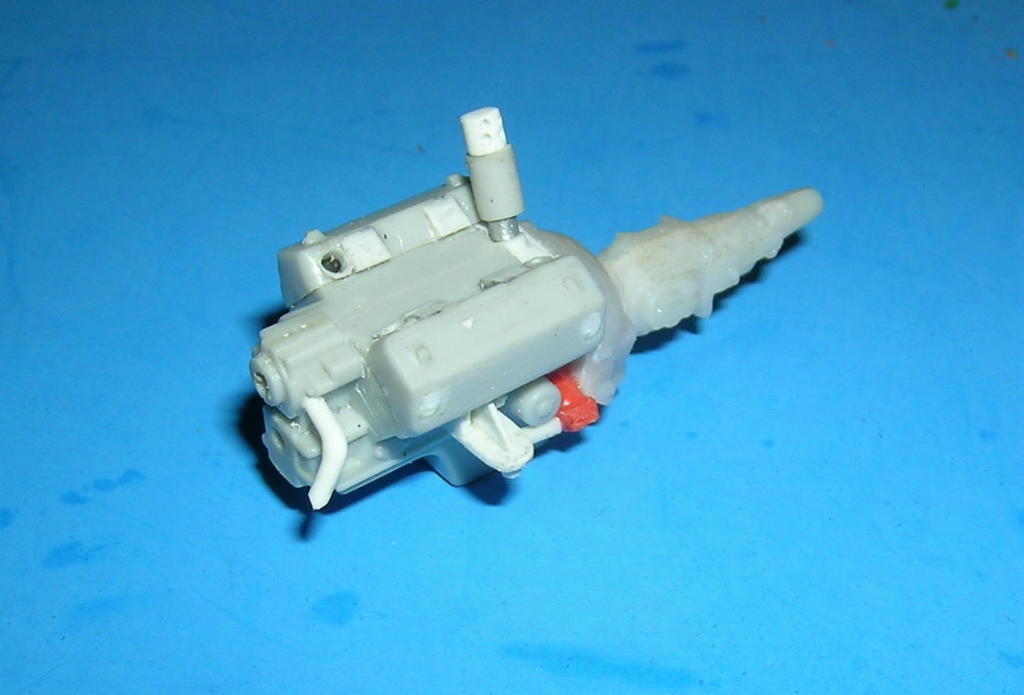

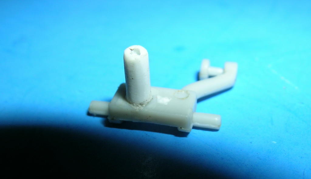

Ralph Henderson Posted November 30, 2018 Author Posted November 30, 2018 (edited) Hi folks, been trying for a few days to add an update. see if this works. so far, so good. something that always bugged me about Y-Blocks in scale was the distributor. They are mounted at a 45 degree angle at the back of the block, not a 90. so I did a little scratchin' and came up with this. then added the oil pump and pickup tube More soon, Thanks for looking! Edited November 30, 2018 by Ralph Henderson

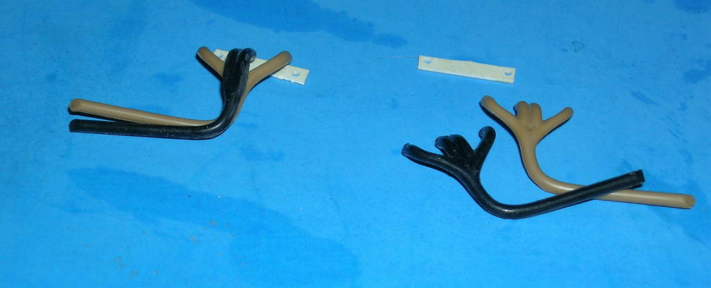

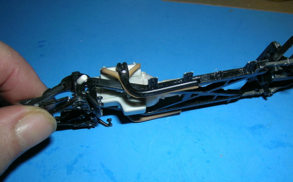

Ralph Henderson Posted November 30, 2018 Author Posted November 30, 2018 Now on to the headers. The headers on the real car are 4-2 type, then out to two pipes exiting in front of each rear wheel well. I took a couple sets of AMT 32 headers, a little slicin' and dicin' and came up with this. still have to section a bit out of the pipes to get 'em a bit closer to the frame, but I think I'm on my way. again, Thanks for looking!
