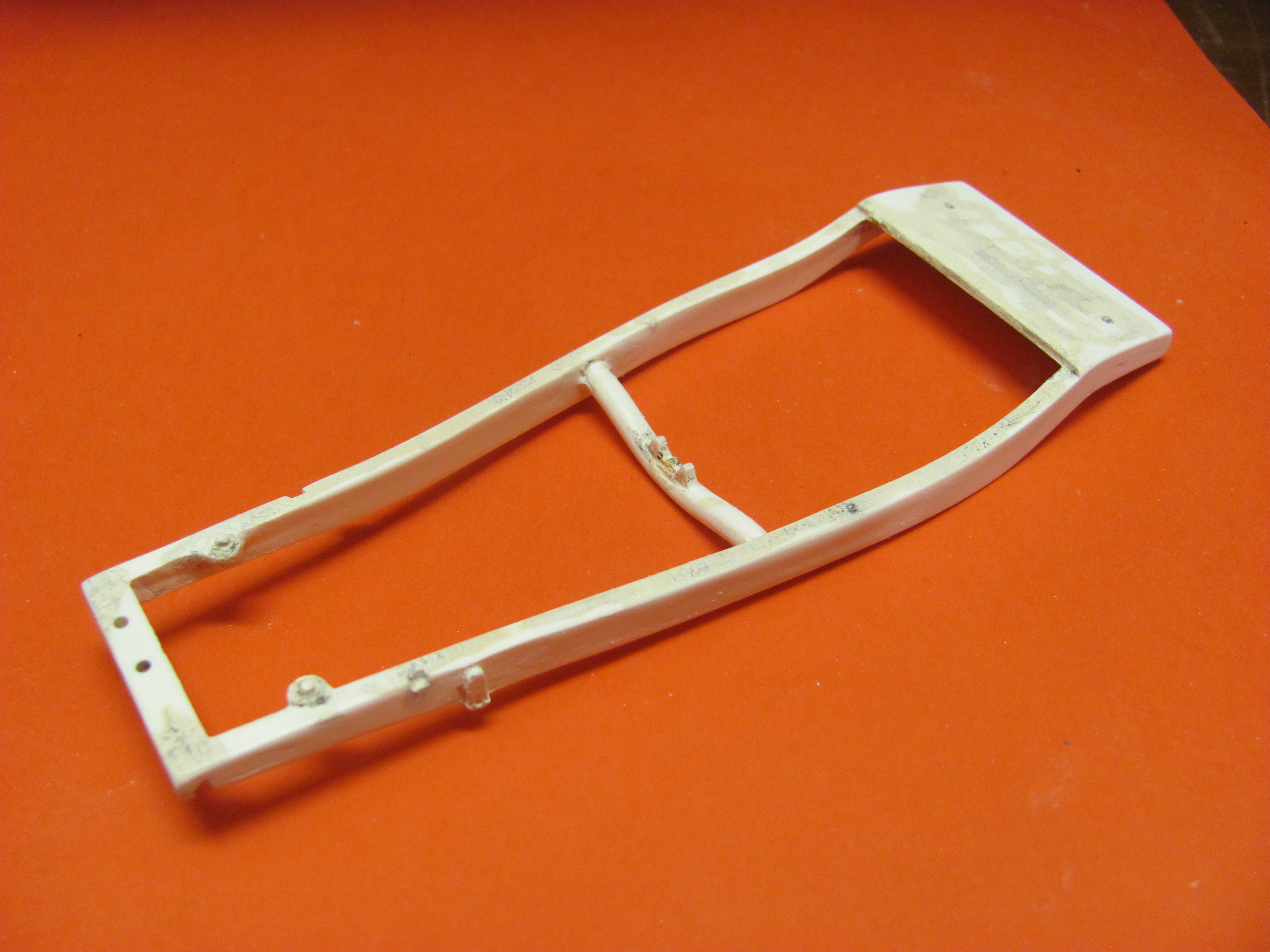

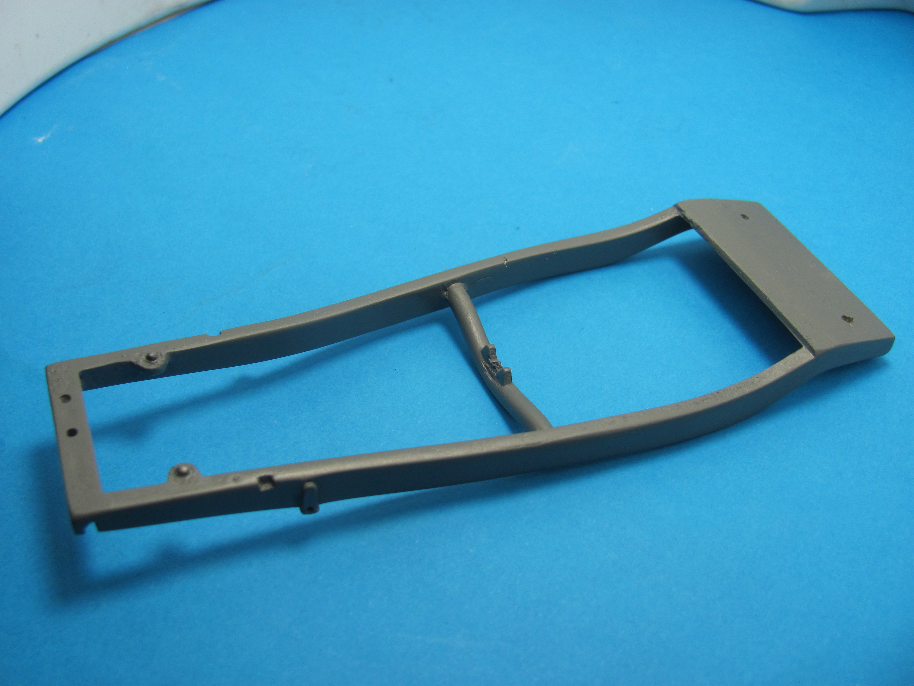

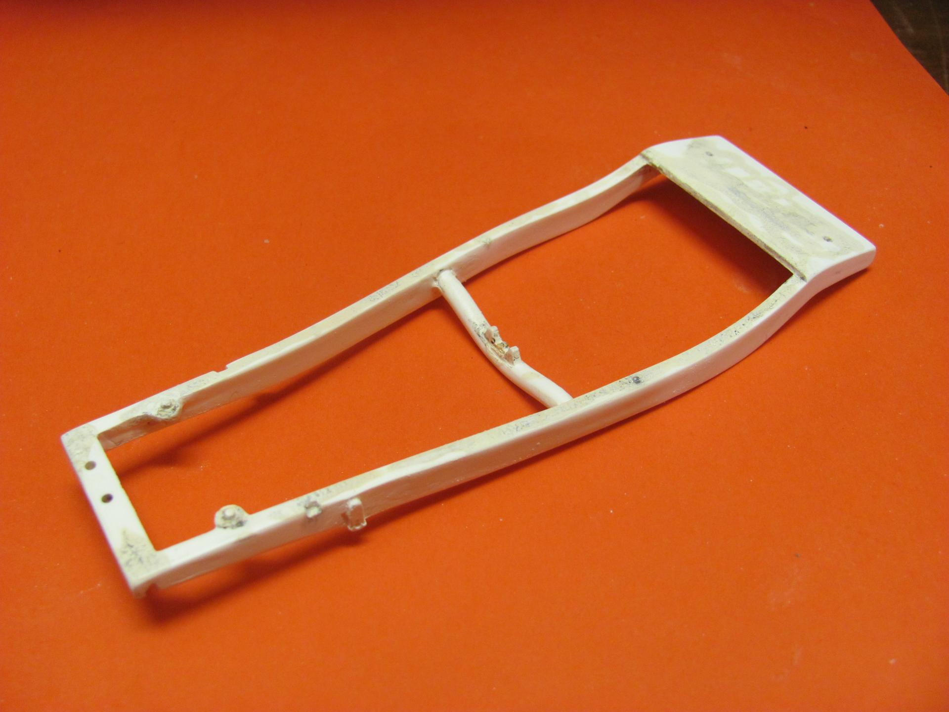

Alan Barton Posted January 5, 2019 Posted January 5, 2019 I blame Greg Myers entirely for this one! Seeing that gorgeous pearl white AMT 32 custom Tudor in the General section got me thinking about the various bits I have gathered over the years. So now it looks like I'm starting yet another new project. First off, here's the chassis. I had paint stripped it years ago but I had to remove plenty of glue as well. It was fairly glue bombed (check that rear panel!) and had massive sink marks along the length of the frame but it wasn't badly damaged and didn't take more than an hour with putty and sandpaper to get looking good.

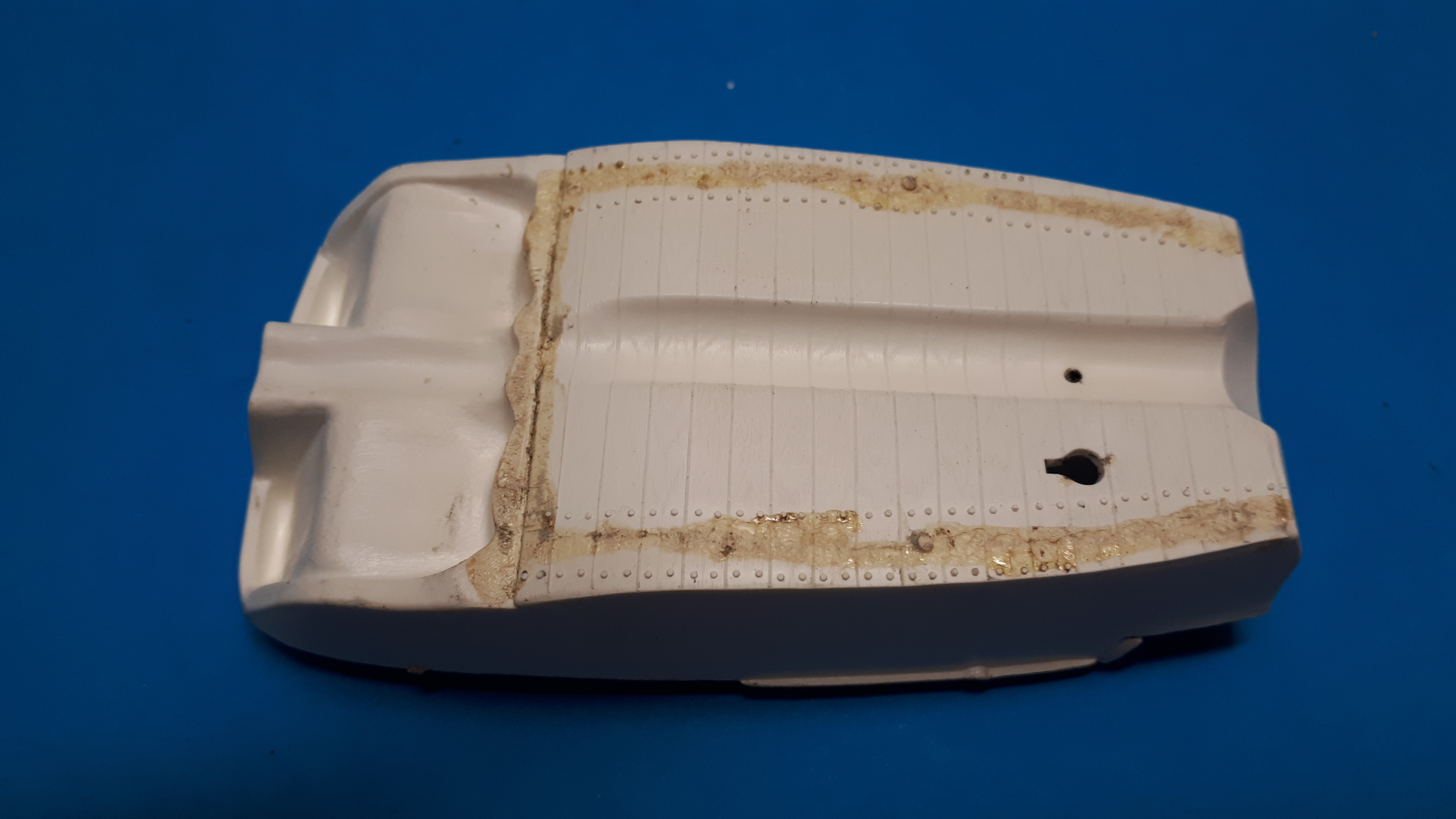

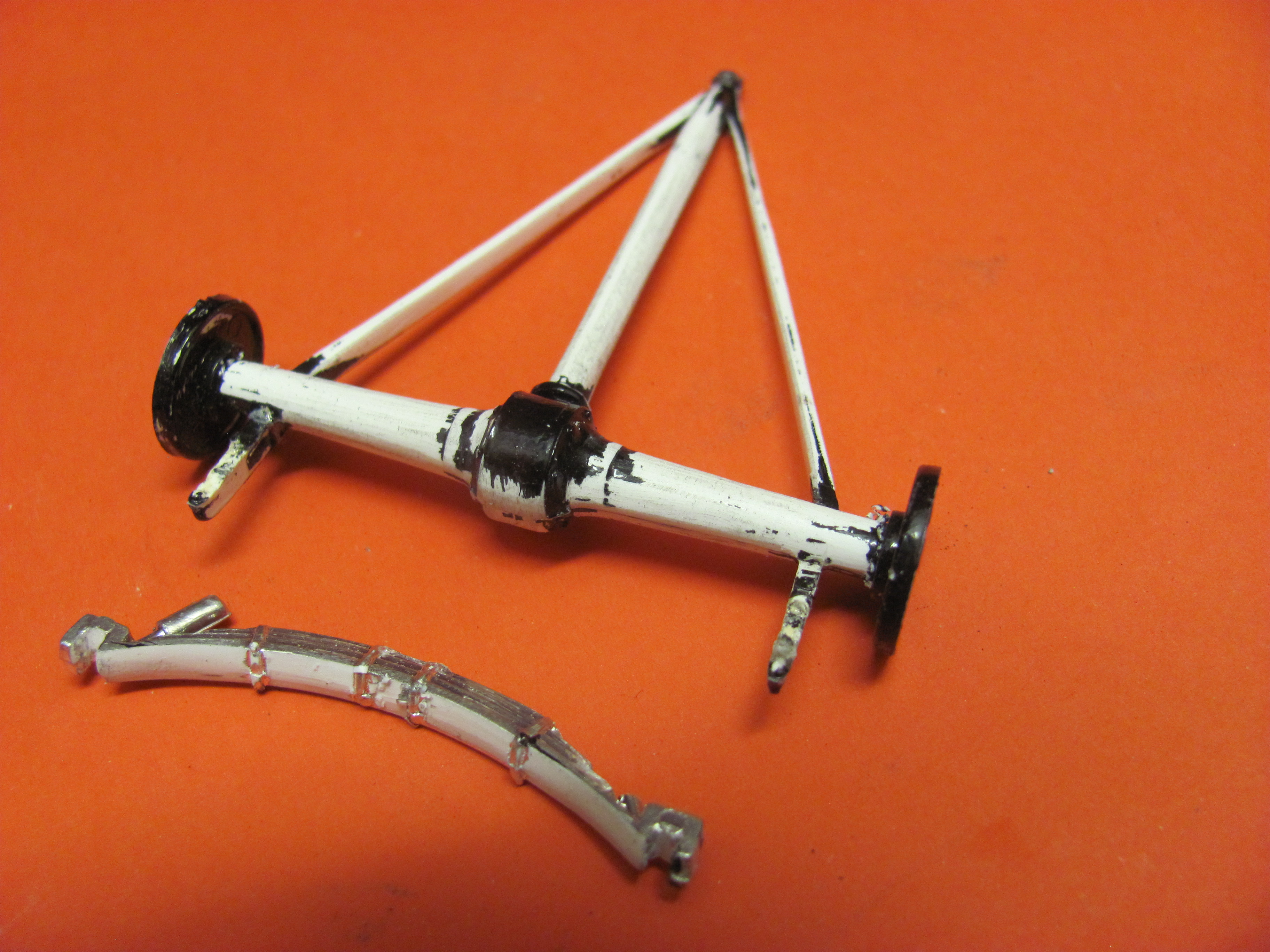

Alan Barton Posted January 5, 2019 Author Posted January 5, 2019 I didn't even know I had the rear end until I went digging and found this. I used an X-acto and sandpaper to strip this part because it let me massage the shape of the radius rods while I was at it. Had to re-glue a spring perch but otherwise it was good to go. I also scraped the humongous mold line of the main spring leaf and will replate it with my beloved Molotow pen.

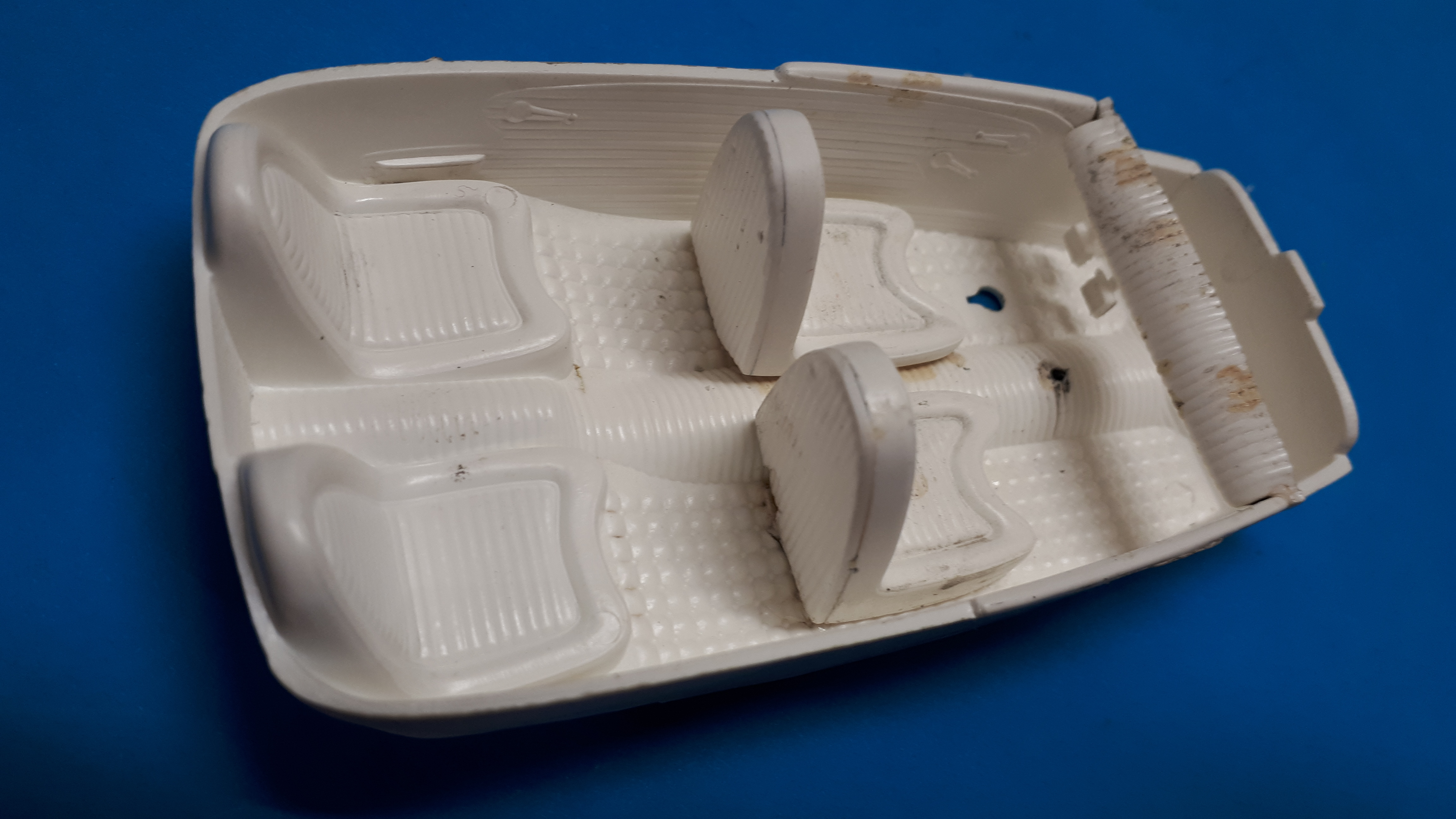

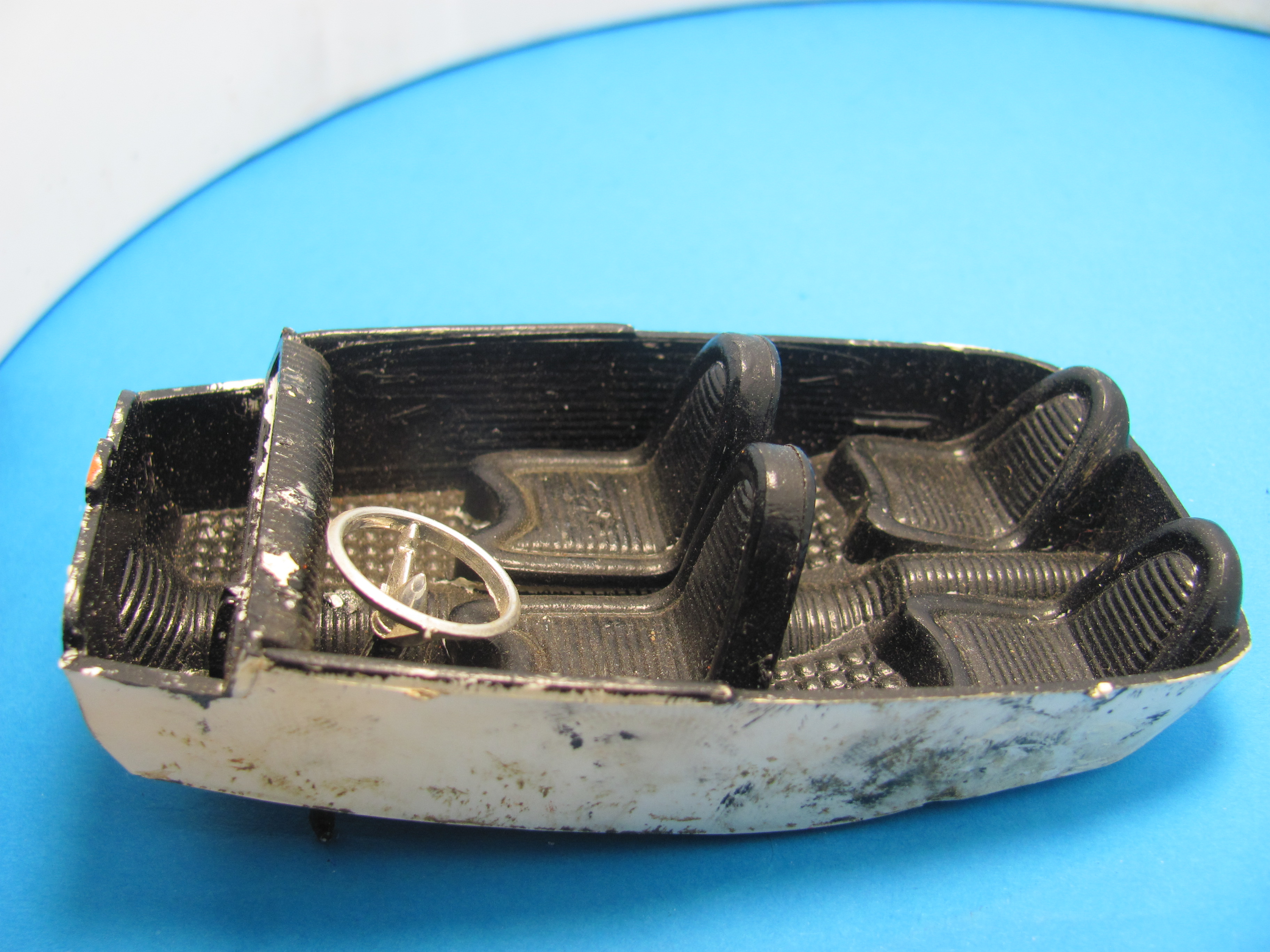

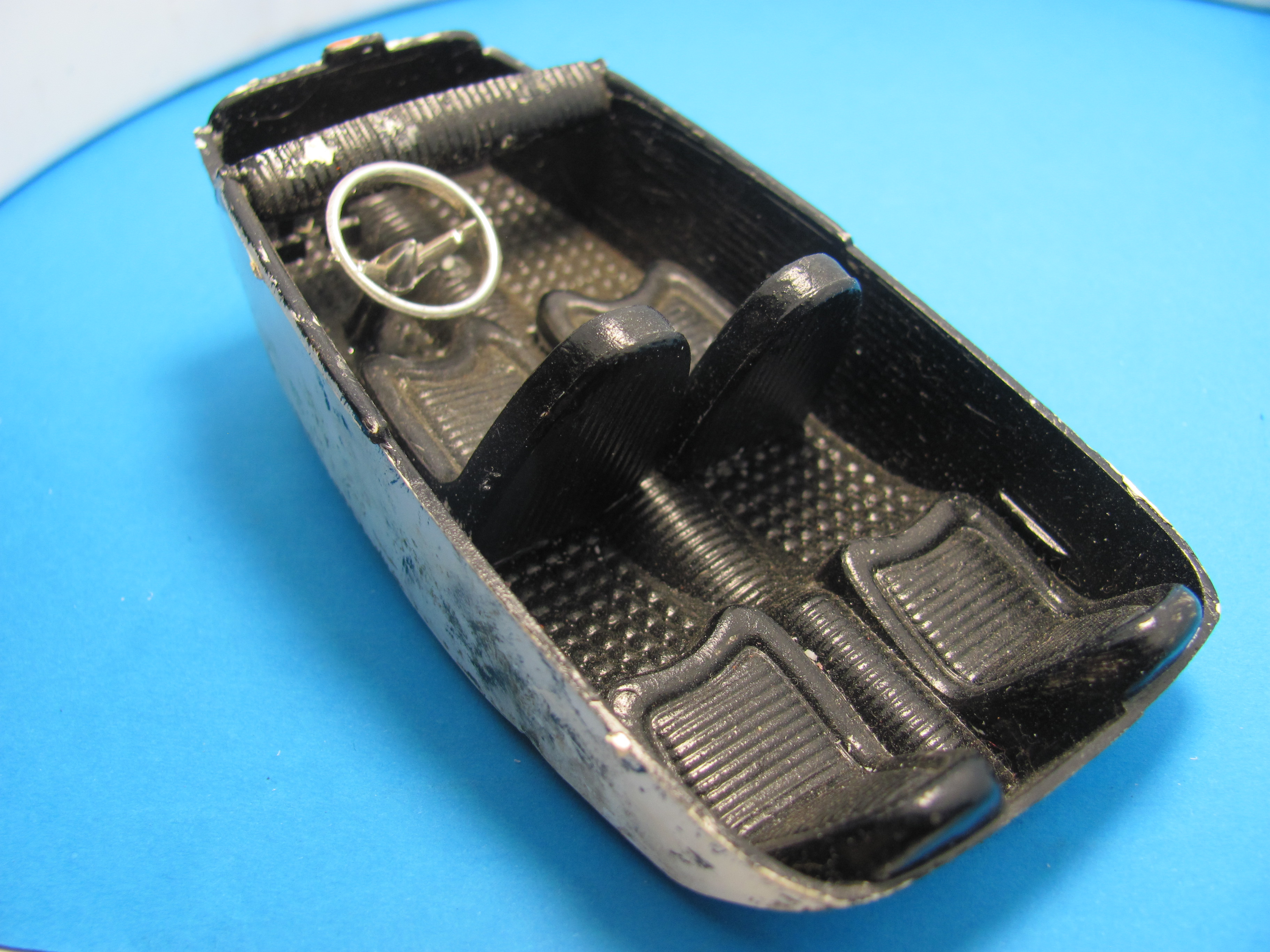

Alan Barton Posted January 5, 2019 Author Posted January 5, 2019 The interior is complete including the instrument cluster not shown here. It appear to be brush painted with Humbrol Gloss Black so that is sitting in my caustic soda bath as we speak. I don't expect it to strip overnight - Humbrol black and yellow always seem to take longer to strip than other colours.

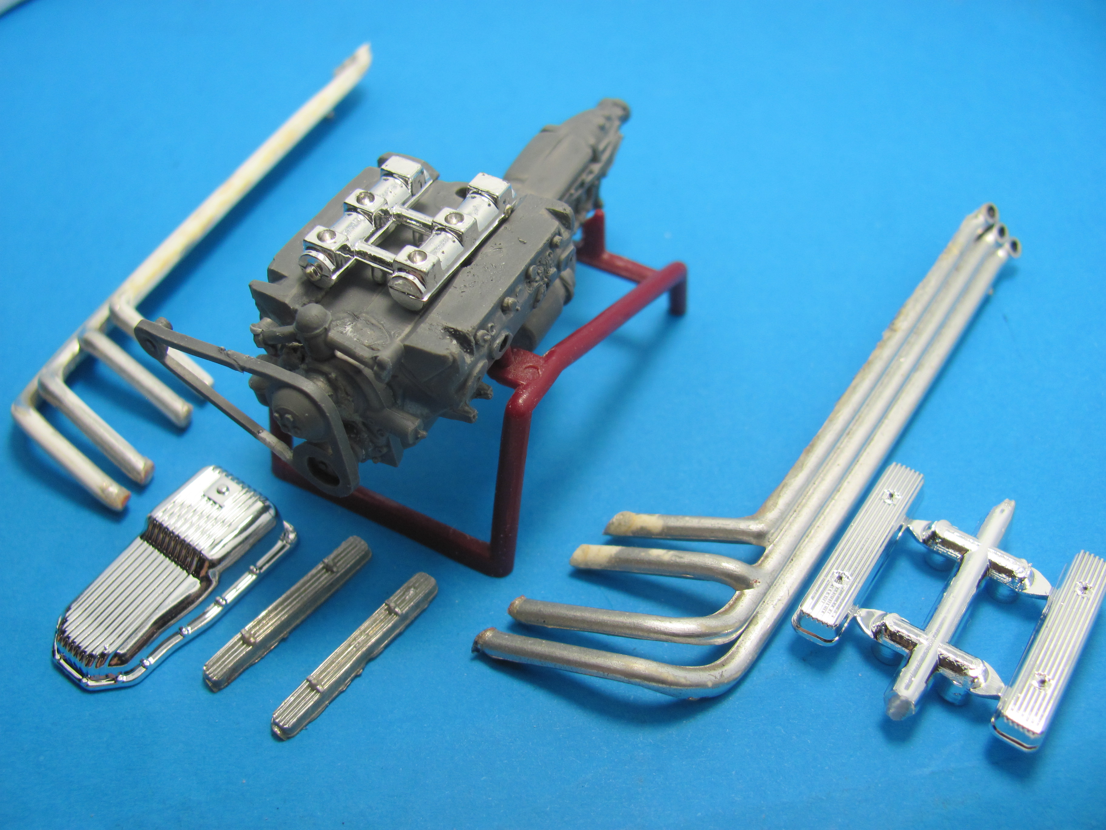

Alan Barton Posted January 5, 2019 Author Posted January 5, 2019 Digging through my Buick box I found the original engine - I must have had plans for it once before because I had already stripped and primed it. I still had the original spark plug covers but will general freshen it up with new rocker covers and oil pan form the Revell Model A Hiboy kit. I just rechecked Greg's Internet photo and I have a hunch I have the original carbs and ram horns somewhere.

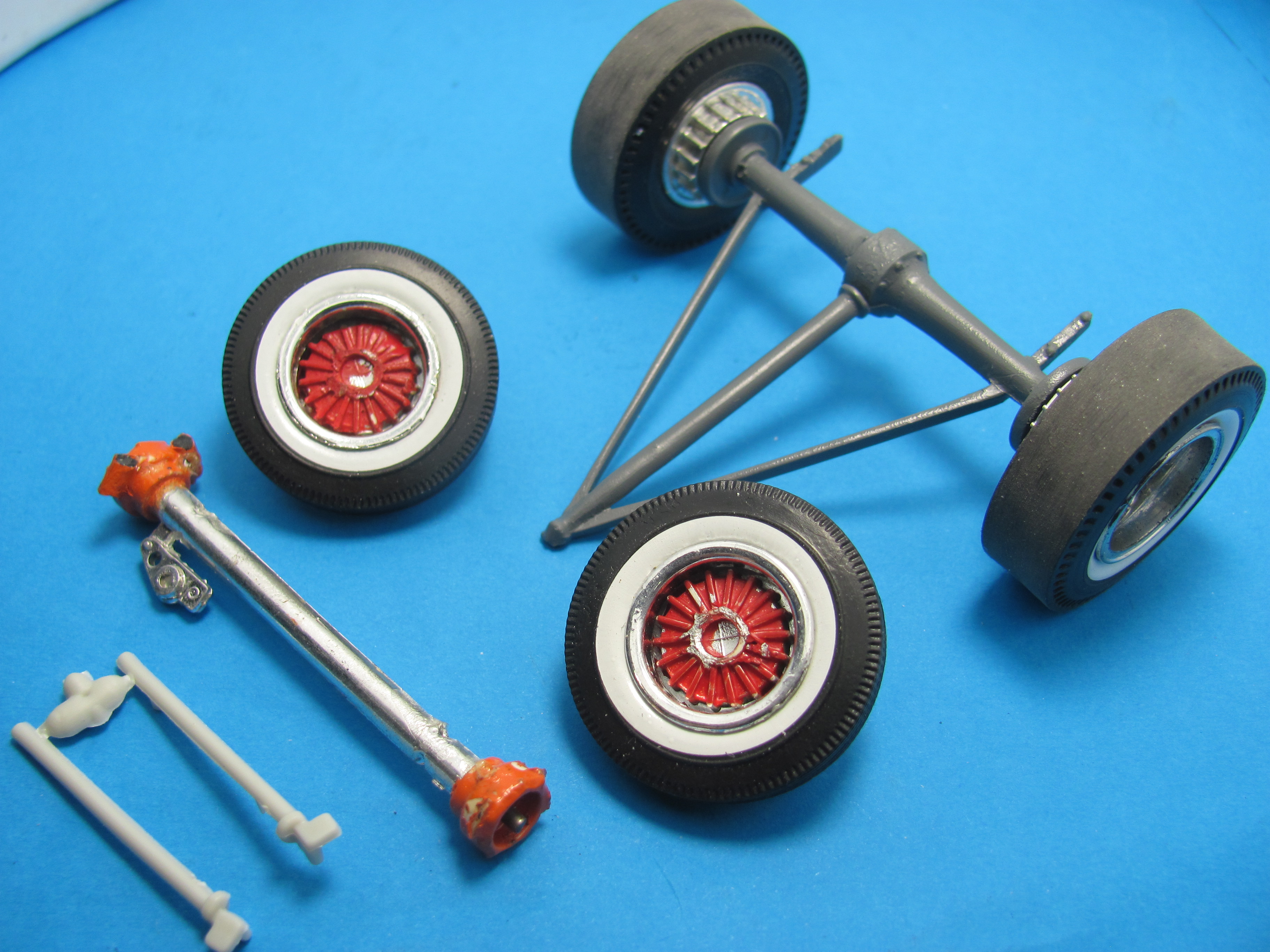

Alan Barton Posted January 5, 2019 Author Posted January 5, 2019 I found the original front axle but it is missing one of the torsion lever arms - shouldn't be too hard to scratch up a replacement. The original torsion bars are long gone but the ones from the Iron Lady 32 Vicky kit should do the job. The rear axle has come up nicely with primer and just needs some final fine sandpaper to be ready for paint. I thought I still had a full set of clean-ish wheels but found two reasonable ones and these two with red centres - thank goodness for Molotow! Round 2 AMT parts Pack tyres will be perfect for the job.

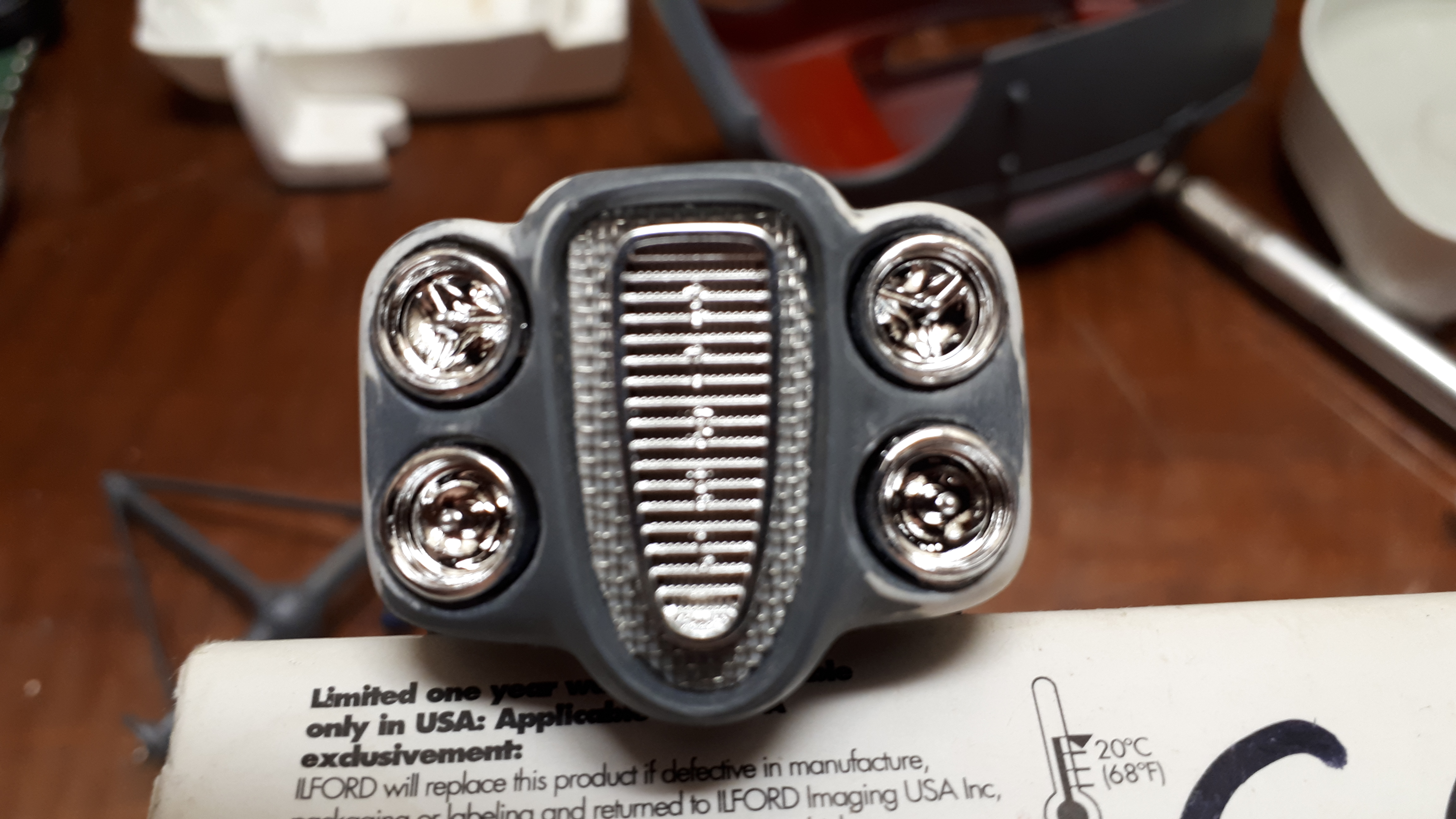

Alan Barton Posted January 7, 2019 Author Posted January 7, 2019 Thanks for the interest , guys! I have been talking to Muncie who has been full of information and assistance and he told me that the original headlight bezels were in the Blueprinter Grilles Parts Pack. Opened it up and there they were along with an Edsel grille which is apparently slightly different to the Double kit unit. So I went looking for the original nose and as I expected I found it on this long stalled 3 window. This is the old Monogram Beachboy's coupe (I think Snake45 would call it a backbirth!) but it was the only thing available when I started it. It is intended to be an east coast show car. I will concoct something new for the coupe - I always thought the custom headlight units form the 66 Corvair would make a startling custom nose piece so we will see what happens there. Cheers Alan

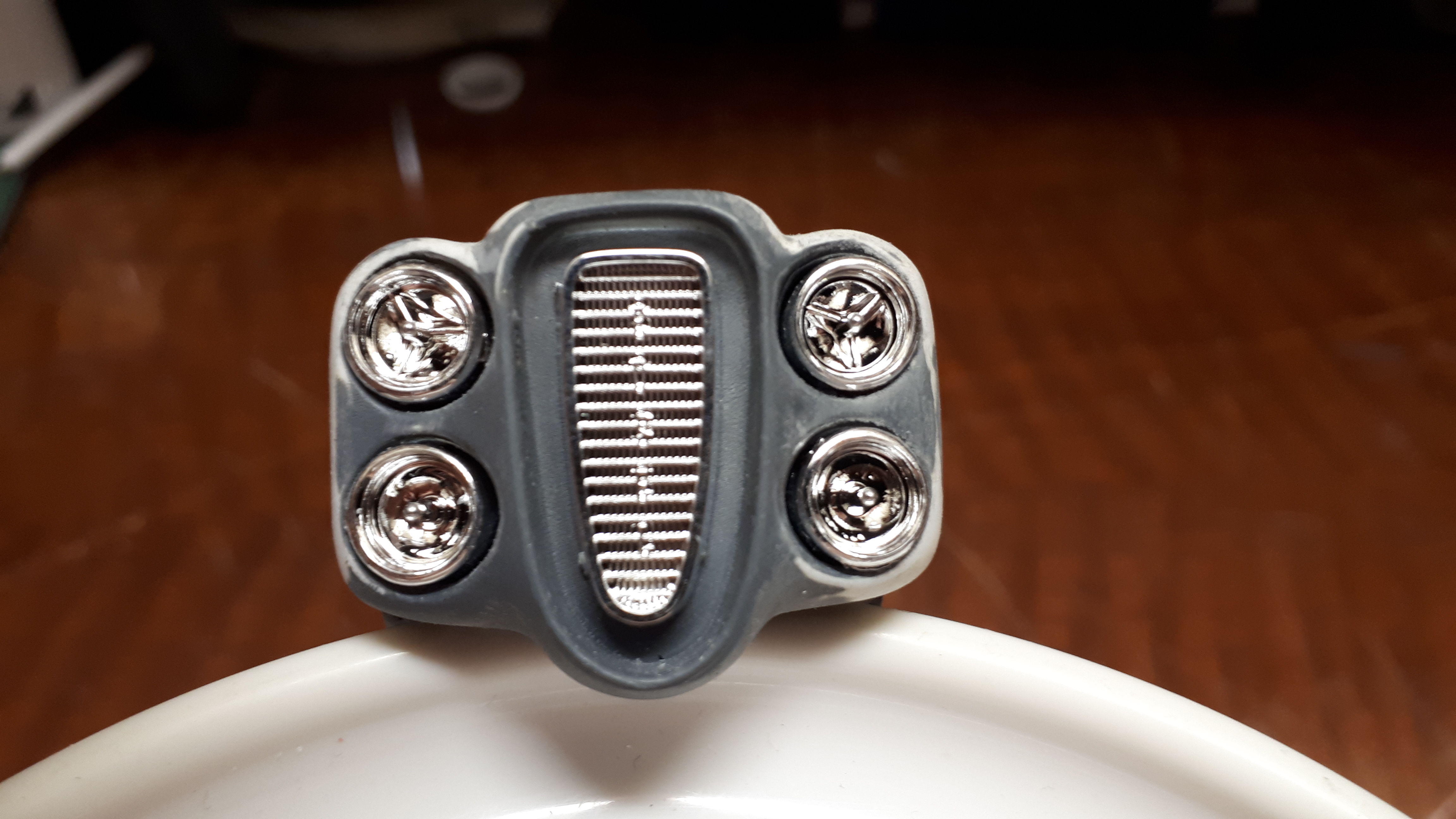

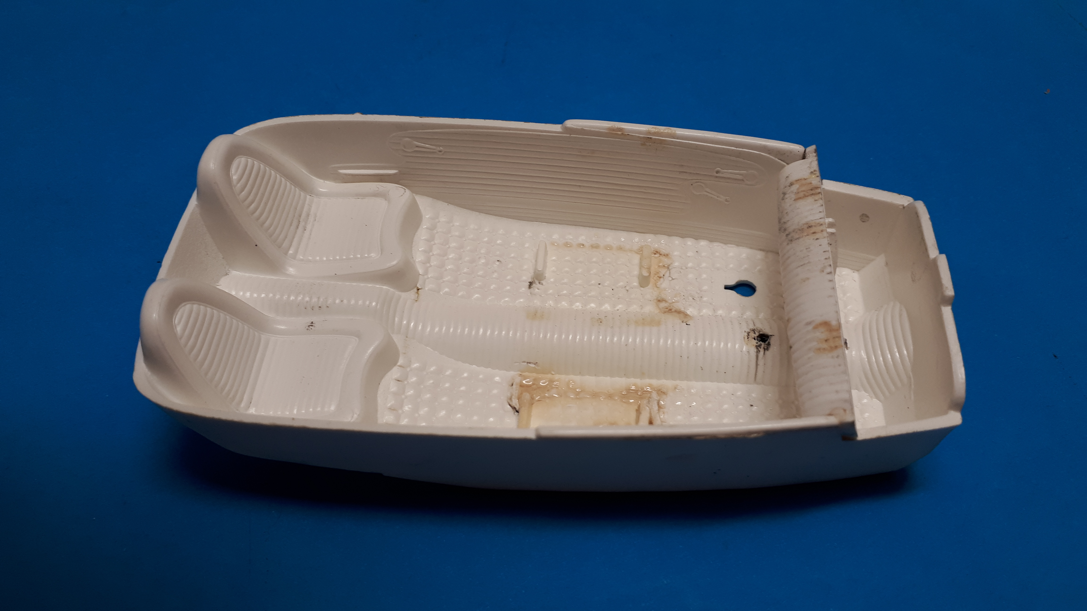

Alan Barton Posted January 9, 2019 Author Posted January 9, 2019 A little bit of progress last night. I got home from work and pulled the interior tub out of the caustic path and it was spotless! I was very impressed as black often is very tenacious and can stain the plastic - the fact that it had never been sanded would have helped a lot here. I can't get over how pure white the 50+ year old plastic is! I also cut some fine mesh to make a backing for the grille and I'm pretty happy with the look. I also got some gold paint on the engine and rear end and some white primer on the firewall - but that may change - stay tuned! Cheers Alan

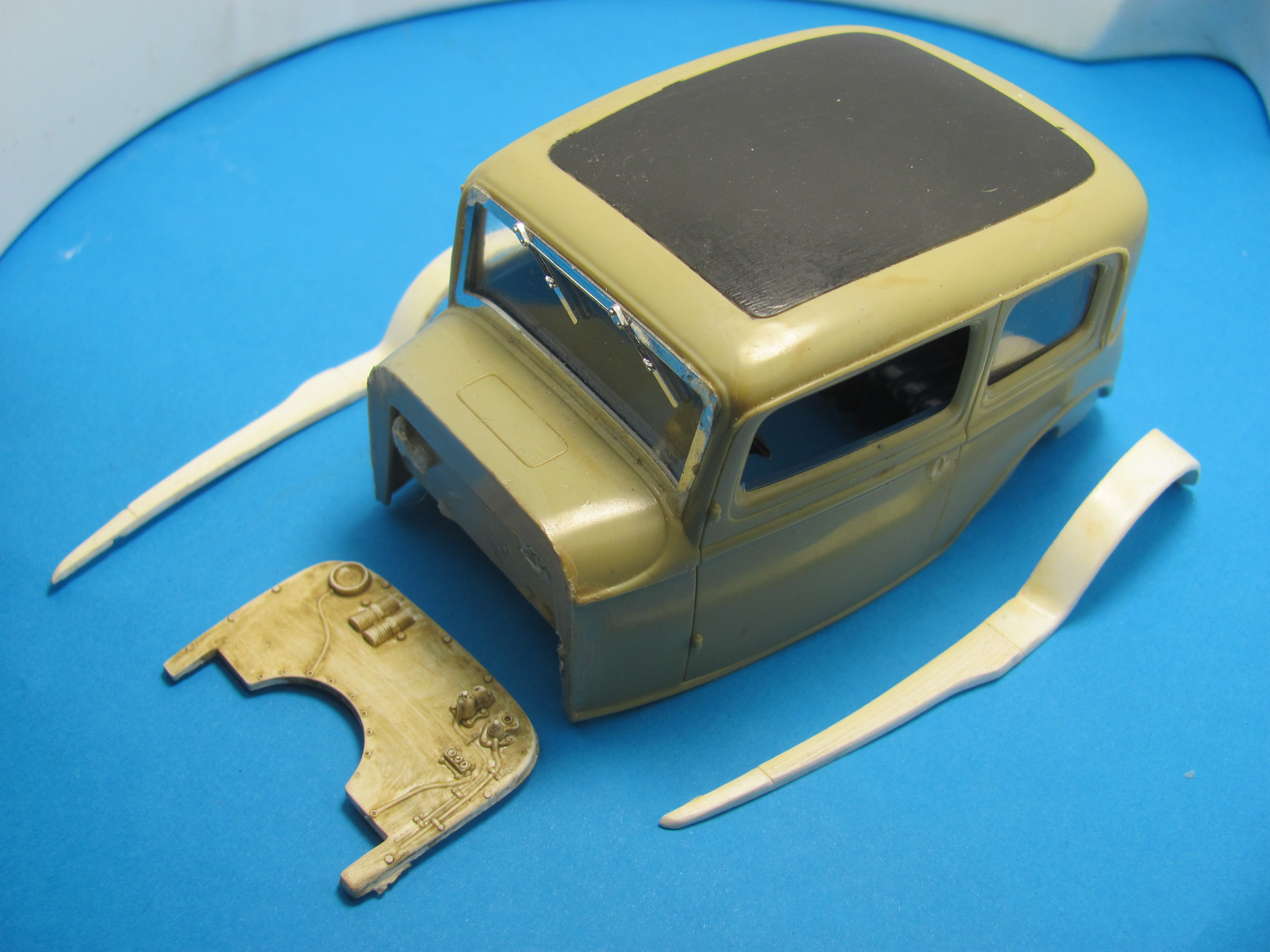

Casey Posted January 9, 2019 Posted January 9, 2019 Nice to see someone go through the effort to bring back a never-to-return oddball. Here's another beautifully built example if you need reference:
Alan Barton Posted January 9, 2019 Author Posted January 9, 2019 Thanks for the link Casey. Somehow I missed this one entirely ( and I never skip a hot rod post, not sure what happened there!) It is a beautiful model, a real inspiration and a great reference as well. Only problem is, I am now confused with wheels. I had intended to keep the kit wheels purely from an historical aspect but Monogram whitewalls and five spokes are my favorite wheels of all times and look killer on that Deuce. Ahh, decisions, decisions! Cheers Alan

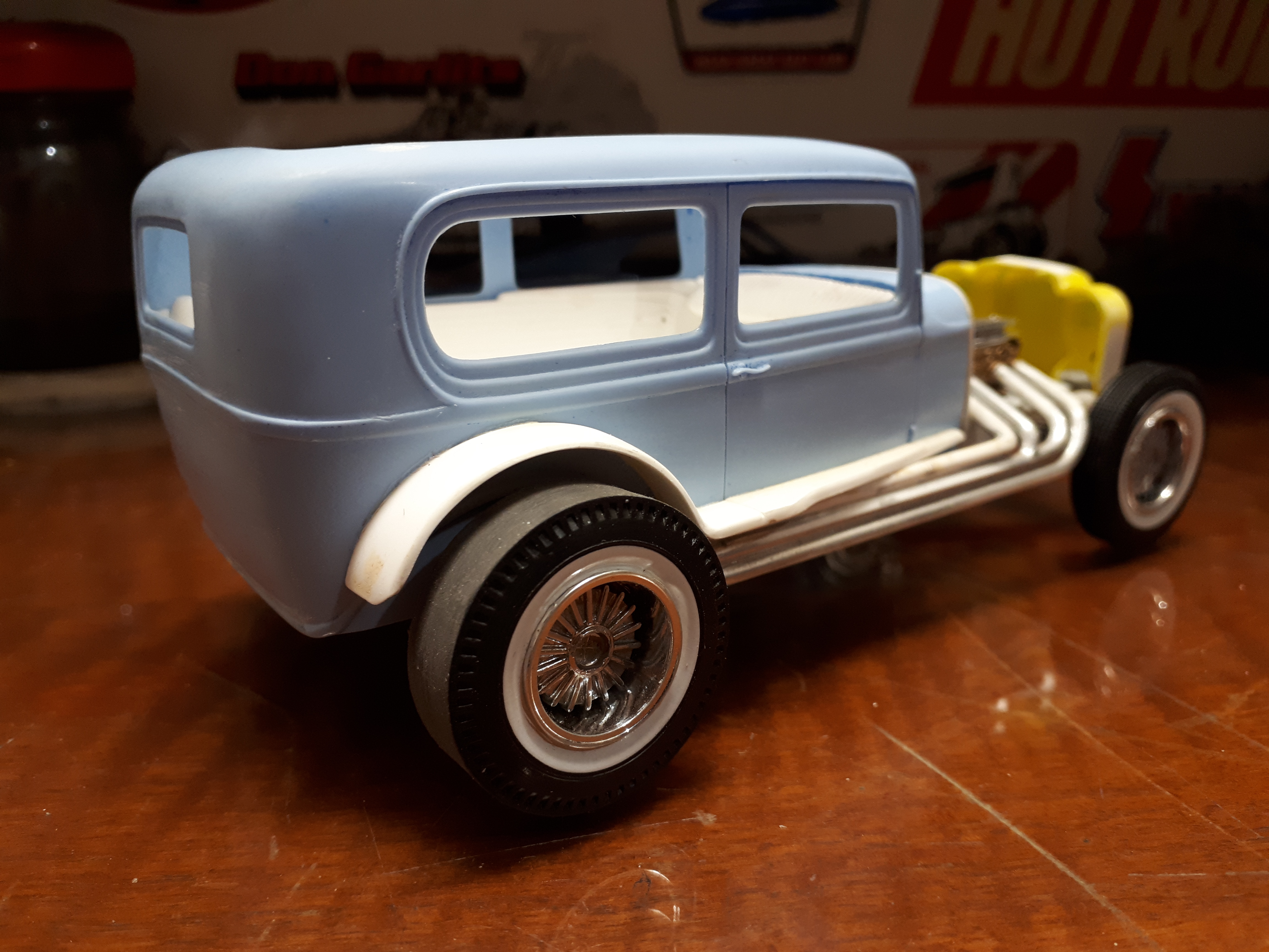

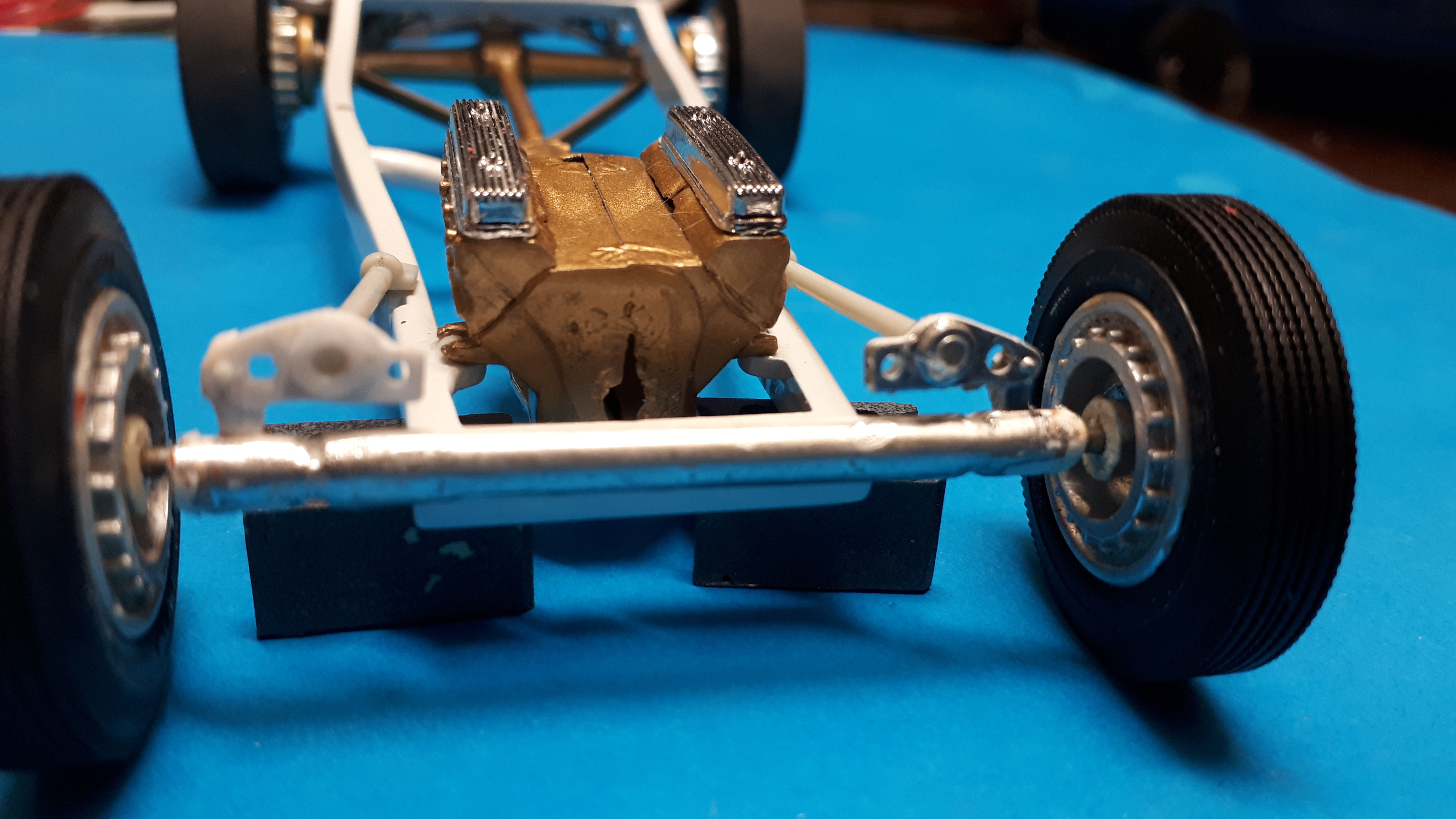

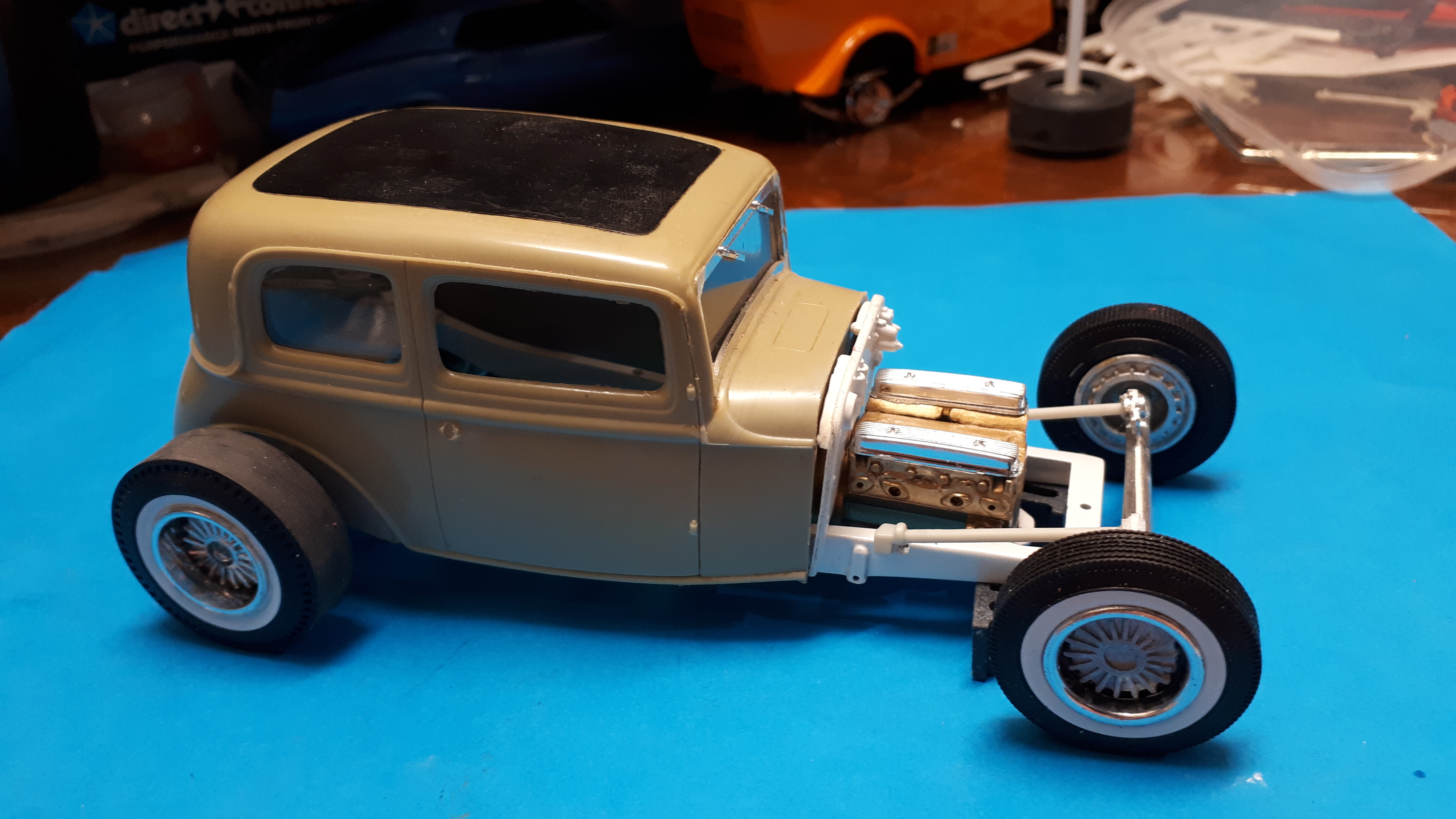

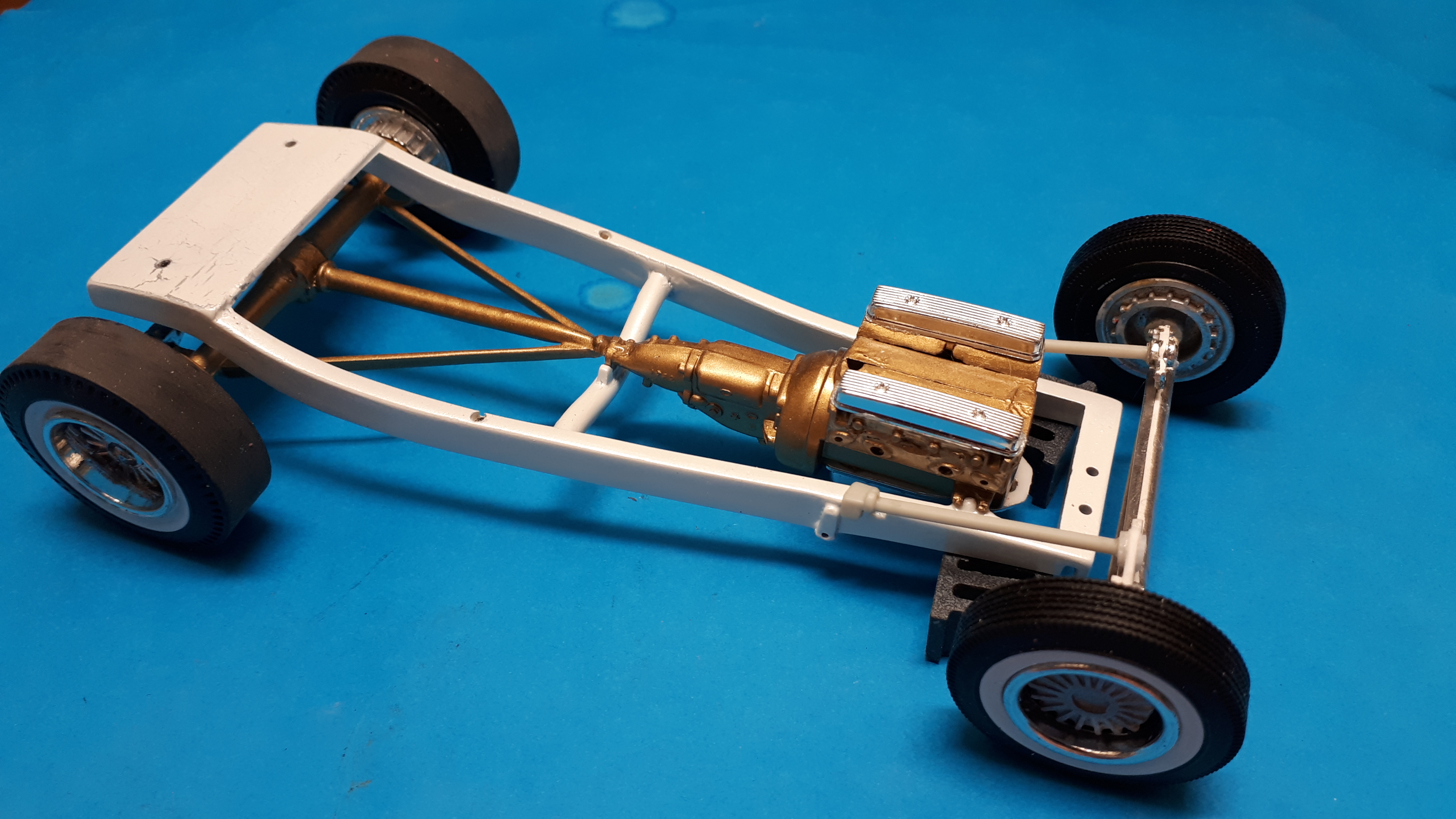

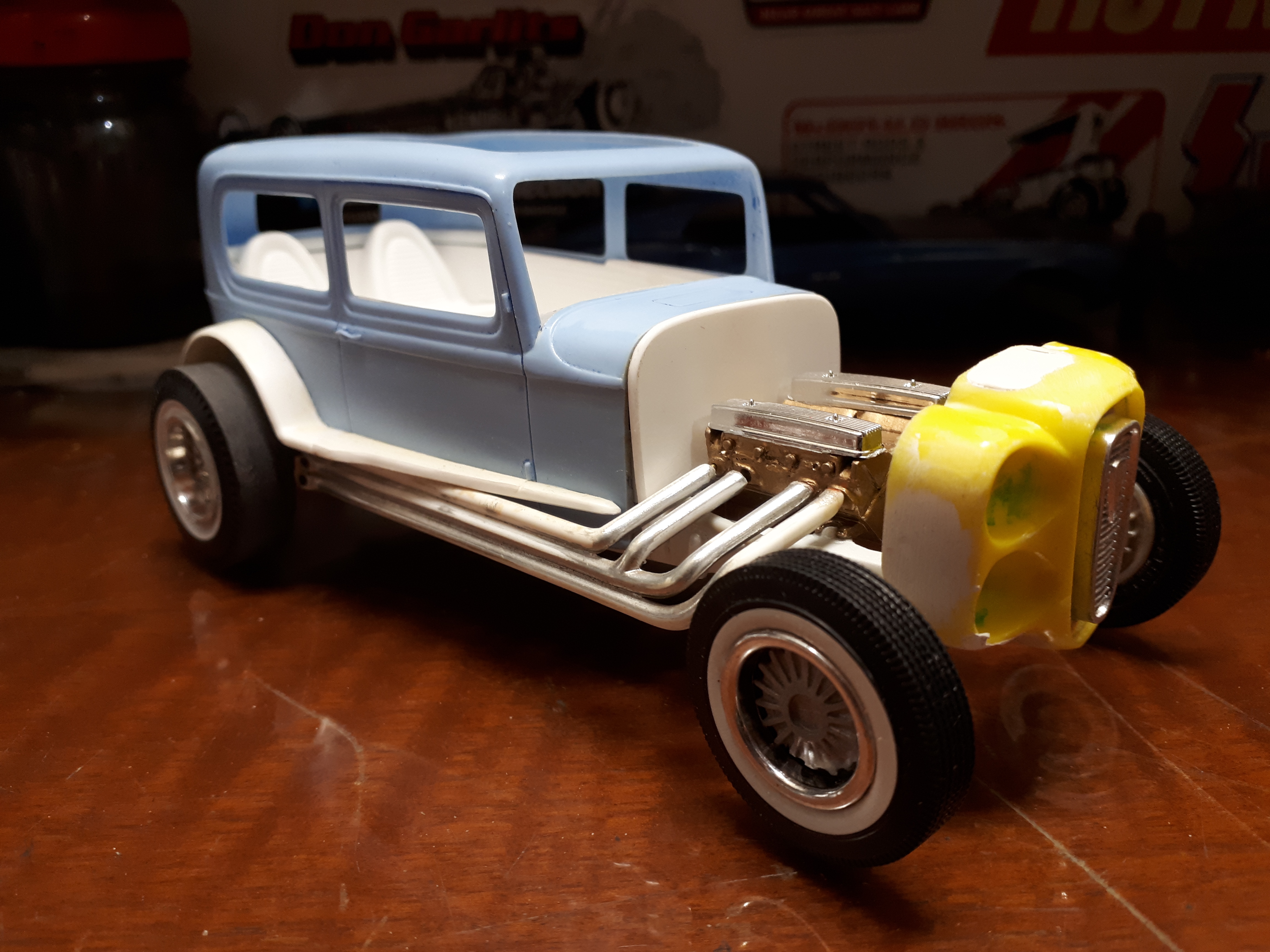

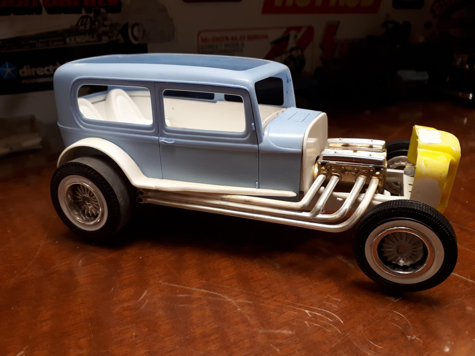

Alan Barton Posted January 14, 2019 Author Posted January 14, 2019 Made some progress on the weekend with the frame. I fabricated a new torsion bar lever arm to replace the broken one - it's just bits of plastic. The engine is glued in so that I can start getting the exhausts repaired and aligned. I found a suitable replacement for the broken rear shock ( I was amazed at how similar it was!) and got the rear end in place. I still have to add some details to the front axle such as king pins and hubs and backing plates - it's just a bit toylike in that area. And just for giggles, I dropped the Vicky body on for a mock-up but this is only temporary - more news soon!

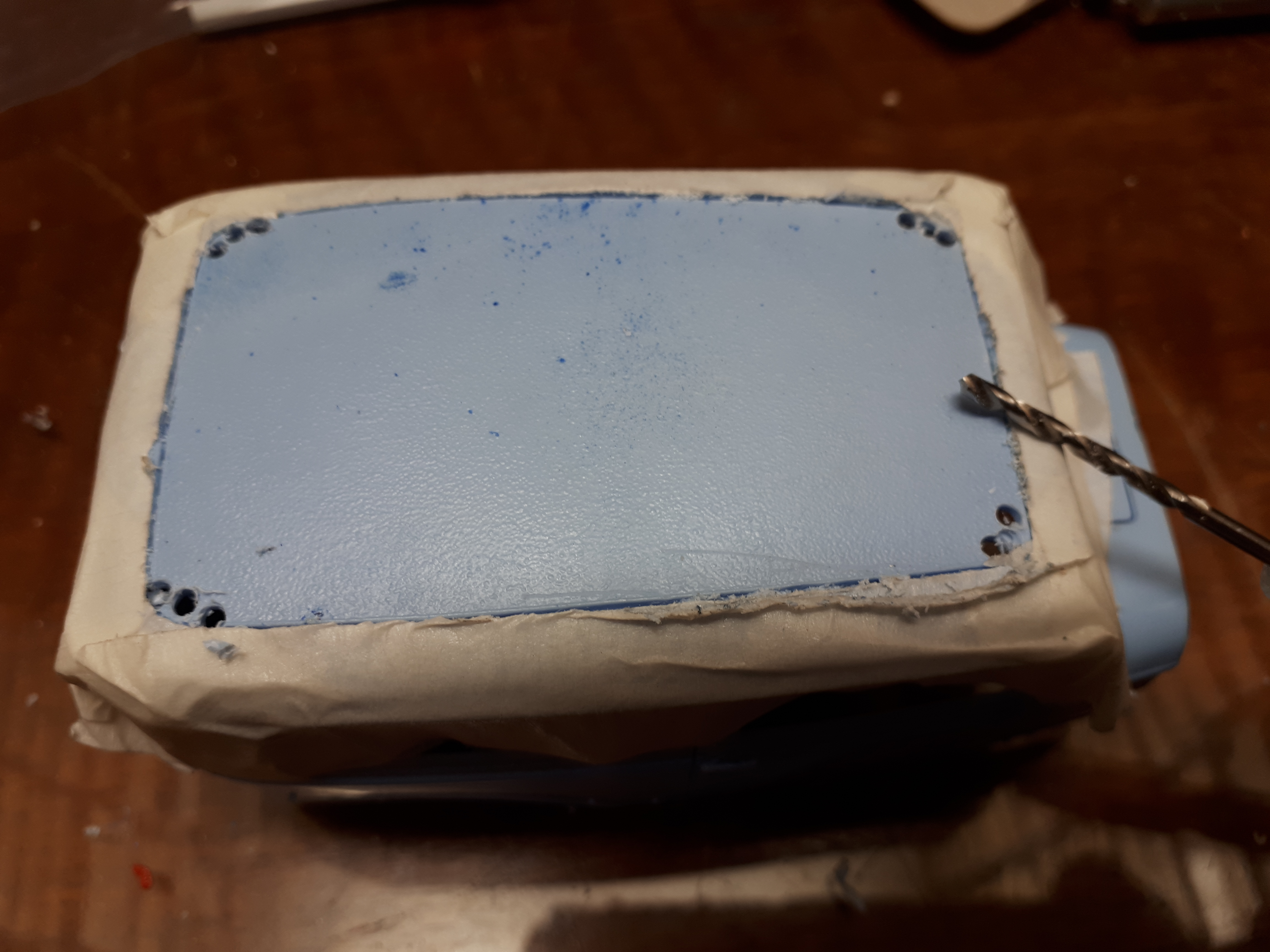

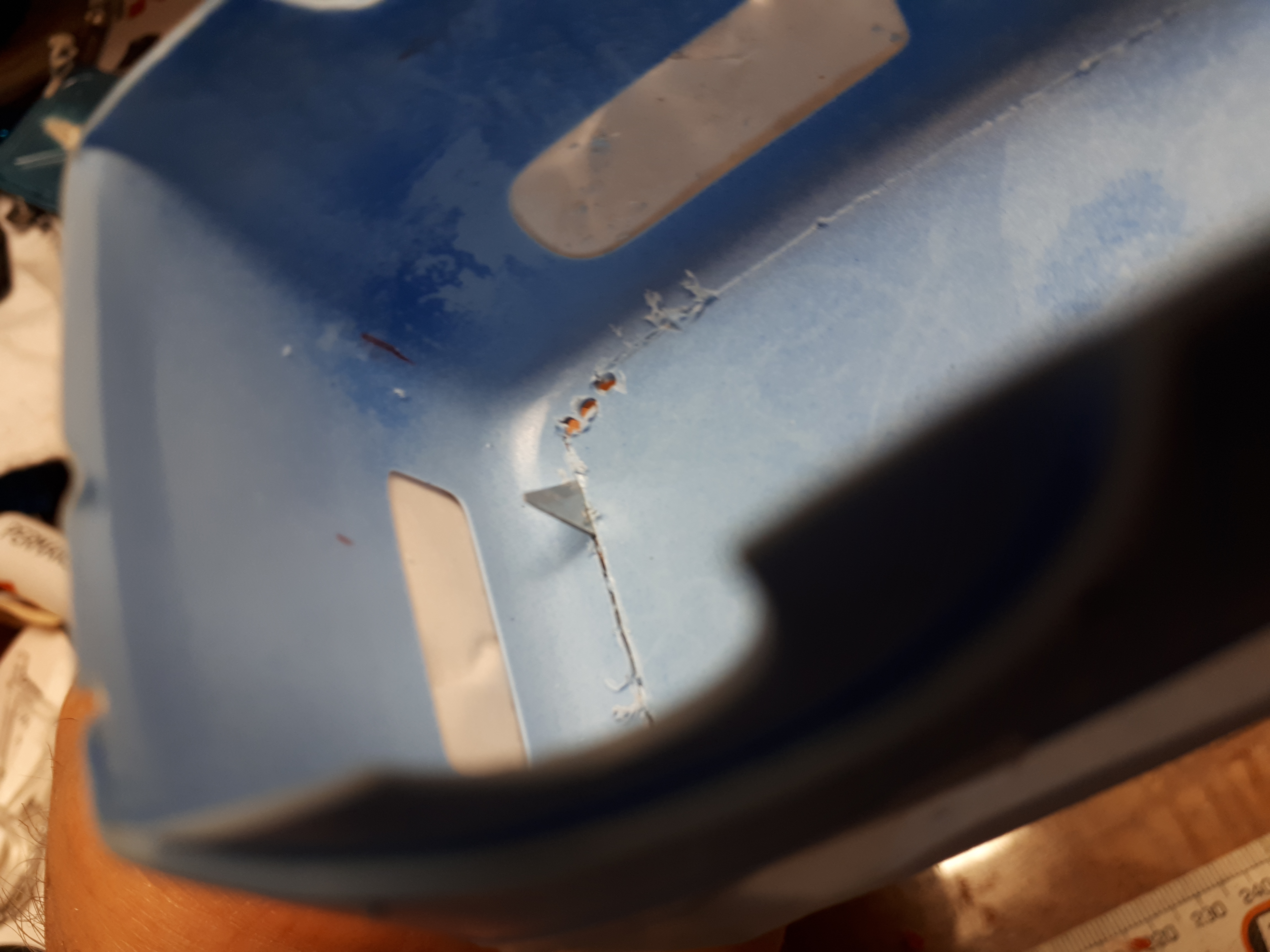

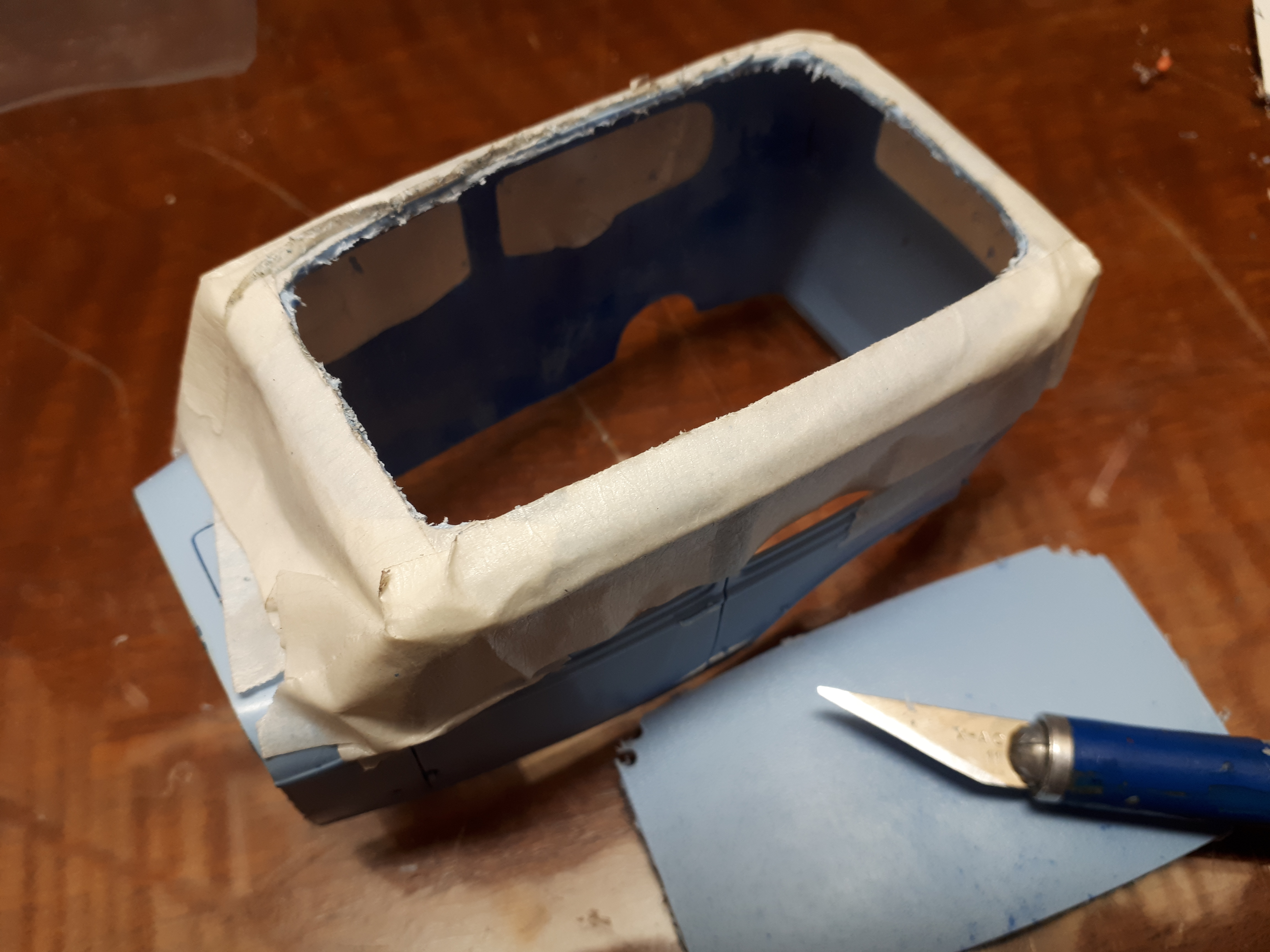

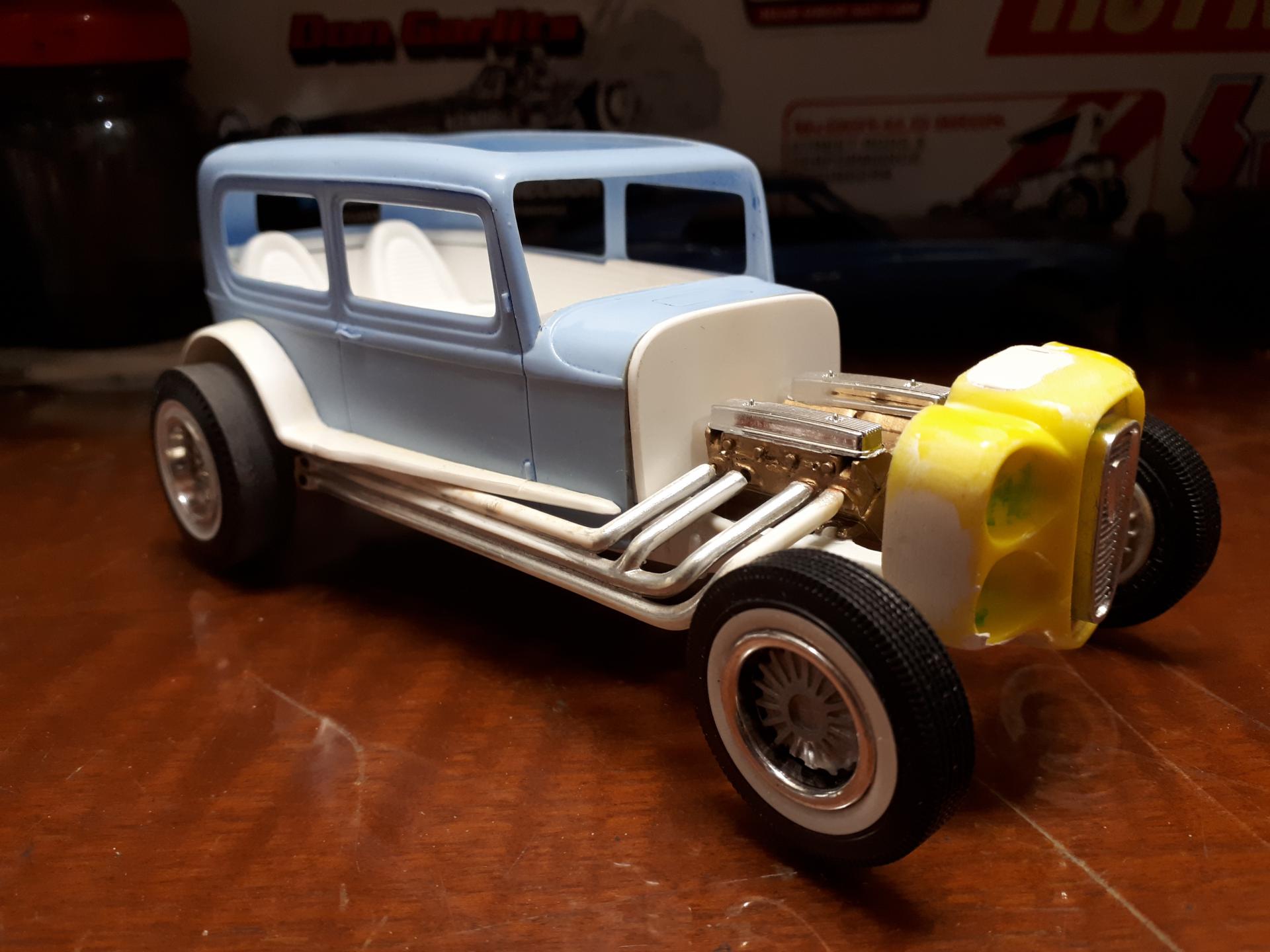

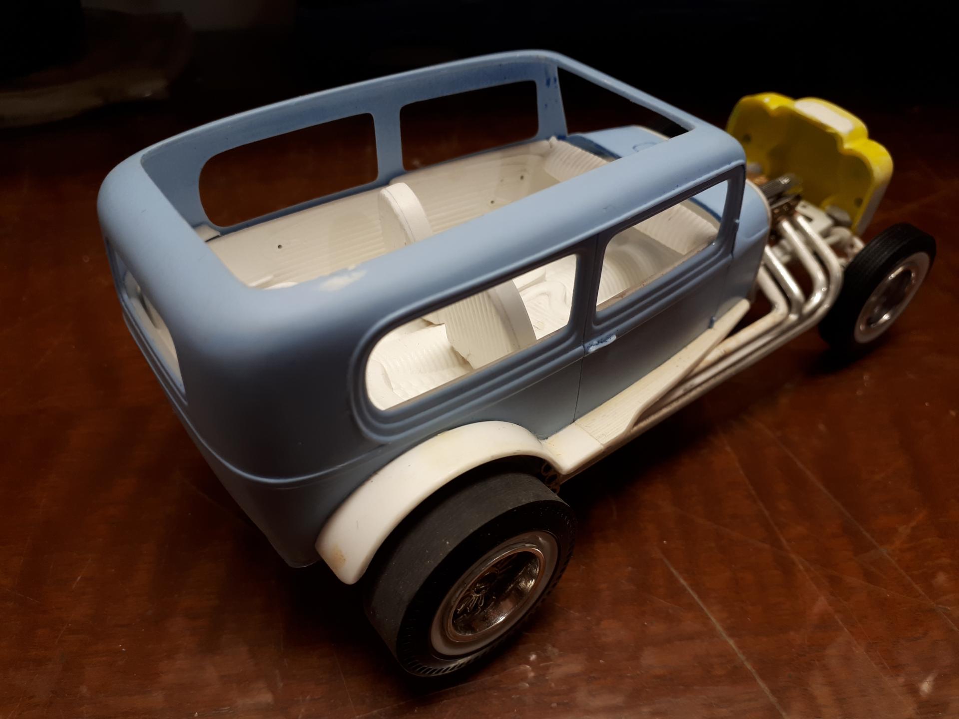

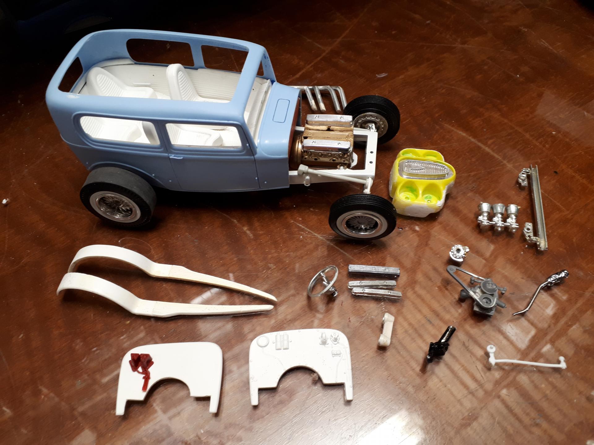

Alan Barton Posted June 22, 2019 Author Posted June 22, 2019 Hey Craig, that is absolutely stunning! Sorry for the tragically late reply, I have been focussed on some other projects, both 1:1 and !;25 and hadn't got much more done so just tonight I thought I would post something and I find your drop-dead gorgeous Vicky! I love the Radirs, I adore the recessed insert in the rear and I can't hep thinking there is something tricky going on with the grille. if I get anywhere near close to this high standard of finish I will be a very happy camper. Last time I posted I hinted that something was about to change my original plans. I really should have got back earlier but anyhow, one of our fellow forum members who goes by the name of muncie got in touch with me and generously offered me a near-mint Tudor body to help with my project. To say I was gobsmacked was an understatement, I mean, who gives up such a rare part? Steve, I am indebted, believe me. To further the surprise, when Steve's package arrived in Perth Western Australia he had also chucked in another grille, saving me from sawing off the front of my coupe! And some lights, and the original instructions. It just doesn't get cooler than this! Meantime, my work has had me travelling a lot so modelling has slowed down a bit but I wanted to show you how this old showcar is shaping up. I very gingerly removed the top insert and will be putting a narrow flange around it to allow a tinted roof insert to drop in place so that all those beautiful pleats don't disappear. I'm not sure whether I had trimmed my pipes as I once had them fitted to a childhood Paddy Wagon build but there seems to be a bit of conflict between the pipes and the frame so I will need to massage these. I am using pins to line them up with the heads so hopefully I will get everything where it should be without too much stress. Steve just proves how good people are and what a great place this is for like minded people to hang out. I'm not sure when I will get the next installment done but thanks everyone for following along this far and I hope I can do the old girl justice. Cheers
Alan Barton Posted June 22, 2019 Author Posted June 22, 2019 Thanks Rodney. It is a fairly simple build but there are some details that will take extra effort to get just right - and stance is a big one! For once bodywork should be the least of my issues! By the time I get the chassis squared away I'm hoping there will be some warmer weather for a nice day of painting. Cheers Alan
