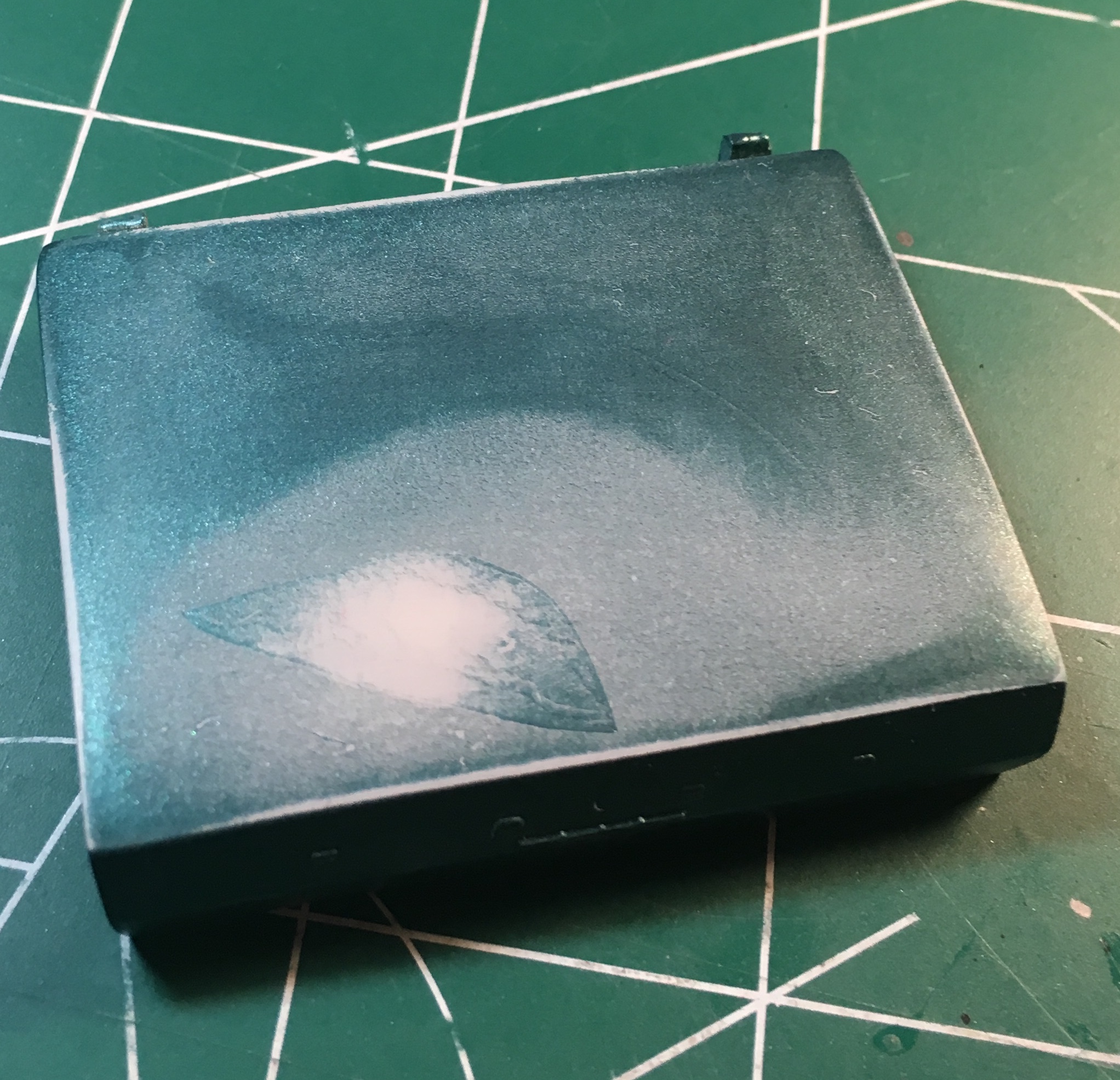

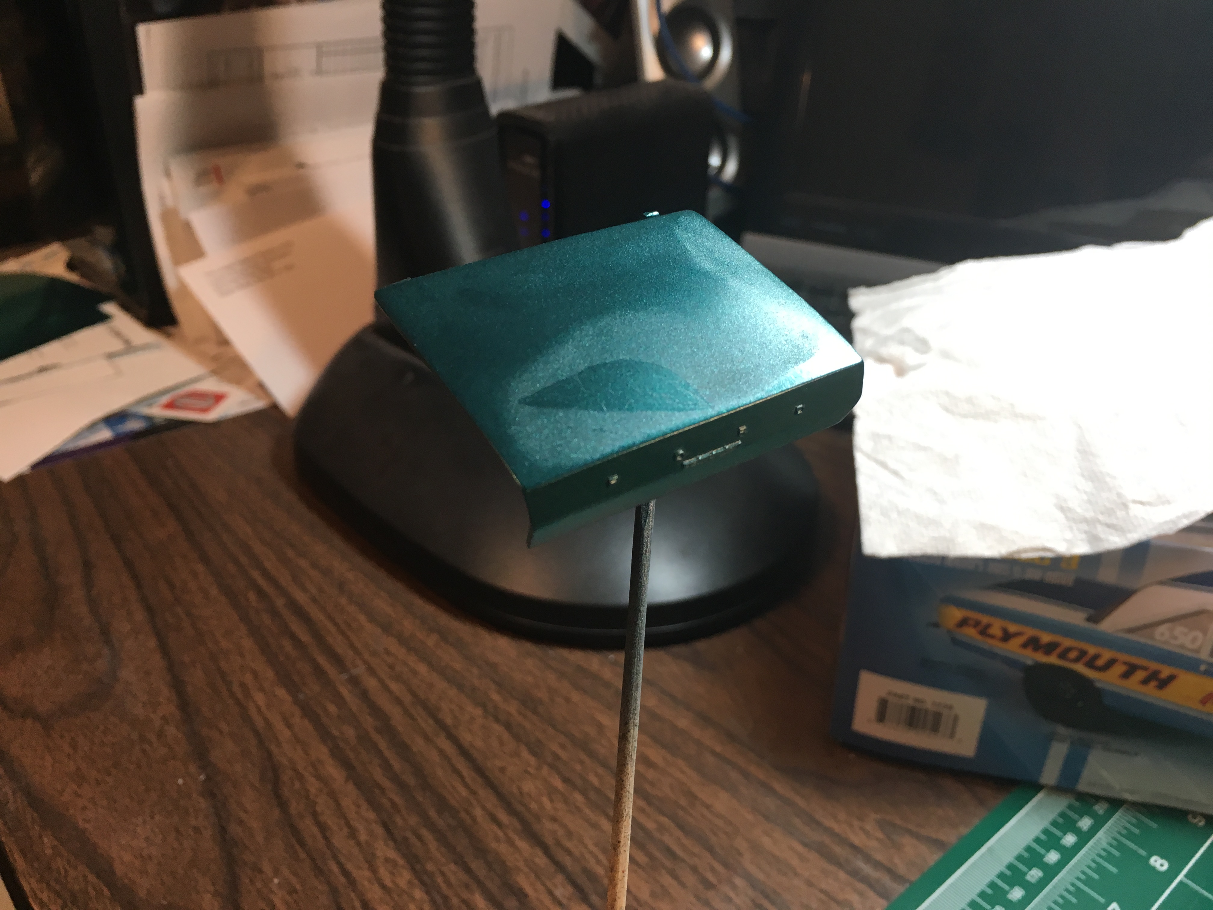

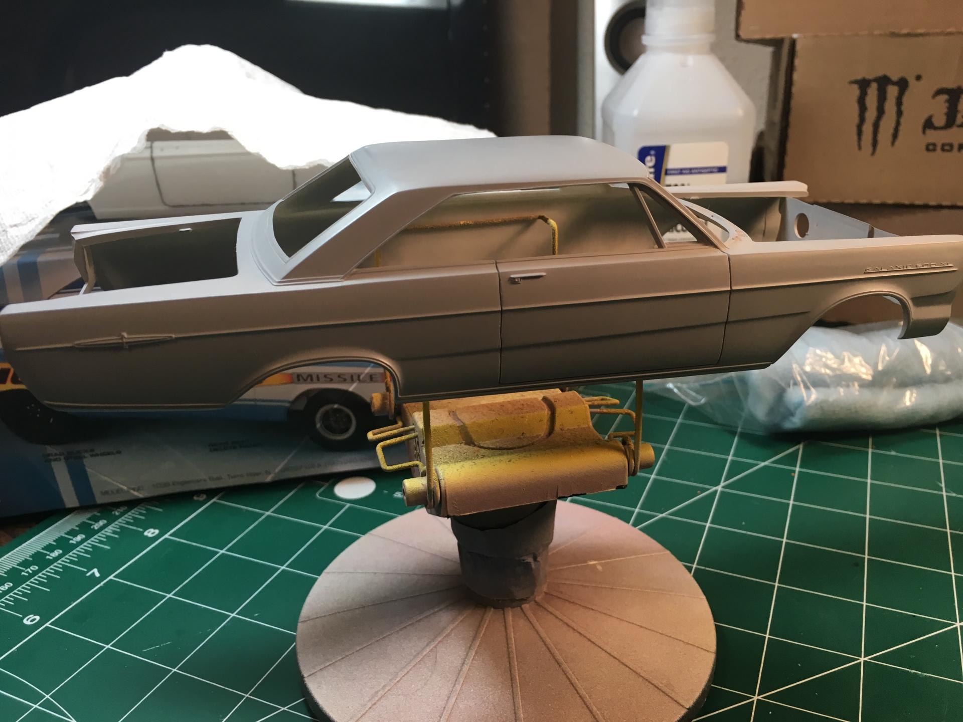

Brutalform Posted January 6, 2019 Posted January 6, 2019 (edited) I’ve used Duplicolor paints on many builds, with great results. Lately, not so much. This 65 Ford was sanded with 3200, up to 4000 on the plastic, panel lines scribed and colored, then wiped with alcohol, and a tack cloth, then primered with Tamiya gray, then sanded smooth up to 4000 again, wiped with alcohol, and a tack cloth. My paint room is 70* and showing 30% RH. I tested this color and the primer on a plastic spoon. I’m glad I only did the trunk lid, and not the body. I don’t know if this is from something I did incorrectly, or the paint? The trunk lid came out like this with two light coats. The trunk looked just as the other parts in the primer, all prepped for color. Edited January 6, 2019 by Brutalform
High octane Posted January 6, 2019 Posted January 6, 2019 Hmmmm, I just sprayed Dupli-Color outside today in 37 degree weather as I don't have room for a spray booth and it came out great.
Brutalform Posted January 6, 2019 Author Posted January 6, 2019 I sprayed this trunk lid inside. I have a hygrometer in my paint area so I know what the RH is. I’ve never had weird shapes come through the paint like this. Especially when the primer coat looked flawless.
DiscoRover007 Posted January 6, 2019 Posted January 6, 2019 (edited) Duplicolor has always been tricky to paint with for me. I think the issue is that it reacts with hobby plastics and primers. The only way I've found that really cures this is to either undercoat the paint with a similar shade of hobby lacquer first OR use Duplicolor primer sealer before painting, to my memory that has also helped. I do share the frustrations though. They are super susceptible to humidity and the paint often crinkles and allows ghost lines to show through. I pretty much stick to TS Sprays now or a select few Testors Lacquers. Edited January 6, 2019 by DiscoRover007
64SS350 Posted January 6, 2019 Posted January 6, 2019 Could be the mixed use of Duplicolor and Tamiya primers. I've had mixed results when I have used the different brands together. I also started using Dupl. primer sealer over the primer sometimes.
High octane Posted January 6, 2019 Posted January 6, 2019 Over the years as being a "rattle can man" I have found Dupli-Color, Tamiya, Testors, MCW, Black Gold paints all compatible with each other.
stitchdup Posted January 6, 2019 Posted January 6, 2019 Could it be the plastic at fault? I've had the same thing happen when I haven't been using duplicolour and it seems to happen more on tamiya and revell kits. I found giving a couple of coats of duplicolur plastic primer first stops it
Ace-Garageguy Posted January 6, 2019 Posted January 6, 2019 (edited) Looks to me like all you have is some mild blushing. Put a little toothpaste on a finger and see it it polishes off. If it does, just wipe it all down again with alcohol and continue painting. Polish the blush off at the end. OR...if it's NOT blushing but crazing, the garbage plastic we're being given today is most likely the culprit. Some bottom-of-the-barrel Chinese cut-every-last-penny-of-cost-out goo that's not solvent resistant. Either way, it's probably not the paint's fault. And even if it IS crazing, you can let it harden up, sand it slick again with 800, and re-spray. Do this repeatedly, it will almost certainly eventually stay down. Edited January 6, 2019 by Ace-Garageguy
Daddy Mack Posted January 6, 2019 Posted January 6, 2019 Probably sanded the primer down to a layer thin enough for the lacquer solvents in the Dupli-Color to bleed through.
Ace-Garageguy Posted January 6, 2019 Posted January 6, 2019 (edited) On 1/6/2019 at 10:01 PM, Daddy Mack said: Probably sanded the primer down to a layer thin enough for the lacquer solvents in the Dupli-Color to bleed through. Expand That's possible too...in which case it's crazing, and as I said above, let it harden up, sand lightly with 800 (you really don't need to go to 3200 or whatever prior to paint, by the way), and respray. If I gave up on paint products or a particular paint job every time I had a problem, I would have quit doing this decades ago. The hood below is Duplicolor over Duplicolor primer. The primer crazed the plastic. It also lifted the bodywork where I took the hood peak off. Then, when I finally got the primer to behave, the color blushed badly and again ate into the softer plastic where I'd removed surface details. But with some effort, it now looks like this...WITHOUT getting horribly heavy paint on the thing. Edited January 6, 2019 by Ace-Garageguy
ZTony8 Posted January 6, 2019 Posted January 6, 2019 I, too, haven't had good luck with a Tamiya primer/ Duplicolor paint combination. I suspect some sort of chemical incompatibility.
Deuces Posted January 6, 2019 Posted January 6, 2019 Have you guys tried plasti-cote primer???? It's great stuff....
StevenGuthmiller Posted January 6, 2019 Posted January 6, 2019 On 1/6/2019 at 10:01 PM, Daddy Mack said: Probably sanded the primer down to a layer thin enough for the lacquer solvents in the Dupli-Color to bleed through. Expand If it's not blushing, this would be my guess. You need a highly impenetrable barrier before spraying a hot paint like this. If the primer is too thin, the paint will eat right through it down to the plastic. Also, some hobby primers can be a little troublesome with automotive lacquers. I have had Testors primer problems under hot paints. I use predominantly Duplicolor primer now, and lots of it! Steve
Ace-Garageguy Posted January 6, 2019 Posted January 6, 2019 On 1/6/2019 at 10:29 PM, Deuces said: Have you guys tried plasti-cote primer???? It's great stuff.... Expand When it was available at auto-parts stores, it was my go-to for many years. A lot of us used it. Recently though, Carquest was bought out by Advance, and Duplicolor replaced PlastiKote in the stores. The PlastiKote stuff available online seems to be a continually-changing formula, and many of us have had such inconsistent results, we've pretty much written it off. The last batch I got was literally unusable for anything but garden tools.
Ace-Garageguy Posted January 6, 2019 Posted January 6, 2019 (edited) In general, I find it's becoming more challenging to get really good model-car paint jobs. Combine the cheapening and tinkering with many of the available automotive primer products (rattlecan) and the soft, less-solvent-resistant plastic many manufacturers are palming off on us these days, and you have a recipe for problems, if not outright disaster.. I personally refuse to complete a model if the paint isn't up to my kinda high standards, and whereas only a few years ago (2012) I knew exactly what I needed to do every time to get gorgeous paint, today, it's a never-ending series of surprises...and one large reason I don't finish anything. I haven't had the time recently to experiment to be as SURE that what I use and how I use it will always work, so seeing the methods people who consistently produce top-quality (like Steve Guthmiller) is a great help. But still, everyone has his own specific needs, and what may work perfectly for Steve every time may not be exactly the procedure I need to get my desired result. So...individual experimentation is key. And sometimes, you just have to beat the model and the paint products into submission. Edited January 6, 2019 by Ace-Garageguy
Deuces Posted January 7, 2019 Posted January 7, 2019 On 1/6/2019 at 10:40 PM, Ace-Garageguy said: When it was available at auto-parts stores, it was my go-to for many years. A lot of us used it. Recently though, Carquest was bought out by Advance, and Duplicolor replaced PlastiKote in the stores. The PlastiKote stuff available online seems to be a continually-changing formula, and many of us have had such inconsistent results, we've pretty much written it off. The last batch I got was literally unusable for anything but garden tools. Expand The last can of white primer I bought at Ace hardware not far from me... I'm not sure if you guys have an Ace in your neighborhood... You might want to check it out...
Oldcarfan27 Posted January 7, 2019 Posted January 7, 2019 (edited) Did you shake the paint cans thoroughly? If the pigment isn't mixed completely with the base, you can get problems like sporadic crazing. If it's just blushing (fogging), don't worry about it, just push on through. You can clear coat or polish and it'll all go away! The best thing about using automotive touch up lacquer is that, if done right, is as durable as a real car once it's completely cured. You can wax and polish it with real car products and the finish will last for decades - maybe longer! Edited January 7, 2019 by Oldcarfan27
Brutalform Posted January 7, 2019 Author Posted January 7, 2019 (edited) Thanks for all of the corrective suggestions everyone. I put the Ford away for now, and started at the Mopars. As Ace stated, it’s like a big surprise anymore when you paint. I didn’t stray from the steps I normally use when I paint. Some of my nicest paint jobs were done with Duplicolor. This AMT kit could very well be a cheaper repop. It’s not from the box with the burgundy box, but the newer stock car version. But lately Duplicolor has been acting funny every time I go to use it. Steven, I was going to pick up a can of the Duplicolor sealer, and primer the other day. I didn’t buy them because what I was using WAS working. Maybe the primer I laid down is too thin, and it started attacking underneath. Im going to sand the trunk down, hit it with a few more very light coats, and see what happens. I’m definitely going to add the Duplicolor sealer and primer to my shipping list. Patrick, the can was shaken very well, and was warmed up also. Edited January 7, 2019 by Brutalform

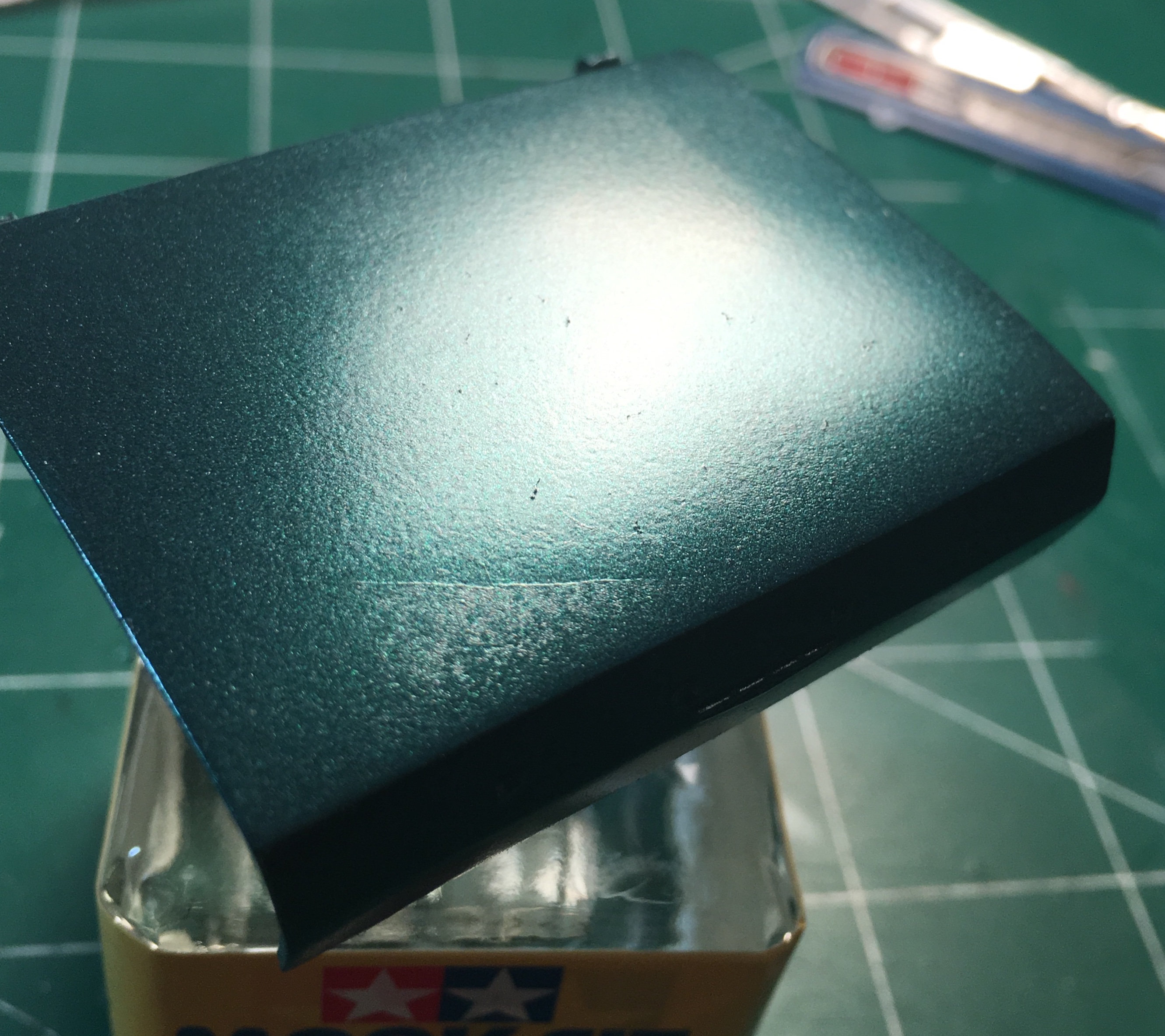

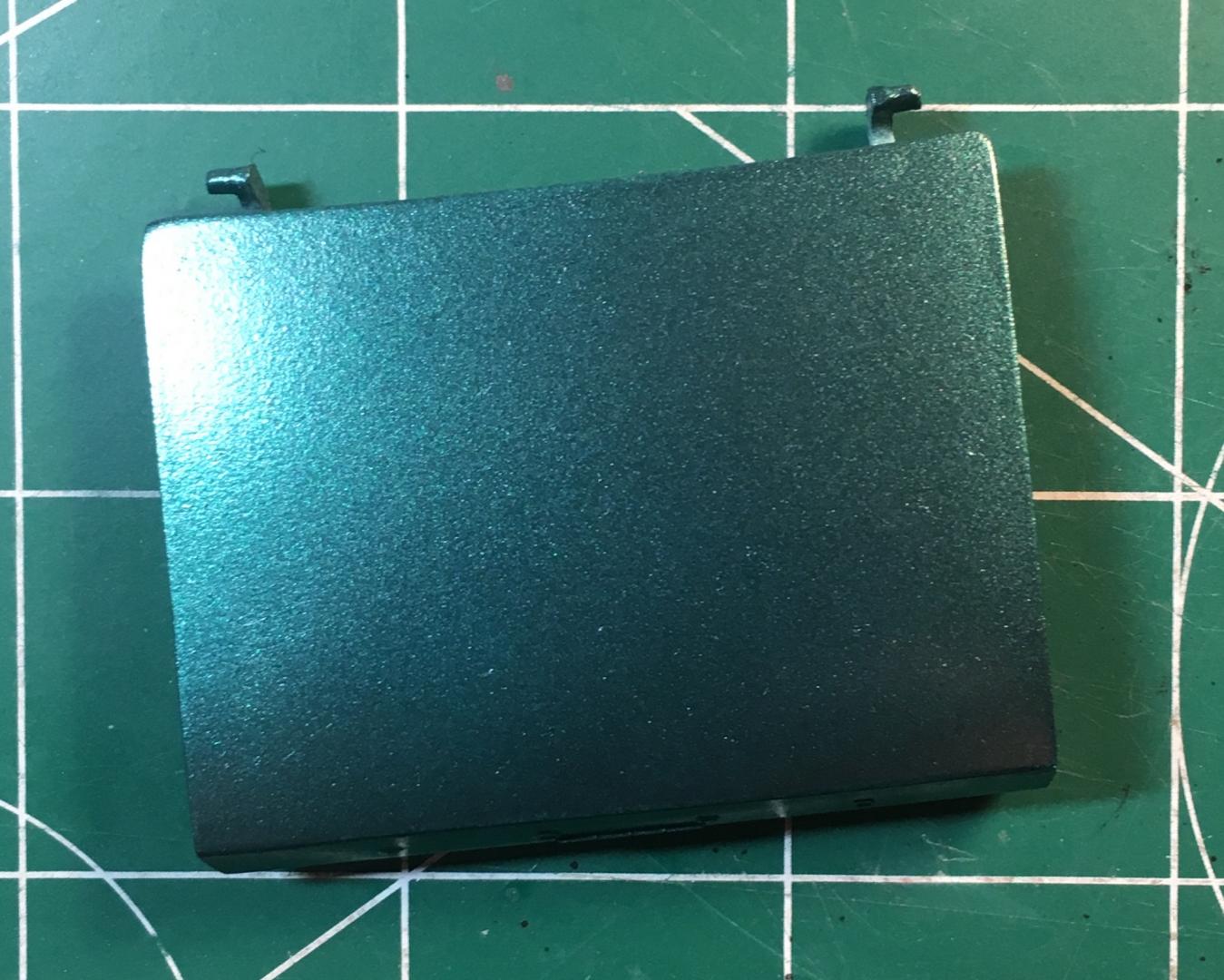

Brutalform Posted January 7, 2019 Author Posted January 7, 2019 Well, Ace I did like you said, and it worked. After sanding, and re spraying, it laid down much better. You actually have to look at an angle to see the crazing. Looks good straight on. I’m going to hit it with clear in s few days, to see how it looks.
