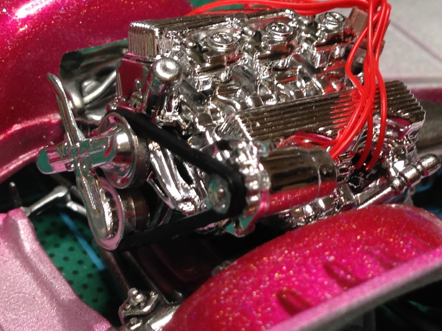

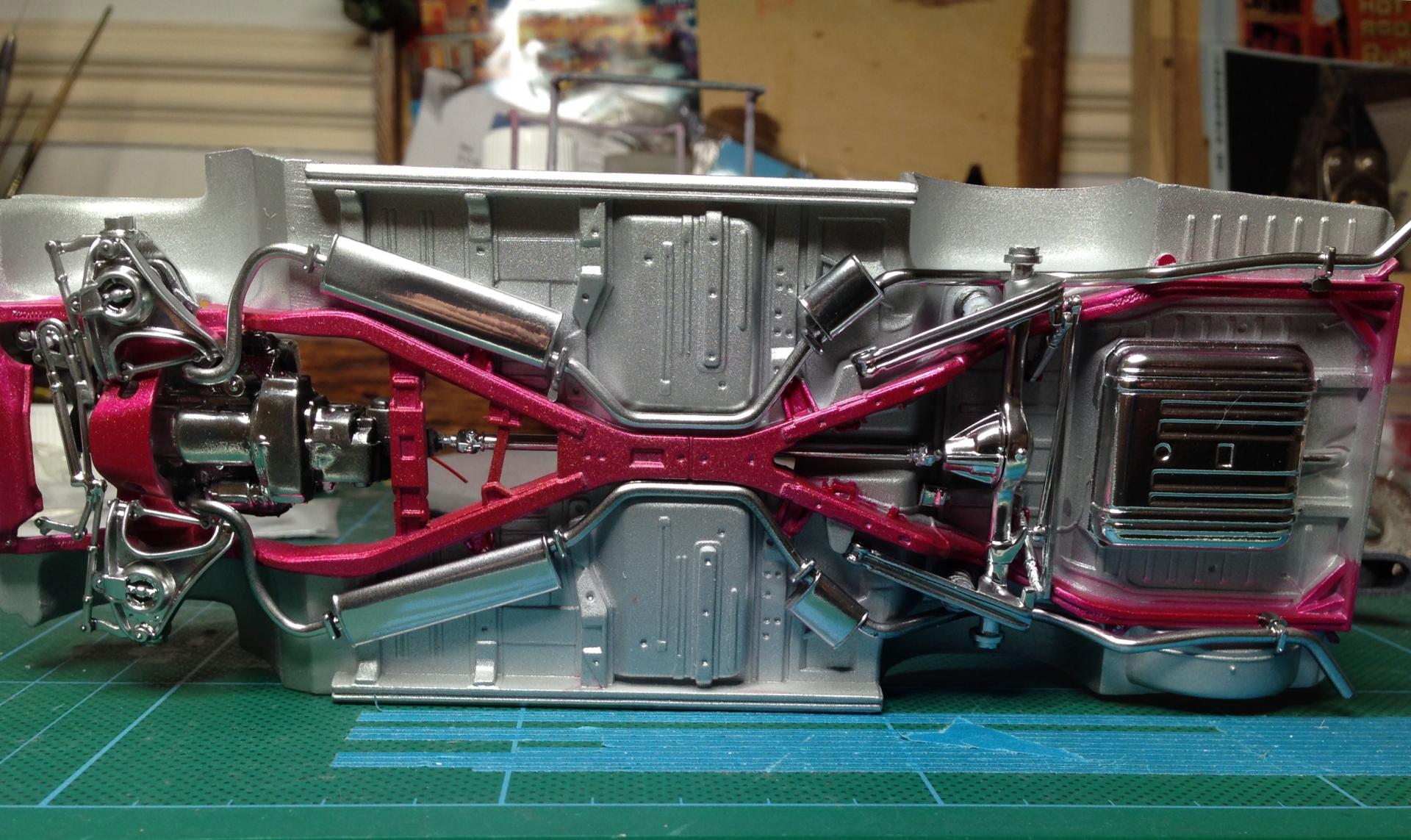

geetee66 Posted March 11, 2019 Author Posted March 11, 2019 15 hours ago, bobthehobbyguy said: Another paint masterpiece in the works. 10 hours ago, Koellefornia Kid said: Awesome paint job! 6 hours ago, MeatMan said: Just a fantastic paint job, and awesome step by step. Thanks. 2 hours ago, espo said: I'm just blown away with this paint work. ☺️ Thanks chaps I'm itching to get the clearcoat on and polish it up. I think the colours will look much better, then. I'll set the body aside for a few days and get on with the rest of it. I bought a bottle of Molotow chrome paint, which I intend to airbrush onto the engine, suspension and rear axle. I'll have to be careful how I handle the parts, as the chrome can show up fingerprints. I'll do extensive test fittings, so the chromed parts just drop into place, during final assembly ?

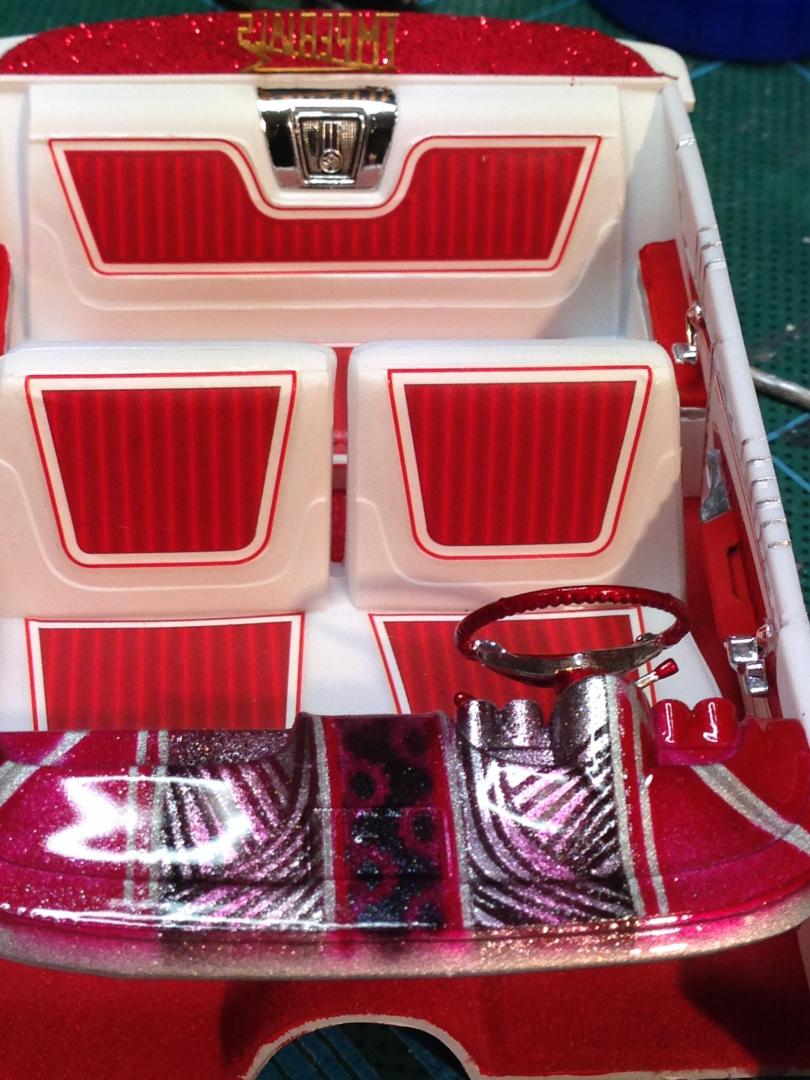

Slimguy Posted April 5, 2019 Posted April 5, 2019 This has really been an amazing paint process. The masking skills needed to do what you have accomplished are off the charts. I have just not been able to master masking. You make it look so easy in this tutorial, but I imagine each step takes a large amount of time. I am curious how much total time have you accumulated to date in order to complete the masking and painting process? looking forward to seeing more of this build...thanks for sharing it with us.

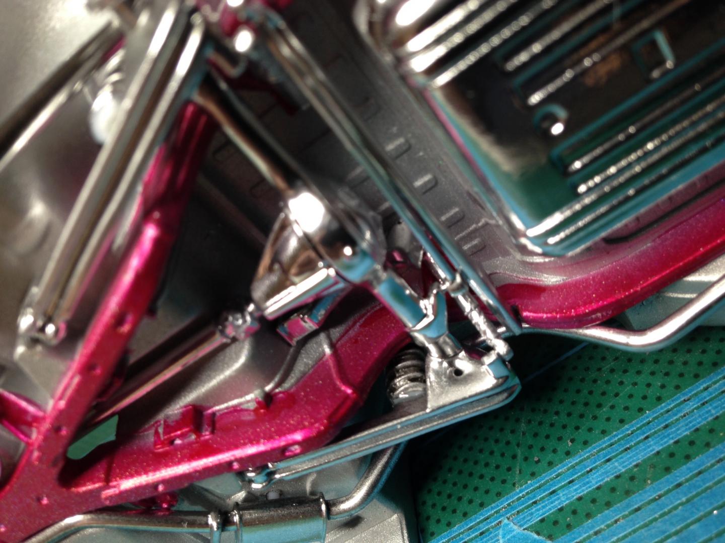

geetee66 Posted April 15, 2019 Author Posted April 15, 2019 On 05/04/2019 at 1:45 PM, Slimguy said: This has really been an amazing paint process. The masking skills needed to do what you have accomplished are off the charts. I have just not been able to master masking. You make it look so easy in this tutorial, but I imagine each step takes a large amount of time. I am curious how much total time have you accumulated to date in order to complete the masking and painting process? looking forward to seeing more of this build...thanks for sharing it with us. It's difficult to accurately account for time spent on this. I do a little bit whenever I can. But the fingerprint pattern, for example, took a day. I needed frequent breaks! thanks for the kind words and interest, guys. I'm glad you like watching the progress of this build. I finished the running gear and chassis this weekend. Molotow chrome used extensively!

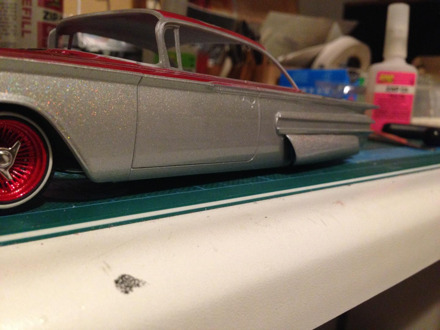

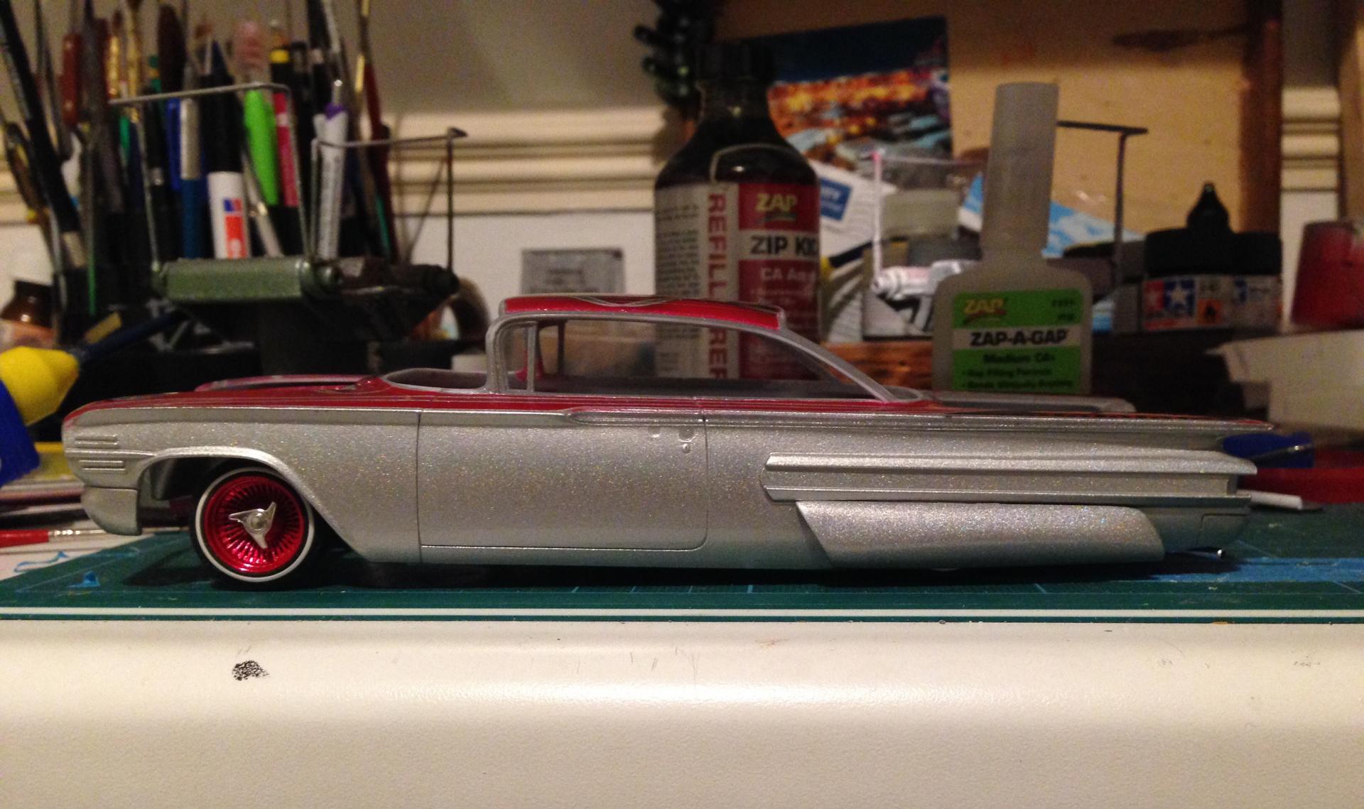

geetee66 Posted April 15, 2019 Author Posted April 15, 2019 I've found some nice cruiser skirts for it. I also sprayed the clear and added some iridescent nail polish to give it a prismatic effect on the silver.. 1

Vince66 Posted April 16, 2019 Posted April 16, 2019 (edited) This is so Sic. Love the looks of it. On the Molotow did you airbrush it and if so what pressure and was it thinned. Edited April 16, 2019 by NothingAsFineAsaW9
geetee66 Posted April 16, 2019 Author Posted April 16, 2019 5 hours ago, NothingAsFineAsaW9 said: This is his Sic. Love the looks of it. On the Molotow did you airbrush it and if so what pressure and was it thinned. Thanks, got the floor carpeted and the door handles on the interior last night. I'll post pics later when I get home from work. No need to thin it. Shot it at about 12psi over a gloss black base, although I forgot to paint some small parts black, so shot the chrome paint over bare styrene. The results were very similar.

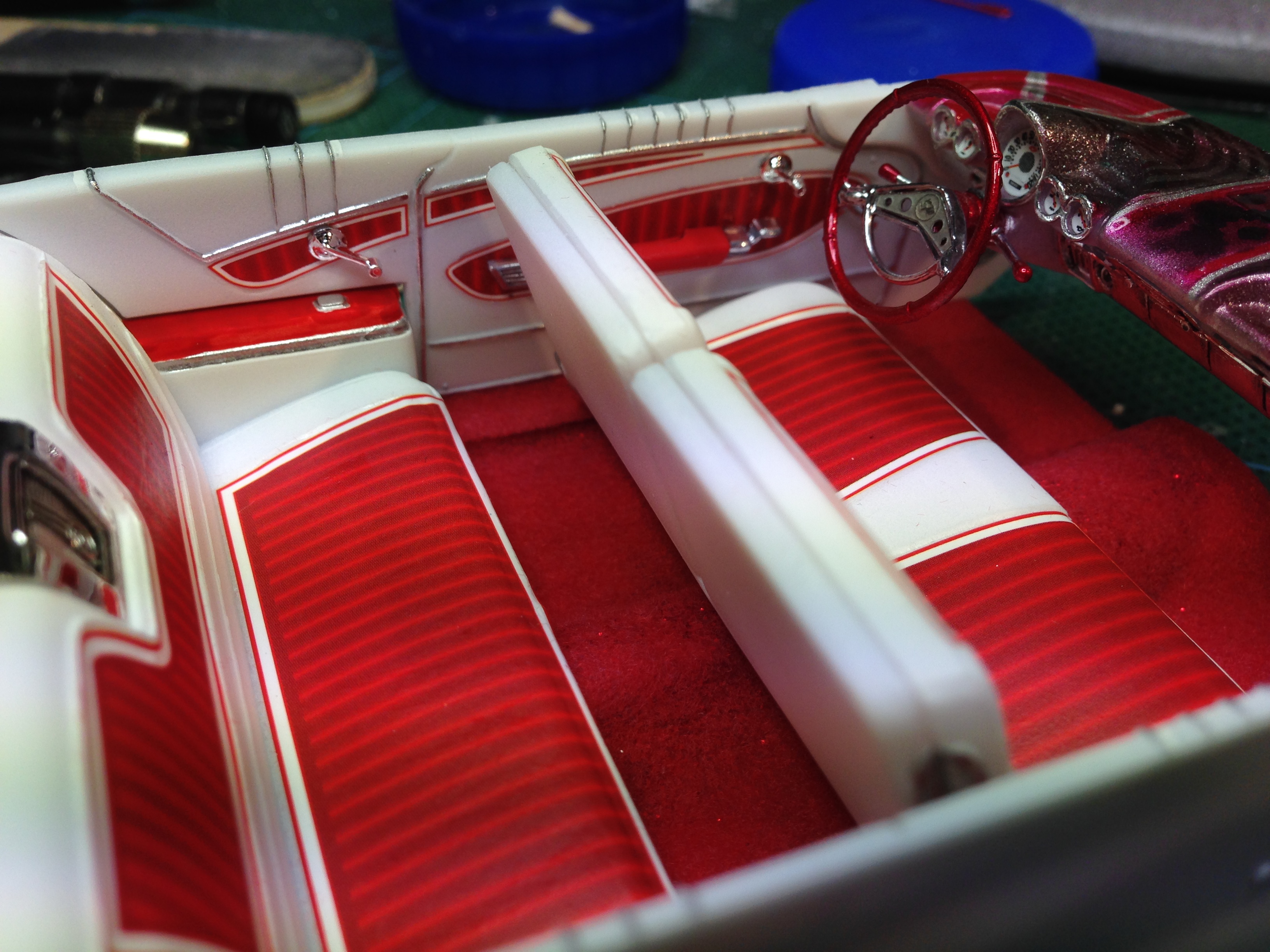

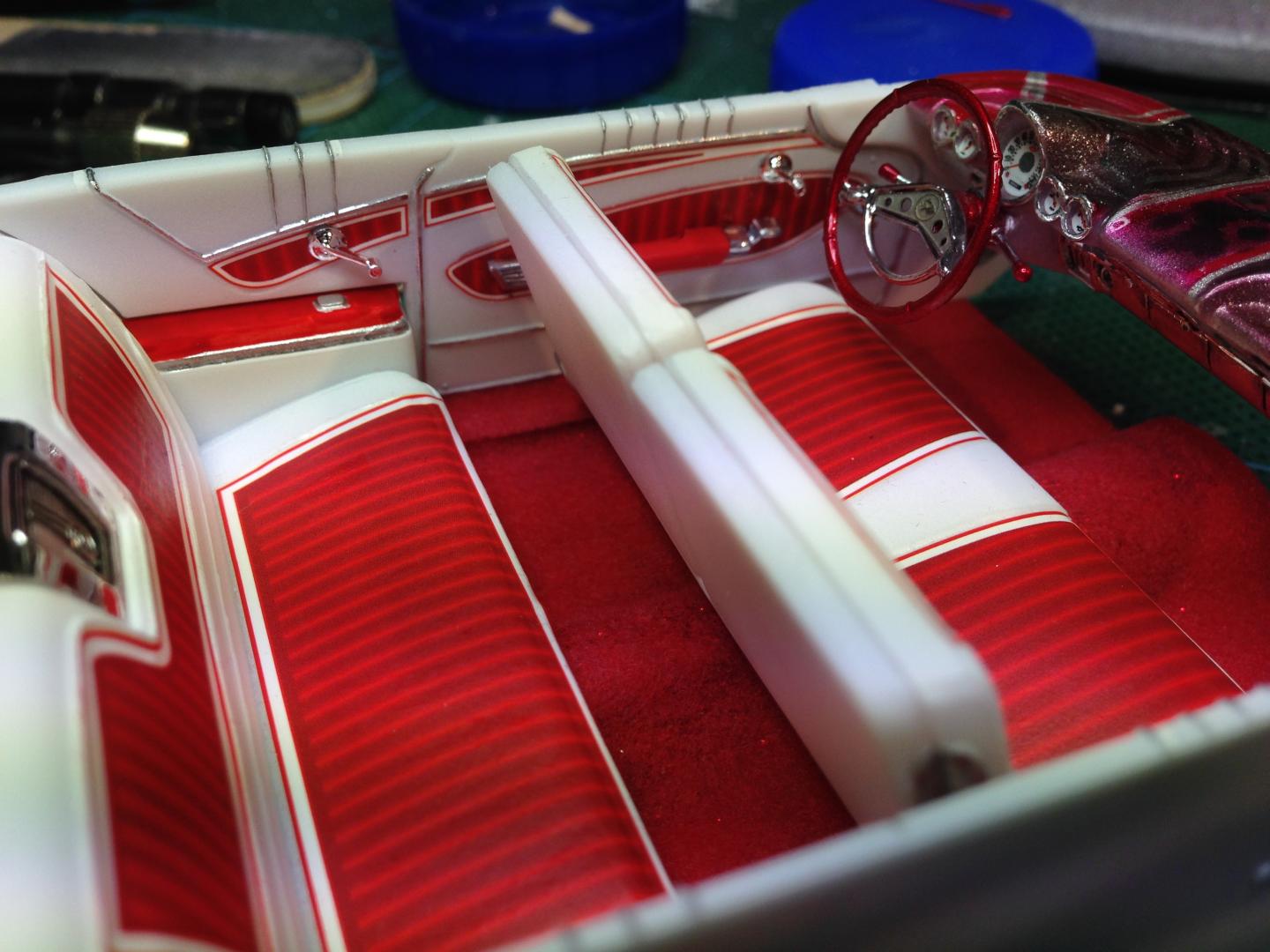

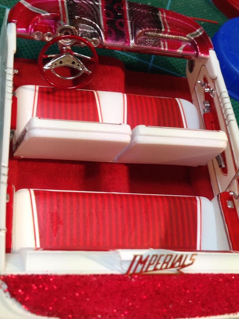

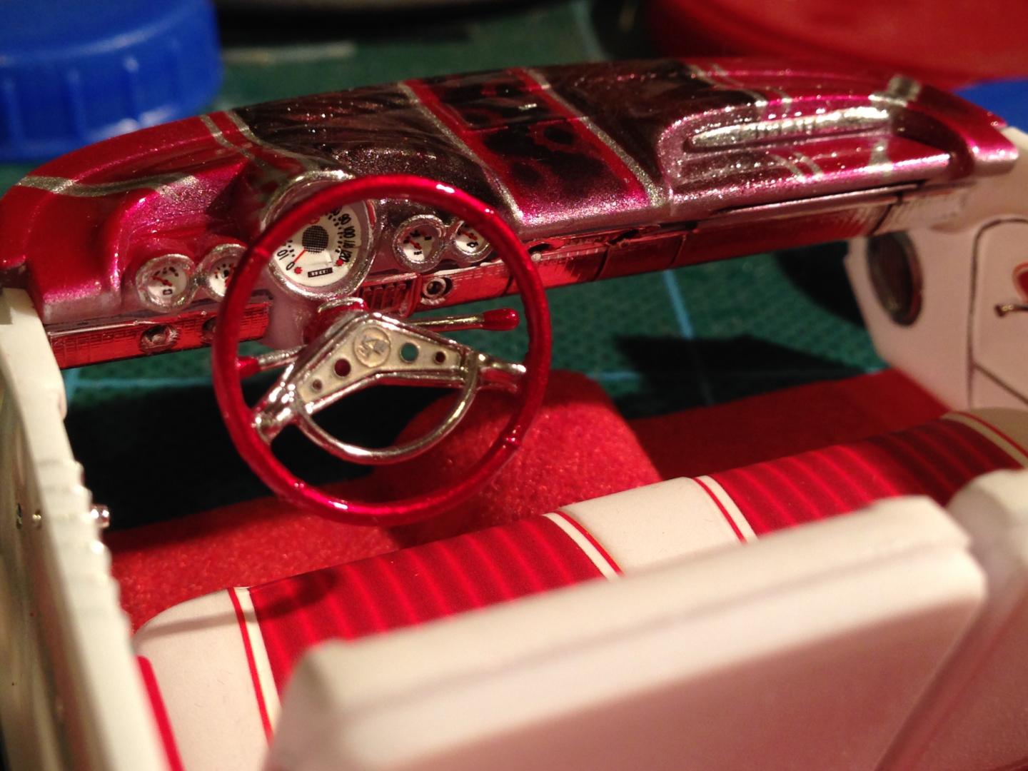

geetee66 Posted April 18, 2019 Author Posted April 18, 2019 Finished the interior. Separate window cranks are a nice touch in this kit ? Flocked carpet applied with double sided tape. Works better than pva white glue. 1
Modlbldr Posted April 18, 2019 Posted April 18, 2019 Looking Sharp! The interior work looks very clean. Been enjoying following your work. Later-
Geno Posted April 18, 2019 Posted April 18, 2019 What a killer build. Guy, you are rockin' this one. Way cool.
Rider Posted April 18, 2019 Posted April 18, 2019 (edited) I have to agree, the flocking on the tape looks real nice, more uniformed then most glue methods. The interior is very sharp, nice work. Edited April 18, 2019 by Rider
espo Posted April 18, 2019 Posted April 18, 2019 I agree on the carpeting. Can you share what brand or type of tape you used, I would like to try that myself.
geetee66 Posted April 19, 2019 Author Posted April 19, 2019 On 18/04/2019 at 4:16 PM, espo said: I agree on the carpeting. Can you share what brand or type of tape you used, I would like to try that myself. Sorry but I don't know the brand. Nothing printed on the cardboard ring to give me a clue. I've had it for literally decades! But it's still very sticky. I also use this tape to mount small parts on wooden lolly sticks to paint them.
