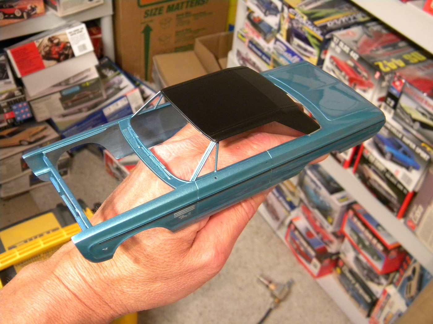

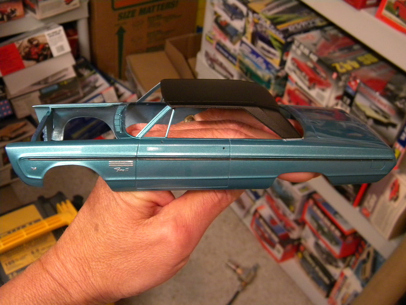

StevenGuthmiller Posted June 19, 2019 Author Posted June 19, 2019 I finally got the body all polished, as well as most of the chassis plate details complete, so it was time to paint the vinyl top. Isn't it funny how you spend your whole life trying NOT to get any orange peel in your paint, to the point that it becomes nerve wracking when you're actually trying to get some! Steve

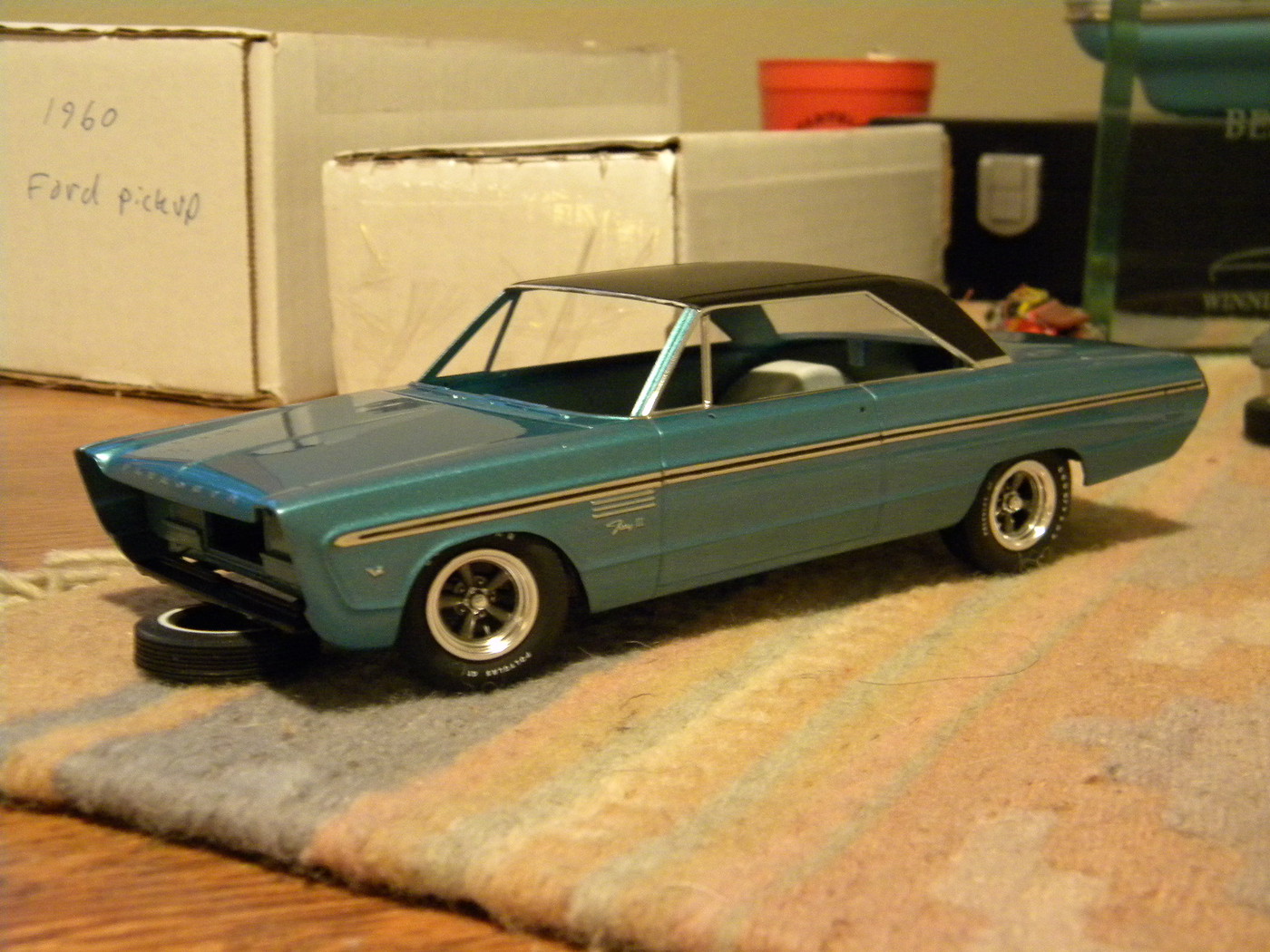

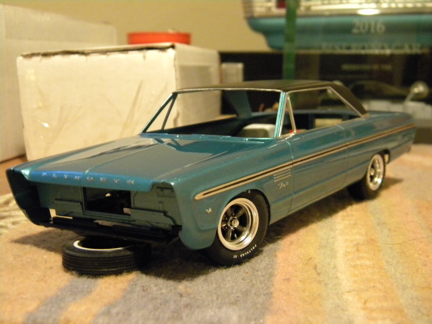

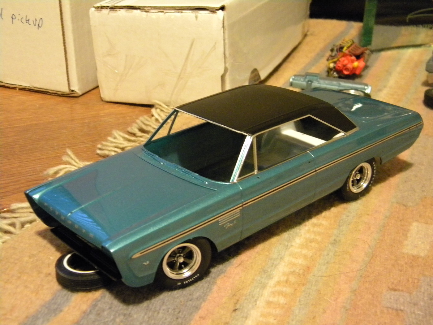

StevenGuthmiller Posted June 23, 2019 Author Posted June 23, 2019 (edited) Just a few more teaser pics now that the body is fully polished, the vinyl top is complete and some of the trim is foiled. I really wasn't certain how well I was going to like this body style, but now that I see how aggressive it looks with the skirts removed and the right wheels and tires, I'm really starting to like it! Please excuse the usual bad photography! Steve Edited June 23, 2019 by StevenGuthmiller
Fish_65 Posted June 23, 2019 Posted June 23, 2019 How did you paint the black in the side spears ? Nice BMF work too.
StevenGuthmiller Posted June 23, 2019 Author Posted June 23, 2019 11 minutes ago, Fish_65 said: How did you paint the black in the side spears ? Well, originally I had painted that strip black before clear coating the body and was planning on just foiling around it. After trying that approach, I found that it wasn't working as well as I had hoped. So I just masked off the the exposed chrome trim and then ran some flat black down the middle. Then I removed the tape and went over the foil with a Q-tip with a little mineral spirits to clean up any edges. It seems to have worked out pretty well. Steve
Modelbuilder Mark Posted June 23, 2019 Posted June 23, 2019 Looking great as per usual from you sir! BTW, what will you be doing moving forward for Chrome work? Chrome Tech, Little Motor Kar etc, are all gone. There is a void... :-(
StevenGuthmiller Posted June 23, 2019 Author Posted June 23, 2019 1 hour ago, br67 said: I like that tough stance Steve you have mocked up The stance will probably be a little higher, at least in the front, when the model is finished. I really didn't intend for it to have this much of a rake. Steve
