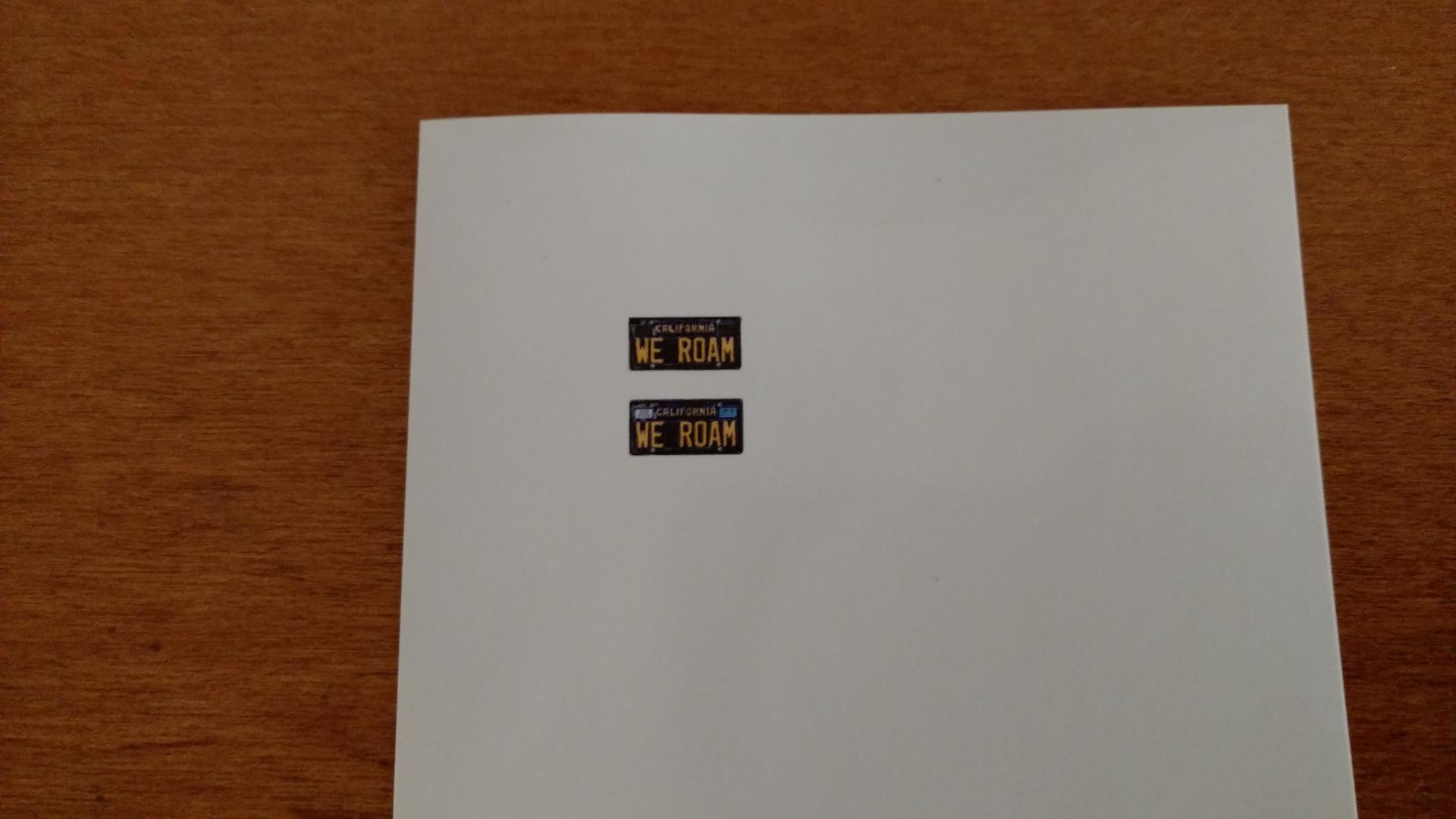

Rodent Posted April 12, 2019 Posted April 12, 2019 These plates started out as a photo of my neighbor's rear plate, shot straight on with my phone (jpg). I cut out the plate itself using Snipping Tool in windoze, which makes a .png. I pasted the images into Word and used the gridlines in the "view" tab to make the images 1/2 inch wide. I printed it on photo paper with a Canon MX922. The front plate is the same image with the registration stickers edited out.

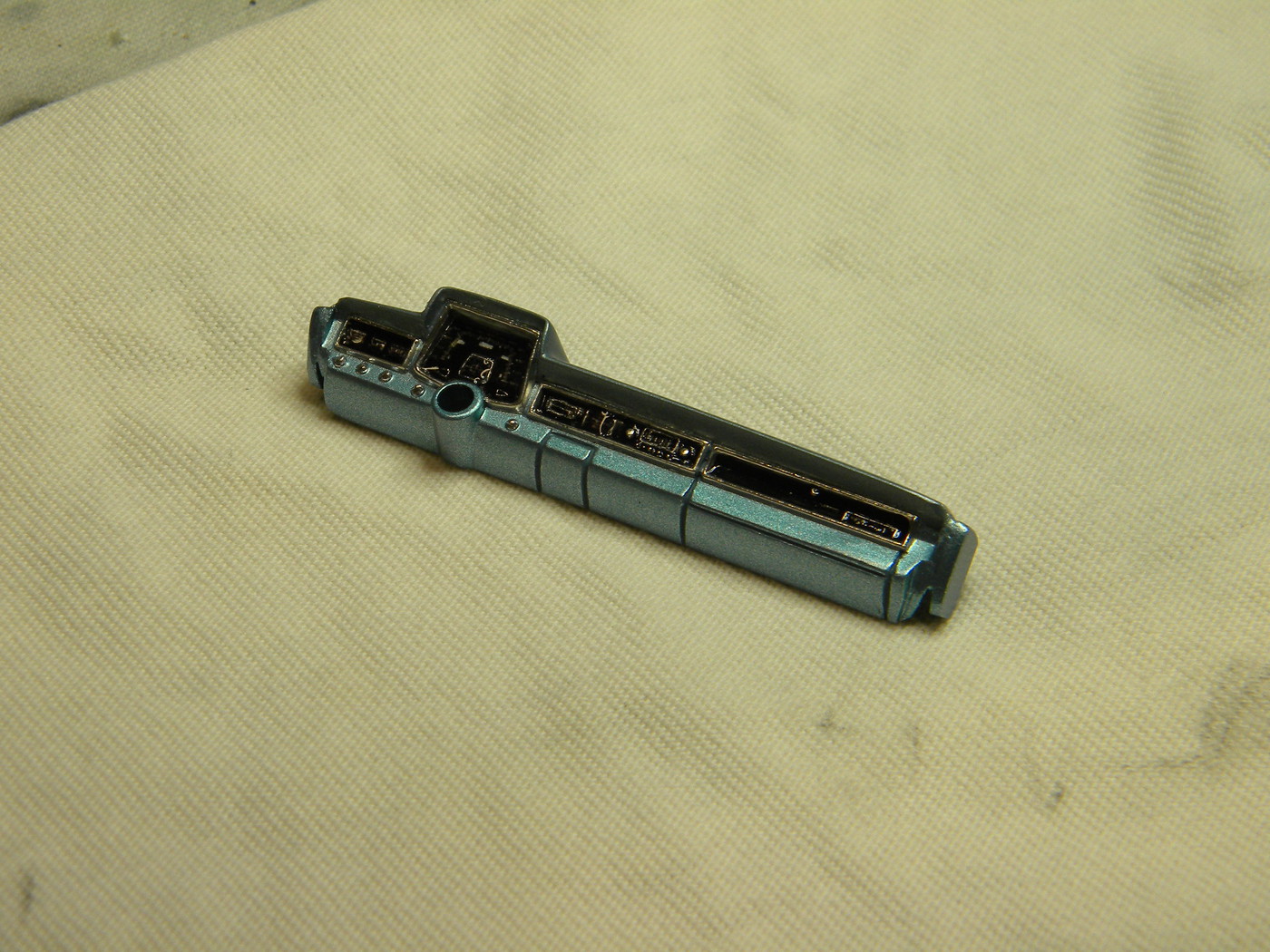

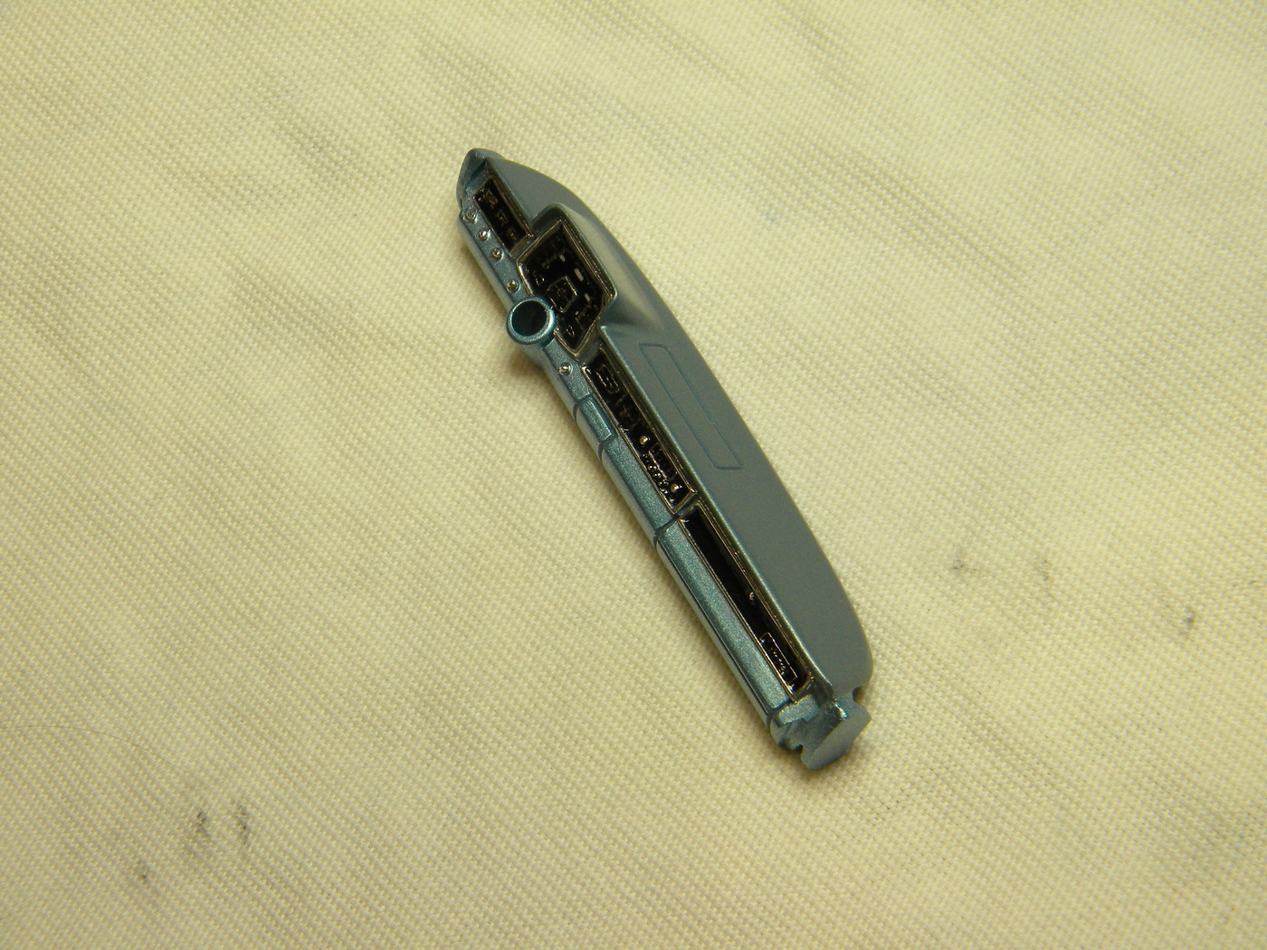

StevenGuthmiller Posted July 5, 2019 Author Posted July 5, 2019 Just thought that this might be a good place to post a photo of how the photo reductions that Bob sent me worked out. I'm happy with them! Steve
