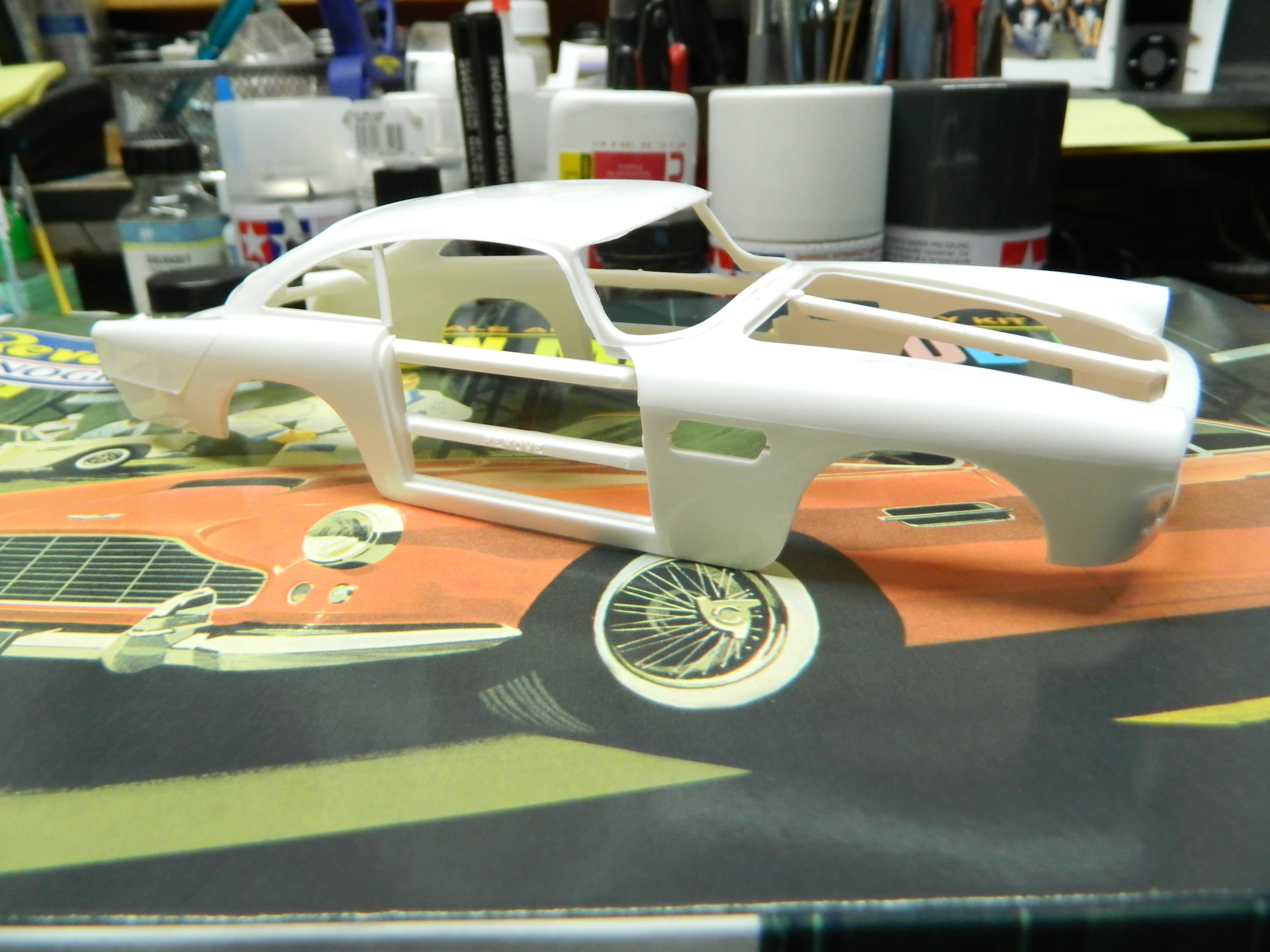

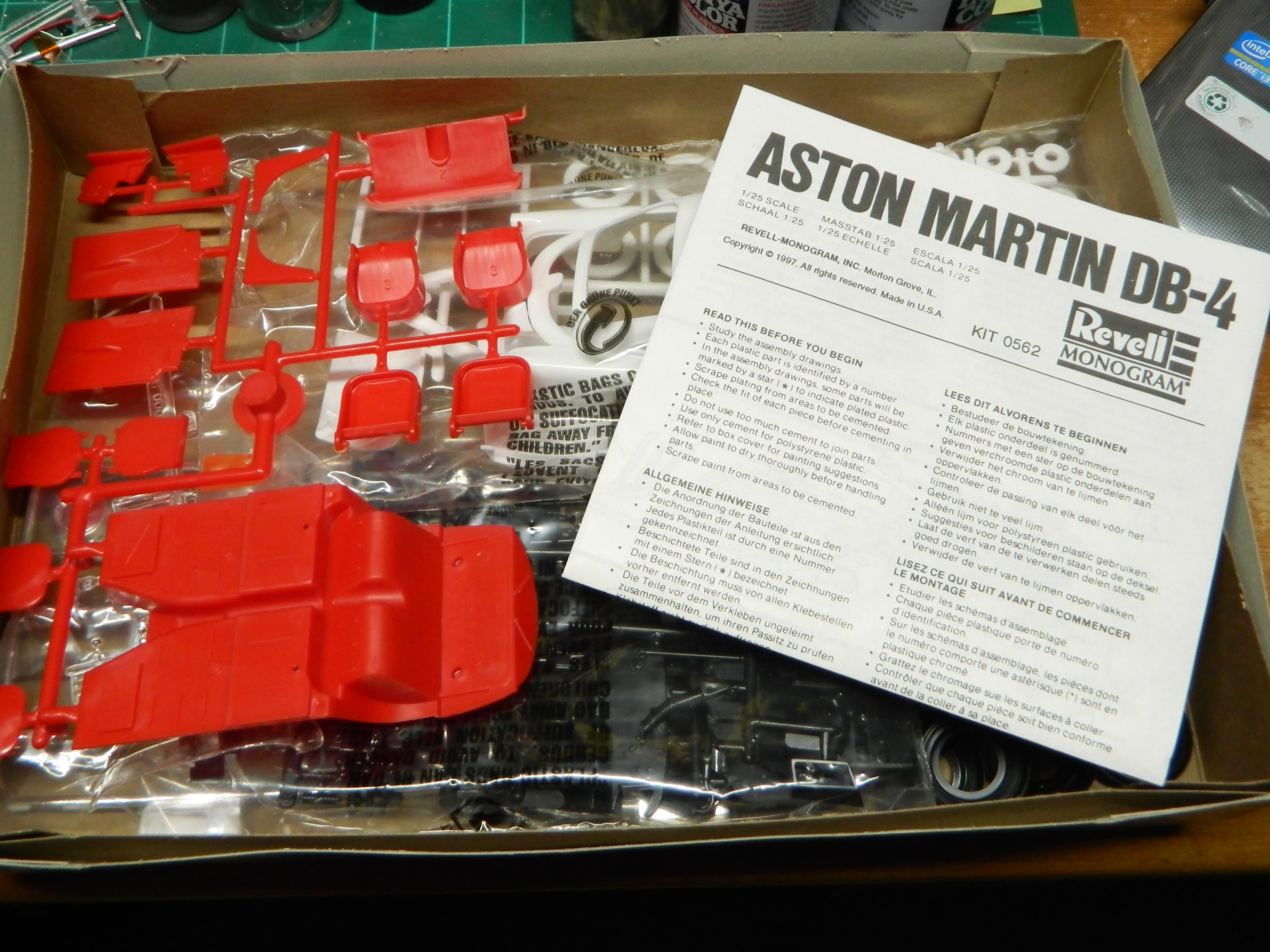

I have been wanting to start this long before I had came into possession of this kit.  This is the Revell/Monogram Aston Martin DB4.  I have been long since been looking for a full-detail DB5 and this is a s close as I have been able to get to.  The only difference between the DB4 and the DB5 is the engine size and a slightly long rear deck.  This kit is from 1979 according to the molding on the inside of the body.  There is some flash and significant moldlines on the body.  This may take a while to clean up.  My research has been ongoing for a little while now.  Plus, I want to see how many unsuspecting people I can fool into thinking that this is the James Bond 007 DB5.  Let's see what I can do with this kit.

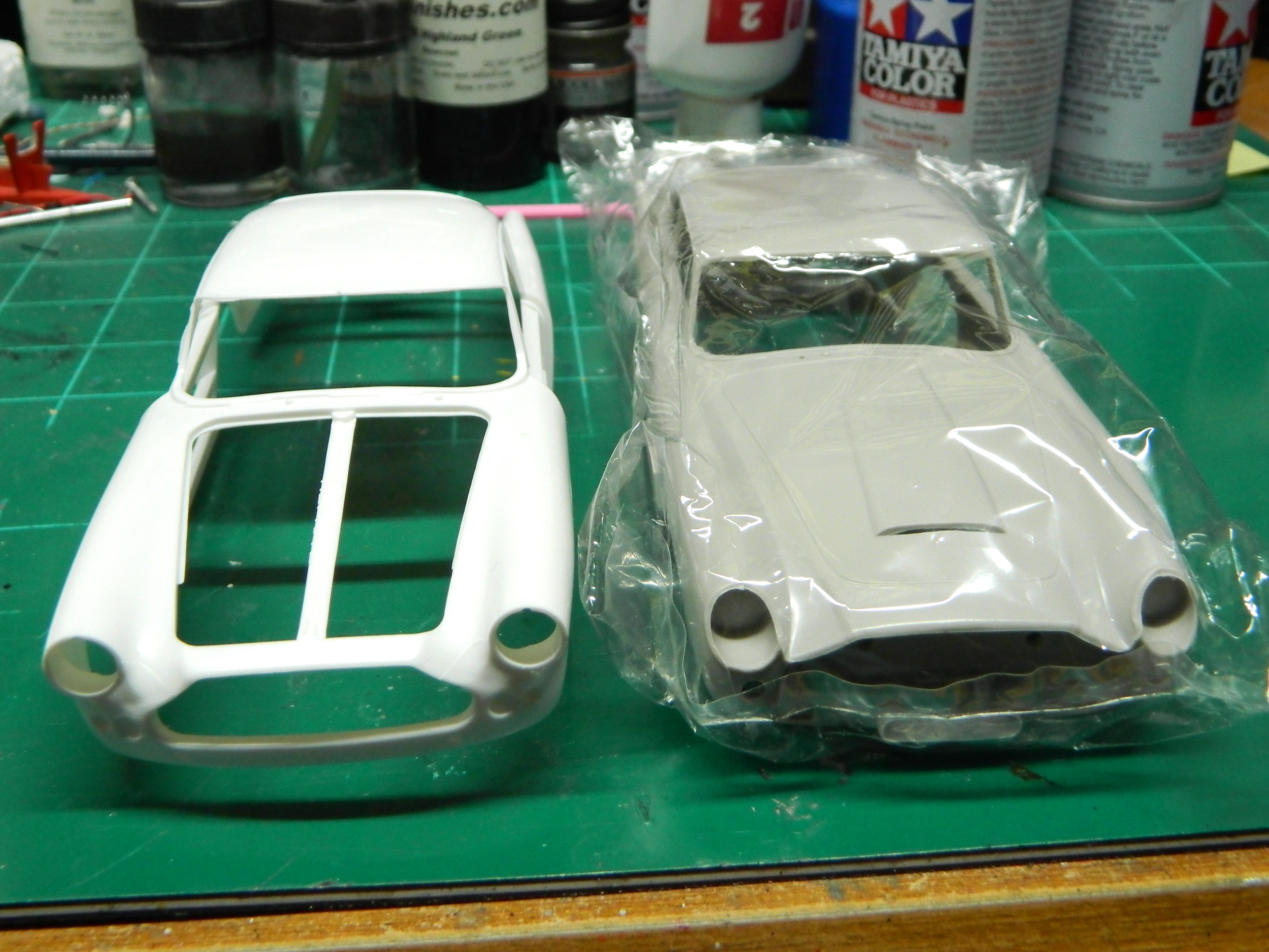

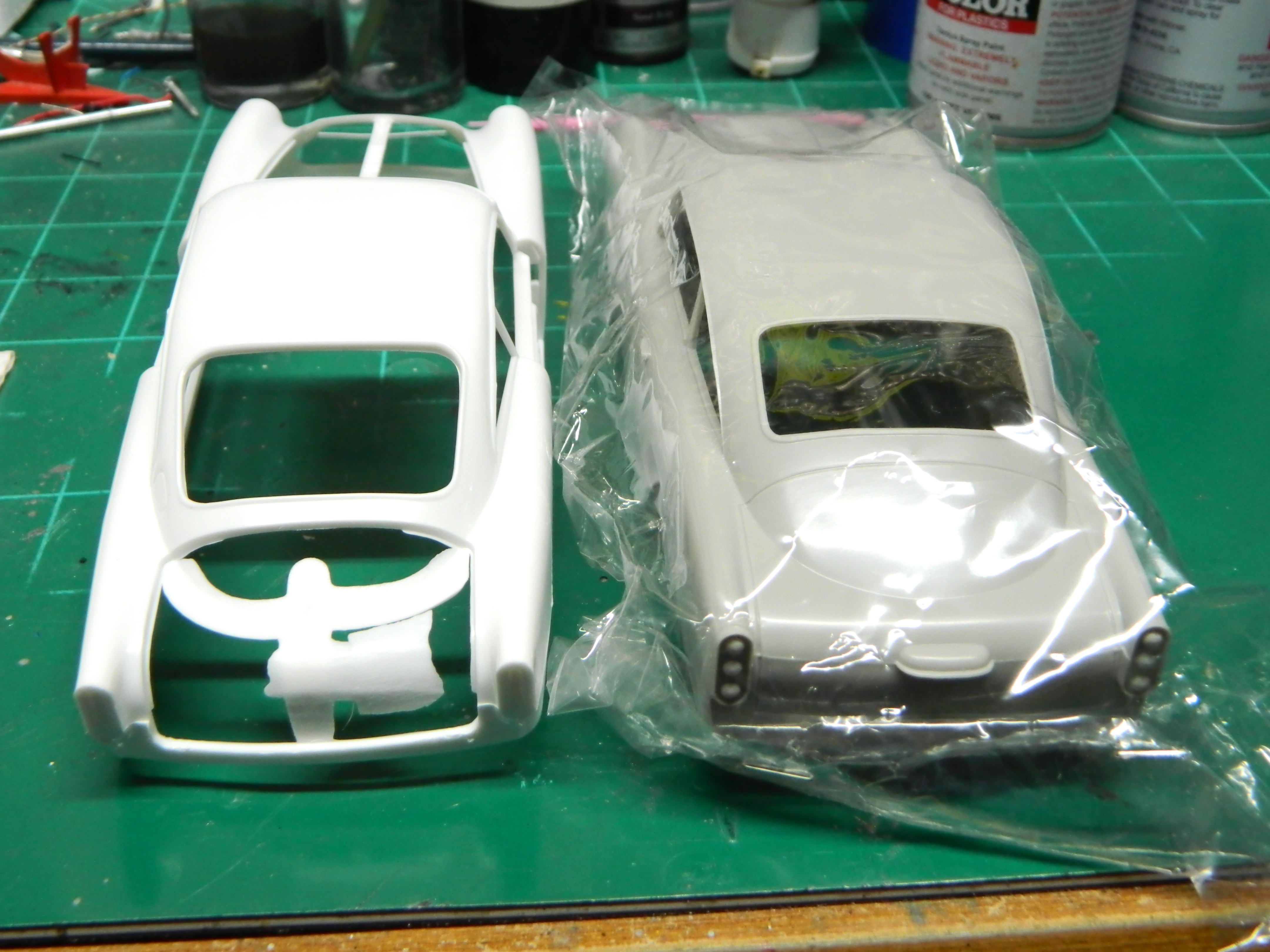

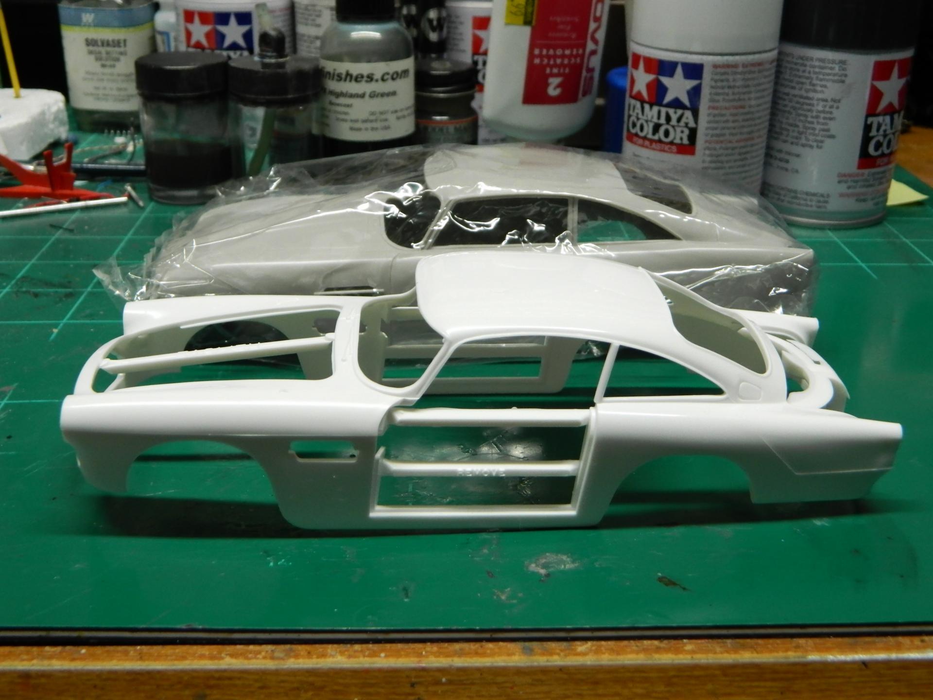

I decided to post three pictures of the DB4 (white) and the DB5 (grey) side-by-side.  You can see the obvious differences between the two cars.  Both models will require bodywork to get them ready for primer and paint, but the DB5 will not be assembled.  I decided a while ago NOT to build the 007 DB5 due to its value.  Some discussion between myself and several model builders in my Club have resulted in some interesting reasons for and against building the 007 DB5 kit.  I have decided to hold onto the DB5 kit for now and not build it.  Maybe I'll build it later.  We shall see.

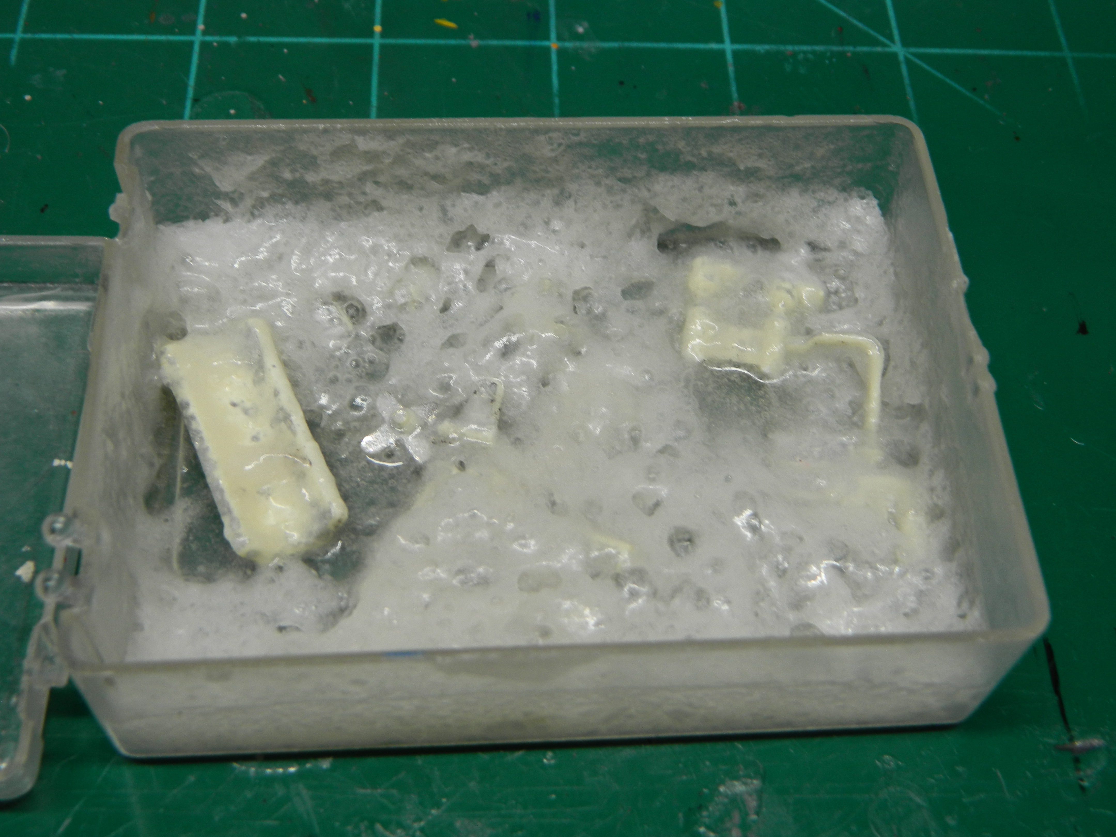

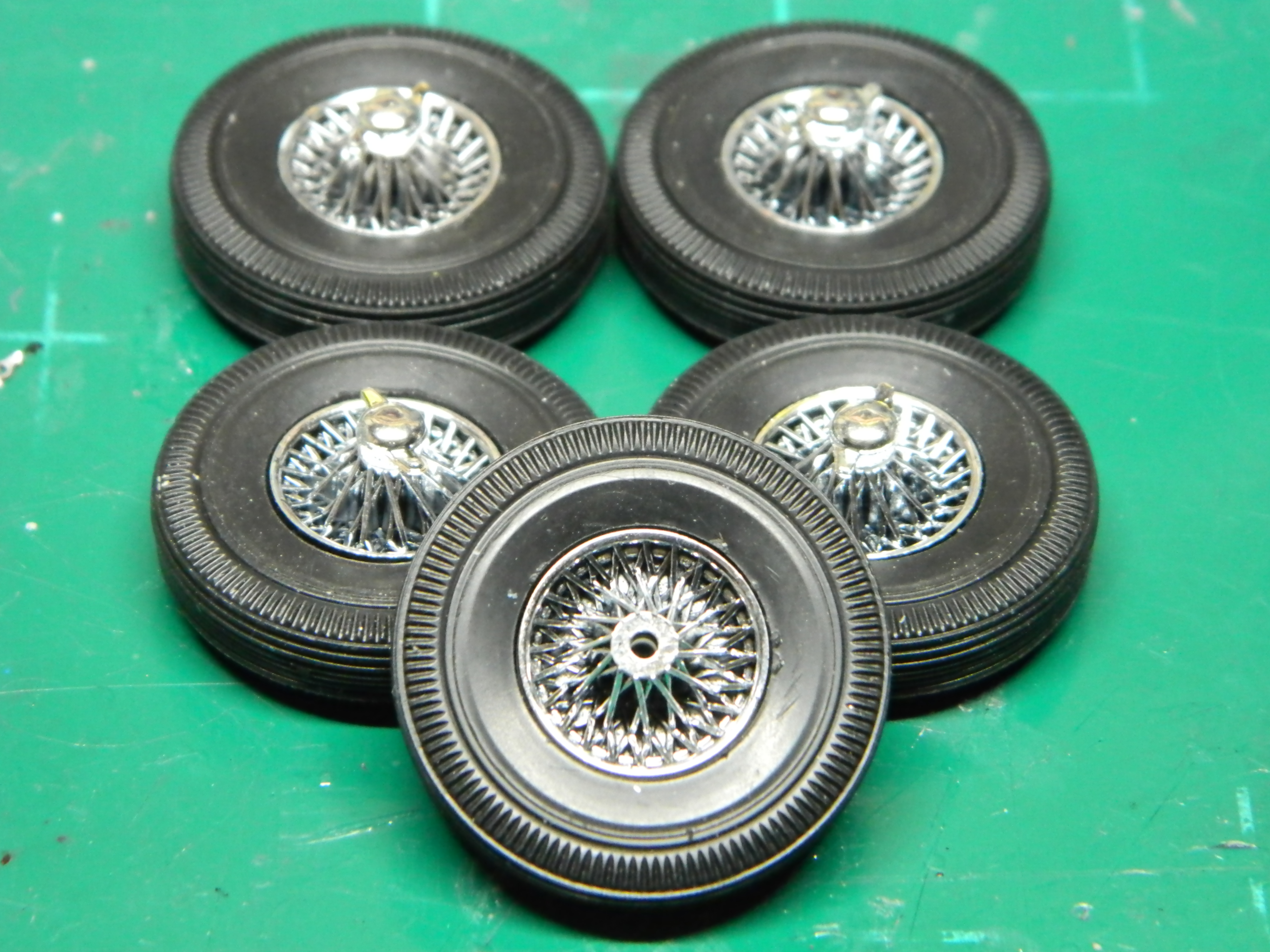

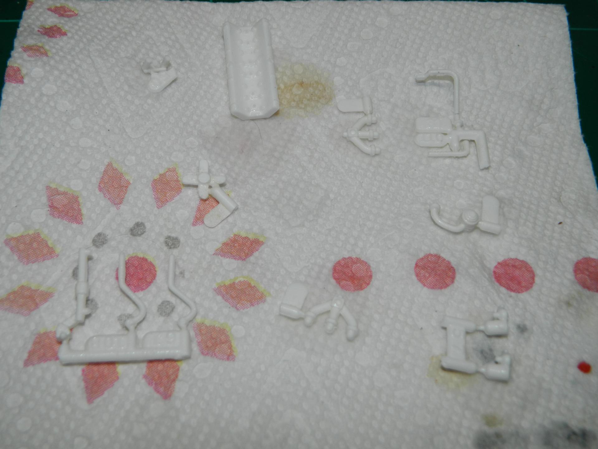

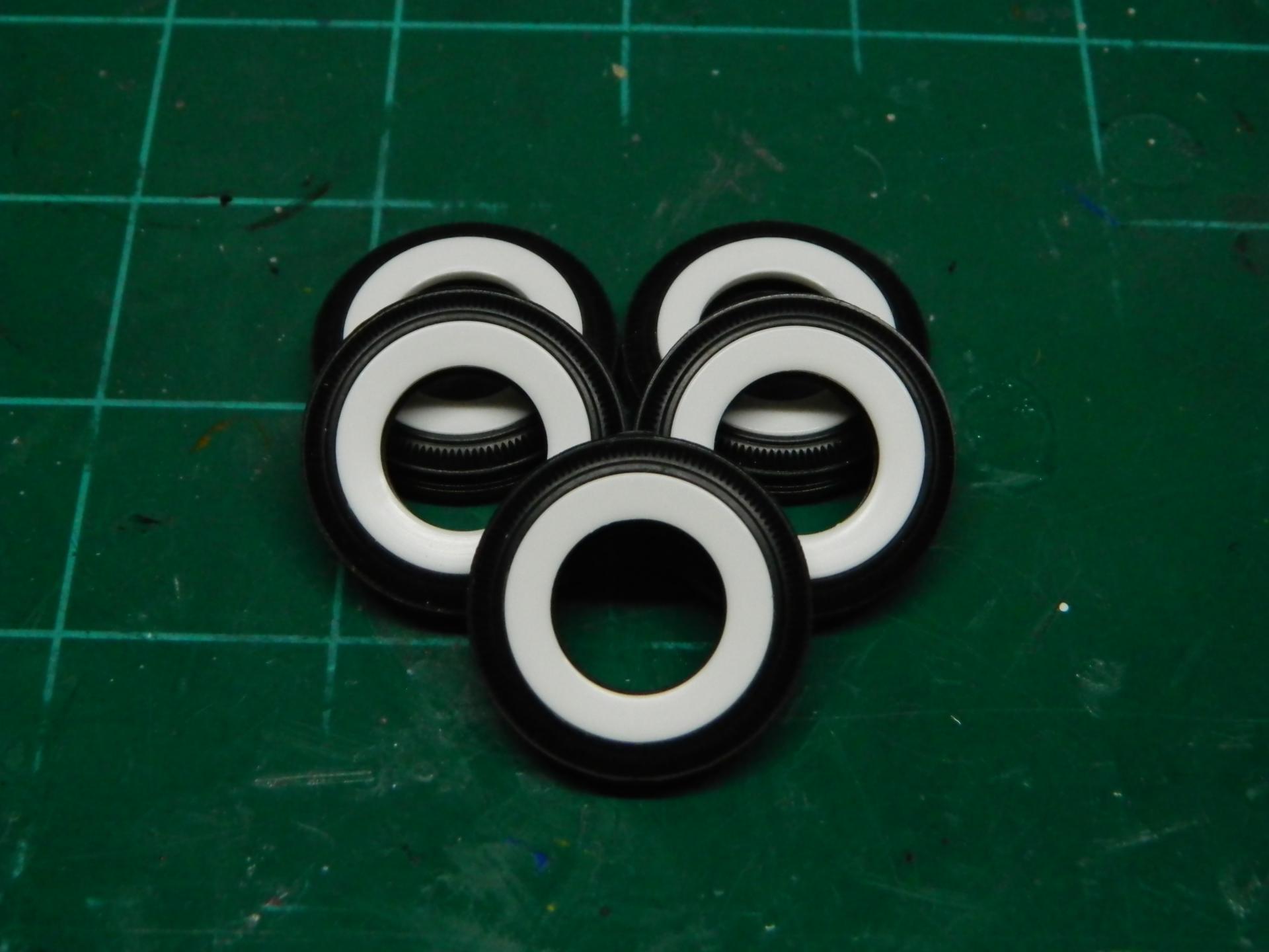

I decided to play around with this kit a little bit this afternoon.  I assembled the whitewalls, but I'll turn the tires backwards and paint the whitewalls flat black or rubber color to hide them.  Whitewalls on a sports car?  Must be a '60s thing.  I thought I was going to assemble a good part of the engine only to discover that many parts are chrome plated.  I removed those parts from the main sprue, leaving the number tags on them and gave them a bath in Easy-Off Oven Cleaner.

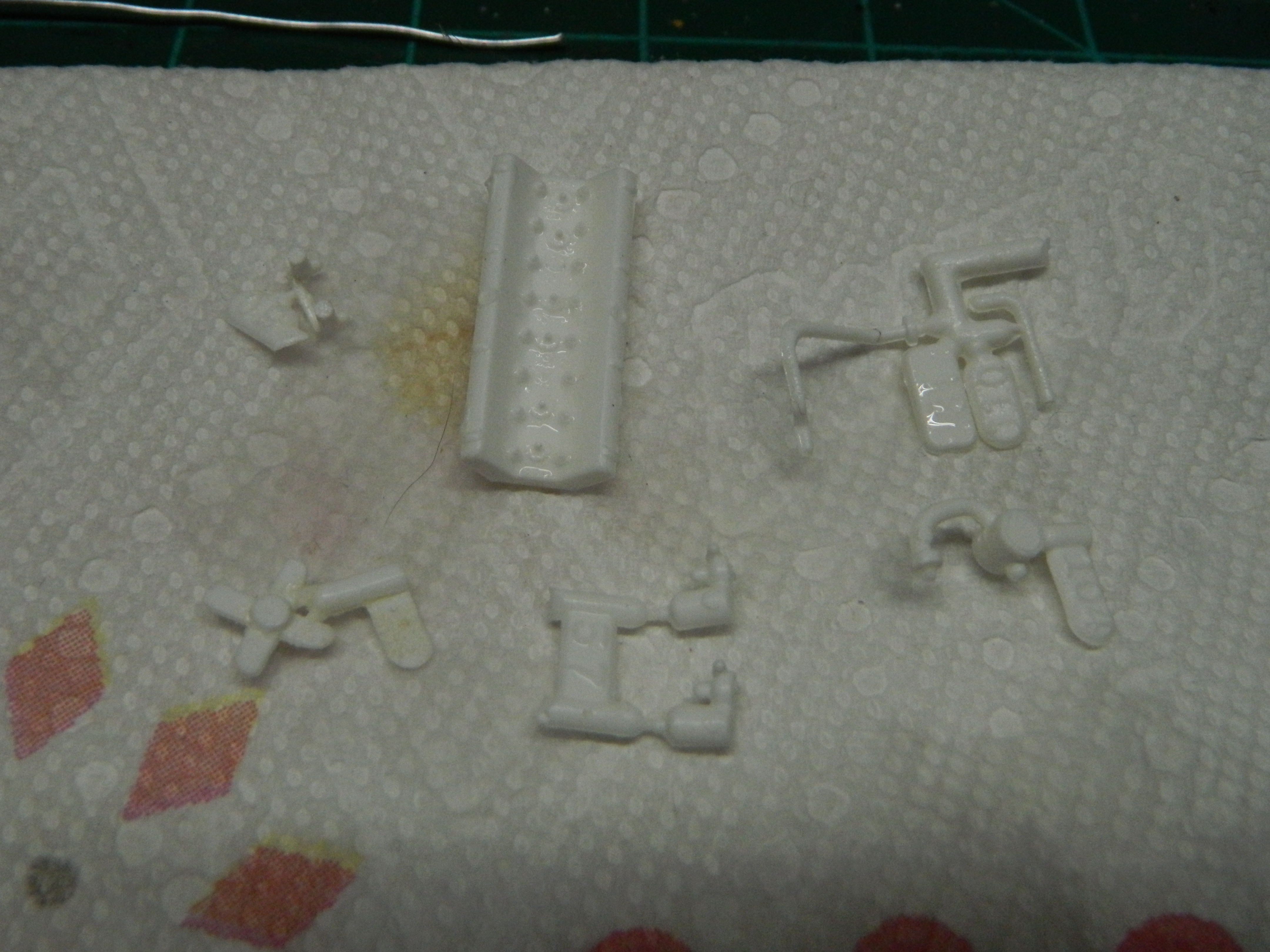

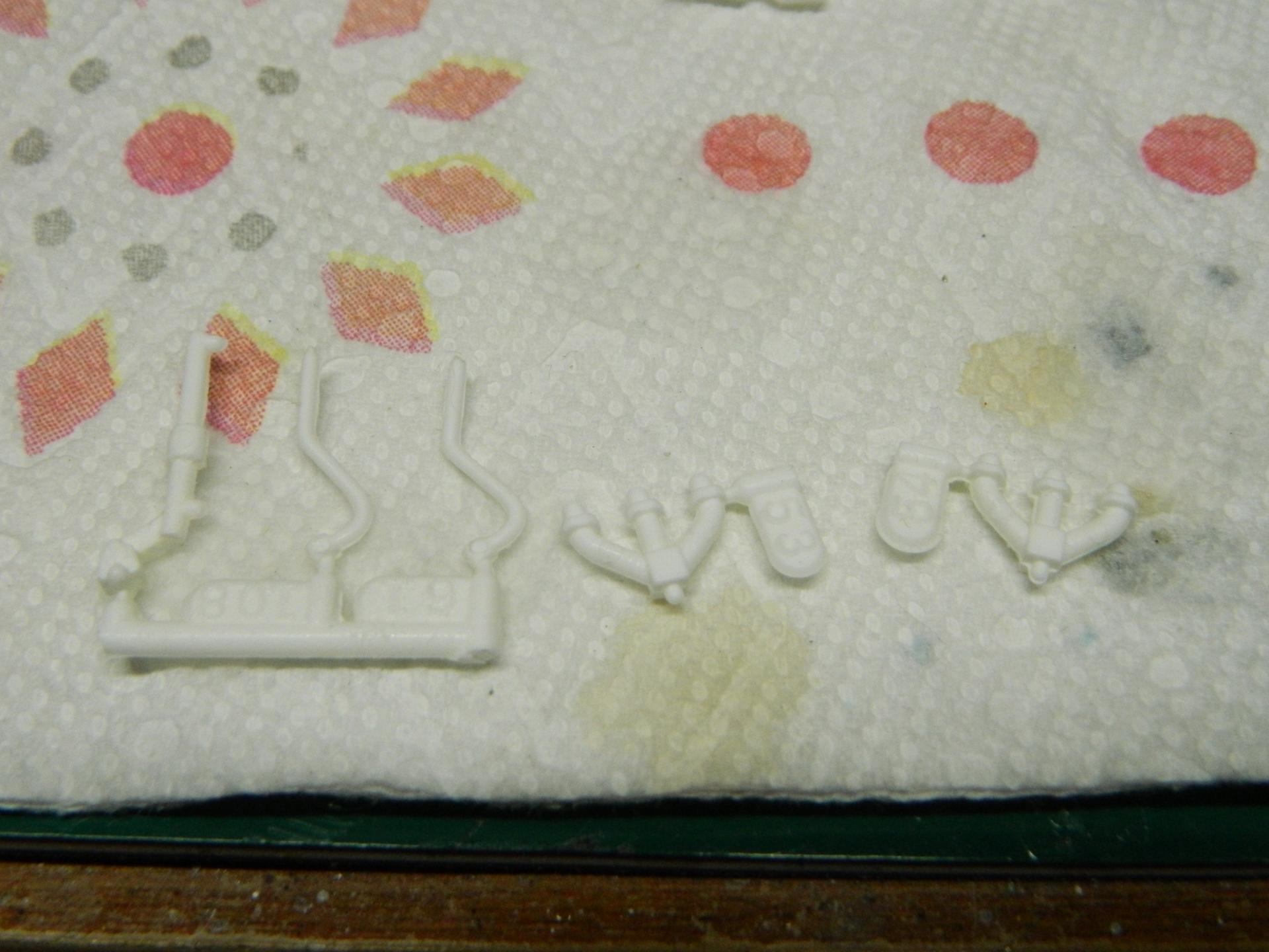

Thanks Robert!  I took a bunch of the chrome pieces for the engine and dechromed them.  I'll paint them up later after I have washed them thoroughly with water and Dawn Dish Detergent.  I've got a long ways to go with this one!  I clipped these parts for the engine from the chrome tree and dechromed them.  Now for some cleanup and painting.

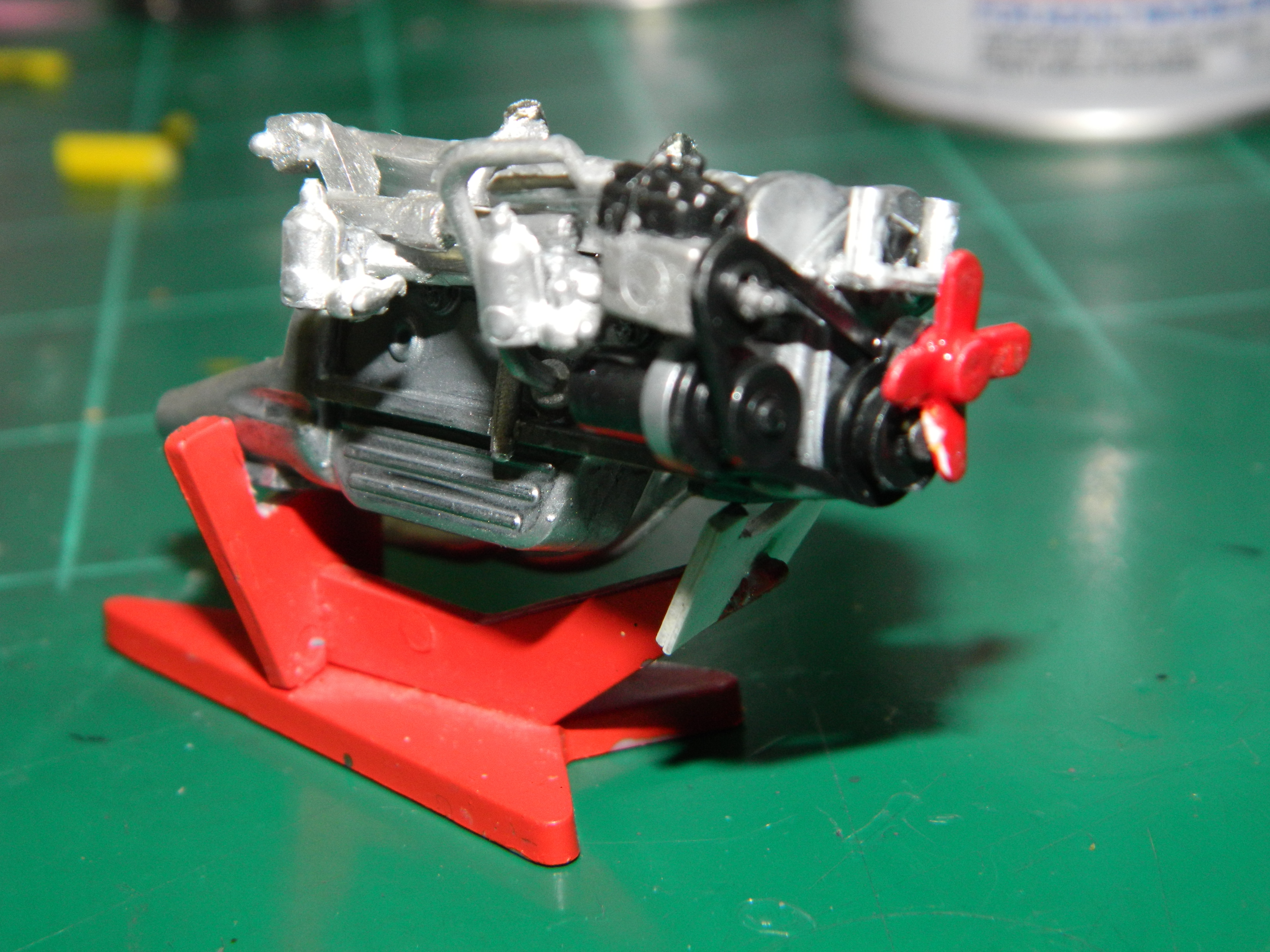

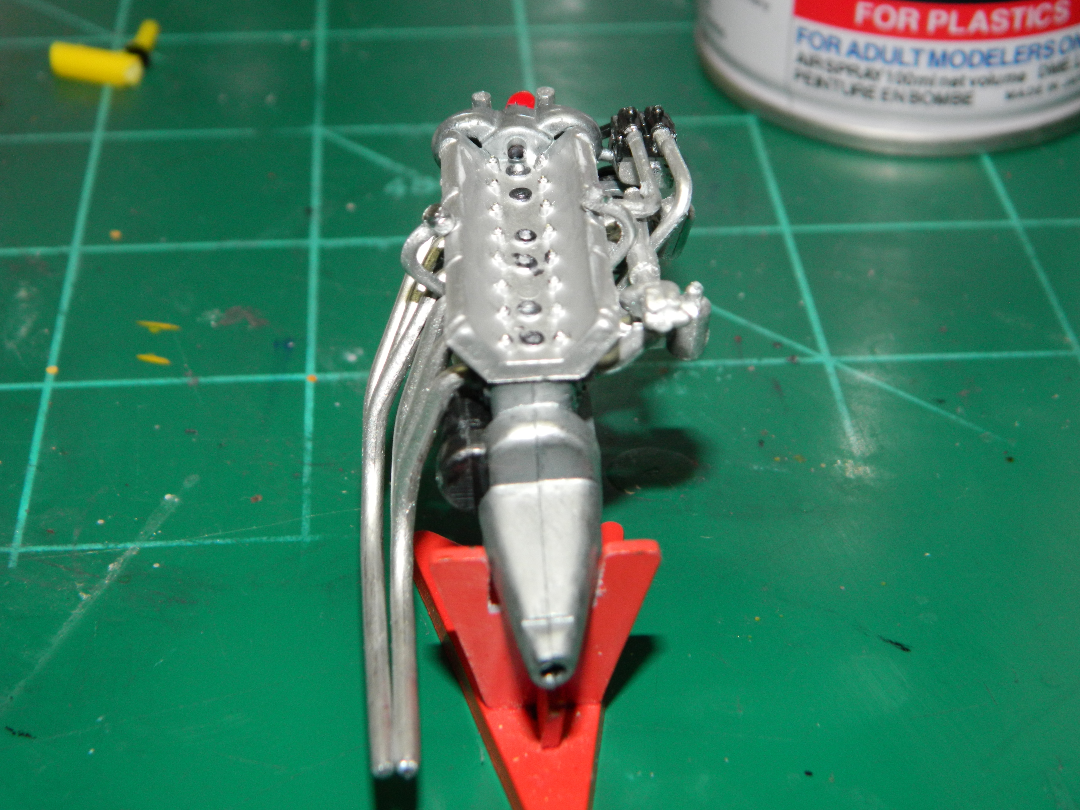

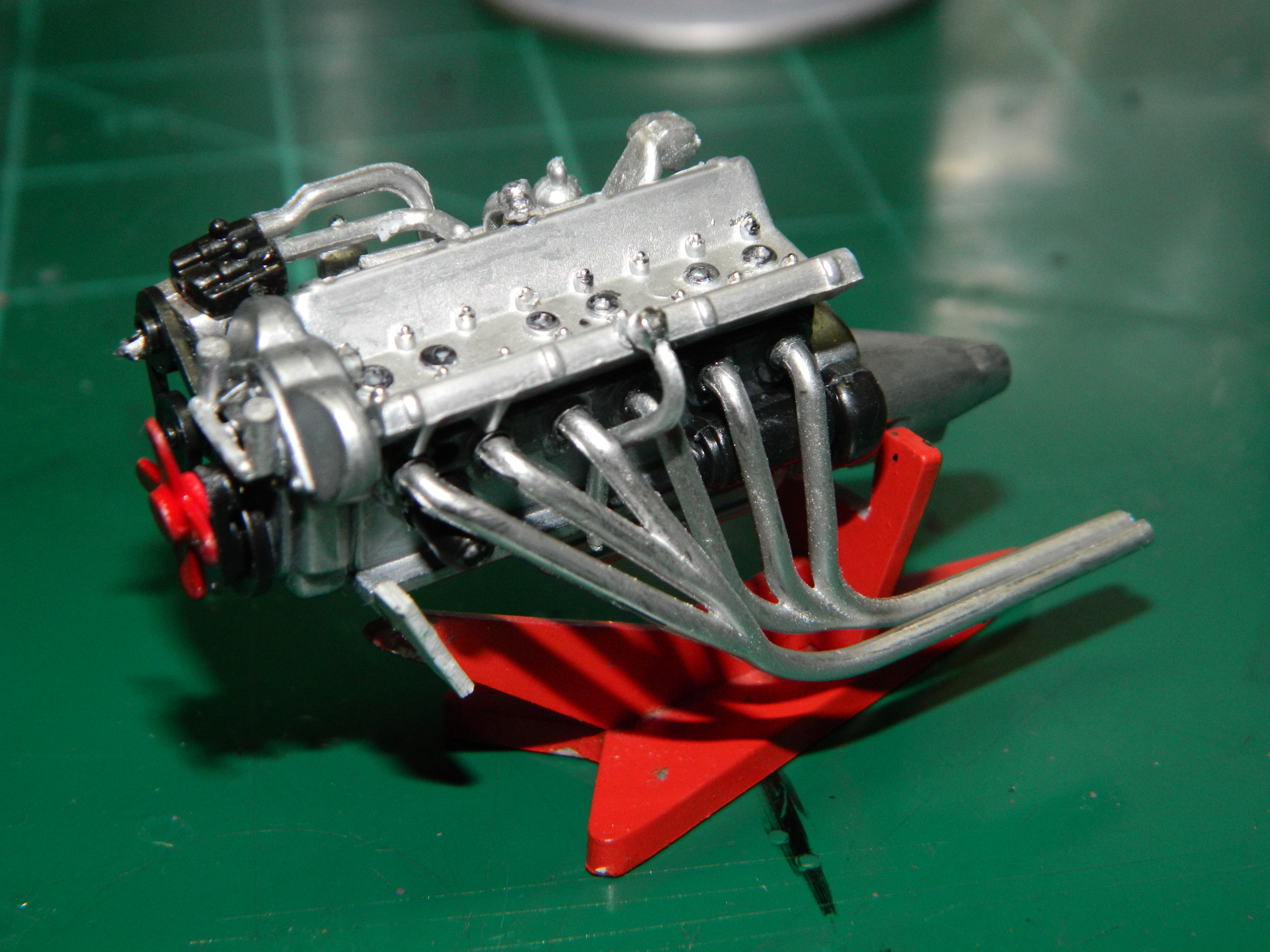

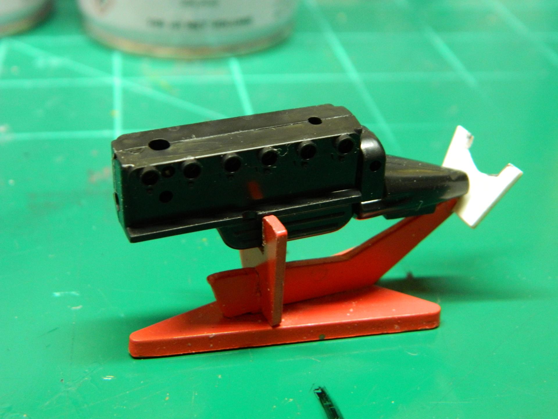

I've been working on assembling the 3.7 Liter engine this afternoon.  Mostly assembled.  Just need the distributor and ignition wire tube added, plug wires and some touchups!

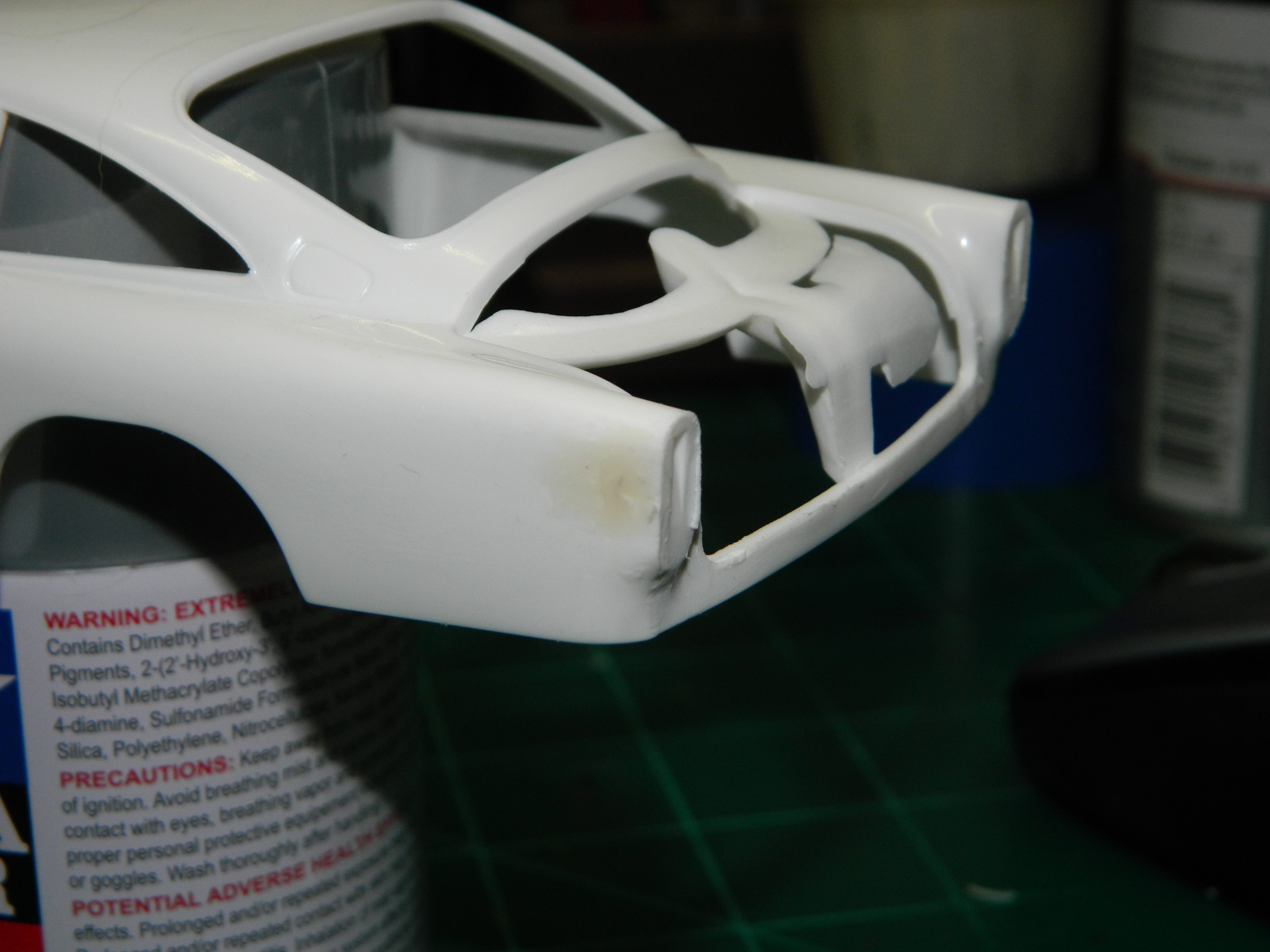

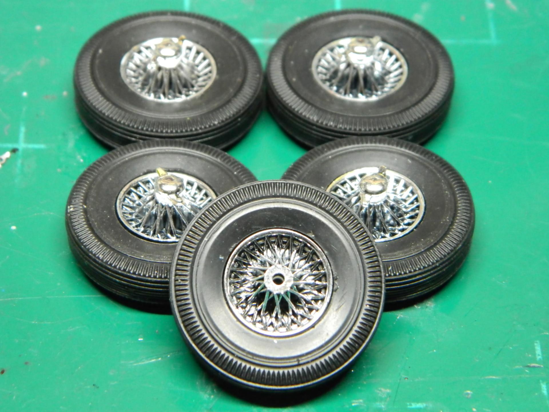

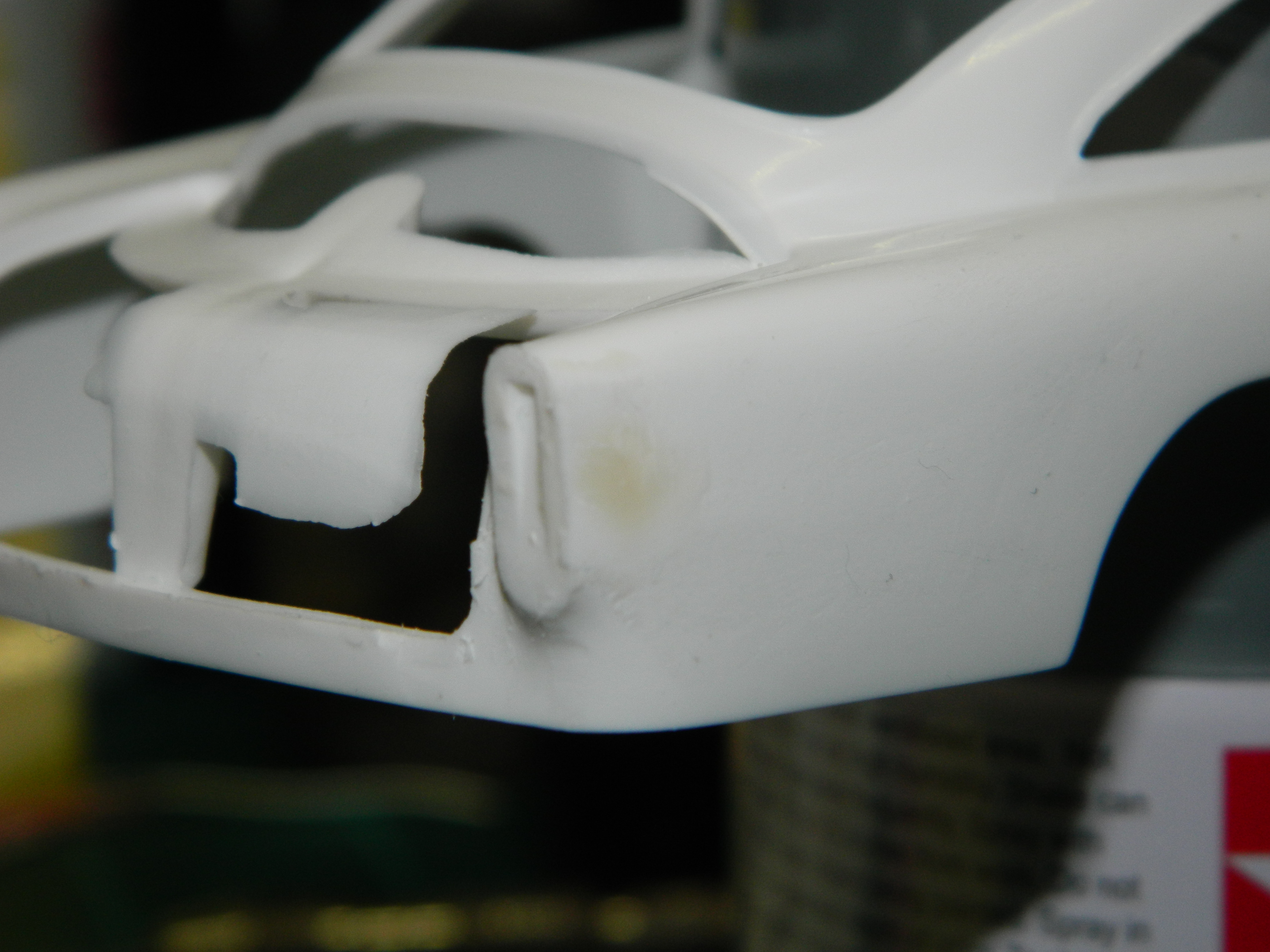

I had filled a couple of sink marks in the rear fenders of the DB4 with Mr. Dissolved Putty.  Great stuff, but does it ever smell!  I painted the whitewall insert with Tamiya Semi-Gloss Black and reversed the tires and assembled the wire wheels and knock-offs.
