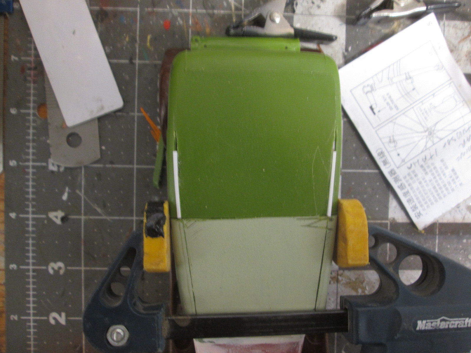

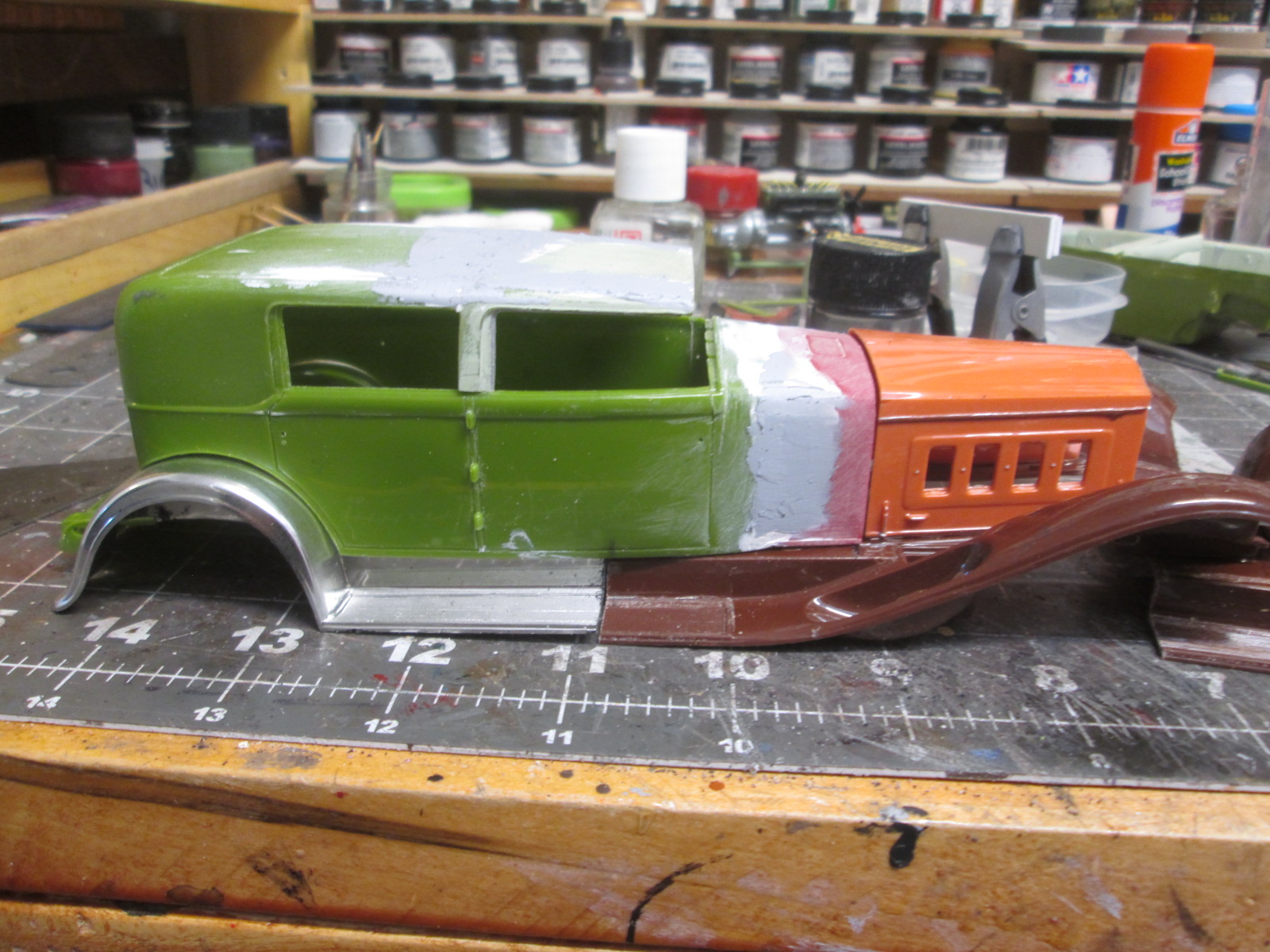

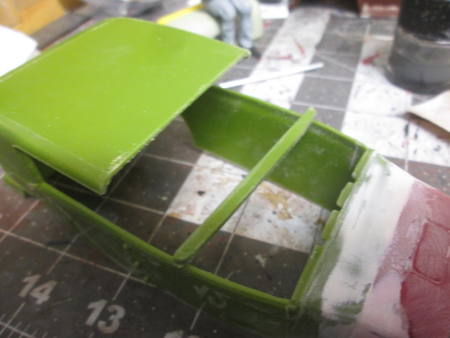

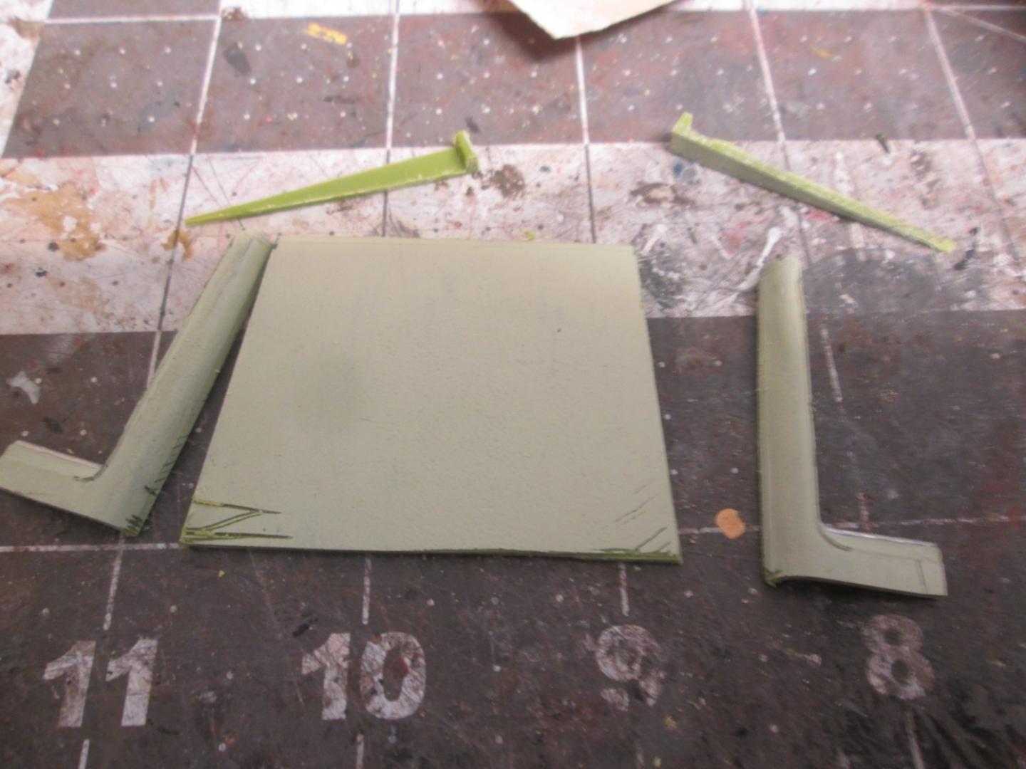

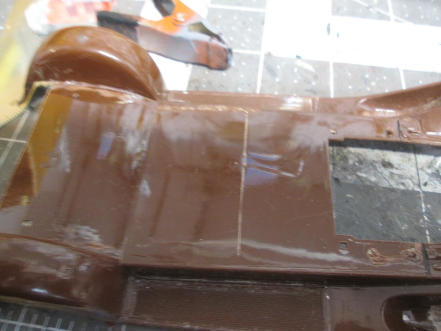

Cut back the front of the rear roof to bring the door pillar in position. Cut the wedges off the front roof to match the body's  taper'
Looks like it might work. Now I have to build some window reveals and rescribe the door openings. And add a "bill" to the front of the roof.

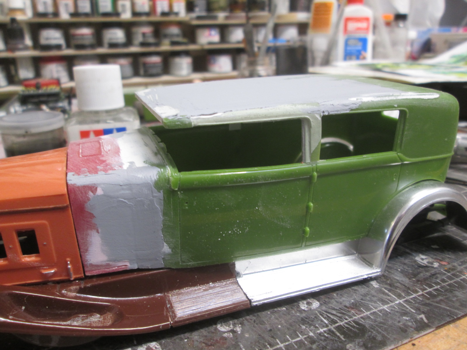

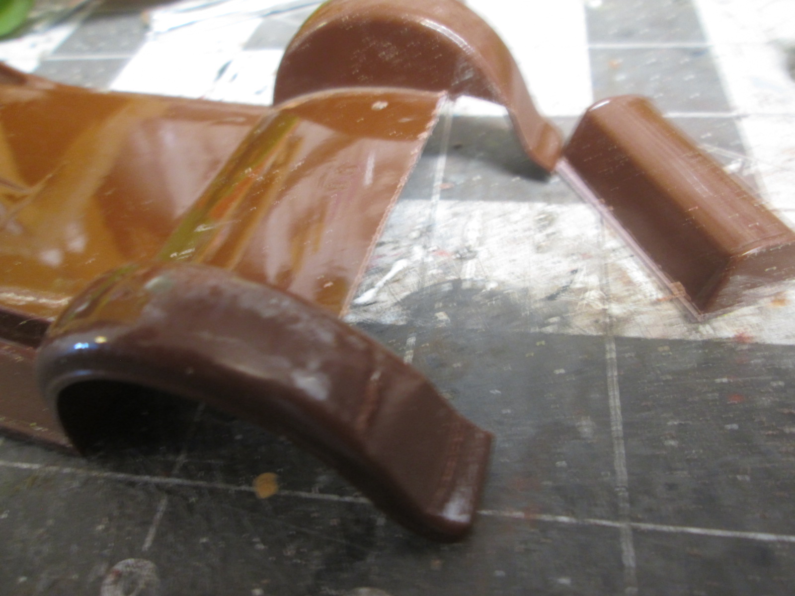

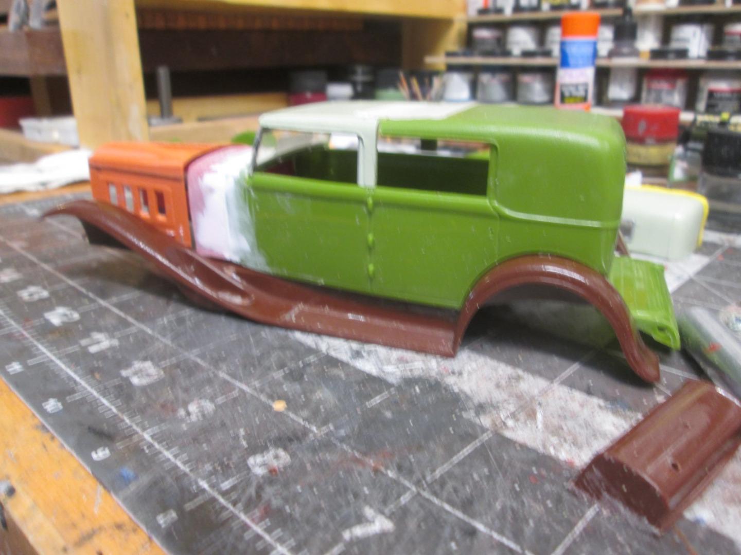

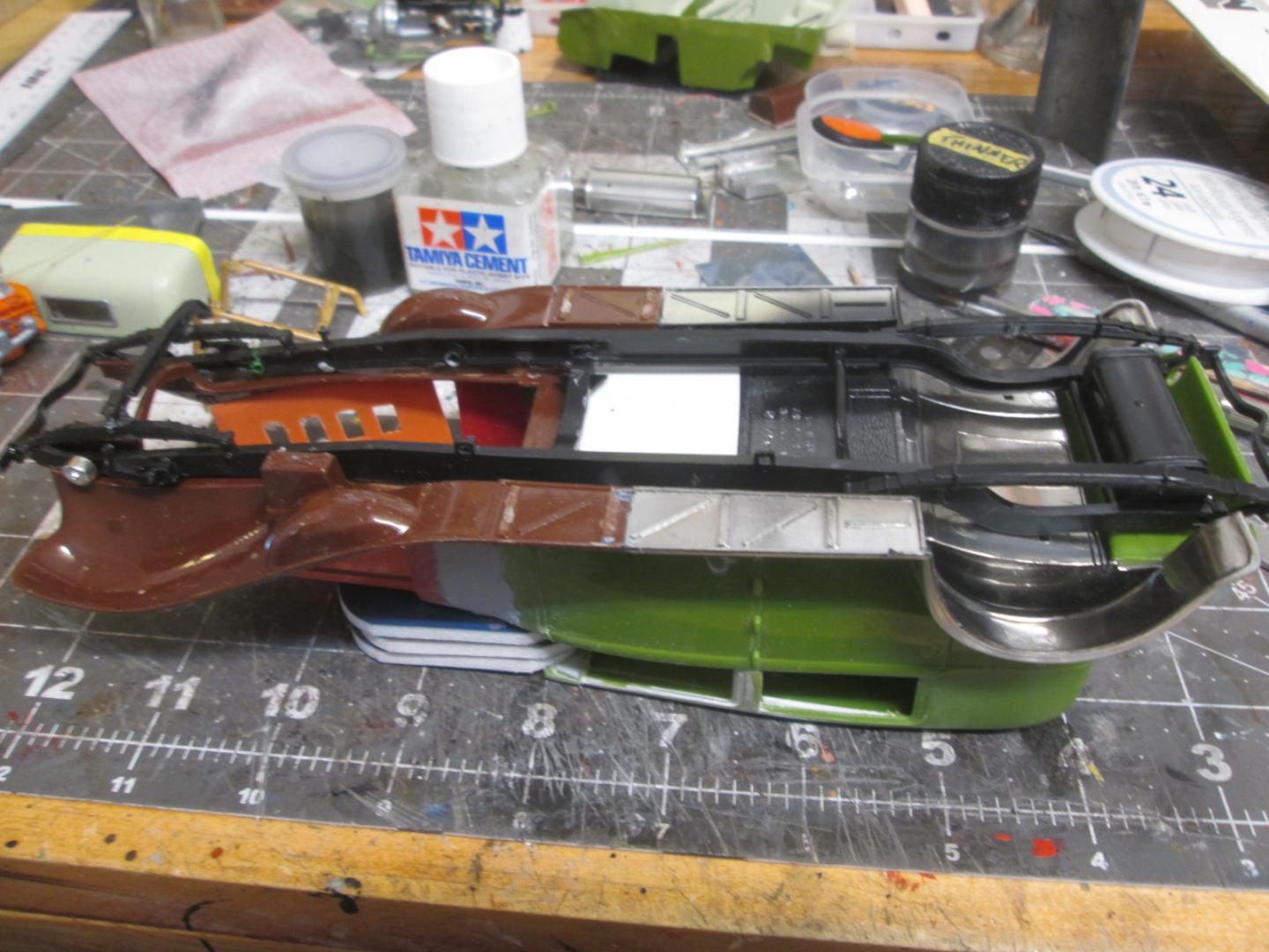

Cut off the apron and gas tank from the Packard fender assembly. this allows the Duesenberg cab to drop right in. i will, however, have to gain some lenght in front.

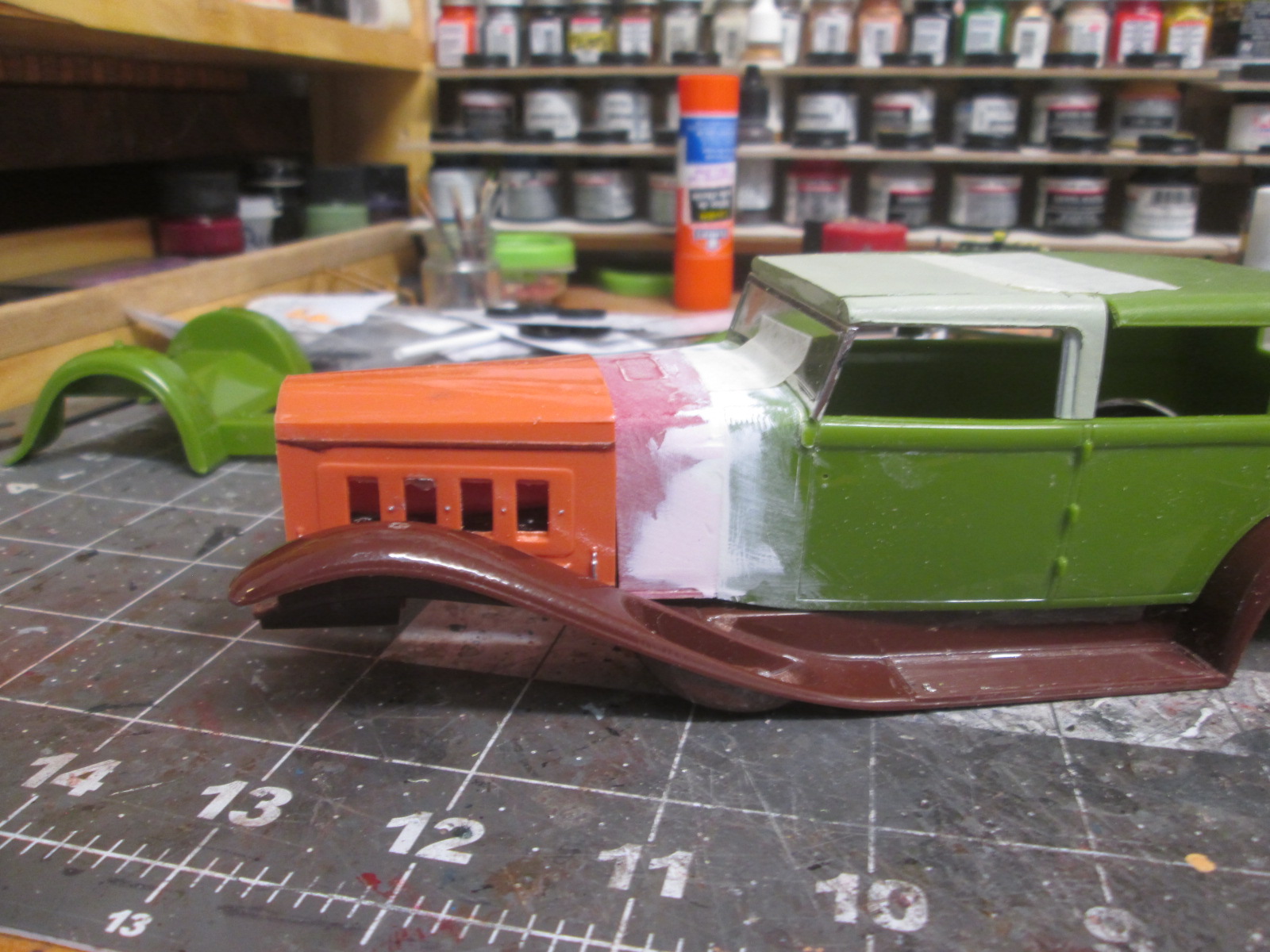

I have to stretch the wheelbase all right. I was going to cut the fender assembly just in front of the rear fenders, lenghten the frame to fit and fab up some new running boards..I only have one Packard rail for some reason and was planning to use either a Rolls Royce frame or a Duesenberg one which may be long enough as it is. Thanks for the offer. Let me investigate the Duesenberg frame first.

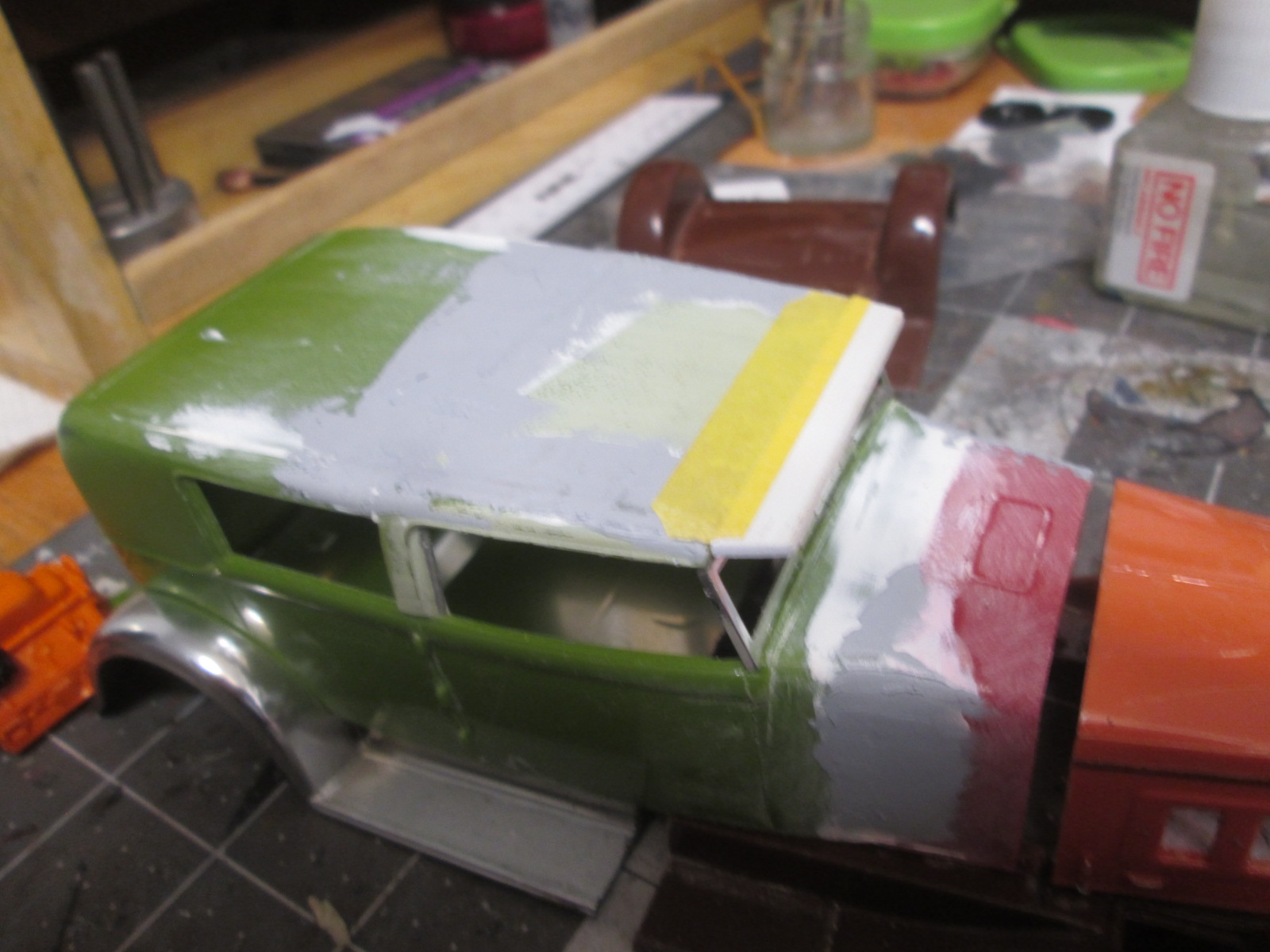

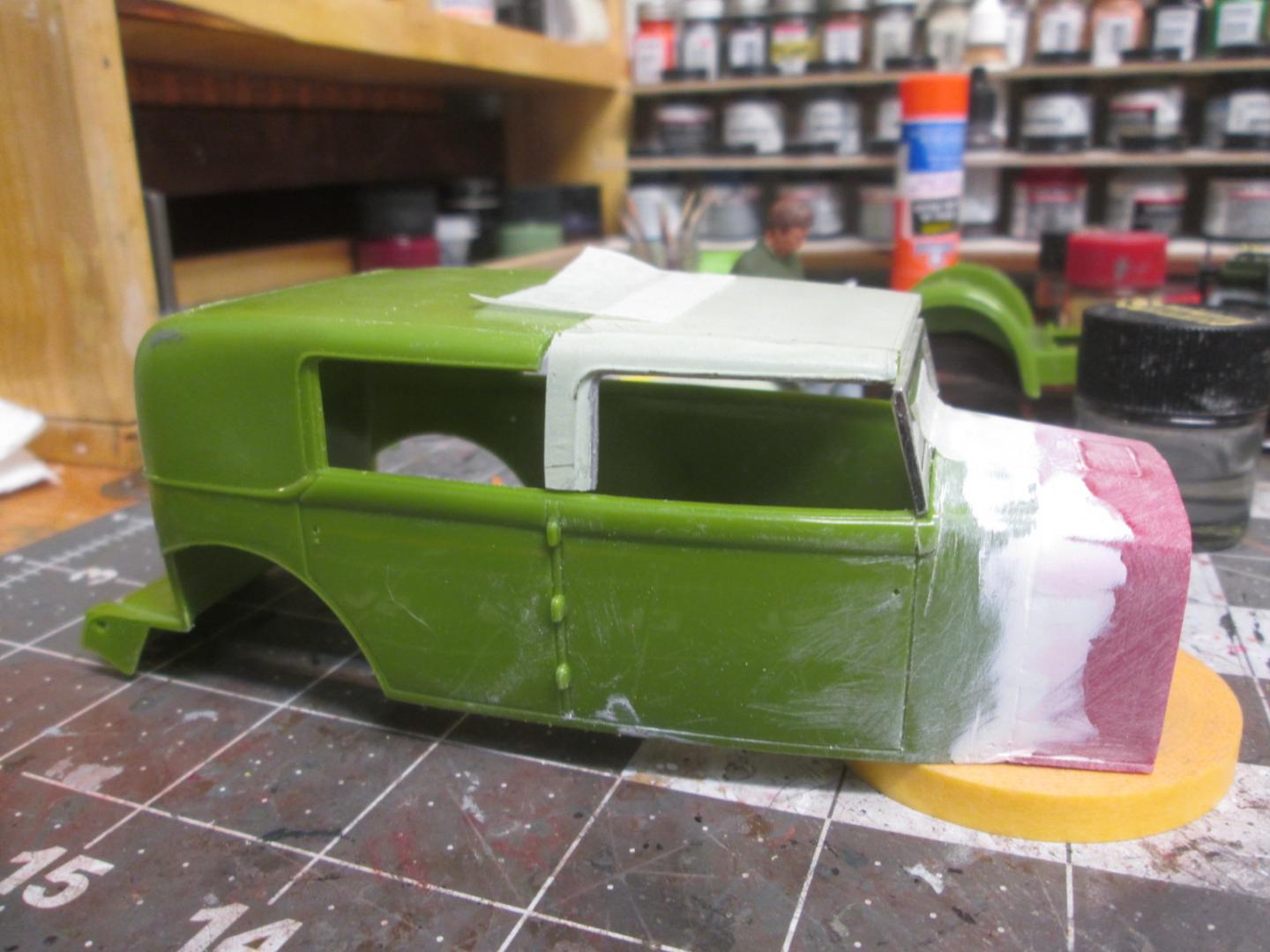

Turns out I have to extend the taper a bit to match the other roof.
Edited by landman

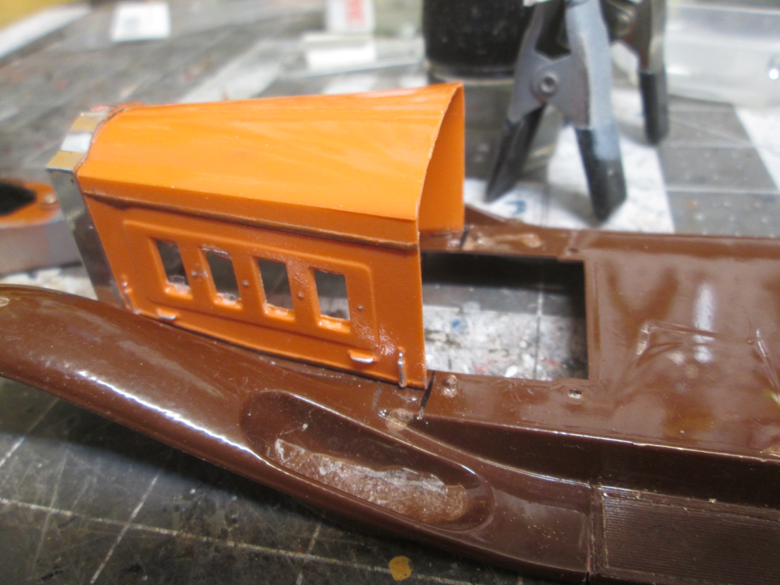

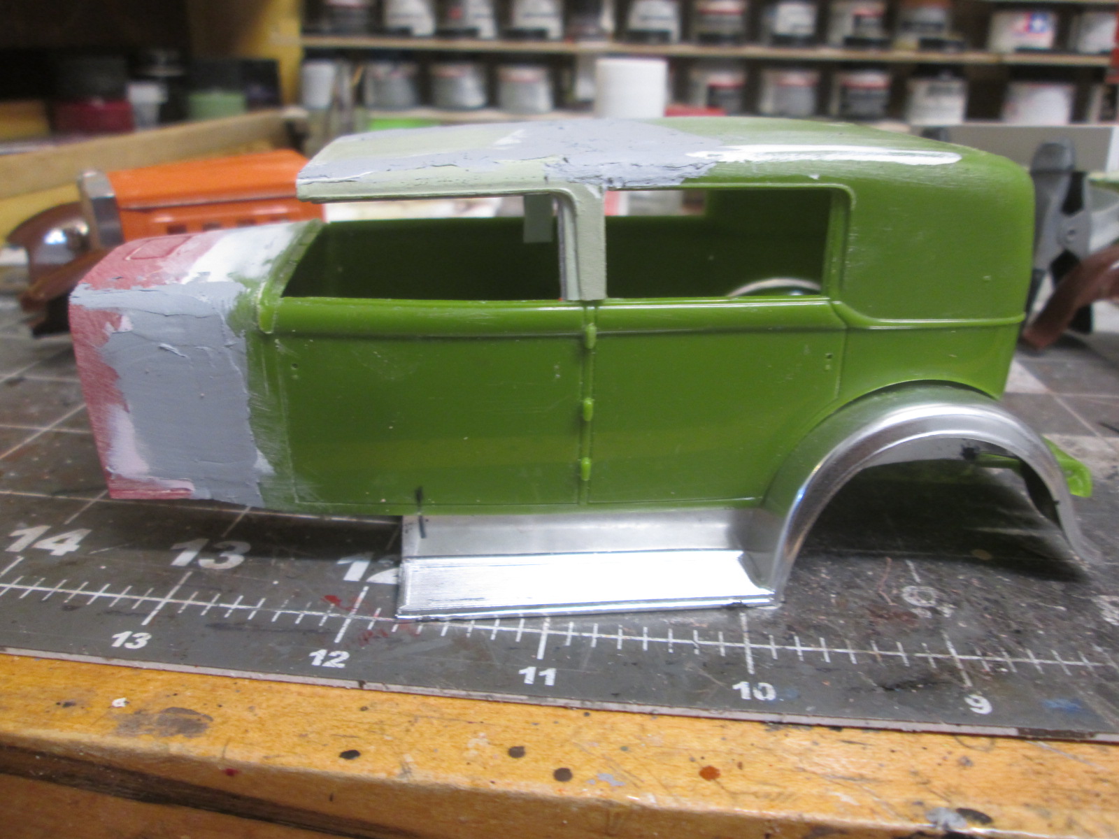

Now that we know what length the body will be, we can determine the length of the fender assembly. First step, determine the location of the front of the cowl. then mark one fender assembly. Transfer mark to body. Mark the rear fender assembly. Cut, splice and hope it will fit.

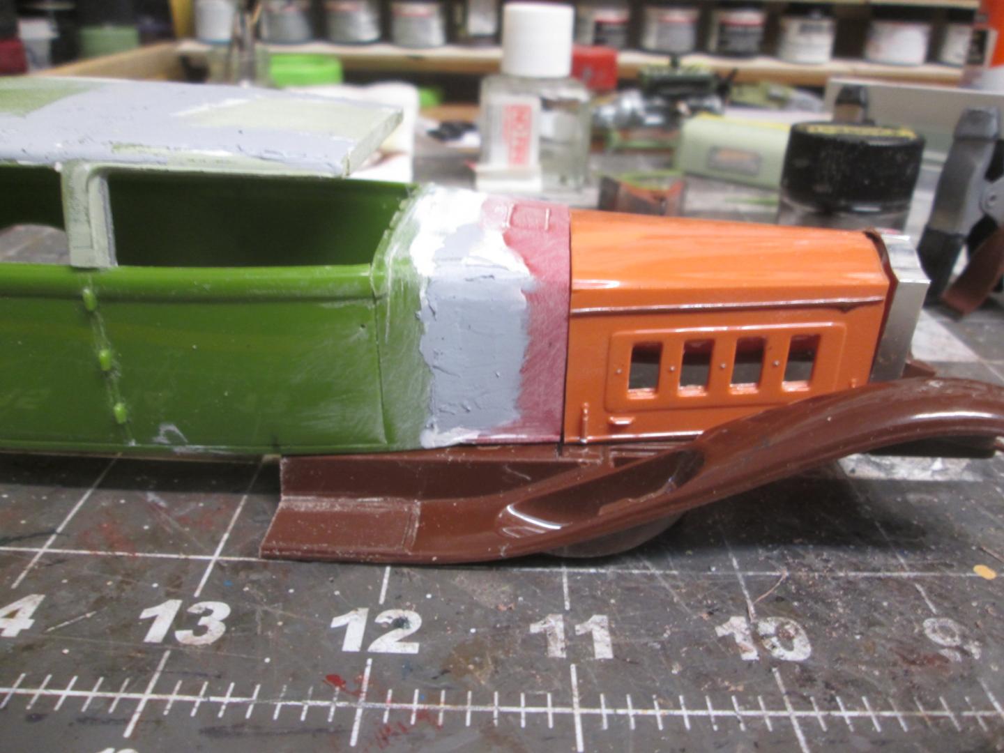

All of your reshaping and molding should qualify you as a "Plastic Surgeon".  I'm sure you have plans for the Cowl Vent before you finish with the body, but I just noticed it is still on the forward section of the Cowl.

Getting there with the shaping. Lots of filing and sanding. I want the shape finalized before I attack the window reveals. Looks like the Duesenberg frame will be a better fit than the Rolls.
