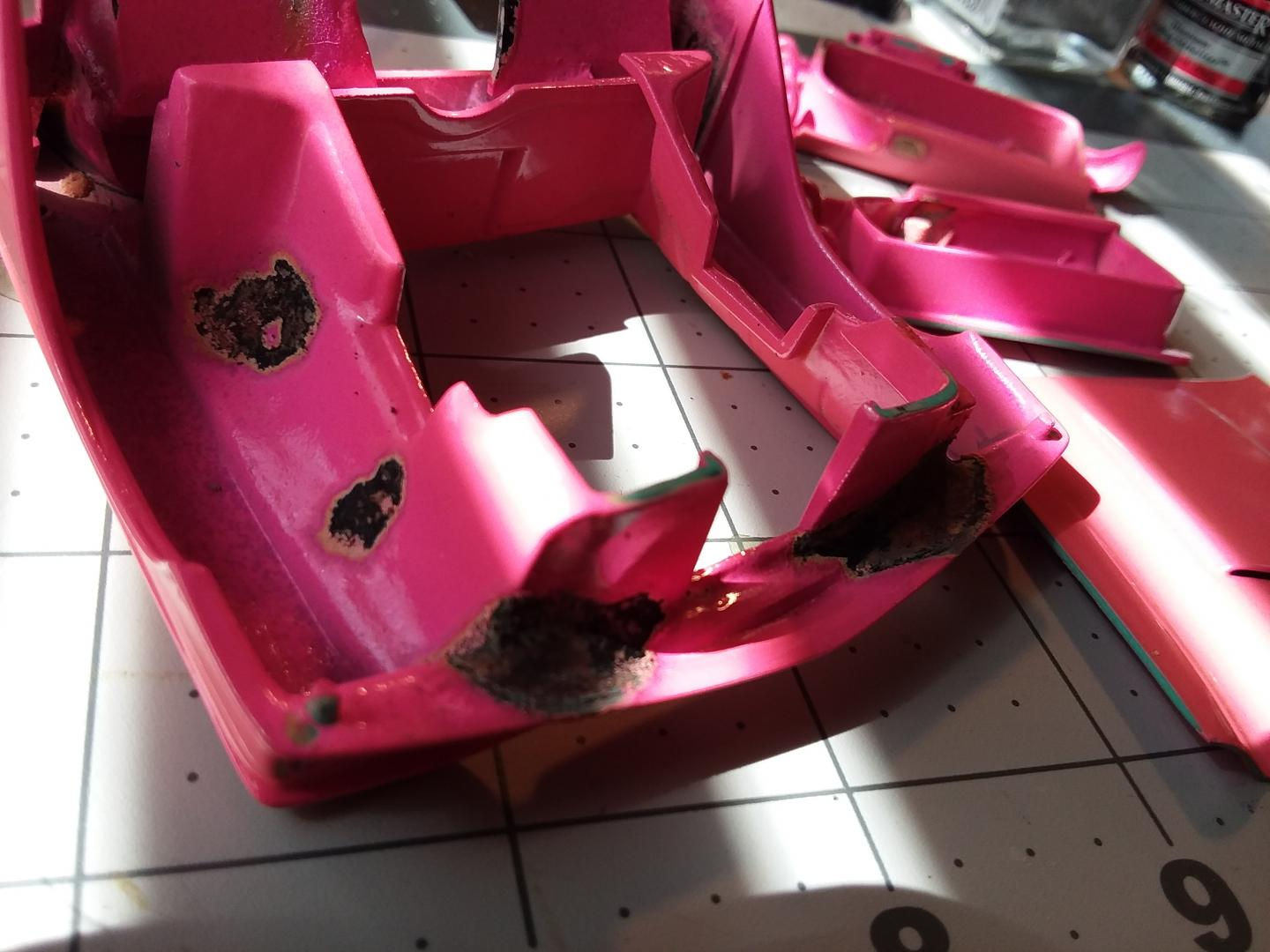

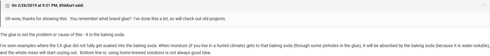

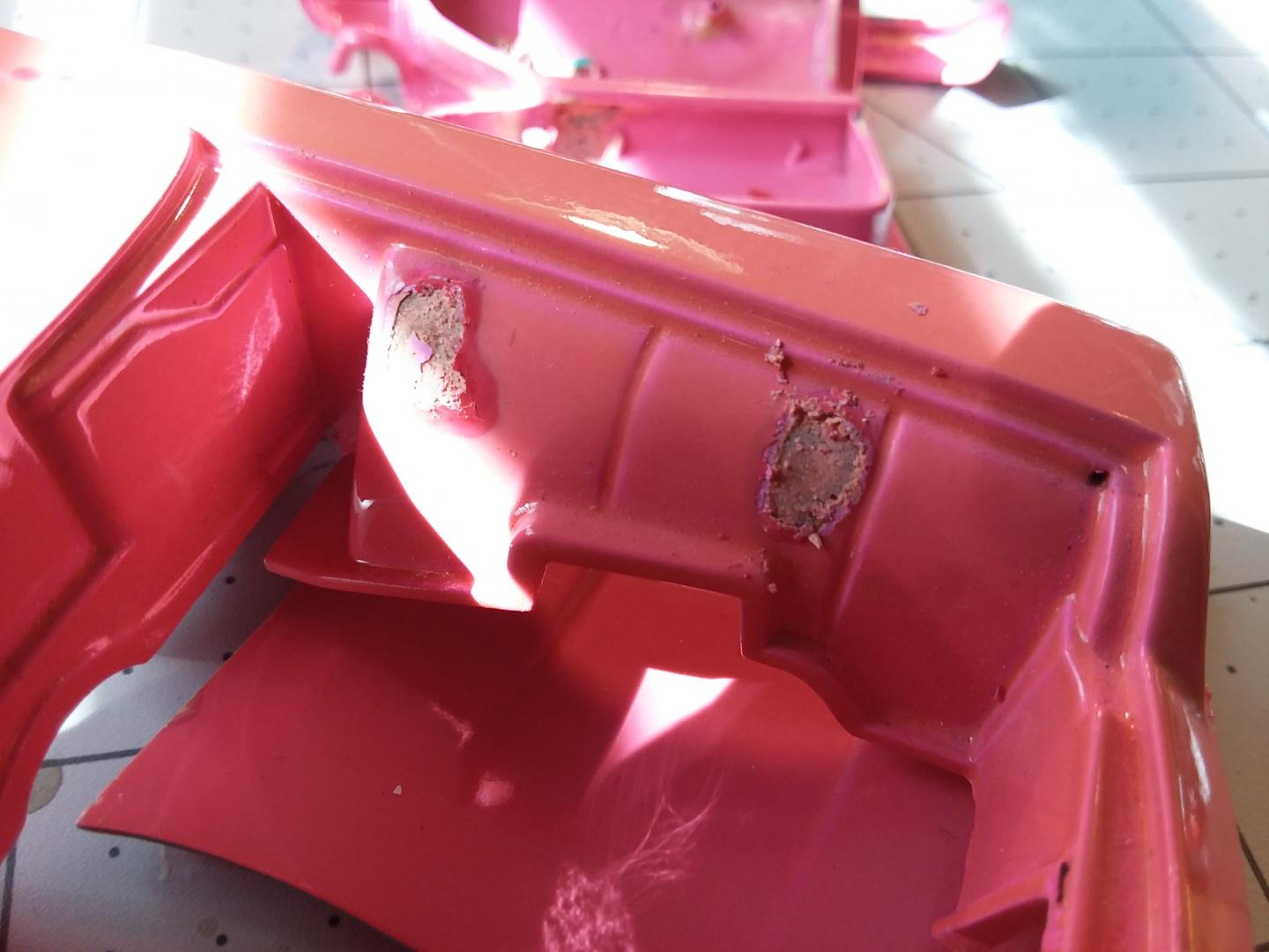

StevenGuthmiller Posted August 30, 2019 Posted August 30, 2019 On 8/30/2019 at 2:12 AM, Plowboy said: Baking soda can't absorb anything once it's been sealed with primer and paint. All of my models are in display cases in my garage where they're exposed to temperature changes from as low as 40 to as high as 96 along with humidity. If anything were going to happen, it would have by now. Expand You might be right, but here is evidence of what can happen when you use the "Baking Soda and Super Glue" trick for body filler. I'm not sure that I would want to chance using baking soda for anything on my builds after seeing this. But I suppose if it's working for you, party on! Steve
Bucky Posted August 30, 2019 Posted August 30, 2019 Hmmmmm.....I have used baking soda and super glue for filler before. I'll check on it, and see if any problems have popped up......if I can remember which build I used it on. I saw the mention of baby powder, but wouldn't most any powder tend to soak up moisture?
Plowboy Posted August 30, 2019 Posted August 30, 2019 On 8/30/2019 at 3:42 AM, StevenGuthmiller said: You might be right, but here is evidence of what can happen when you use the "Baking Soda and Super Glue" trick for body filler. Expand Well, I don't use baking soda and super glue. So, I don't think I'll have that problem. Besides, there's no way of knowing exactly what caused that issue. Could've been the primer, paint, who knows? Builders have been using that concoction for decades. If it happened frequently, it would be common knowledge. That's the first time I've seen that happen.
