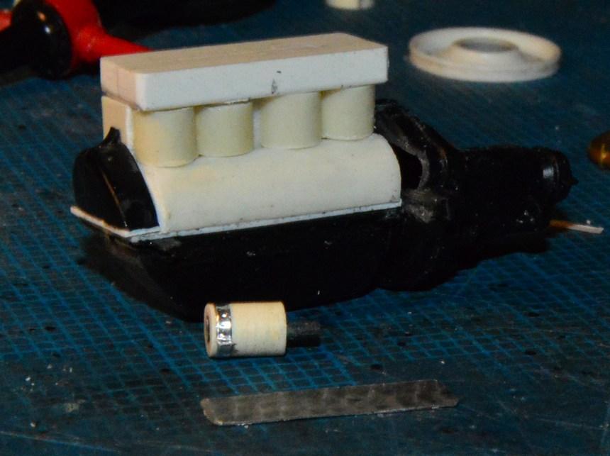

Straightliner59 Posted November 17, 2019 Author Posted November 17, 2019 I had to do a little reshaping on the block, where it meets the pan rail. I installed the tubing that makes the space for the crankshaft too far out, over the pan. The flathead four has a flange cast to the block, that the pan bolts to, rather than the pan's flange overlapping the block. I got that mostly fixed, less a little more rounding-off. The beginnings of the front engine mount are in place. When I am done with it, there won't be much left of that angle stock! I carved the water outlet from .125"X.156" Evergreen strip. I need to find something I can flow into all these gaps. I am wondering if maybe Mr. Surfacer, applied with a fine brush would work. I'm asking, because I don't have any, and am wondering if it's worth the investment. Also attached is a photo of the block, before I cut the flange.

Straightliner59 Posted November 19, 2019 Author Posted November 19, 2019 I added a few more details to the engine. Since the solenoid/switch cover is stamped, I carved one out of some .060" Evergreen and embossed some tooling aluminum over it. I made and mounted the water pump mount, and added the little bosses on the lower block sides, that the oil pan bolts thread into. Turned a crank pulley, but, I am unsure of the size of the pulley, so I eyeballed it. Questions, comments and critiques are always welcome!
Flat32 Posted November 22, 2019 Posted November 22, 2019 Admiring your "eyeballed" pulley. I know what it must have taken to machine it. Looking at the small nail-like pins you're using and wonder where you get them. They have a very nice looking head shape that I need.
