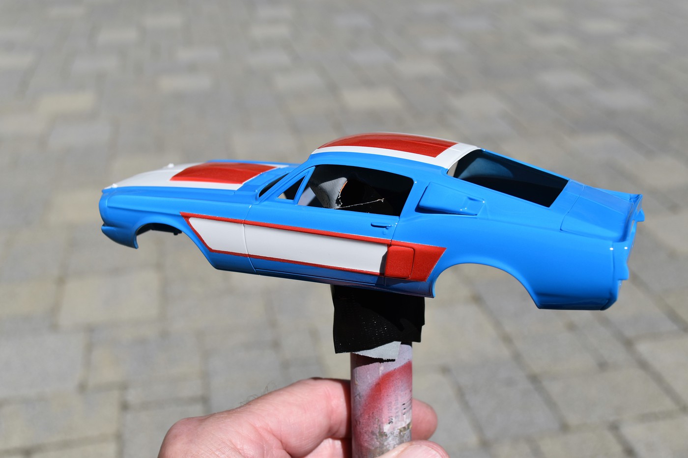

Codi Posted August 3, 2022 Author Posted August 3, 2022 Well, with the engine out of the way and on it's new stand (wink-wink Claude) I'm moving onto the body. But first........... Claude, I admit, the block off plates were the "lazy" albeit creative way of not having to make headers for it........remember, this is my "supposed" quick build. Chris Smith - Yes sir, long journey so far but still moving forward with her..........btw, your Ferrari is looking sweet! Daniel - I do admit there's a ton of effort in this build so far.........appreciate the acknowledgements & compliments. Francis - Well.......trust me I'll be spending some time looking at your truck again and what's possible in machining plastic. btw, what type end mill & speeds do you typically use when machining plastic? I know it'll melt at the blink of an eye......you need to try out the renshape material too........you'll love that stuff! Onto the bodywork - This pic is what I'm starting with from Johan .........I know it's a Dyno Don Mav but I don't like the scoop on this build at all. To be fair, my car is a few years down the road as Pro Stock developments go........... I found a great article with "Things to Come" as they applied to early 70's Pro Stock development. This pic gives an idea of where I'm going with this car -- back to the hood scoop.........this one on the "Super Shaker" Colt caught my eye and would work well with the big boss 494 What I've learned so far...........after messing around with making a wood buck and trying my hand at forming a brass scoop, I gave in and accepted that I'll NEVER be a Randy D. panel beater............some of my failed experiments So what do I do (he said to himself) well of course........machine it........well.......try to. This is one I did that has some mistakes on it but it did prove out that I could do it and that it will give me a good facsimile to the real one. The resin base is from the parts bin of some piece I bought a few years ago.........the base will be metal as well, the whole scoop will be made in 2 parts. the next several pics are just mock-up pics that will benefit me as I make copies of them and pencil and pen them to get the final look I want. I have a couple tools (long reach end mill and drill bits) coming to make the scoop. I have not had a tool break on me in a LONG time and I snapped 2 dremel drill bits while machining this piece........I was quite surprised to say the least. This profile pic gives a good idea but I will extend the base of the scoop by about 3 or 4mm.......remember, it's a boss 494 underhood. Lastly, I gathered up the CompResins Maverick body I bought from them 2 years ago and the 2 recent Mav Promo models I purchased in July as well. The resin hoodscoop at the bottom of this pic is a Futurattraction piece (well done btw) and of course the primer gray scoop that came with the car. All the bodies and bits are to help me "speed" (funny huh?) along with the bodywork. I can over cut doors, fenders & the trunk and then mix and match the bits for tight fits. Since I don't build many cars I figured I could spend the budget on these to help me out to get her done. Cheers to Everyone!!! tim 2

Codi Posted September 14, 2022 Author Posted September 14, 2022 Ian - We most certainly agree. Hopefully this one turns out as sweet as I envision it. Time will tell. cheers Francis - Thanks for the insights. I tried it quickly with a 2 flute 3/16" end mill at 1000 RPM........turned out perfect. More experimentation to come I'm sure but it works well. Now I know why you use it too in your builds. cheers Dave (Goatguy) always good to see you too.........June seems so long ago......we'll get together soon! Claude - Thanks for the heads-up. Funny that you mentioned that about the promo kit cars. The bodies DO feel different. I'll be cautious when cutting em' up as these Maverick kits are getting pricey. Art - I appreciate your support Art and I would hope I can be there. Not sure if I'll bring a car.....certainly won't be the Maverick unless there is a "work in progress" category. We'll see! Bruce - a sincere nod of appreciation too sir. Hope you follow along and that my progress on it picks up.......... So.........I've been "quiet" on the build as I've been having neck / arthritic issues that have prevented me by and large from moving ahead in a meaningful way. Short story of it.........numbness and a thousand needles in my hands at night......can't sleep.......can't get comfortable because of the pinching of the neck vertebrae on the nerves themselves. Seeing my doctor next week and will be getting surgical advice / options as I don't want to live with this anymore.....sadly, in 3 of the 5 types of surgeries I explored on-line, fusing of the spine is part of the deal. UGH! I don't want that of course. So, I do what I can do each day and right now I'm feeling a little better. Working on the mill or lathe creates "awkward" positions that irritate my neck so I thought I'd explore eventual paint options. This is NOT a Maverick as you can see and my masking job was quick and it shows. The good that came out of this little test was that I LOVE Splash Paints. Their product lays down so beautifully, color options are huge and their shipping and customer service is top notch. I'll definitely use their paint when it's time to paint the Maverick. Thanks to John Teresi for sharing a few tips with me that I were most helpful. The colors I chose are period correct "Ford Factory" colors btw. Cheers everyone! I just sprayed the 2K clear on the car an hour ago and the body was not polished at all........no orange peel either! 2
Chris Smith Posted September 14, 2022 Posted September 14, 2022 Tim.. Awesome job on the paint work! I’m sorry to hear that your having issues with your back and neck. Praying that you get back to some semblance of normalcy soon!
John Teresi Posted September 15, 2022 Posted September 15, 2022 Tim…..so very sorry to hear about your medical issues …..I feel your pain…..I may have the same thing ….. I haven’t been to the Dr. yet but, I have the same issues ?…..I hope and pray for you that you get the best outcome.? but, I got to say, for a test tape and paint job Wow !!!! …..and the colors are Awesome they really pop……I have no dought that your paint job on the Maverick will be great ? Tim I wish you the best on a speedy recovery……hope to hear from you soon.
charlie libby Posted September 19, 2022 Posted September 19, 2022 hi tim ,the paint came out great.cant wait to see it on the maverick.sorry to hear about your back and neck. i will be 68 this week and getting old is not for the weak. good luck , ihope you get it taken care of. one comment on your brass forming attempt. did you anneal the brass first ? makes a huge difference.
