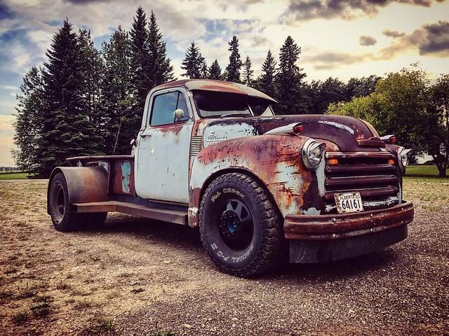

Jantrix Posted September 25, 2019 Posted September 25, 2019 I have a club build off coming up and this is my plan. I need recommendations on a kit to supply wheels (don't need to look like the ones in the pic) and tires. I have the wheels and tires from the Revell Ford dually but the tires need better alternative. Visor perhaps? I'm going to start with the AMT '50 Chevy 3100. Also some ideas for an unusual engine choice would be appreciated. Just throw out some ideas please. Trucks usually aren't my thing but I love the look of this one. Much appreciated.

Tom Geiger Posted September 25, 2019 Posted September 25, 2019 Definitely a visor! That '50 Chevy pickup kit comes with one. Engines? Early Mopar Hemi in the AMT '53 Ford Pickup Caddy engine from either the AMT '59 El Camino or Monogram '59 Caddy Olds engine from 1950 Oldsmobile kit Rear fenders can be made from pill bottles. Note the running boards are just flat metal... these elements make that truck! Front fender lights can be made from big rig top of cab lights. Looks like a fun project! Let's see it happen!
Plowboy Posted September 25, 2019 Posted September 25, 2019 I'd use a diesel engine of some kind with a set of stacks. That truck looks like it has a C on the hood. So, it probably has a Cummins. I'd look at some road tractor kits for a donor. It could also supply the wheels and tires. Maybe the frame too.

Jantrix Posted September 26, 2019 Author Posted September 26, 2019 I had four engine ideas based on my memory of my spares, and I'm missing two of them. ? Now I have to go through all my kits and figure out where I've squirreled them away. Still need some ideas on the truck tires. This looks like a a 3/4 or 1 ton version of the truck, but I'm not sure I want to bother stretching the bed. I may just move the axle back about a half inch to give it a rake.

Jantrix Posted September 27, 2019 Author Posted September 27, 2019 1 hour ago, iBorg said: Use the Ford where you're steeling the wheels and maybe the tires. After closer examination, the tires in the photo look more like a standard tall off road tire. I'm going to check my 4x4 projects and see what fits the look. Coming up with two sets though, ugh.

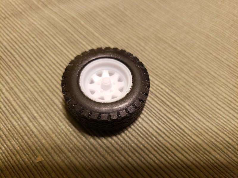

Jantrix Posted October 1, 2019 Author Posted October 1, 2019 So far this is the plan. I think these will be perfect. I have a set of four of these and two more tires coming in the mail from a club friend. I'll figure out the rims from the parts box. As for the engine. The blown hemi from the Revell 41 Willys hot rod is the leading contender, with the Revell BBC from the pro-street '67 Chevelle a close second, the ability to keep it under the hood will be the deciding factor. I had two other ideas but I cannot seem to find the engines that I know I had. I'm also kicking around a resin 4 cylinder turbo diesel, but that might be a little too "Welderup", for me. After studying the photo I think I'm going to move the rear axle back about 3/8 of an inch, to give it a longer look with a rake. The real truck is probbaly a 3/4 or 1 ton with a longer wheelbase and bed, but stretching the bed is more work than I want. I'll be starting this, this weekend, so stand by for a WIP thread. Thanks very much for the advice guys. It helps.
