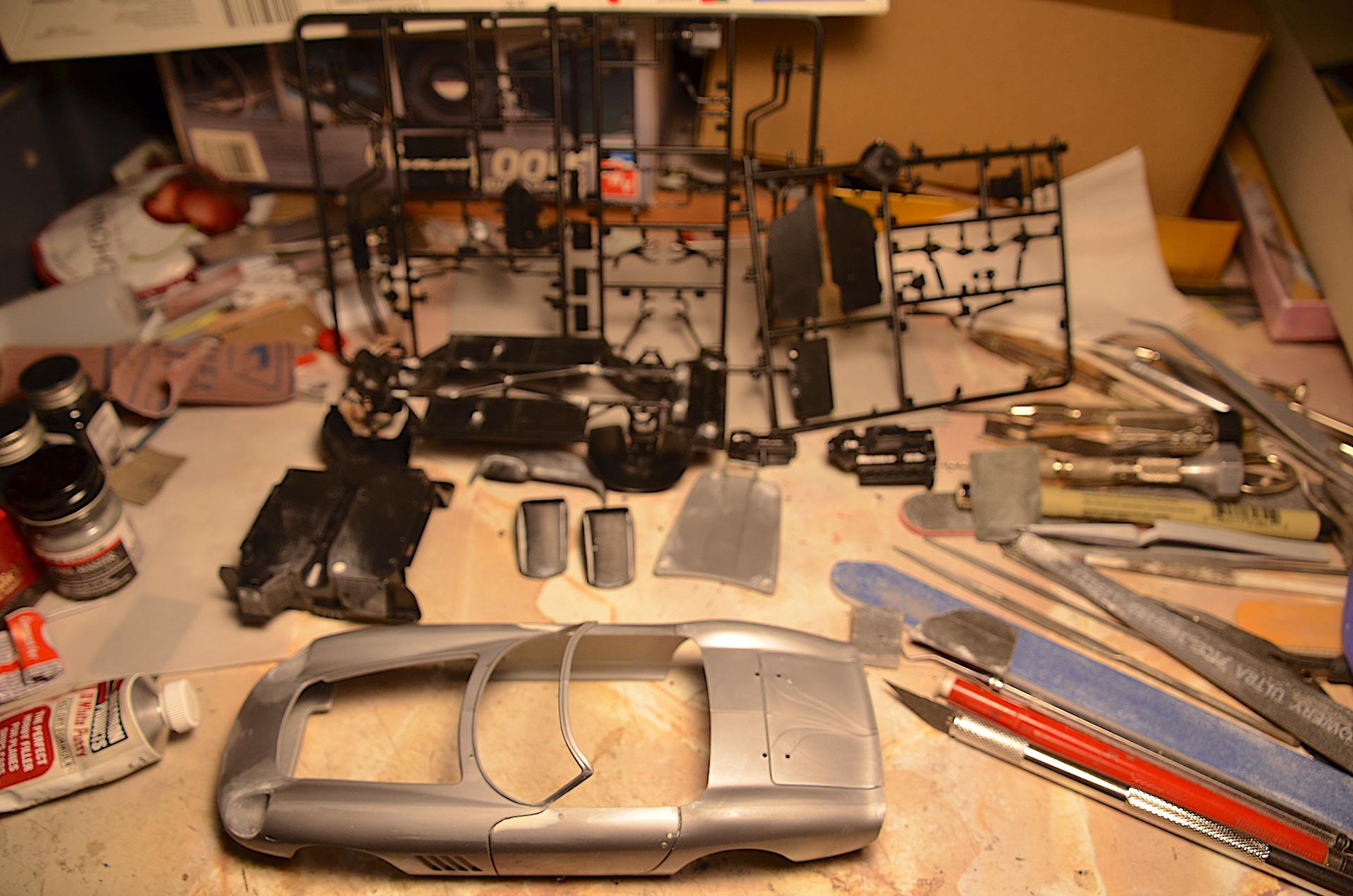

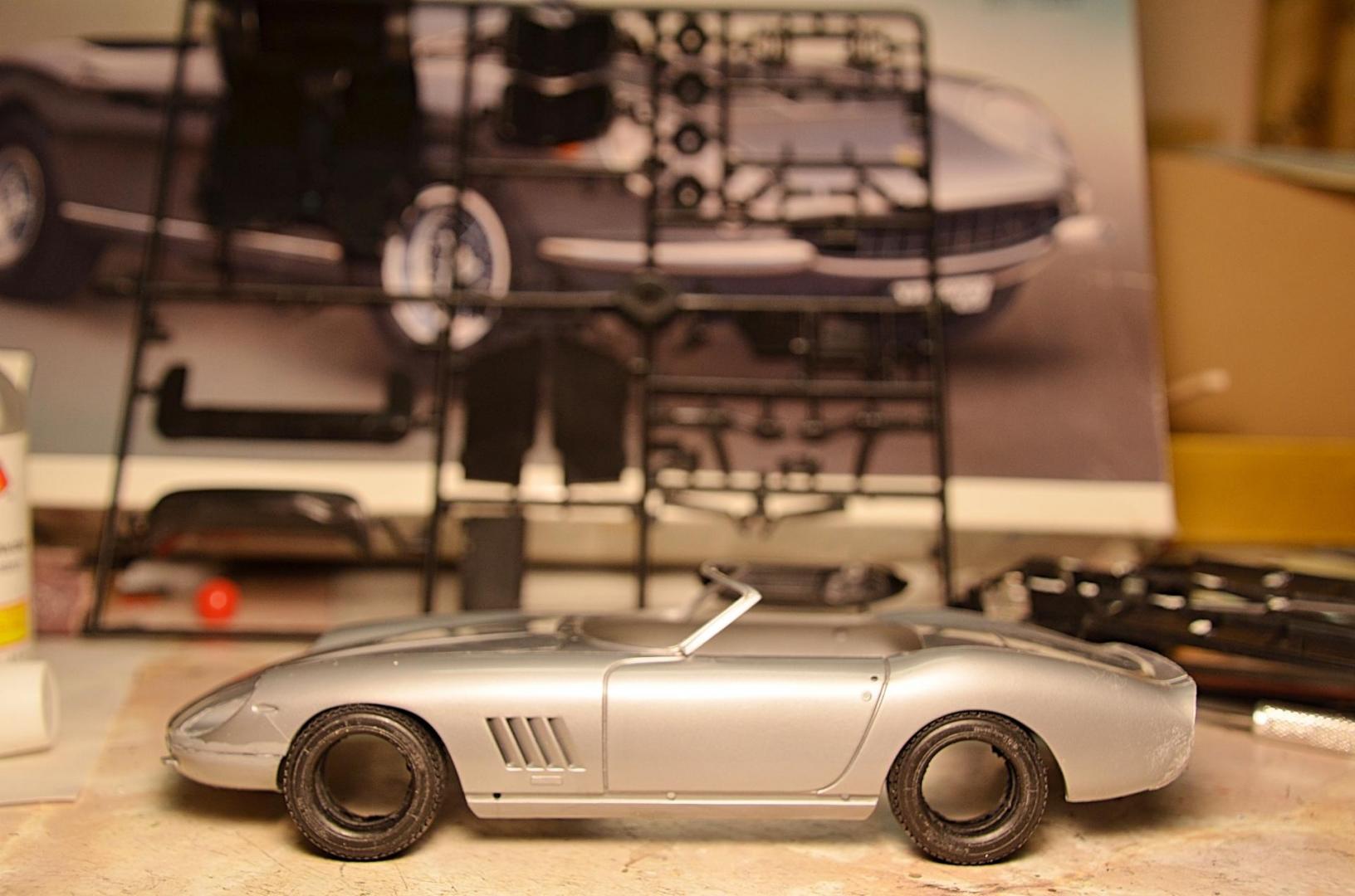

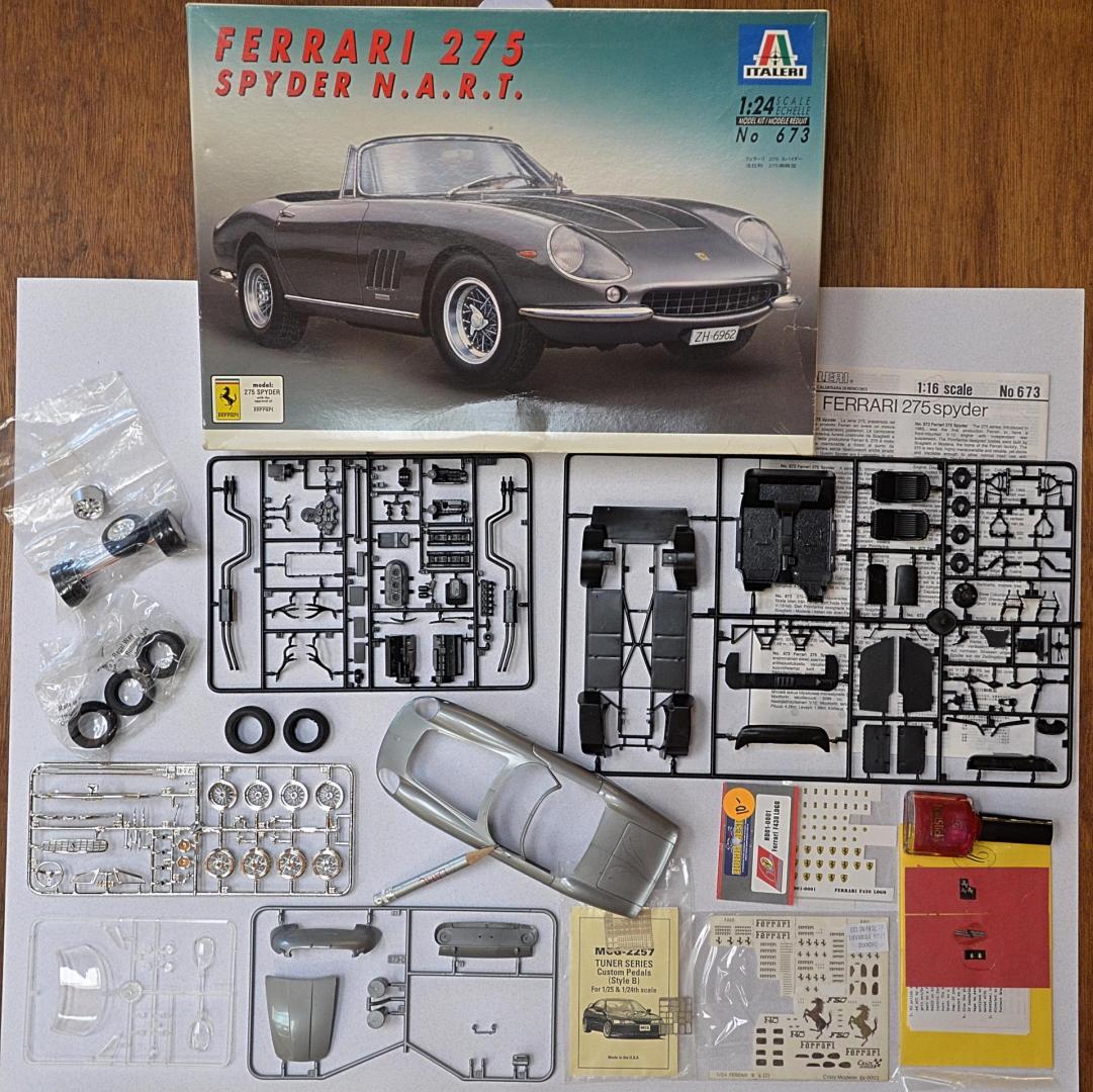

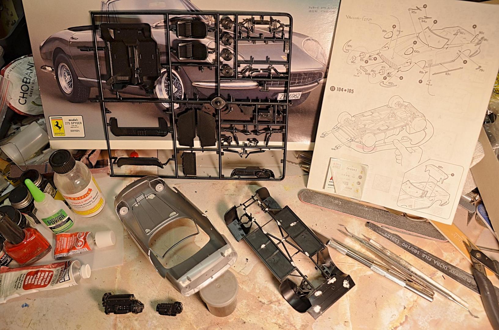

89AKurt Posted October 2, 2019 Posted October 2, 2019 Ferrari 275 GTS by Italeri, labeled as the Spyder N.A.R.T. I got this years ago at a local r/c hobby shop that didn't last long, for about $15, I didn't have to think twice about it. Even though I have three WIP started last century, this has been staring at me from the stash. It has got to be the sexiest Ferrari, close second is the 250 GTO which was vying for my attention. My plan is to improve a few things, not go overboard (famous last words). First to go are the horrid truck tires, have a decent set from the horrid Aoshima VW Beetle kit that fit the nice wire wheels, are lower profile and most likely wider than correct, but looks much better. The windshield frame has a broken post, so will embed a steel wire, in both, to make stronger and give a chance of adjustment if required. Looks easy to make the wheels steerable. The headlights are a pet peeve, the center pin in the lens and flat reflector are getting fixed (taillights are similar but just the pin removal should work). I'm seriously thinking of opening the doors, will add steel plates to the chassis and sill before cutting, the door panels are separate so it begs to be done. Plug wires and radiator hoses will *have to* be added. I've collected some cool aftermarket emblems and parts over the years, so even though the decals are nice, that's a *have to*. Have the pearl dark red nail 'polish' picked out. If I'm feeling really ambitious, will vacuum form headlight covers. Started today with the basic assembly of the engine and transaxle, suspension, and other things that are two parts. It's decent quality, needs some mold line scraping, a few parts have flashing, but parts fit really well. I used Testors tube and Flex-i-file liquid glue for steps so far, exception is the rear body where the beautiful spoiler lip could be melted, so used superglue. Also used Squadron putty to fill minor ejection pin marks. Need to think about stance, lowering just 1 mm would help.

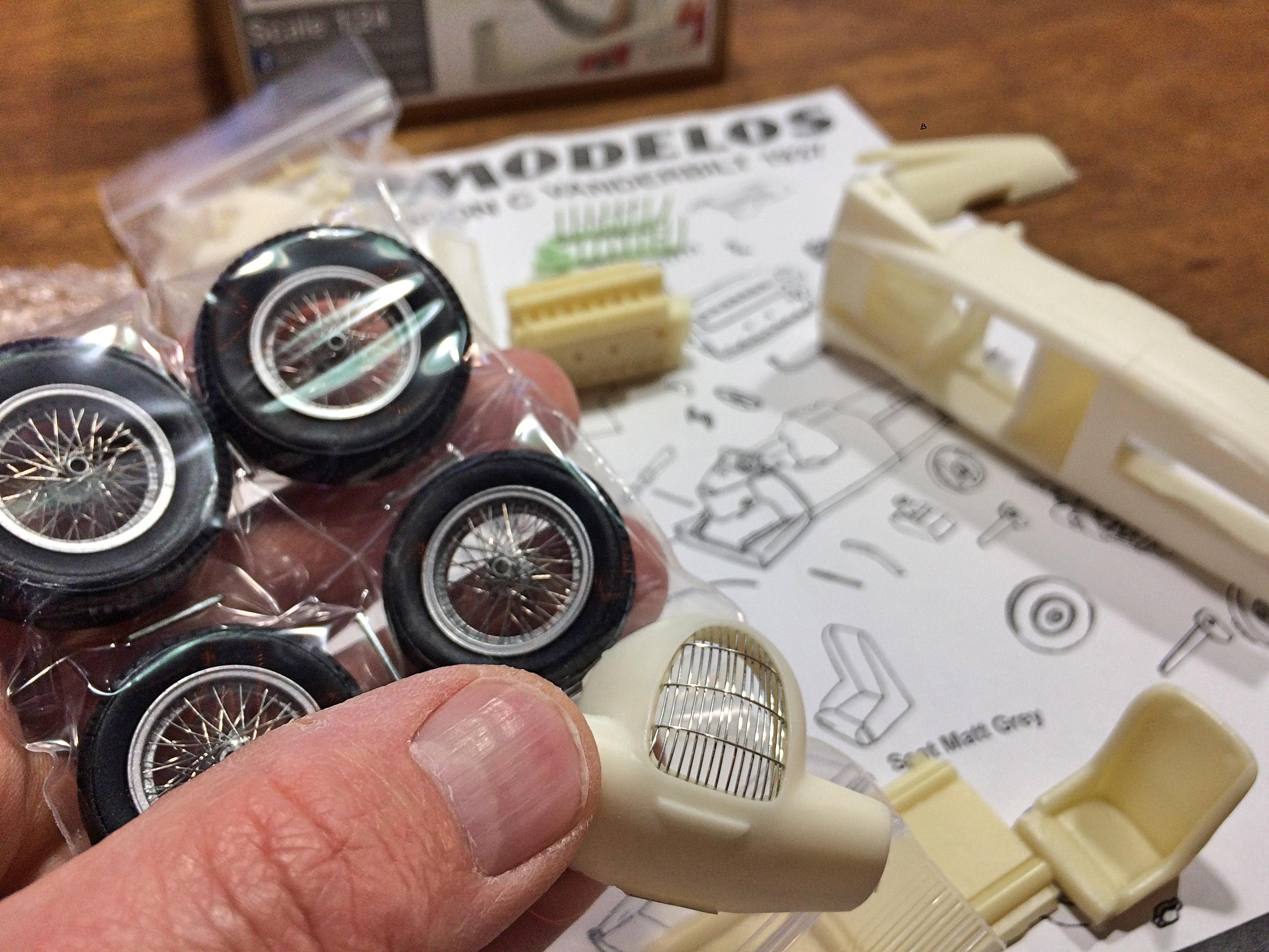

89AKurt Posted October 5, 2019 Author Posted October 5, 2019 On 10/4/2019 at 5:36 AM, DukeE said: [...] FPPM is Fernando Pinto. Does amazing stuff. [...] Yes he does! I got his Auto Union kit with these amazing wire wheels. 2 hours ago, Funkychiken said: This is a beautiful Ferrari! Sure is.

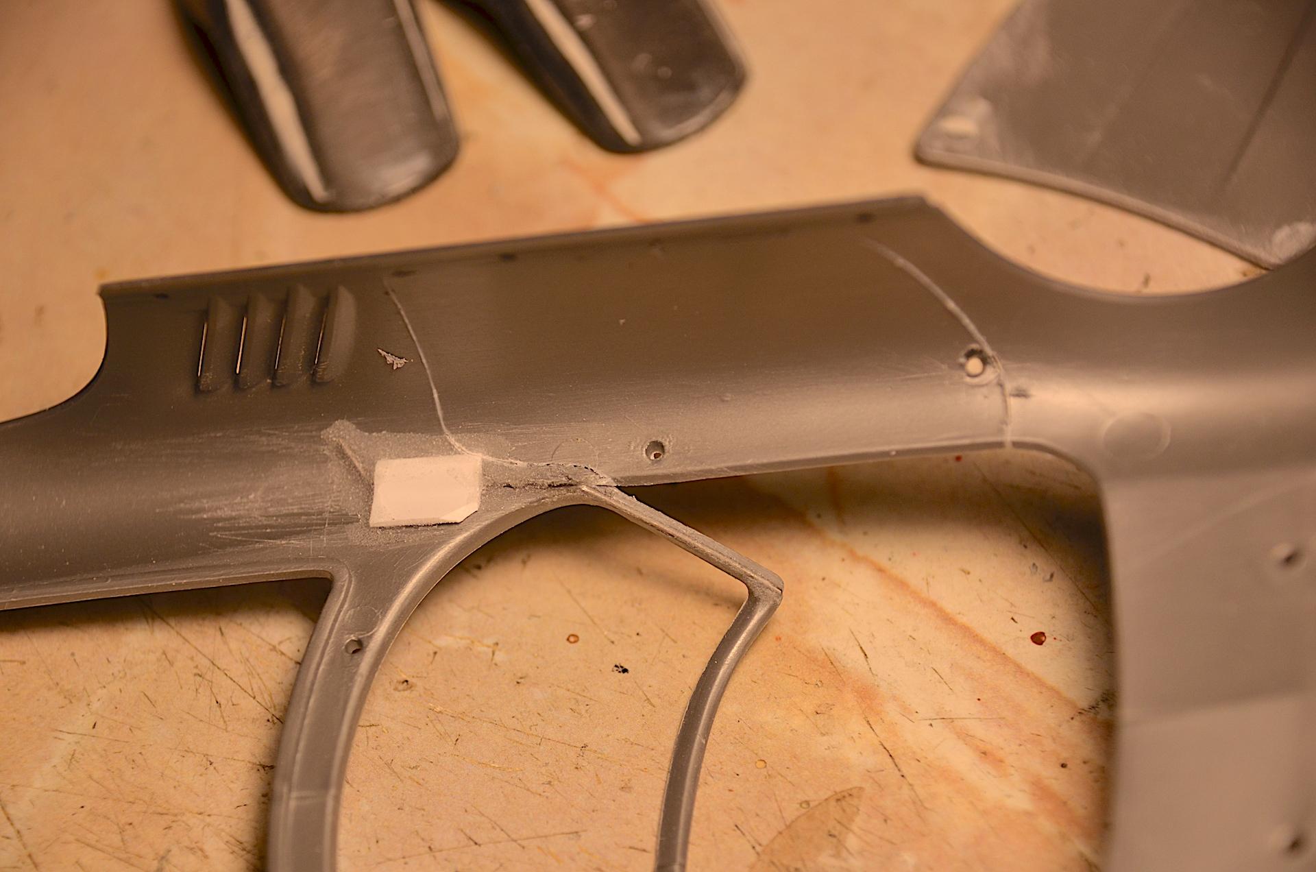

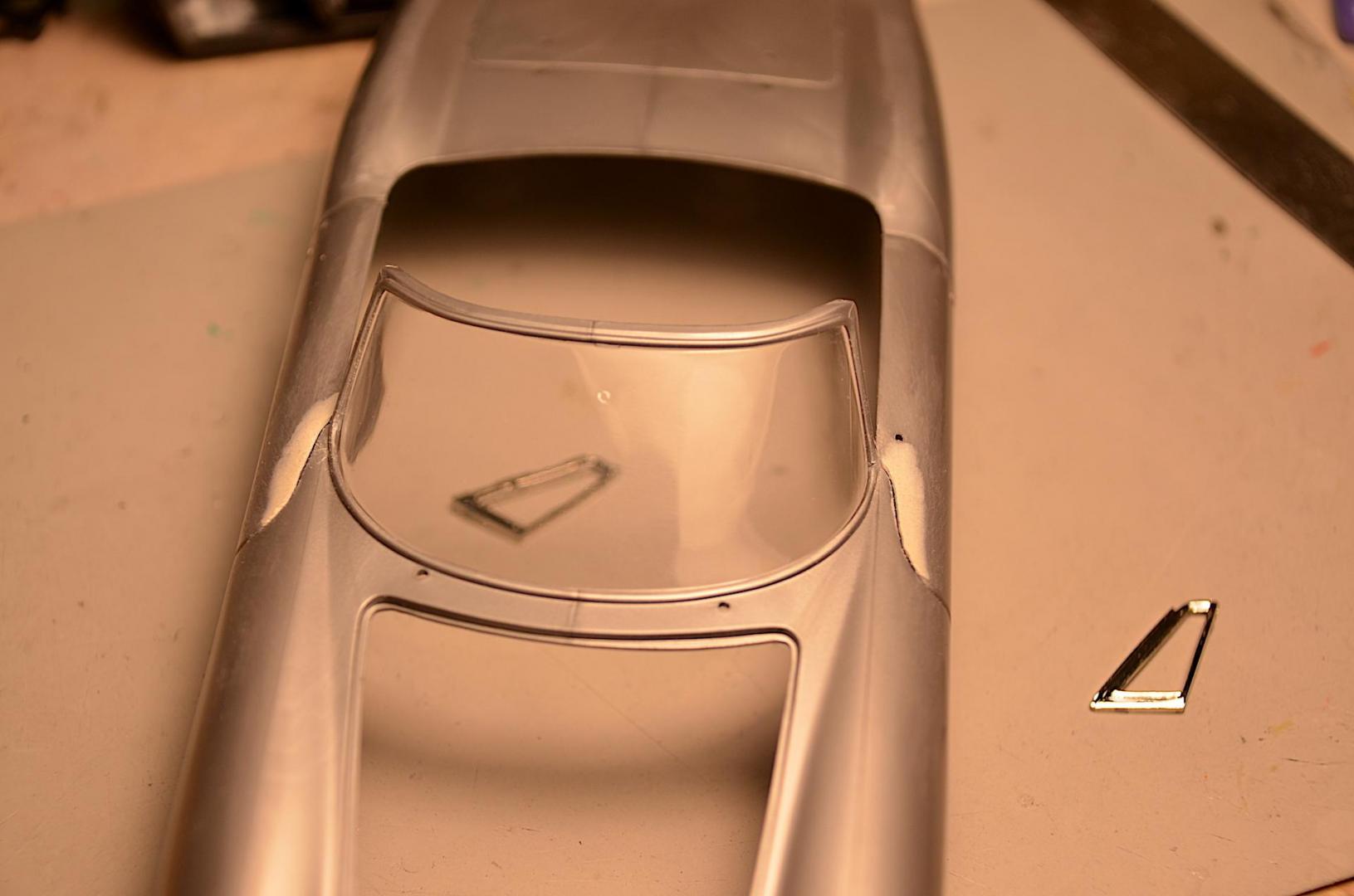

89AKurt Posted October 6, 2019 Author Posted October 6, 2019 6 hours ago, djflyer said: These are the Fujimi 15" Borrani wire wheels with their Michelin tire mounted. Not as good as the FPPM's for sure, but definitely better than the kit. Did you rob a Fujimi kit for the tires? I have a few, but want to keep the kits together. I've been filling every sink hole, and ejection pin hole that can be seen, with Squadron putty. Scraped all parts of mold lines. But the big thing was to fix the broken windshield post. I'm figuring out where to add plastic, such as the tail end of the chassis pan, so there will be a positive match ledge, and not open air which could result in poor fitting body/chassis. I would like to add screws too, don't like counting on massive gluing. Even thinking of adding trunk floor, which is now a gapping hole above the transaxle. I ought to open the trunk at this rate. ? I used a #11 blade to scribe a kerf, then super-glued in a wire, with a bent leg going under the fender, with another bend, and then plastic over that. I'm planning to do the other post too, this ain't breaking! I have also scribed the doors about 95%, so I will glue the jambs to the body, not the interior tub as I've done on previous projects.

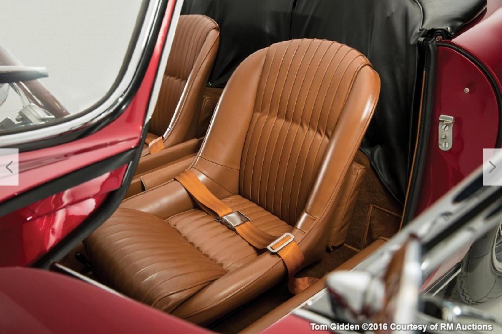

89AKurt Posted October 6, 2019 Author Posted October 6, 2019 More examples of get-it-when-you-see-it. I looked for tan Zero-Design carpet, not available anywhere! I've used the black, will *never* use flocking, I've not seen a good result yet using that stuff. I have little left-over pieces of Detail Master now discontinued white paper-backed carpet, thinking of gluing together bigger pieces, or I have another option.....

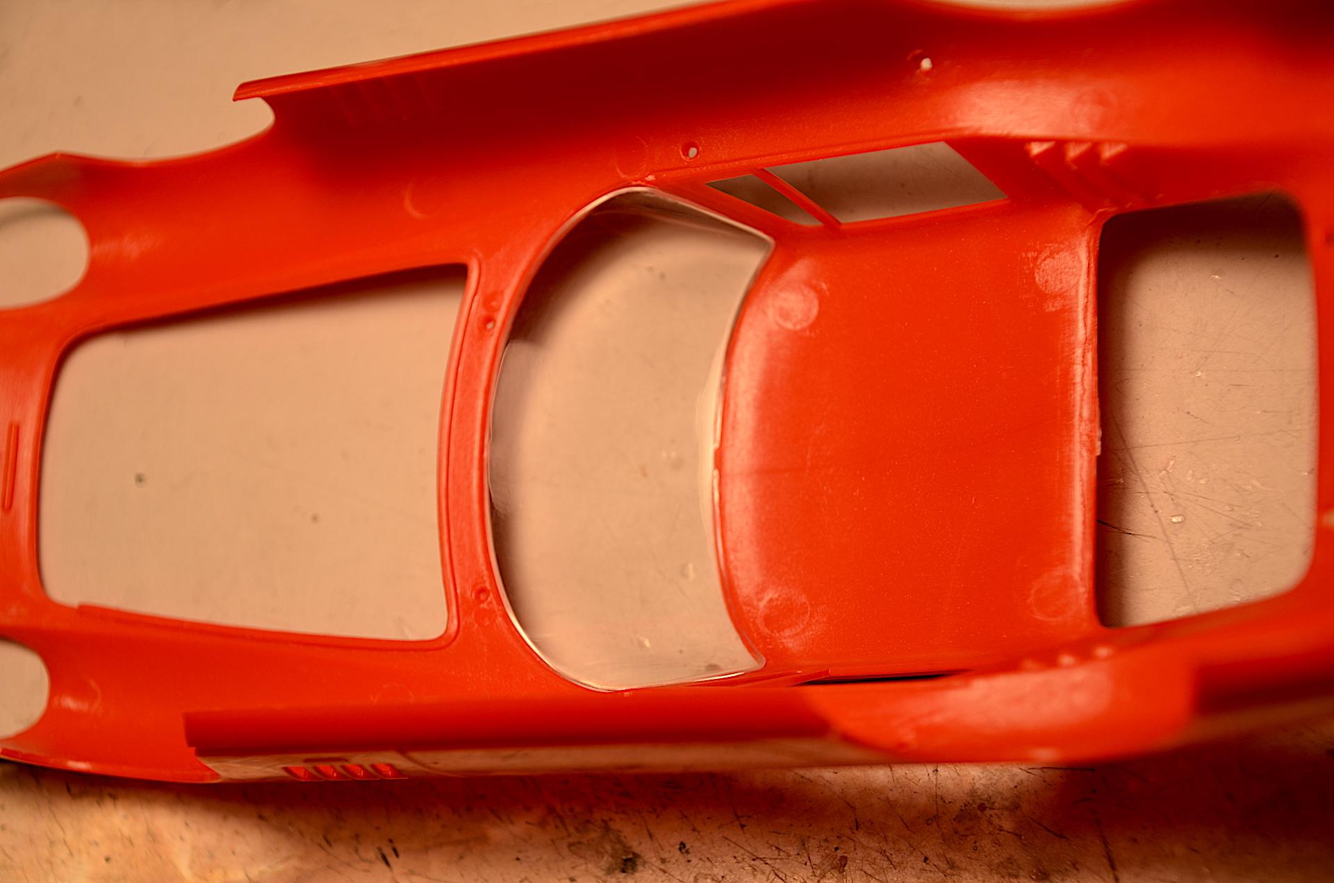

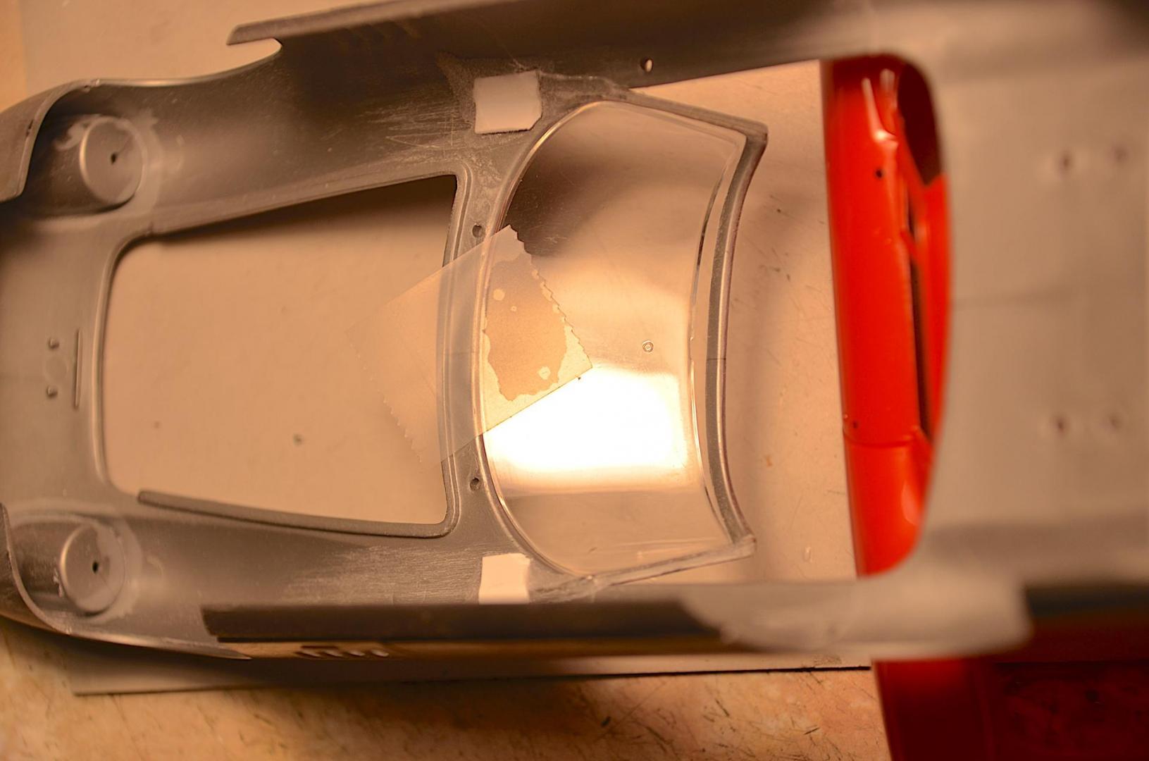

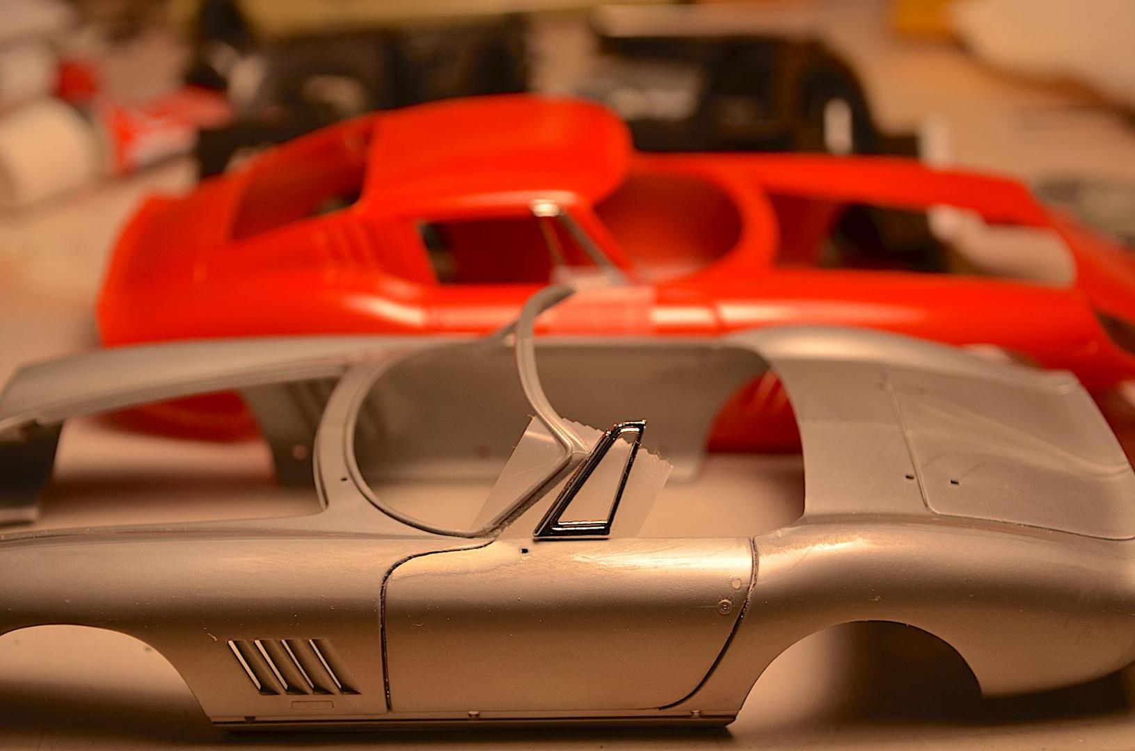

89AKurt Posted October 7, 2019 Author Posted October 7, 2019 8 hours ago, Rich Chernosky said: Will be following this one fer sure. A nice kit of one of the best looking Ferrari's Thanks for riding along! If I was the average model builder, or a kid just starting out, I would have had a cow when I fit the windshield in! ? The problem with this kit, if any weight pushed the box down, it bent and/or broke the windshield frame. Lucky to have a GTB kit, so I pulled it out, and saw the window fit fine. That kit has a completely different window part, side windows are integral, in fact the driver window has a hole to look like it's half way down. Then I got smart, and removed the vent wing parts, and saw how badly the rake was! I had a feeling this would be the case, but not this bad. I put a block of wood at the corner, then gradually bent the posts up until the vent windows showed the same rake. The window fit really well, it's by friction in this picture. HUGE relief this is all it took. I can bet many of these ended up in the junkyard. Started adding sheet styrene to fill holes and gaps. Might never see the bottom of the battery, but it's done. ? Got the rear done. I barely glue some parts together, such as the interior, so next step is to put the body on, and figure out steel bracing and door jamb. I'm going to add styrene along the bottom of the windshield on the body, to help keep the glass in place, and fill the space so light won't shine through. Found sink holes on some more parts to putty. The firewall part needed to be cut and bent where the 4 louvers are (tweezers clamping). I'm really wanting to open the trunk too, since the fuel filler is under the lid (can't clutter the beautiful body lines with an aluminum racing filler like the GTO ?), doing that hinge is going to be a trick, since it's not what we usually do for doors, thinking of using fusee watch chain with all but the operating hinge "pin" glued. Maybe.....
