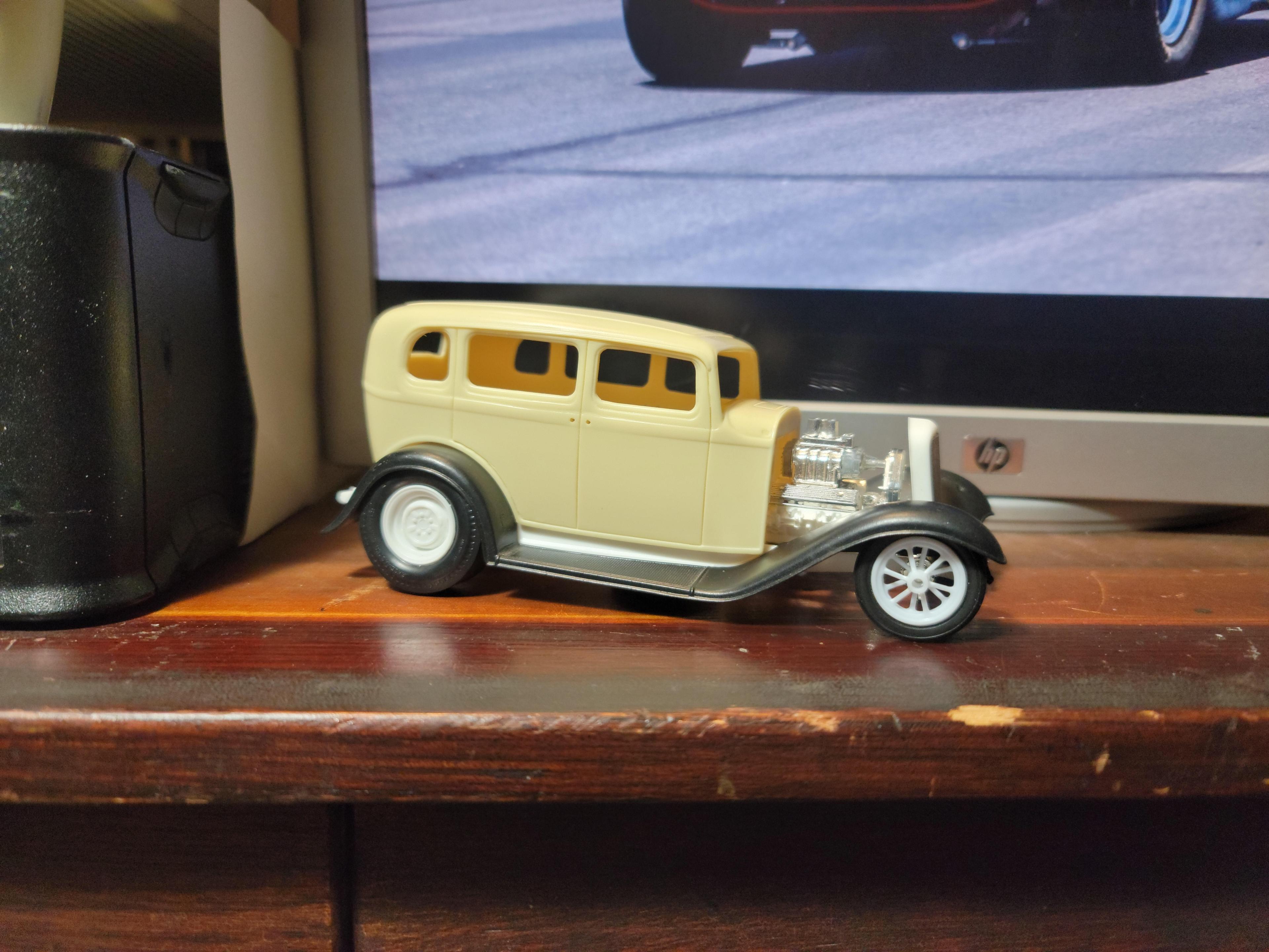

chris chabre Posted November 25, 2021 Posted November 25, 2021 NICE WORK Hope you don't mind me posting this... I started playing mock up with my Drag City chopped moredoor.
mrm Posted December 11, 2021 Author Posted December 11, 2021 Thank you everyone. On 11/24/2021 at 8:09 PM, chris chabre said: NICE WORK Hope you don't mind me posting this... I started playing mock up with my Drag City chopped moredoor. I have one of these bodies too, which I am planning on building fenderless.
