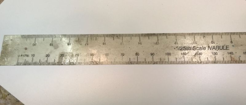

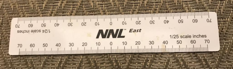

Tom Geiger Posted December 13, 2019 Posted December 13, 2019 (edited) Why do any math? Here's a couple 1/25 scale rulers. Put it up against your model and measure it off accurately in scale! Edited December 13, 2019 by Tom Geiger
Khils Posted December 13, 2019 Posted December 13, 2019 21 minutes ago, Tom Geiger said: 1/25 scale ruler Hi Tom Did you ever check if you had any of those NNL rulers left....I asked you about them Saturday night in Toledo.
Tom Geiger Posted December 13, 2019 Posted December 13, 2019 3 minutes ago, Khils said: Hi Tom Did you ever check if you had any of those NNL rulers left....I asked you about them Saturday night in Toledo. I remember Kevin! I just sent you a private message.
