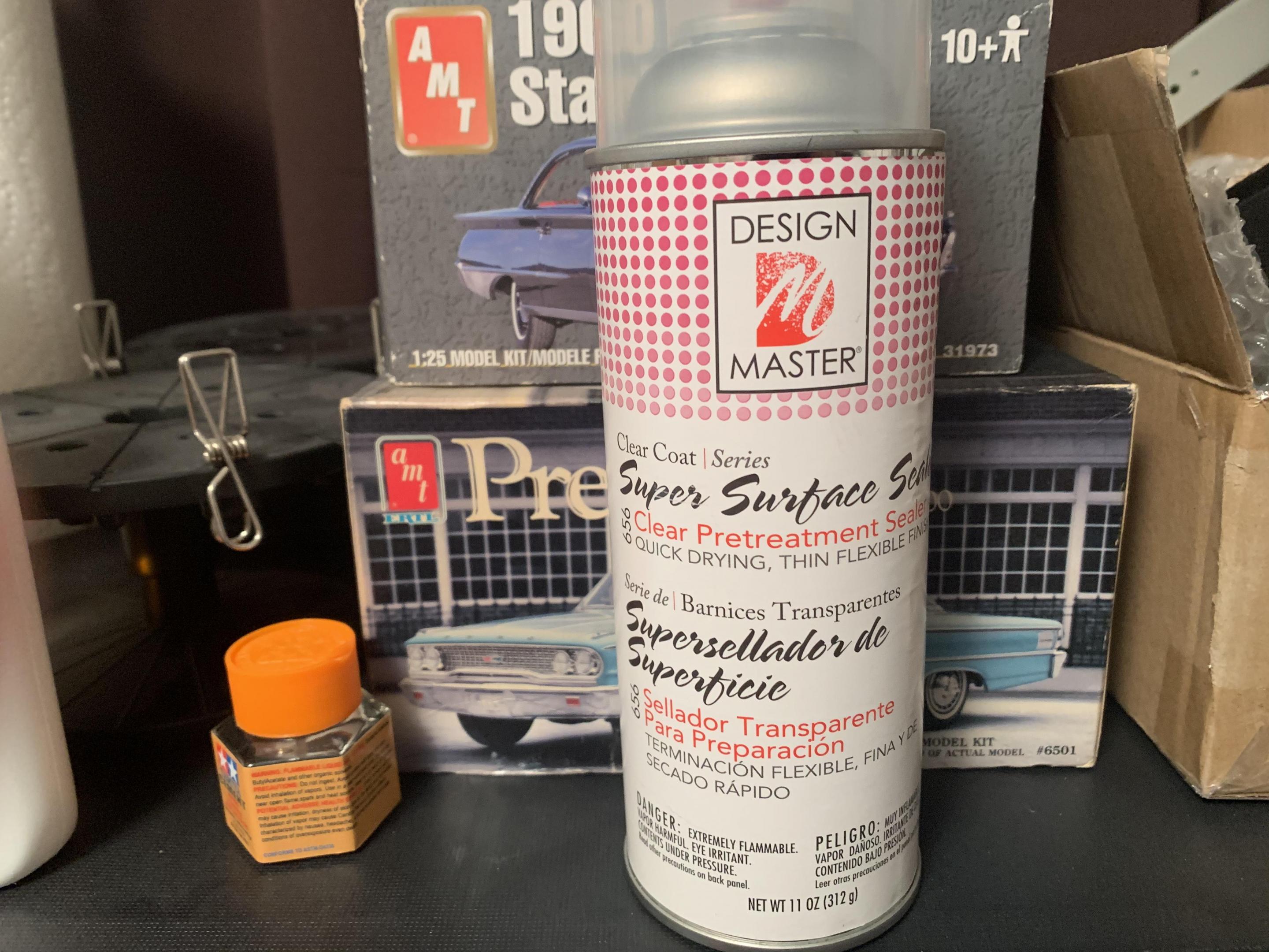

This stuff works every time.
Where could one get that? and would you recommend it if you were going to paint the model with a different red? I have one molded in red that I would like to paint a deeper darker shade....
I bought it on Amazon for about $8. I’m sure it’s available in many craft stores also.
After priming a red body, and the red starts showing through the primer, I hit it with two coats of this, and no problems.
I don’t see any problems if you were going from a red to a darker red. You might have a problem going to a lighter shade of red though. You’ll have to give it a try to see. I usually test my paints on an old body or some other part I probably won’t ever use.
