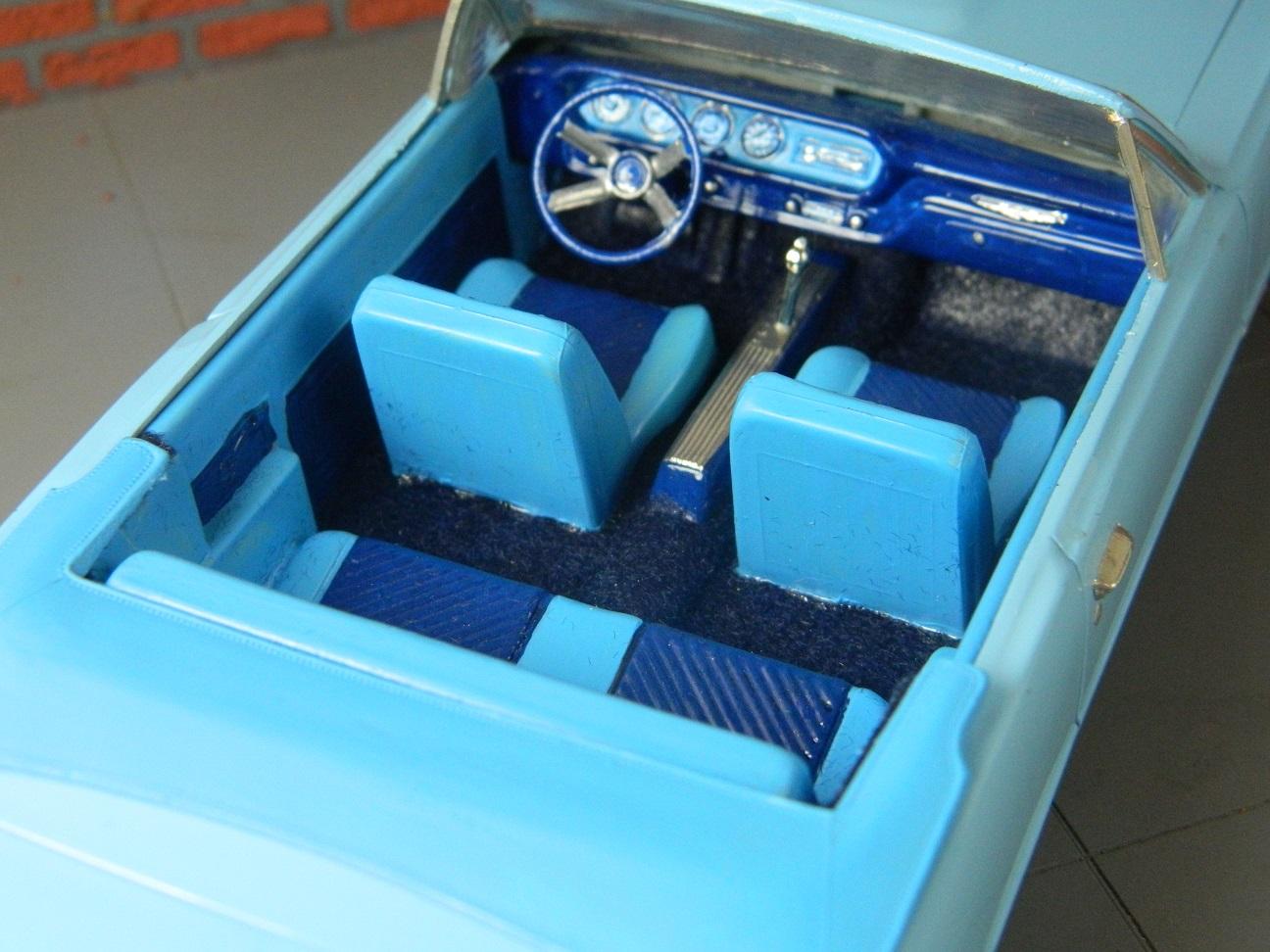

Detailing my dash and want to cover the instrument cluster to represent the clear glass cover. What are some recommendations on what I can use?
