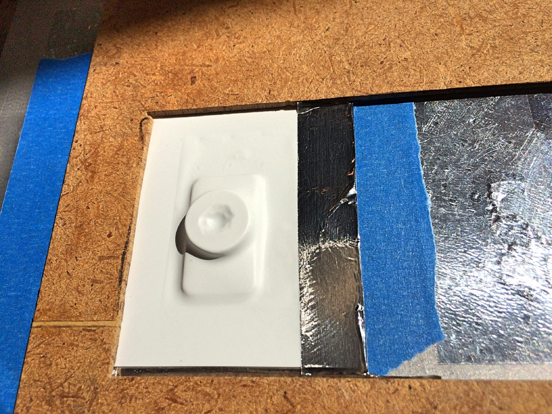

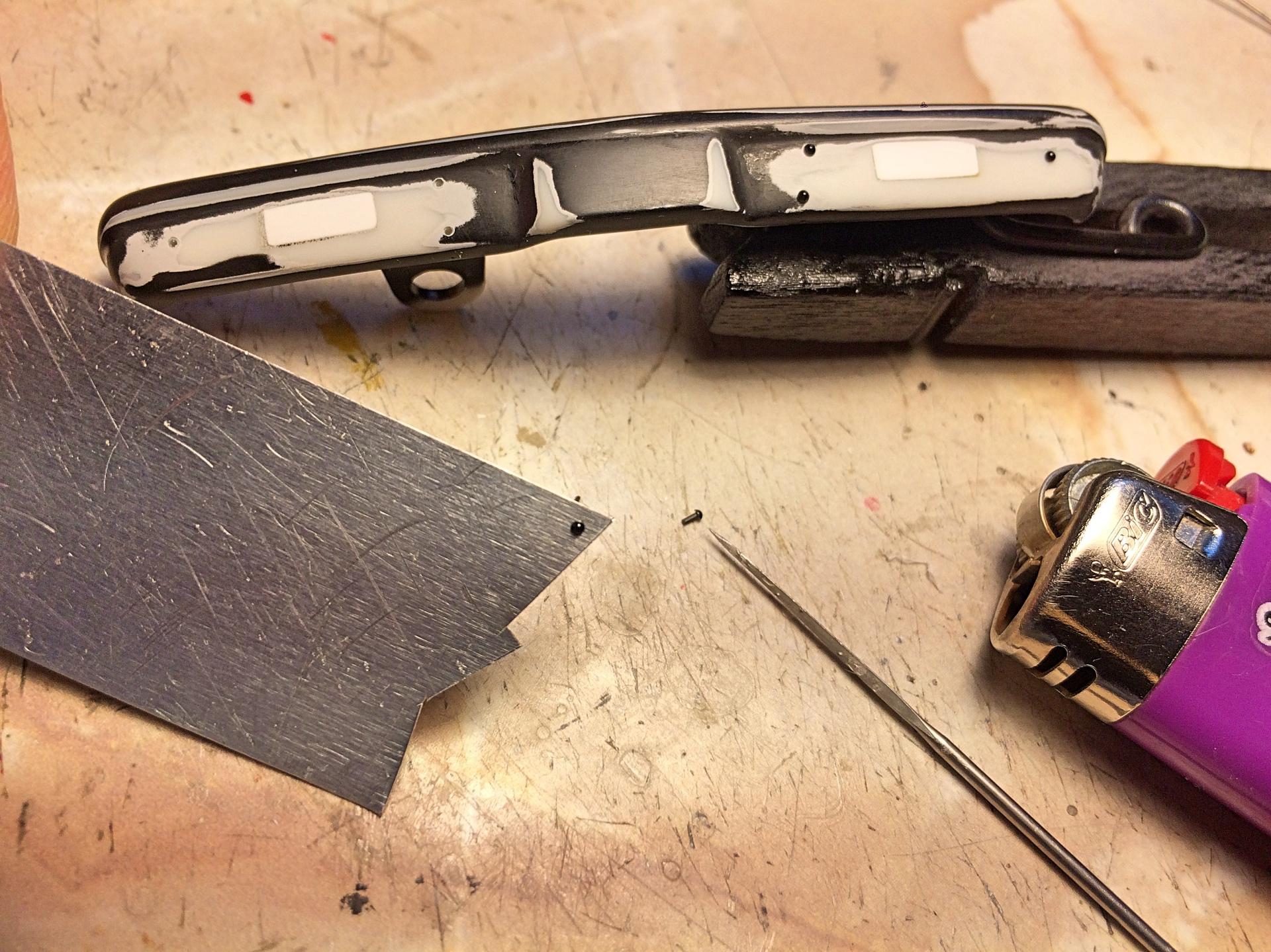

All I did, was make rivets.  Since the bumper has been giving me fits, been sanding so much that I decided just to take the rivets off.  Then drilled holes, one in the aluminum plate.  Stretched sprue put in the hole, extended exactly 1.0 mm, then melted with the lighter.

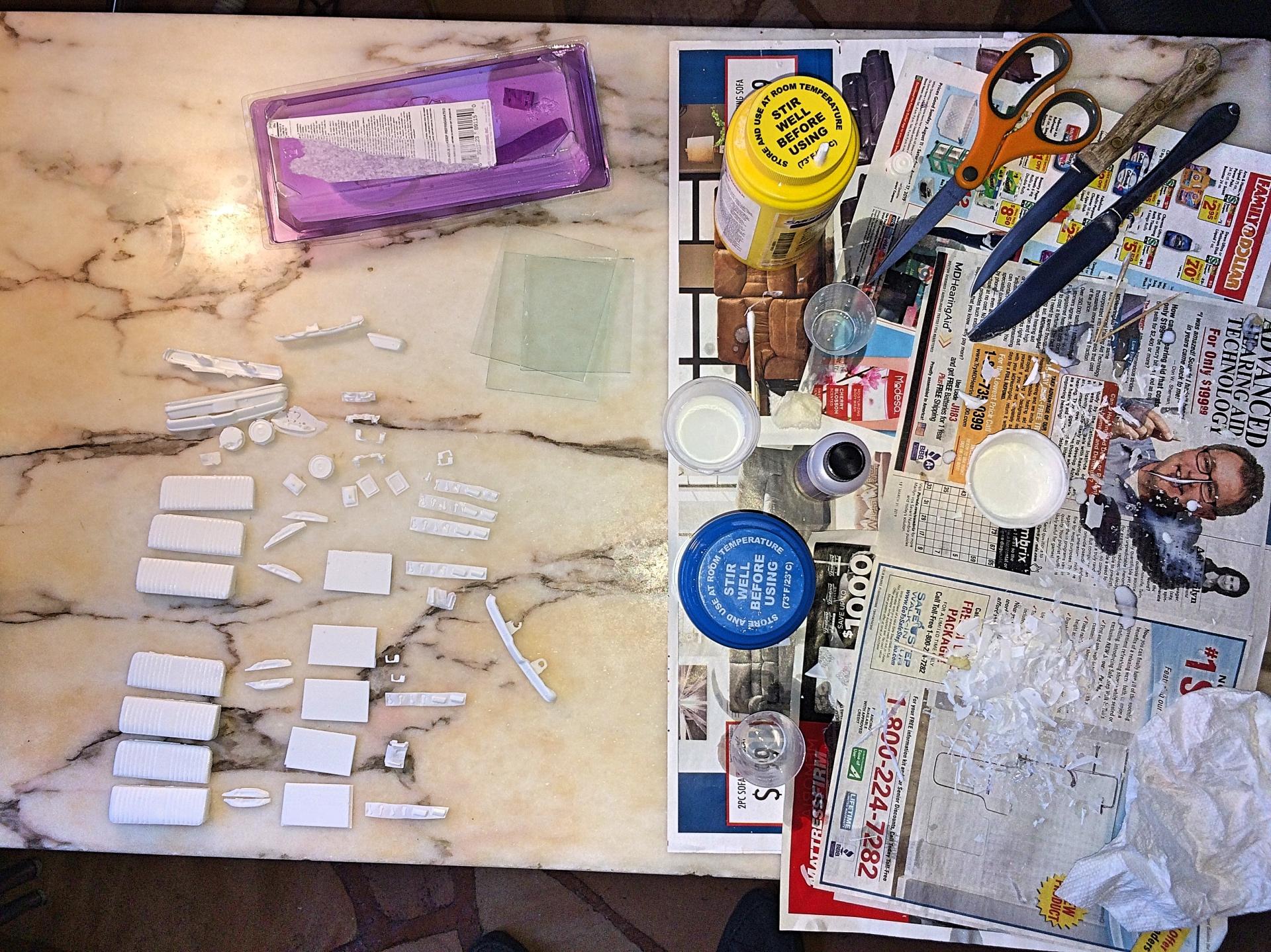

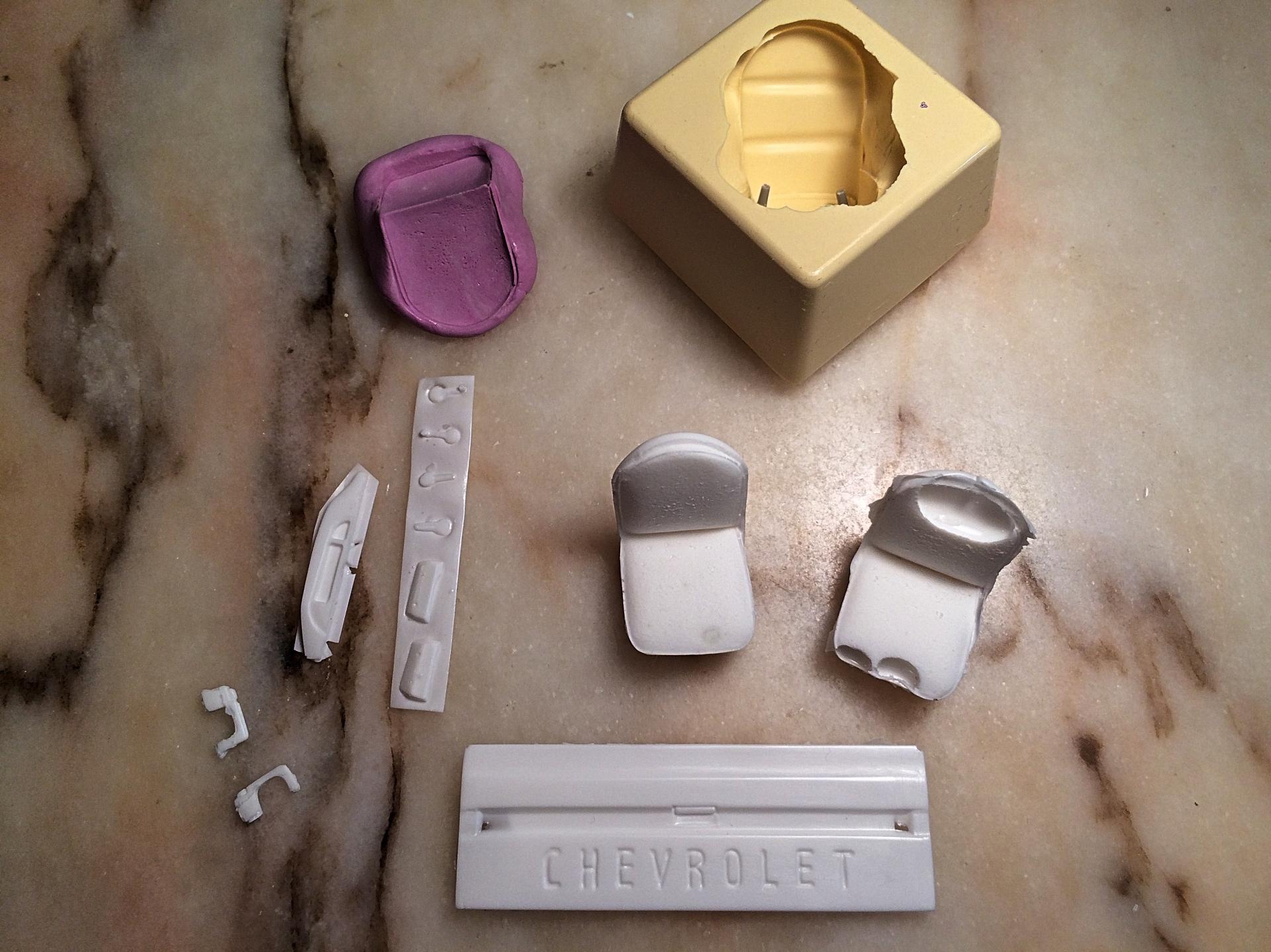

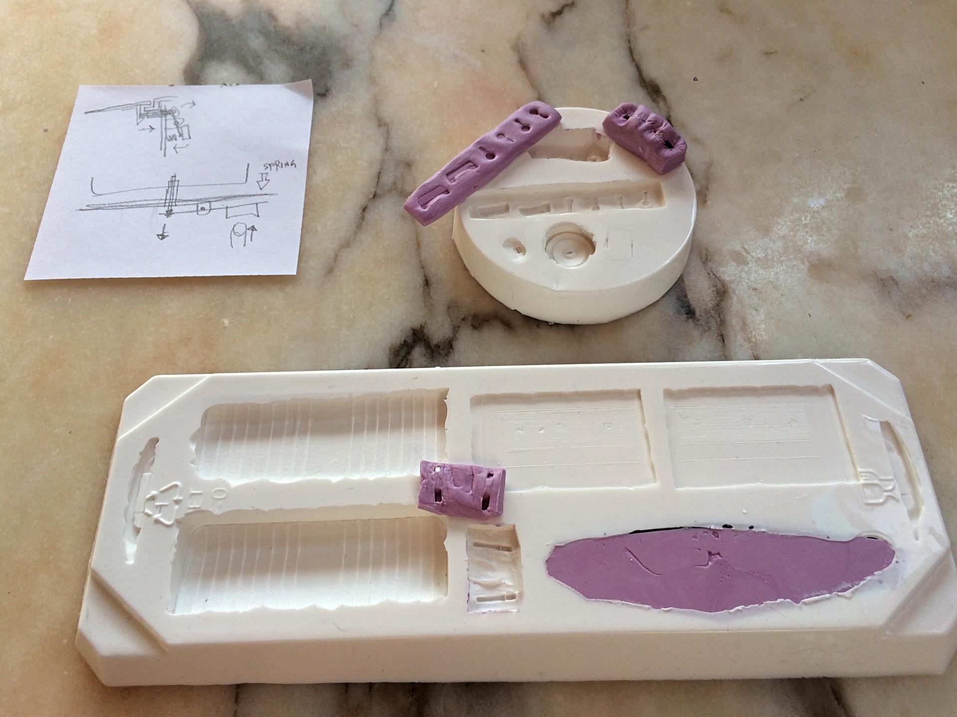

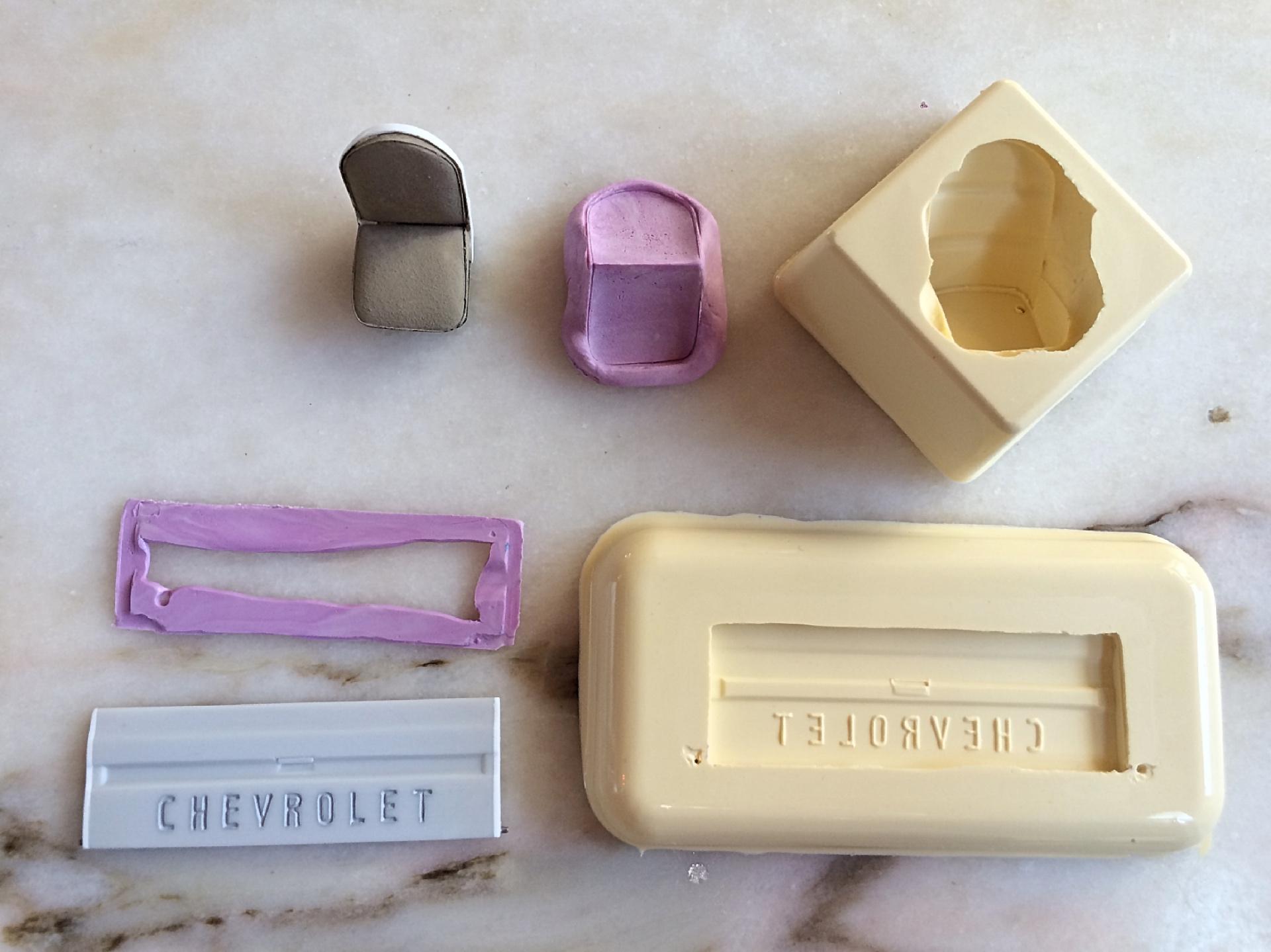

Worked on preparing the bumper for resin casting.  First half is the Alumilite rubber putty.  Also going the be able to make door handle copies, these plastic originals will go to the chrome plater with the other parts, but the resin bumper will have to be separate.

Got a new batch of RTV, successfully made the molds.  Worked all day on trying to get one half decent front bumper, to send for chrome plating.  Wasted a bunch of resin, but since it has a short shelf life, better than never using any.

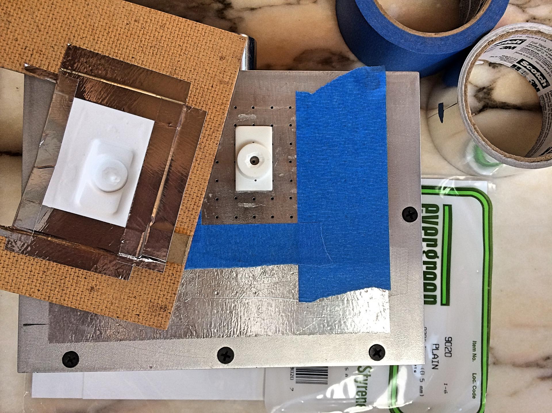

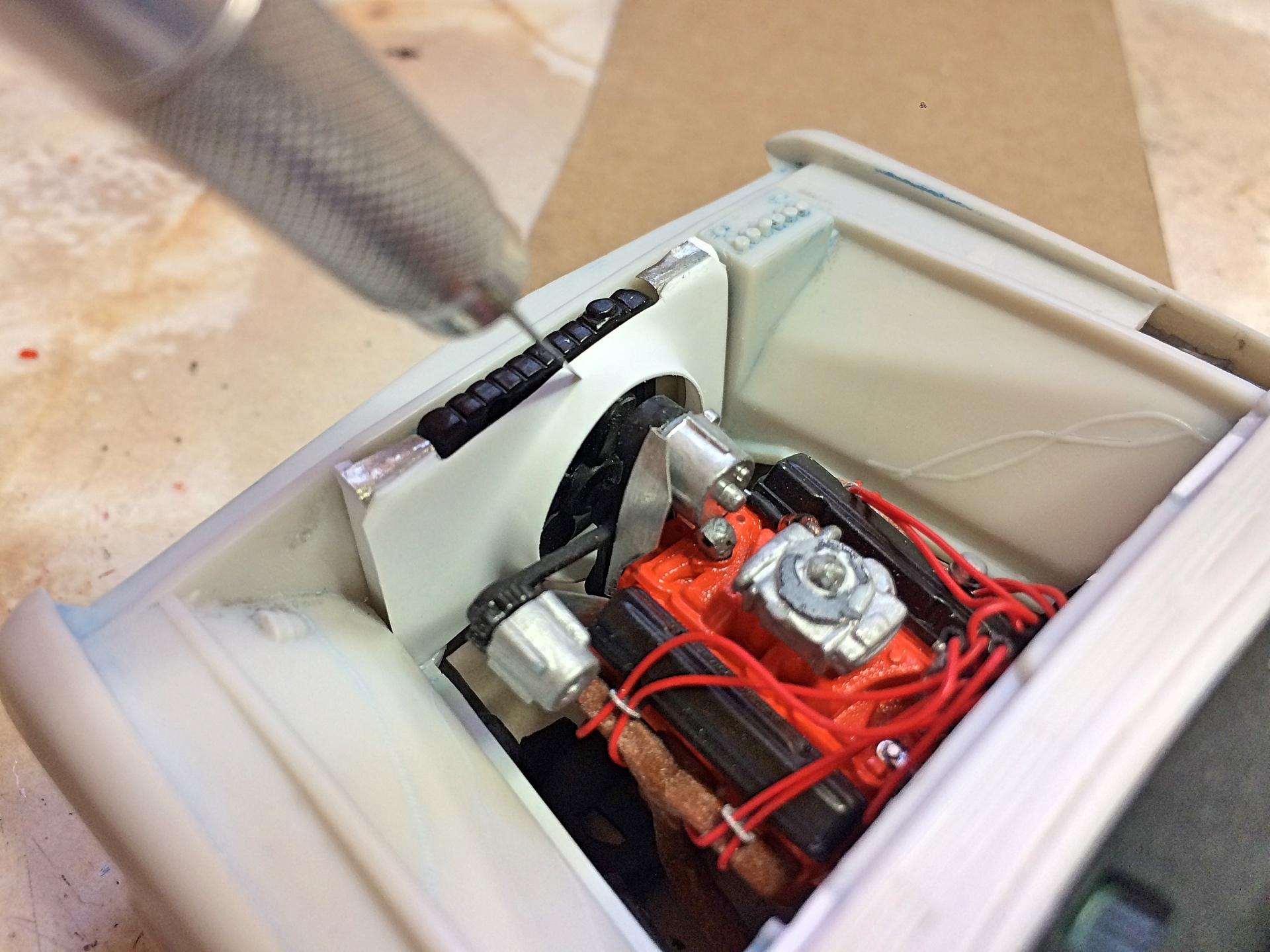

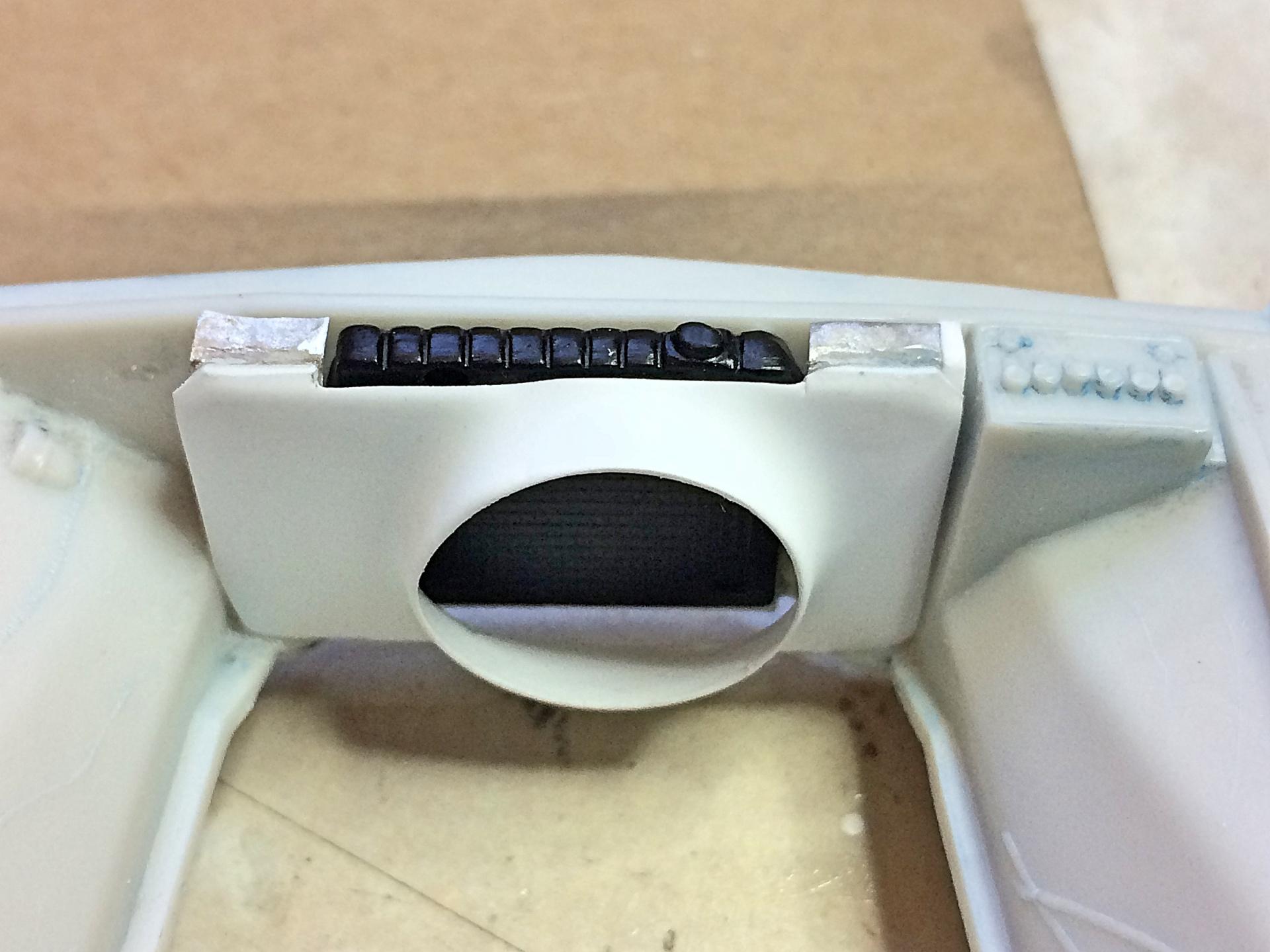

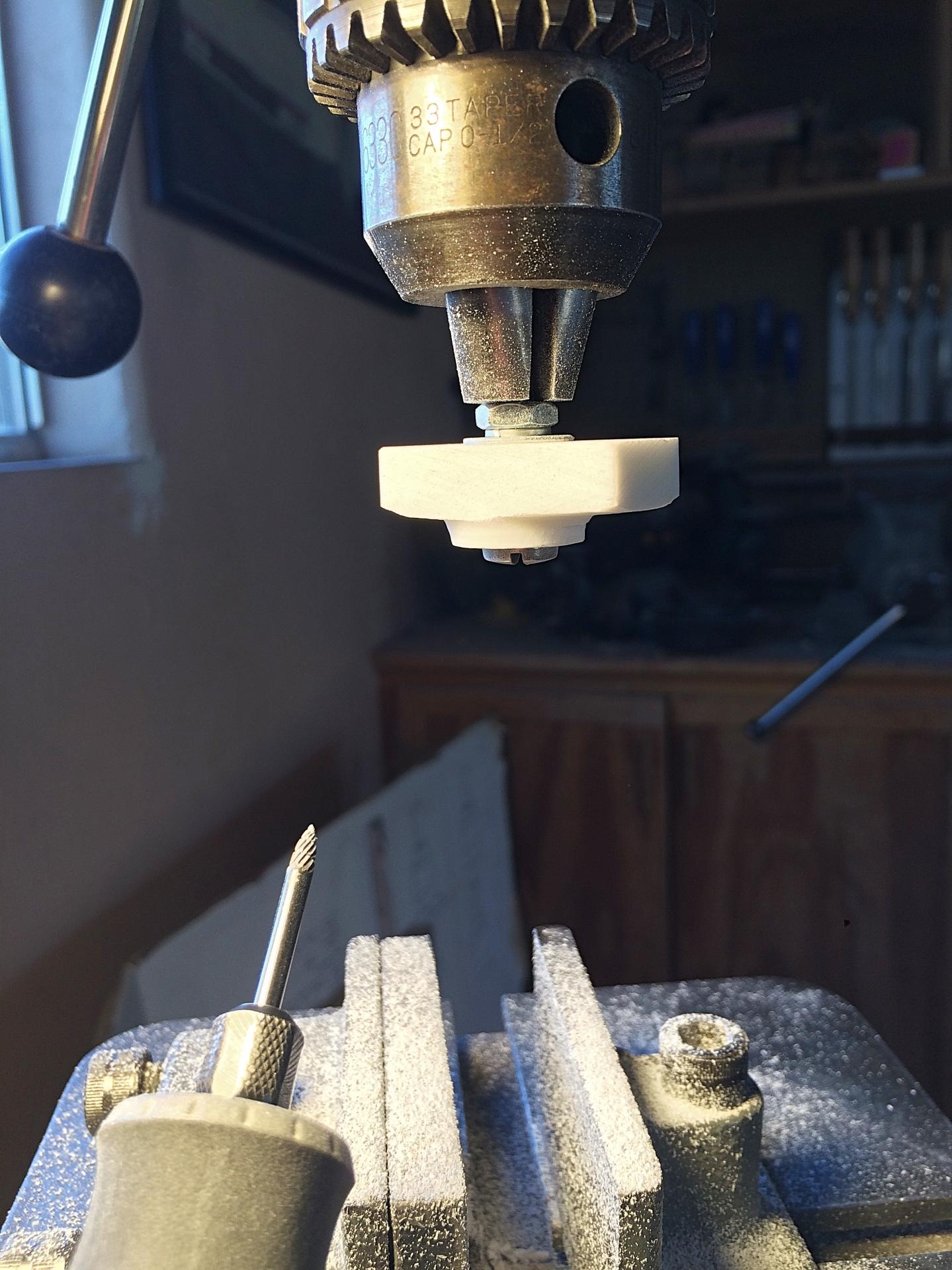

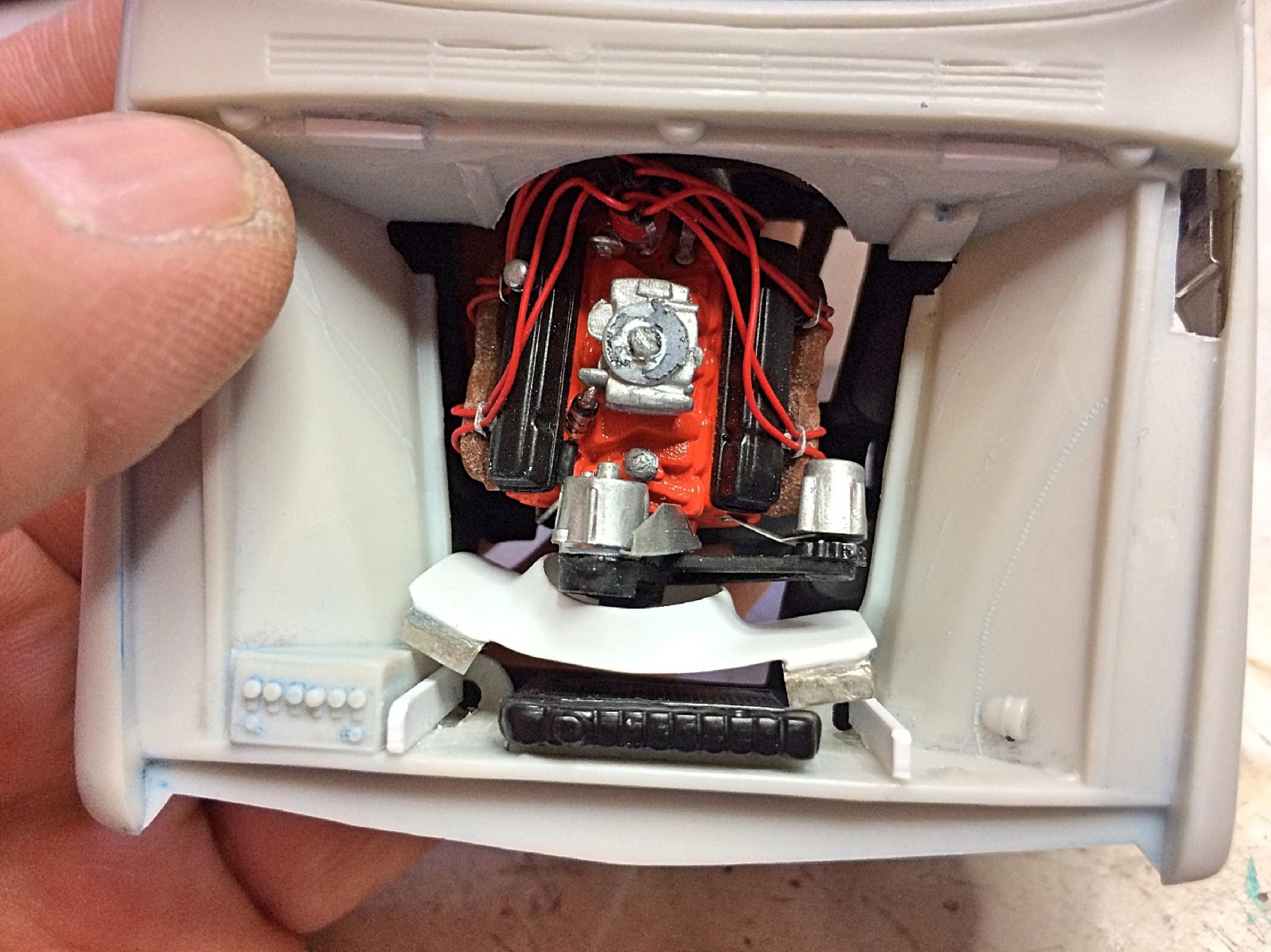

Decided to fabricate a fan shroud.  This item is obvious in most vehicles, thought it would add a little detail while disguising the inaccurate radiator and inner fenders, and fat fan blades.  Turned the pattern out of Corian, using the drill press and Dremel.

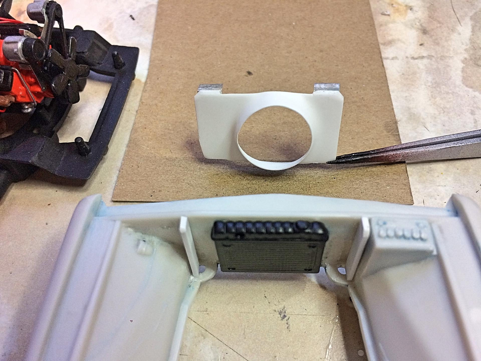

For once, the first attempt was successful on the vacuum-form.
Cut out, several test fits later.....  The promo style engineering had big round things on each side of the radiator, not at all representative, so grinding them out helped a bunch.  I don't like the battery, but if I did that, next would be vac-formed inner fenders, then correct suspension, and then you would never see this done. ?
I figured getting everything together would be a trick, easy enough to bend the shroud.

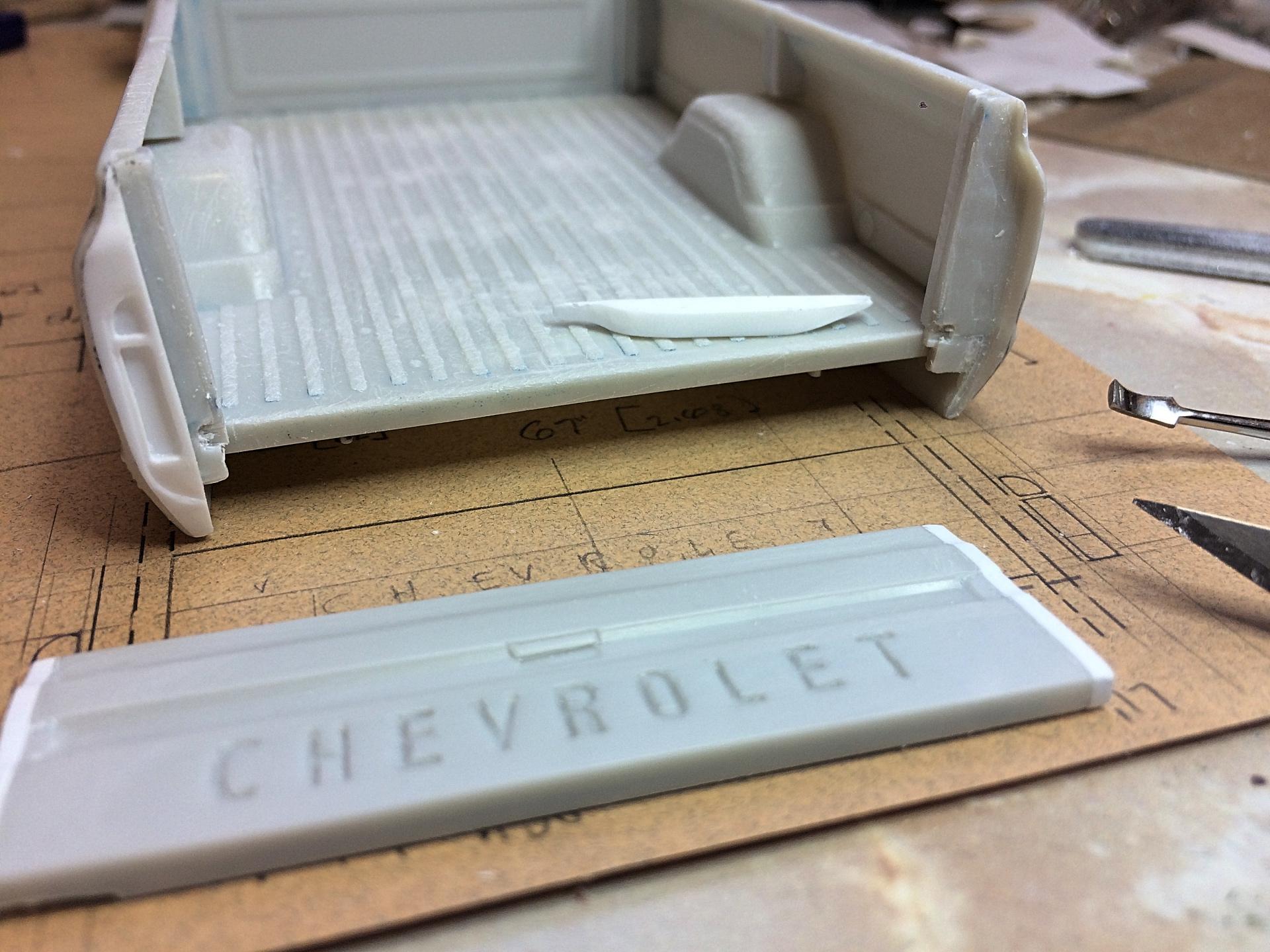

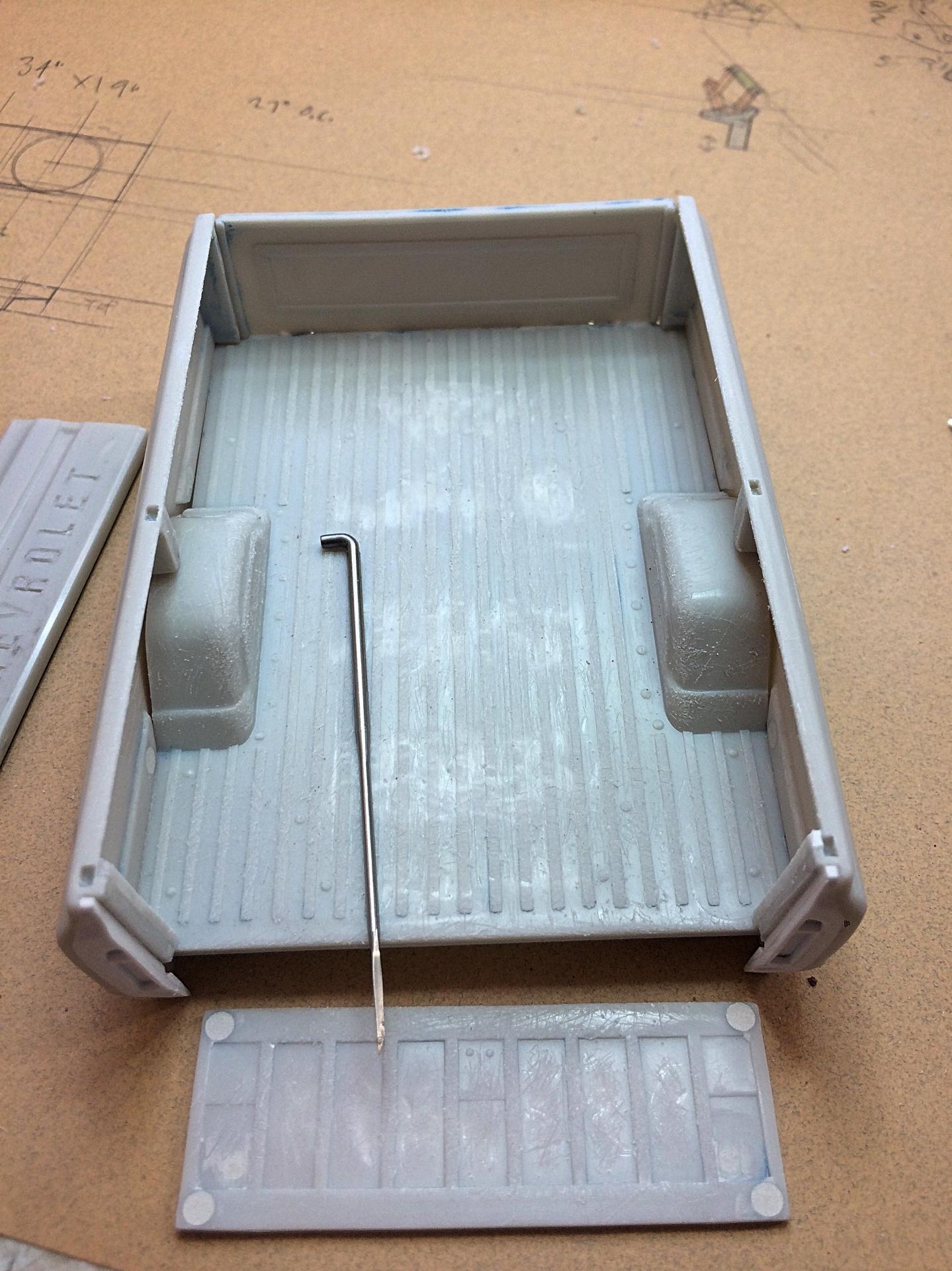

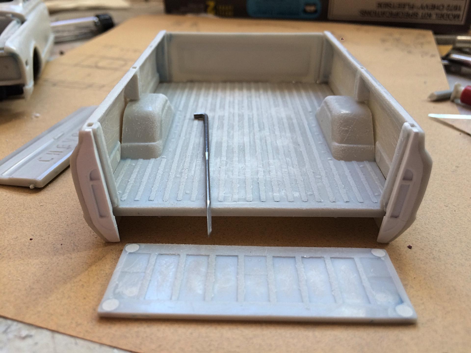

The real truck had bodywork done before painting, but the bed floor was not touched.  It worked on a ranch, was beat up by livestock; distressed by grinding down the underside until it could be bent, hit with the knife handle and file tip, sanded with the roughest emory cloth I got.  Also added the stake pockets; made a tiny chisel from a machine sewing needle, sharpened on oil stones.
Cleaned up the tailgate letters best I could.  Need to figure out how to evenly smooth the bottom on all.

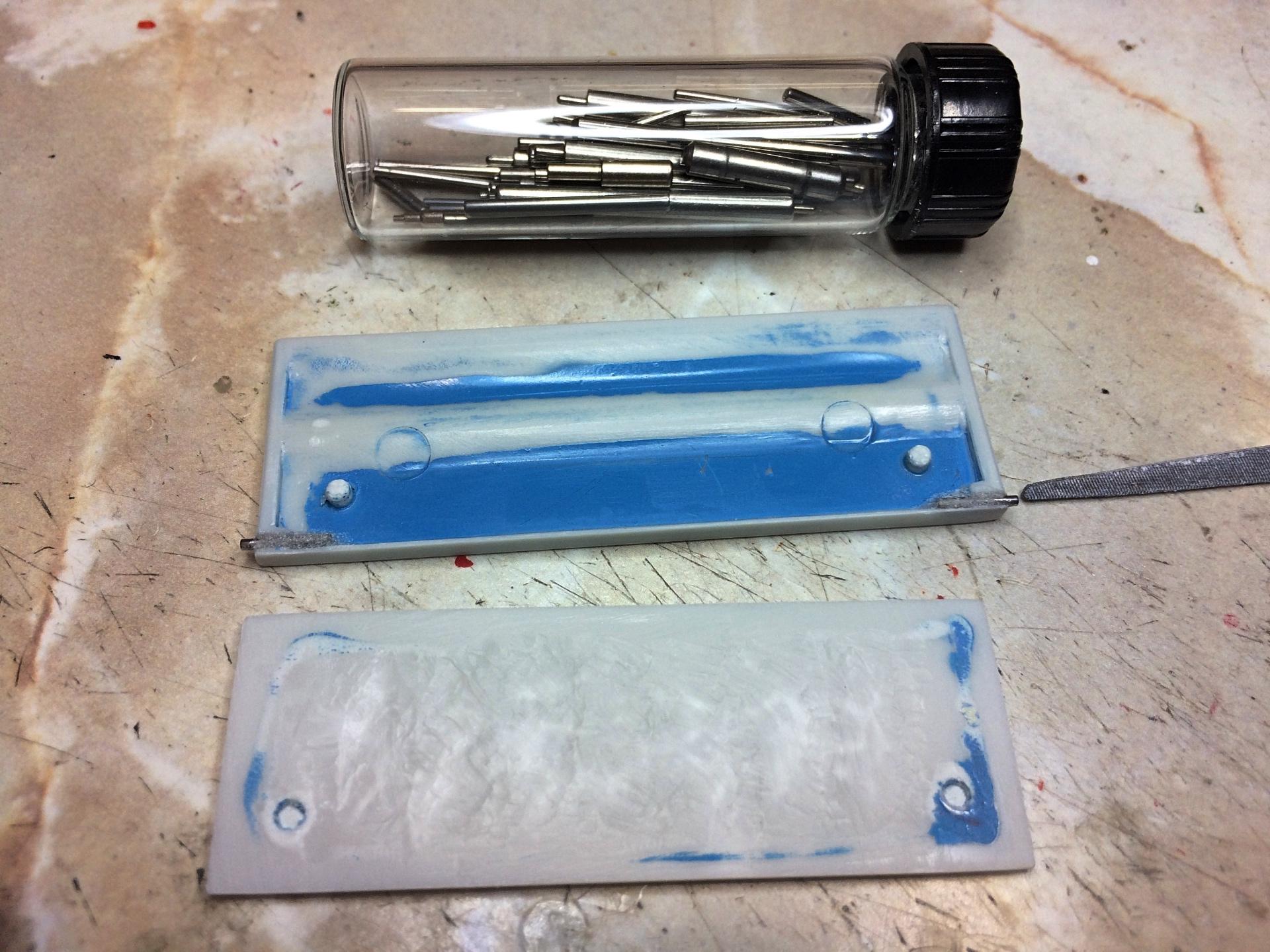

Great, nothing like thinking you got past a step, then the next one forces you to re-evaluate and say "since I'm going to all this work, why half-*$$ it?"  Good thing I made a mold and have cast some resin parts already.  I have a collection of salvaged electronic parts, this bottle is pins, cut one in half for the tailgate pivots which are relocated on the original part.  You can also see how I ground down the back of the tailgate panel, to distress.

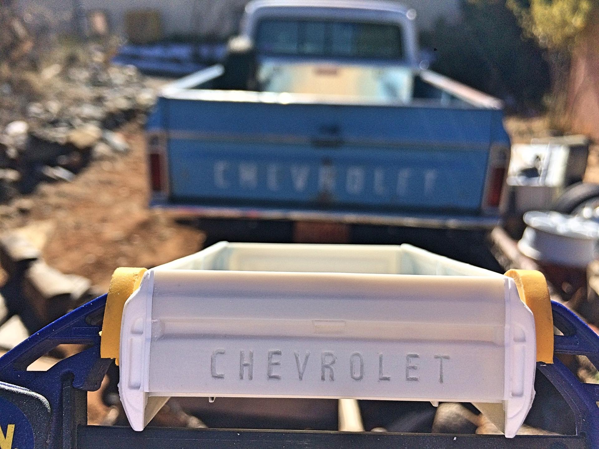

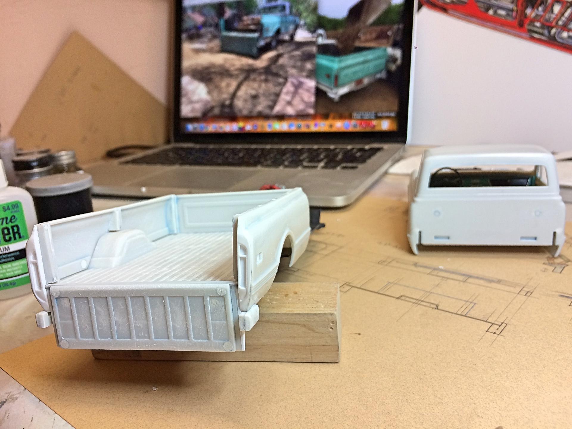

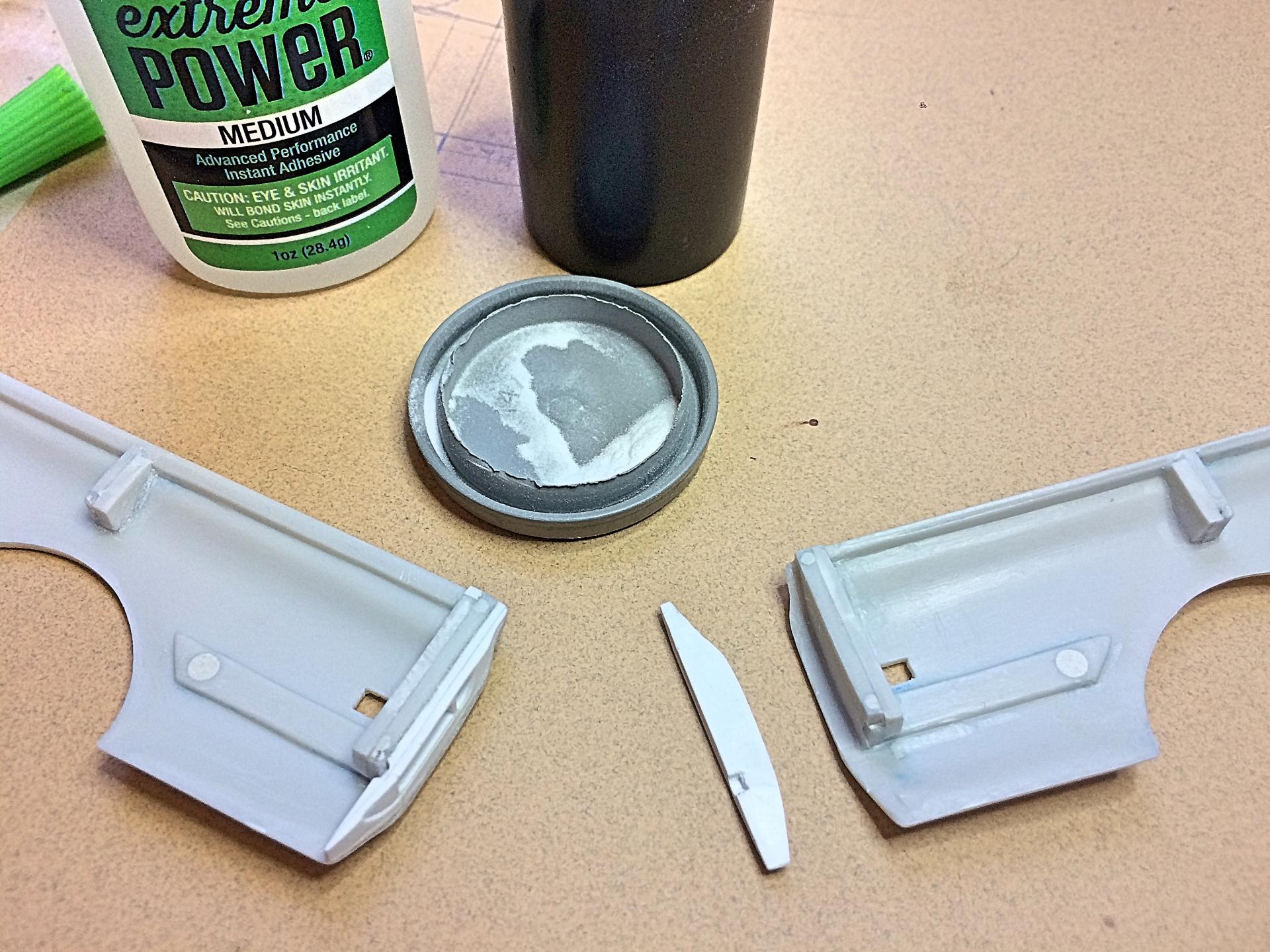

I wasn't happy with how the taillights were too far in.  I knew the tailgate is narrower than measured on the real truck, wasn't really sure why AMT did that.  Only after assembling this area, do I see how to fix it.  Will need to waste the taillight parts, grind almost to the corner.  The outer tailgate will be easy to make longer, need to redo the pivots.  Won't add to the inner tailgate.  Discovered other things that need attention before final gluing the back end (the front of the sides are glued to the bed and front panel).

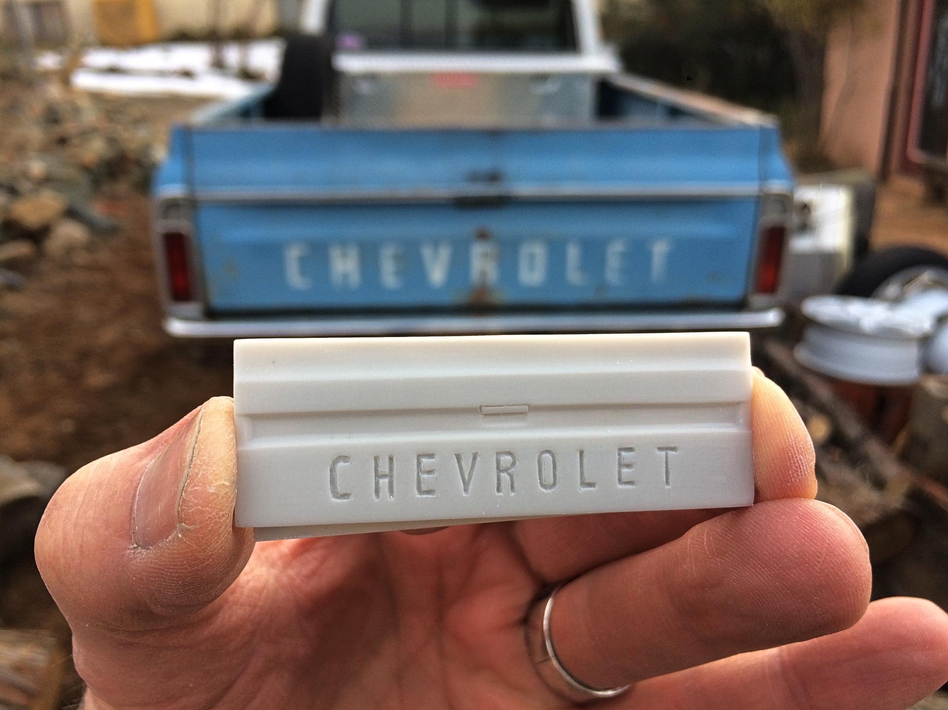

Alright, managed to improve the tailgate area 1000%! ?
Squint and see it's close enough.

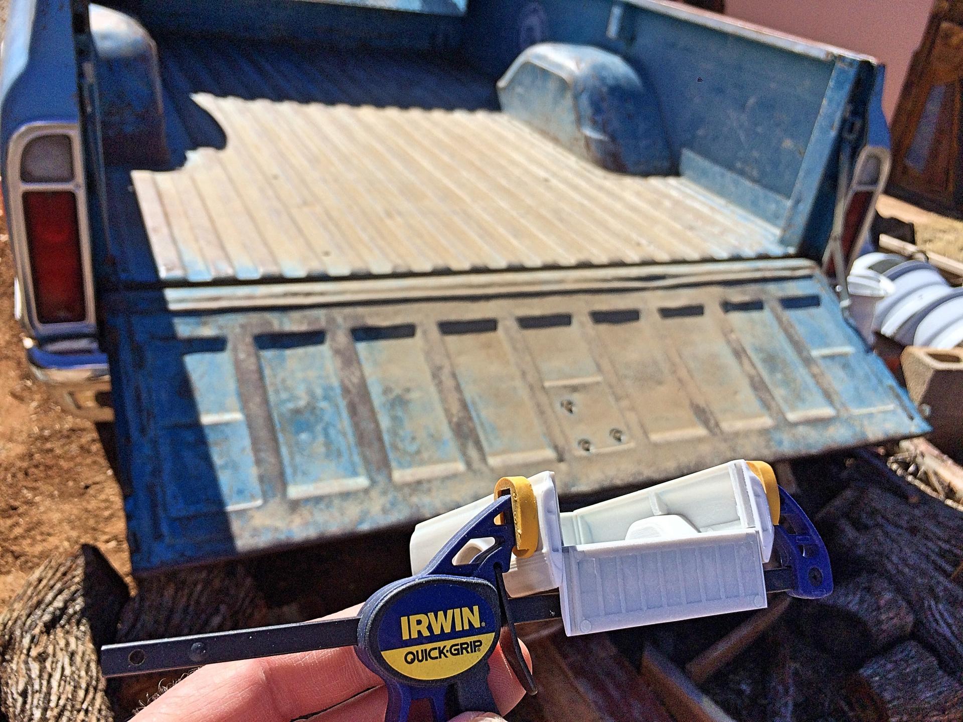

The more important thing, the real truck tailgate can open all the way down, when you take the support arms off.  In the case of my '68, no, but the '69 had what was a ranch bumper, which came in handy a few times.

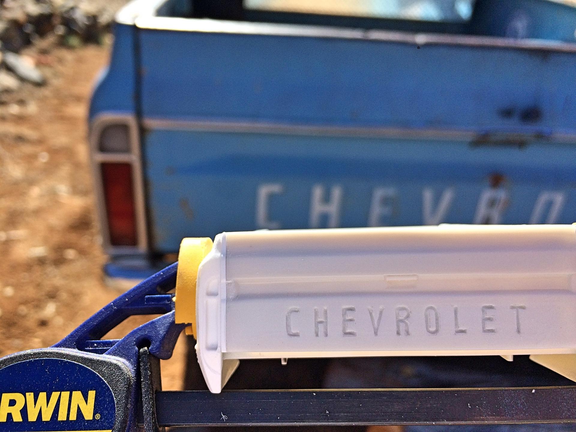

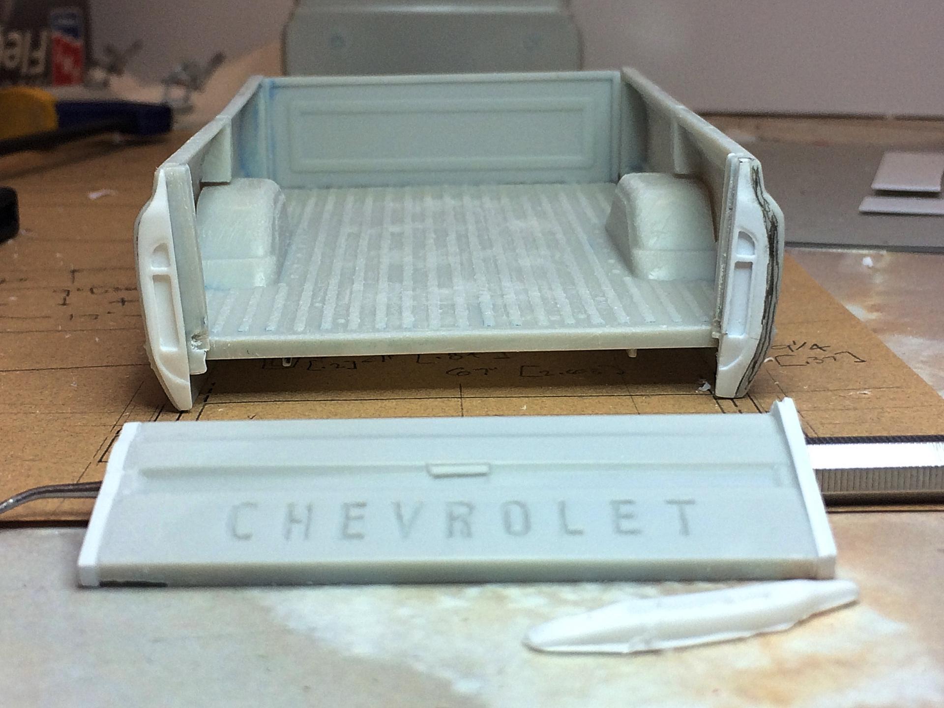

One tip, always double-check modifications before you use RTV, you don't need to duplicate mistakes.  I noticed the tailgate is still not correct, the indent above the letters has an angled slope inward, and the plane the letters are on is just a little 'lower', there is no dip at the recess belt line.  Also, a weird thing with this Alumalite RTV, the catalyst changed color in the short time since opened.

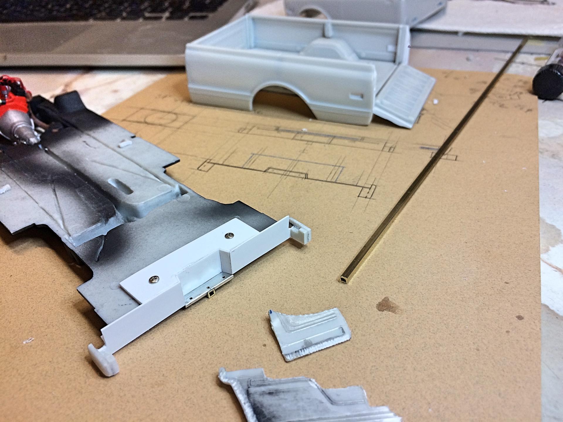

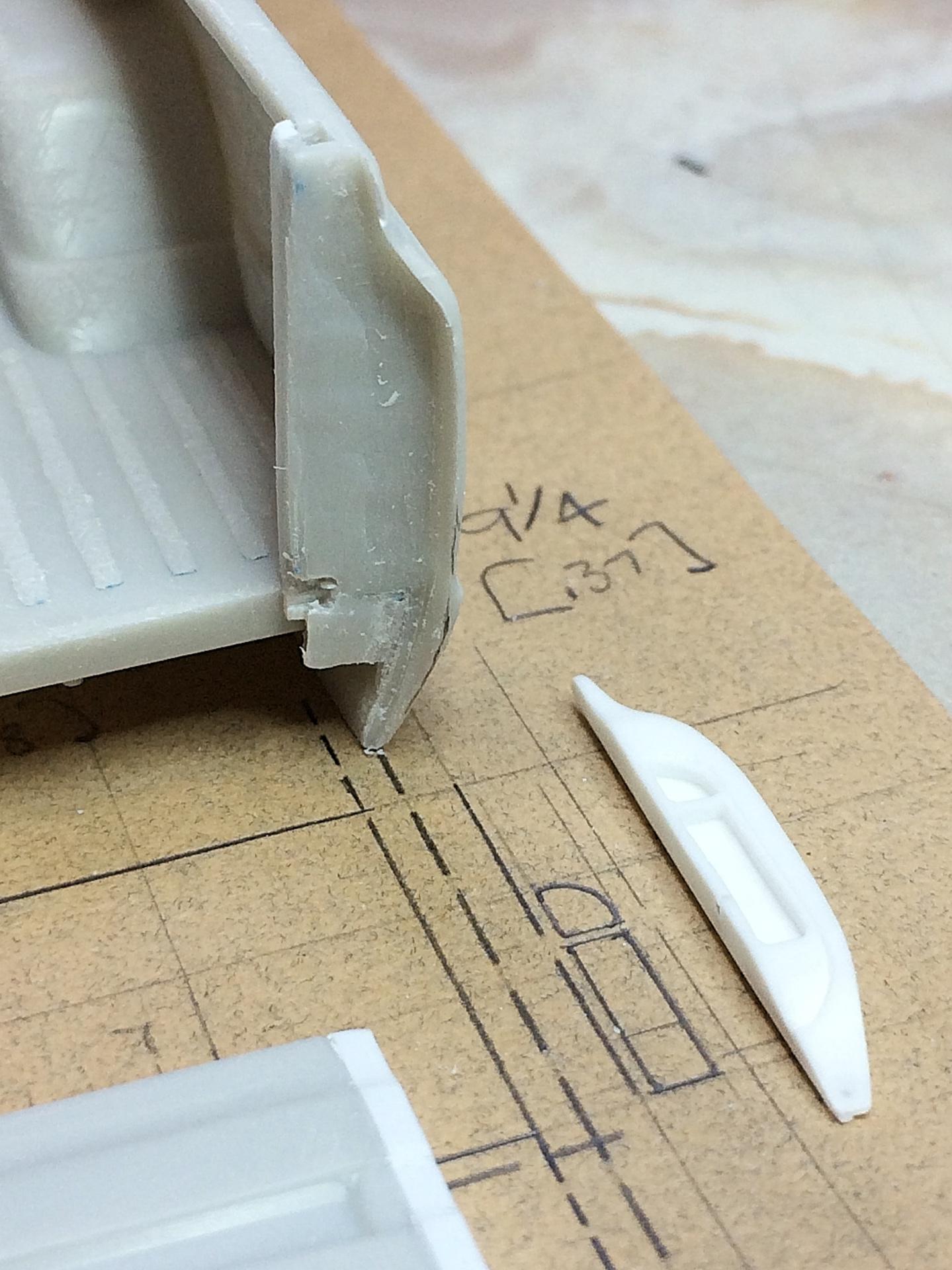

First major part to be scratch-built that is unique to the real pickup, the ranch type back bumper.  Had to fudge a few things, drew it first.  Screwed it to the chassis plate, just in case it needs adjusting after painting.  Used some of the interior left-over pieces for the ends.

??  Running the '48 Canopy Express along with this project, since similar processes are involved.  I'm going to work on this copy of the tailgate, namely the area that is a failure anyway, that should be sloped inward anyway.  The other thing is to work on the plane the letters are in, needs to be cut down about .5mm.  I'm also trying to make a bunch of door handles that will be sent out for chrome plating.

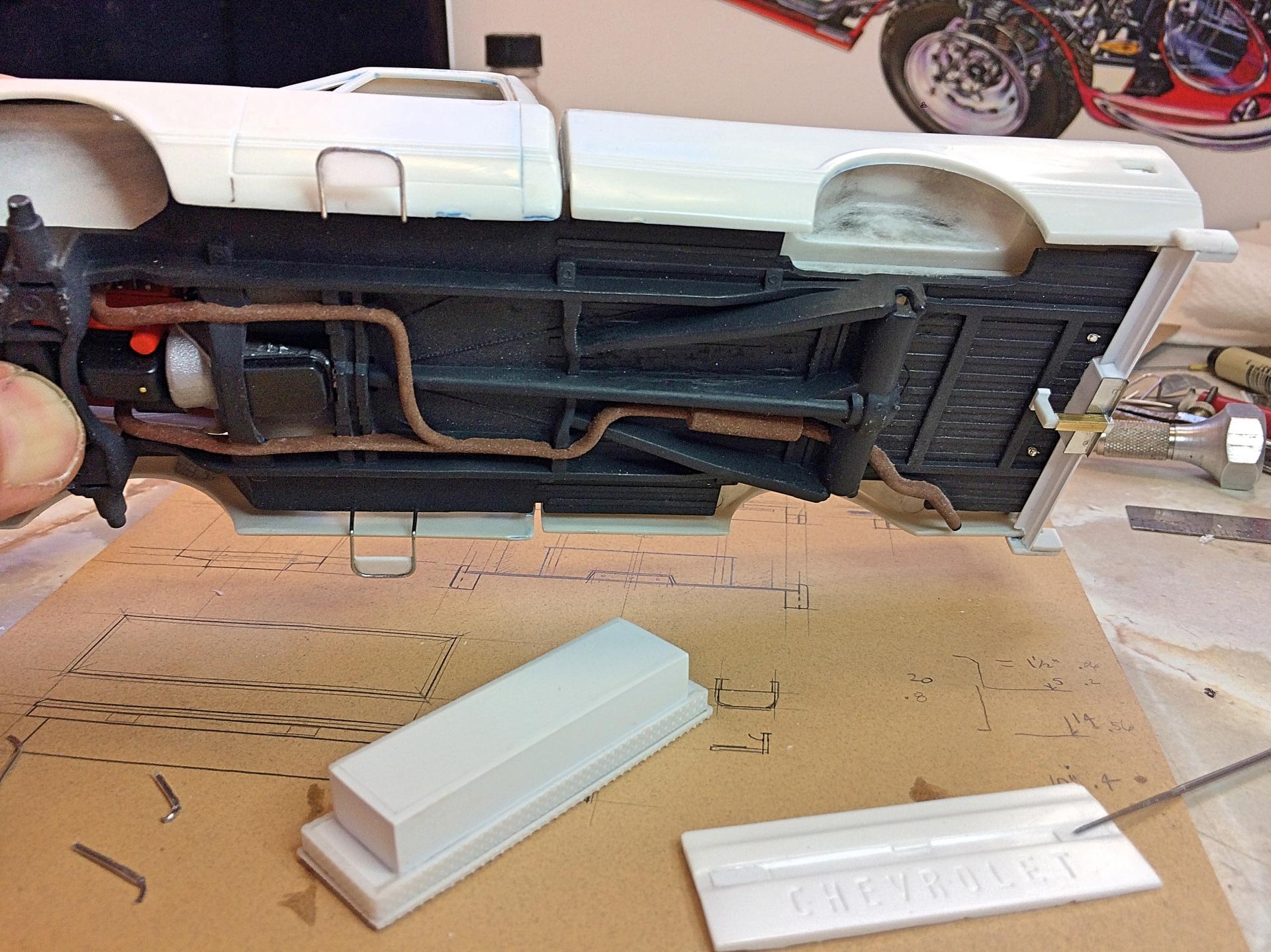

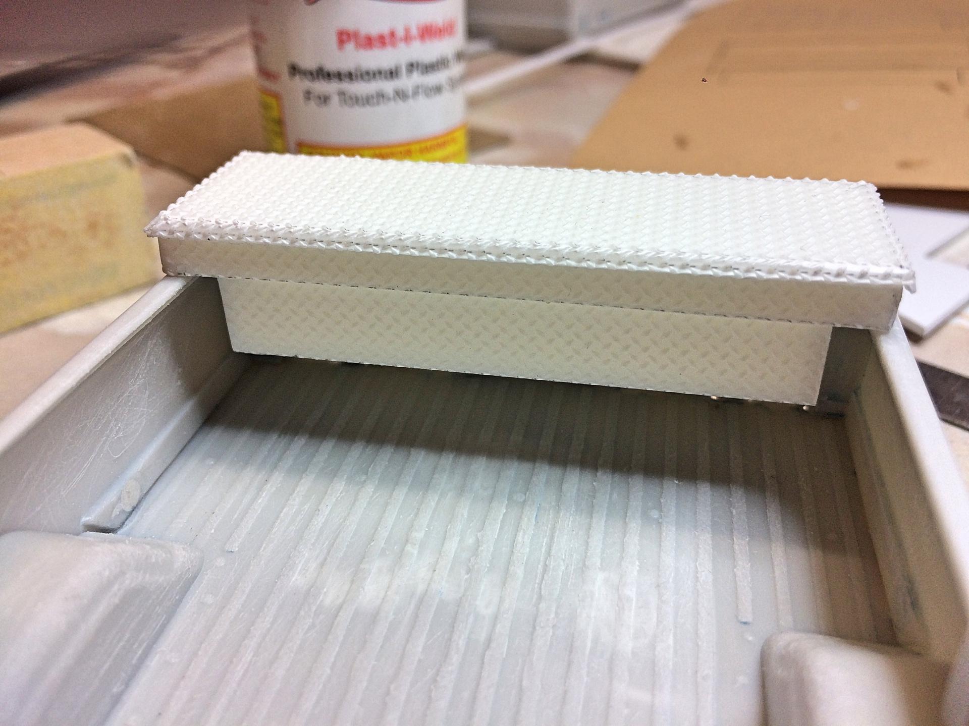

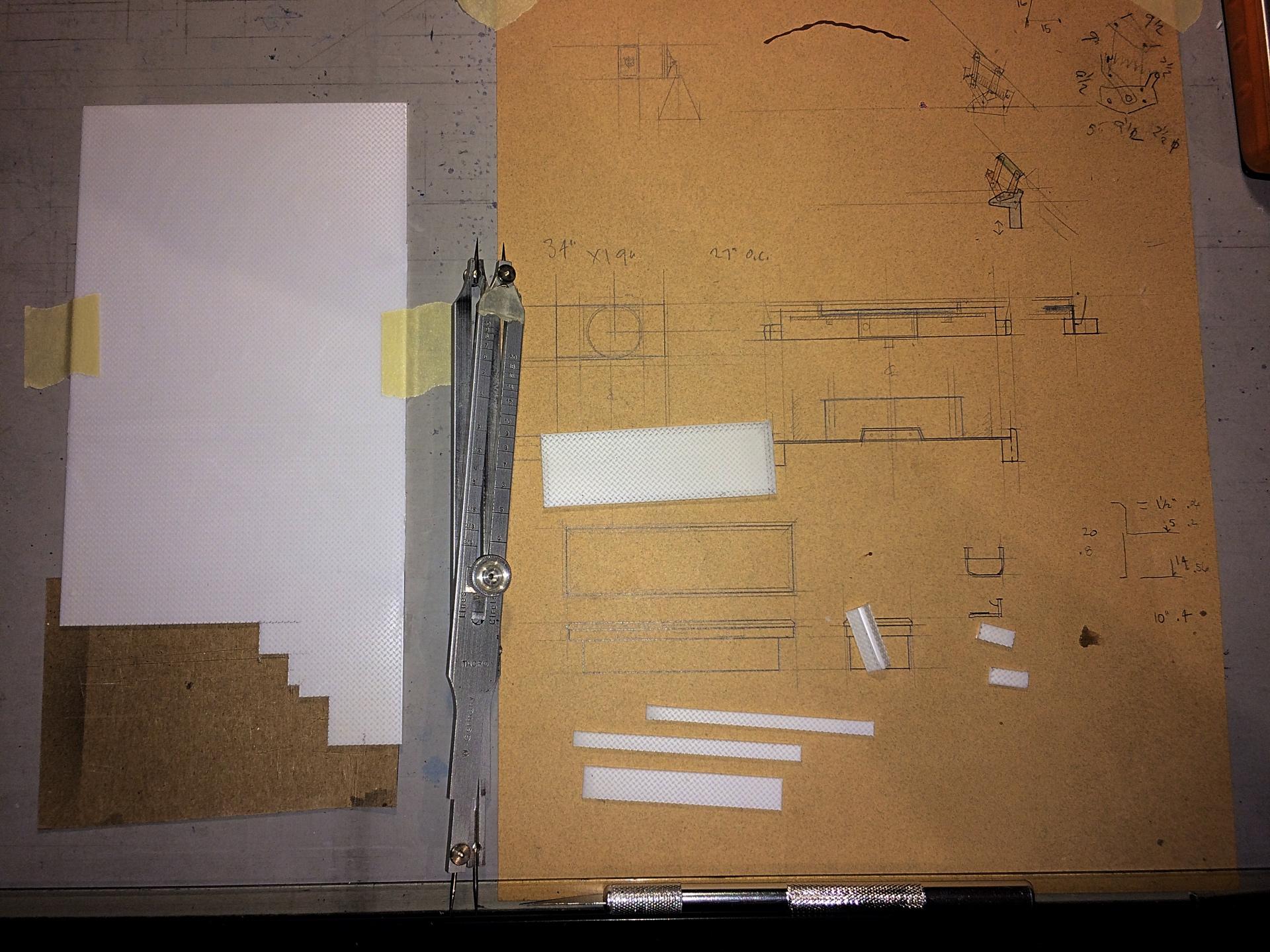

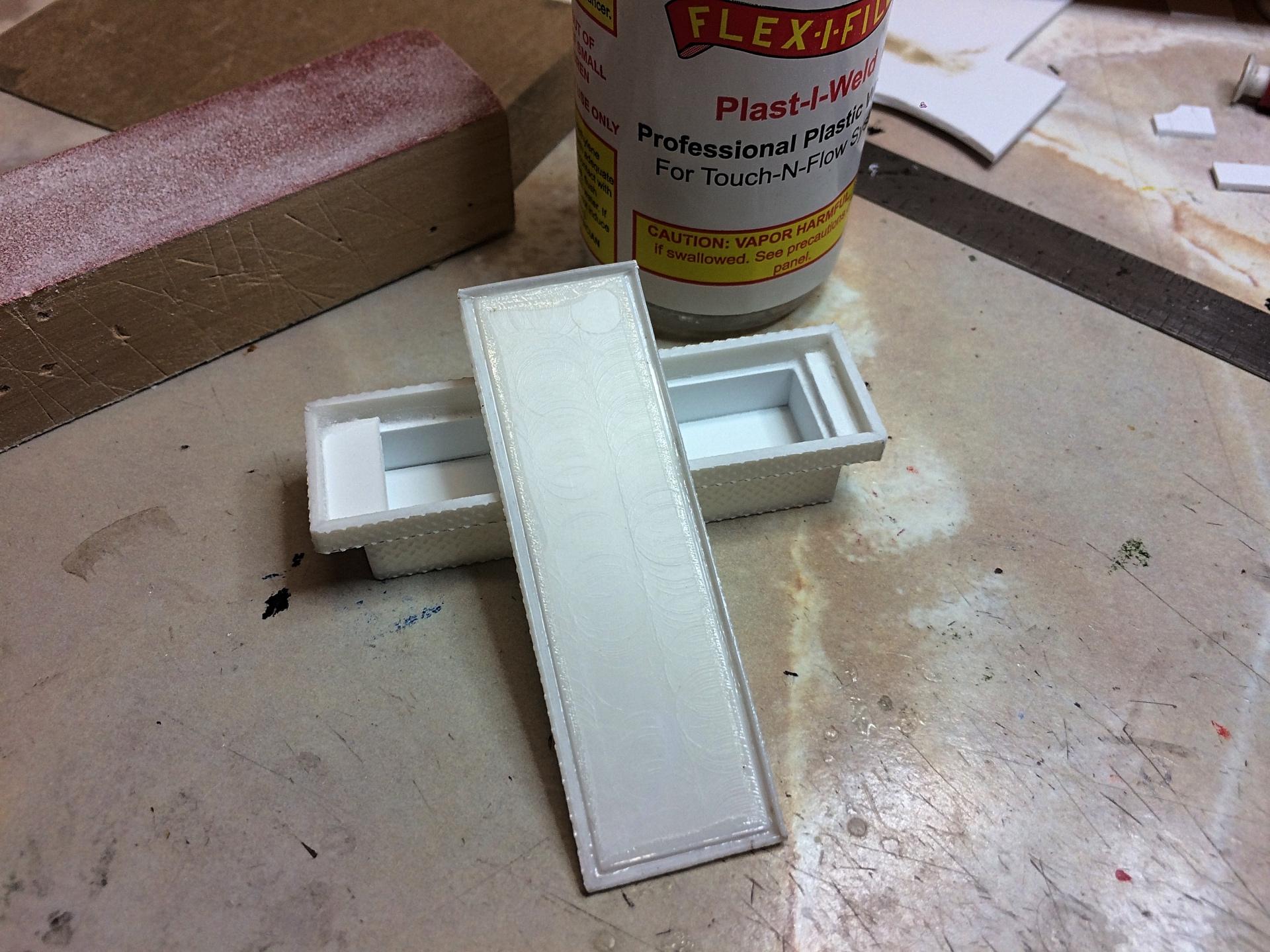

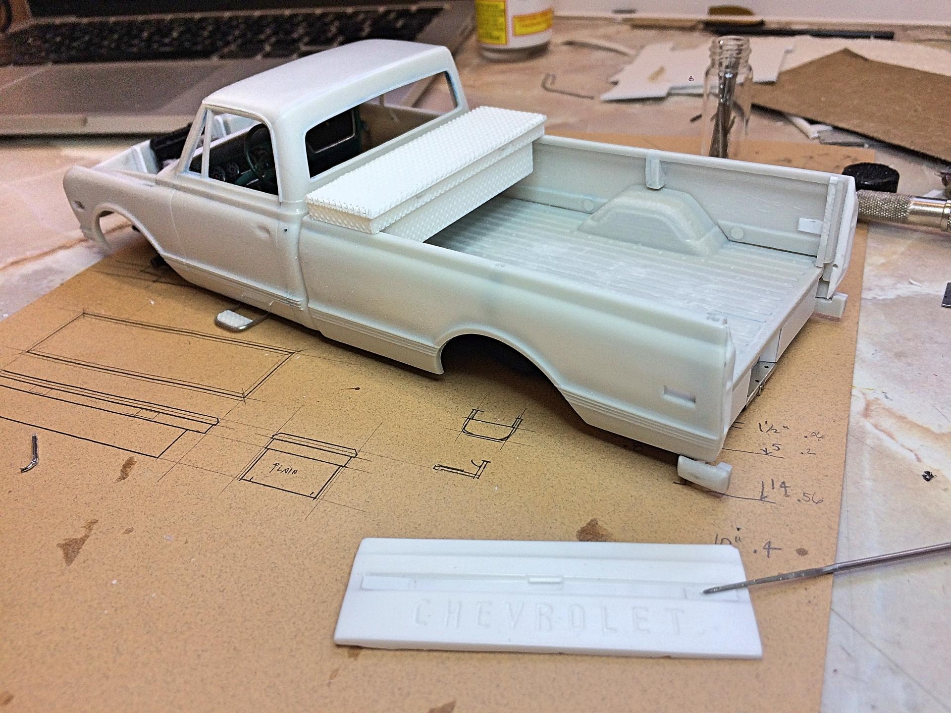

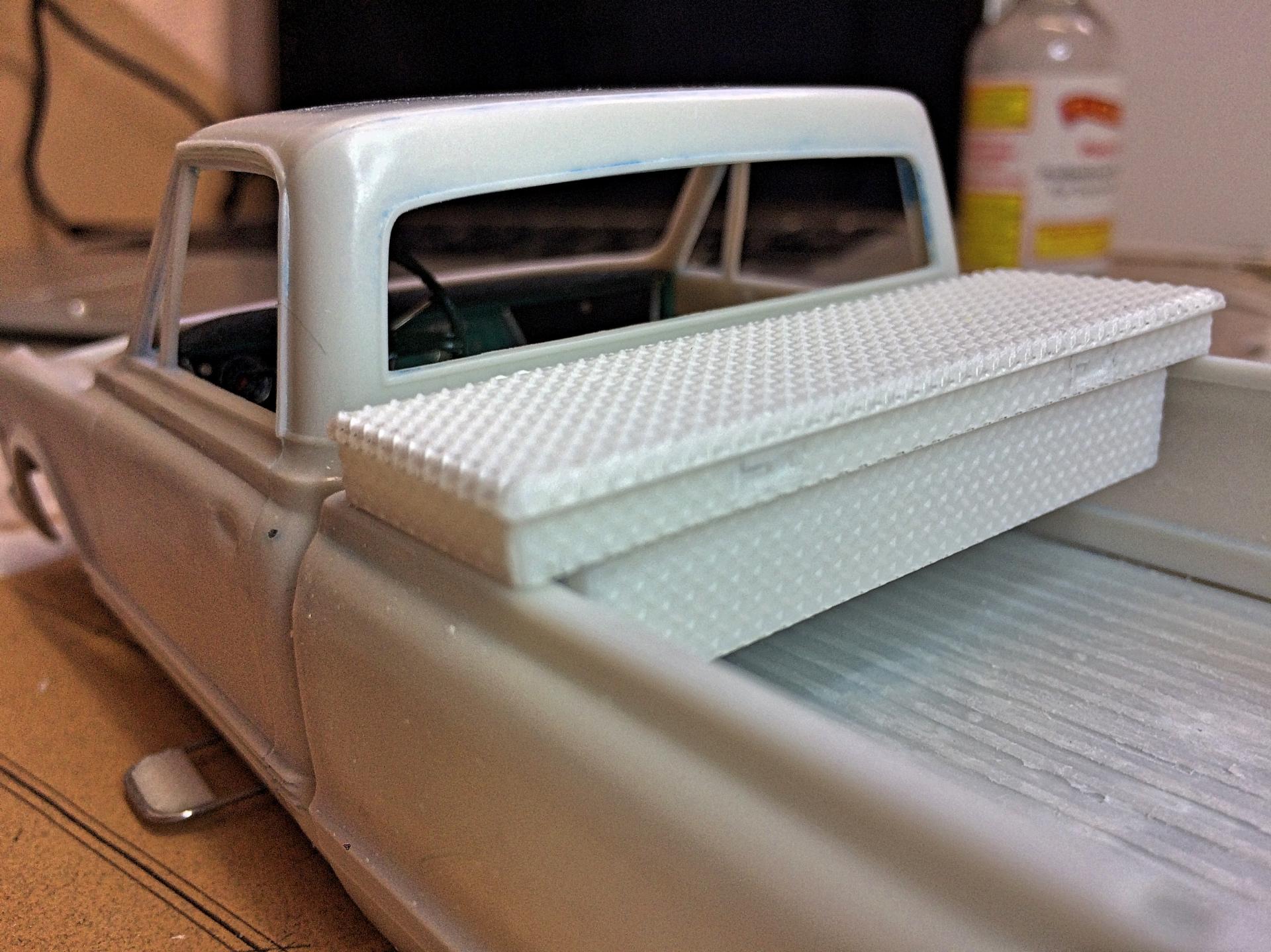

Thanks to this forum, got a lead to nice diamond plate, so got the toolbox and steps done.  First step was using photos I took with the tape measure in the picture, taken when I knew the truck was sold, drew to scale.  Taped down the diamond plate on the drafting board, marked then cut out the parts.
Got this far by 2:00AM.  For the lid, scribed first, then scraped down the edge, final scribe for the bend lines, used the liquid cement to soften the plastic to help bend, and of course weld the corners.
This morning cast a tailgate, then started to modify it.  Made the steps using paper clips, which are nice a shiny, unlike many.IMG_1642_Fotor.jpg.7063019d04c91cdf05a6a71876169900.jpg
Scribed and cut in the latches.
For the box, only the exposed sides are diamond plate, why waste it when not seen?  Steps were simply drilled into the floor pan, which will make them easy to adjust for final assembly.

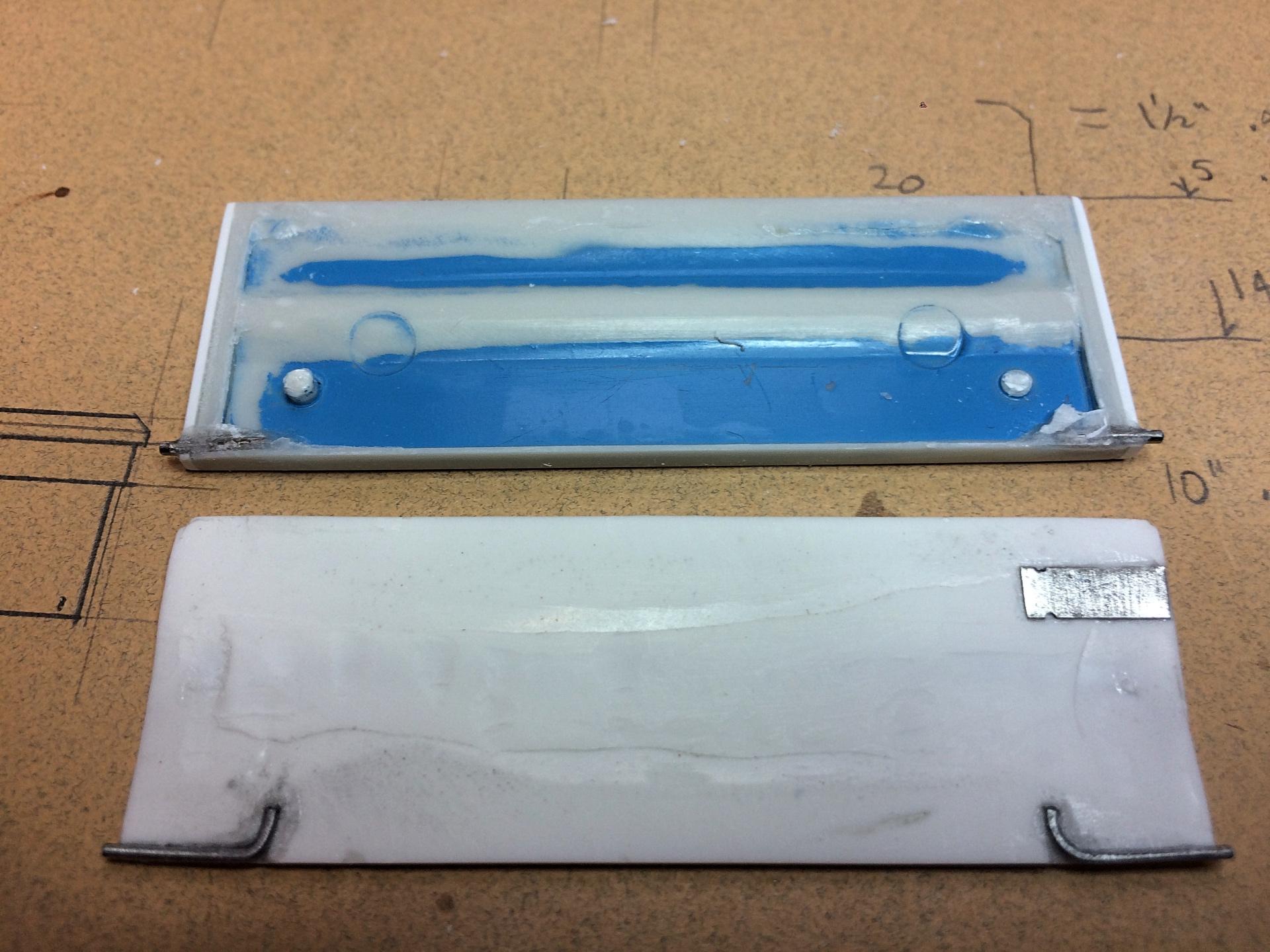

Revised the hinge pin locations a little, used the same paper clip.  I'm going to put a magnet into the bed stake pocket, so embedded a steel plate.  Then I mixed some resin and put on glass, then squished down the tailgate, so the back will be completely flat for when I make a new mold.  The whole unit will also be thinner, the kit is too thick.

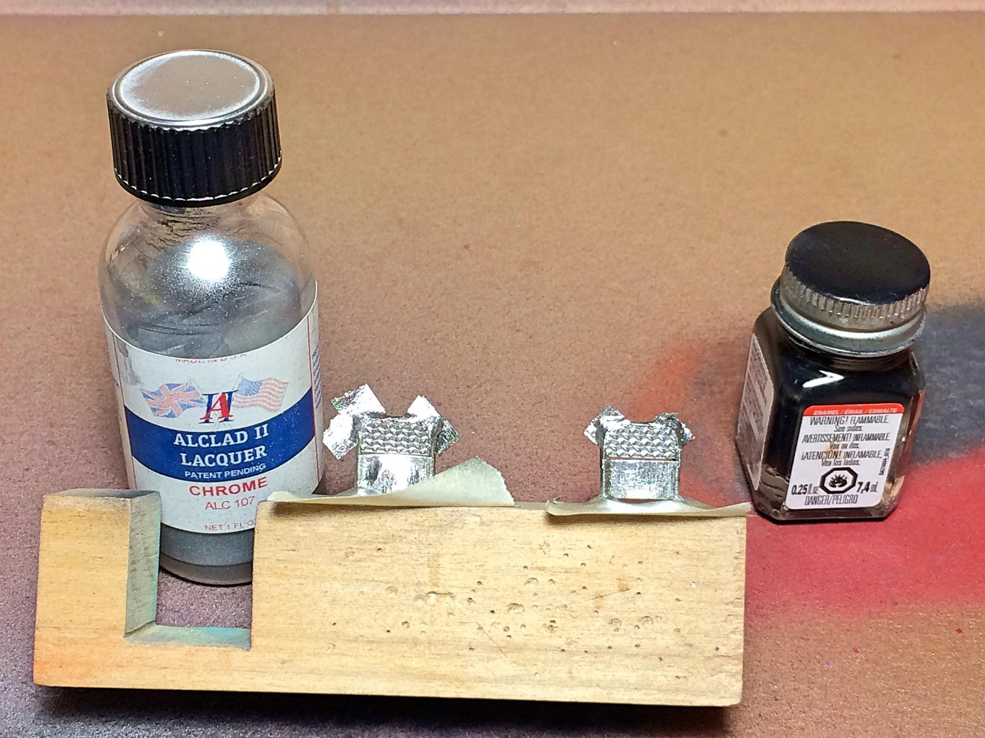

Masked the paper clip, sprayed Alclad 'chrome' on the steps, since they were steel.  The box will be 'polished aluminum', after I make a mold of it too.
