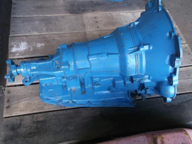

OLDS PONTIAC SLIM JIM ROTO HYDRAMATIC TRANSMISSION 1960's IN SAN DIEGO
The bigger Super Hydramatic (Star Chief and Bonneville) isn't in anything, far as I know...but you could build a passable example by modifying one of the earlier Hydramatics available in parts-packs.
1962 Pontiac Transmission

Yup, looks kinda like the short-tailshaft version of the Roto box in Tempest .

Yeah, the GP supposedly used the "Slim Jim".
Neither of those Johan gearboxes are really right, but either would be probably as close as you're going to get.
The correct gearbox case bolts together in 3 pieces, like zo. Neither of your doners represent this correctly. So whichever one you think looks best, well, there you go.
A somewhat more accurate appearance might be obtainable by mating a manual gearbox bellhousing to whichever one you choose.
