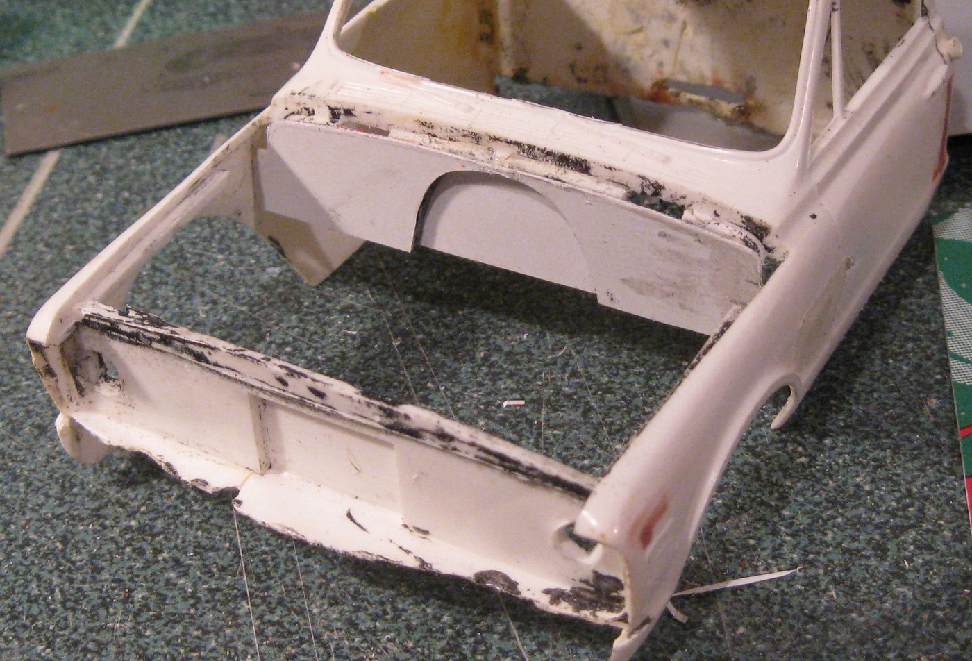

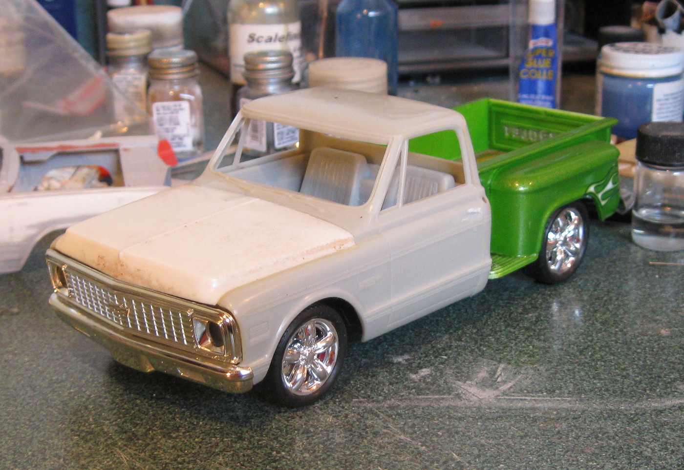

Did a bit on this last weekend . Decided to use this MPC cab and interior instead of the newer AMT cab shown above.
It is a bit rough compared to the unused cab but the grille and front bumper I want to use belongs to this cab.
Did a bit of body work.
Also rounded up most of the parts I'll need for this build.
Unfortunately, the only MPC hood I have has a large hole in the center.  I'll have to fill it. Either with some sheet plastic or a large blower. ?
IMG 2855
Opened up the grille from an AMT Blazer and removed it from it's surround.
I'll grind out the existing grille from the MPC part and swap this one in.  It looks better to me but I may swap the bow-ties as the MPC one looks better proportioned.
IMG 2856

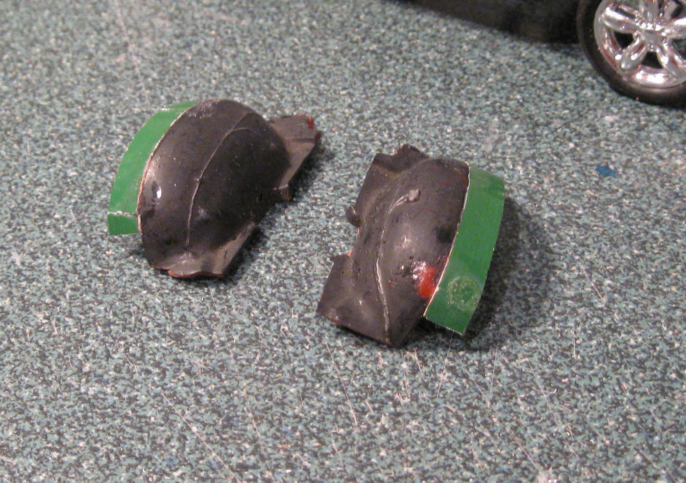

Here's my widened fenders. Doing the math, the assembled box would be 5 scale inches narrow as came in the kit.
I added about 2.5 scale inches to each fender. Looks better to me and now the math works out.
IMG 2857

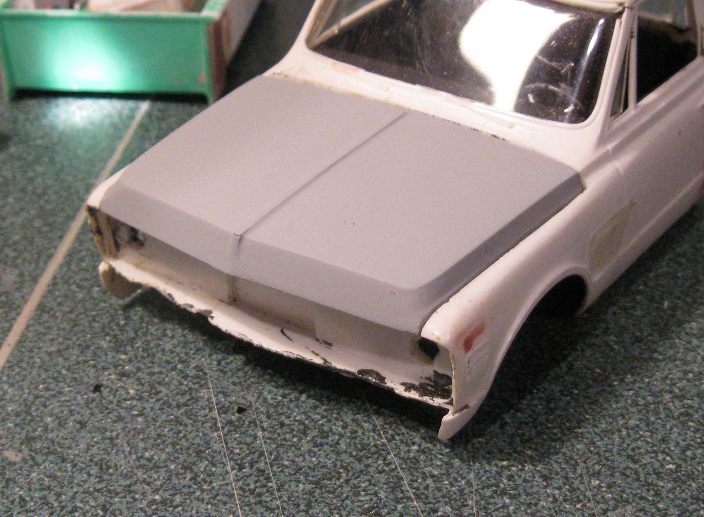

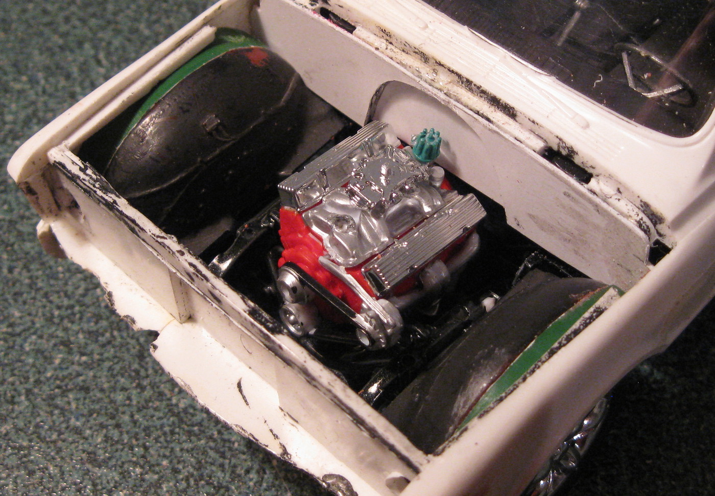

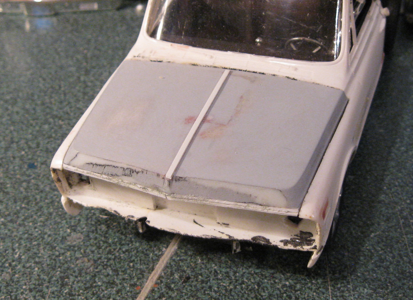

Filled the big hole in the hood, added some material to the front and back ends and re-did the ridge up the center.

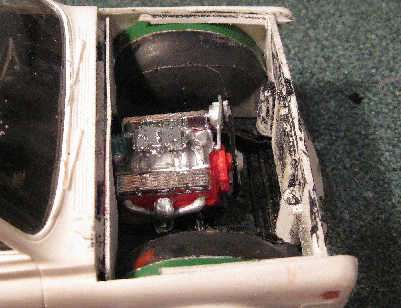

I also have been working on the underhood area. Smoothed off the firewall and filled the cut-out with a piece of sheet stock.
Also making new inner fenders using the inner fenders cut from the chassis plate of an MPC '79 Trans Am widened with sheet stock.
It's just roughed in now and will need more work before I even think of paint.

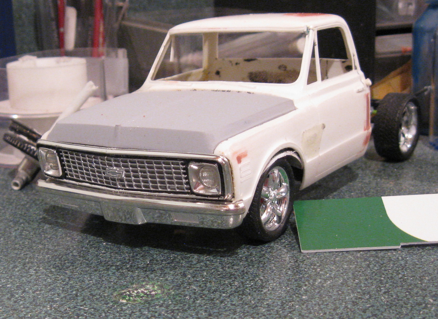

Headlights replaced grille replaced with one cut from an AMT '72 Blazer part and detail painted. I'm gonna run some Tamiya smoke around the headlight lenses later to highlight them.
IMG 2916
  • 1 month later...

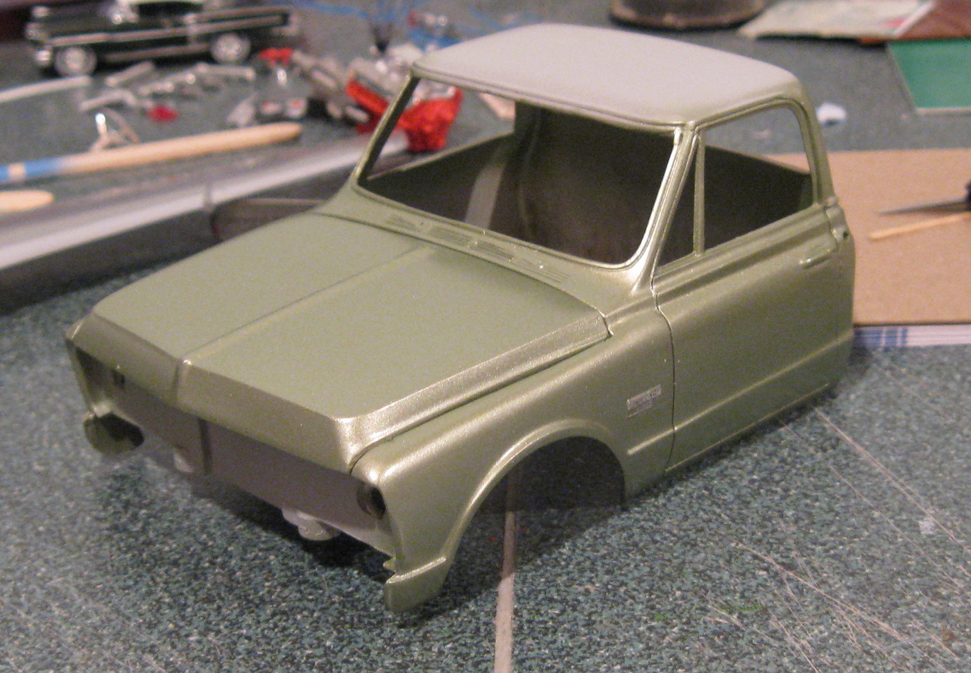

Well, here's a shot with a little color. This thing really fought me.
I've found out the hood was actually from a Blazer but it fits now. LOL
Just need to spray the roof white and I'll clearcoat and polish it out.
IMG 2942
IMG 2944
