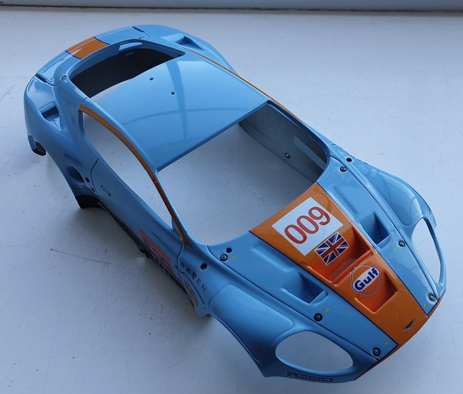

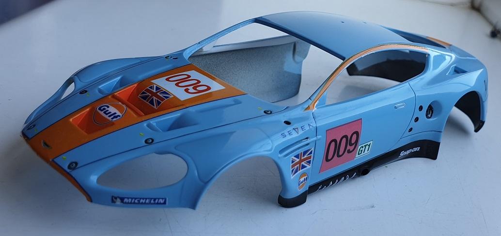

Funkychiken Posted June 24, 2020 Author Posted June 24, 2020 To the untrained eye, it looks no different, but this is a week's worth of on & off polishing! ready for final masking and painting... not perfect, but good enough for me!

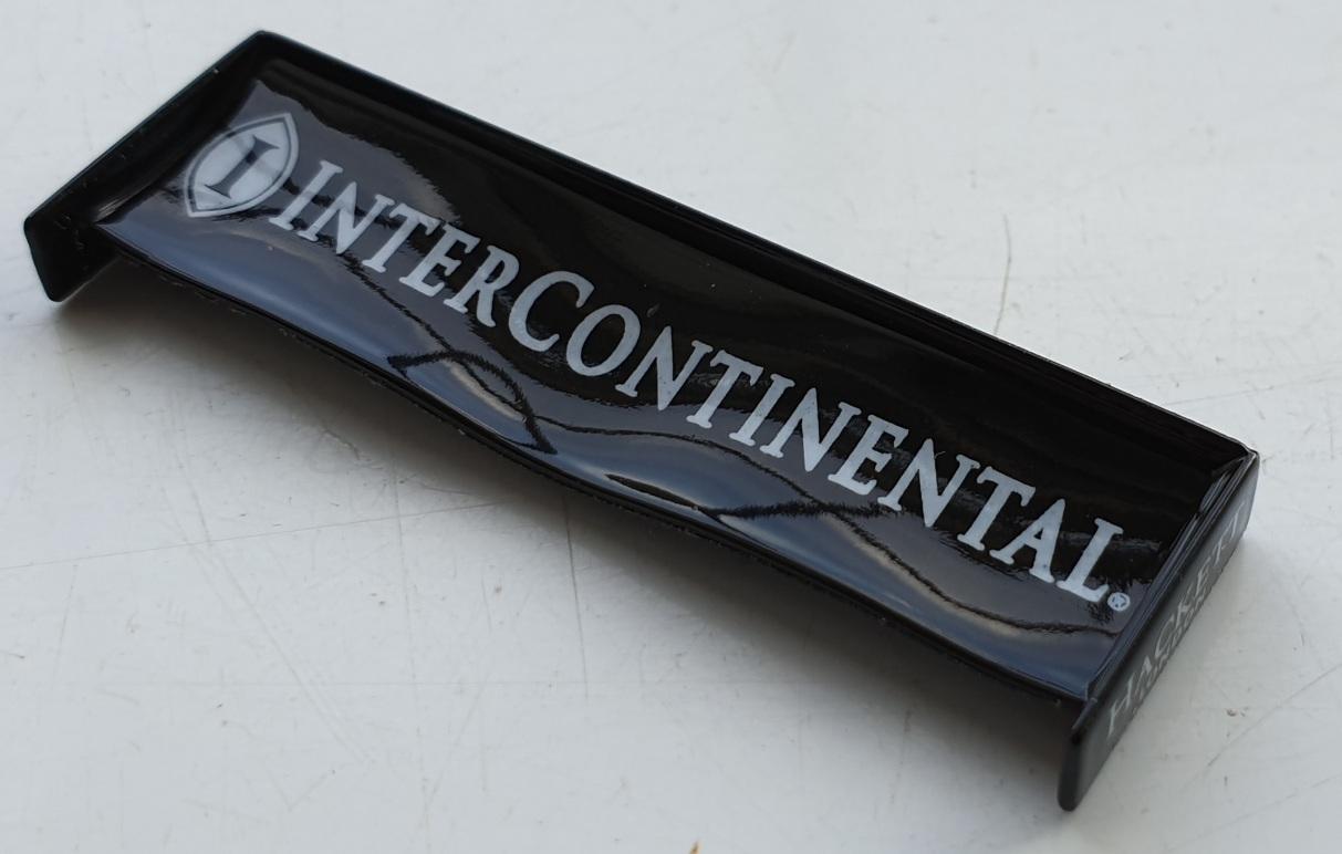

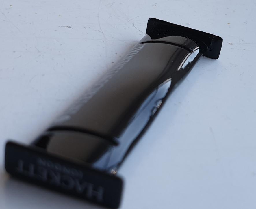

Funkychiken Posted July 14, 2020 Author Posted July 14, 2020 As is often the case in this hobby, 3 steps forward, one step back! I thought about how to mount the rear spoiler for clear coat. I failed at one attempt to mount on the recesses and spray it all in one go. It kept falling off from the pressure of the airbrush. So, I did the top side first, masked and did the bottom after. Top side with 2k zero seen here

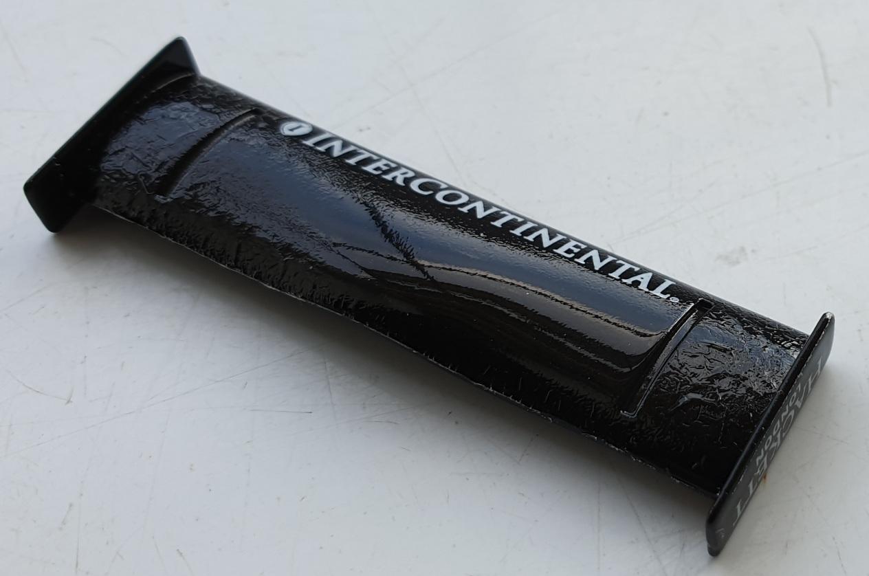

Funkychiken Posted July 14, 2020 Author Posted July 14, 2020 Came out perfectly, no dust! Them masked to do the bottom side with 1k zero Disaster! I'm going to try to send it out.
Funkychiken Posted July 15, 2020 Author Posted July 15, 2020 On 7/14/2020 at 8:16 AM, slusher said: Body looks awesome! Thanks Slush! I have sanded the underside from 400 grit to 1000 grit Tamiya wet and dry Then masked for touching up the black where I'd sanded through the base coat to the primer.

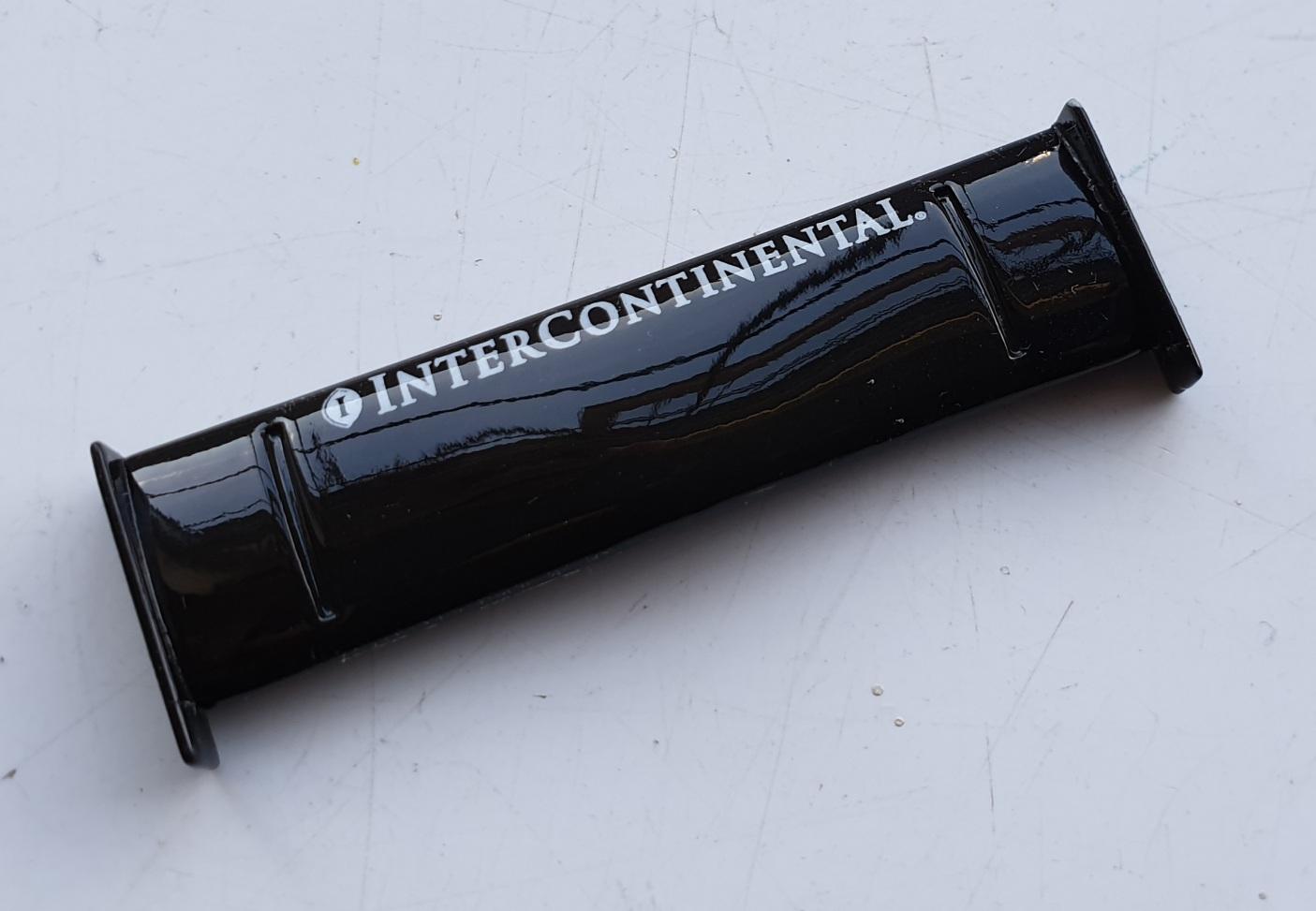

Funkychiken Posted July 15, 2020 Author Posted July 15, 2020 Unfortunately, when taking the Tamiya tape off, it pulled some of the clear coat with it... But I'm not looking for perfection here. I went ahead and clear coated - this time with zero 2k. It came out far from perfect, but to my eyes, it's s save!
Funkychiken Posted July 15, 2020 Author Posted July 15, 2020 Only thing left now is to pick out the black and aluminium details on the shell... Then final assembly!

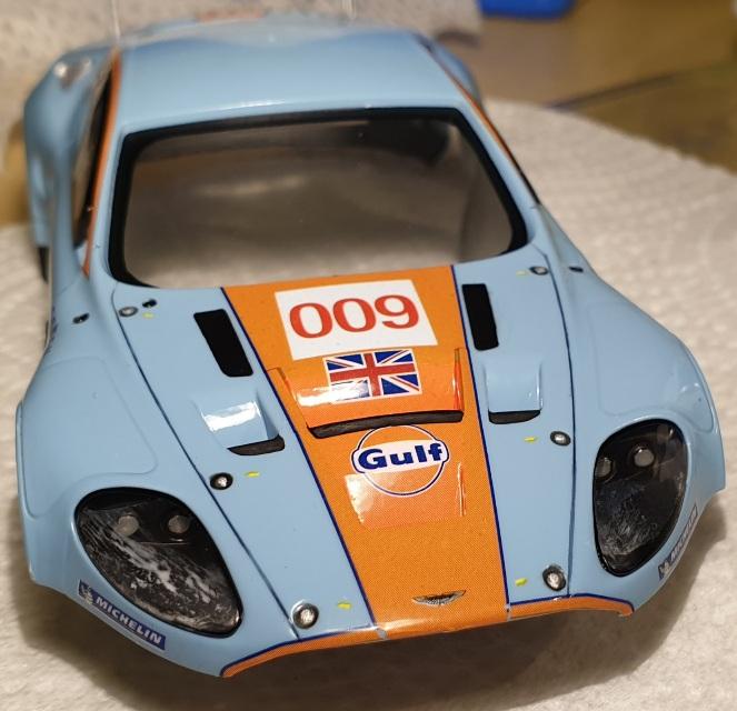

Funkychiken Posted July 21, 2020 Author Posted July 21, 2020 (edited) On 7/18/2020 at 5:15 PM, Dann Tier said: BEAUTIFUL job!!!!.....its a save to me as well!!.....its the underside that helps save it! Thanks Dann, yet another build giving me heartache. Made a rookie mistake, I did glue in the headlamp lenses with PVA, then u messed up and put the light cluster in with CA, and it fogged up... Well be taken apart and sanded... Edited July 21, 2020 by Funkychiken
Funkychiken Posted July 26, 2020 Author Posted July 26, 2020 Taken apart, the clear parts were sanded, polished, waxed, redid the eyeliner, the lamp units had to be sanded and re-sprayed. Back to where we were!

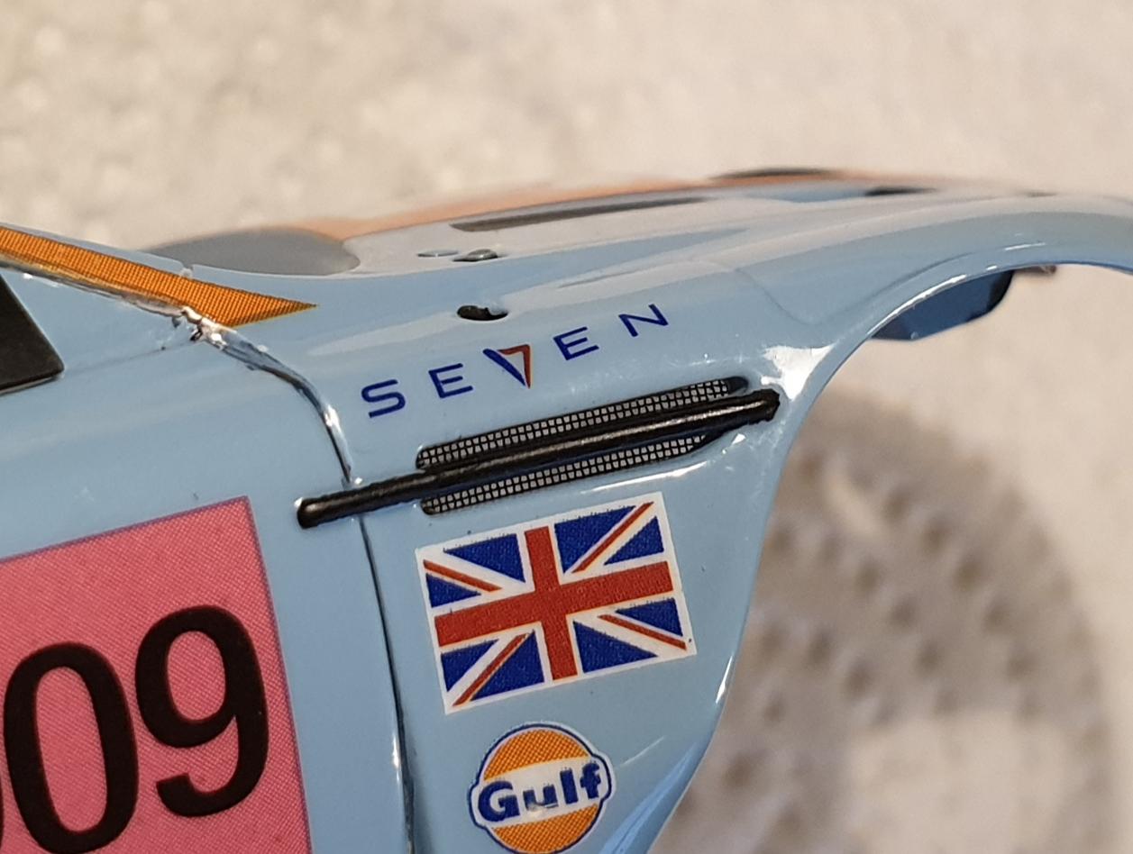

Funkychiken Posted July 26, 2020 Author Posted July 26, 2020 Also added some mesh, I doubt it will be visible in the finished model...

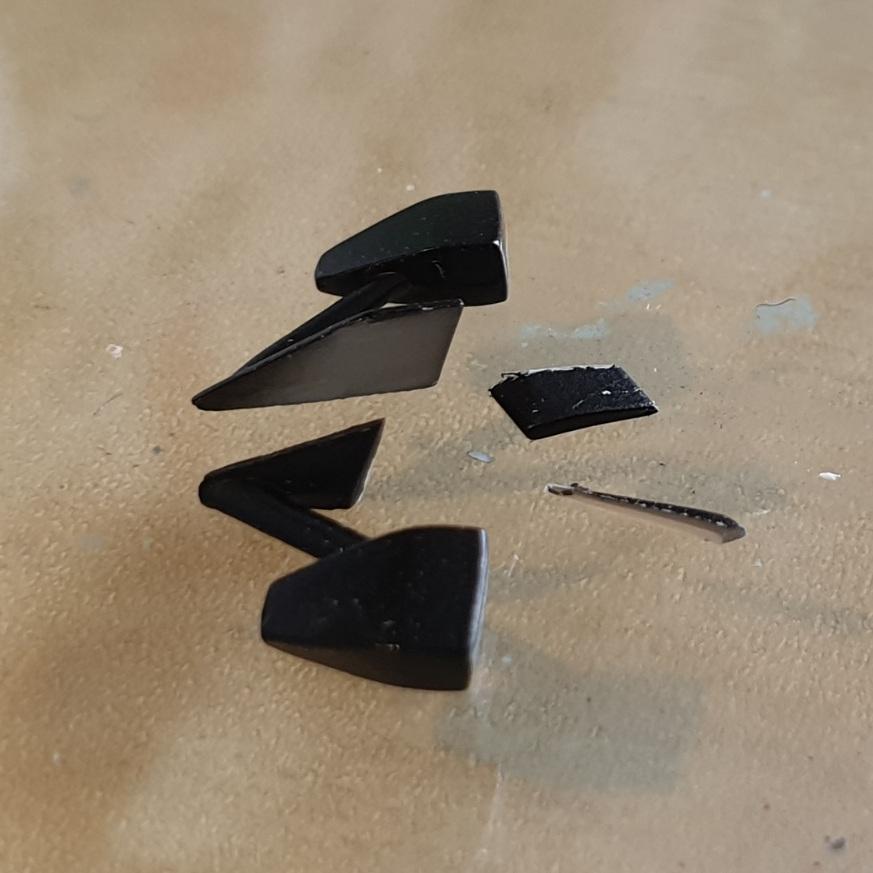

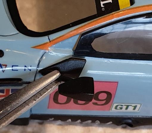

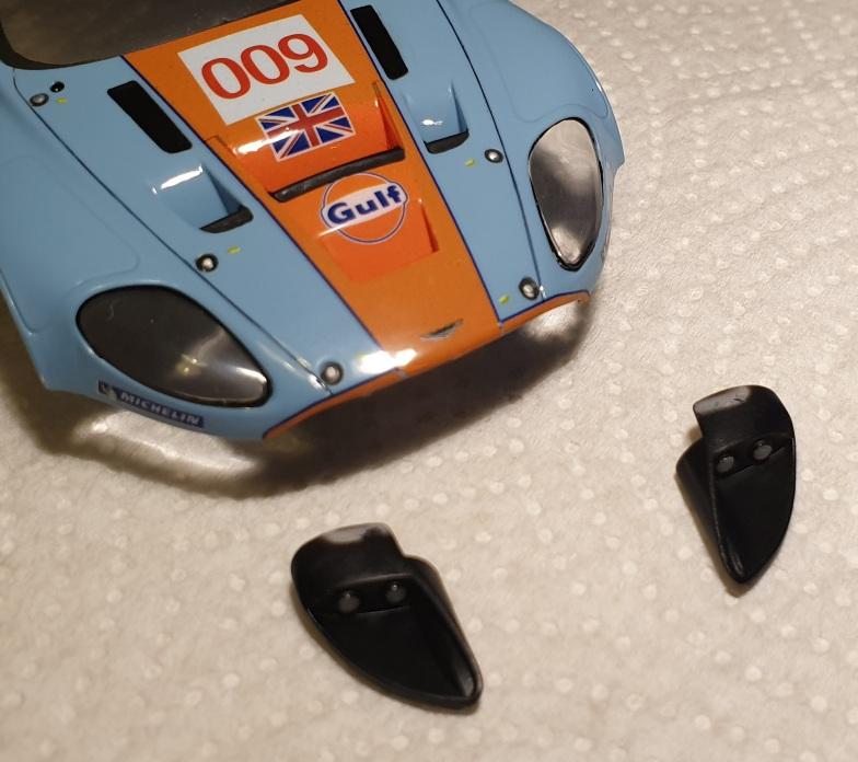

Funkychiken Posted July 26, 2020 Author Posted July 26, 2020 The wing mirror pieces were almost 2 times too big to fit. A lot of the supporting material had to be cut to fit, the 2nd photo shows one before, and one after the chop

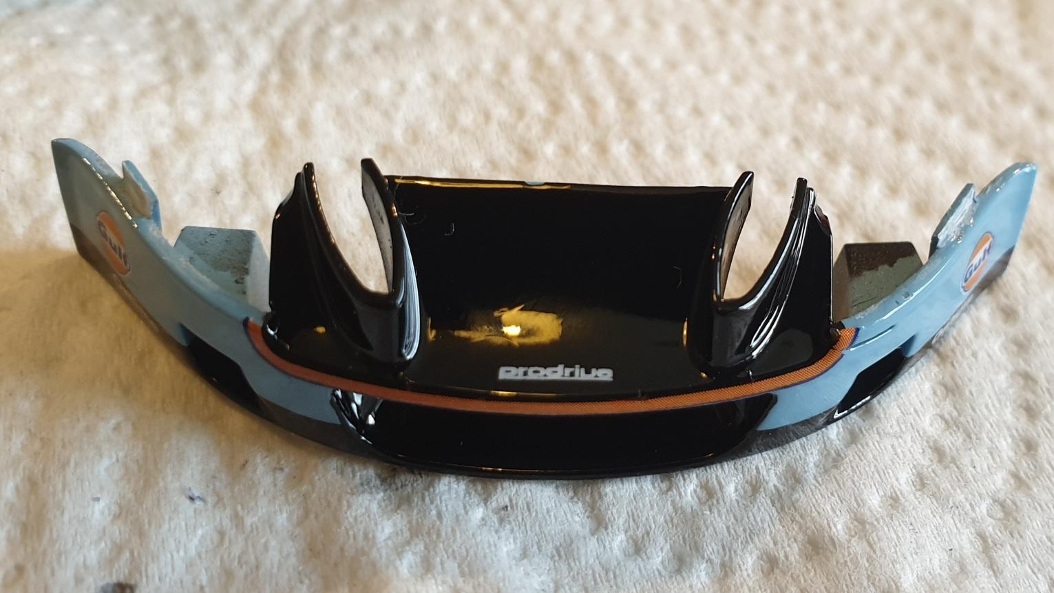

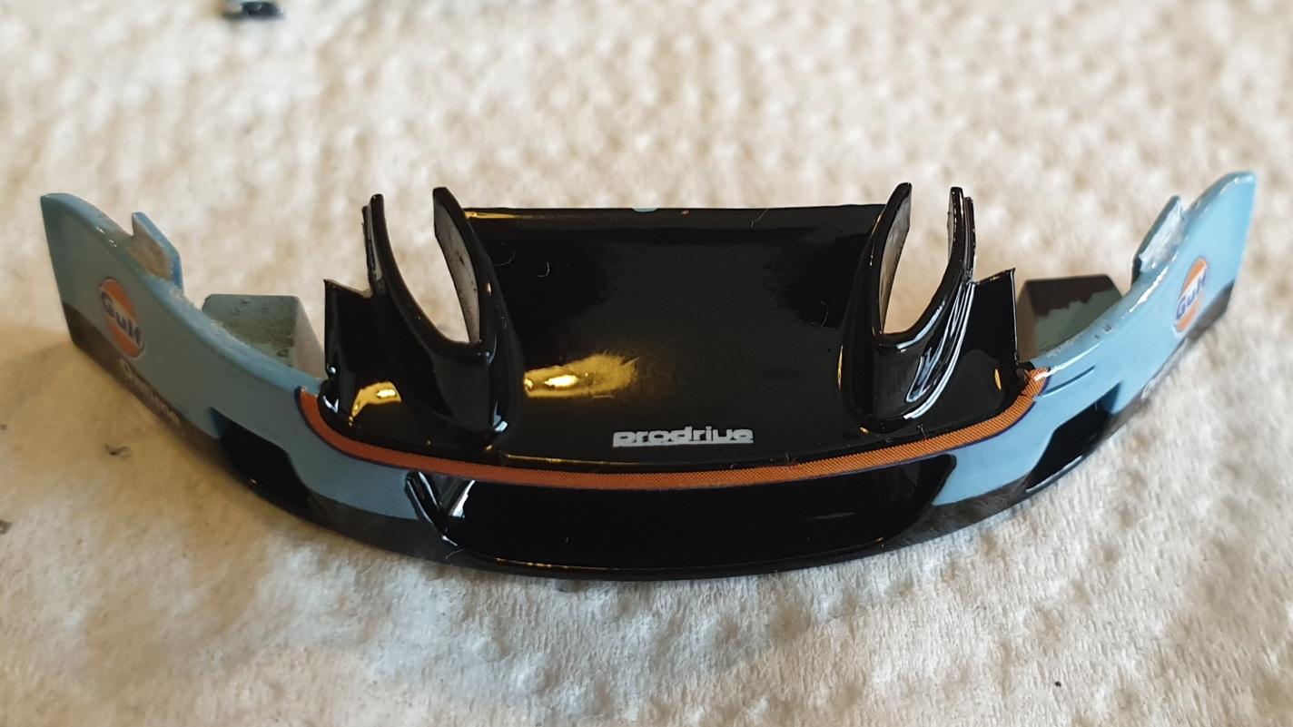

Funkychiken Posted July 26, 2020 Author Posted July 26, 2020 The front bumper wouldn't fit due to a clash between the extreme top left and right back areas of this front end air intake, they were clashing with the underside of the lamp units. The 2nd image shows how much had to be cut to get it to fit Net up will be finished images, unless I have any further disasters!
