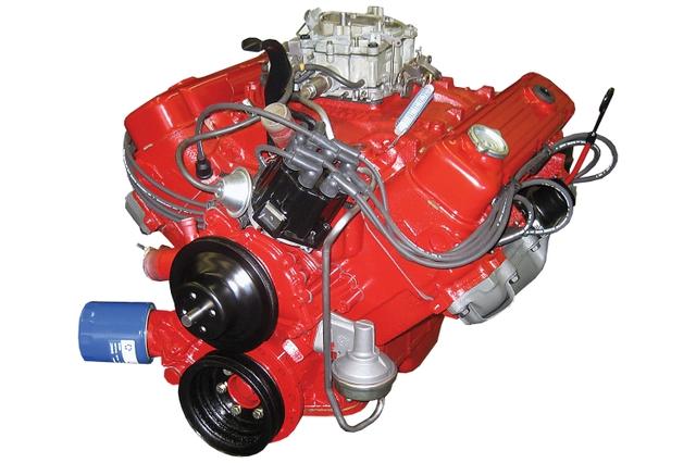

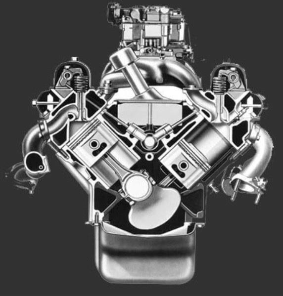

unclescott58 Posted May 15, 2020 Posted May 15, 2020 Okay, I'm not so sure how clear things are on history of Buick V8s after reading the above posts. First the Buick 350 and her sisters 400, 430, 455 are not based the same engine. The Buick 350 was based on an engine that first came in 1964 model year at 300 cu. in. This was enlarged for the '66 models to 340. And finally to 350 for '68. This "small block" engine is mainly related to the aluminum 215 of 1961 and the related 198 V6 of '62. In fact the 300 had the same bore and stroke as the V6, and was manufactured on the same line as used for the aluminum V8. The "big block" Buick V8 came out for the 1967 model year, replacing the venerable nail head used from '53 through '66. It looked close to the Buick small block, but was in reality a different engine. For '67 through '69 it came in two sizes. A 400 and 430. In 1970 both of those engines where replaced by a basically bored out 430, upped to 455 cu. in. I hope this clears a few things up. And I'm sorry to say, I do not know one way or another if there has or hasn't been a model of small block Buick engine. One last thing. The "Star Wars" air cleaner. As far as I know, it was only used on the '67 Buick GS400 and '67 Buick Riviera with the GS package. It was first seen in model form in the AMT '67 Riviera kit. And was continued in the '68 and '69 kits. But, not seen on the real cars after '67.
unclescott58 Posted May 15, 2020 Posted May 15, 2020 (edited) On 5/14/2020 at 8:38 AM, espo said: Just mount the Distributor in front and see how it looks. The oil filter would need to be moved to the front, right side of the block too. Edited May 15, 2020 by unclescott58
espo Posted May 15, 2020 Posted May 15, 2020 Just now, unclescott58 said: The oil filter would need to be moved to the front, left side of the block too. This is true along with the fuel pump and maybe even the alternator.

NOBLNG Posted May 15, 2020 Author Posted May 15, 2020 (edited) On 5/14/2020 at 8:06 AM, NOBLNG said: The 350 (450 lbs) is a smaller version of the 430/455 (600 lbs). It may look similar, but it has a 1/2” lower deck height and is 150 lbs lighter. 5 hours ago, unclescott58 said: Okay, I'm not so sure how clear things are on history of Buick V8s after reading the above posts. First the Buick 350 and her sisters 400, 430, 455 are not based the same engine. The Buick 350 was based on an engine that first came in 1964 model year at 300 cu. in. This was enlarged for the '66 models to 340. And finally to 350 for '68 The "big block" Buick V8 came out for the 1967 model year.... You are correct Scott. The 350 design is based on the aluminum 215 and preceded the big block. They may look similar, but they are not. Edit: But for the purpose of my model, I can easily make the 430 look like a 350.? Edited May 15, 2020 by NOBLNG
NOBLNG Posted May 15, 2020 Author Posted May 15, 2020 (edited) On 5/14/2020 at 8:38 AM, espo said: Just mount the Distributor in front and see how it looks. 5 hours ago, unclescott58 said: The oil filter would need to be moved to the front, right side of the block too. 5 hours ago, espo said: This is true along with the fuel pump and maybe even the alternator. I was going to take the front cover/oil filter/fuel pump assembly from the V6 and graft it onto a SBC, but the block is quite undersized and the heads don’t look right. The seller I got the ‘69 Riv from was also selling a separate 430 engine...so I bought it too!? Edited May 15, 2020 by NOBLNG
